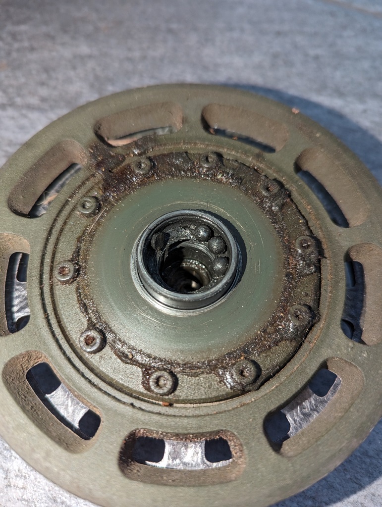

I was doing some maintenance on the Cent BARV and spotted the RH idler was a little loose.
So I removed the hub cap, expecting to have to tighten up the fixing cap.
Nope, still nice and tight.
So I removed the idler completely...

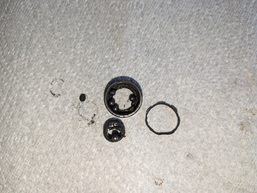

Inner bearing is toast. Some of the ball bearings came out in pieces :shock:
Being at the front, idlers on Centurions are very exposed, so I wonder if this model has suffered a front end collision, which damaged the bearing somehow.
I've ordered new SKF bearings, and will replace all four at the front, just in case.

so ist es wenn man billige Lager einbaut !
Wer billig kauft zahlt doppelt
SKF Lager sind immer eine gute Wahl^ :D

Adrian if everything was still tight l doubt it would be collision damage that caused it. probably just a bearing failure. Seen plenty bearing breakups when l was working on bikes.

The BARV has been in the sea , so sand and salt may have got into the bearing and over time caused it to deteriorate to the point of failure.
