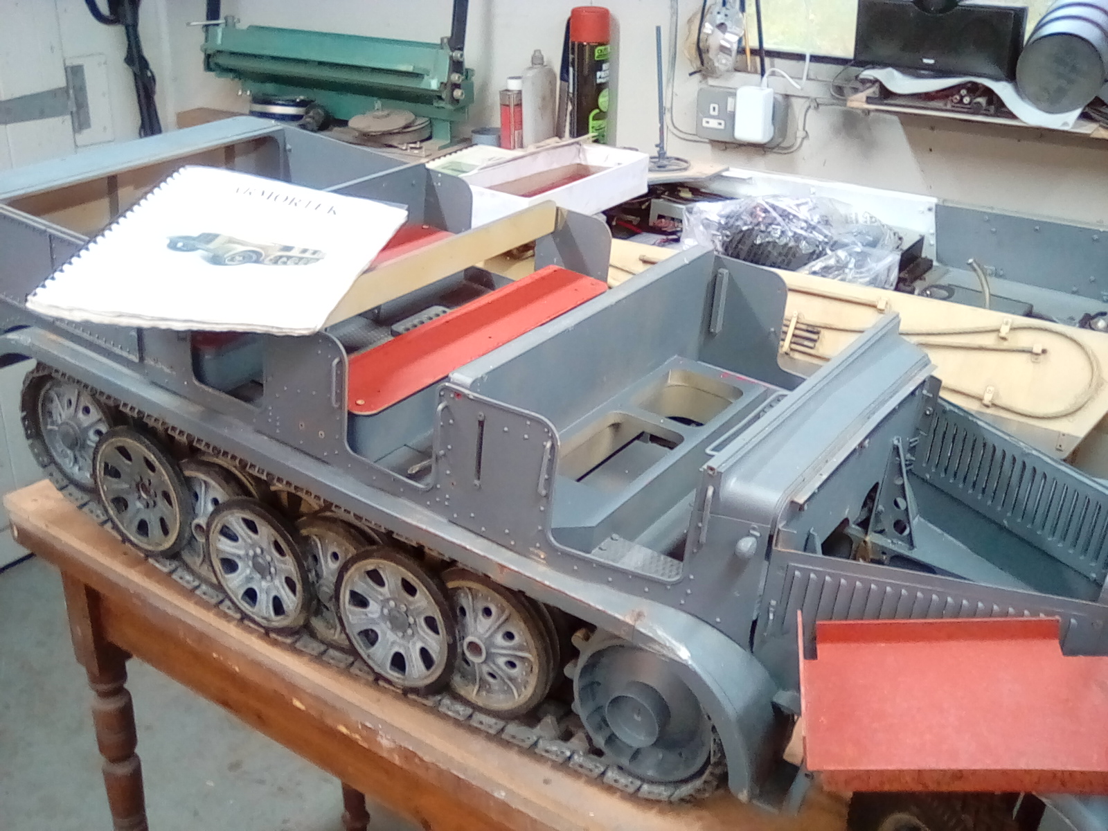

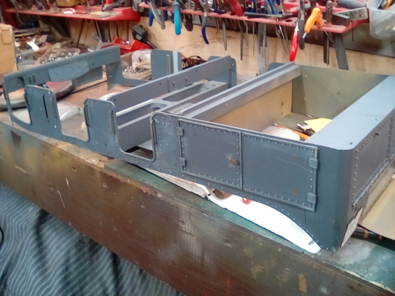

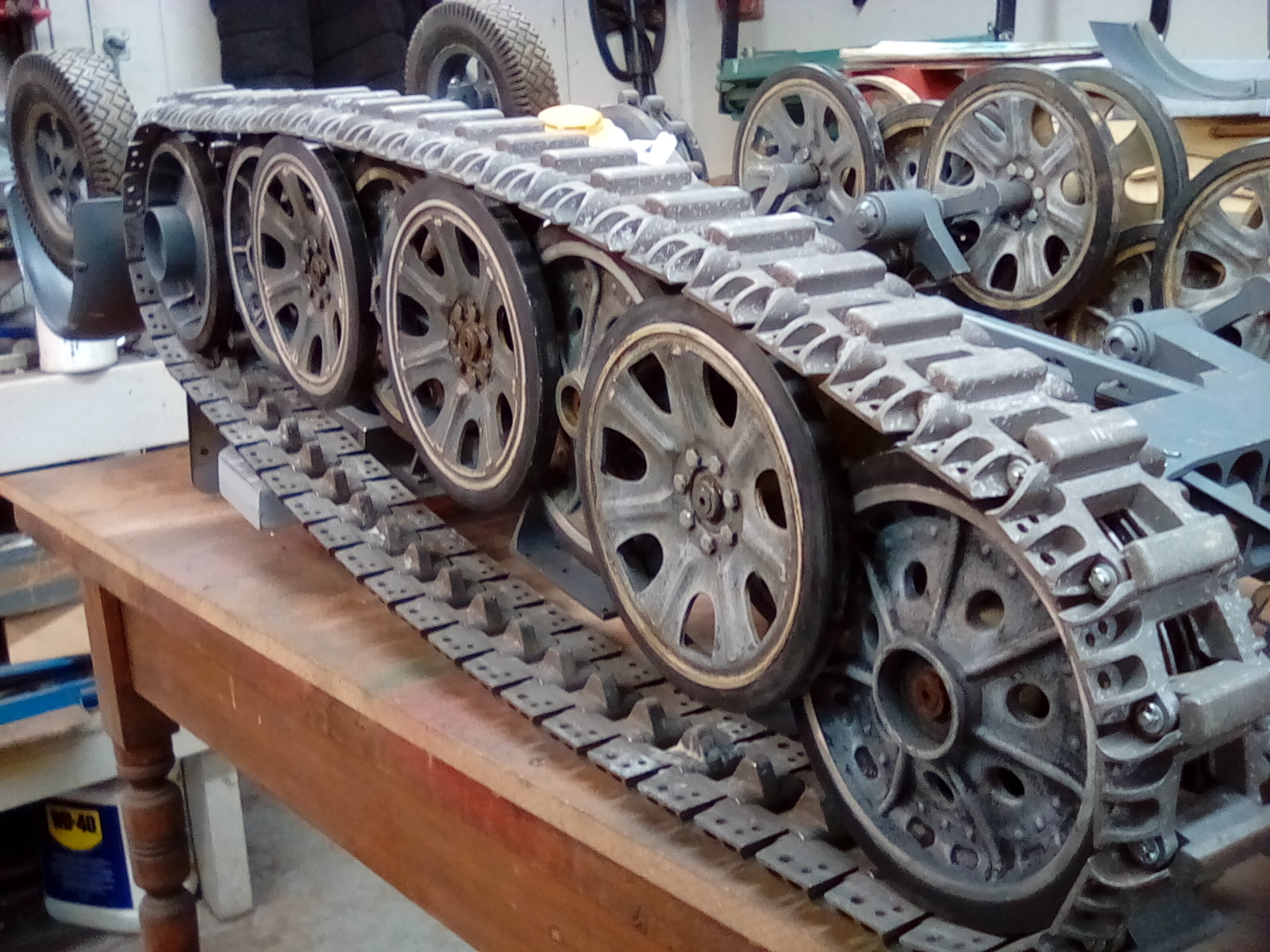

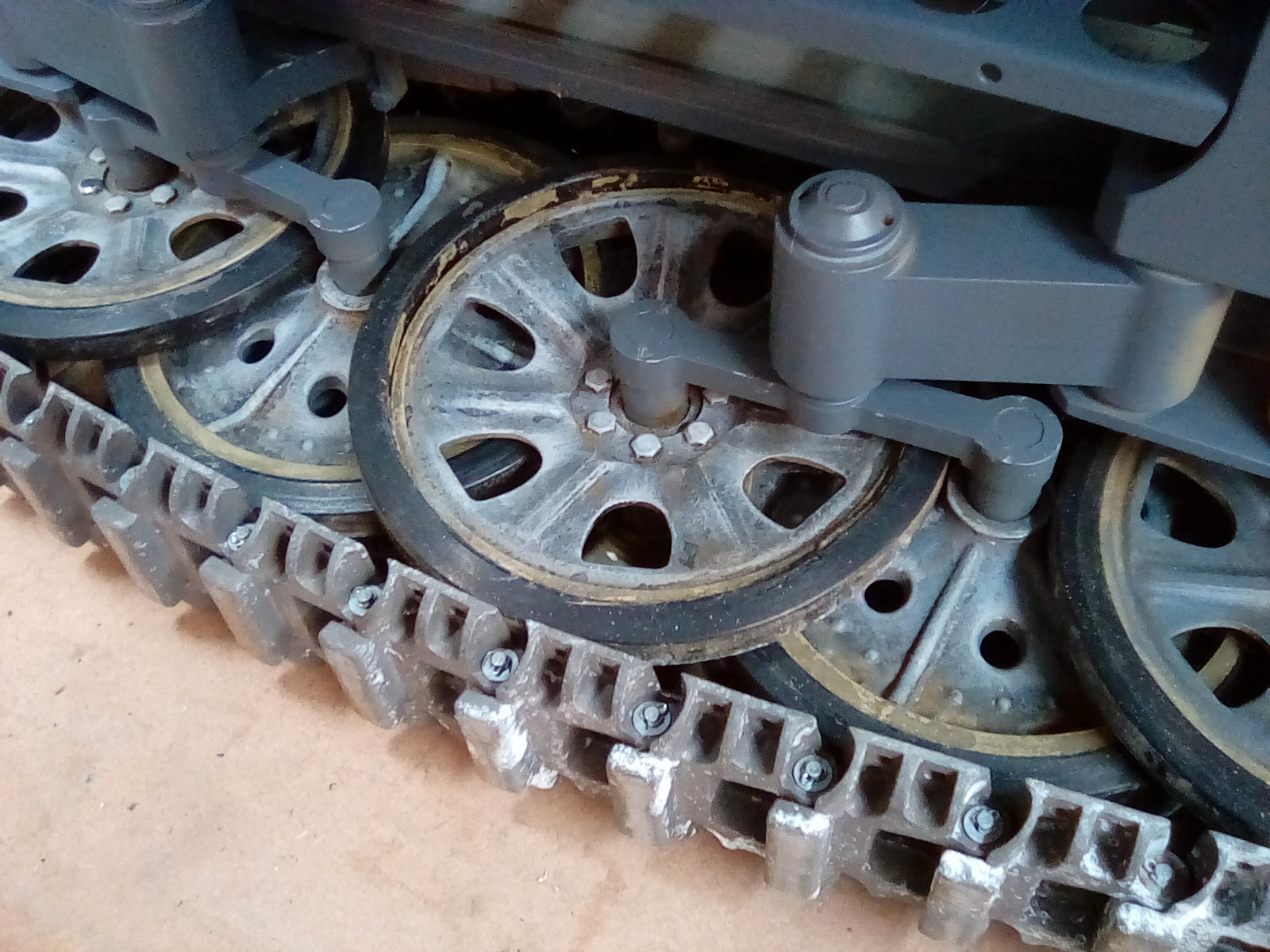

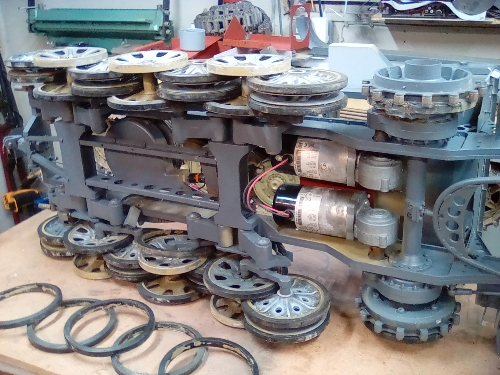

Lots done. The body has been removed. There are some nice details on this model.
After a short time running each track it's obvious something is rubbing, see ali dust.

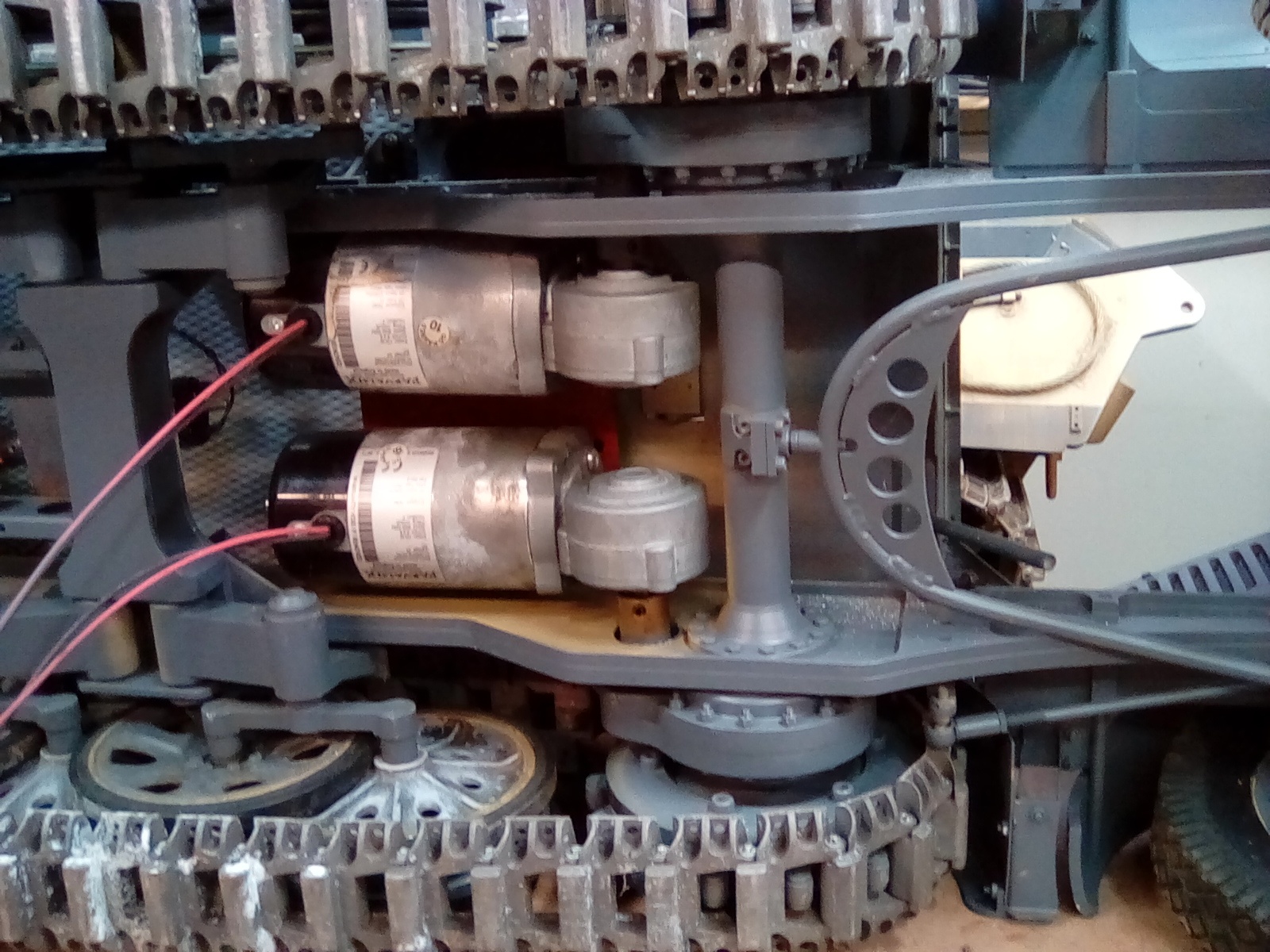

Motors and gearboxes working well

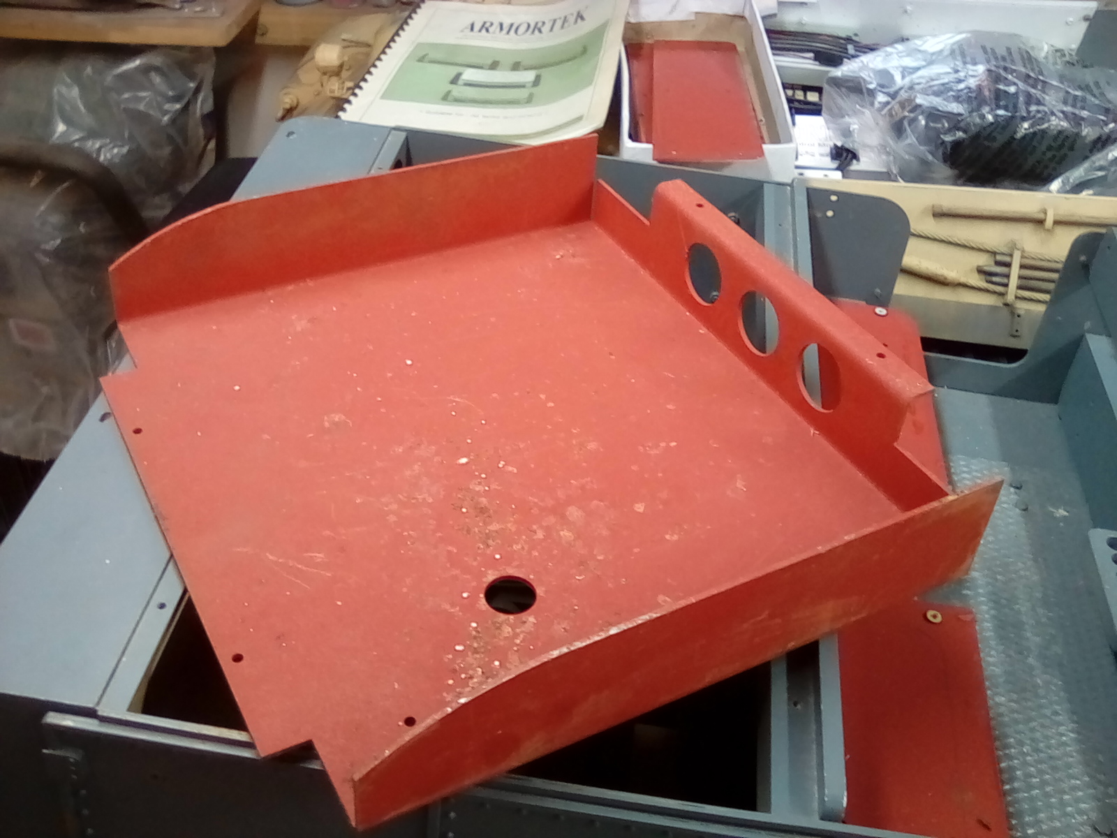

We are not sure where this tray has come from but it's not from inside this model
We don't have this tray

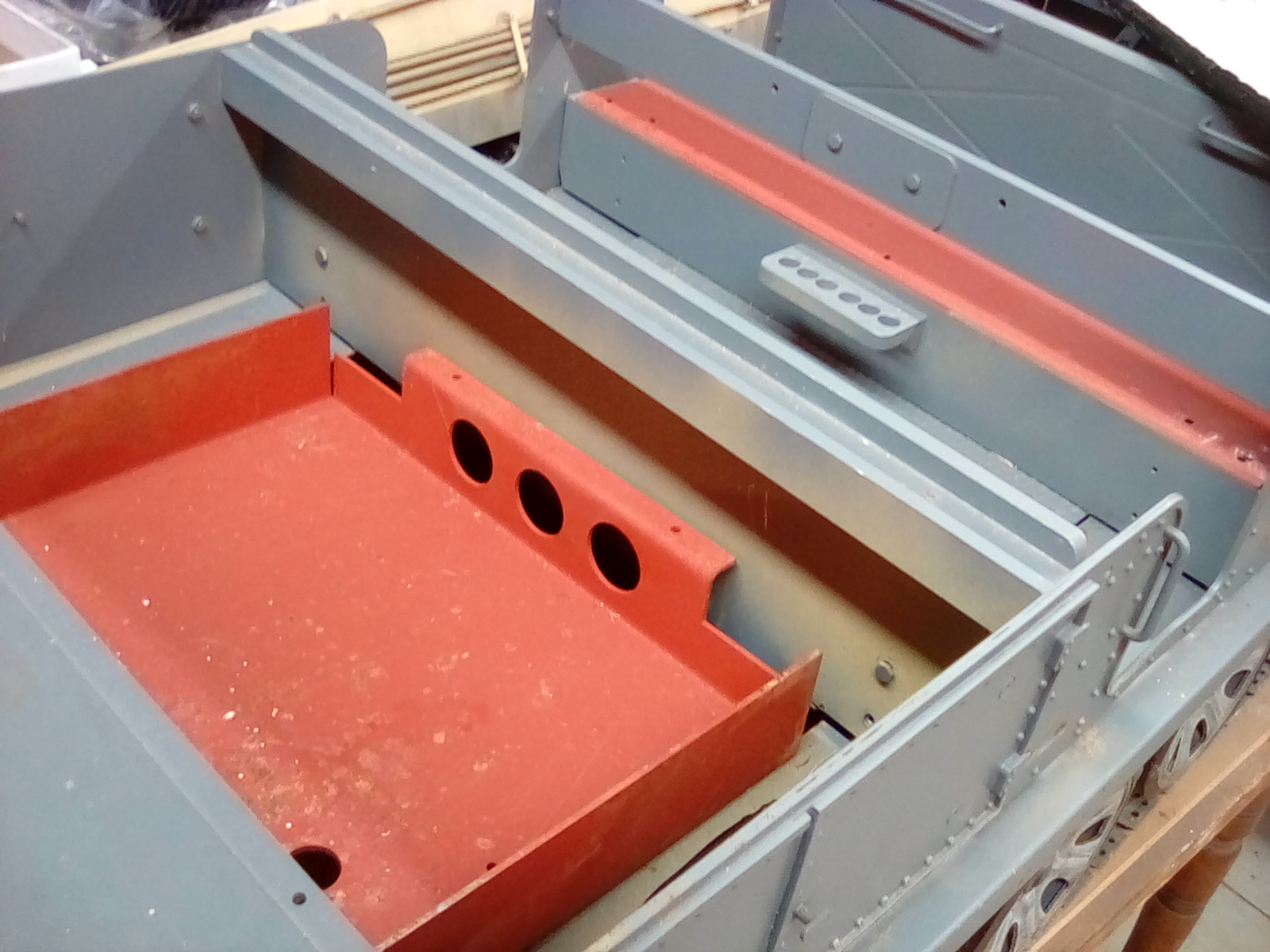

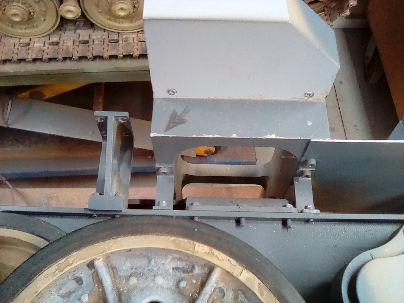

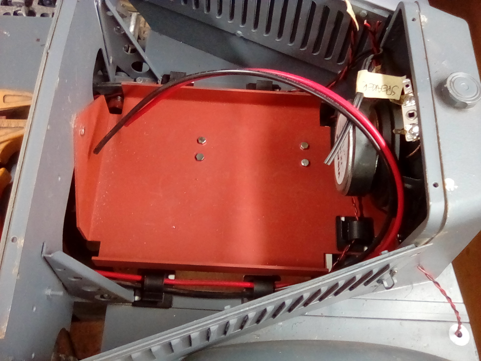

After a bit of tin bashing the battery tray now fits

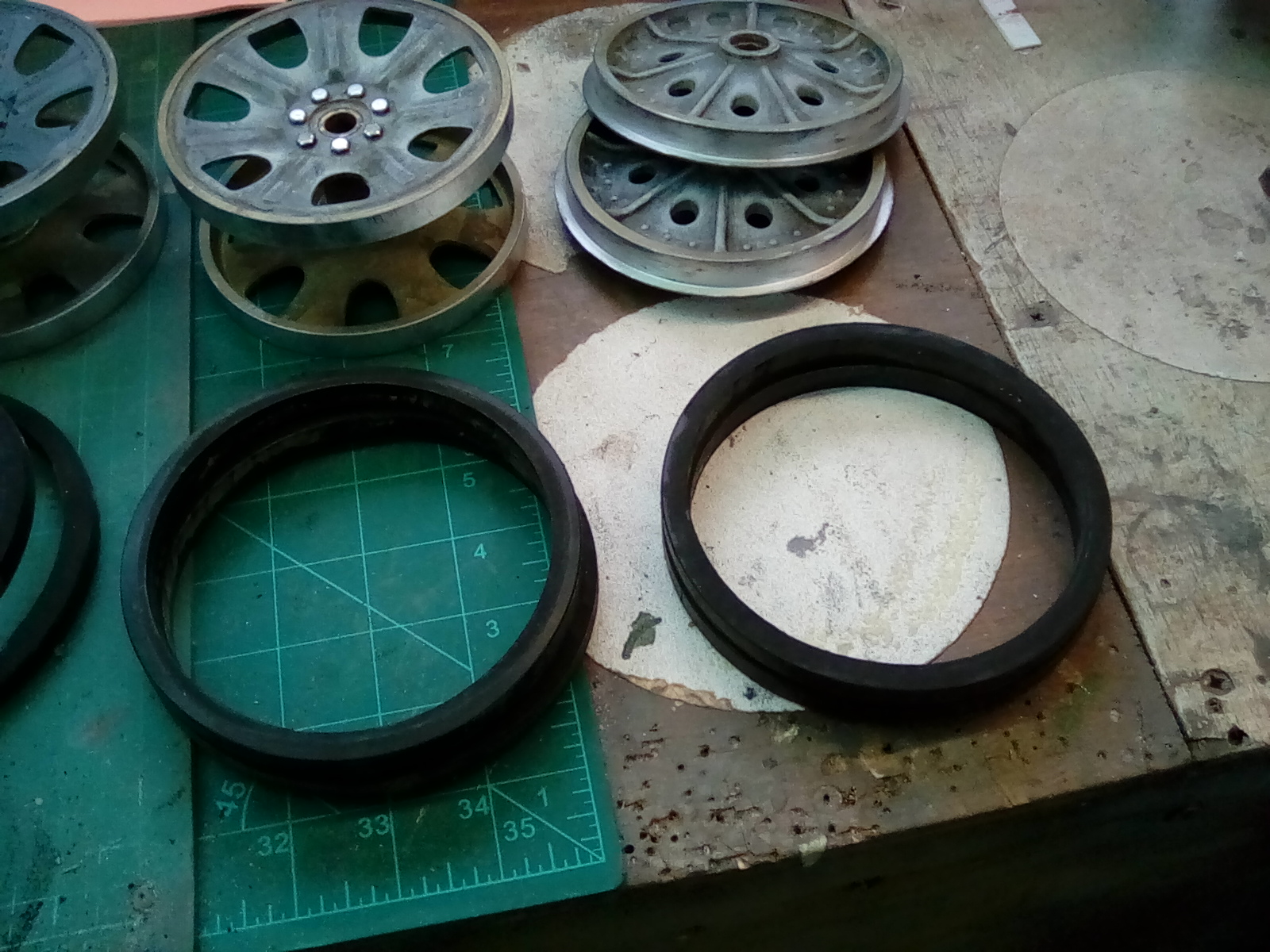

No rubber on this sides sprocket, I may have to make the tyres

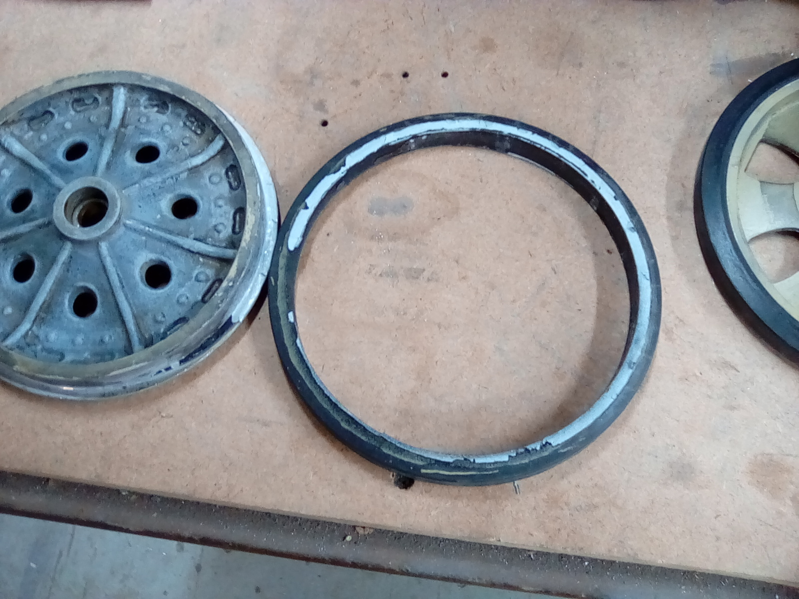

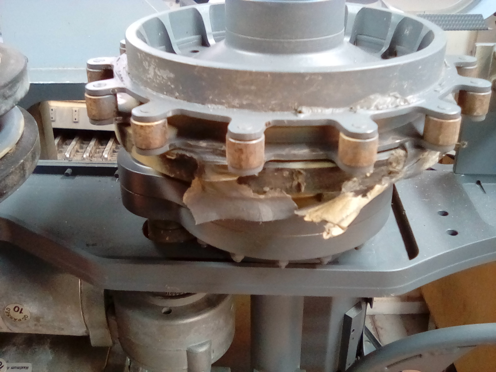

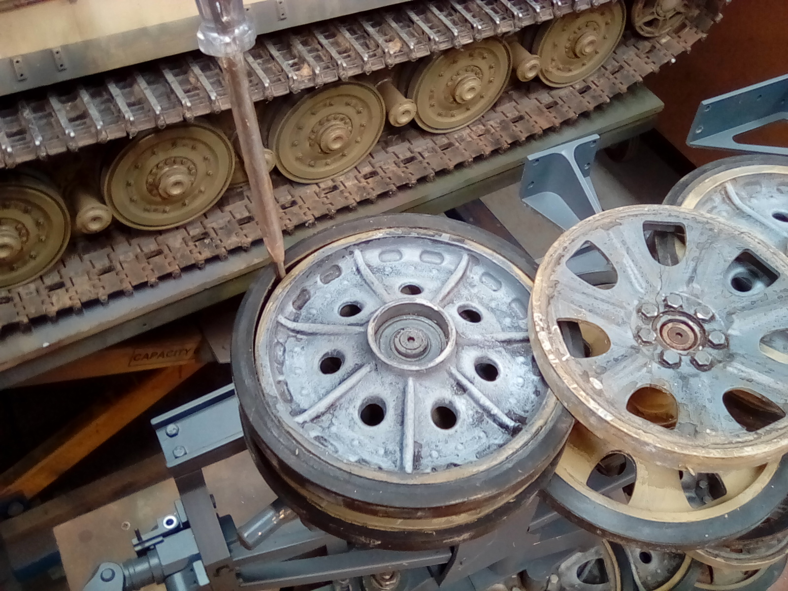

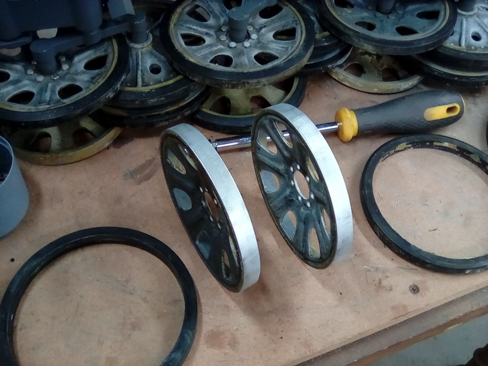

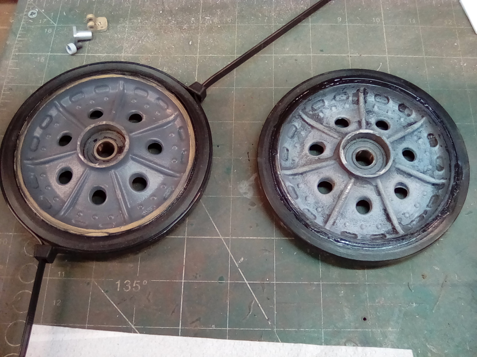

I'm afraid the bonding has deteriorated over time, she was made nearly 20 years ago.

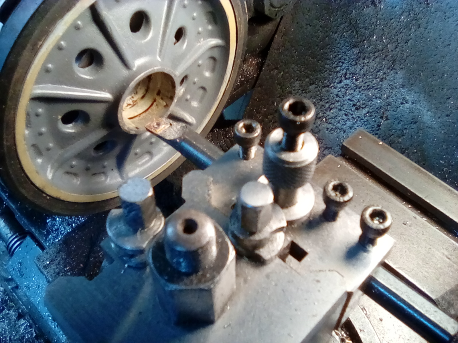

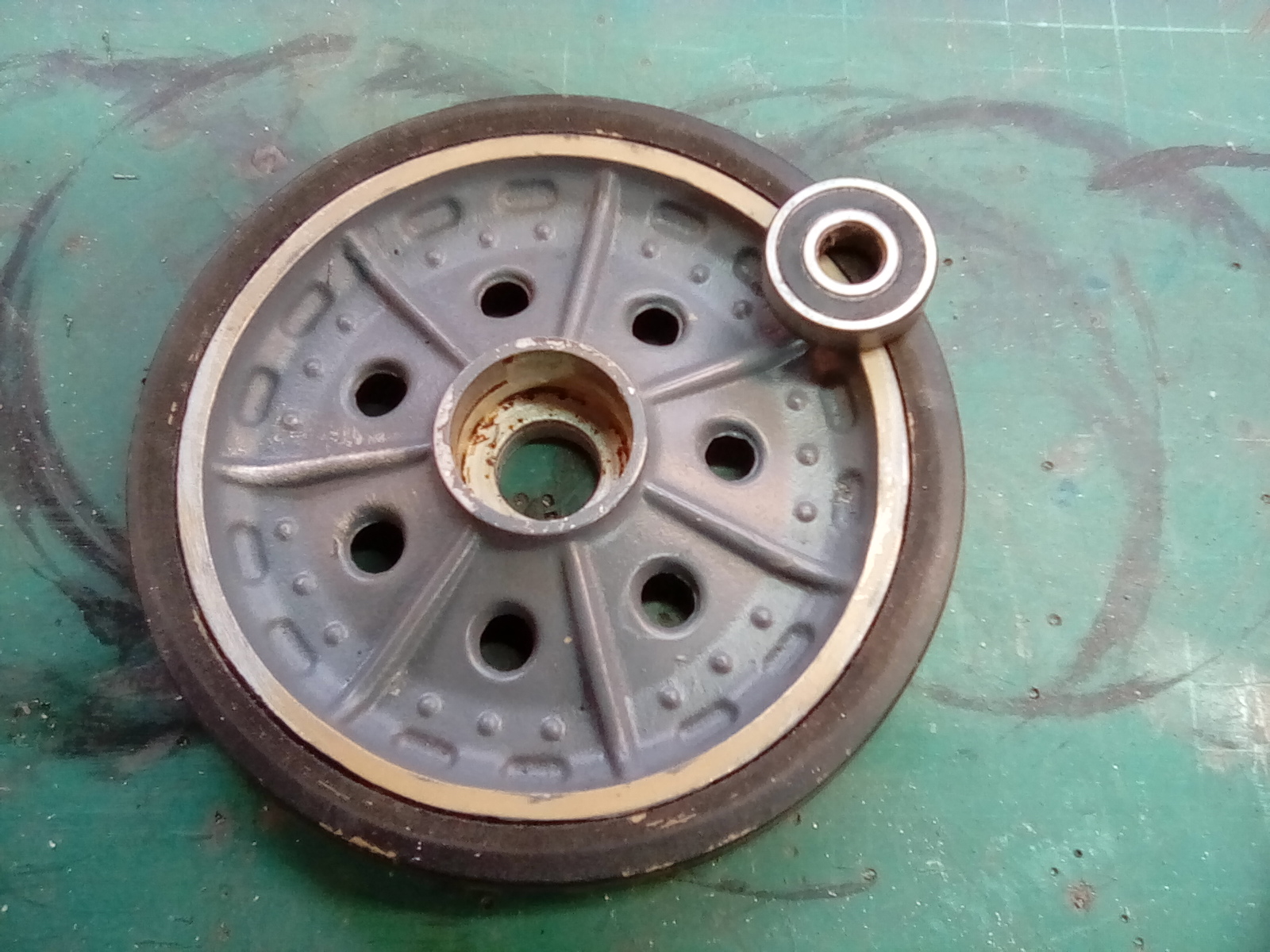

All the wheels will need some lathe work to remove the old bonding, then all needs rebonding once more
There are some nice details in that rear end.
I can now see what I'm doing
All the rubber needs rebonding, I just hope the tyres are not stretched ie going to be too slack, although if you then use epoxy once more it will fill that gap, I've just ordered some nice fresh Locktite 480 as I like to use that above all else
Has liked: 2281 times
Re: Motion and sounds packs

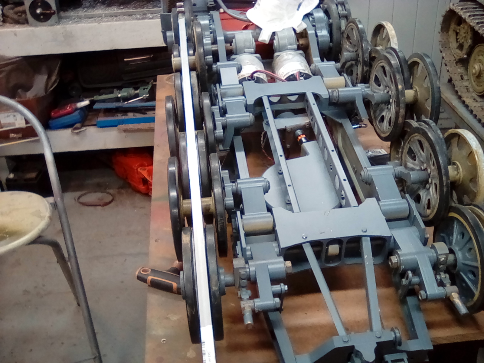

I'm getting my teeth into her now and I am slowly finding the areas that need fetling, it's all very tight around those road wheels. It's worth noting that this model was built by its last owner as a "static" and build very well. Time in damp conditions has taken its toll.

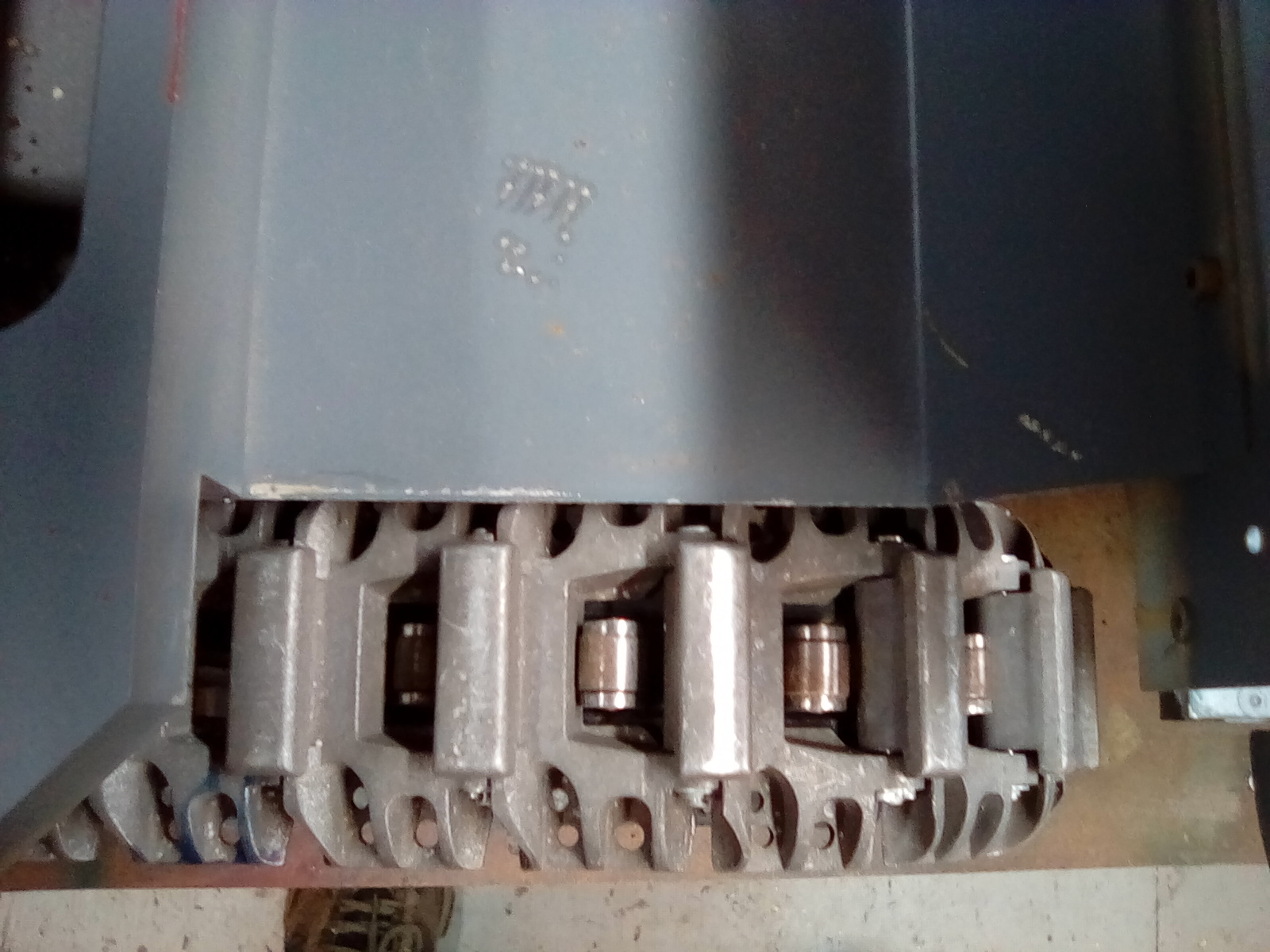

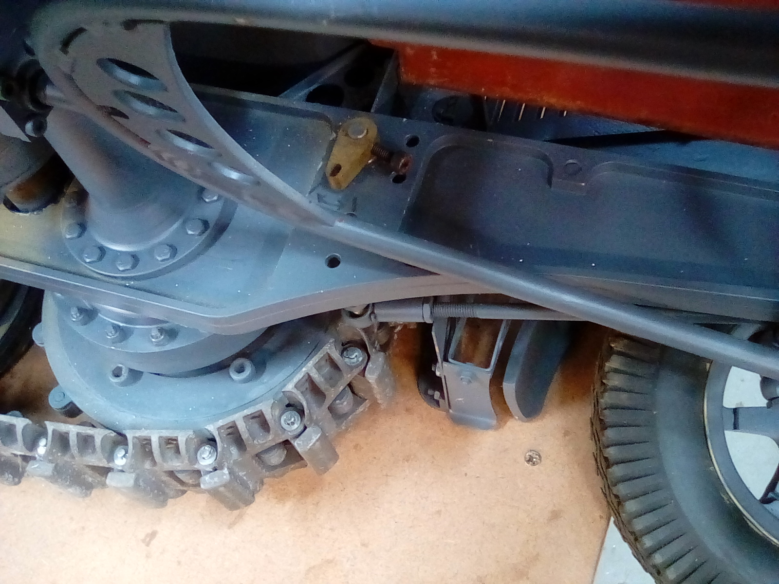

This right angled edge needs dressing back as it's interferes with the track during " track wip"

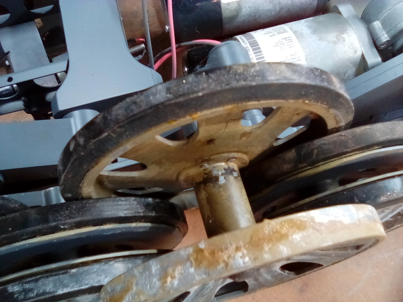

Bolts shaken loose and missing.
Rust on the bearing surface needs removing and a grease applying, if they are all tight it just won't run right.

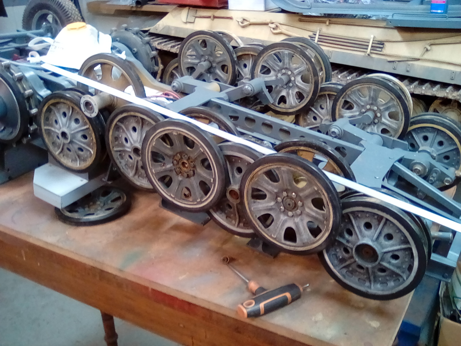

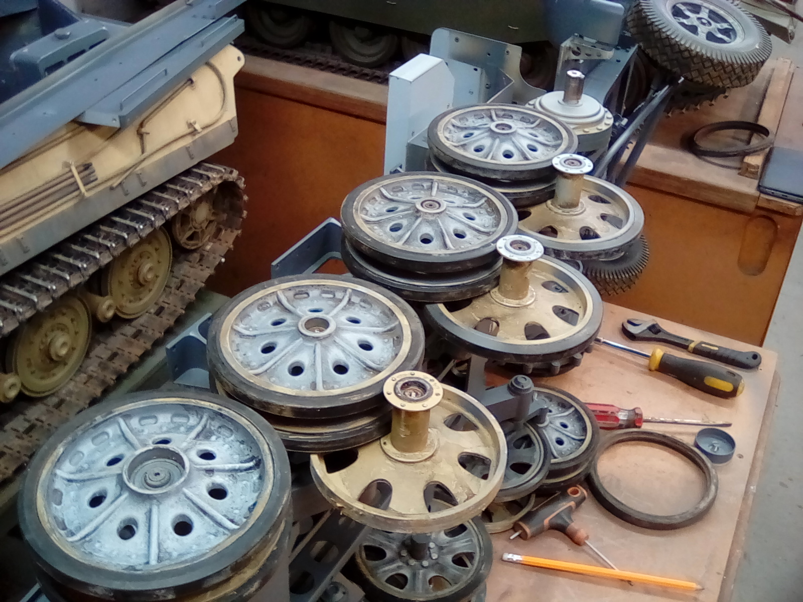

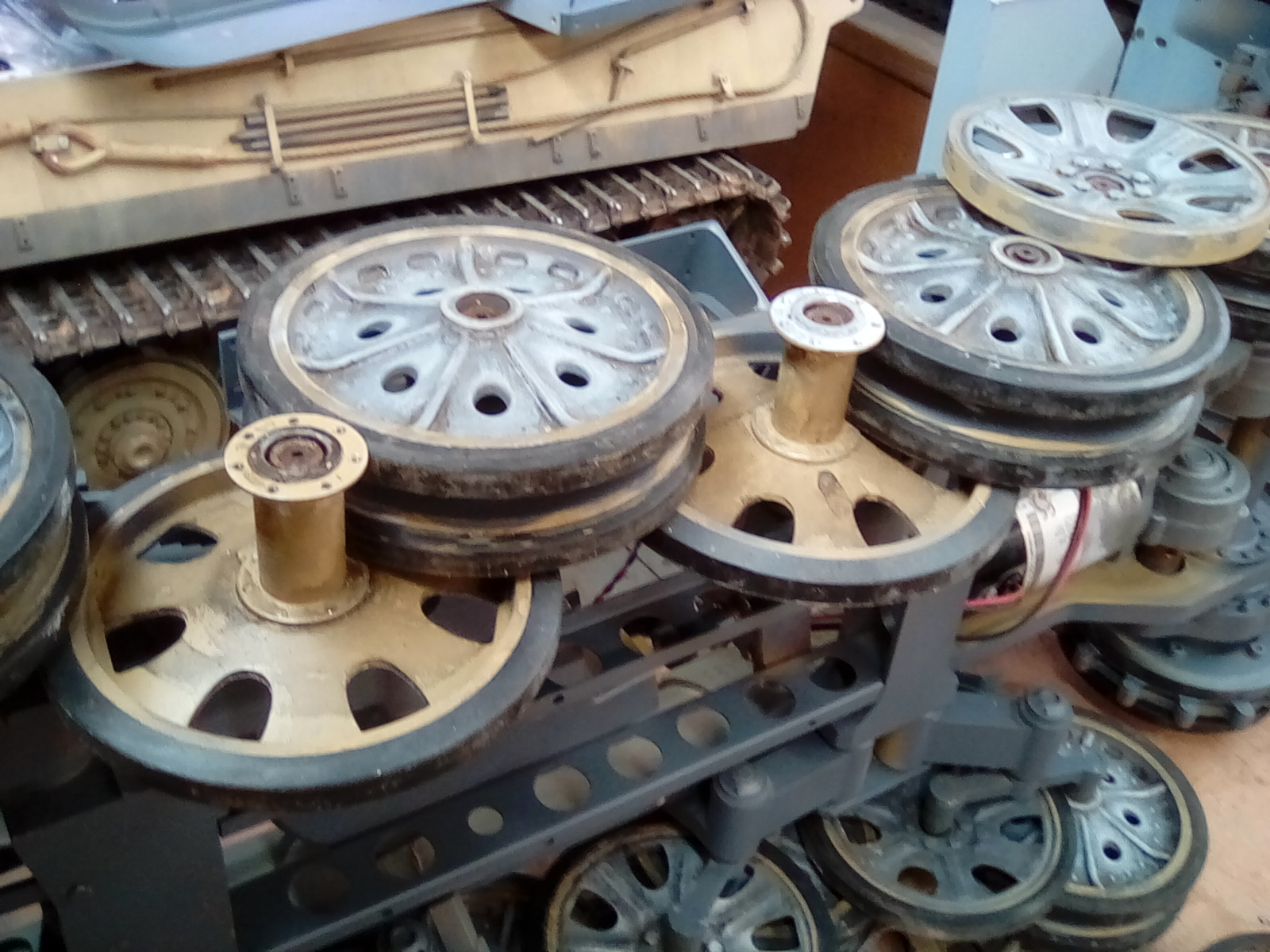

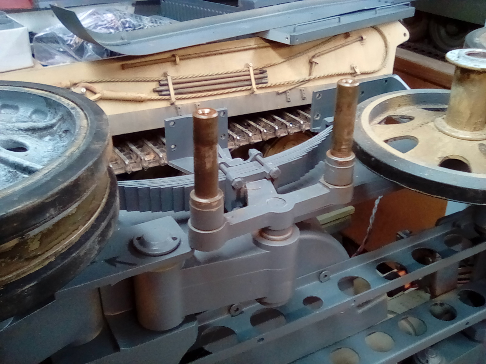

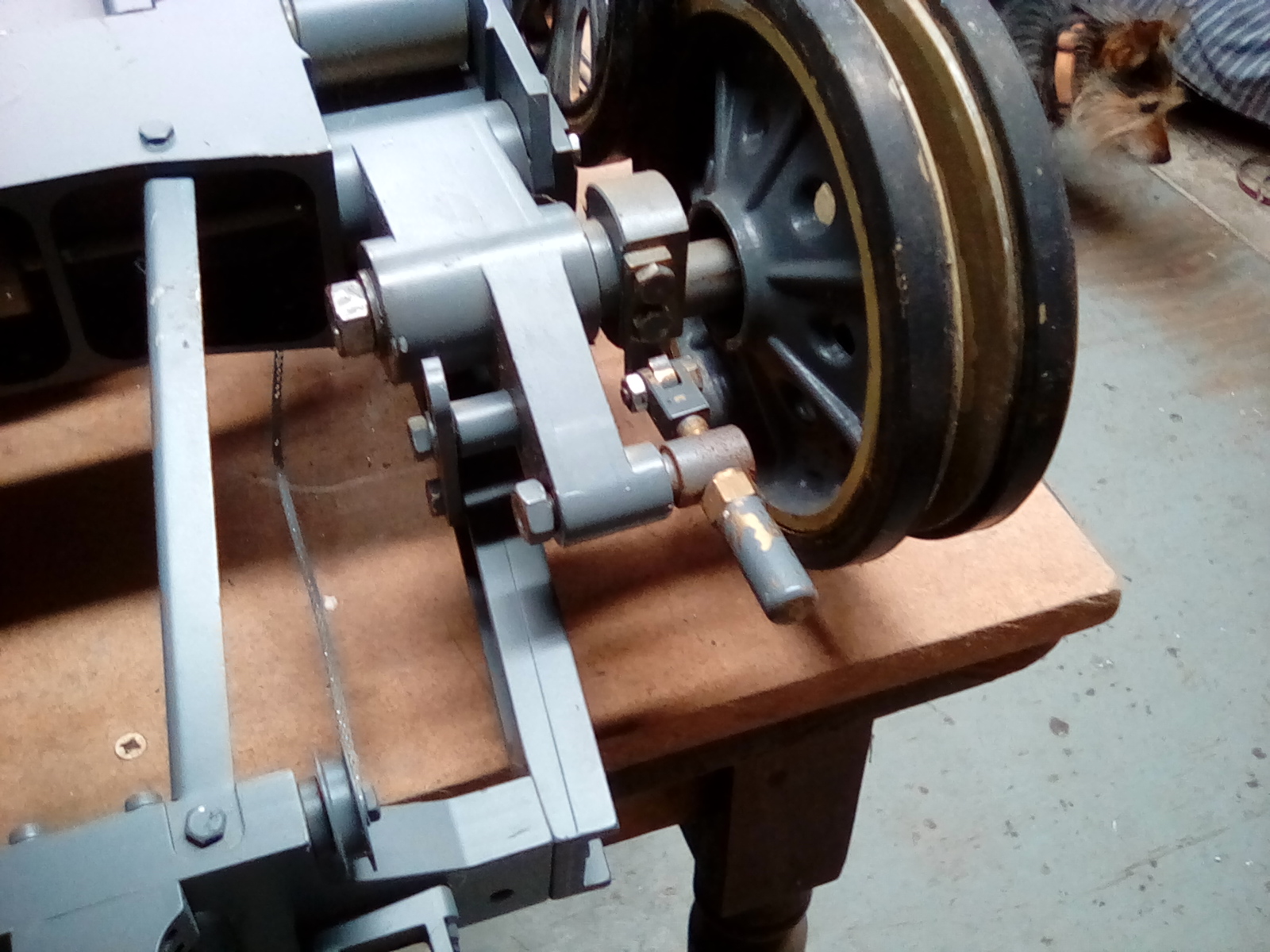

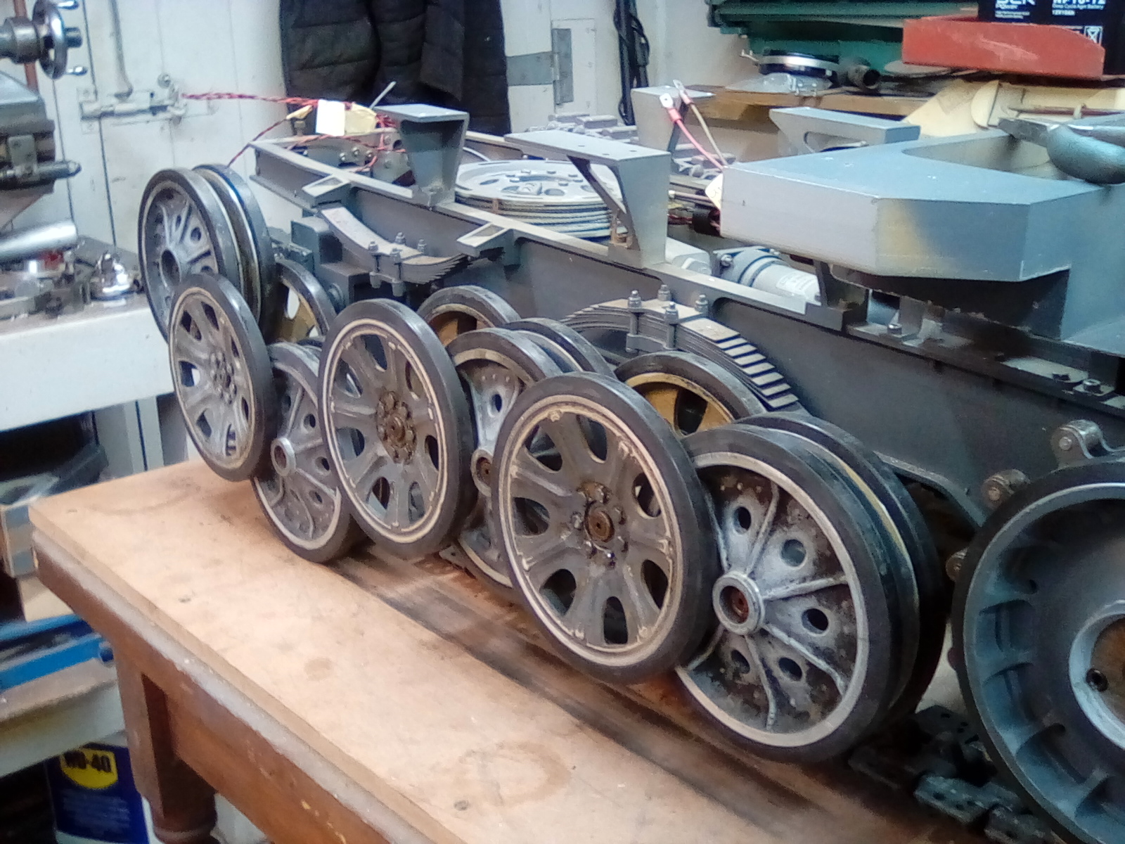

If you angle the road wheels sets like this assembly and disassembly is so much easier .
This bonded joint here pushes the tyre to far over, it needs to be flush as the clearance is crucial .

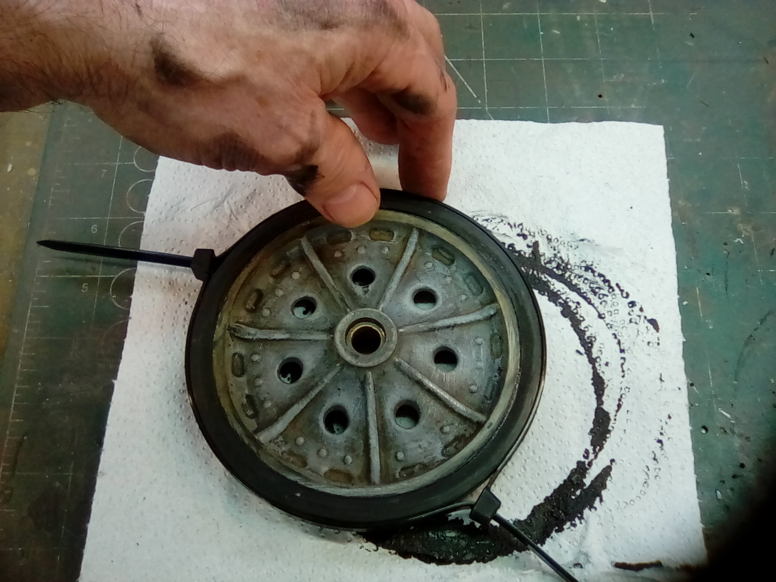

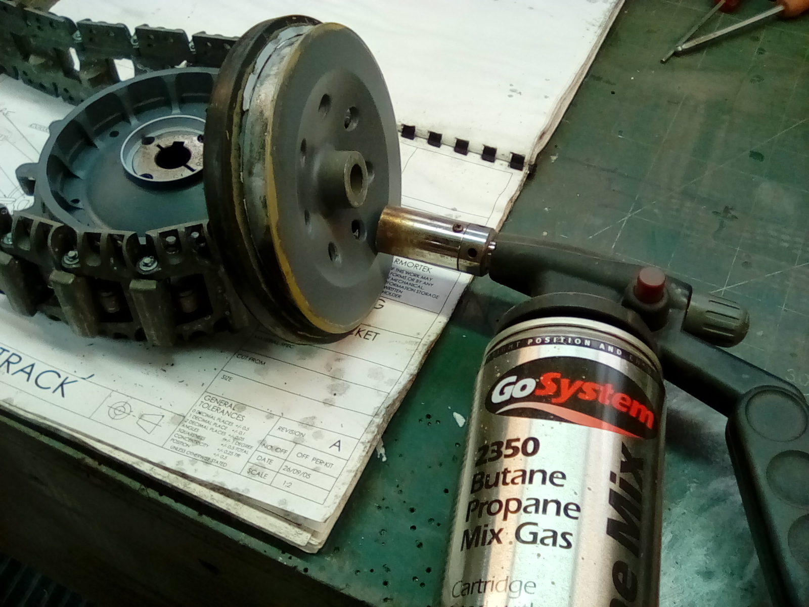

A little heat releases the adhesive.
The double road wheel sets have copious amounts of adhesive at the rear face which is causing the tyres to rub the opposing wheel set, on its own this is not a big deal but all the road wheels rubbing this way is just to much resistance.

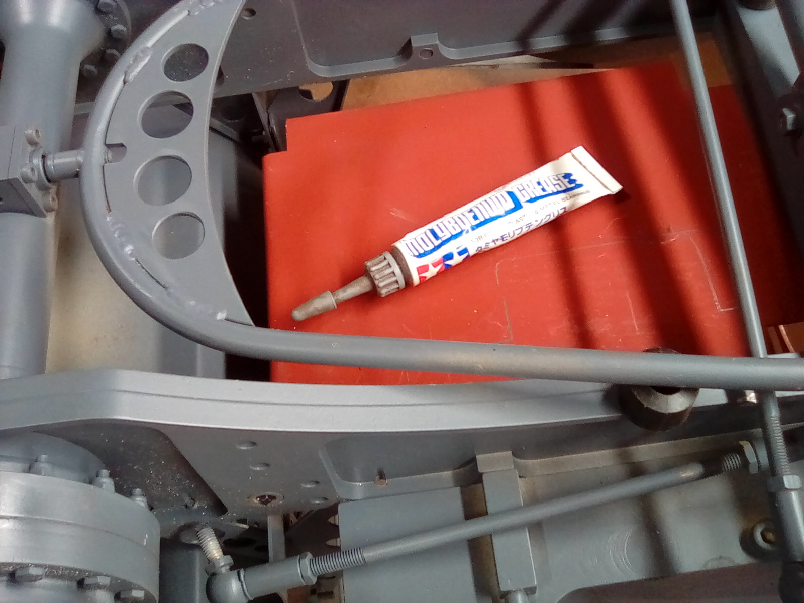

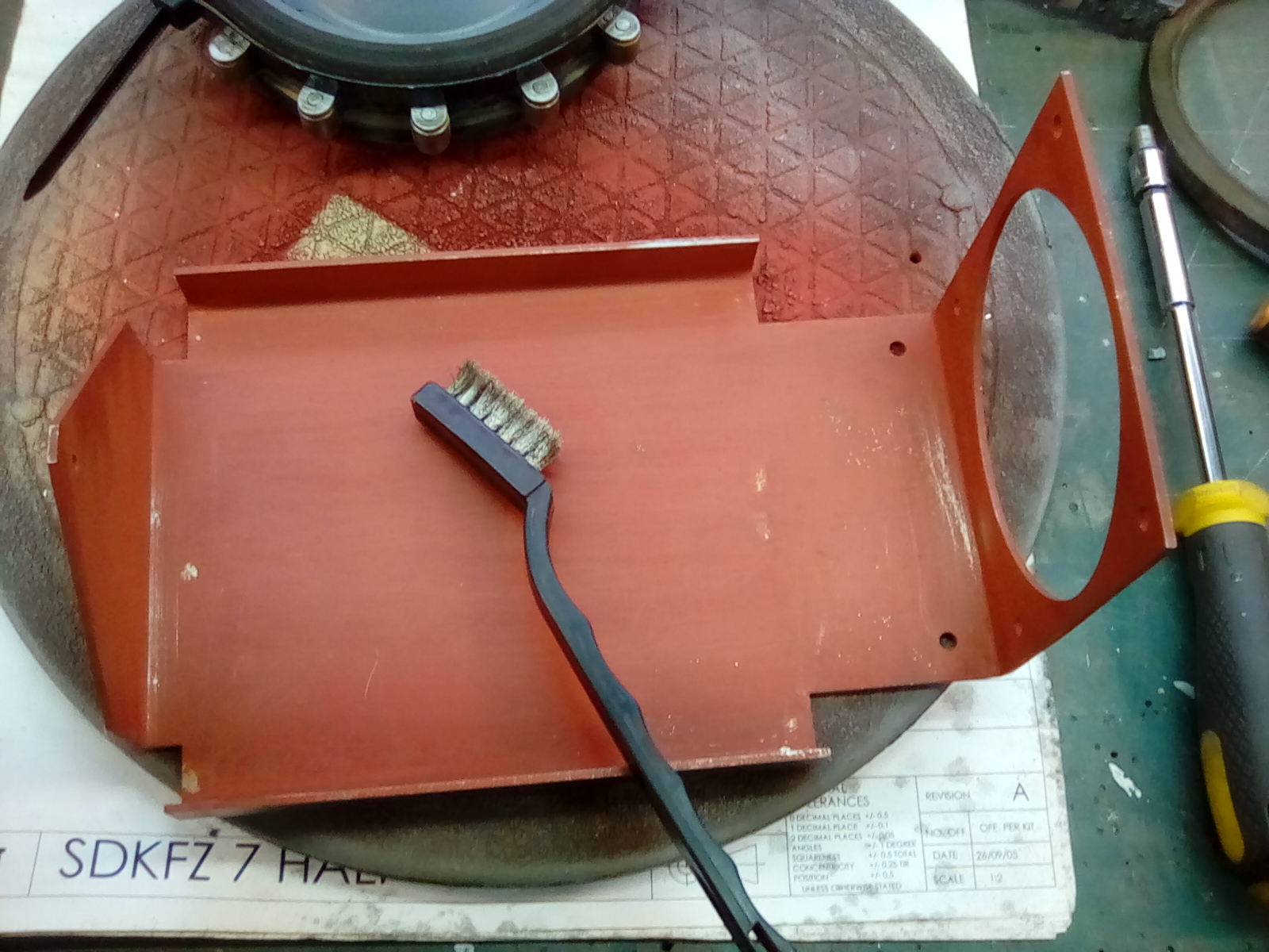

Surface rust prep.
Surface rust prep.

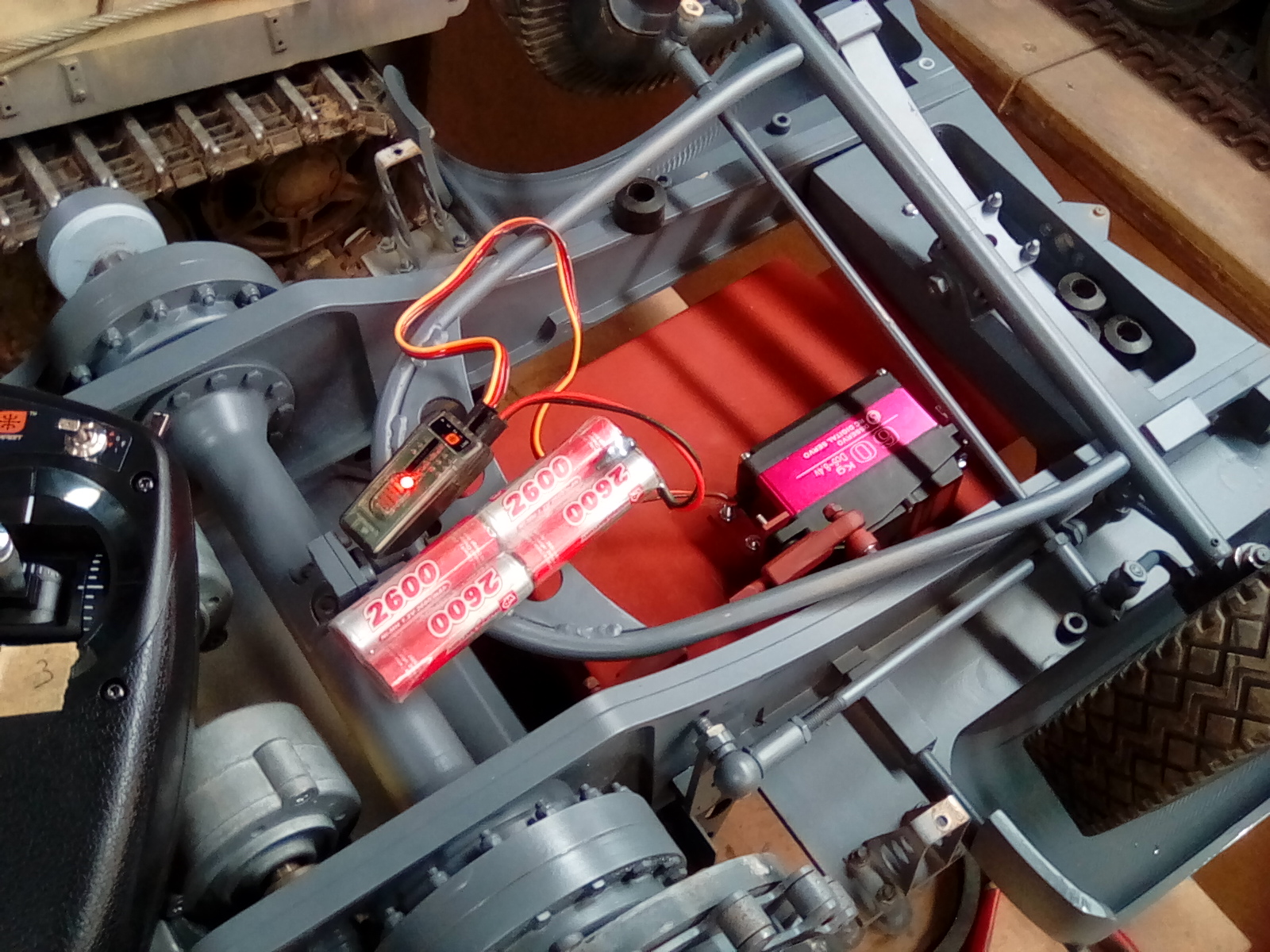

Battery tray primed, remember I'm not painting this model.

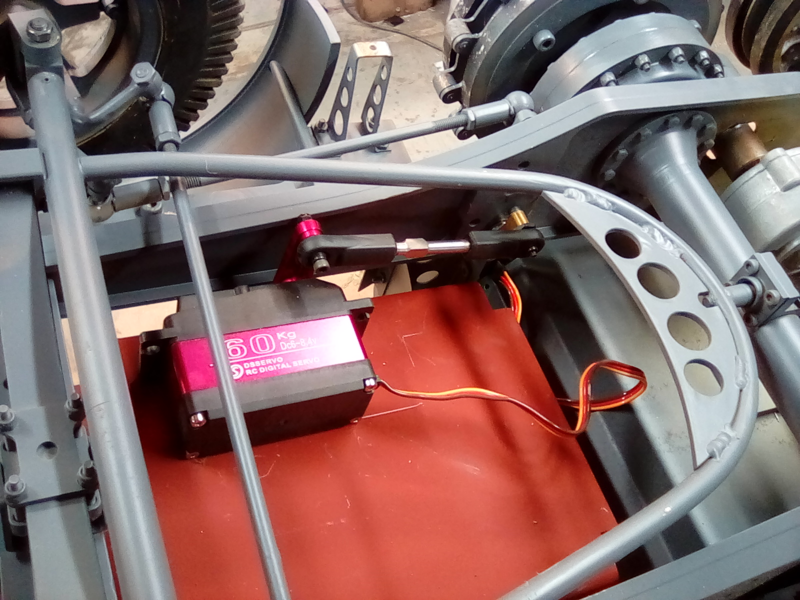

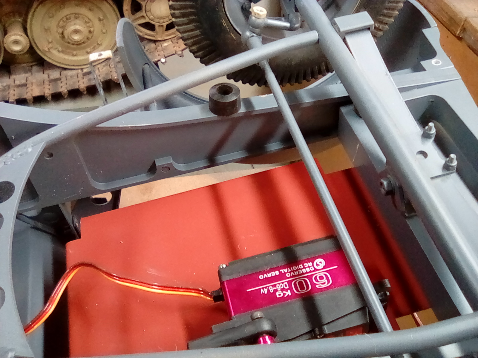

I'm happy with this steering servo convenient position so that's where it's going to live.

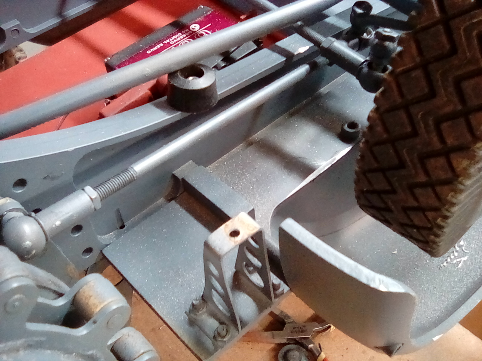

Checking where's best to place the front pivot axle bump stops, If you don't add these the steering joints catch the chassis frame causing all kinds of steering issues.

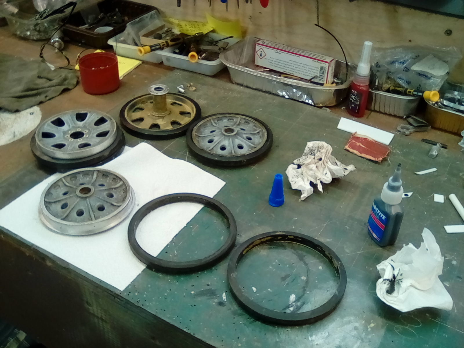

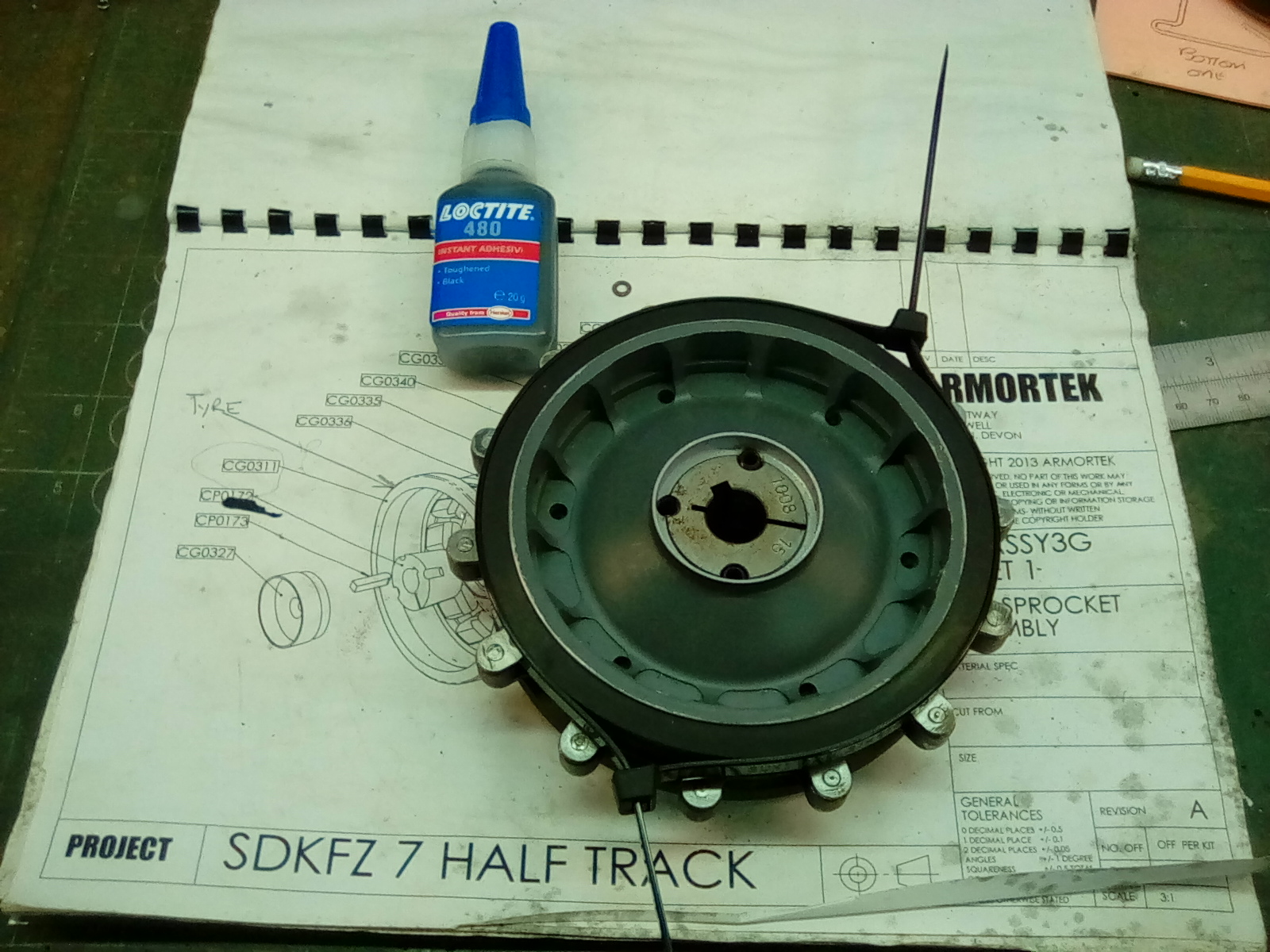

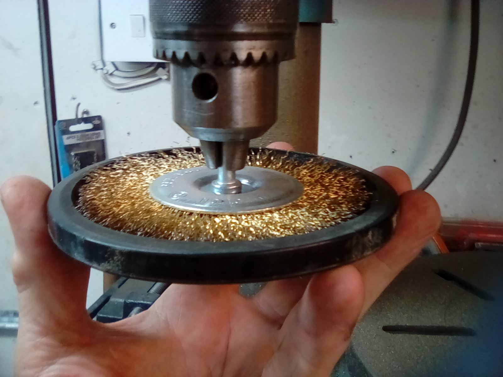

The wheels clean up nicely ready for bonding, Locktite 480 is designed to bond rubber to metal not rubber to paint.
That's the area that is binding , the rubber on the wheel sets is slightly to proud.
Now this technique is not recommended but it does work very well. A light pressure removes the adhesive nicely without damaging the rubber.

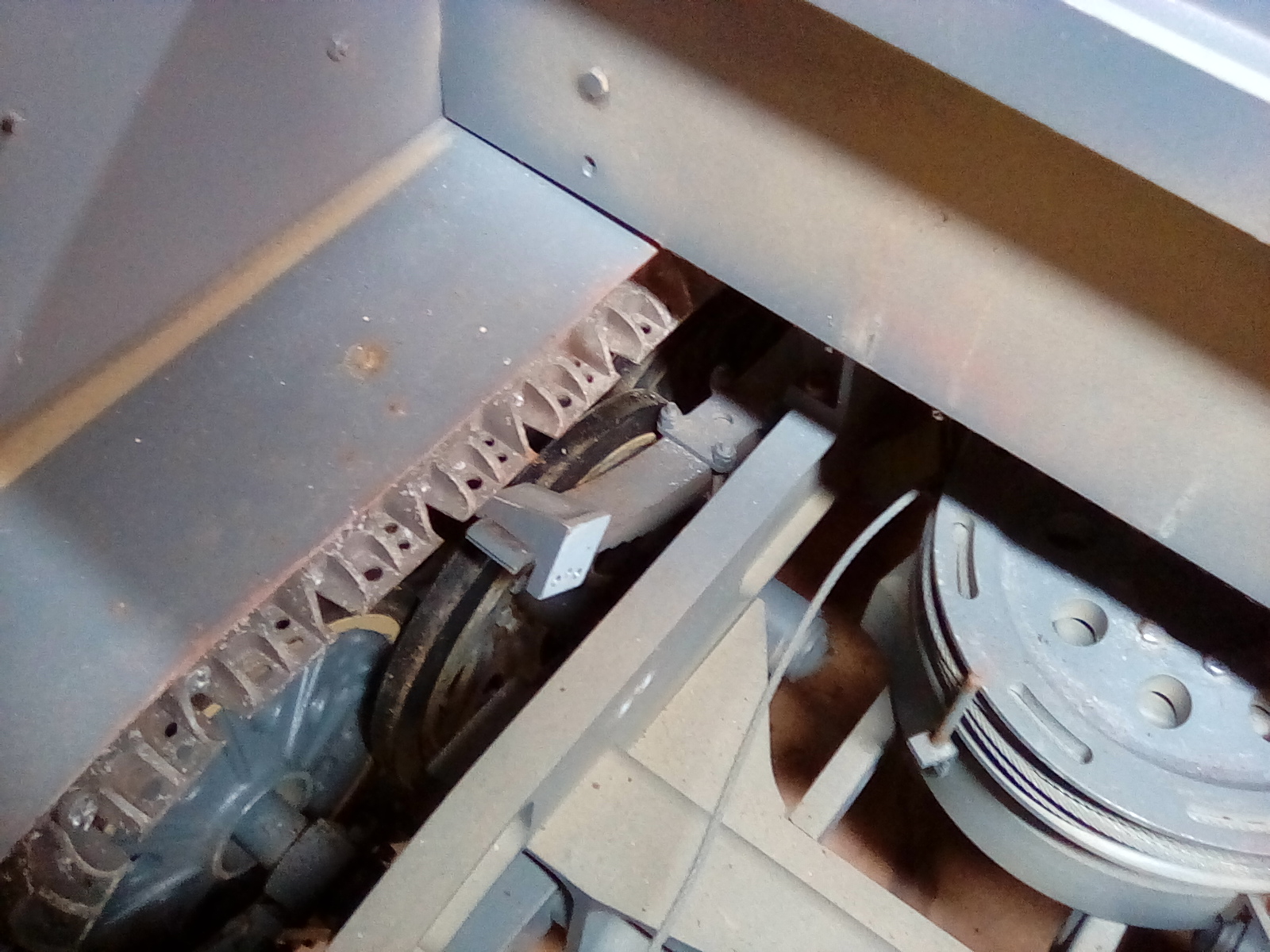

The track horns are a little tight on the sprocket so a tad of easing will be necessary with a file but not just yet until I've run it and had a look at the witness marks.

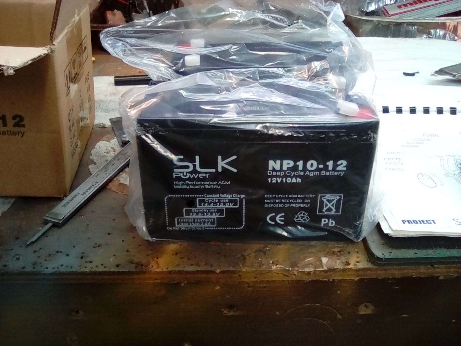

Deep cycle batteries arrived yesterday

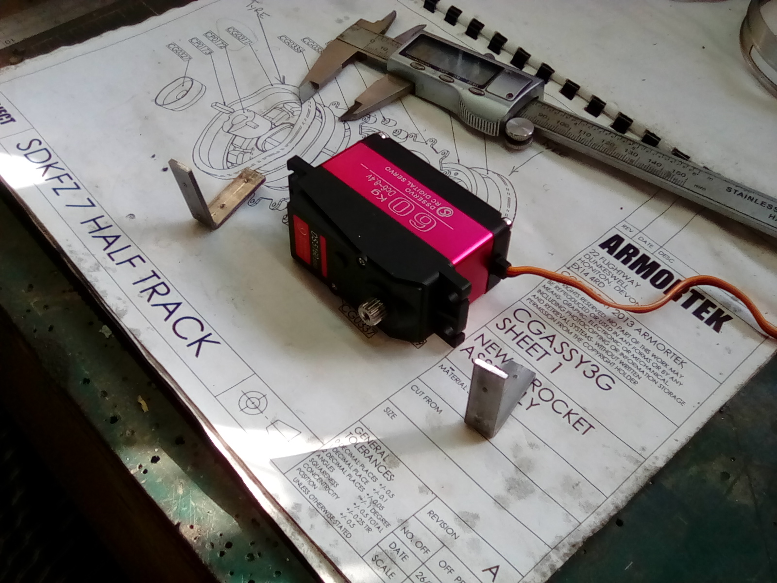

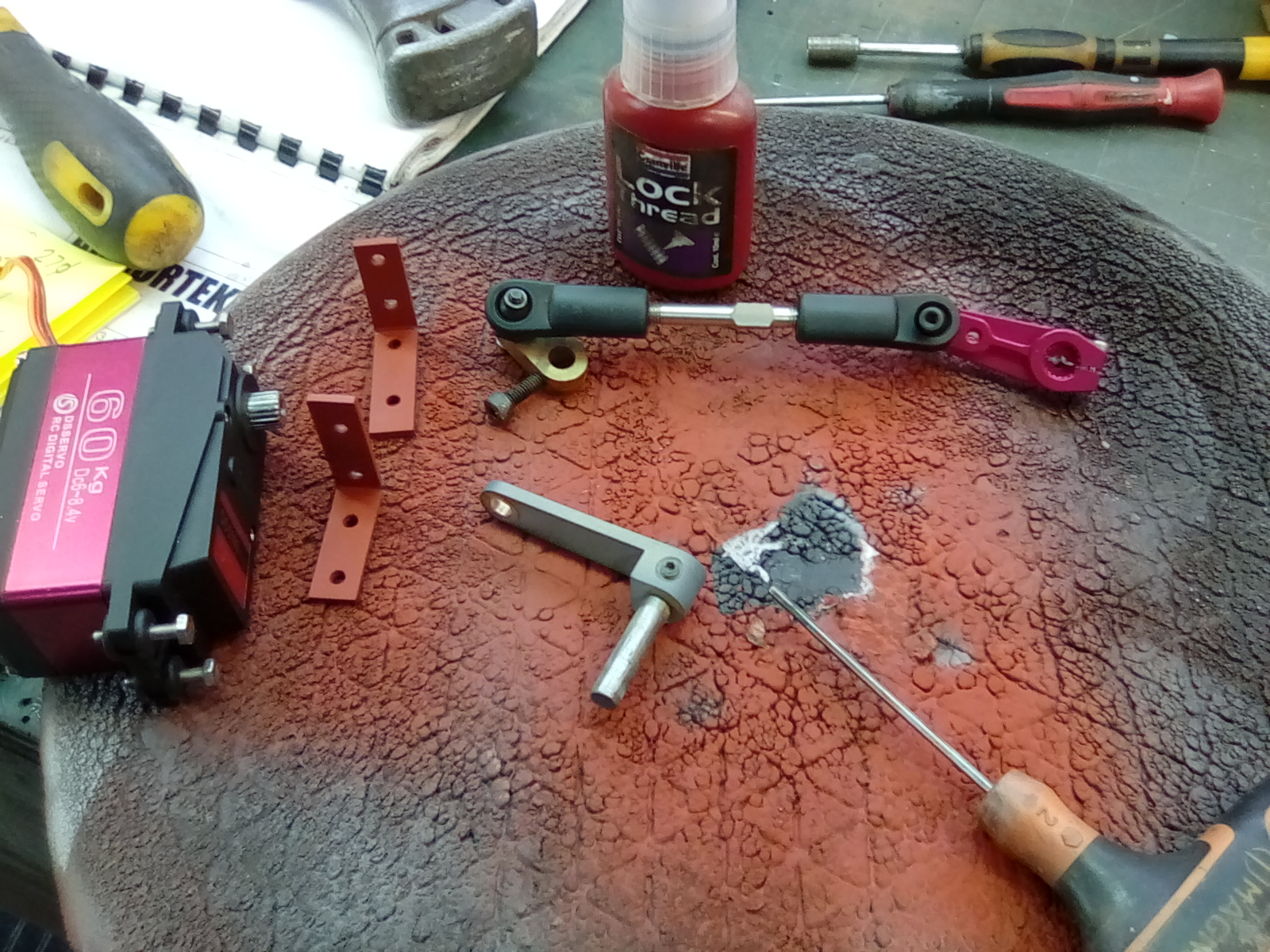

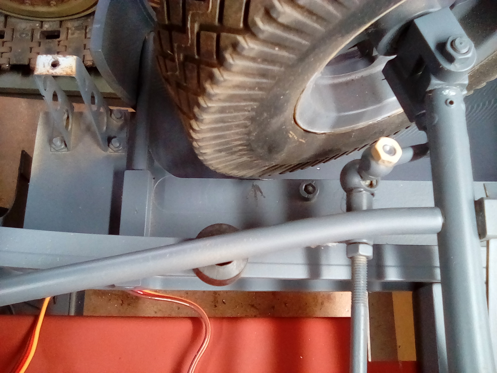

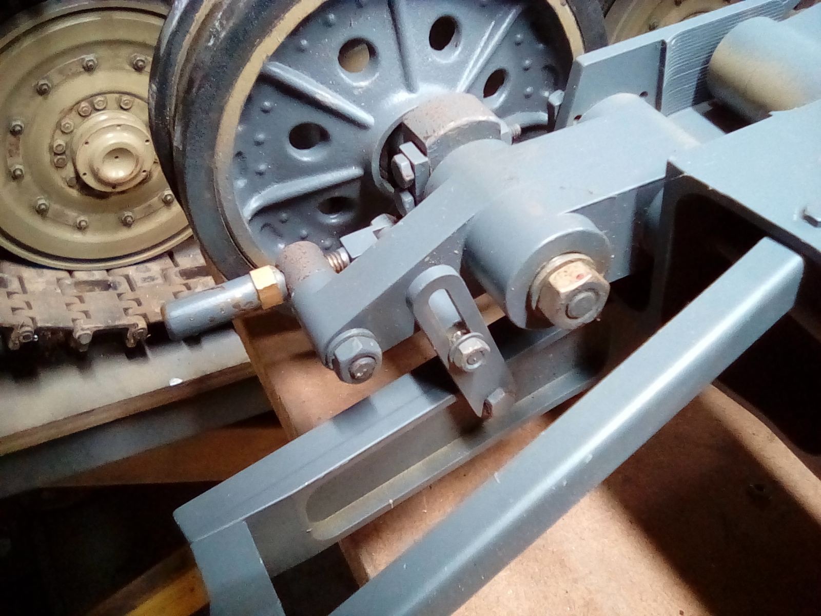

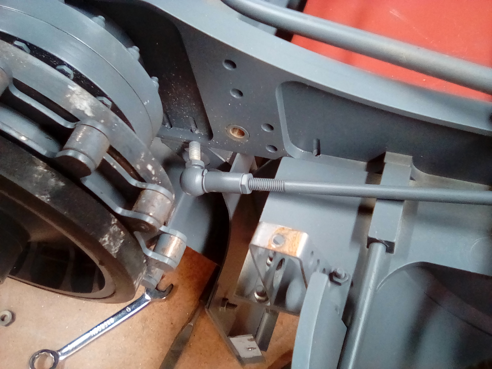

Servo brackets made, thread lock applied to all the steering nuts, in fact I'm applying thread lock to everything that needs it .
Grease applied to all the steering joints
New radio bound and working well

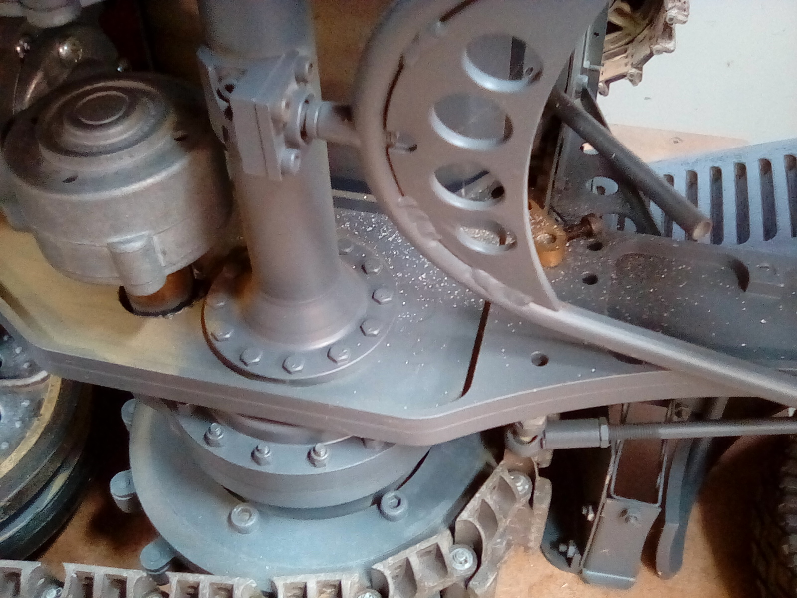

These areas need rounding off or the inner tyre walls will be damaged
The steering servo and brackets all bolted in and working correctly via the radio.
Fitting the bump stops

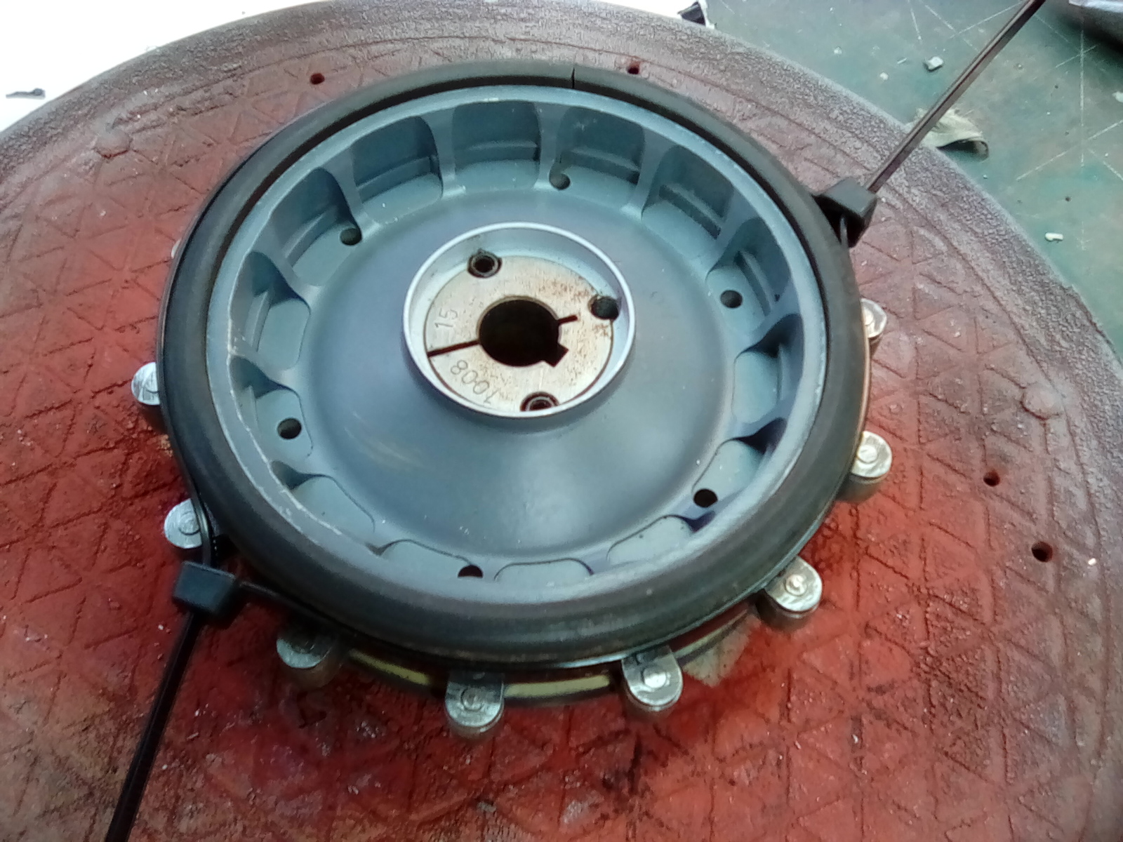

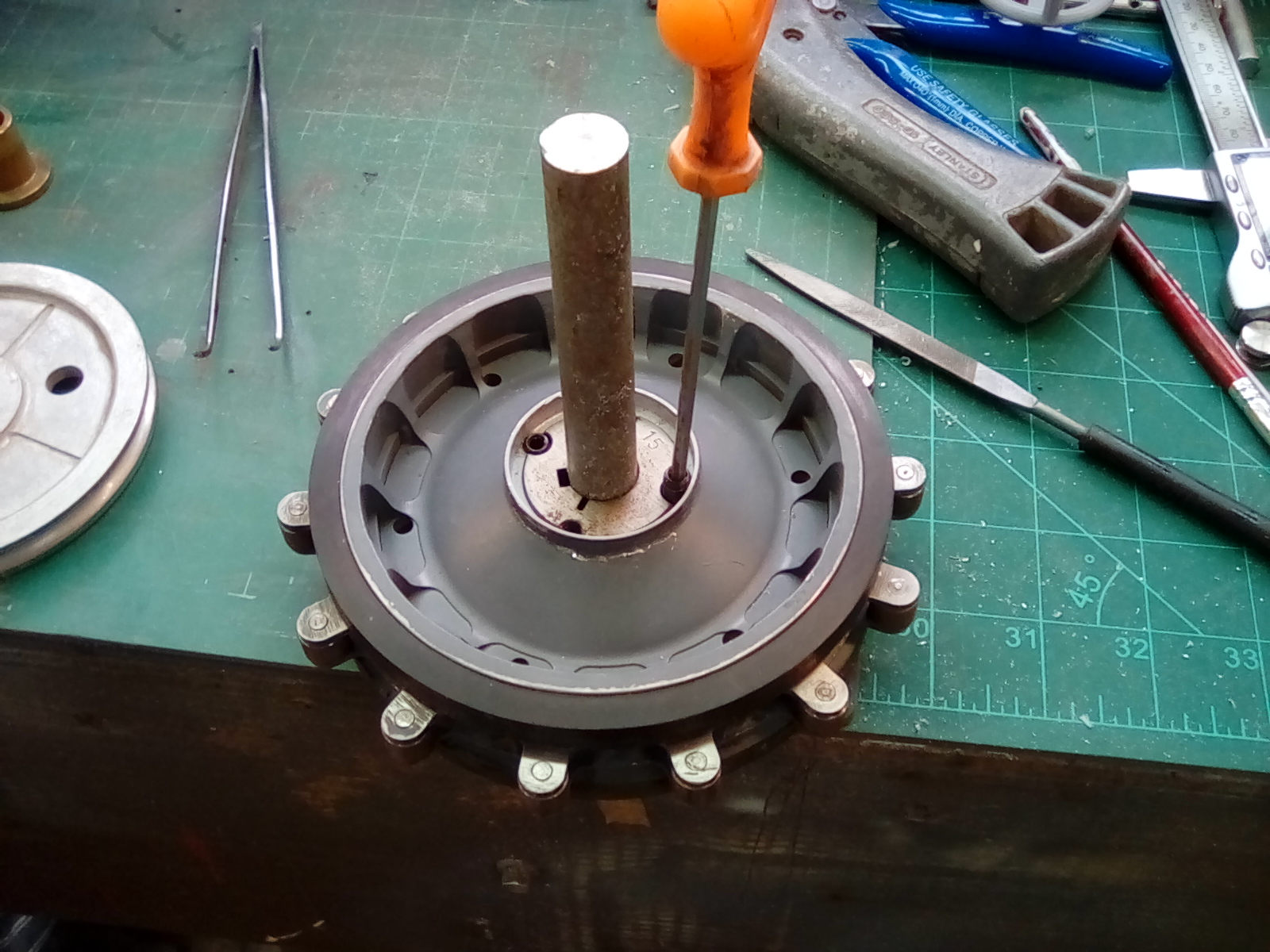

First of the drive sprockets cleaned up and the rubber bonded in place

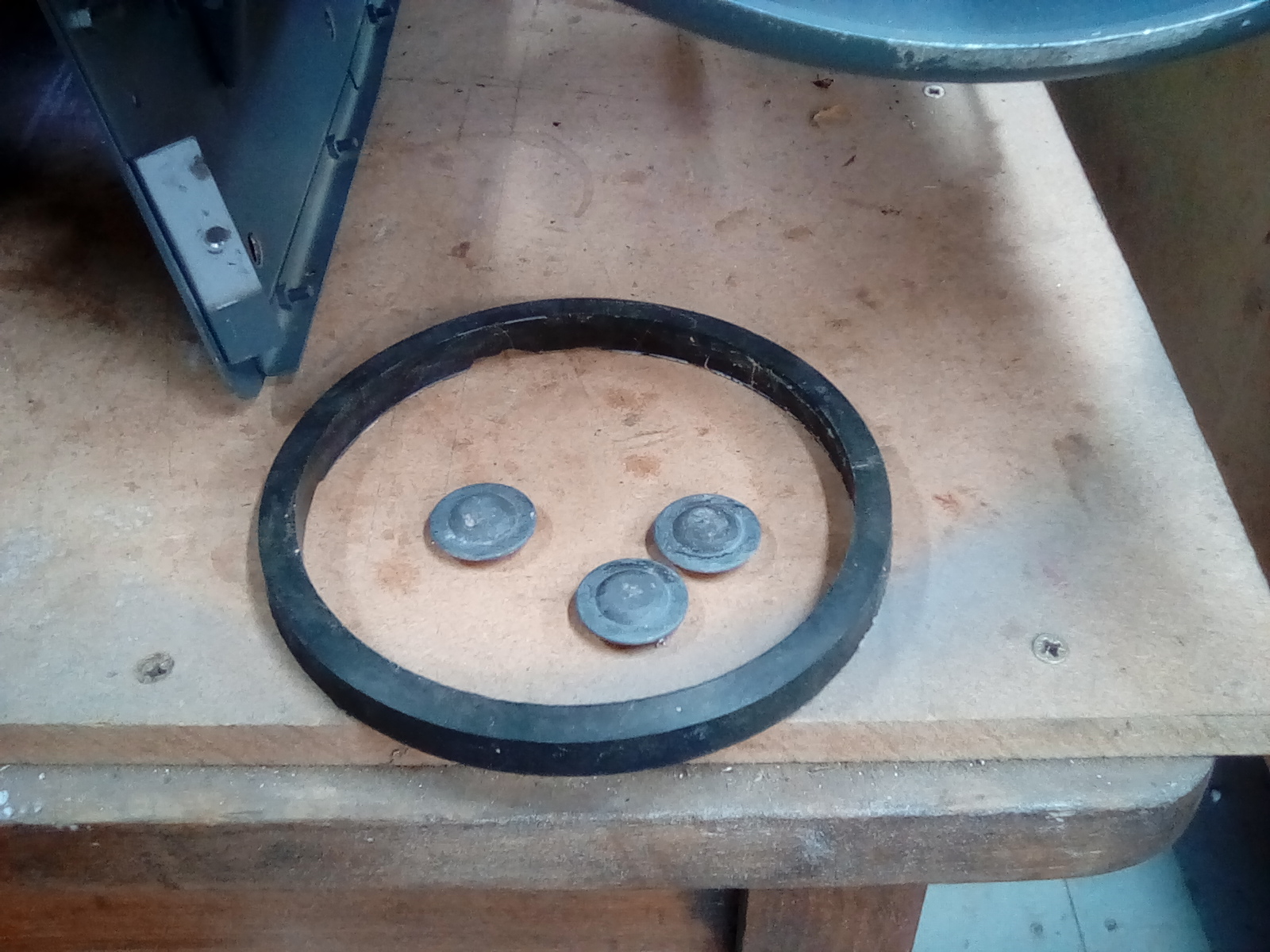

As we don't have new rubber some damage is filled with 480

I'm having to shim a lot
Before........
Before........
......After
......After
It's a grotty job but has to be done
All shimmed and in line on this side anyway.

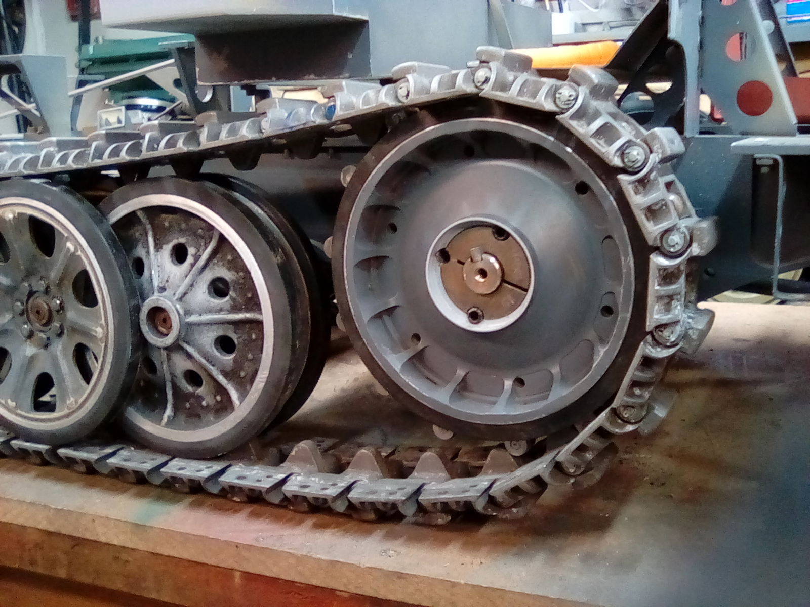

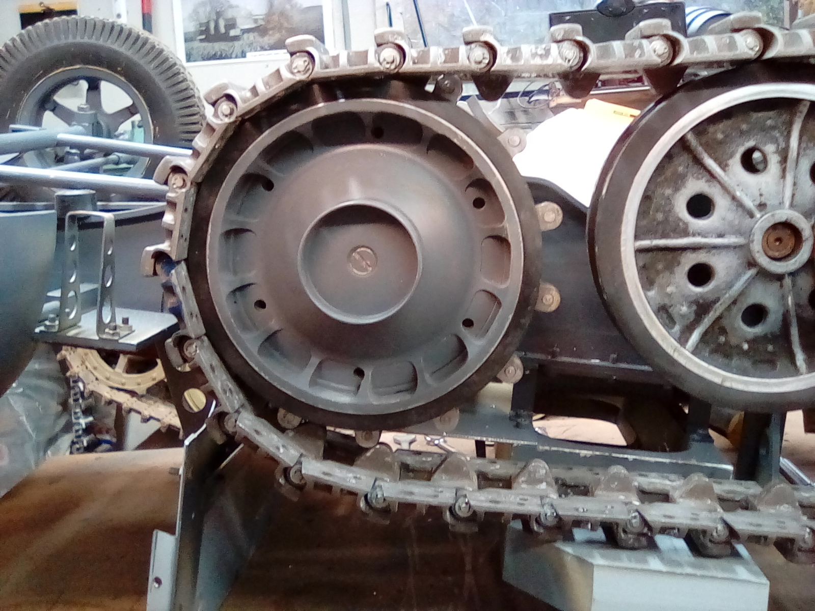

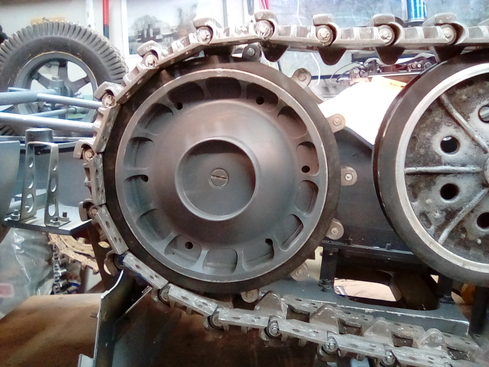

All nicely in line but the links won't fit the sprocket
Will the track stretch with running and fit the sprocket or will I have to fettle each link?

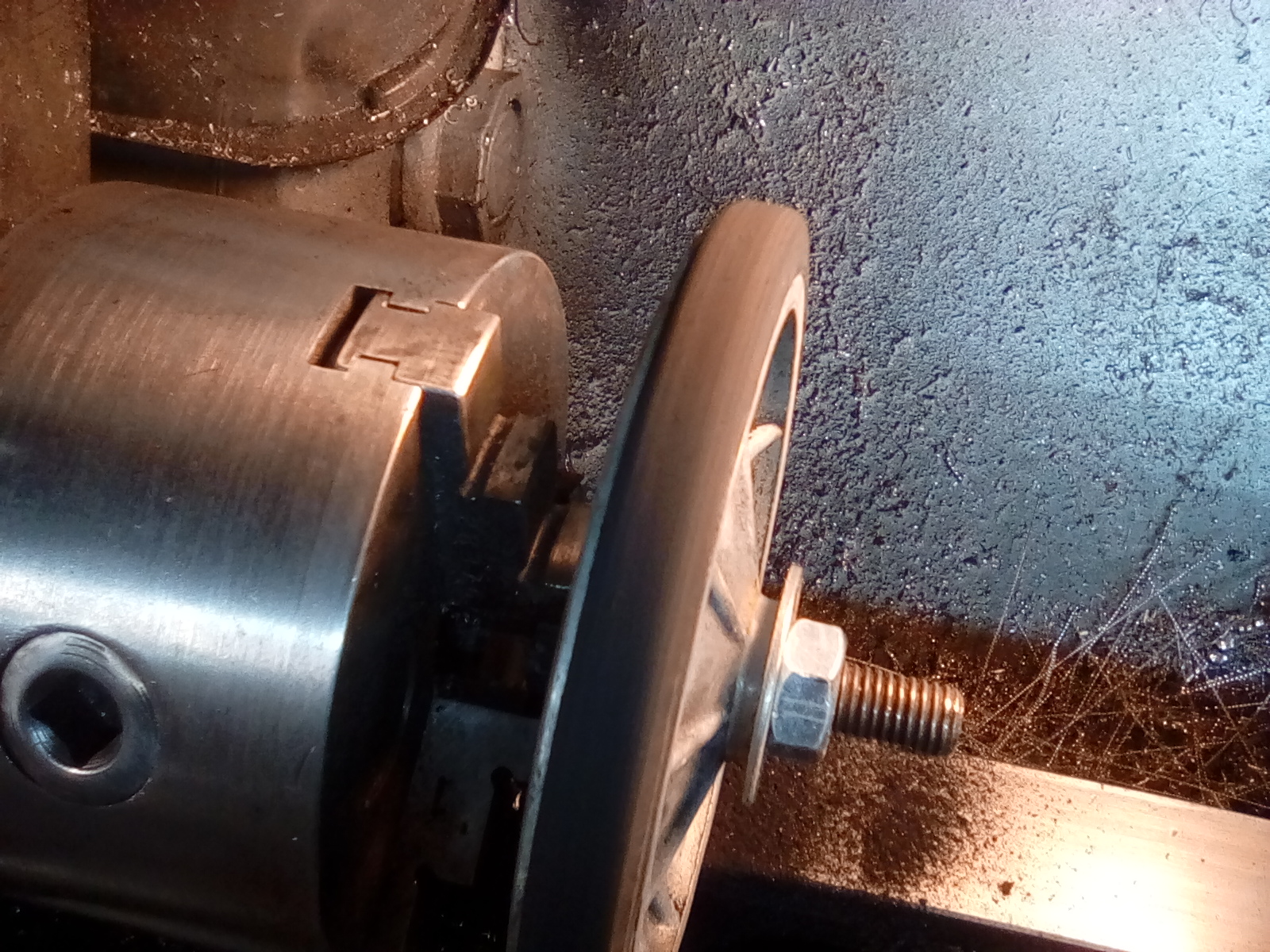

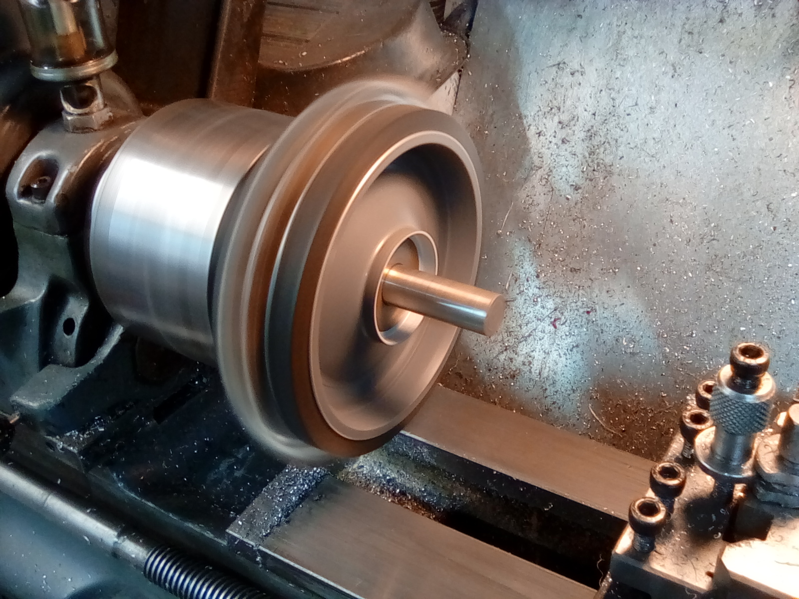

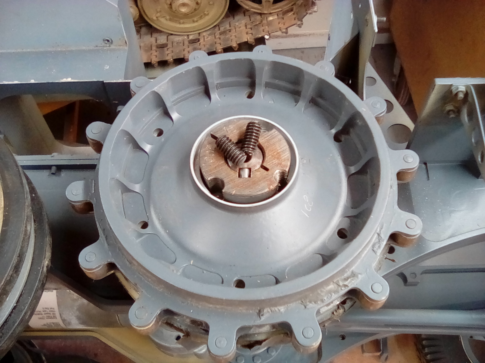

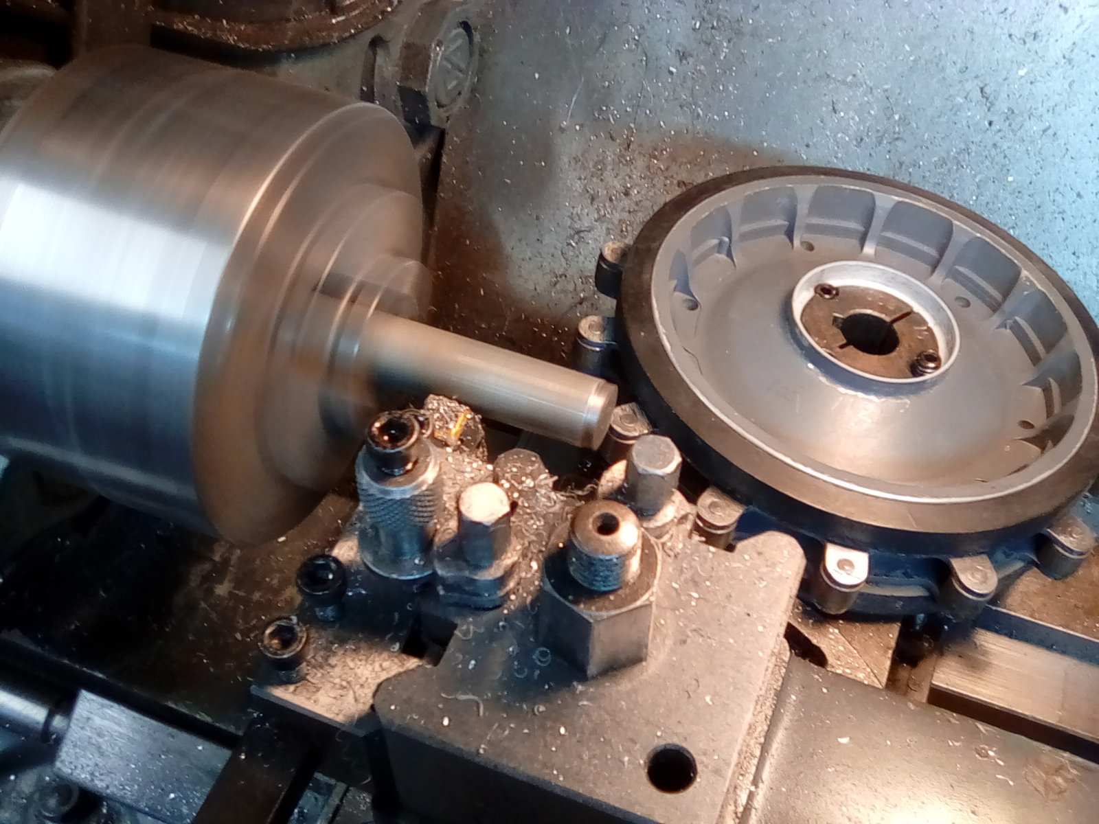

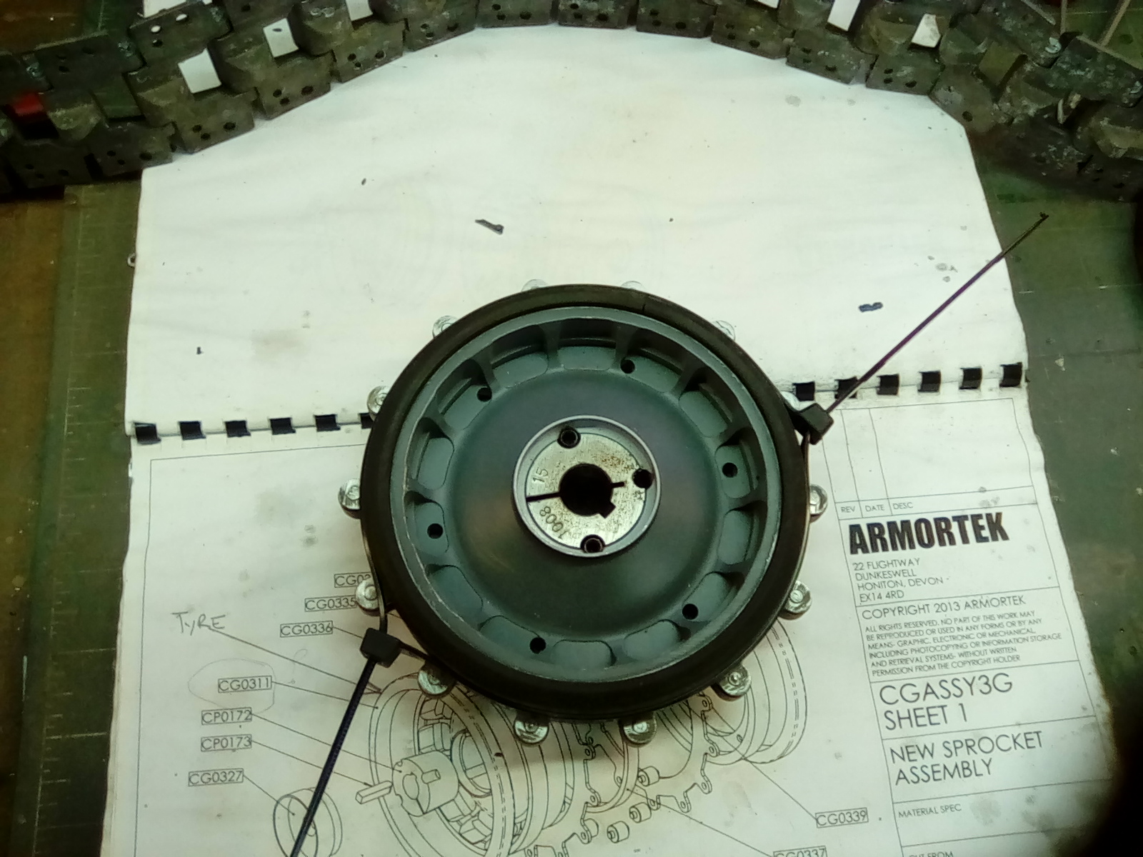

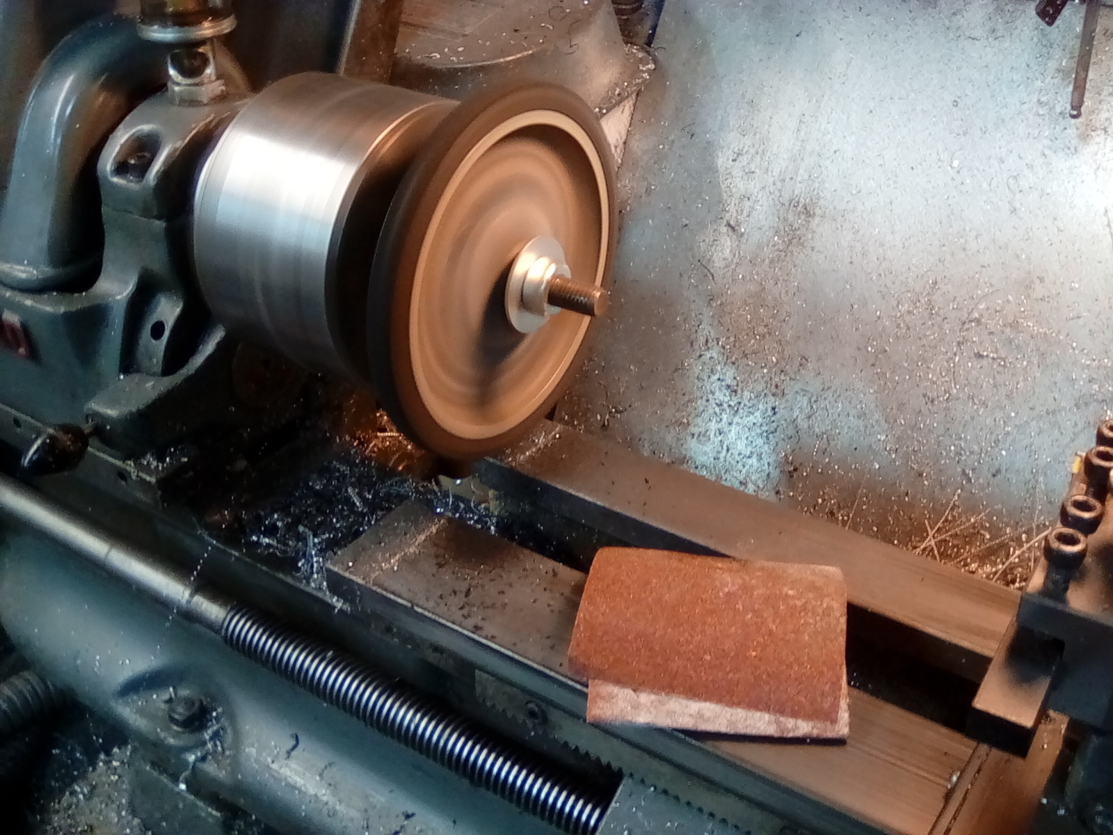

Phil the outer diameter of the new style sprocket tyres needs be 123.5 to 124mm. The tracks will then sit correctly. I turned my glued tyres down in a lathe whilst on the sprockets.
Thanks,
That makes perfect sense Mark thankyou! I shall now turn my lathe black with rubber dust.

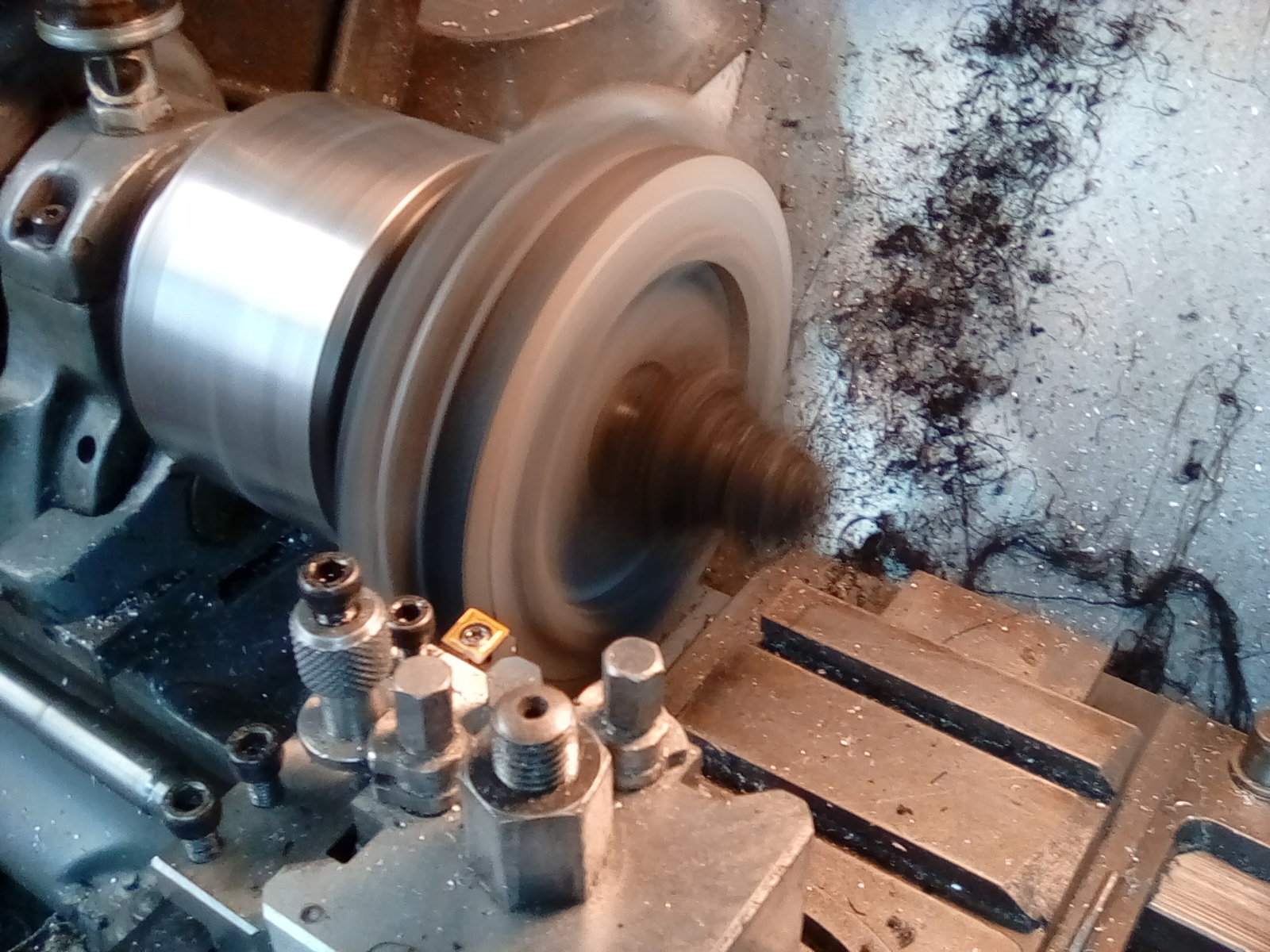

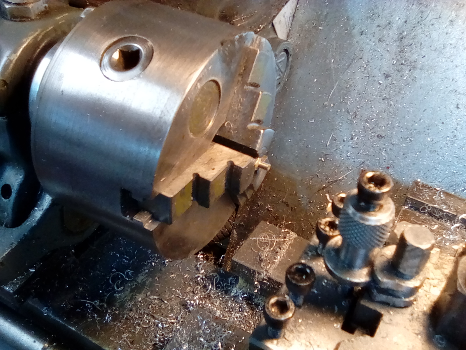

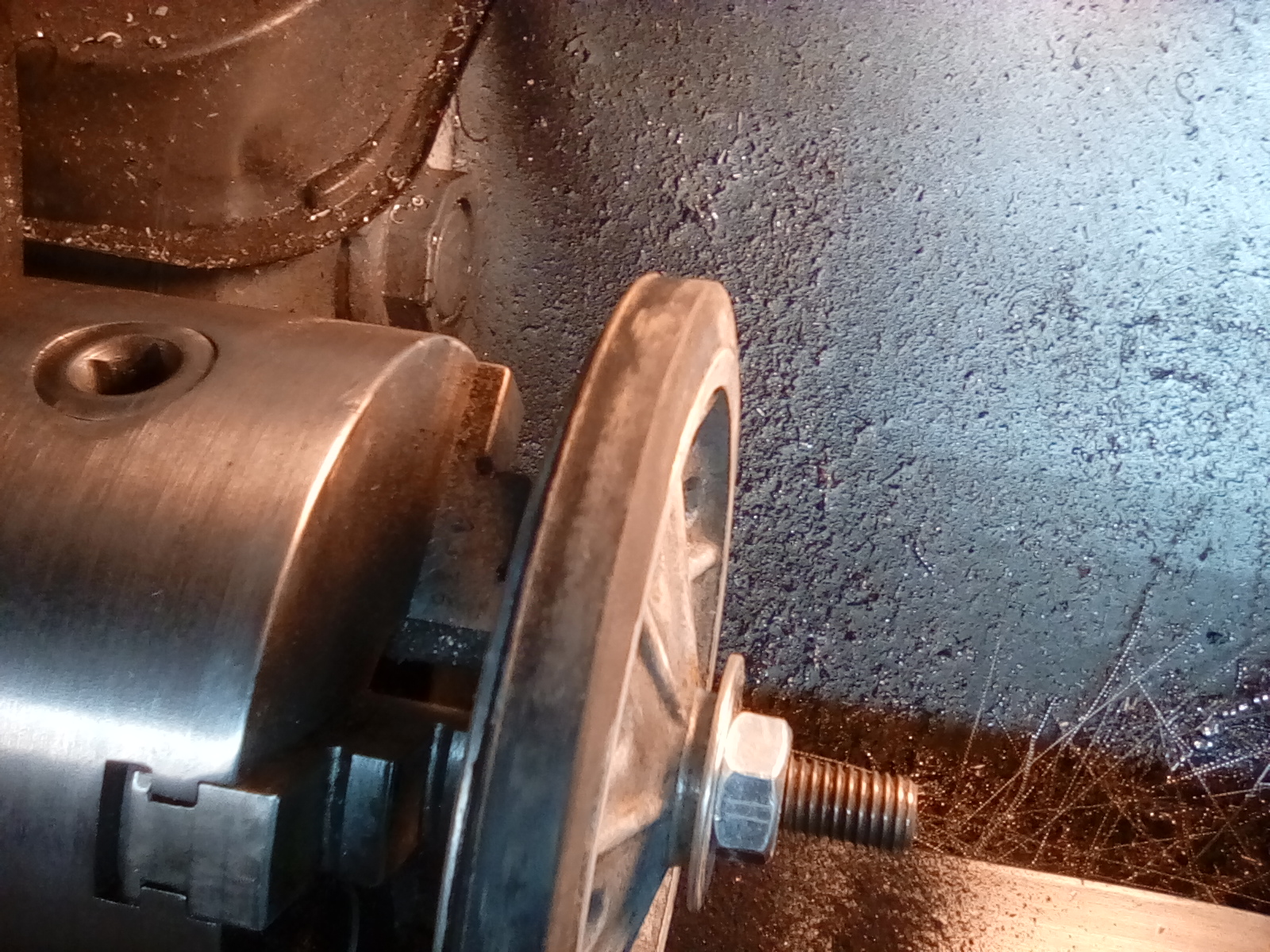

I followed Marks advice and the track fits almost perfectly with just a little fetling required.
Outside calipers makes the job quick and easy and accurate .

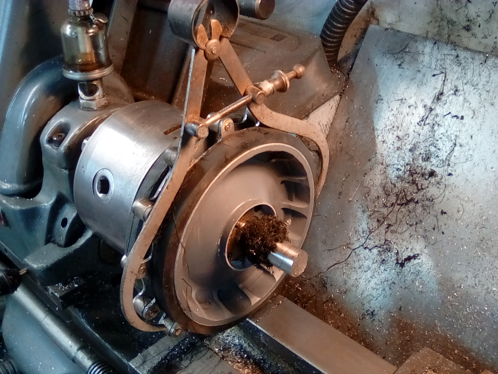

A quick bit of turning and we can now mount the sprocket using the taper lock.

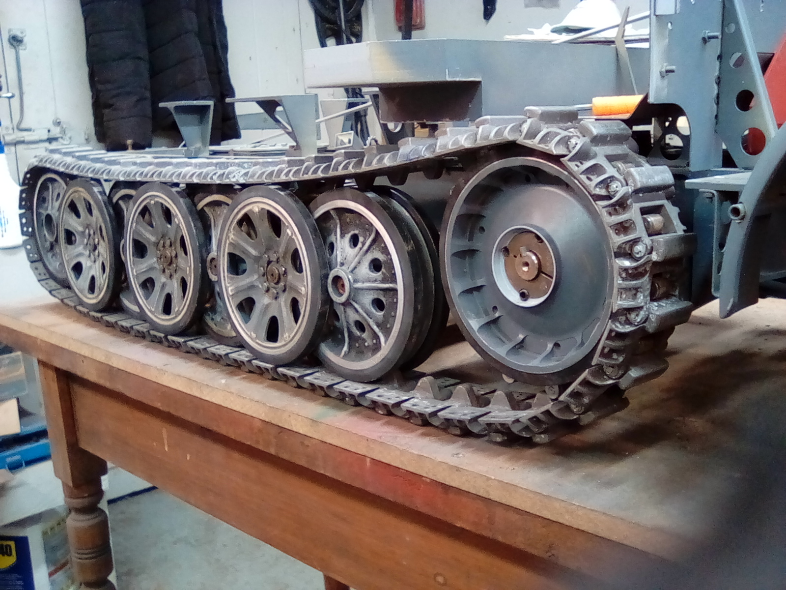

With all this work the half track will be silky smooth.
I'm very pleased with this side.

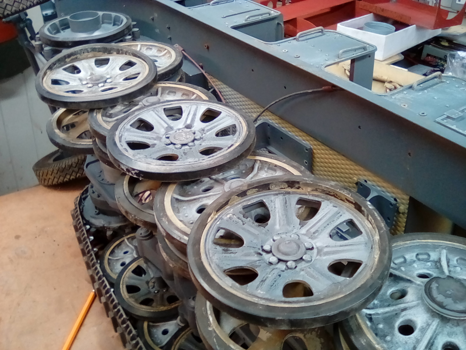

A taxing days work. It's fighting me all the way, everything interferes with its neighbour but I will methodically go through it , some of the tyres need reducing in diameter just a little to clear the hub of the adjacent wheel set, some of the rubber has a proud casting "rib" on one side which is rubbing the bobbin hubs .
This side for some reason is a bugger.

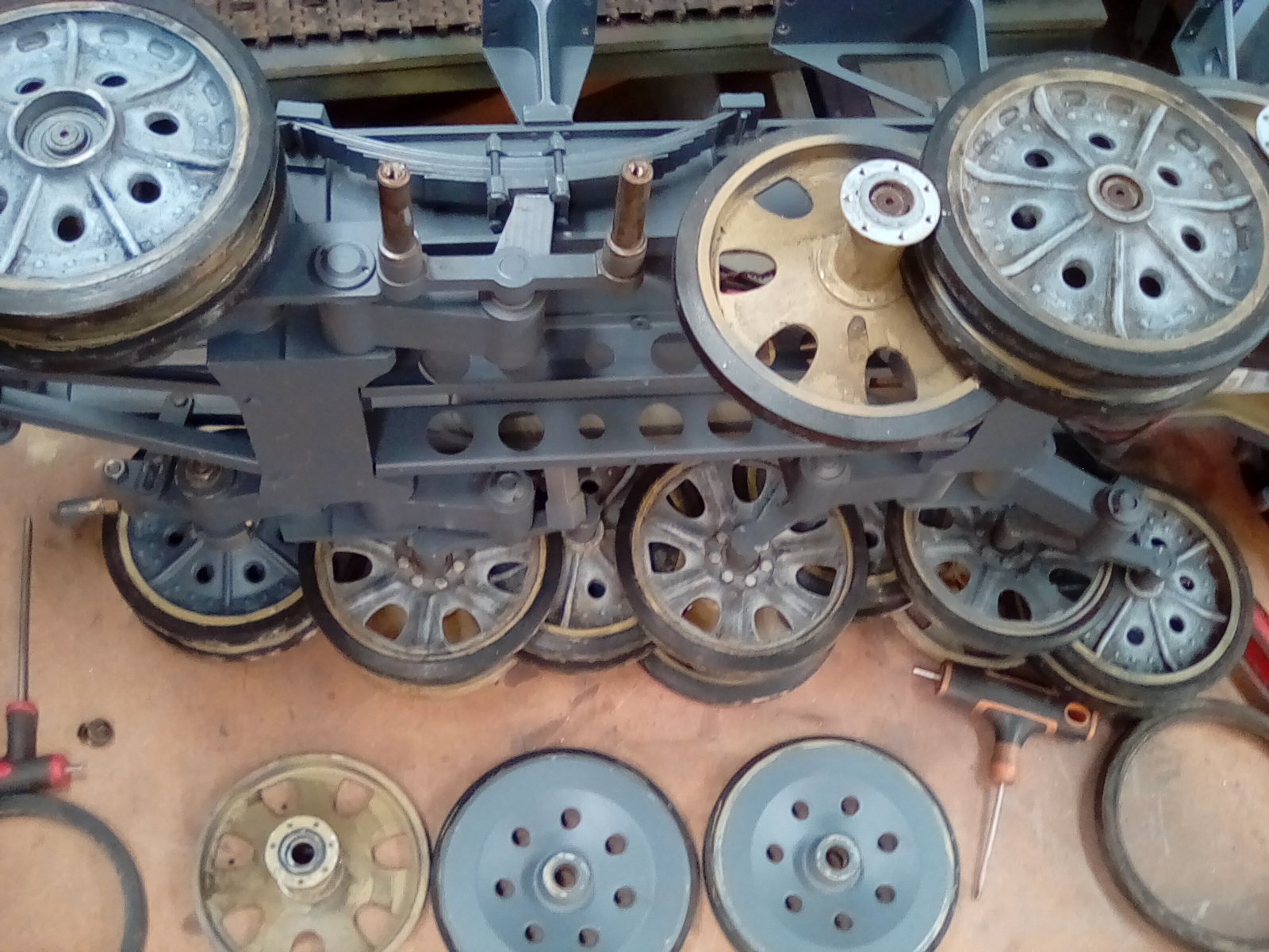

Trying to keep the wheel sets in their original places but I think they are already mixed up.

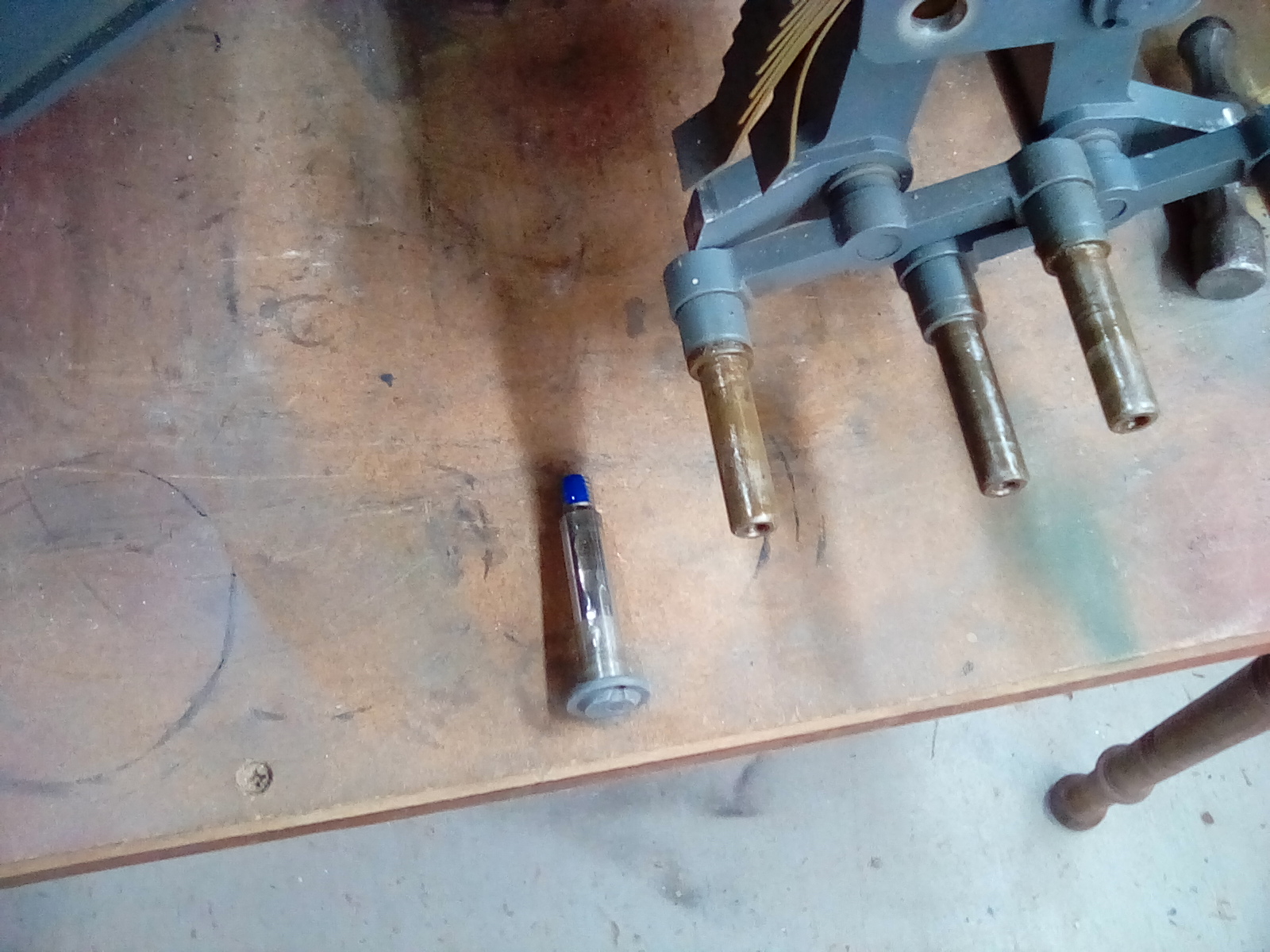

All the hidden swivels need Locktite and lube.

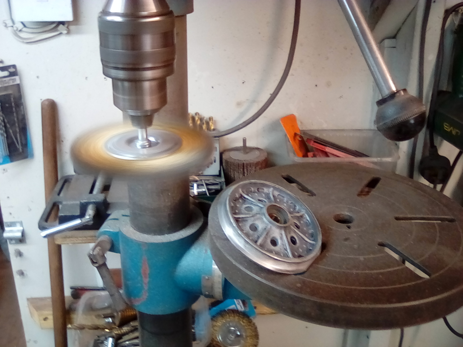

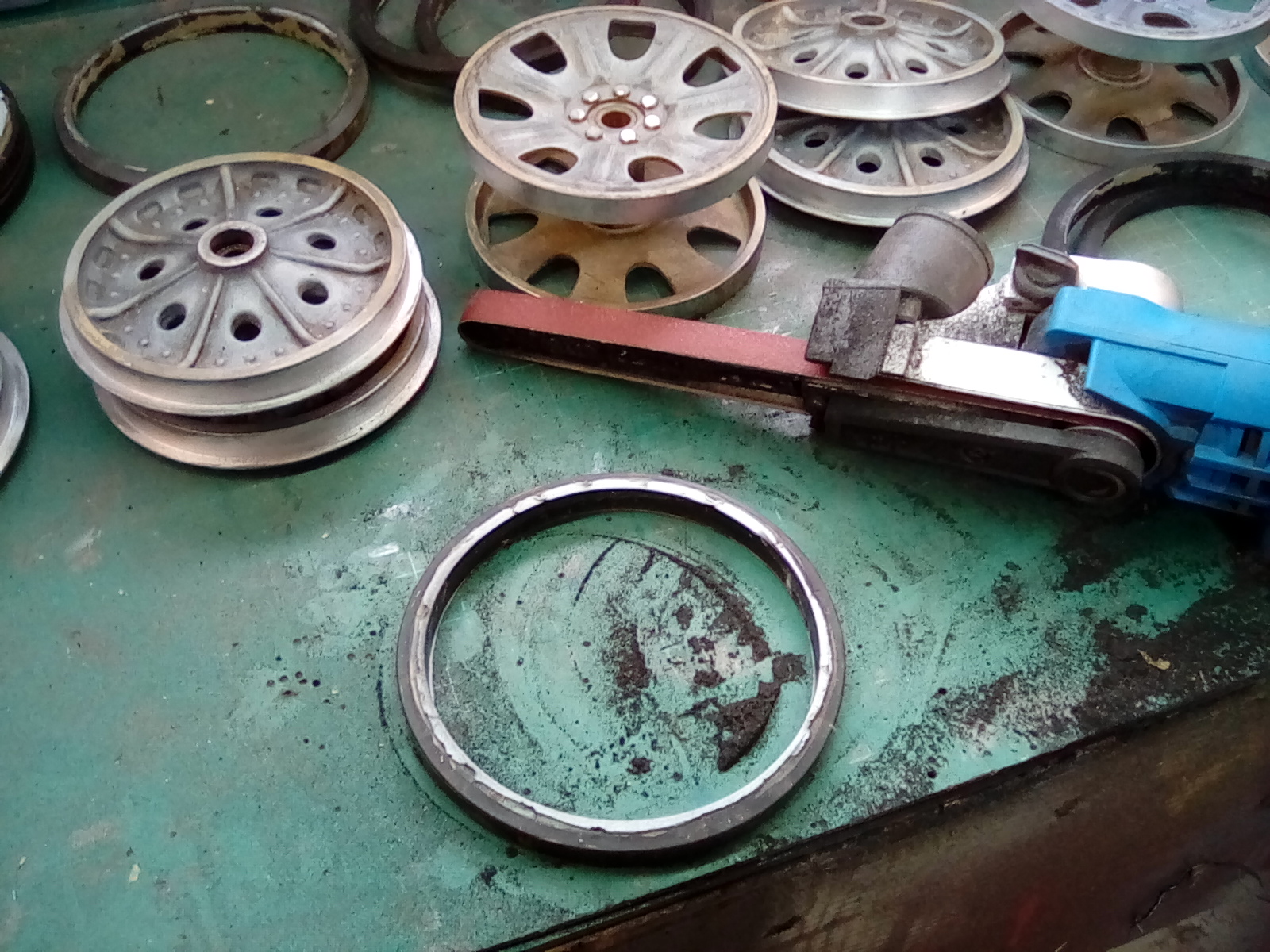

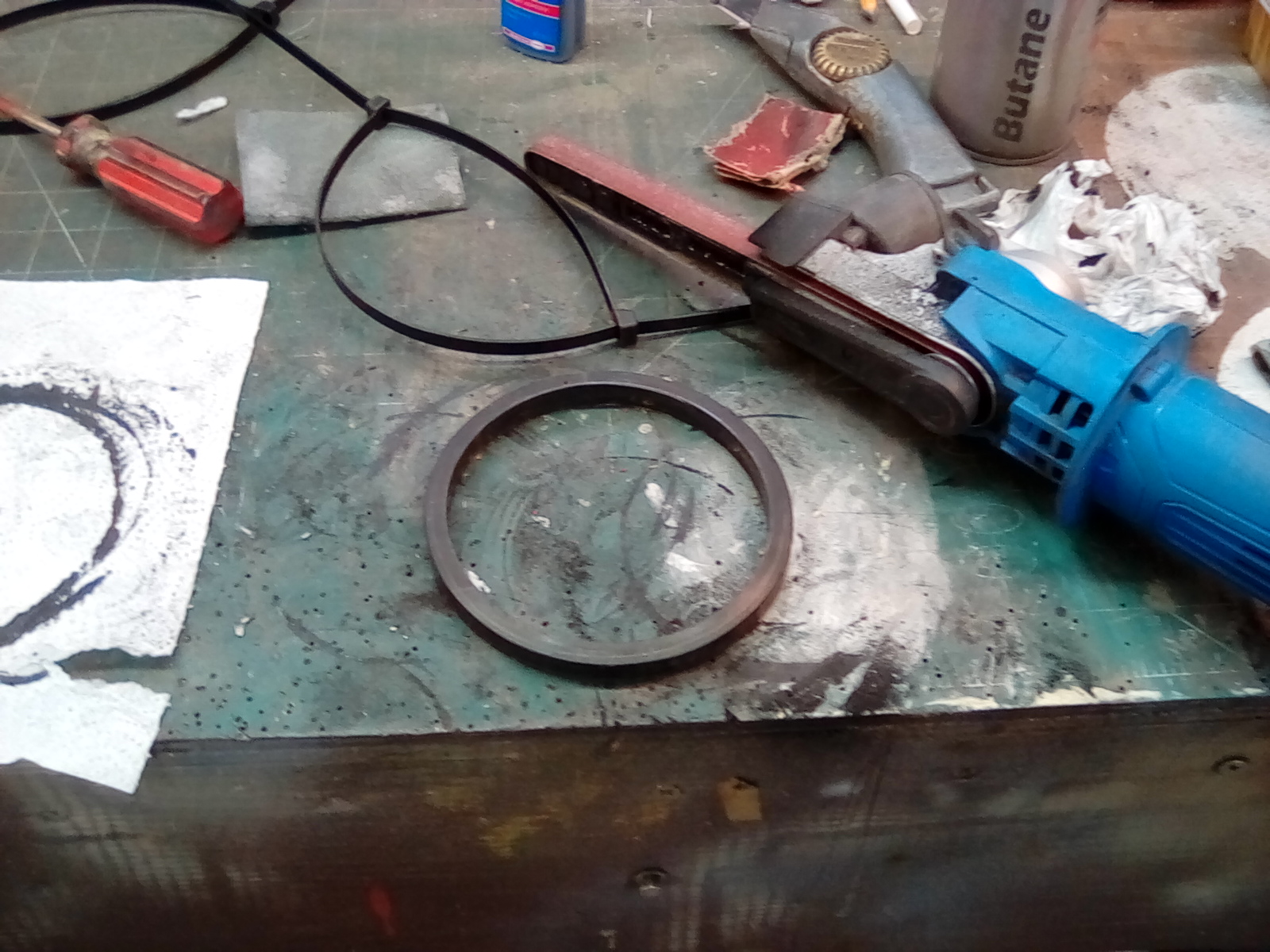

The power file is ideal for this type of clean up job but you have to keep it moving!

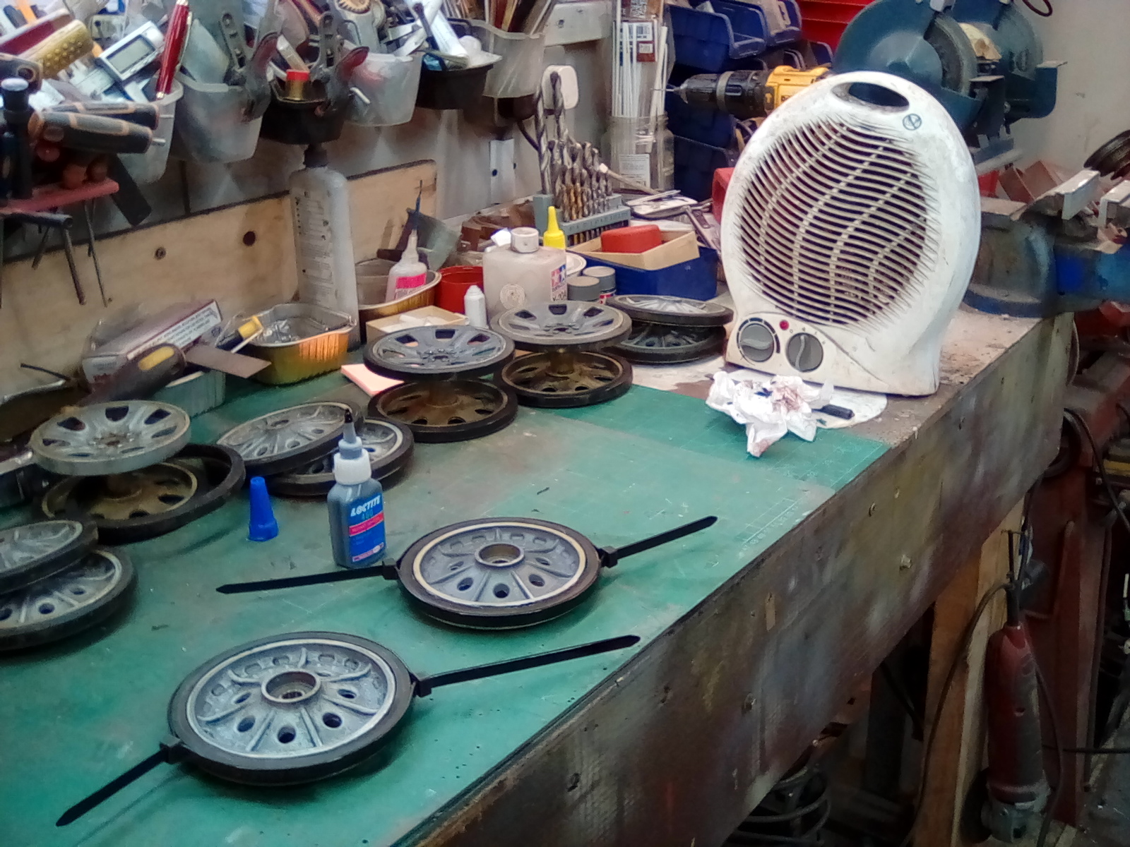

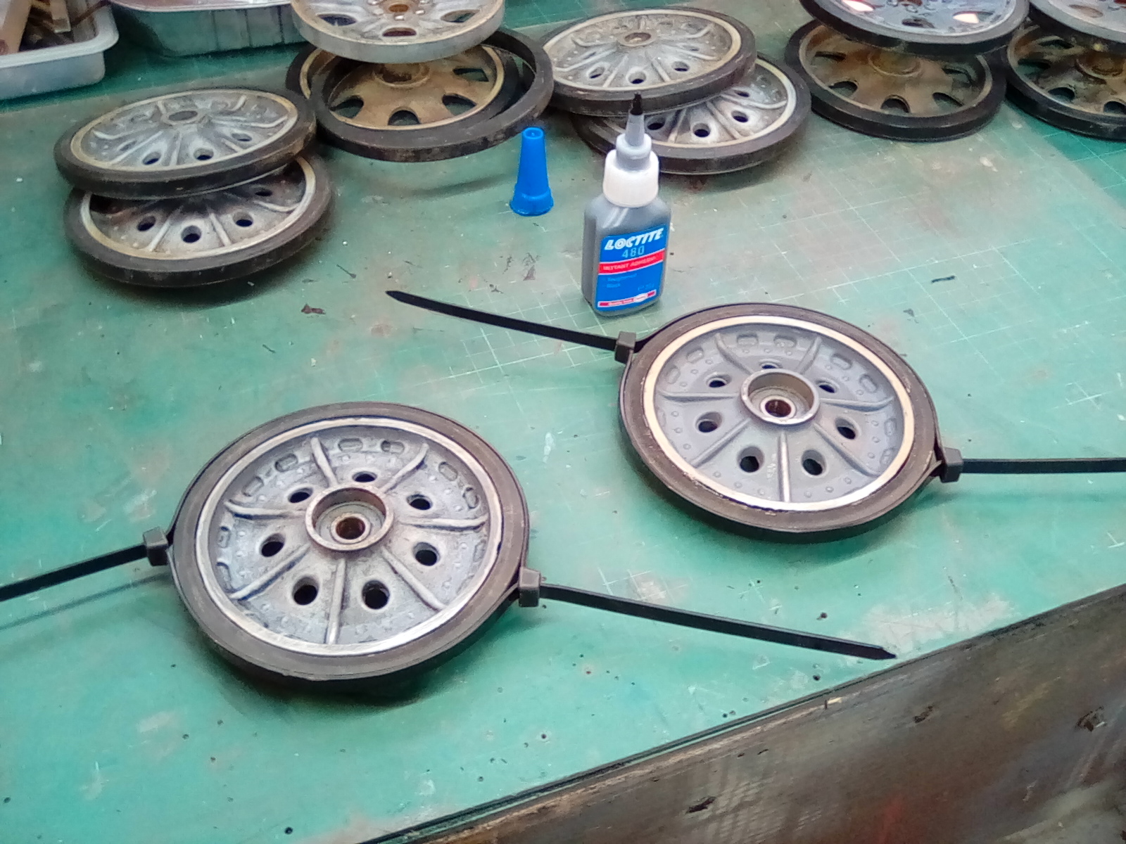

Ready for bonding
Ready for bonding
The tyres only just fit the second time around, I think it would be a good idea if Armortek offered new rubber for these superb models, from what I have seen here the rubber is on its way out.
A fan blowing cold air helps keep the cyno fumes away from my nostrils

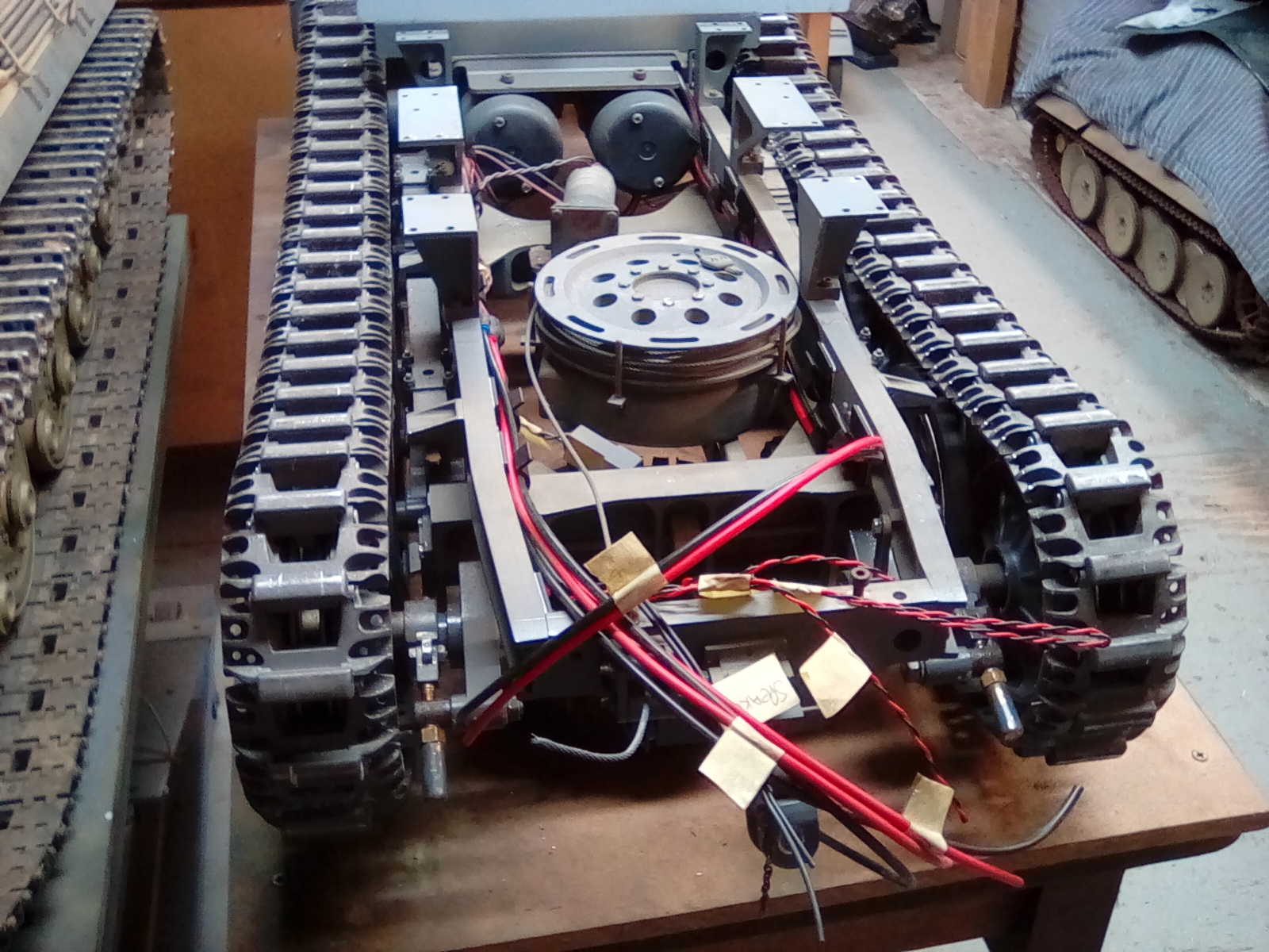

That's a lot of amps for such a small vehicle.

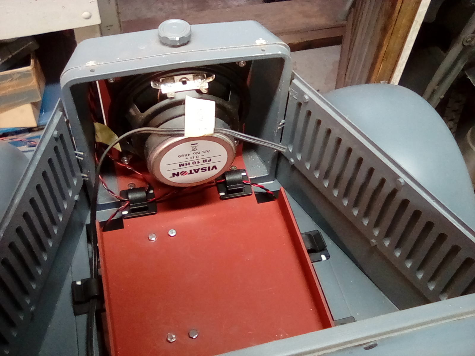

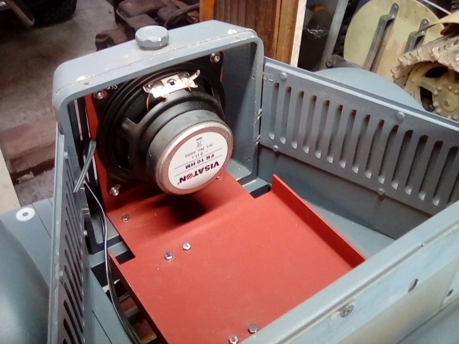

Speaker bolted in place
Beginning to run the wires

The only way to get the correct alignment
The idler on this side needs tweaking in by almost 2 mm
First proper run at low rpm for this side and it's very smooth indeed, worth all the effort.
Before, you can see the flashing on the tyre that needs removing
After
After
I'm always amazed at how much wire is required
I think that's most of the cables run
Main power leads run through from the rear

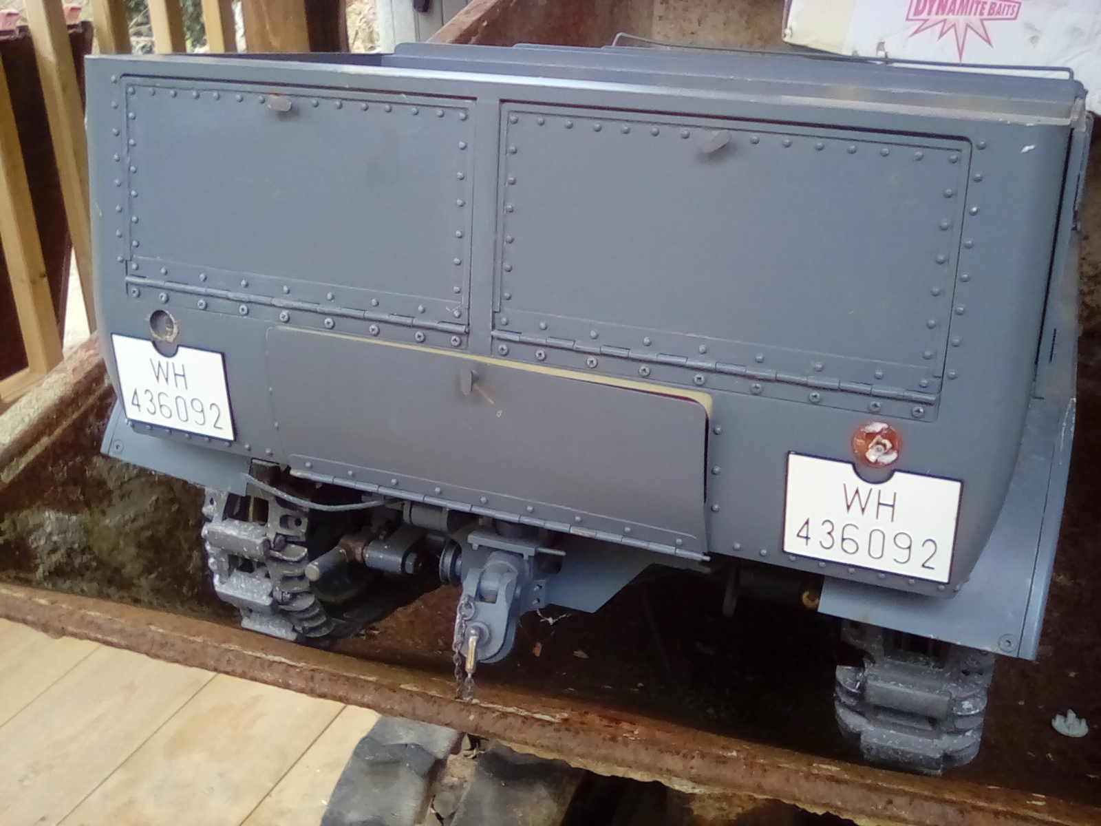

Almost ready for the body to be bolted down

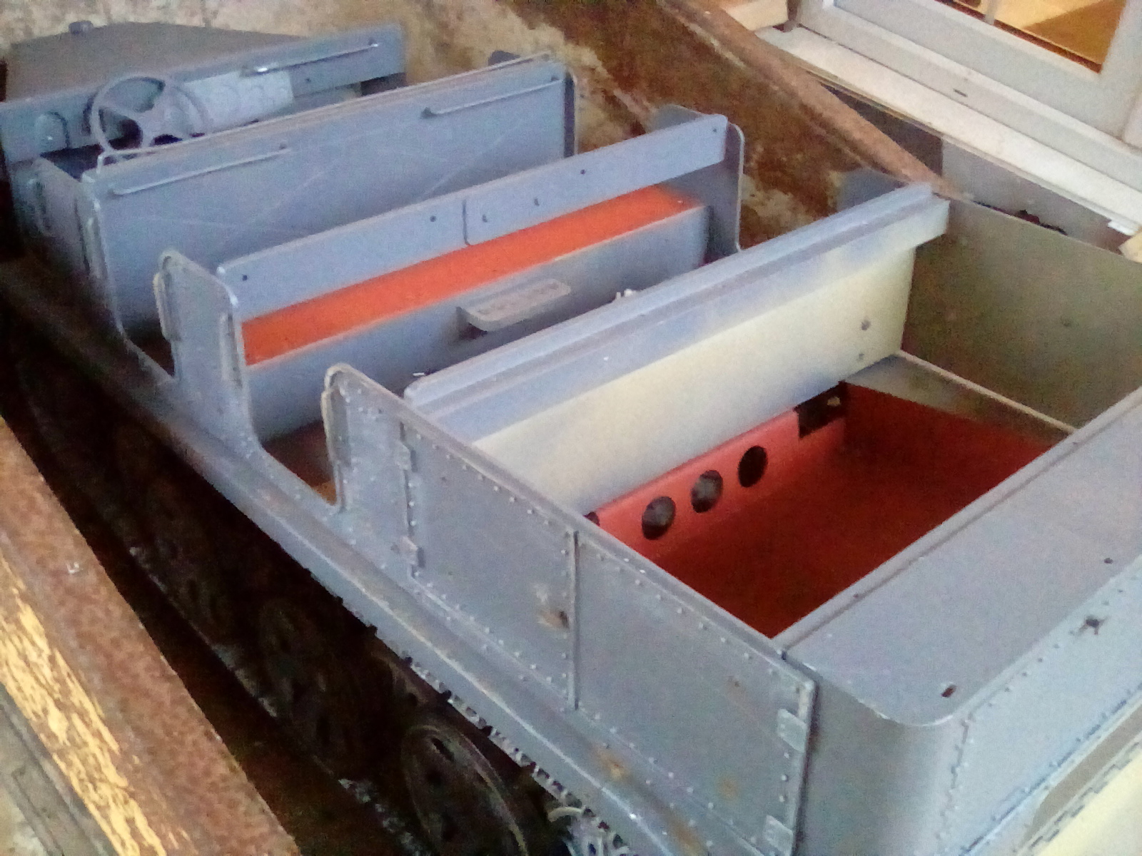

Lots of room in here
I shall make a tech tray for all the electrical boxes to sit on in that cavernous rear end
