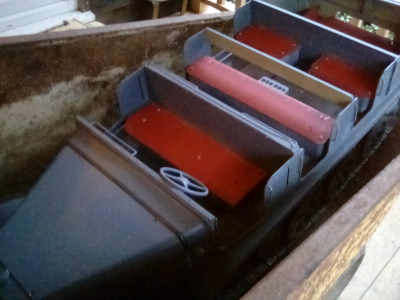

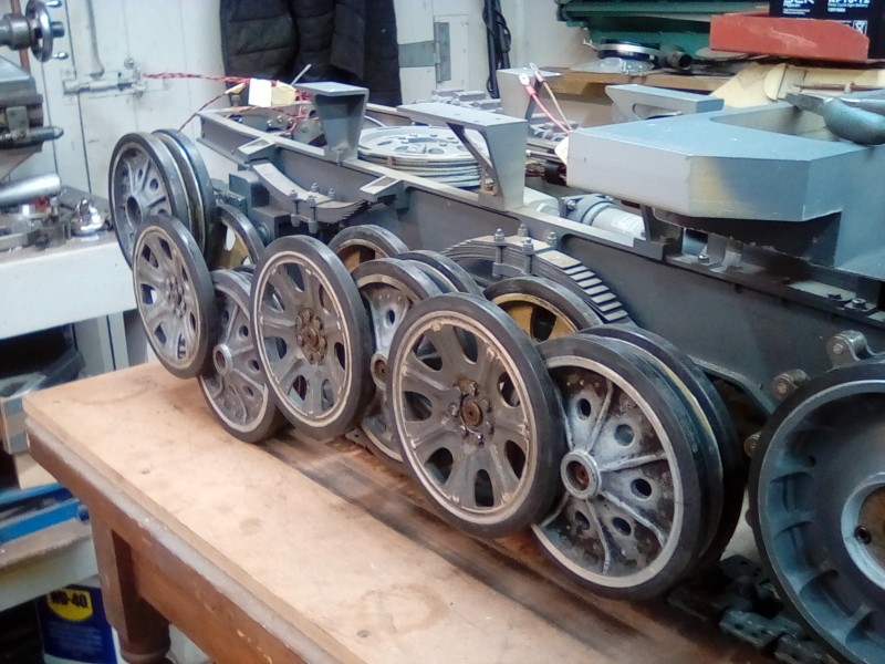

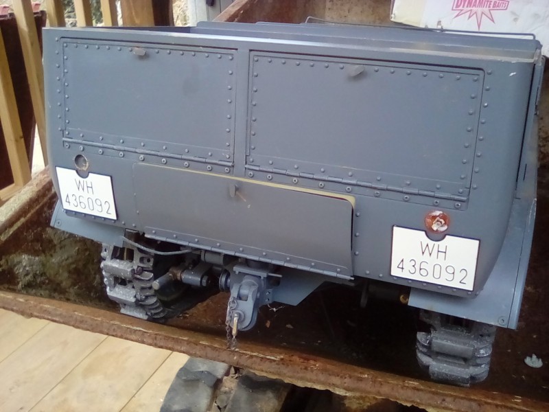

Lots done. The body has been removed. There are some nice details on this model.

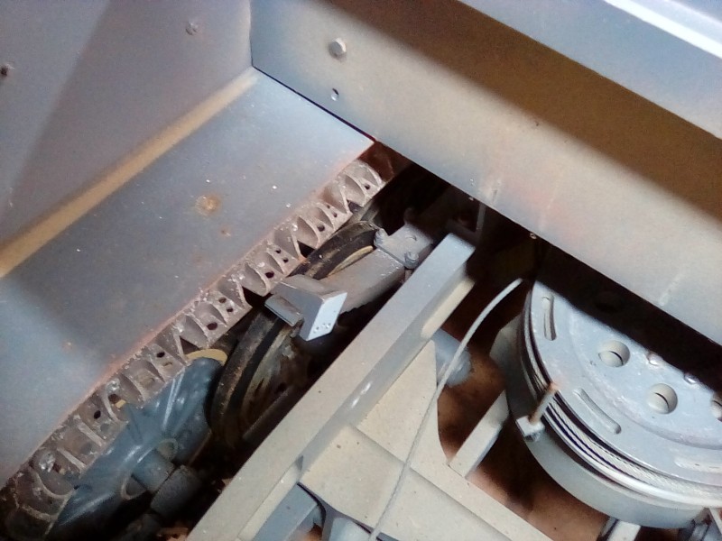

After a short time running each track it's obvious something is rubbing, see ali dust.
Motors and gearboxes working well

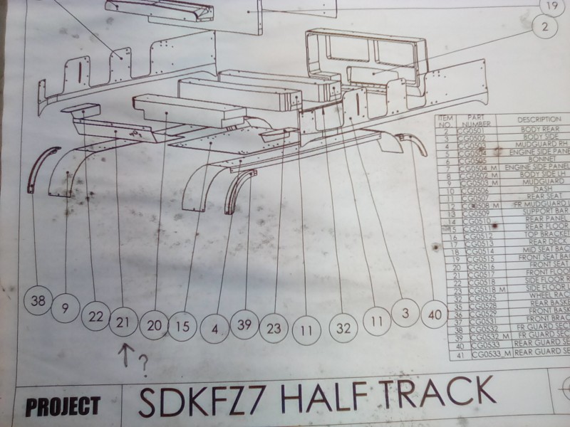

We are not sure where this tray has come from but it's not from inside this model
We don't have this tray

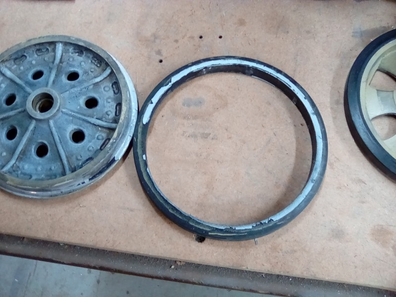

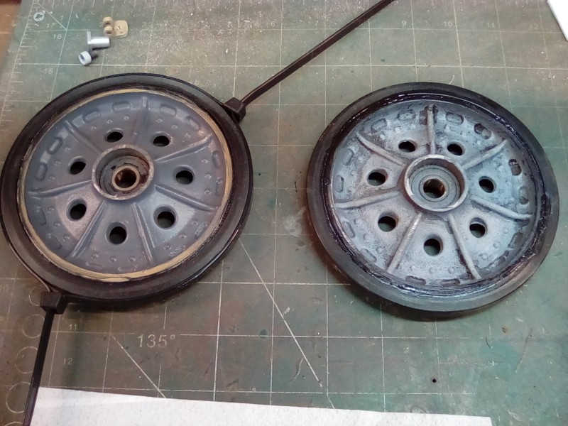

I'm afraid the bonding has deteriorated over time, she was made nearly 20 years ago.
All the wheels will need some lathe work to remove the old bonding, then all needs rebonding once more

All the rubber needs rebonding, I just hope the tyres are not stretched ie going to be too slack, although if you then use epoxy once more it will fill that gap, I've just ordered some nice fresh Locktite 480 as I like to use that above all else
Re: Motion and sounds packs

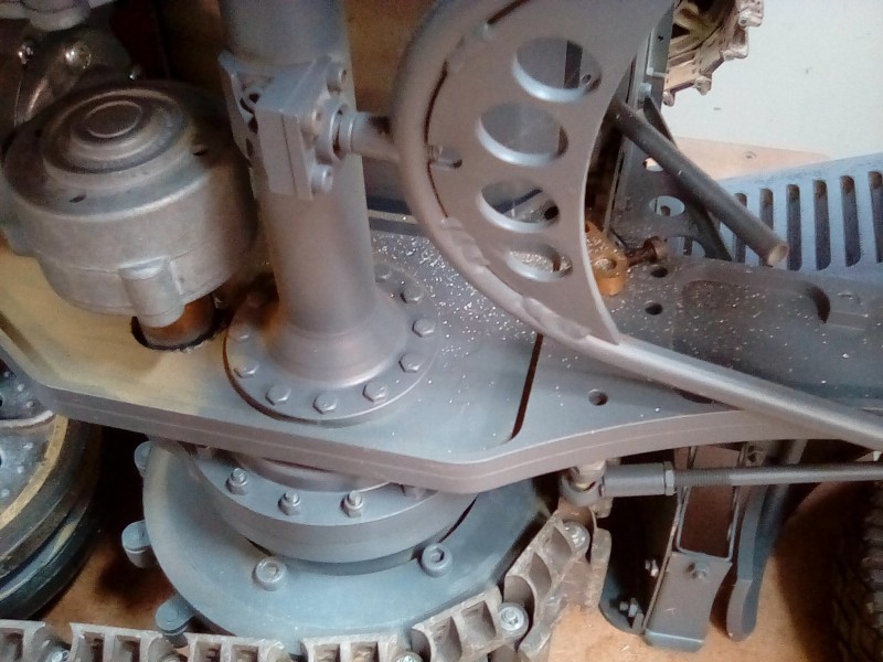

I'm getting my teeth into her now and I am slowly finding the areas that need fetling, it's all very tight around those road wheels. It's worth noting that this model was built by its last owner as a "static" and build very well. Time in damp conditions has taken its toll.
This right angled edge needs dressing back as it's interferes with the track during " track wip"
Bolts shaken loose and missing.
Rust on the bearing surface needs removing and a grease applying, if they are all tight it just won't run right.

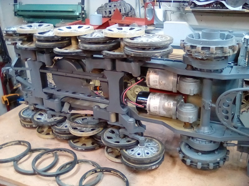

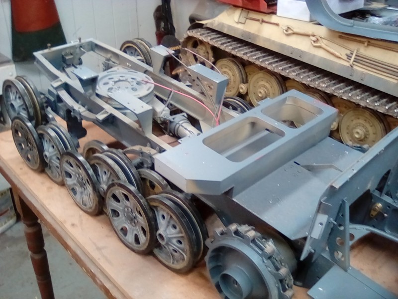

If you angle the road wheels sets like this assembly and disassembly is so much easier .
This bonded joint here pushes the tyre to far over, it needs to be flush as the clearance is crucial .
A little heat releases the adhesive.
The double road wheel sets have copious amounts of adhesive at the rear face which is causing the tyres to rub the opposing wheel set, on its own this is not a big deal but all the road wheels rubbing this way is just to much resistance.

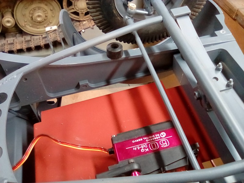

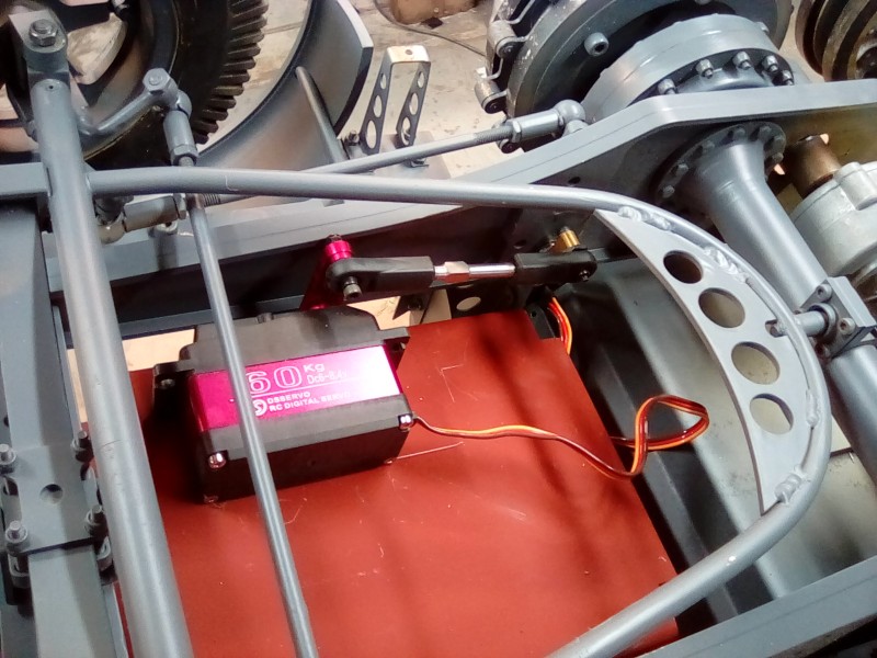

I'm happy with this steering servo convenient position so that's where it's going to live.

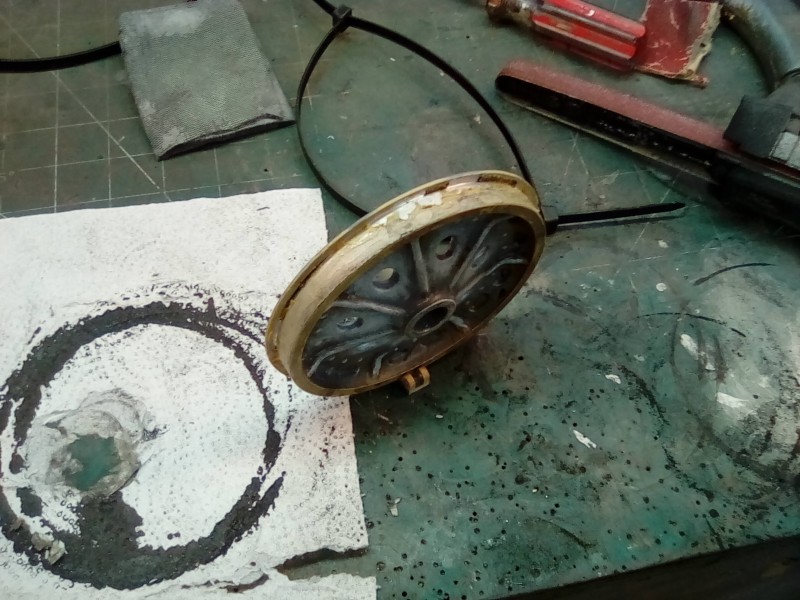

The wheels clean up nicely ready for bonding, Locktite 480 is designed to bond rubber to metal not rubber to paint.
That's the area that is binding , the rubber on the wheel sets is slightly to proud.

Servo brackets made, thread lock applied to all the steering nuts, in fact I'm applying thread lock to everything that needs it .

The steering servo and brackets all bolted in and working correctly via the radio.

First of the drive sprockets cleaned up and the rubber bonded in place

I'm having to shim a lot

All shimmed and in line on this side anyway.

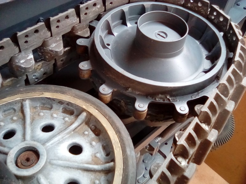

All nicely in line but the links won't fit the sprocket
Will the track stretch with running and fit the sprocket or will I have to fettle each link?

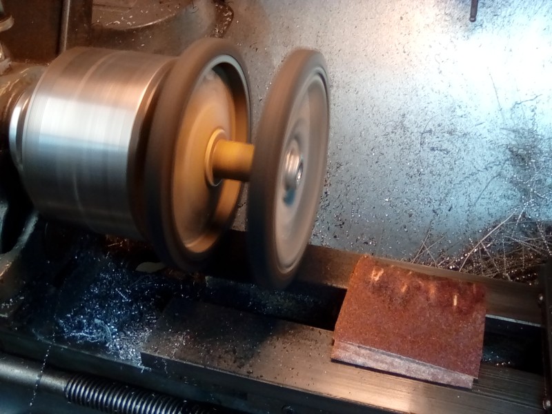

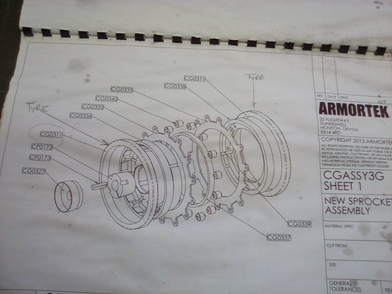

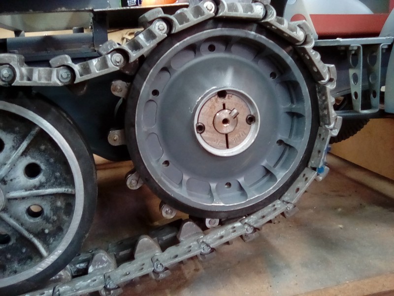

Phil the outer diameter of the new style sprocket tyres needs be 123.5 to 124mm. The tracks will then sit correctly. I turned my glued tyres down in a lathe whilst on the sprockets.
Thanks,
That makes perfect sense Mark thankyou! I shall now turn my lathe black with rubber dust.

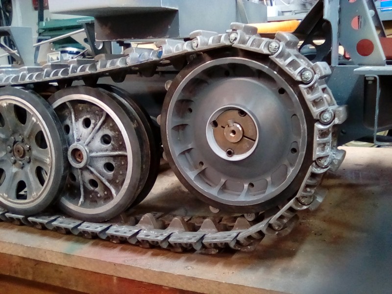

I followed Marks advice and the track fits almost perfectly with just a little fetling required.
Outside calipers makes the job quick and easy and accurate .
A quick bit of turning and we can now mount the sprocket using the taper lock.

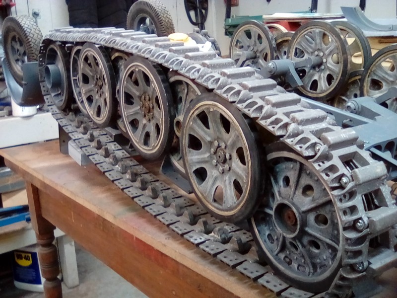

With all this work the half track will be silky smooth.
I'm very pleased with this side.
A taxing days work. It's fighting me all the way, everything interferes with its neighbour but I will methodically go through it , some of the tyres need reducing in diameter just a little to clear the hub of the adjacent wheel set, some of the rubber has a proud casting "rib" on one side which is rubbing the bobbin hubs .
This side for some reason is a bugger.

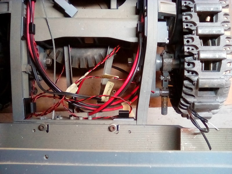

That's a lot of amps for such a small vehicle.
Speaker bolted in place
Beginning to run the wires

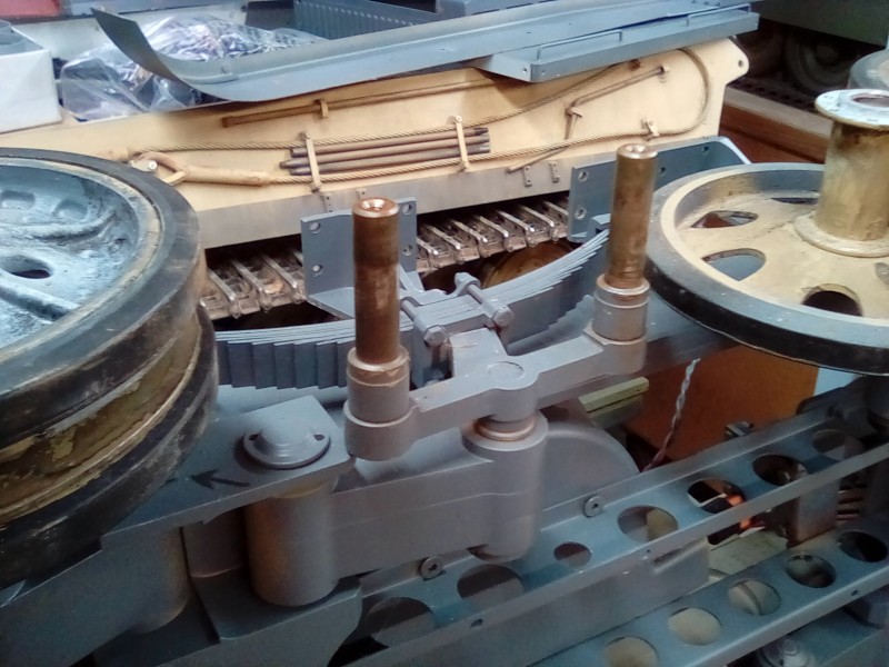

Troublesome idelers
Troublesome idelers
No turning back now
No turning back now
The only way to get the correct alignment
The idler on this side needs tweaking in by almost 2 mm

First proper run at low rpm for this side and it's very smooth indeed, worth all the effort.
Before, you can see the flashing on the tyre that needs removing
After
After
I'm always amazed at how much wire is required
I think that's most of the cables run
Main power leads run through from the rear
Almost ready for the body to be bolted down
Lots of room in here
I shall make a tech tray for all the electrical boxes to sit on in that cavernous rear end
