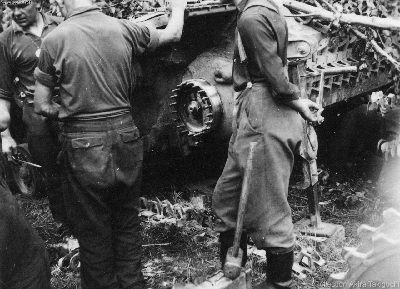

Hi Roy,
Not easy to find foto,s on using the Jack. Believe the where used to lift the road wheels for maintenance. As you can see in the foto. The front road wheel is lifted to its up position to the bumpstop. To release the sprocket.

Another interesting foto of using a jack on a tiger !

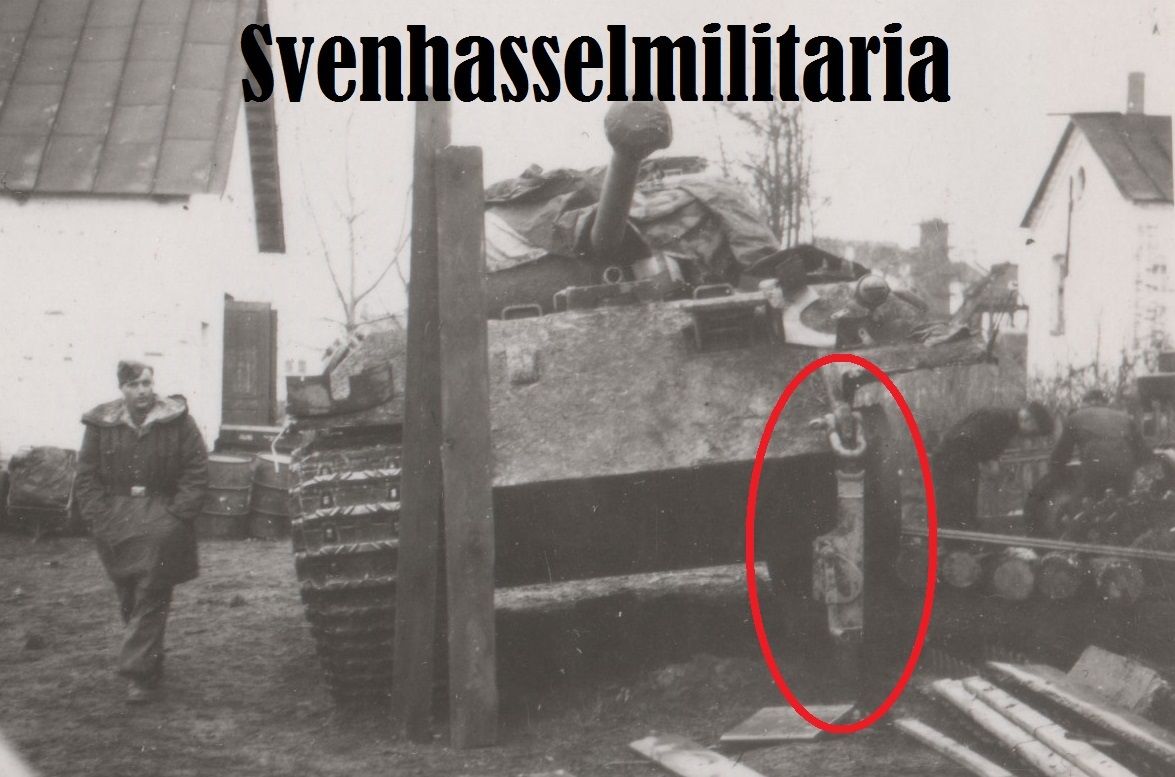

Here's another👍
Hi Kees, that's an interesting picture indeed. Seems to be a surprising position to place a jack. At first glance it looks like its pushing against the mudguard but it's the superstructure on that point already...

Here's another👍
Hi Manny, that's a good photo too, looks like they used the towing eye to attach the jack...

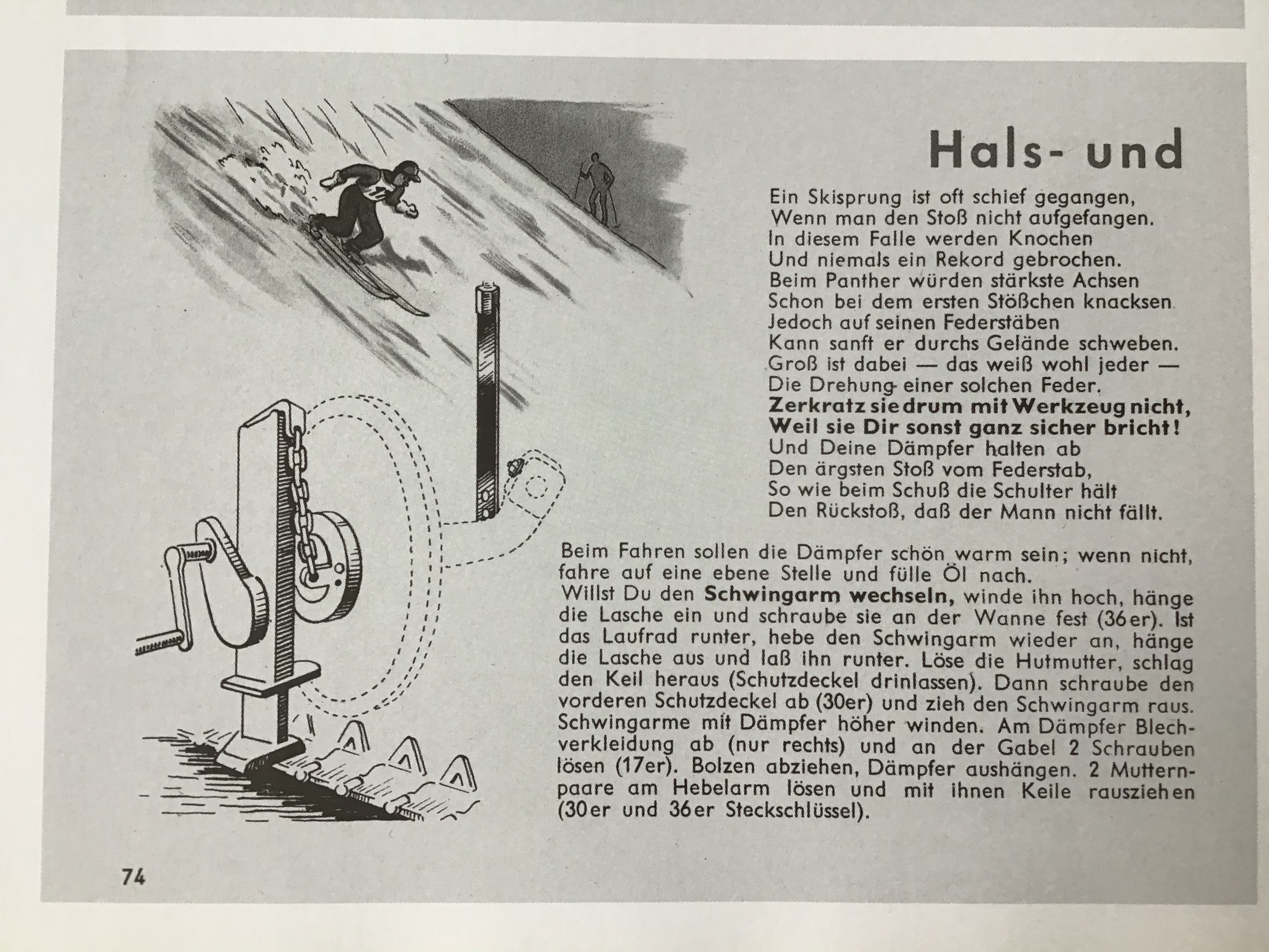

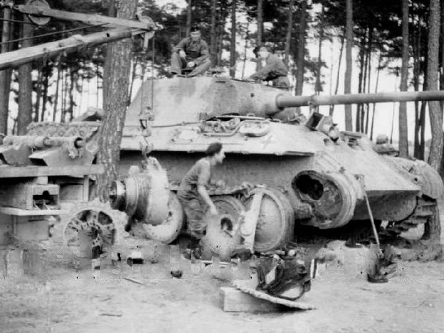

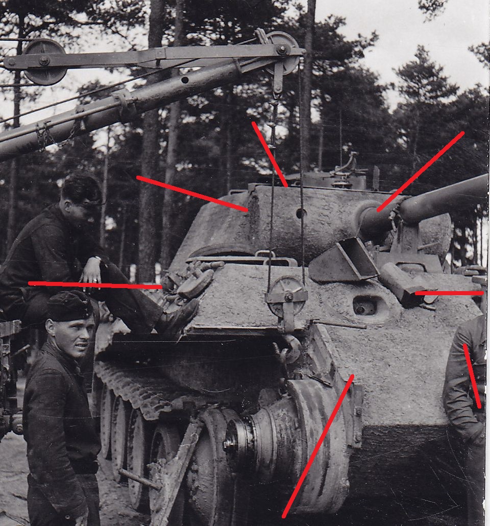

Here are some nice ”jack in action” pics, enjoy.

Excellent pictures Kent, especially like the one in the manual that depicts the use of a special fitting on the hub to lift the road wheel.
Then in the "field" the jack goes straight under wheel rim.
Operators :roll:
