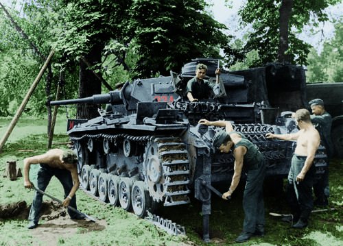

A photo I found

Then he realises that that's the wheel he has to take off :lol: :lol: :lol:

Hi Manny, nice picture! Thx! but like Adrian noticed, either he doesn't know what he is doing or he is trying to achieve something other than exchanging a road wheel... ;-) Any information on the photo's context?

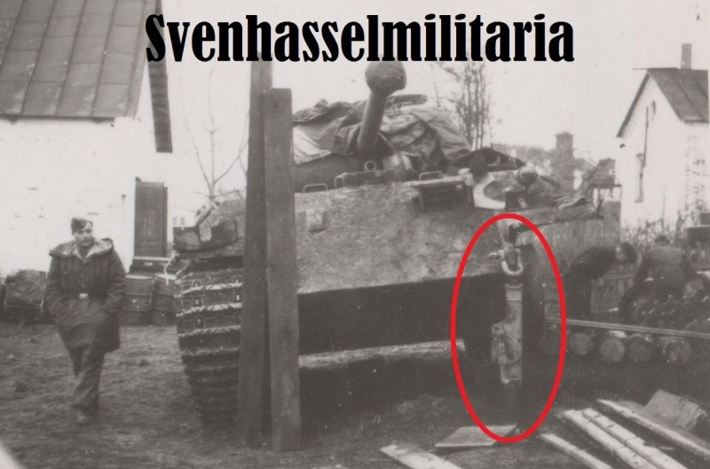

Here's another👍

Hi Manny, that's a good photo too, looks like they used the towing eye to attach the jack...

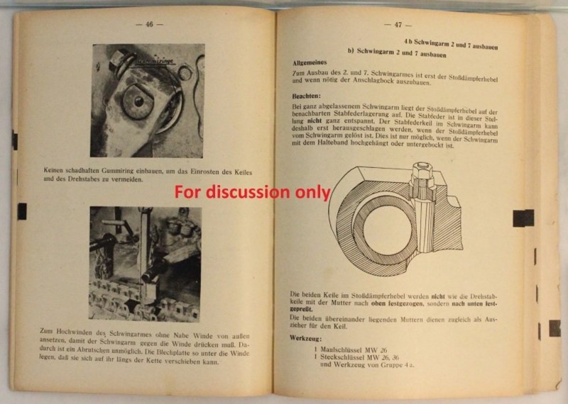

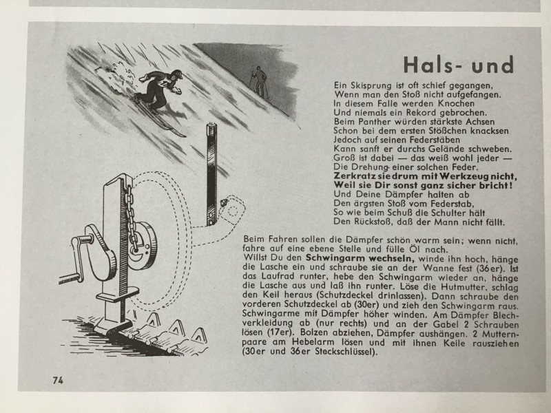

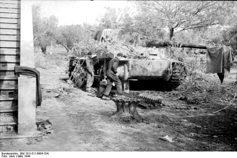

Here are some nice ”jack in action” pics, enjoy.

Excellent pictures Kent, especially like the one in the manual that depicts the use of a special fitting on the hub to lift the road wheel.
Then in the "field" the jack goes straight under wheel rim.
Operators :roll:
