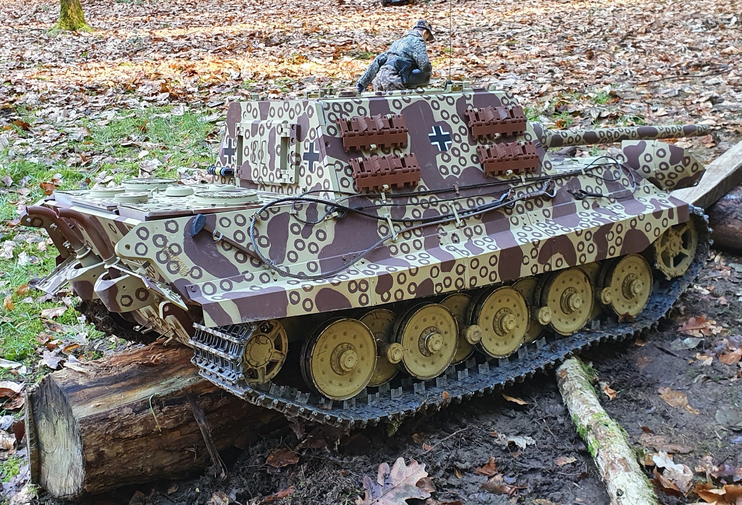

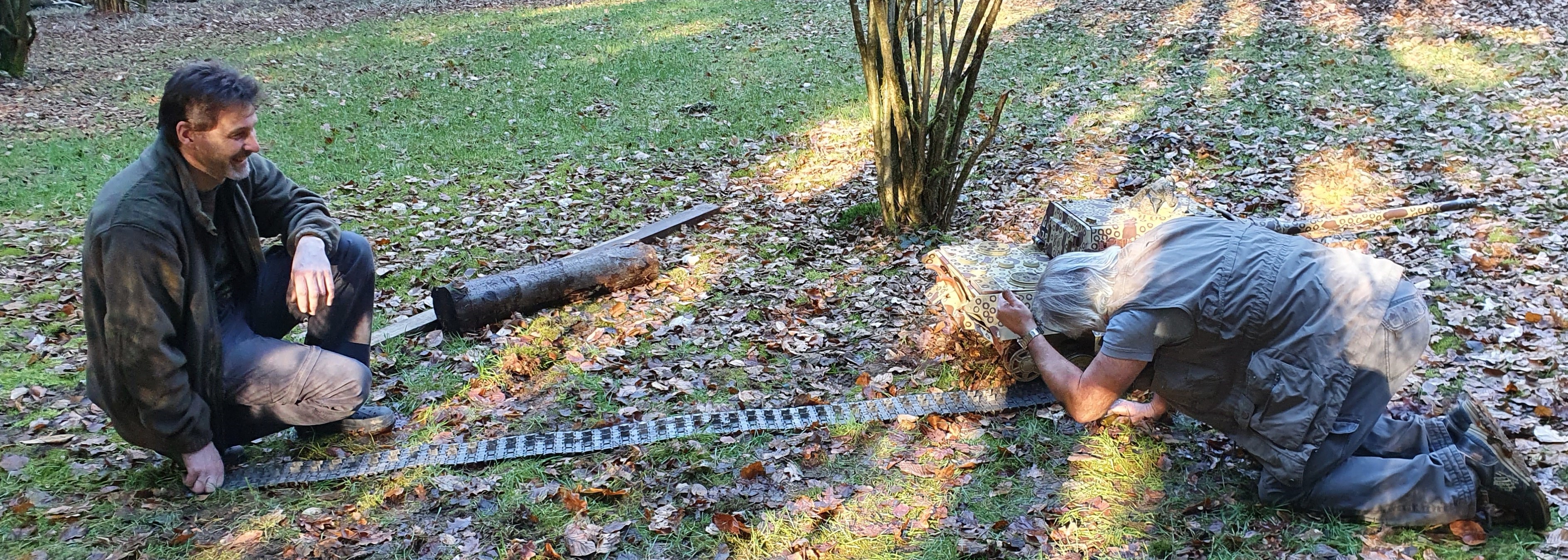

Yes, it´s the same track width. Actually, the tracks you see on the pics are KT tracks. The new At tracks are as shiny as the Stug tracks.Tom Wittstock wrote: ↑Mon Dec 21, 2020 2:28 pmQuestion for you, did the Jagdtiger require wider tracks then the King Tiger or were they the same as the King Tiger tank?

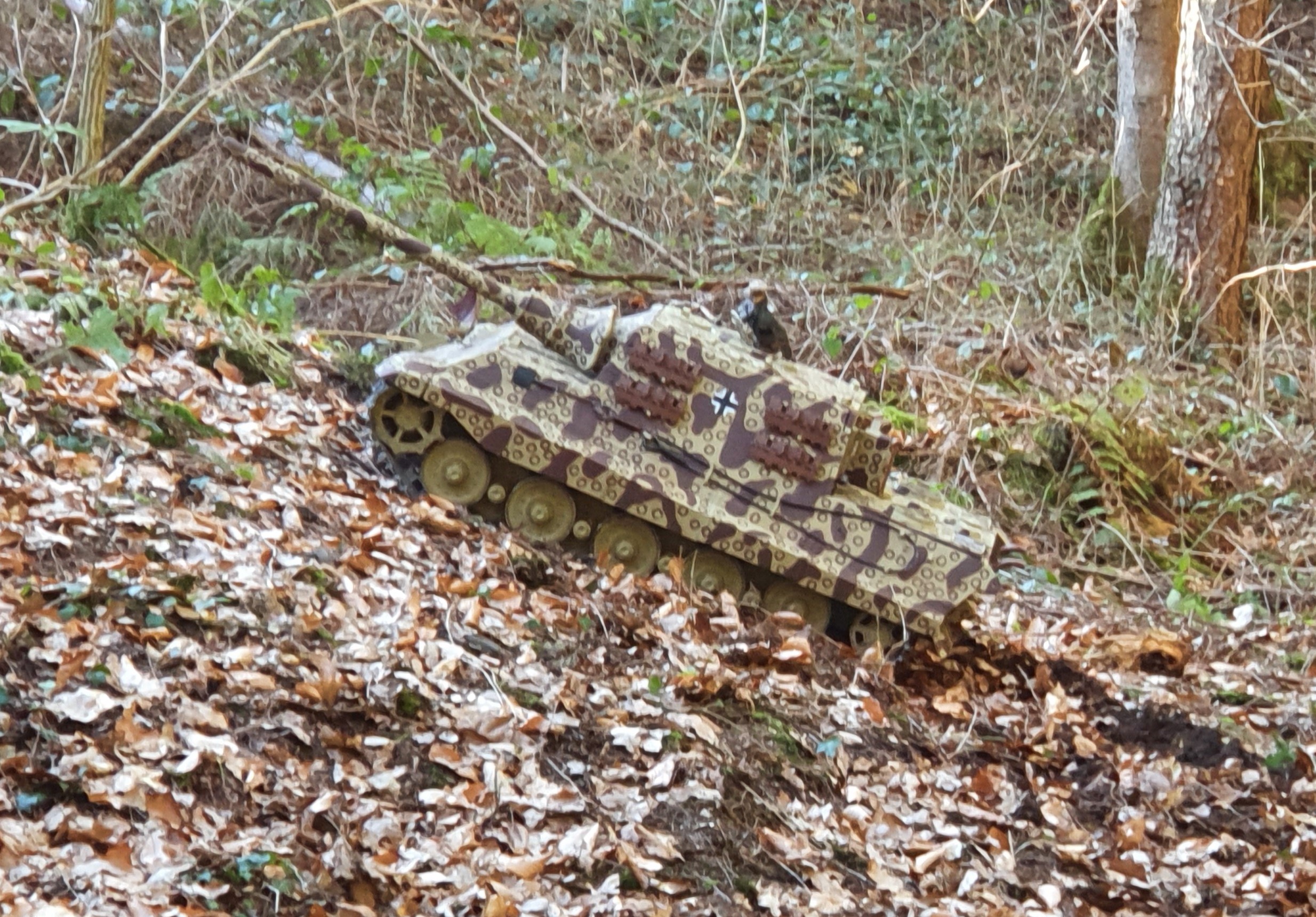

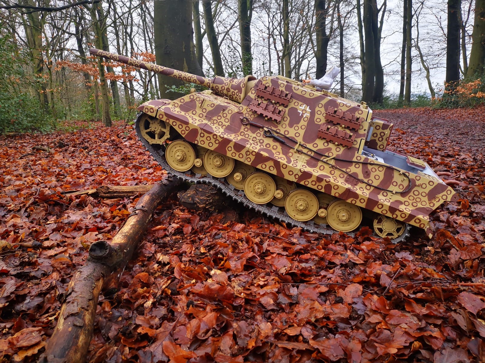

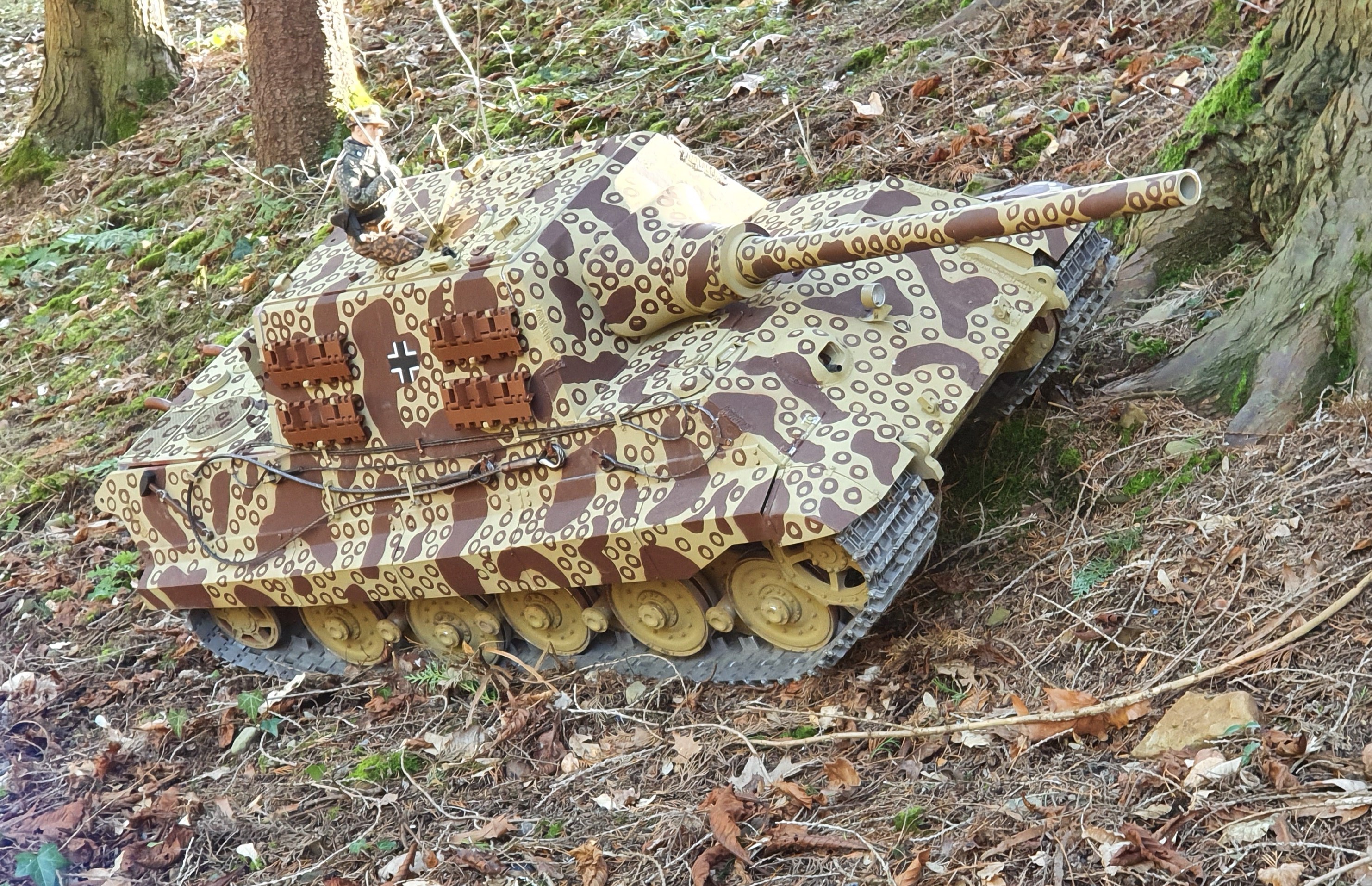

While waiting for the new batteries and exploiting a lull in the rain, I decided, though not finished yet, to take the cat out for a test drive... Enjoy:

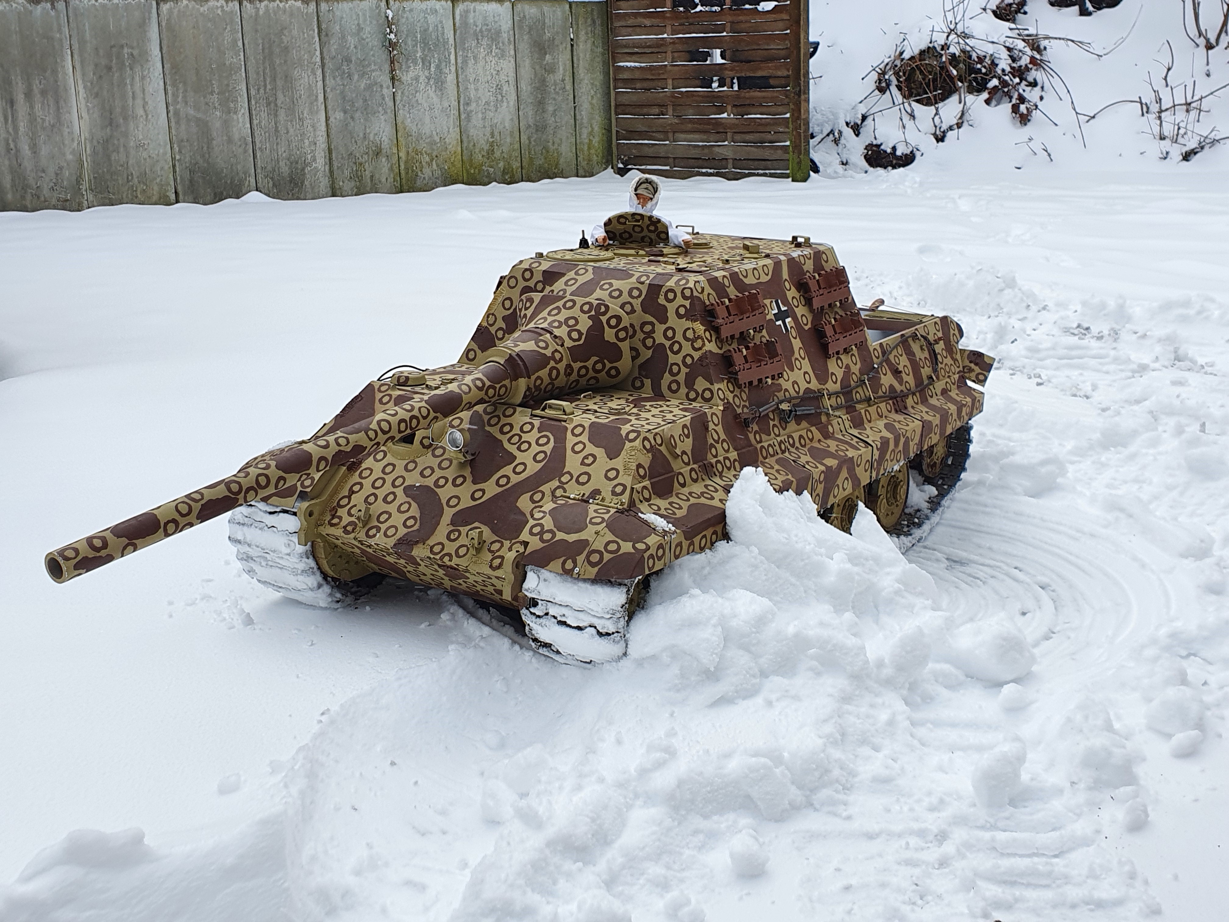

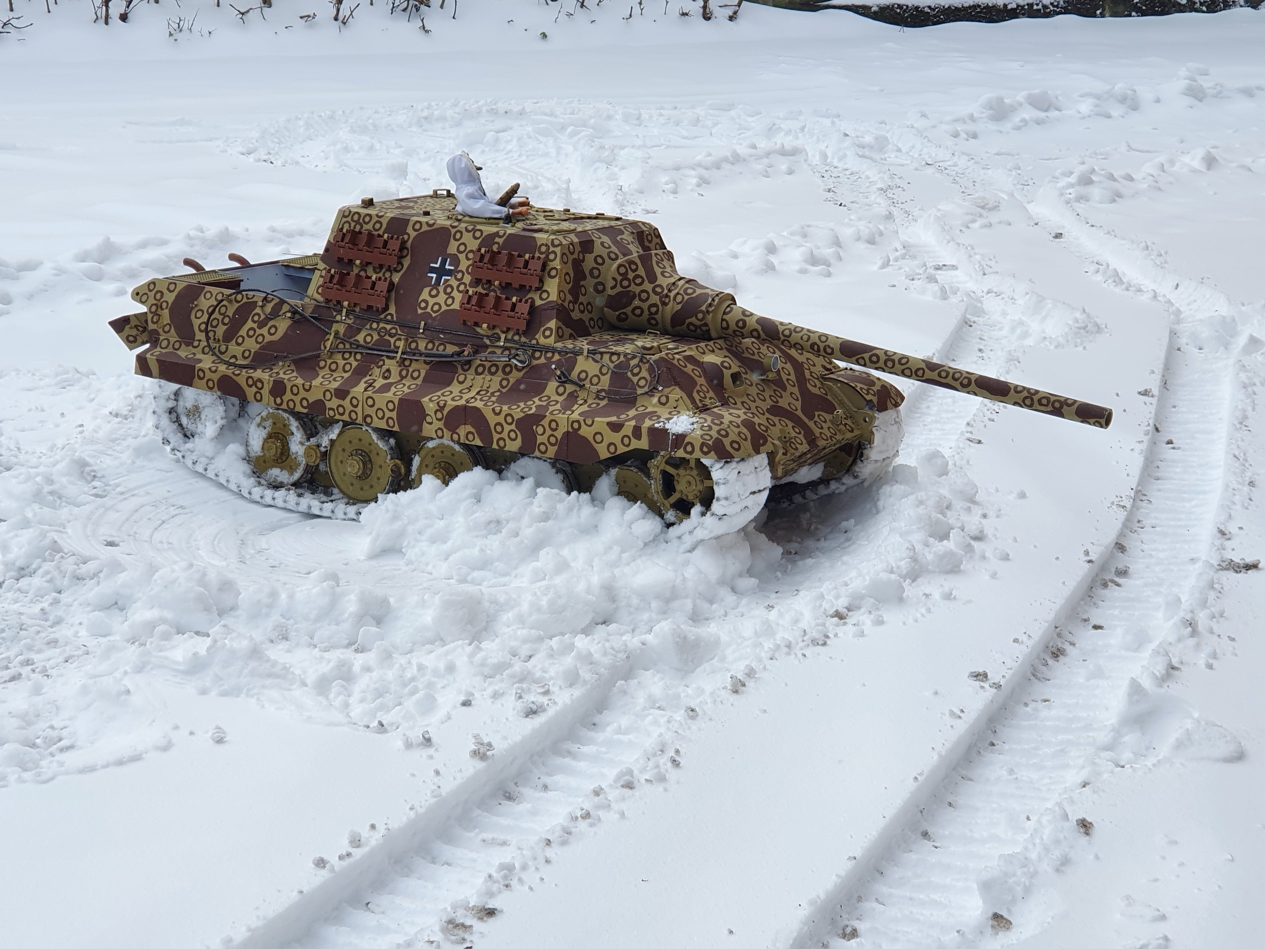

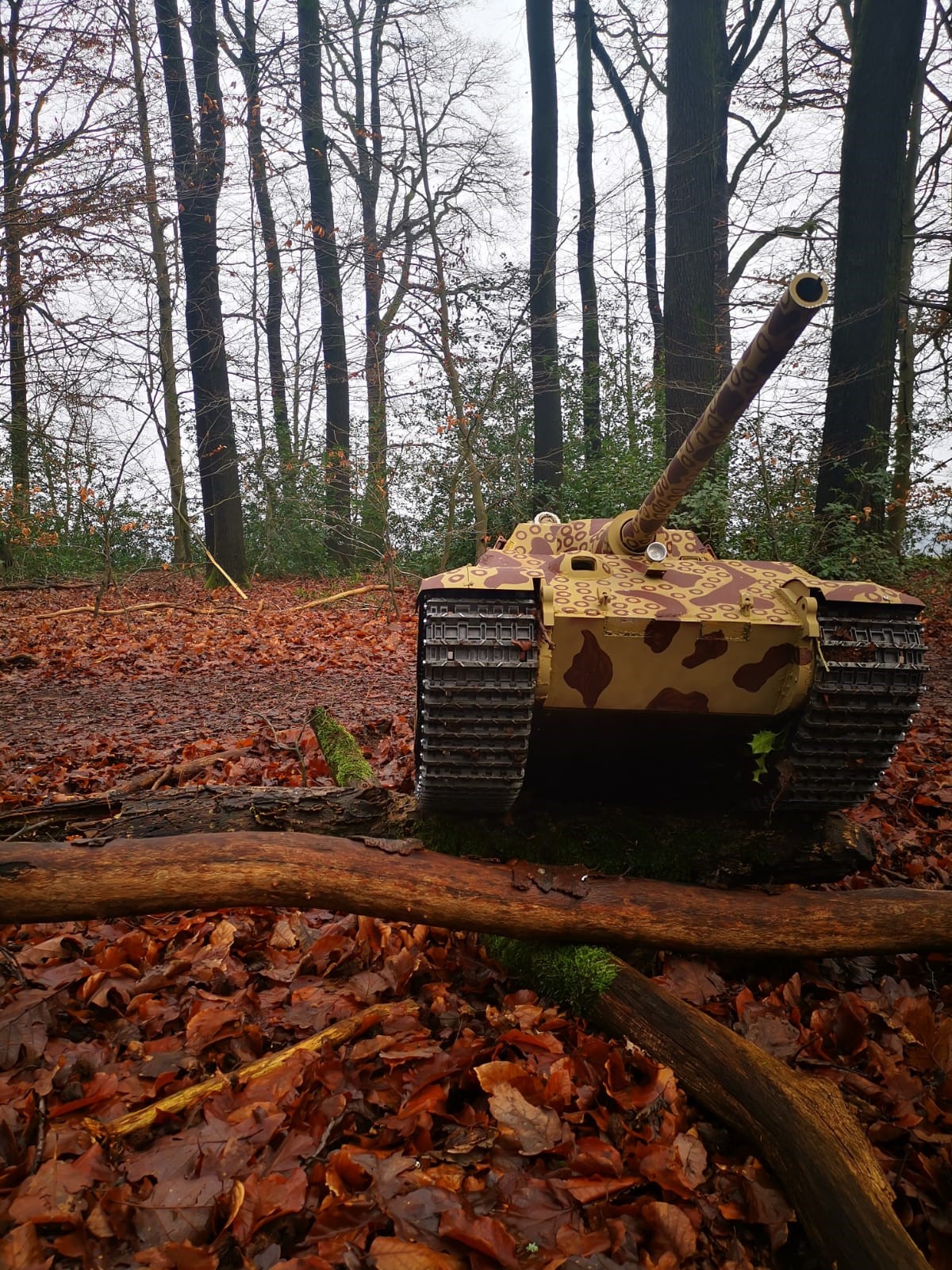

While still waiting for the batteries....
Tigers in the snow... Lord, give me strength to change the things I am able to change.... and patience to endure the things I can not change A bunch of Tiger and Panther variants, a few 88`s and smaler ones like Hetzer, Stug III, etc. and soon a Leo II

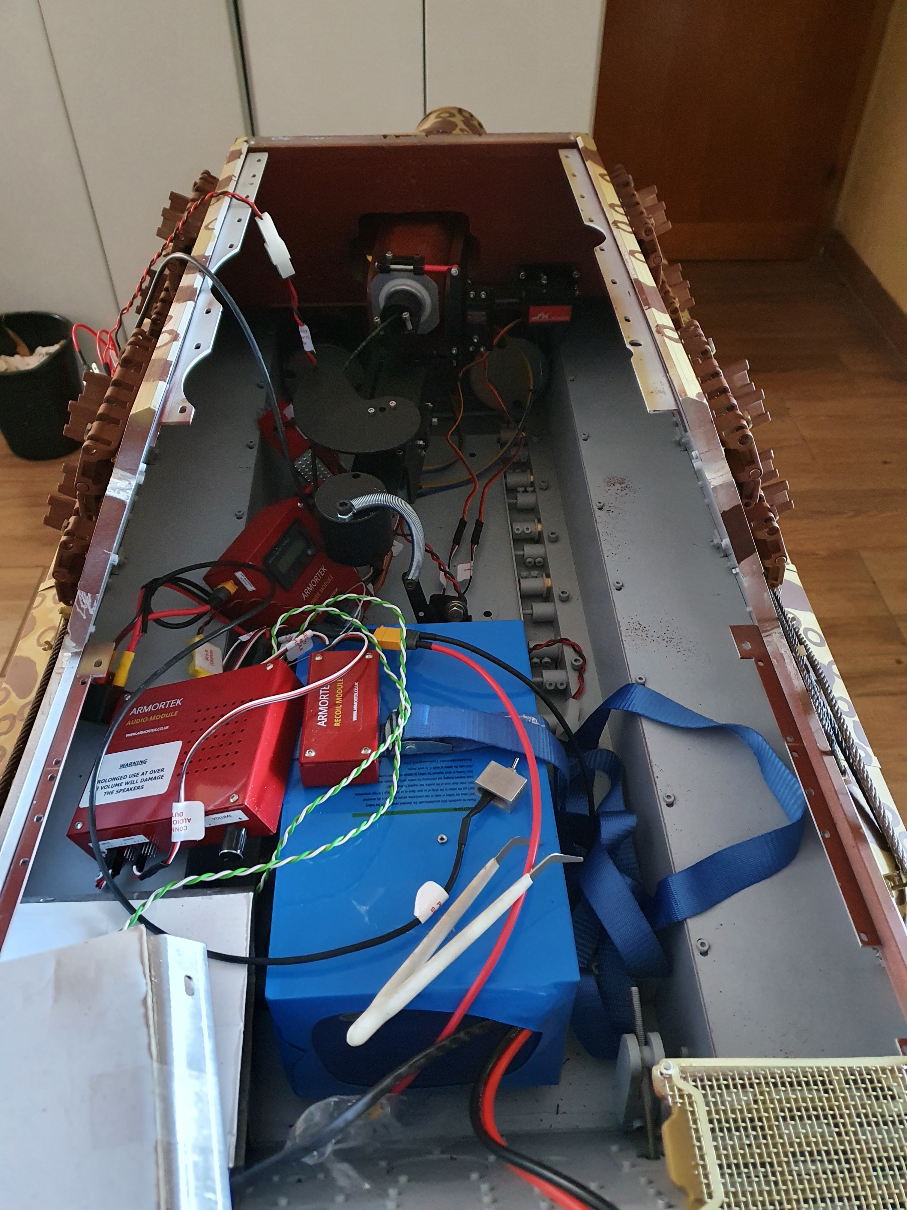

Battery finally arrived, thanks to Kees!!
Thus the work can be resumed...Lord, give me strength to change the things I am able to change.... and patience to endure the things I can not change A bunch of Tiger and Panther variants, a few 88`s and smaler ones like Hetzer, Stug III, etc. and soon a Leo II

Hello Peter,
20 kgs are a lot of weight to spare, you will see. I got this experience also in my Jati and was very pleased about that.
Nice battery pack. It comes together with a BMS, I suppose?
A strong battery also needs a powerful charging device. In my models I use both types of battery packs, with BMS and without. Therefore I needed a charging device with balancer, and I chose the Junsi iCharger 4010 Duo with 2 x 1,400 watts charging power. It has a maximum charging current of 70 amps (hardly needed) and a balancing current of 2 amps, a strong value. Most of other balancers can handle only 1 amp balancing current or less.
Please keep in mind that this charging device needs a seperate power supply.

Hi Michael,Gerhard Michel wrote: ↑Mon Feb 15, 2021 10:40 amHello Peter,
Thanks for the advice!! All taken into account. A special charger came with the battery.

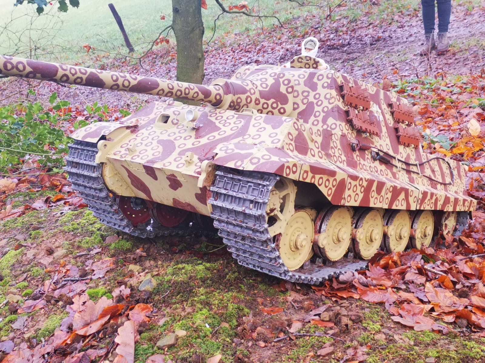

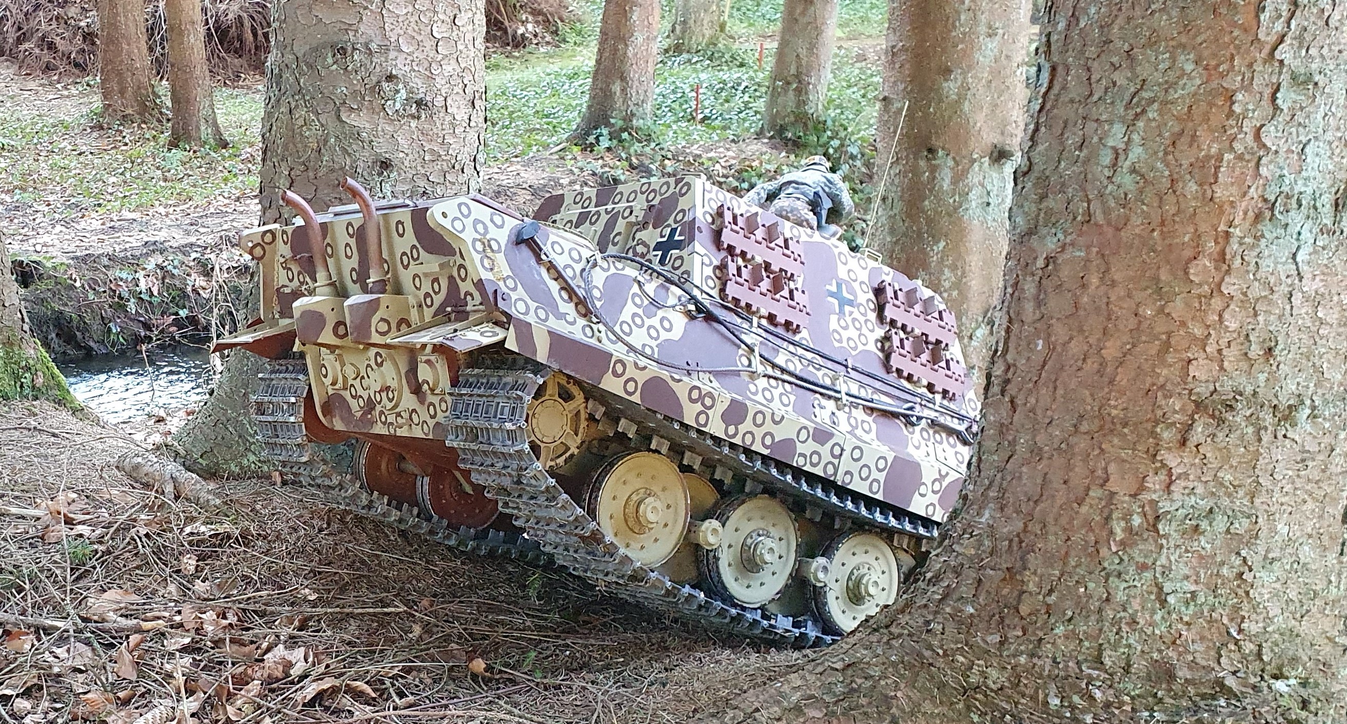

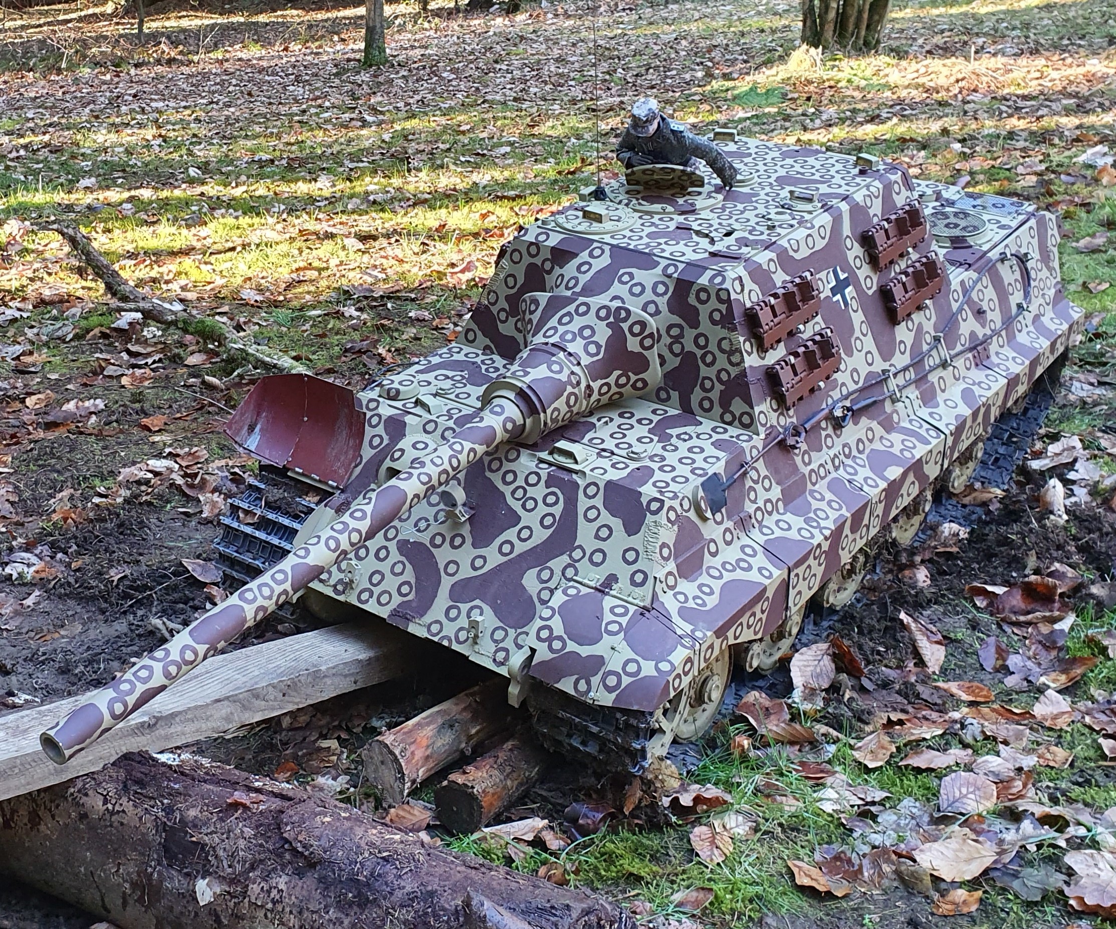

On return from maintenance, a lone JT negotiates the woods....
... spotting an American Unit, moving into an ambush position....

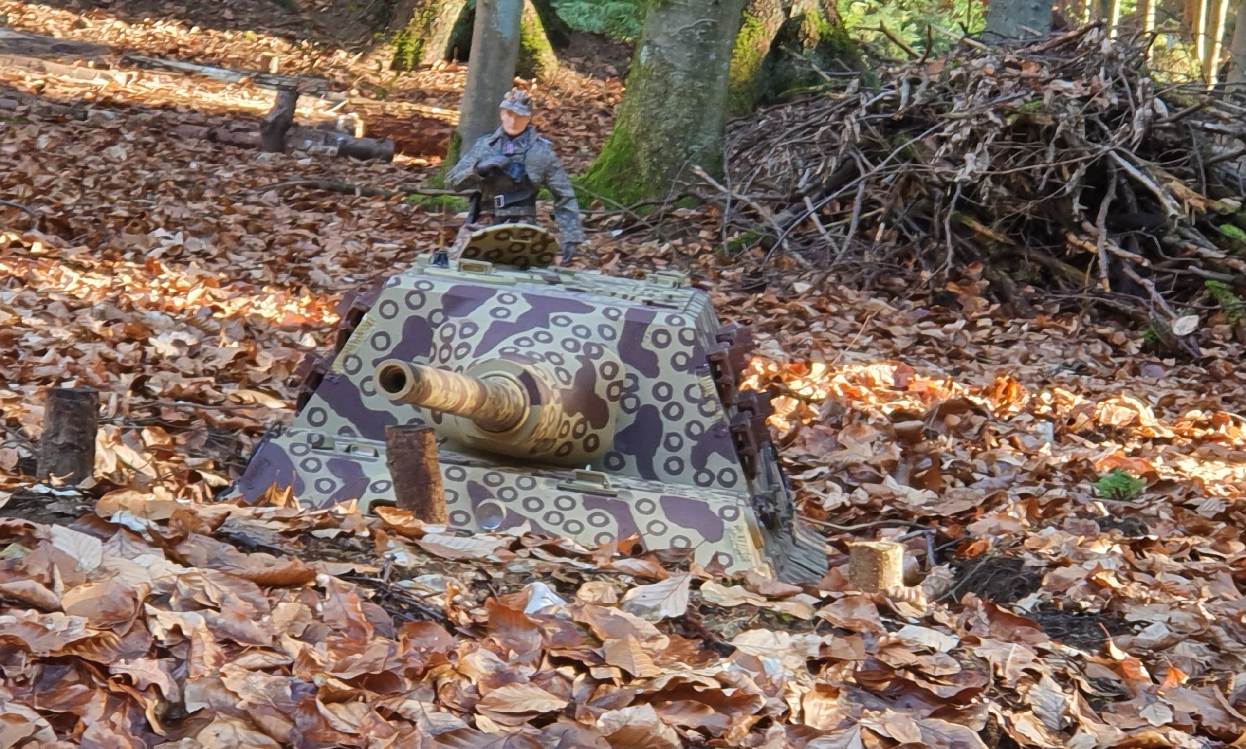

...lurking....
...Americans ambushed and captured...

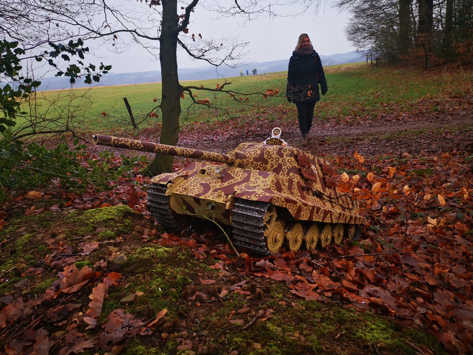

...but luck ran out, a few miles down the trail...
... right track climbed over the idled wheel...

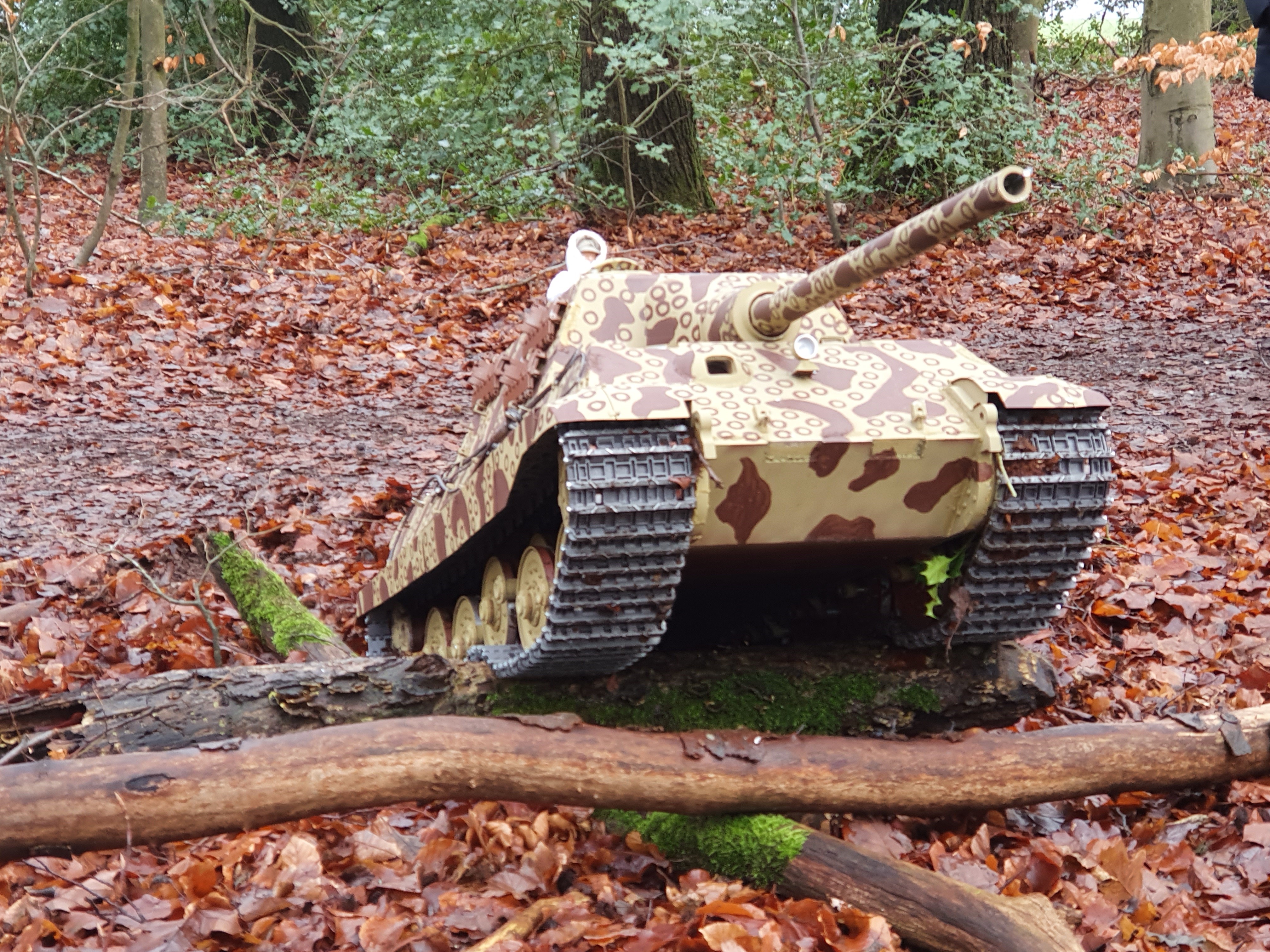

.. but maintenance crew got to work at once...
... and march was resumed after a little while....Lord, give me strength to change the things I am able to change.... and patience to endure the things I can not change A bunch of Tiger and Panther variants, a few 88`s and smaler ones like Hetzer, Stug III, etc. and soon a Leo II
