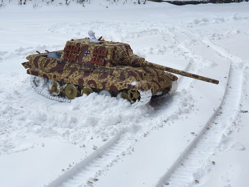

While waiting for the new batteries and exploiting a lull in the rain, I decided, though not finished yet, to take the cat out for a test drive... Enjoy:

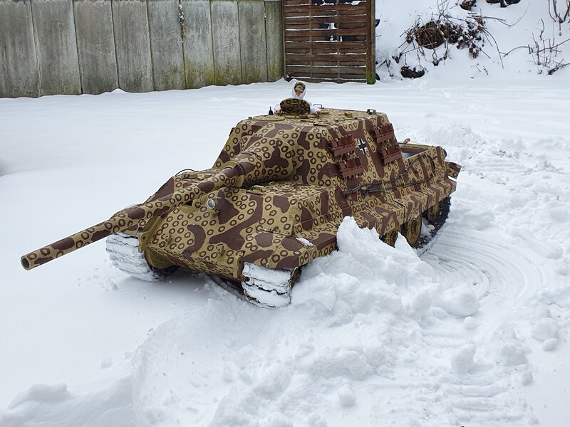

While still waiting for the batteries....
Tigers in the snow...

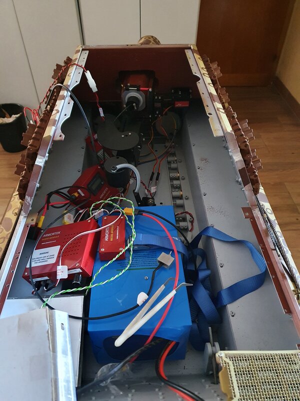

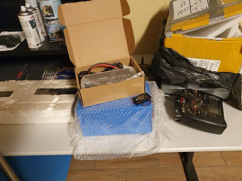

Battery finally arrived, thanks to Kees!!
Thus the work can be resumed...

Hello Peter,
20 kgs are a lot of weight to spare, you will see. I got this experience also in my Jati and was very pleased about that.
Nice battery pack. It comes together with a BMS, I suppose?
A strong battery also needs a powerful charging device. In my models I use both types of battery packs, with BMS and without. Therefore I needed a charging device with balancer, and I chose the Junsi iCharger 4010 Duo with 2 x 1,400 watts charging power. It has a maximum charging current of 70 amps (hardly needed) and a balancing current of 2 amps, a strong value. Most of other balancers can handle only 1 amp balancing current or less.
Please keep in mind that this charging device needs a seperate power supply.
kind regards
Gerhard

Hi Michael,Gerhard Michel wrote: ↑Mon Feb 15, 2021 10:40 amHello Peter,
Thanks for the advice!! All taken into account. A special charger came with the battery.
Peter

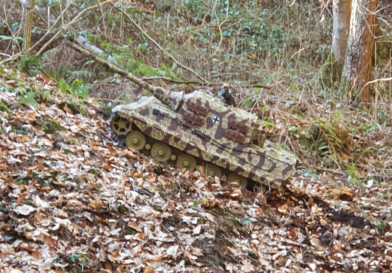

On return from maintenance, a lone JT negotiates the woods....
... spotting an American Unit, moving into an ambush position....
...lurking....
...Americans ambushed and captured...
...but luck ran out, a few miles down the trail...
... right track climbed over the idled wheel...
.. but maintenance crew got to work at once...
... and march was resumed after a little while....Lord, give me strength to change the things I am able to change.... and patience to endure the things I can not change
