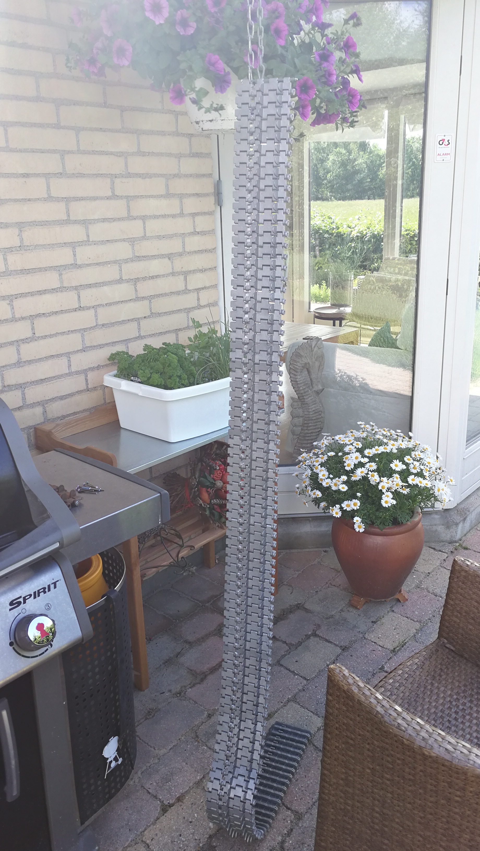

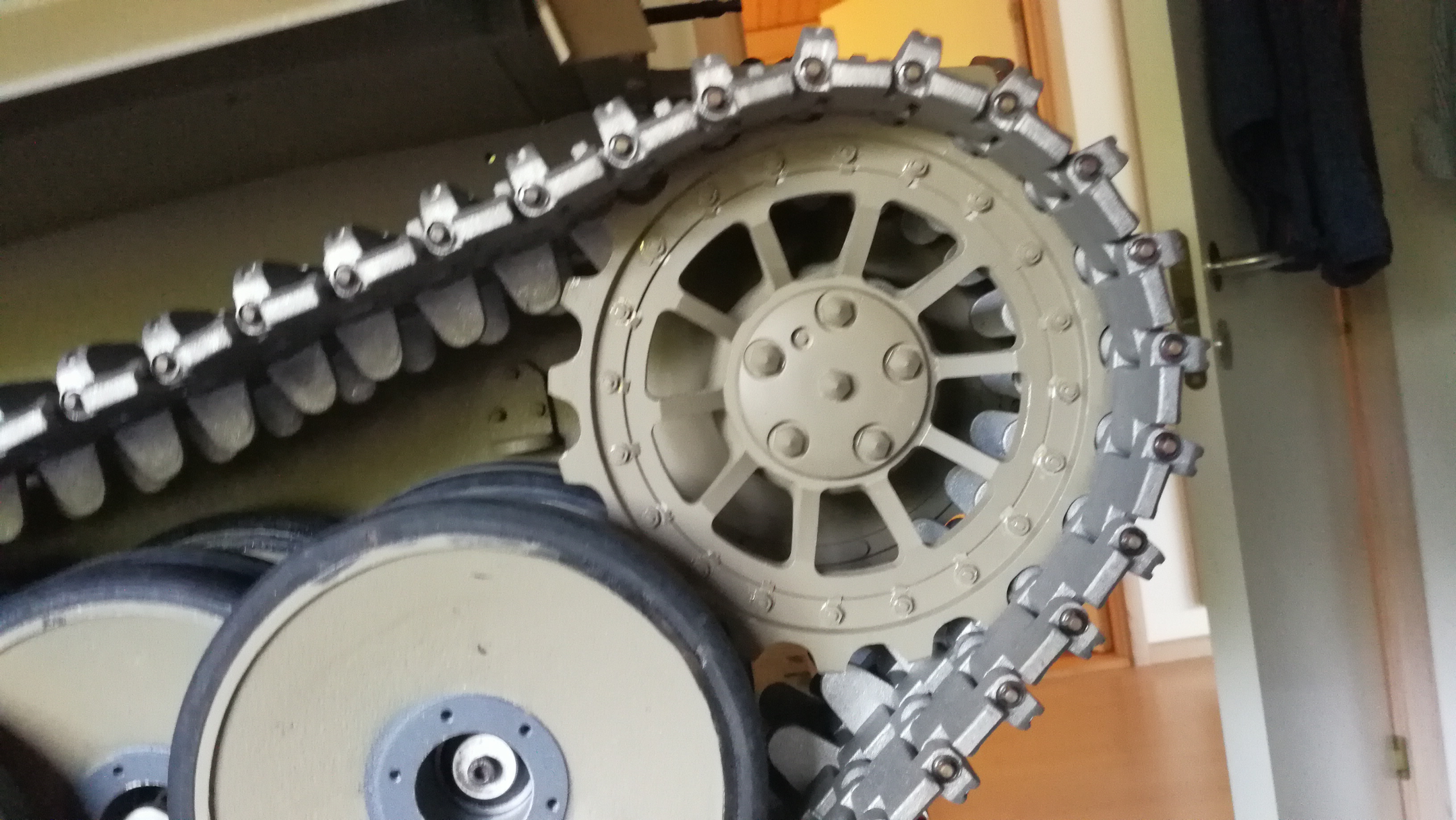

I am having a hard time finding out what the problem is with the tracks on my 2003 tiger 1 build
Road wheels are 100 % aligned and sprocket has been gently alligned by rolling the track by hand so that it gets the perfect fit.
The pictures shows the tracks will not fit the sprocket teeths.
The tracks are the 2003 version put together a looooong time ago.

The 2003 issue Tiger tracks have a casting fault on them. If you look at the circular part of the track link that sits between the sprocket teeth, it has a right angled corner profile instead of being circular. You need to re profile every link with a hand file or Dremel to make them circular.
You will also find that the spring washers that hold the track pins in have a habit of coming off during running, causing the pin to come out. All the track pins now are cross drilled and split pinned.
Sorry for the bad news. It looks like you have some rework to do. There is only 200 track links and pins

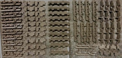

Does anyone have a picture of a track link where the change has been made, just for comparison on how much to dremel the area

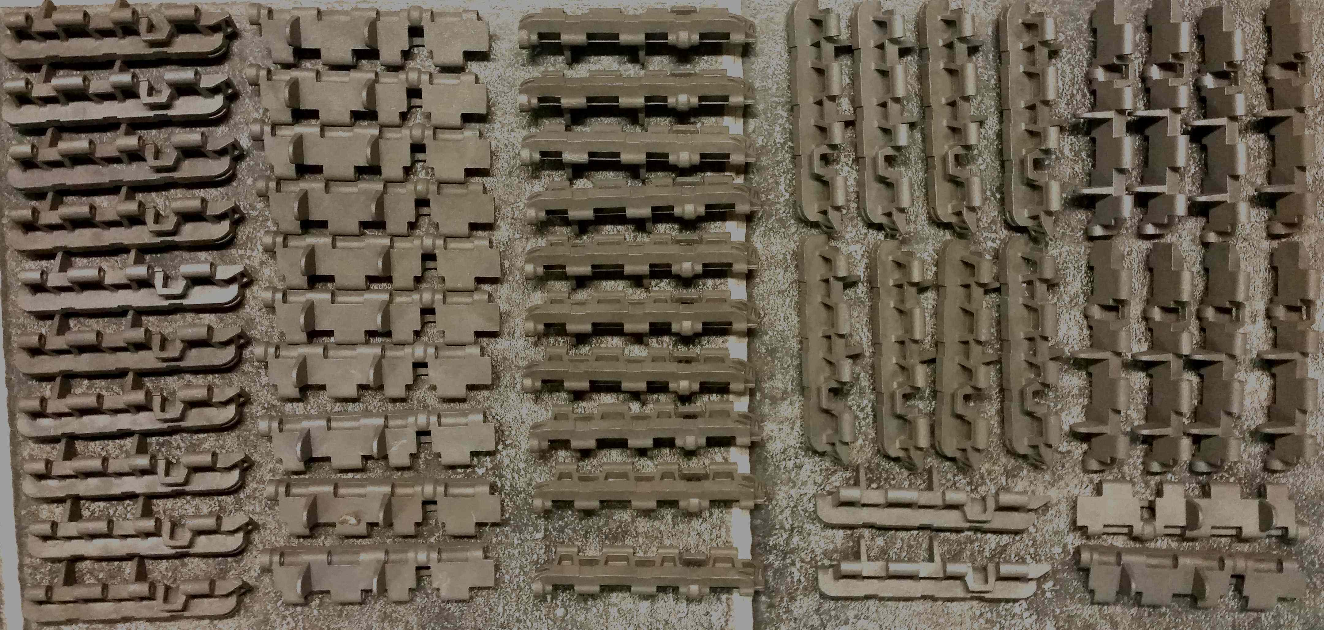

This pic is from the links which were on special offer:

Got it
thanks Adrian - Weekend is coming up and no rain, so this will be enjoyed in the garden with lots of dremel work

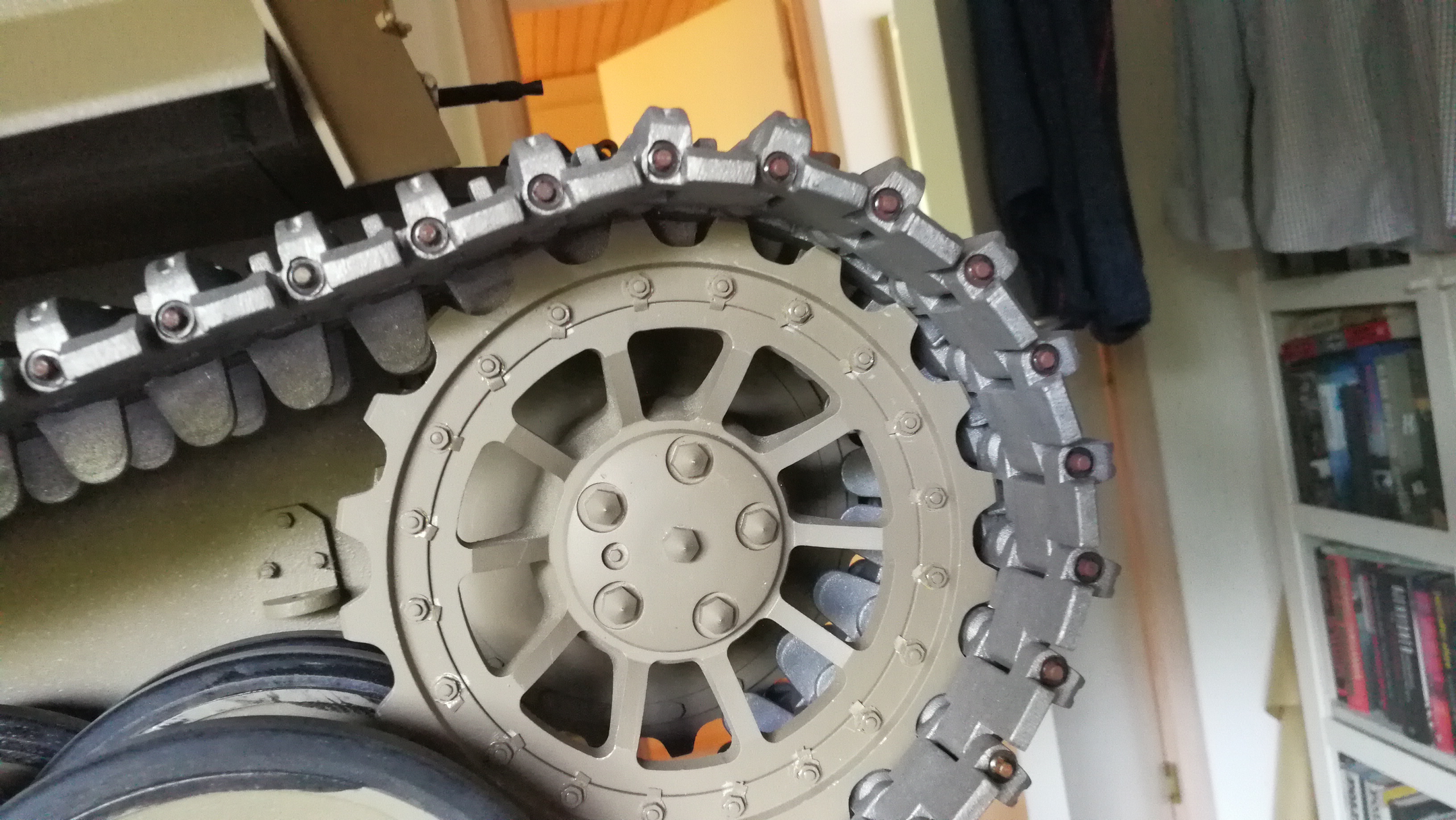

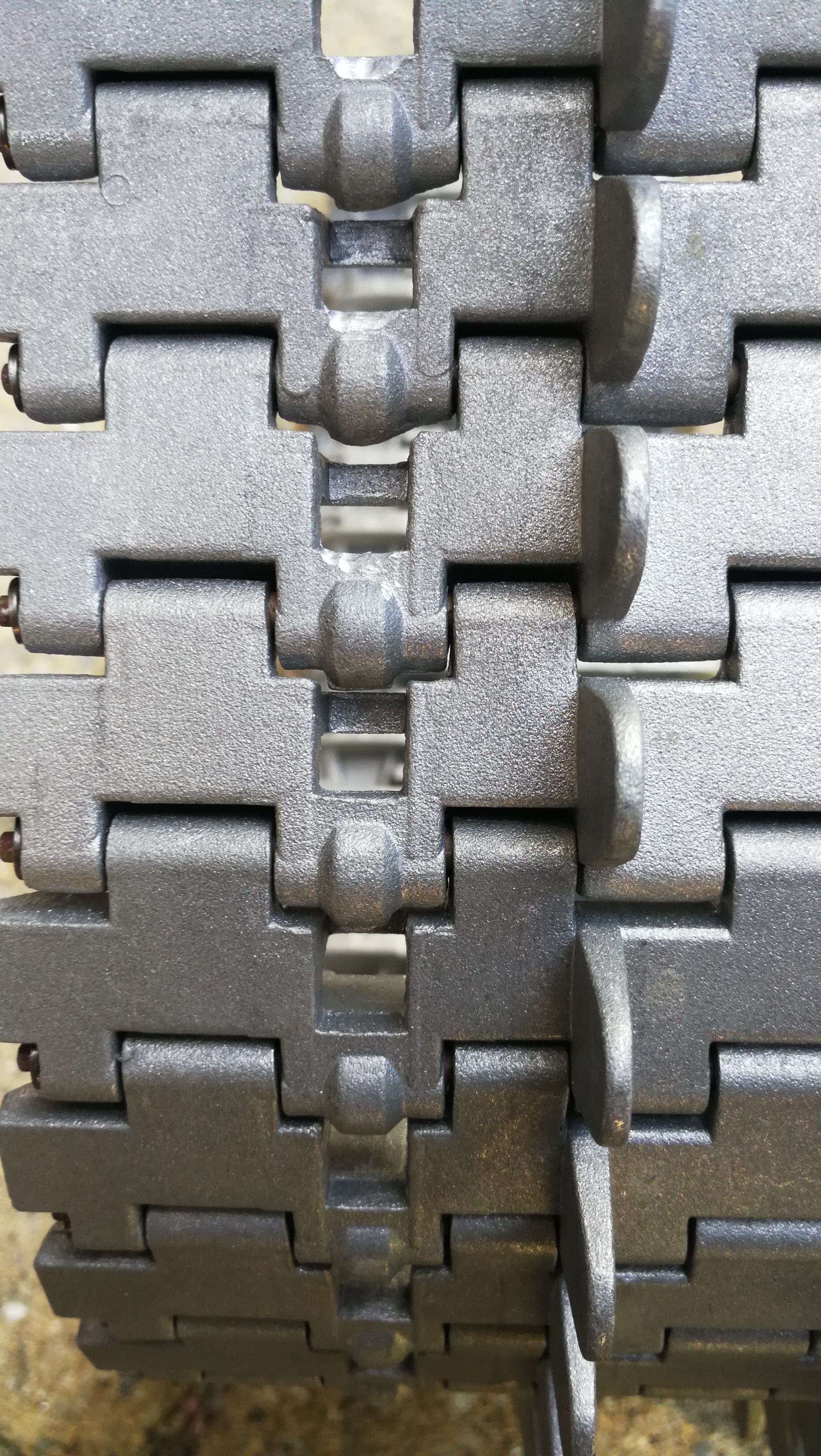

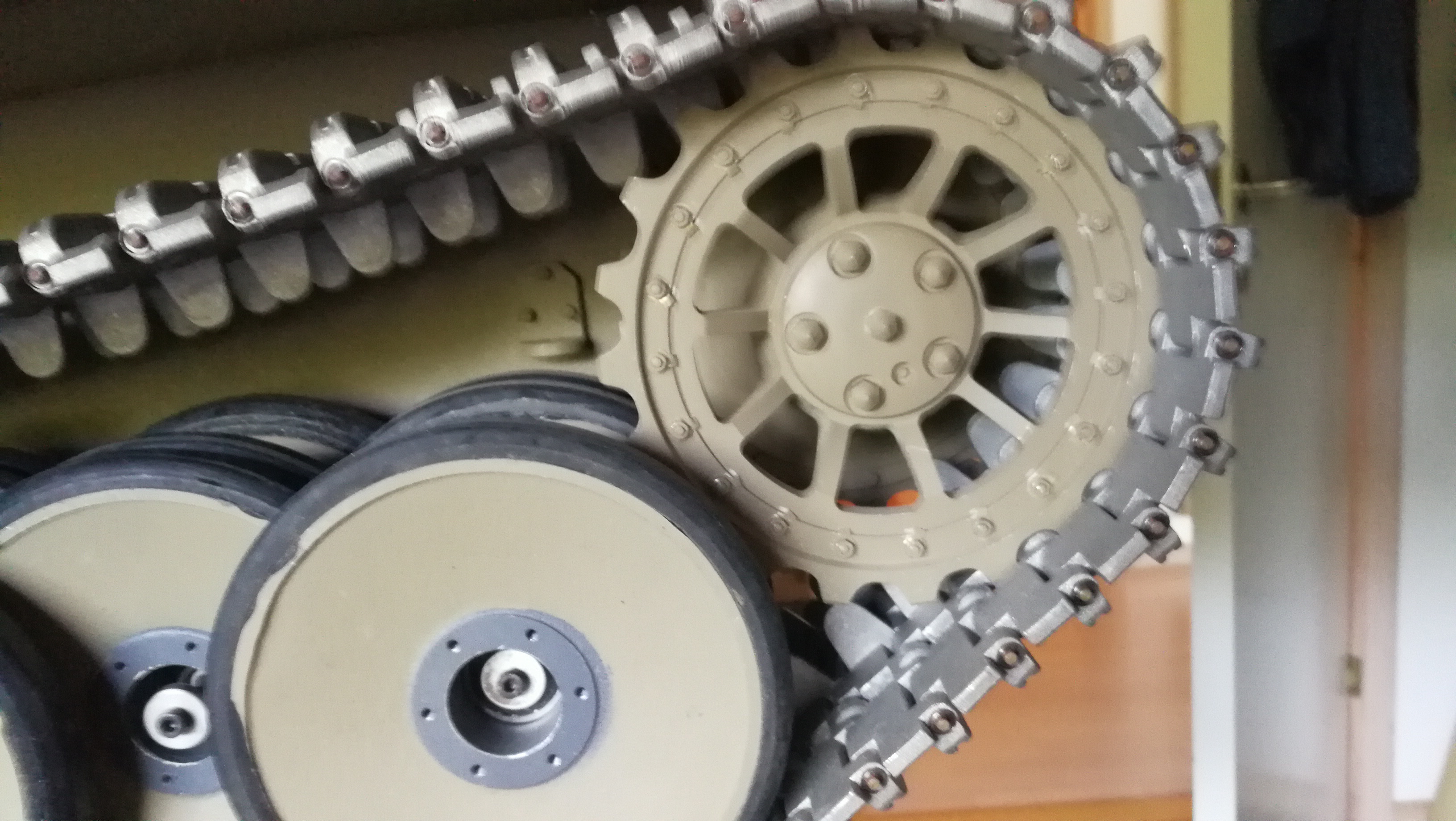

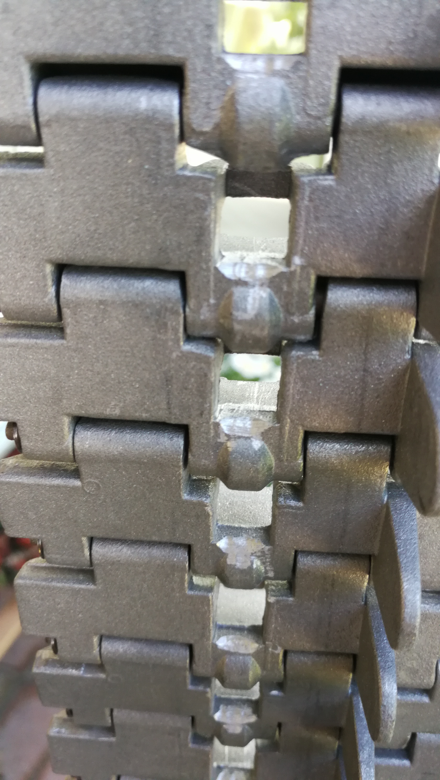

tracks are now adjusted with my dremel - test fittet and everything seems to just fine.
Here are some pictures of the work
