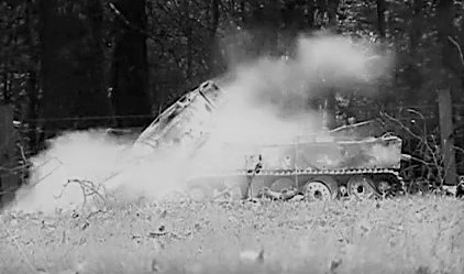

Been going through my old videos and found a few pics that may be of interest. Just enjoy don't try this at home
- Tiger1,Anti tank rifle at a Tiger1 hulk.-mz7Rk4NgISI_x264_Moment(4).jpg (50.35 KiB) Viewed 3084 times

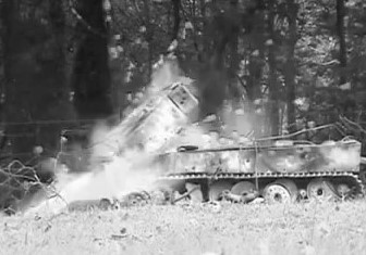

Re: Tiger1 Firing Trials By Magpiespyro
Cheers Steen, here's the next in sequence in the Tiger 2 mine explosion.
