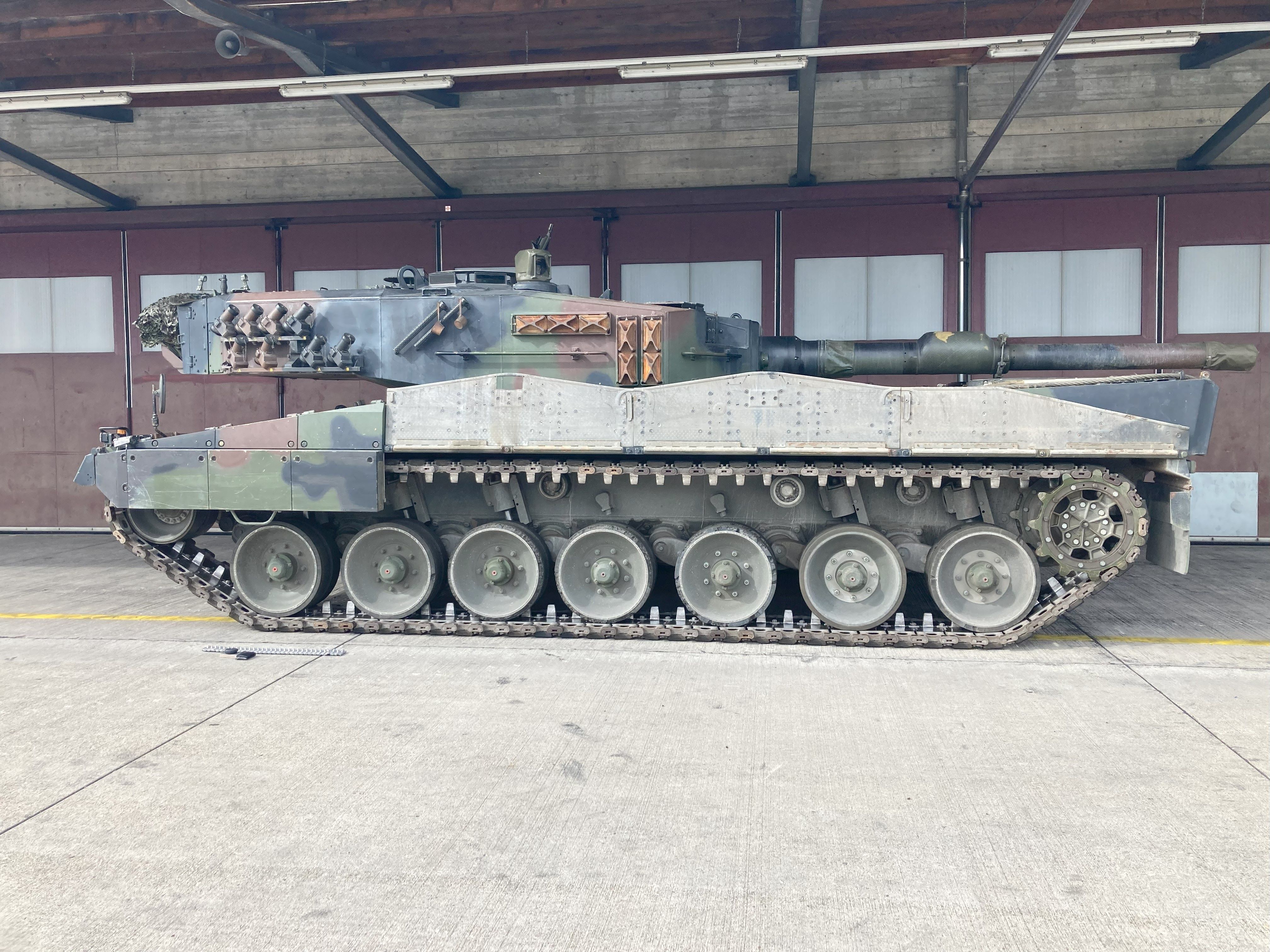

Guys I need some help with info. I can't find clean pictures of Bump Stop B anywhere. in the photos I can see that they are of two types, but in how many and in which places they are, it is difficult to understand.
this is the one
and this is the other one
Andre Meylan
Posts: 162
Joined: Sat Aug 17, 2024 6:02 pm
Location: Olten / Switzerland
Has liked: 787 times
Been liked: 356 times
Re: LEO-2A4
Post by Andre Meylan »
Hi there,
I think these photos could be helpful.
Best regards, Andre
