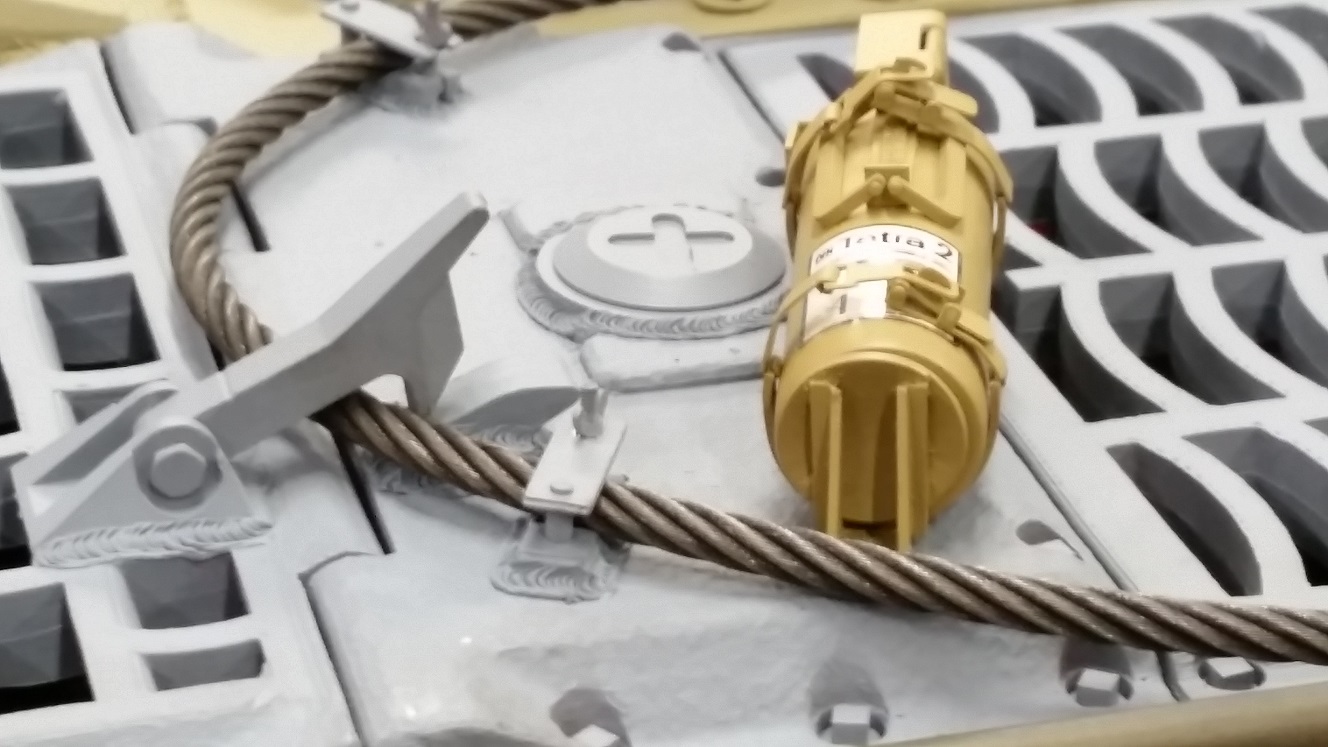

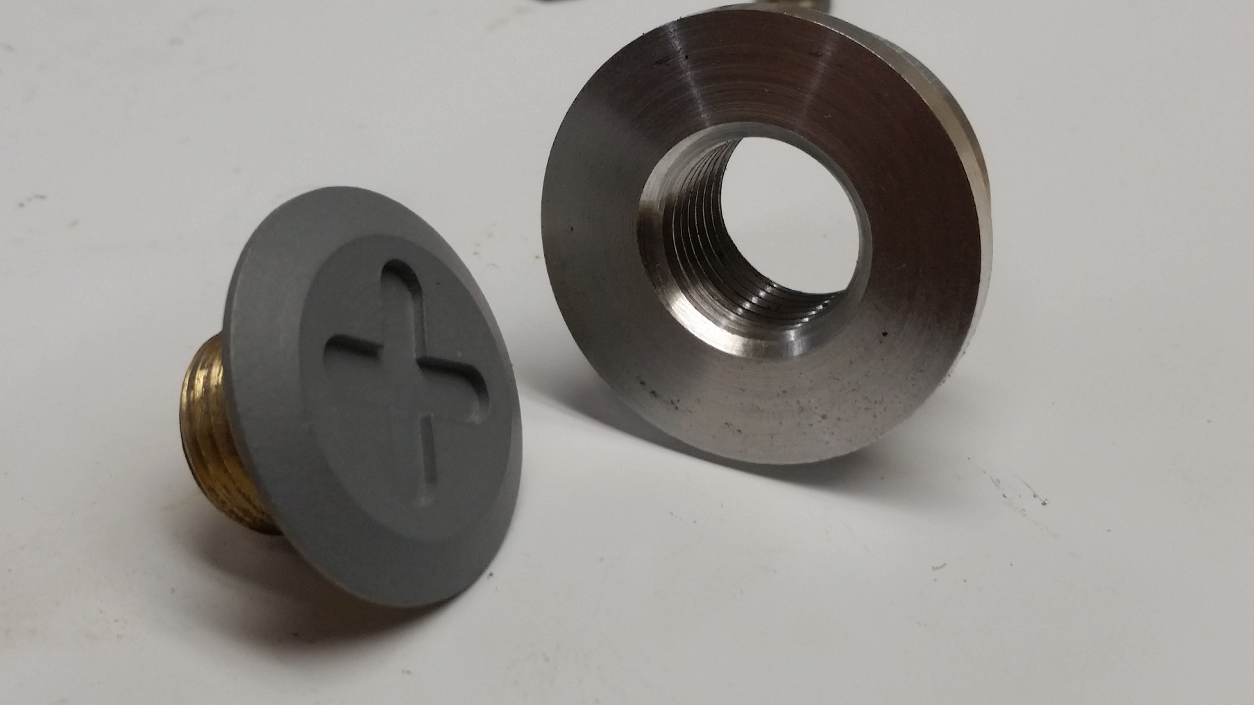

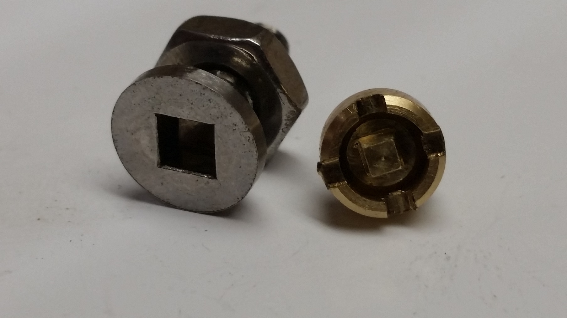

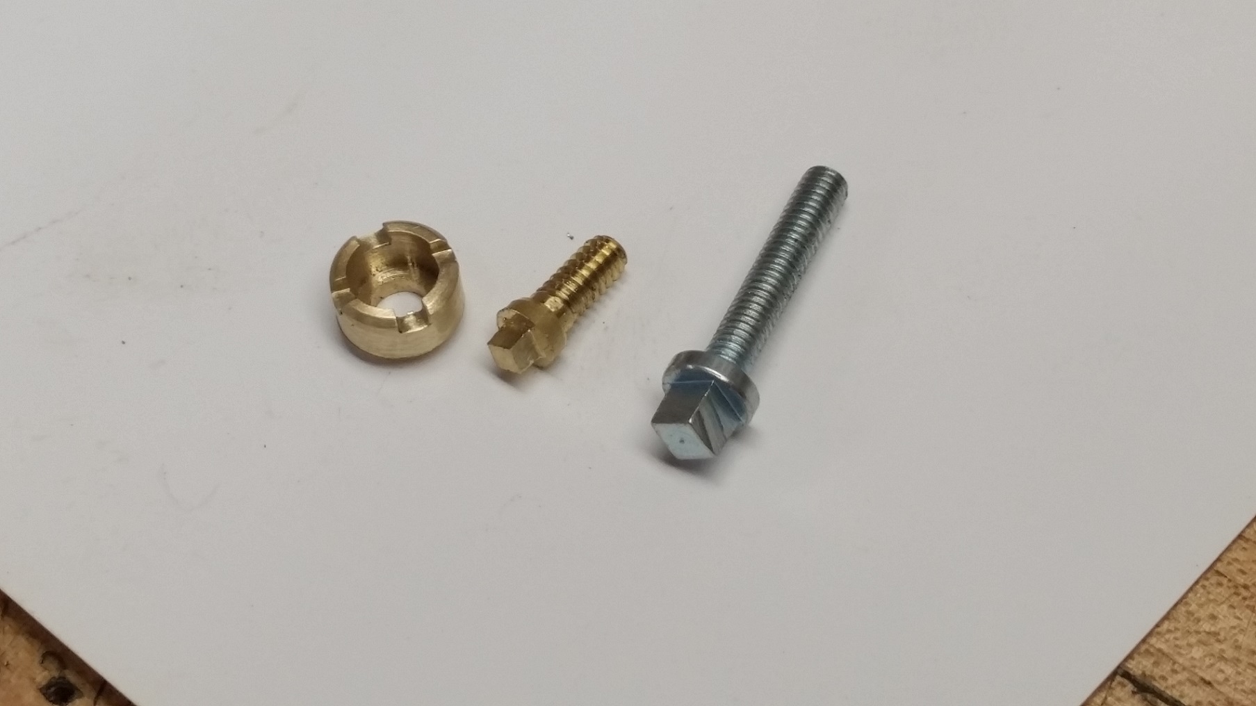

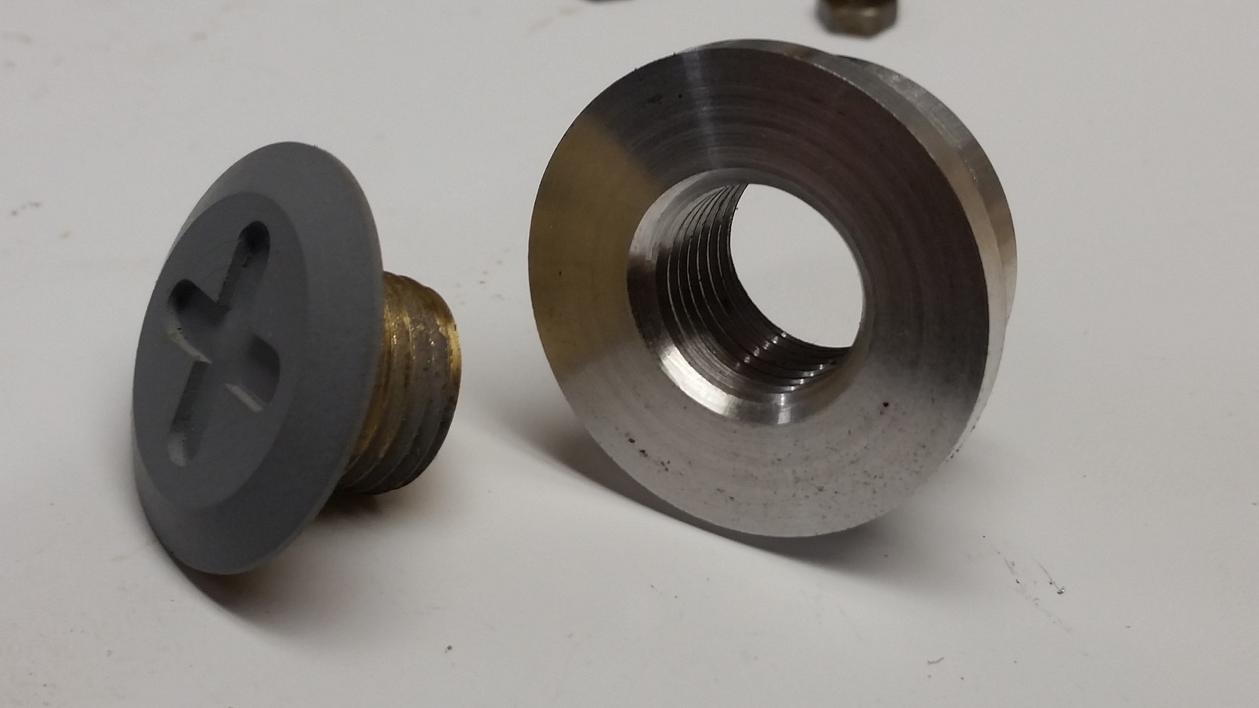

Took a short break...started working on grills and engine hatch..little details 1st...made armored fuel cap covers and engine hatch locks..

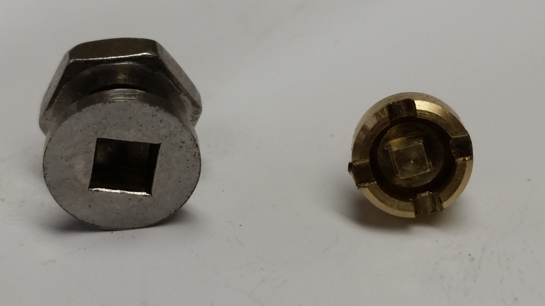

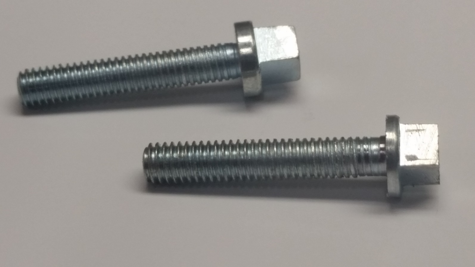

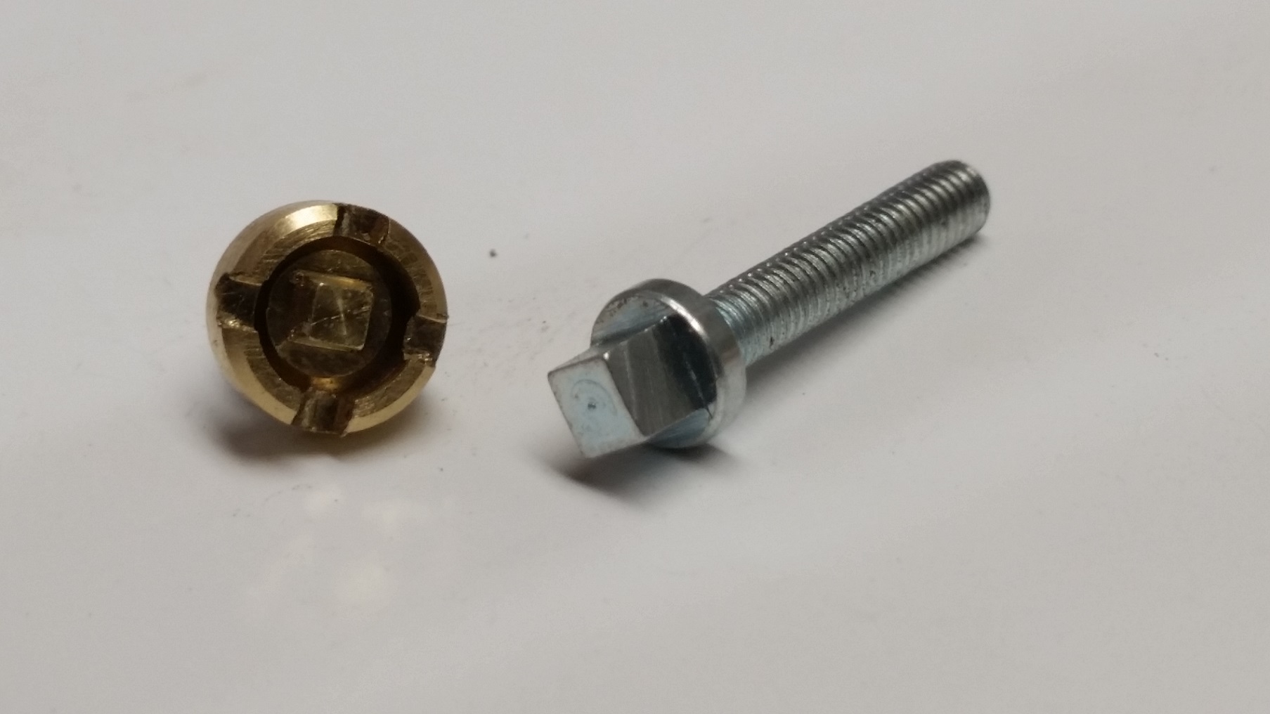

Decided to machine down supplied square head bolts to help recess as much as possible...was able to shave 3/64 off....cutting down on the shoulder and the head......every little bit helps
Has liked: 794 times
Re: Tiger build
That's a great idea to make those brass engine hatch locks in two pieces.

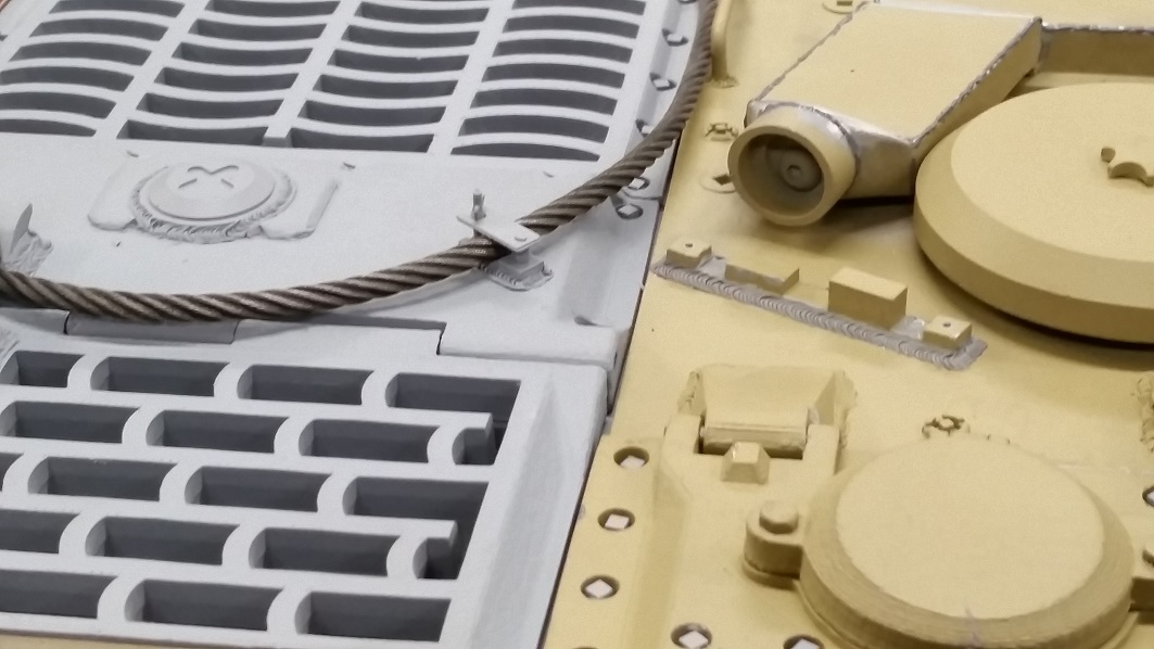

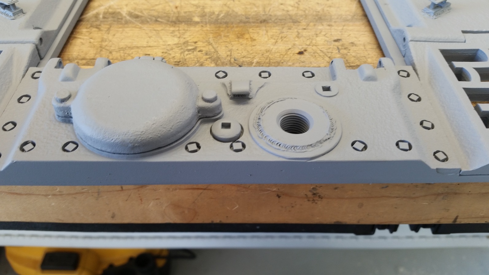

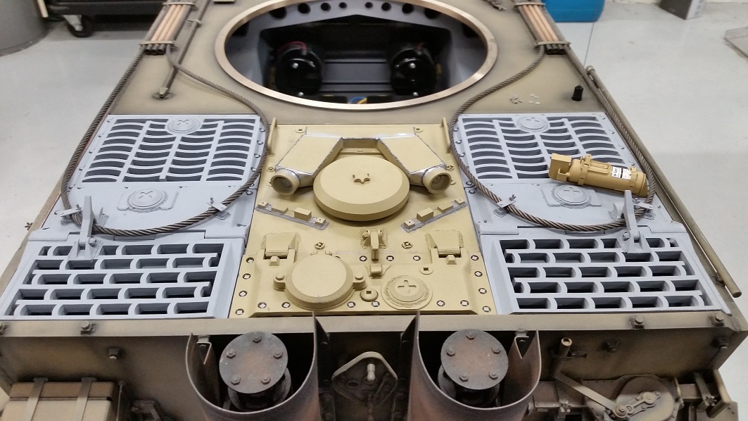

Progress had been slow and sporadic due to a bad shoulder (rotator cuff tear)... some pics of rear deck details

Reworked welds around armored fuel caps...much closer to scale now

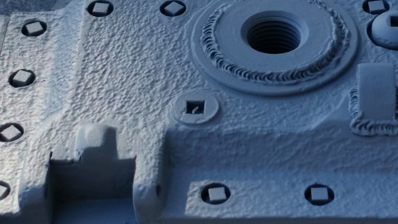

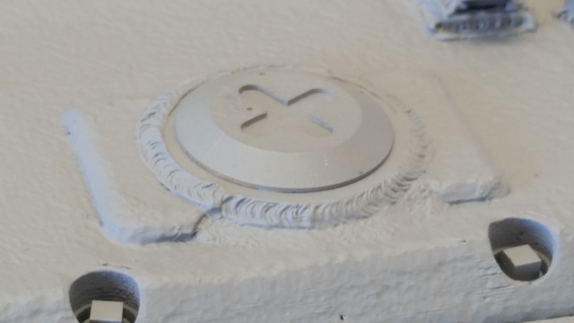

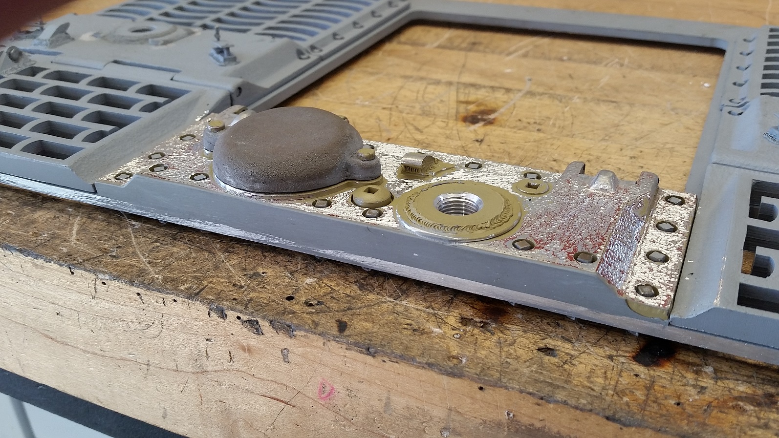

Textured white metal castings and snorkel base cap by stippling to look more like cast..filled in back of center casting

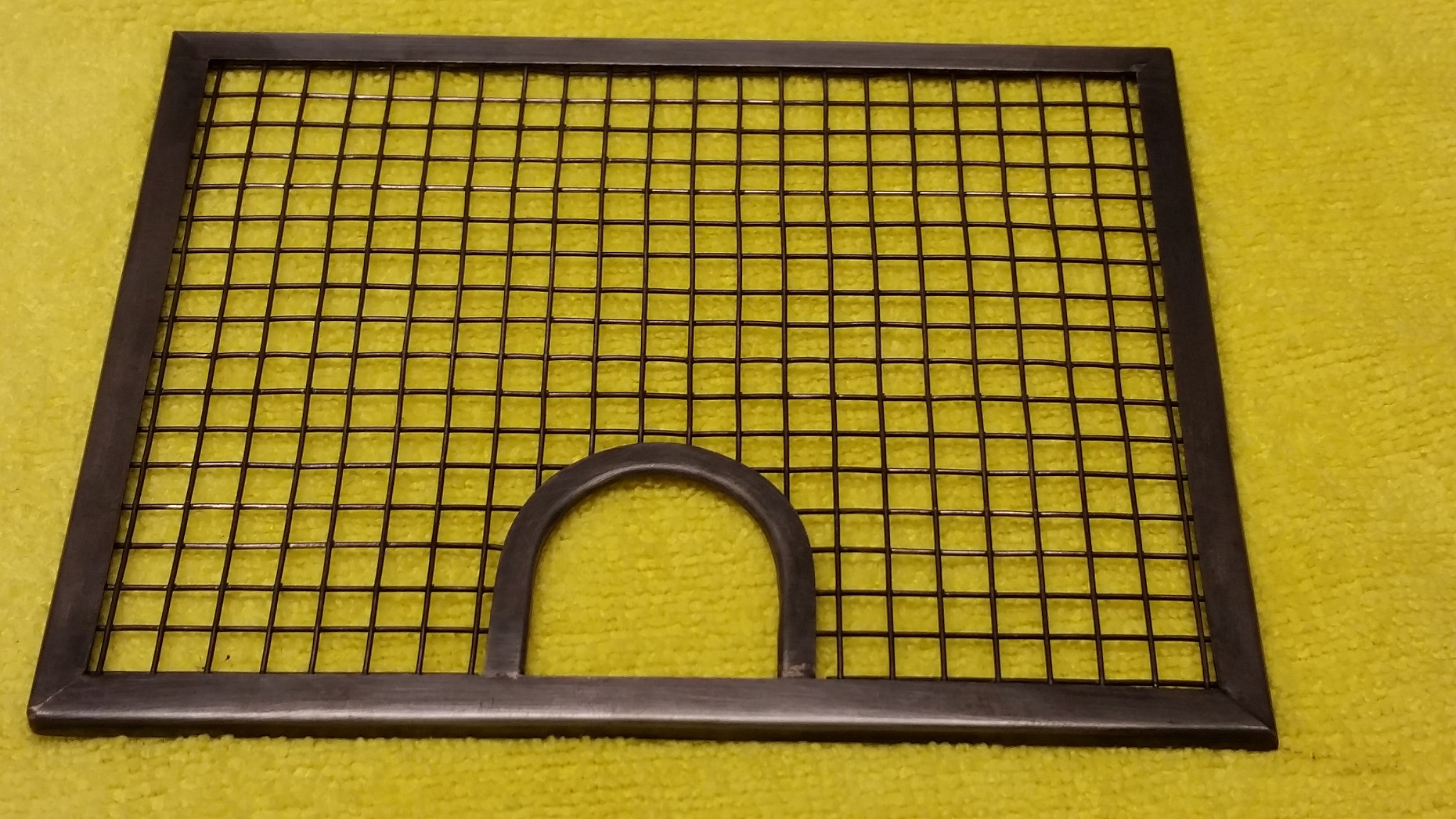

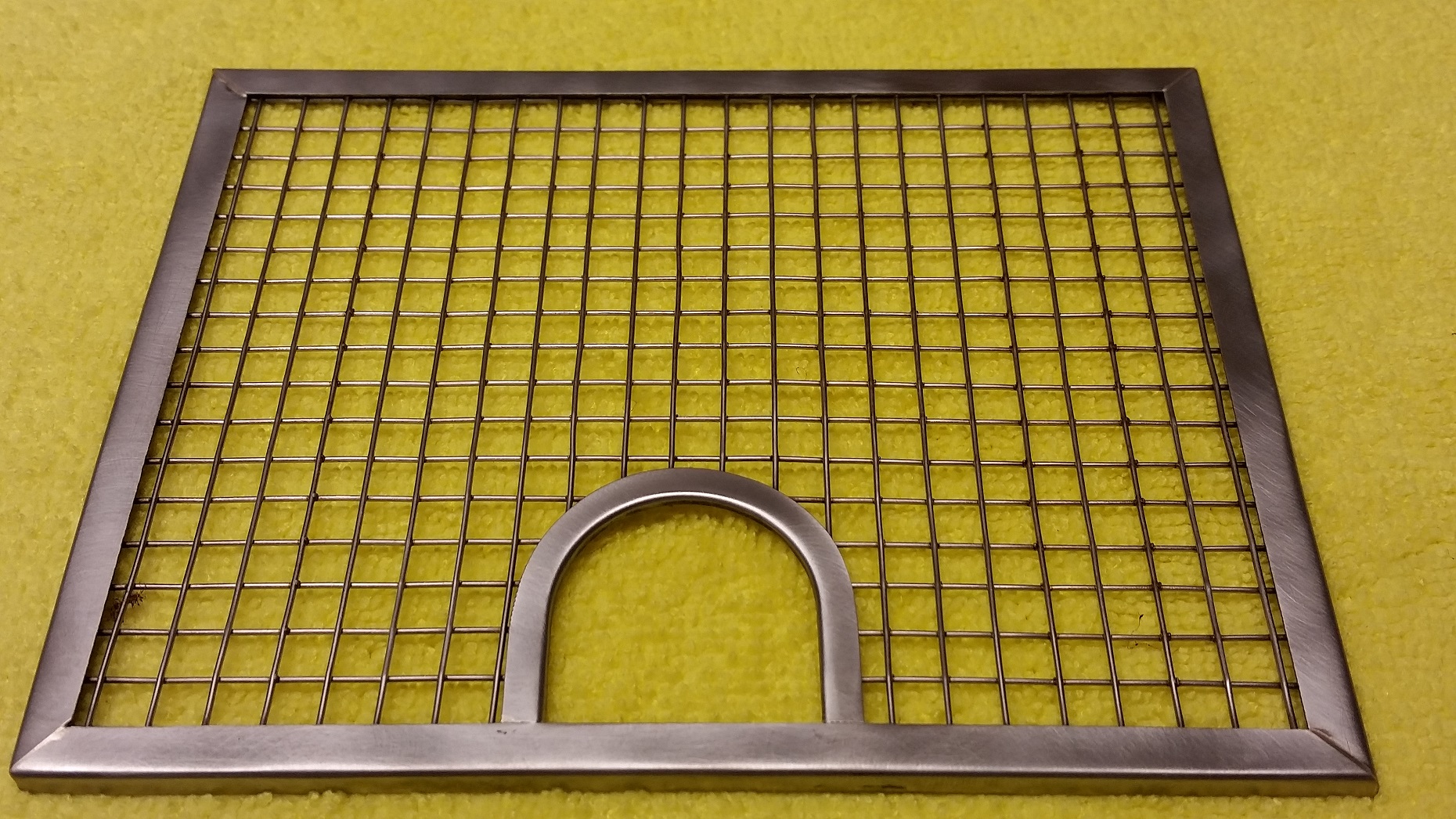

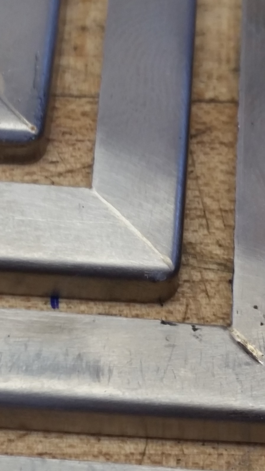

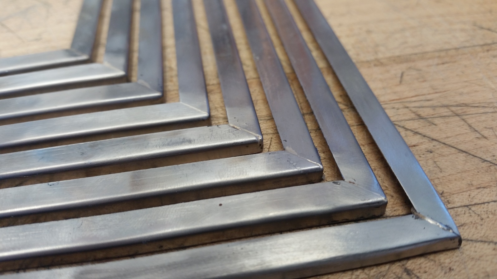

Started engine deck grate screens using .030 stainless steel hard soldered

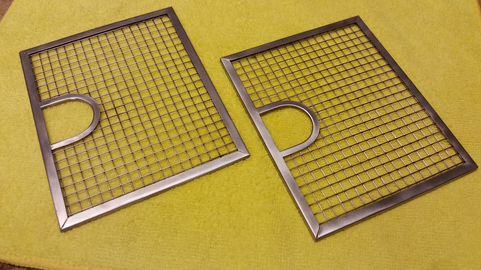

Made up engine grate screen covers out of stainless....

Before and after using blackening treatment
