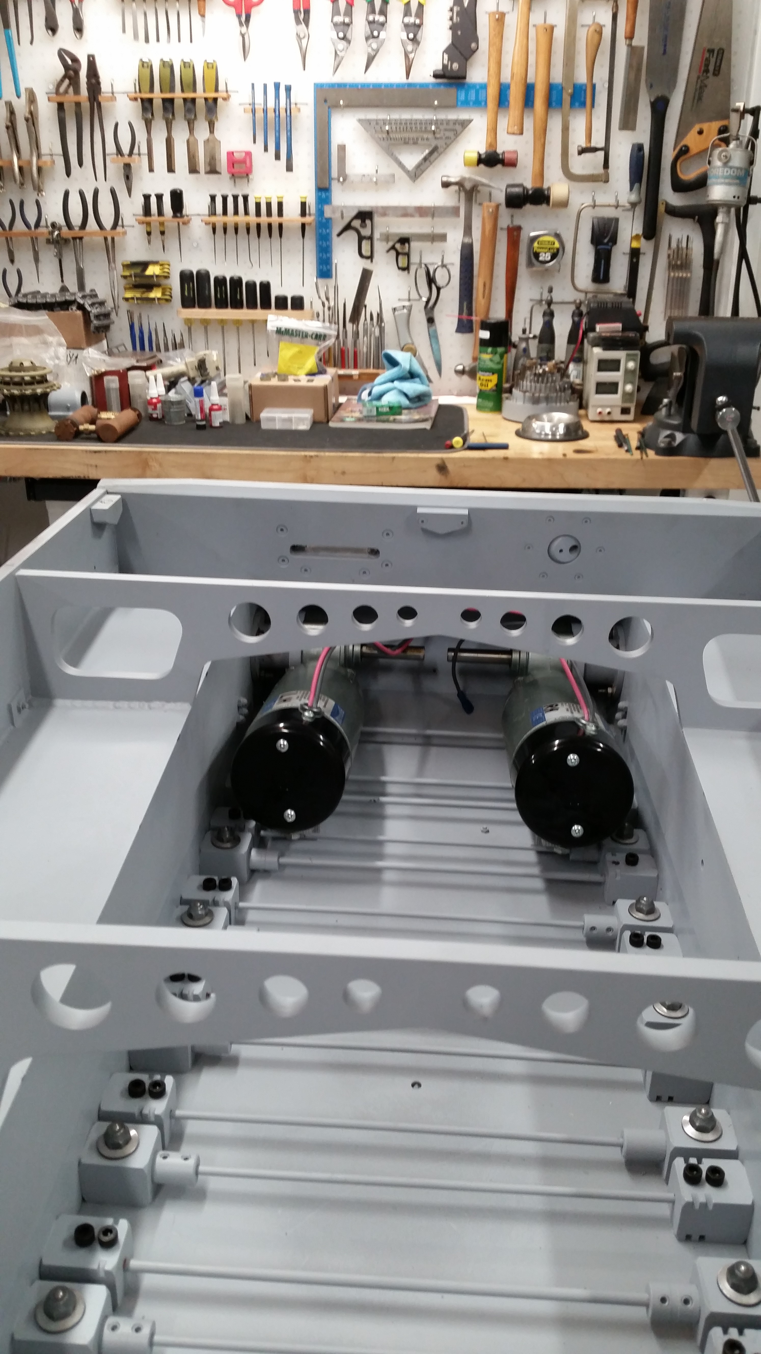

Hi ! my name is Mark. I am living in SW Florida...started working again on my 1st gen tiger after a 13 yr break !...An accident that left me paralyzed and wheelchair bound, grand kids and a divorce delayed my build but I am now back to building again !...I also have a Flak 88 sitting in a box unstarted that will be next after I finish the tiger

Electronics...and my old trusted JR10X

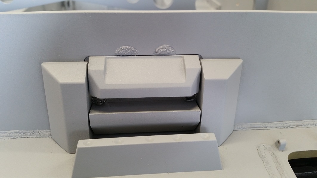

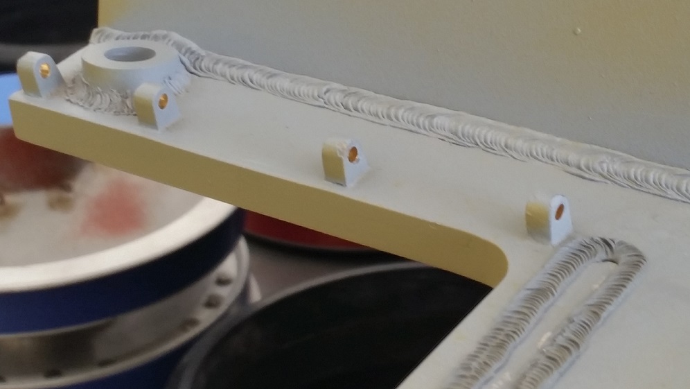

Was dreading using epoxy putty to make the simulated welds along the pannier gussets, instead I used an epoxy glue I've used for many yrs building rc jets ...stuff stays where you put it ! just ran a little bead and waited for it to start hardening ...couple of hrs as it is a slow cure...hit it with a texture tool and was done..quick and easy..results are satisfactory

Same adhesive used above drivers armor...

Those are perfect welds. I'm going to have to rip my milliput out and use the loctite. What tool did you use?
