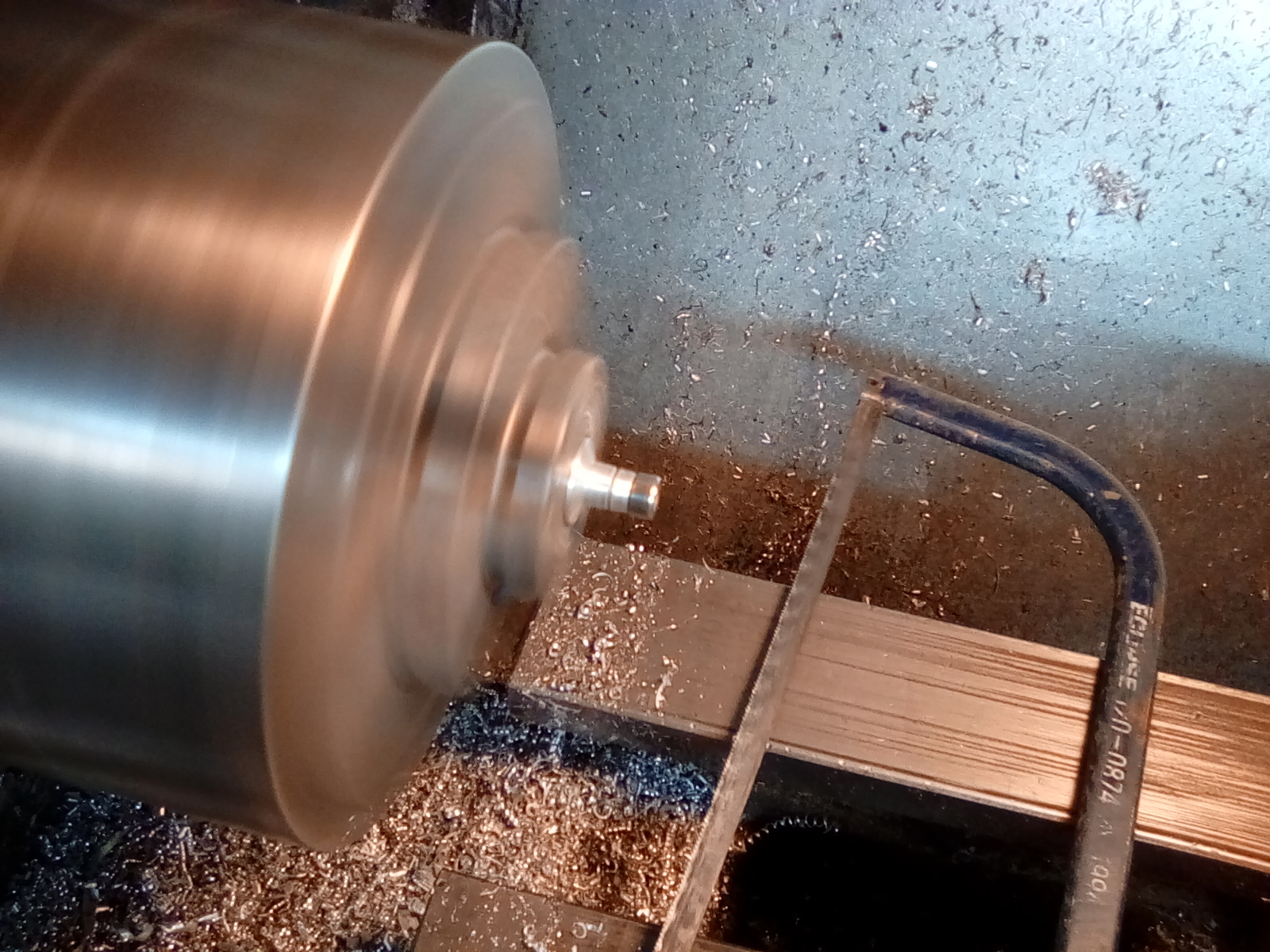

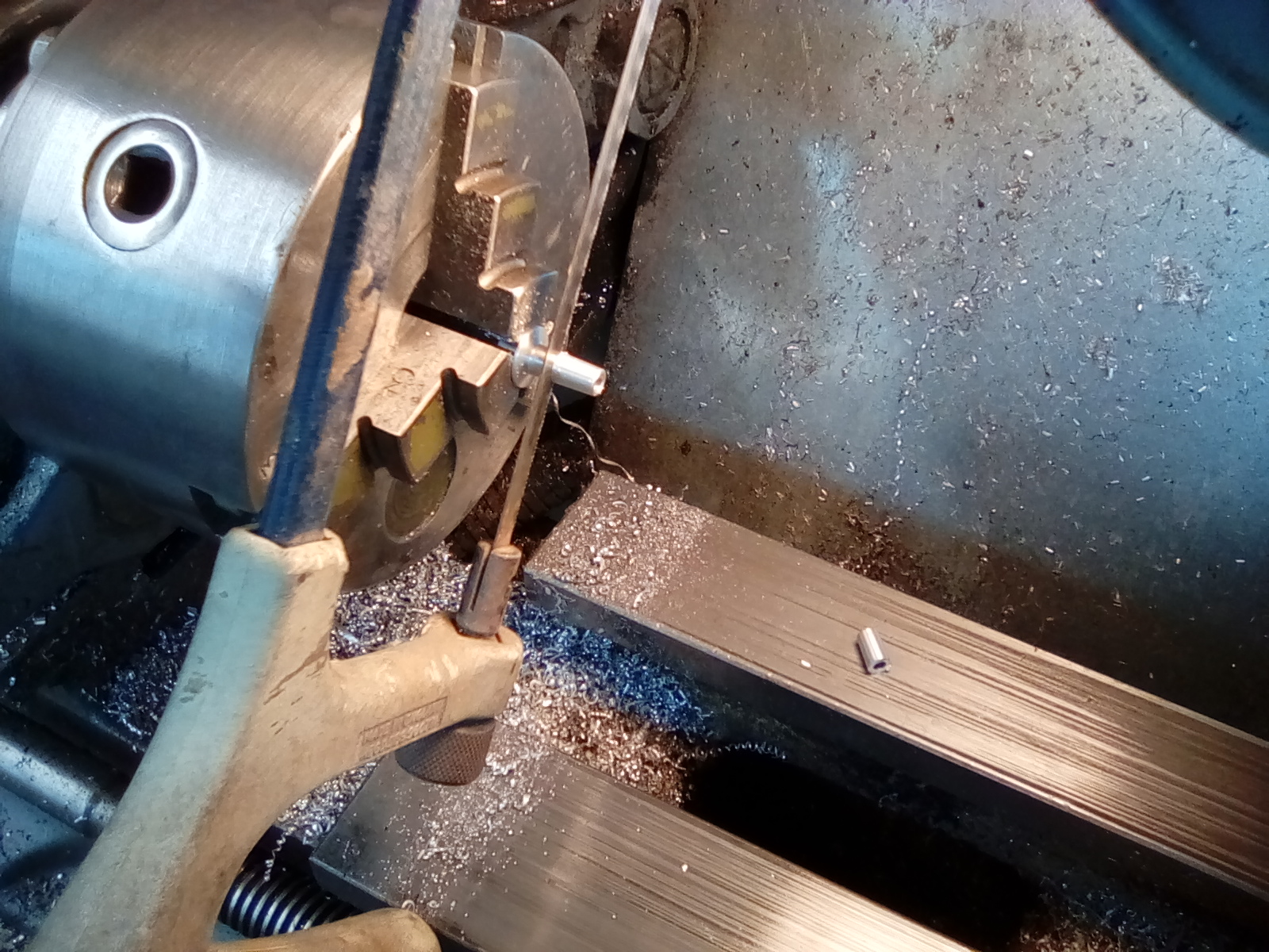

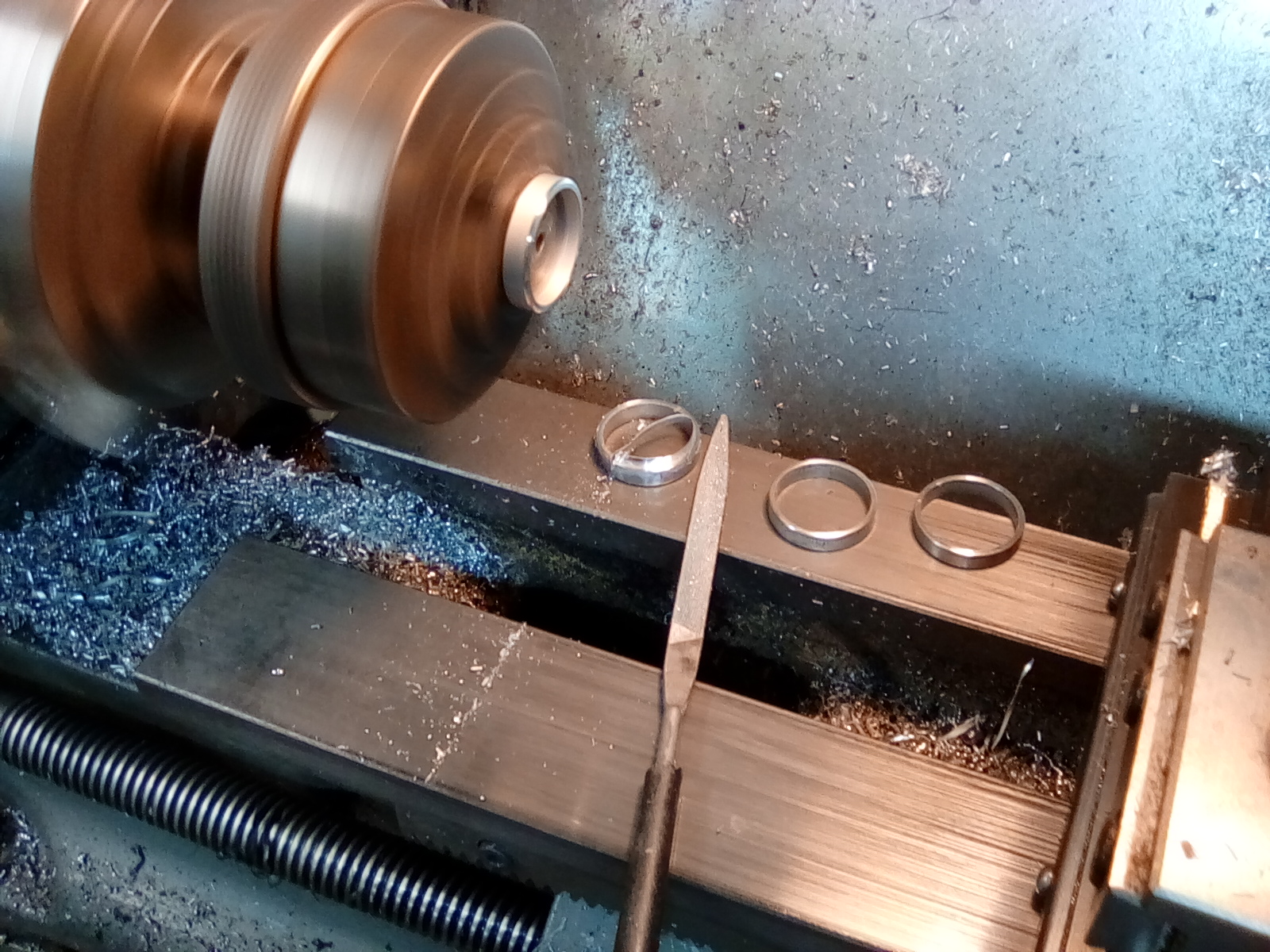

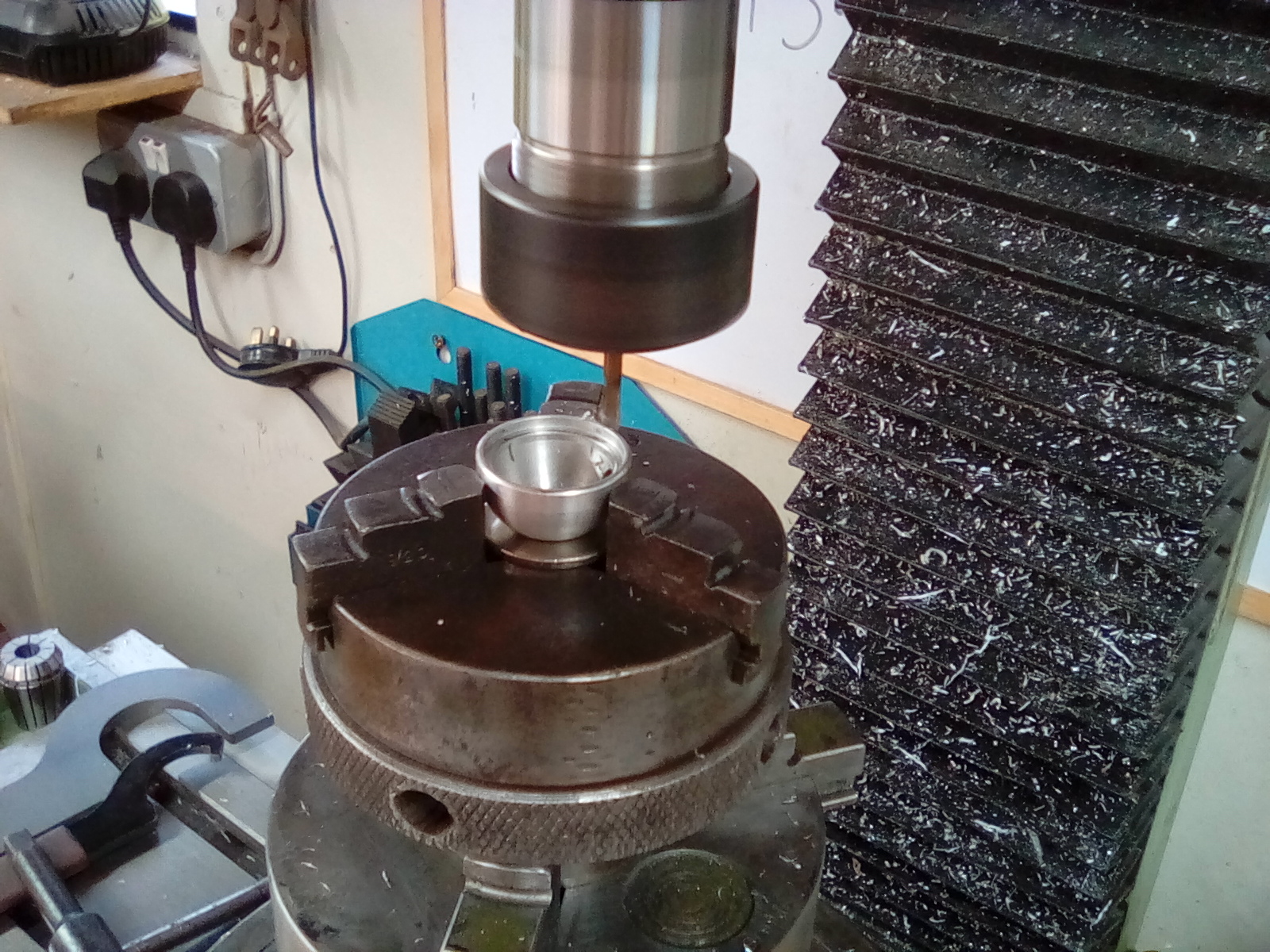

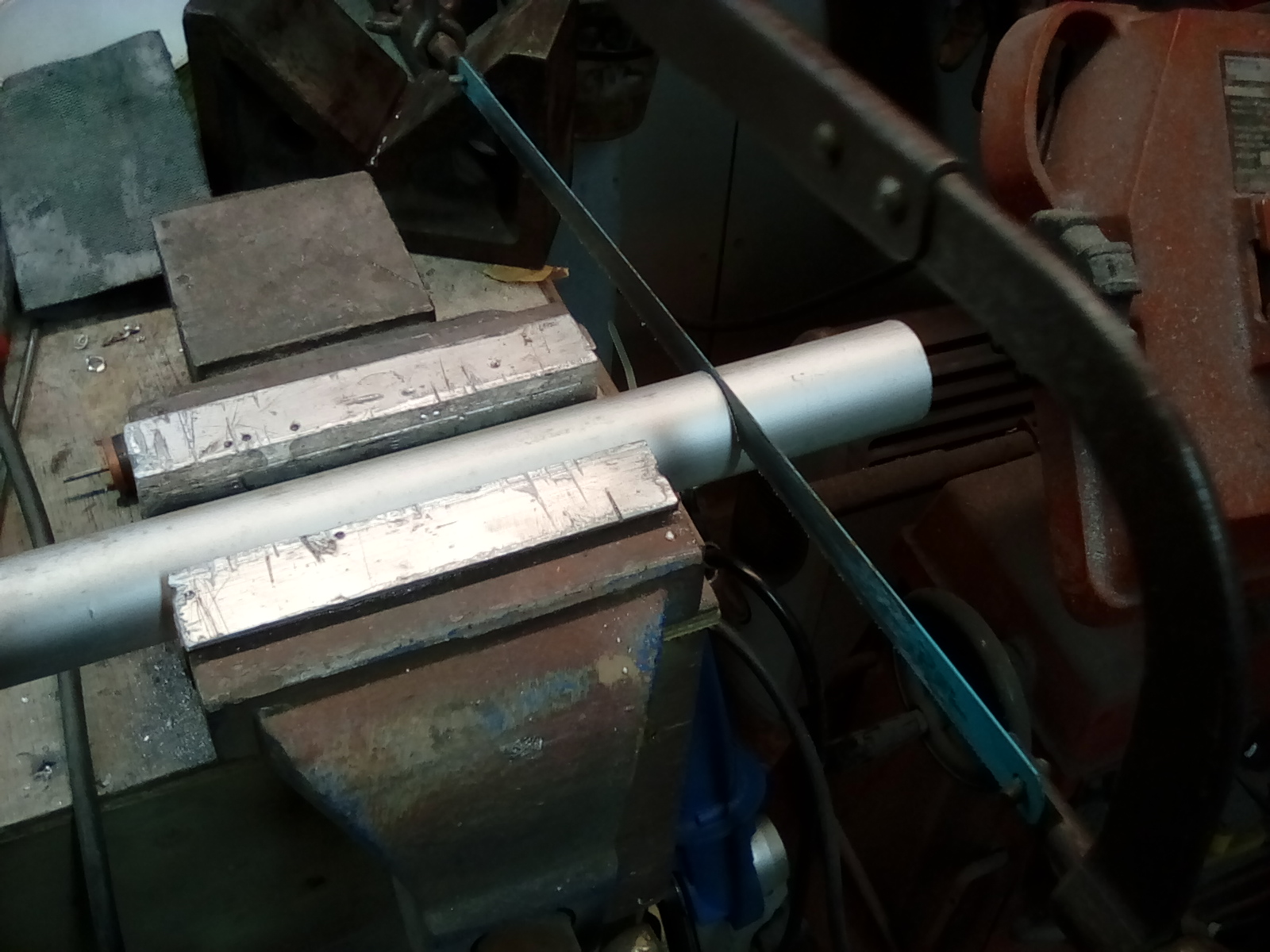

Parting off very carefully

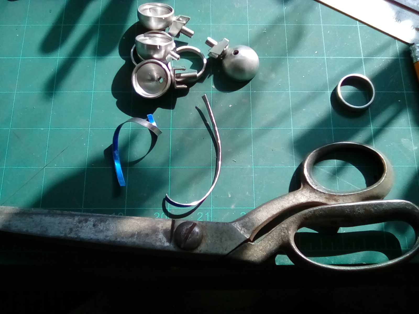

Polishing the bezels

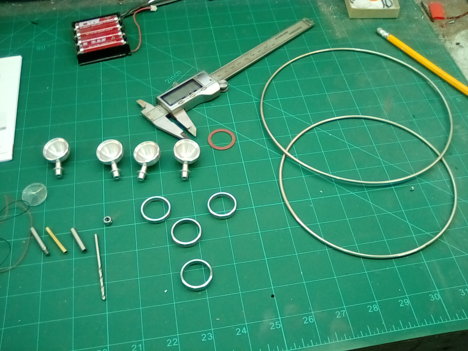

A small piece of stock used for the headlight bezels
These stock parts are not far off but do need that big bezel

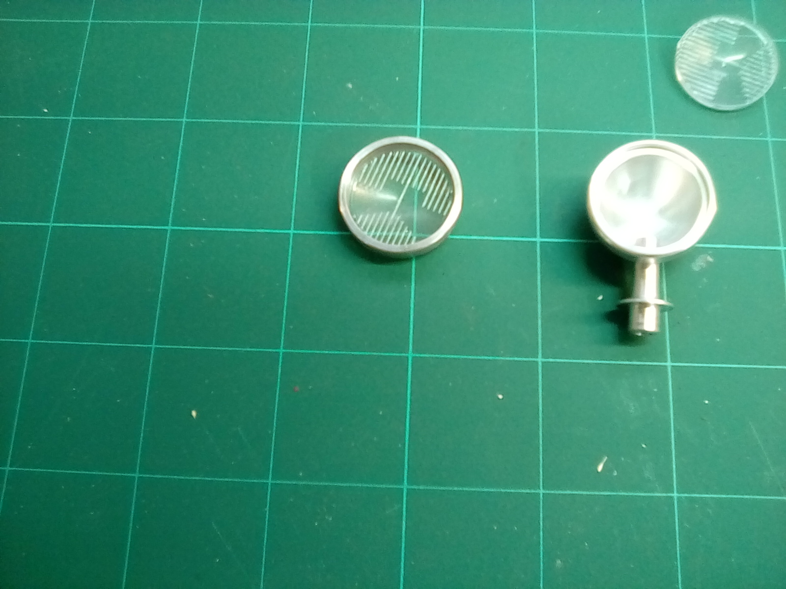

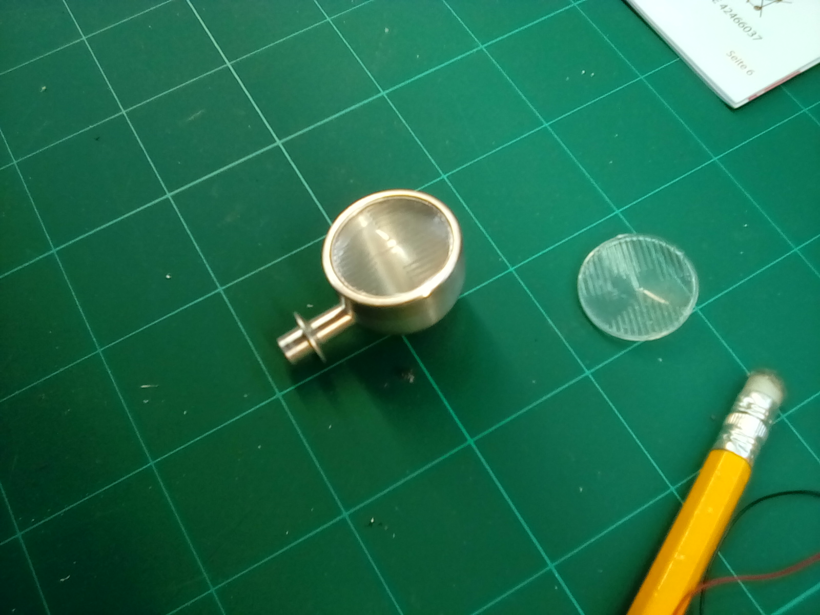

I can't believe the lenses fit perfectly with just a little fetling

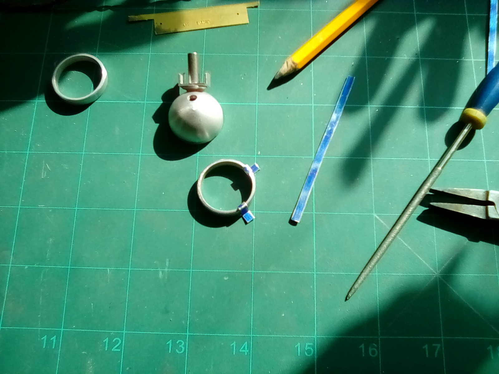

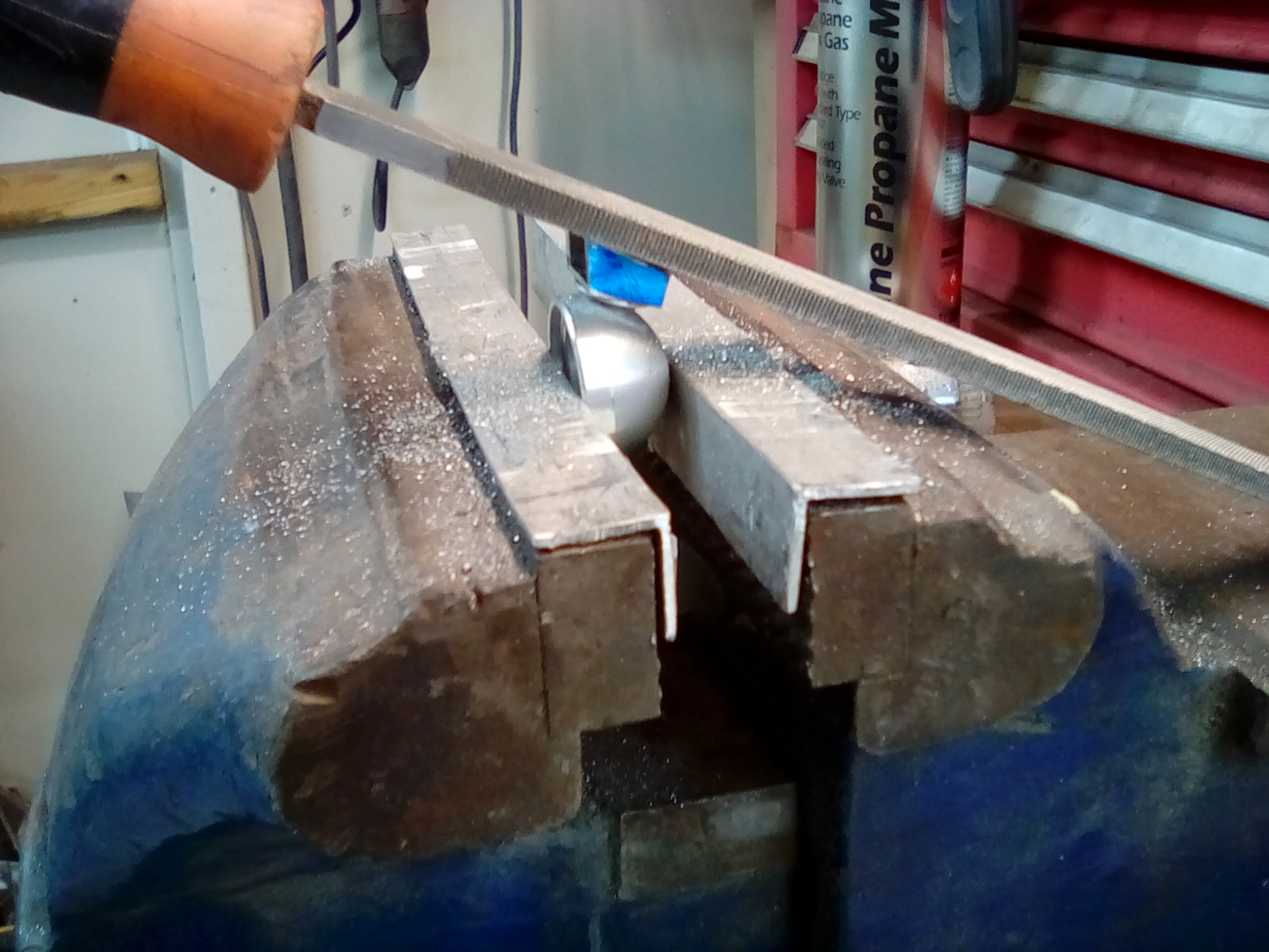

Using a needle file to profile the bezels
That's four bezels made, the brackets for those will be tricky

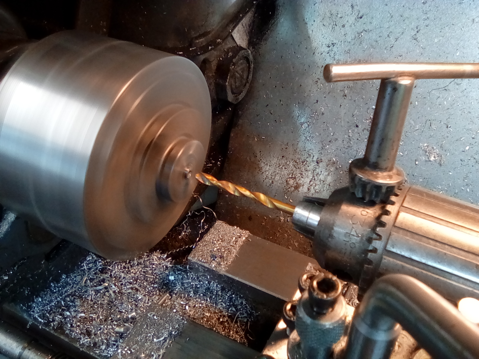

Opening up the winky pot post to take the wires

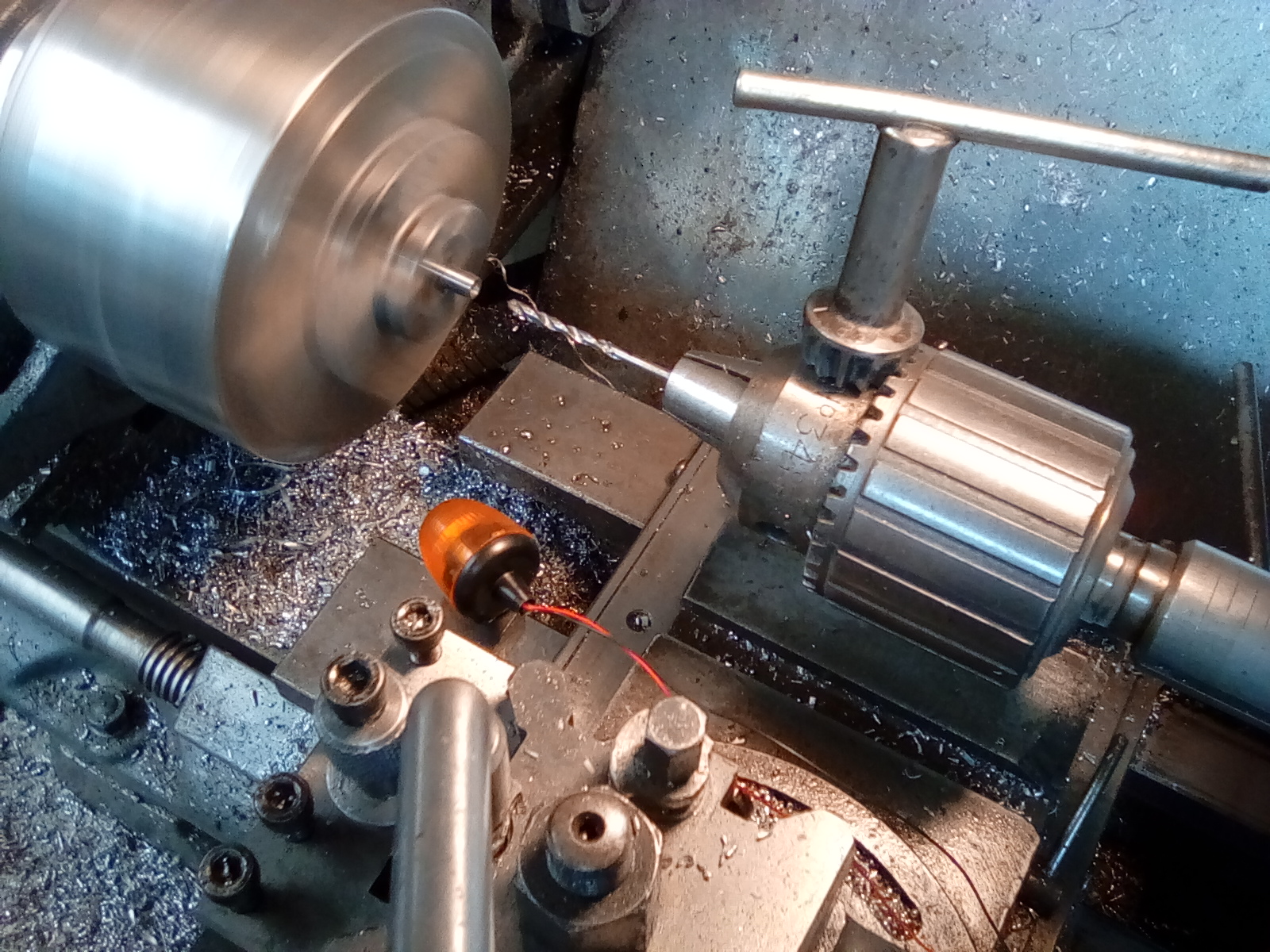

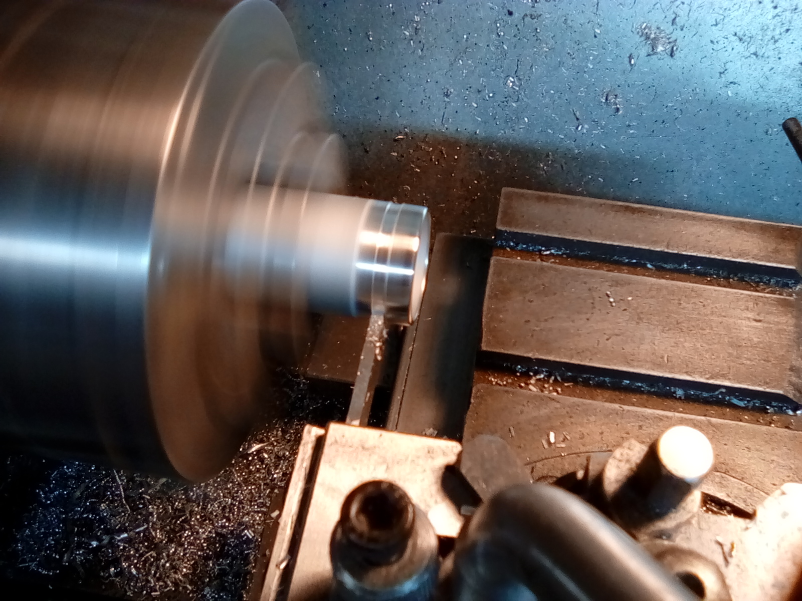

Turning down the head light post
I want to use the post headlight bowl mounting to keep things nice and strong but incorporate the u channel bracket as well, the post will not really be seen

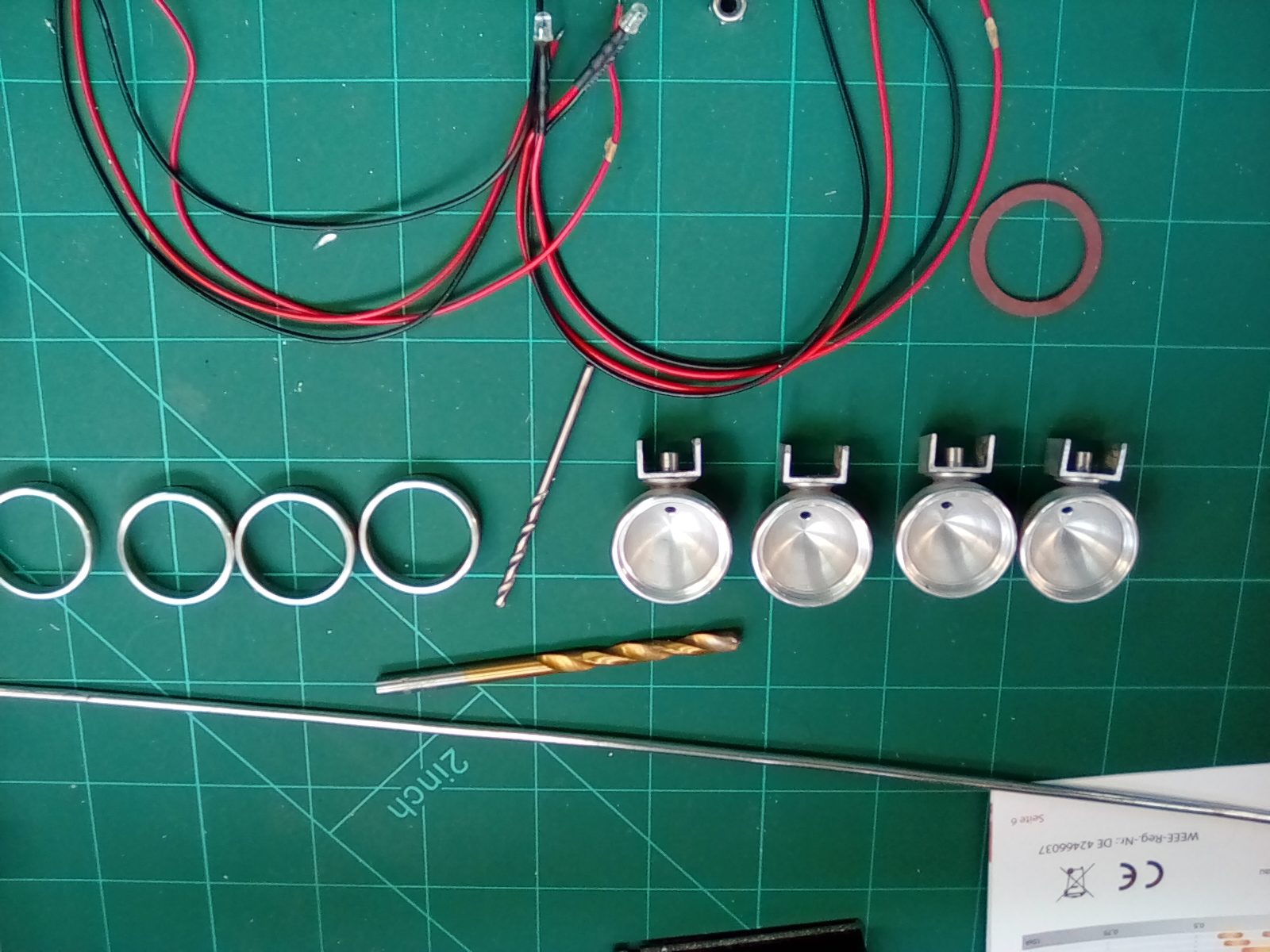

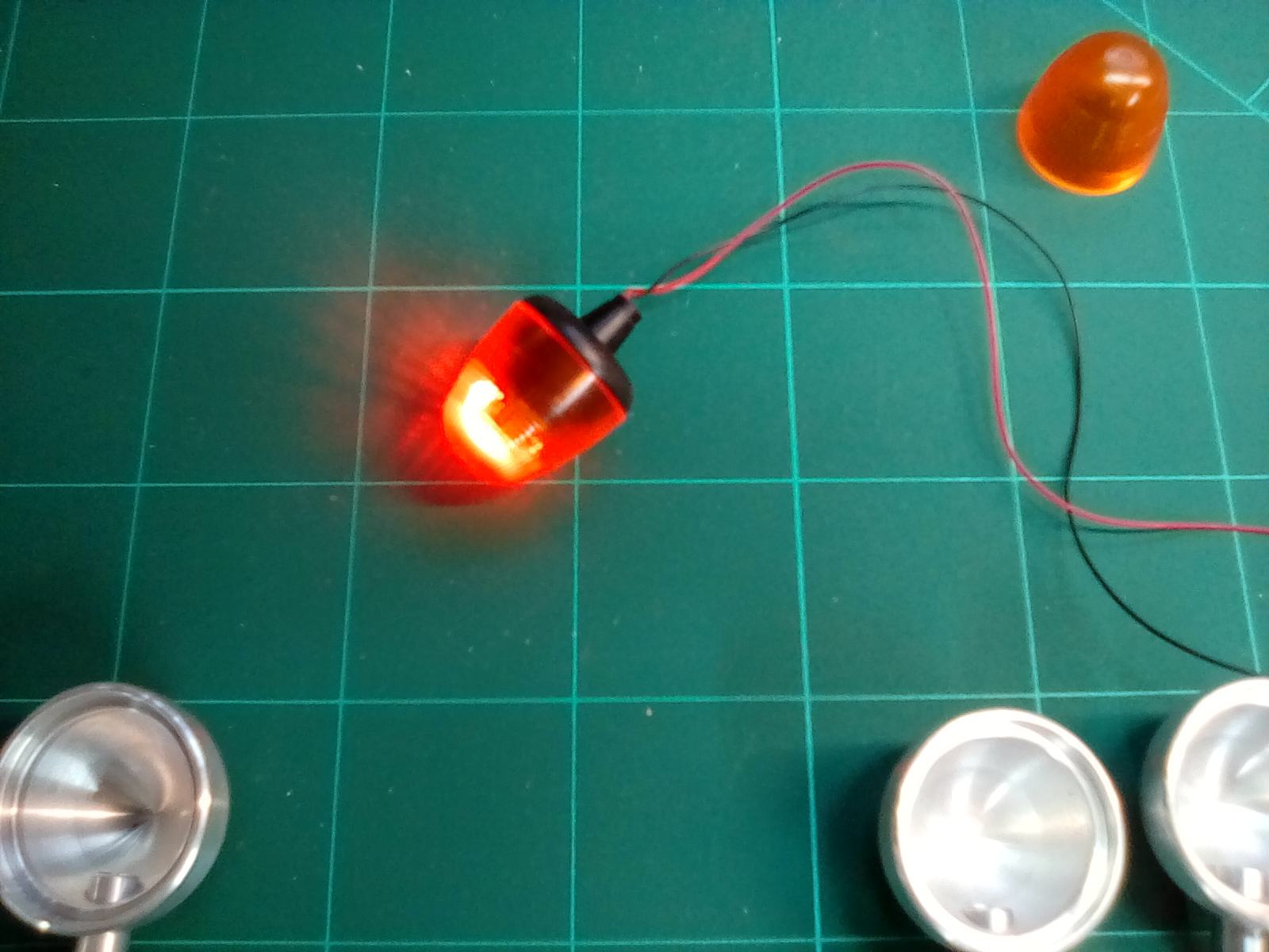

Moving on with the driving lamps
Not really necessary but I'm going to use red leds for the outer lamps in addition to the ir glass effect
So many tiny pieces
So many tiny pieces

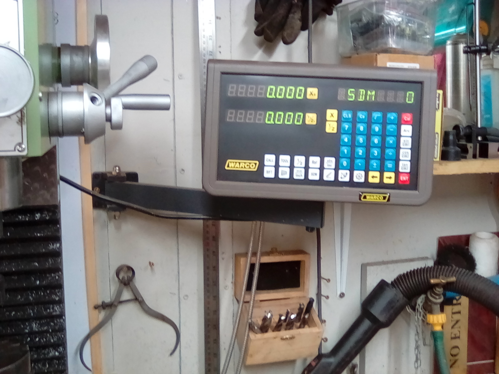

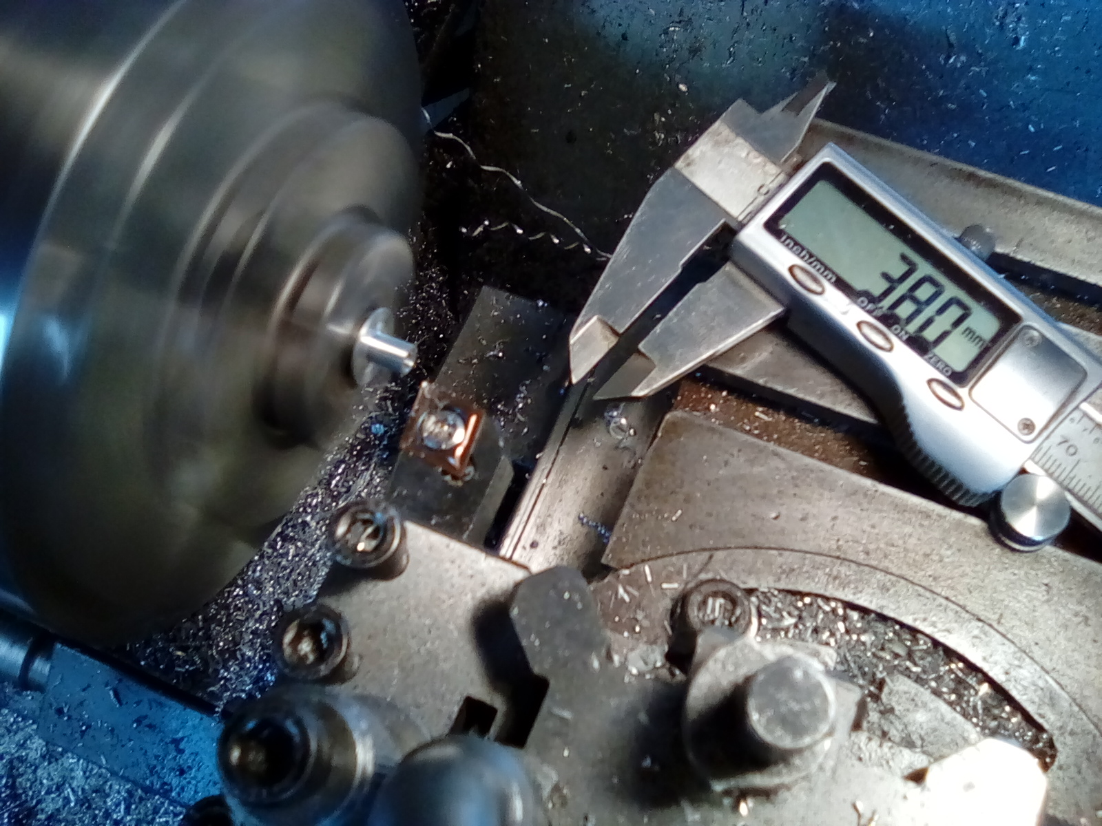

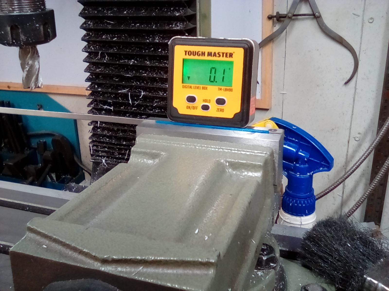

This digital gauge is so useful

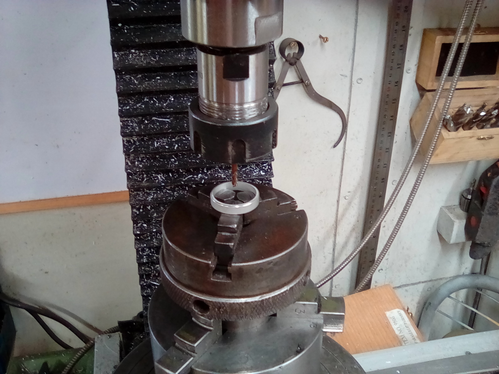

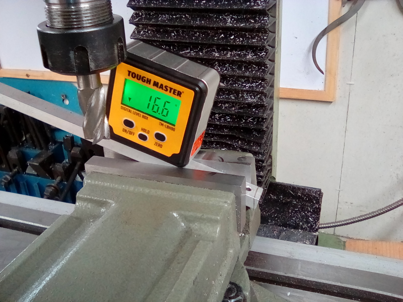

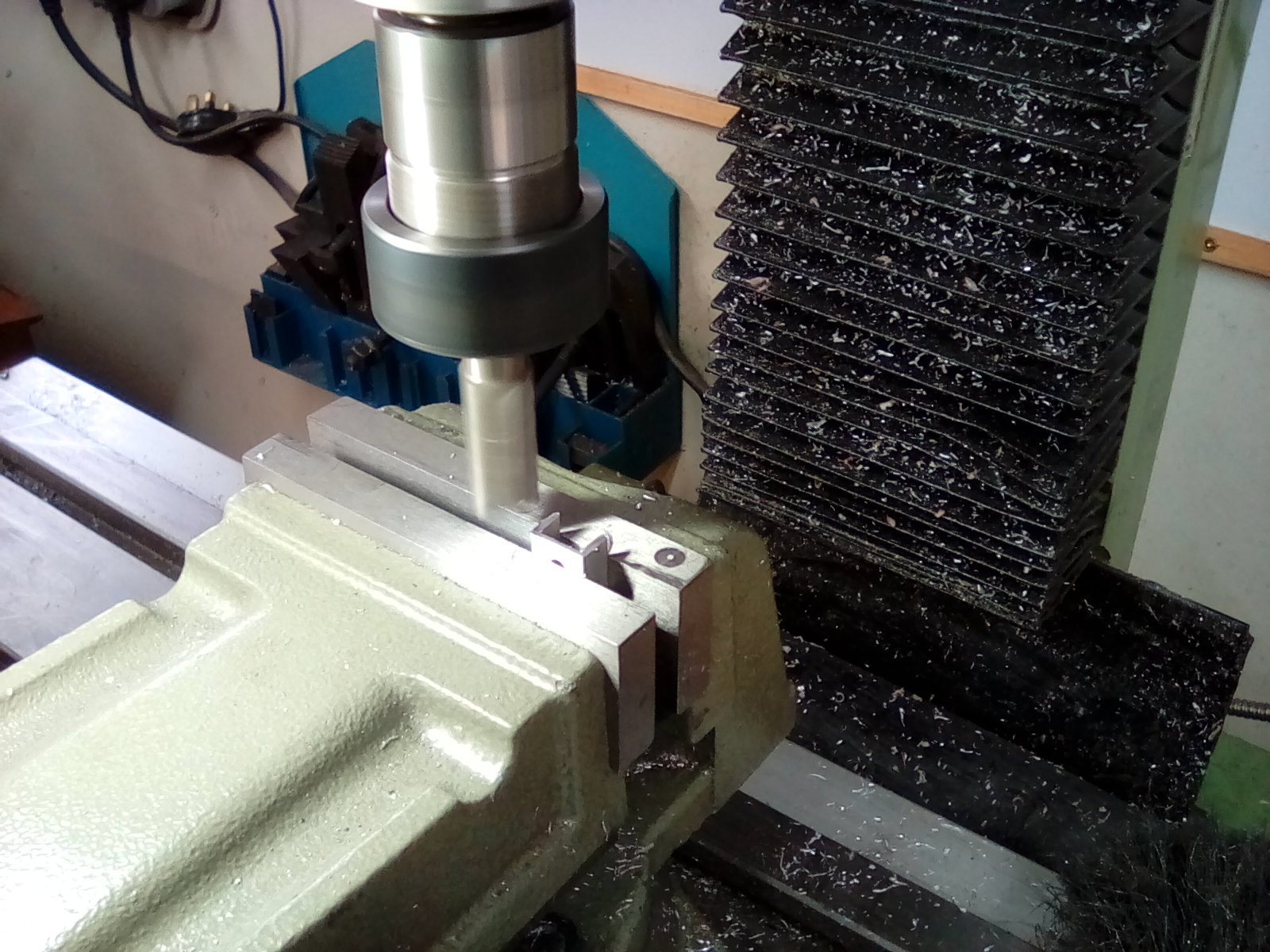

Milling of course
Milling of course
A little production line
Angles to match the front plate

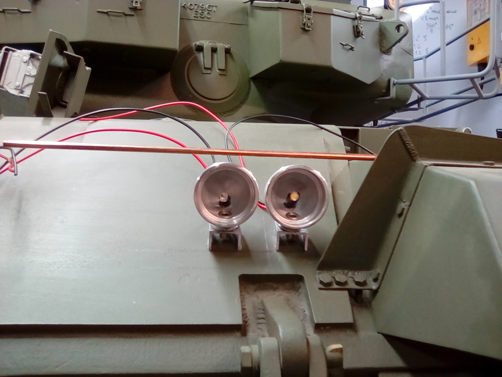

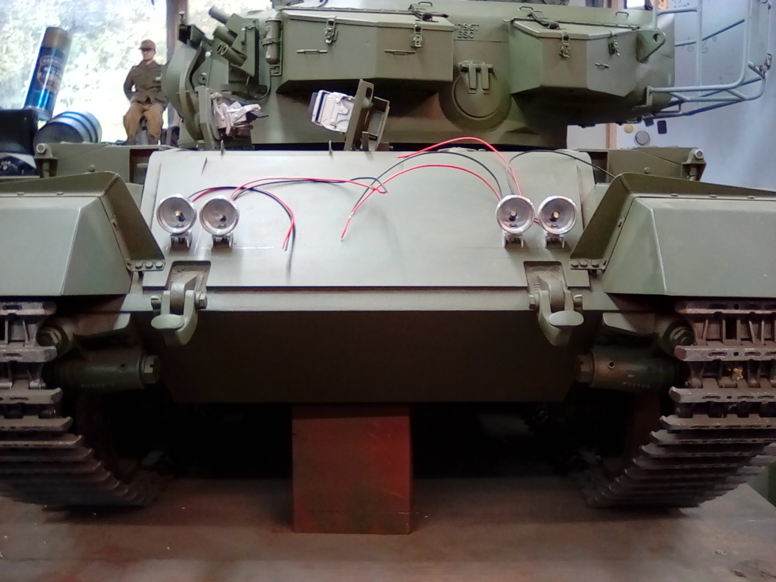

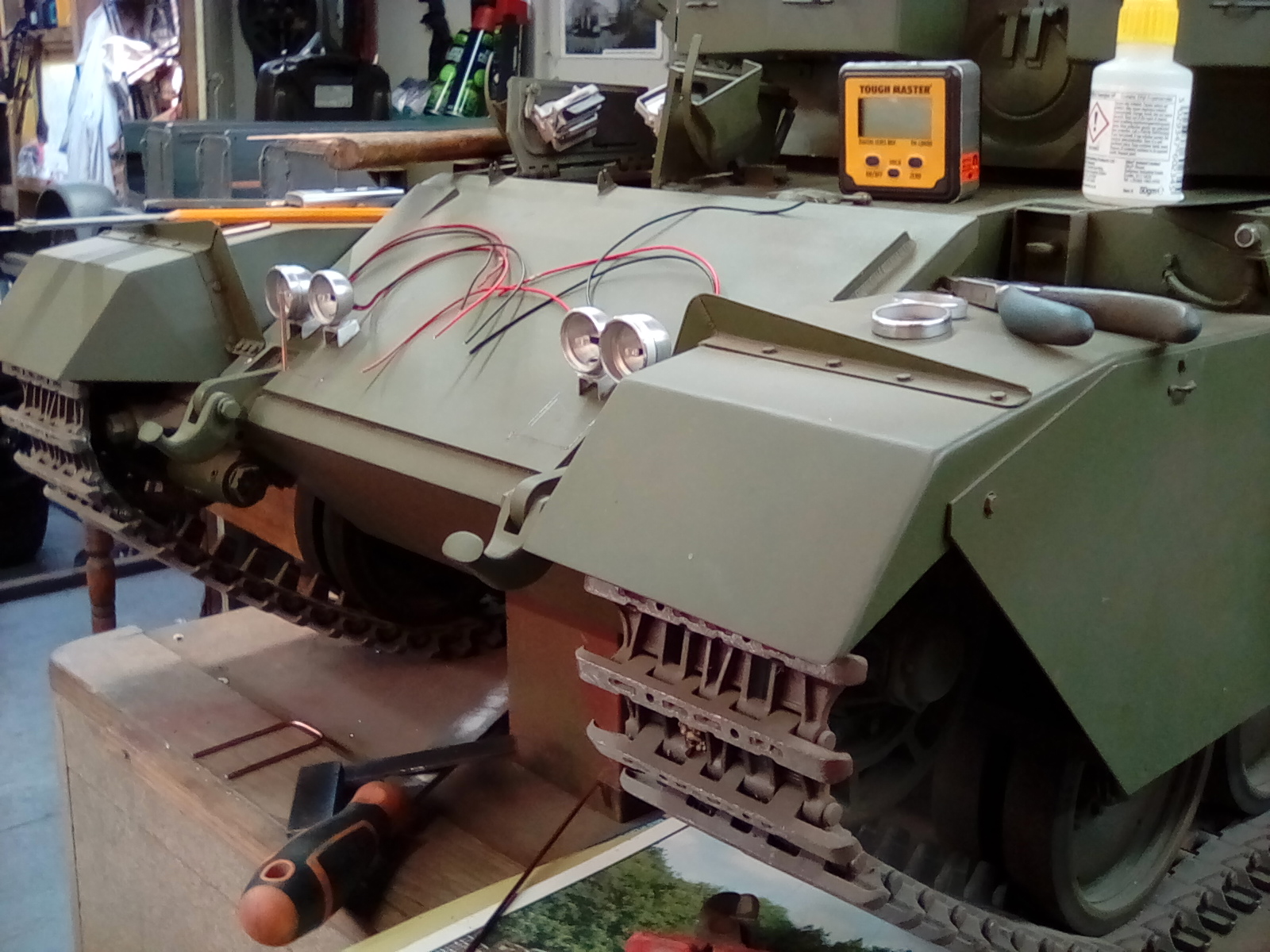

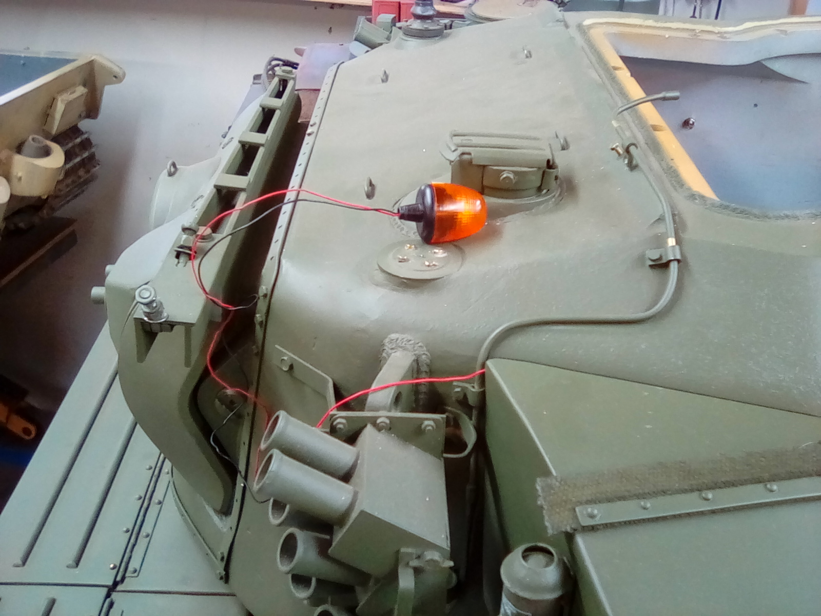

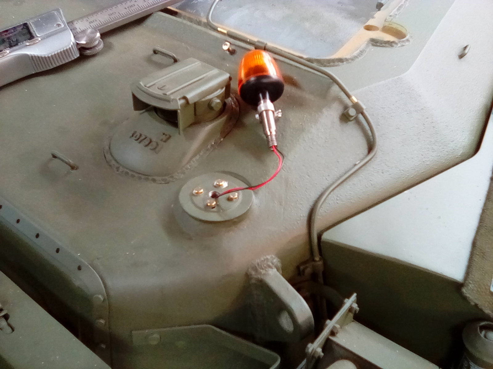

Don't get too excited, the lamps are just tacked in place to have a " look see "
This will not be the final position I'm sure, what do you think of the piece of steel for for for the lamp guard surrounds Phil? The diameter is just a gnats tadger under 3 mm.

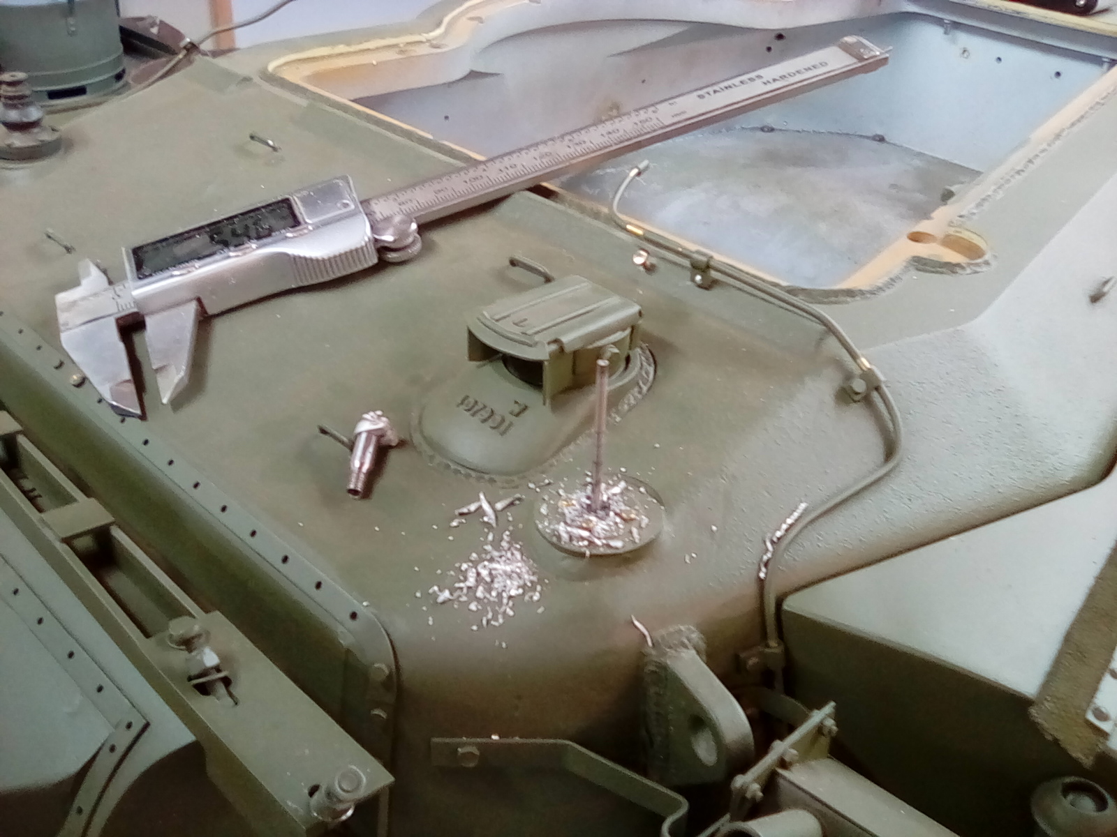

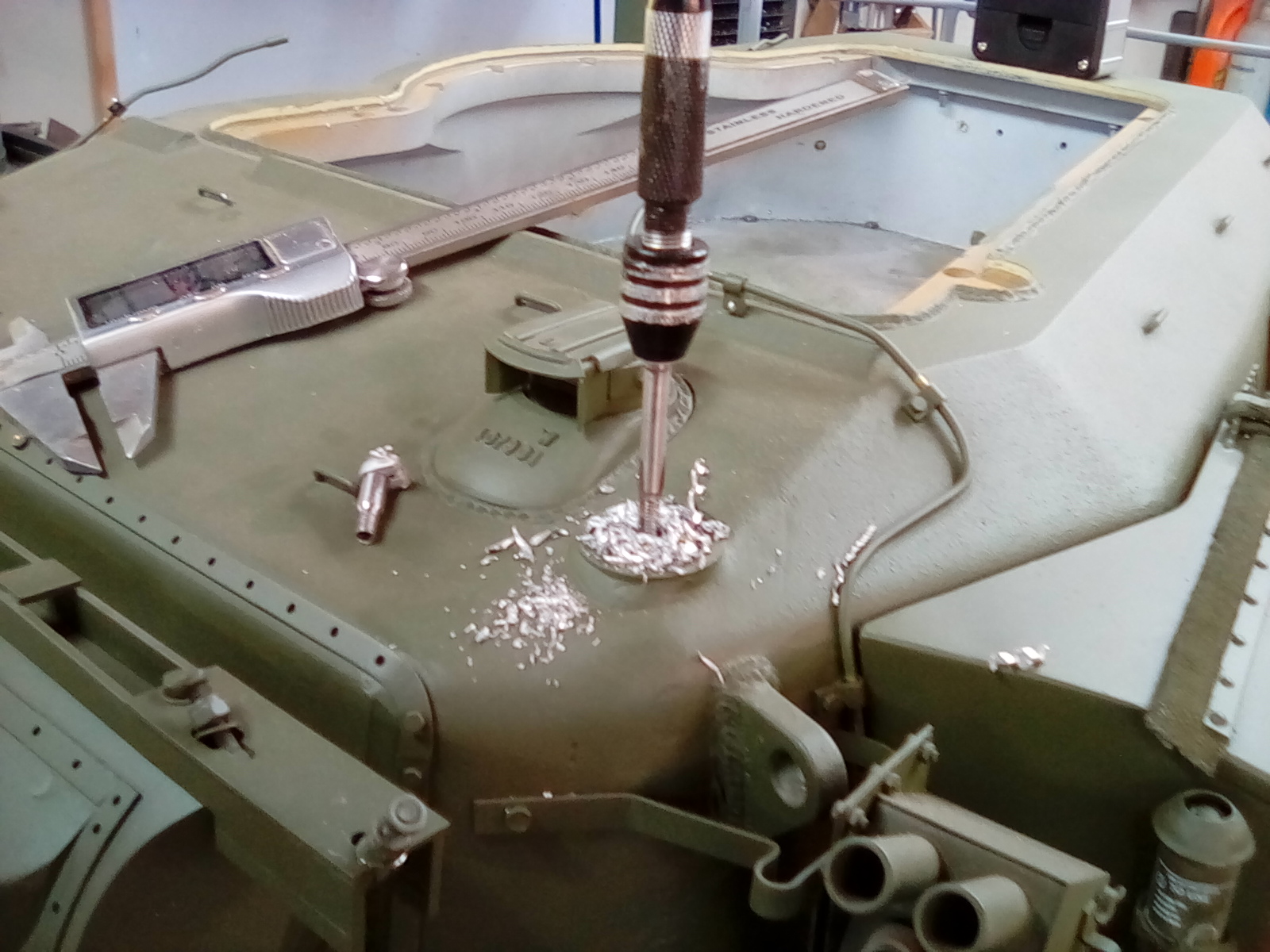

Letting the post into the light body stalk
The correct length
The correct length

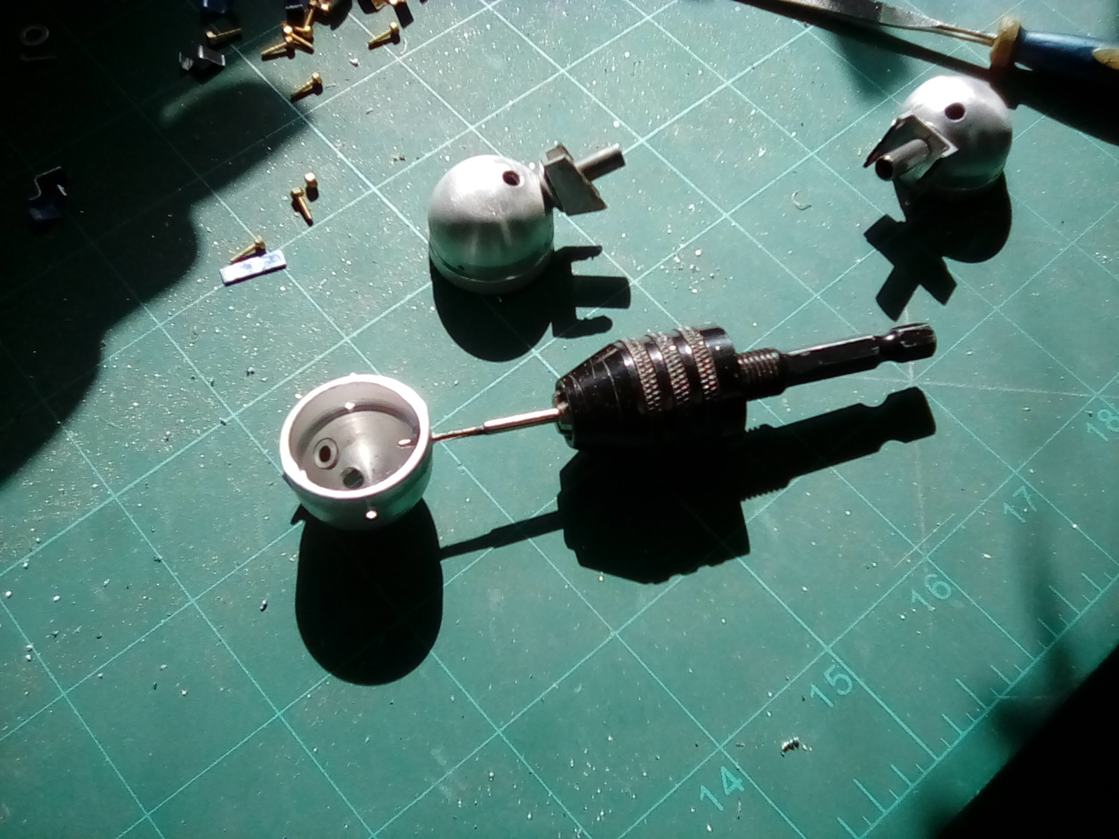

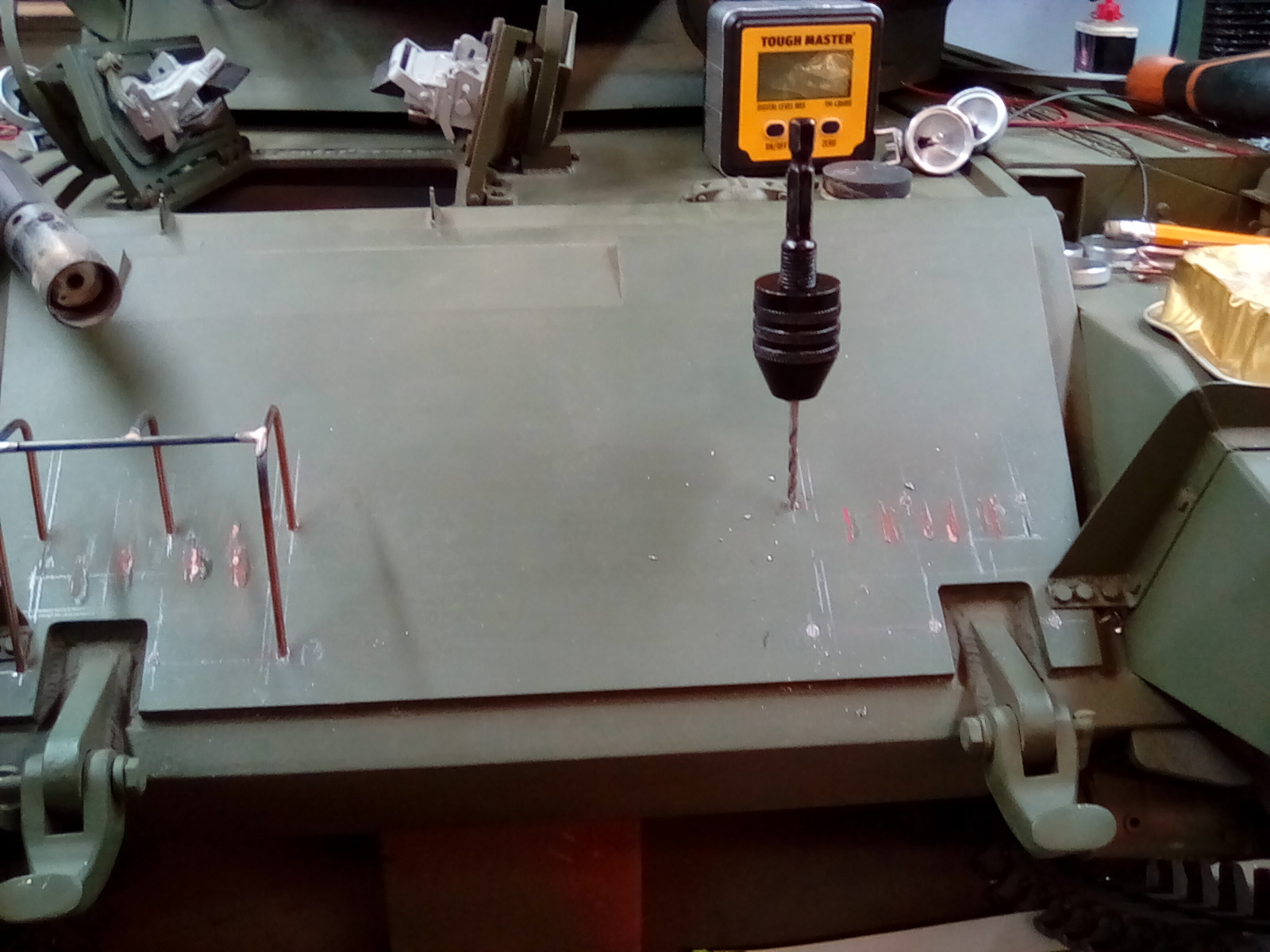

Always start with a small drill bit
M4 tap
M4 tap
Those sites are tiny

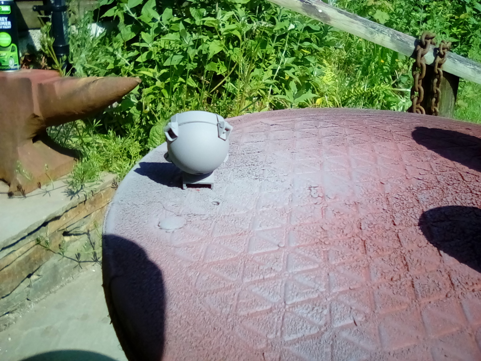

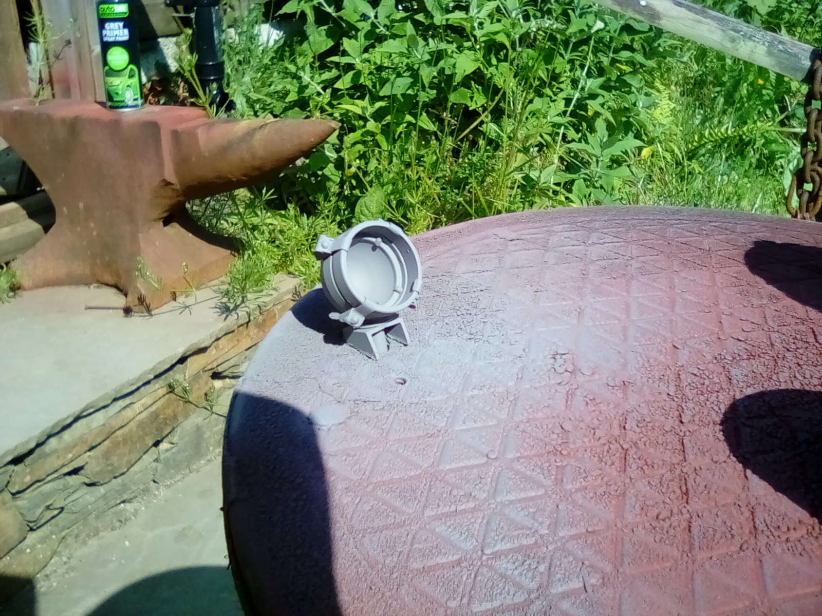

Now to paint
Now to paint

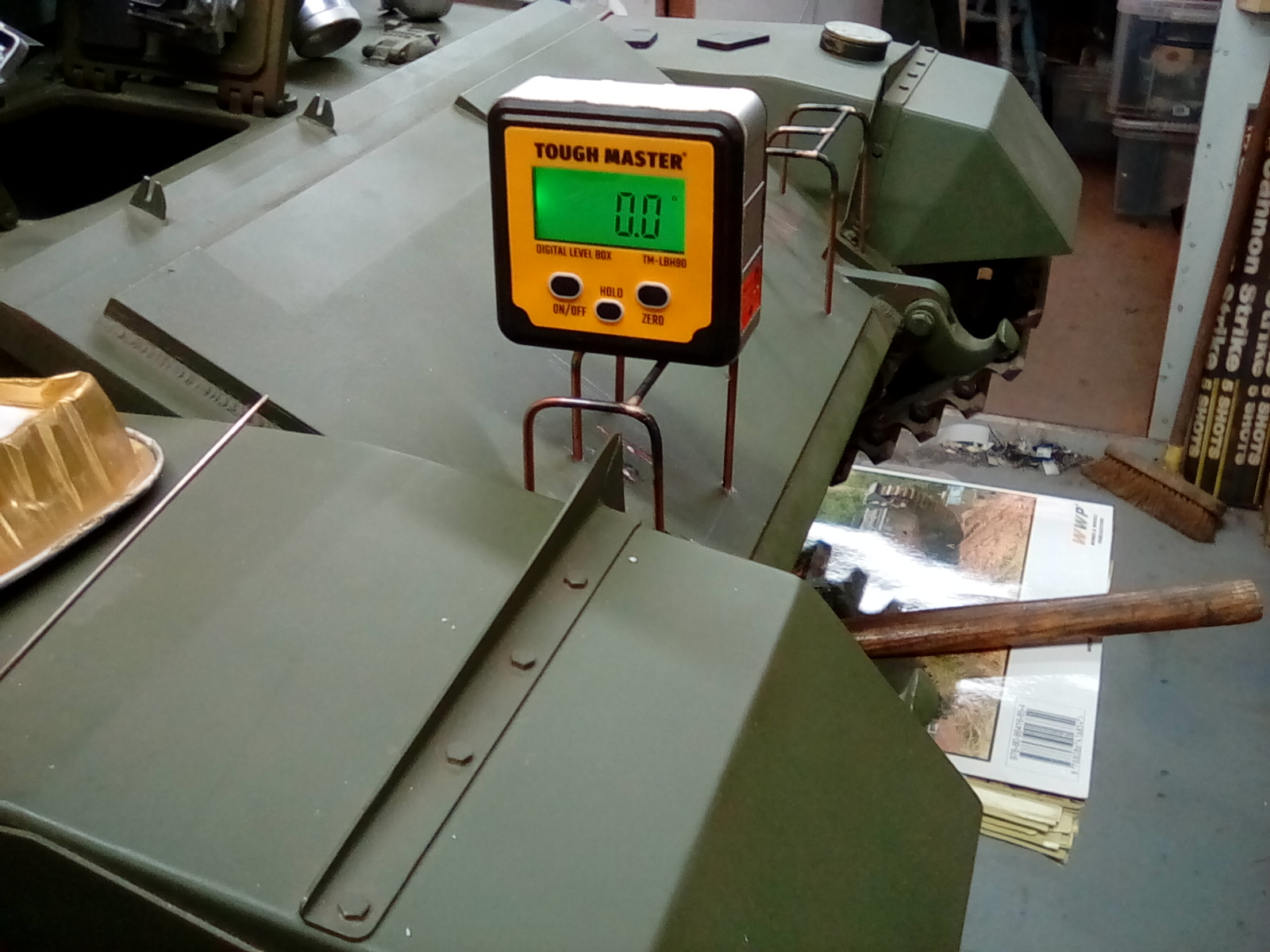

This will take some head scratching
Measure check, check again , measure and centre pop, I shall make them long and then cut back to finish
I'm being really careful as I only want to make these once

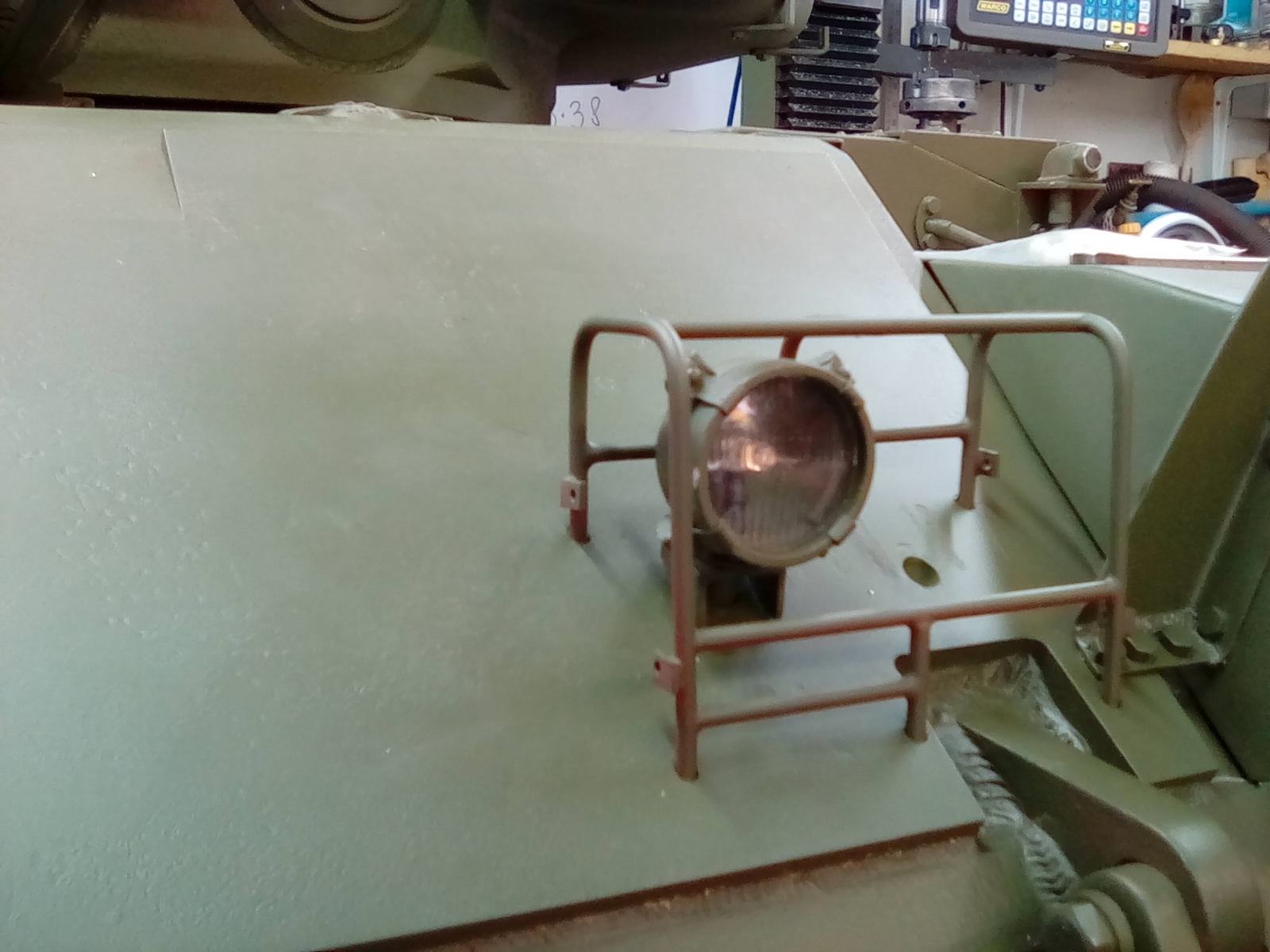

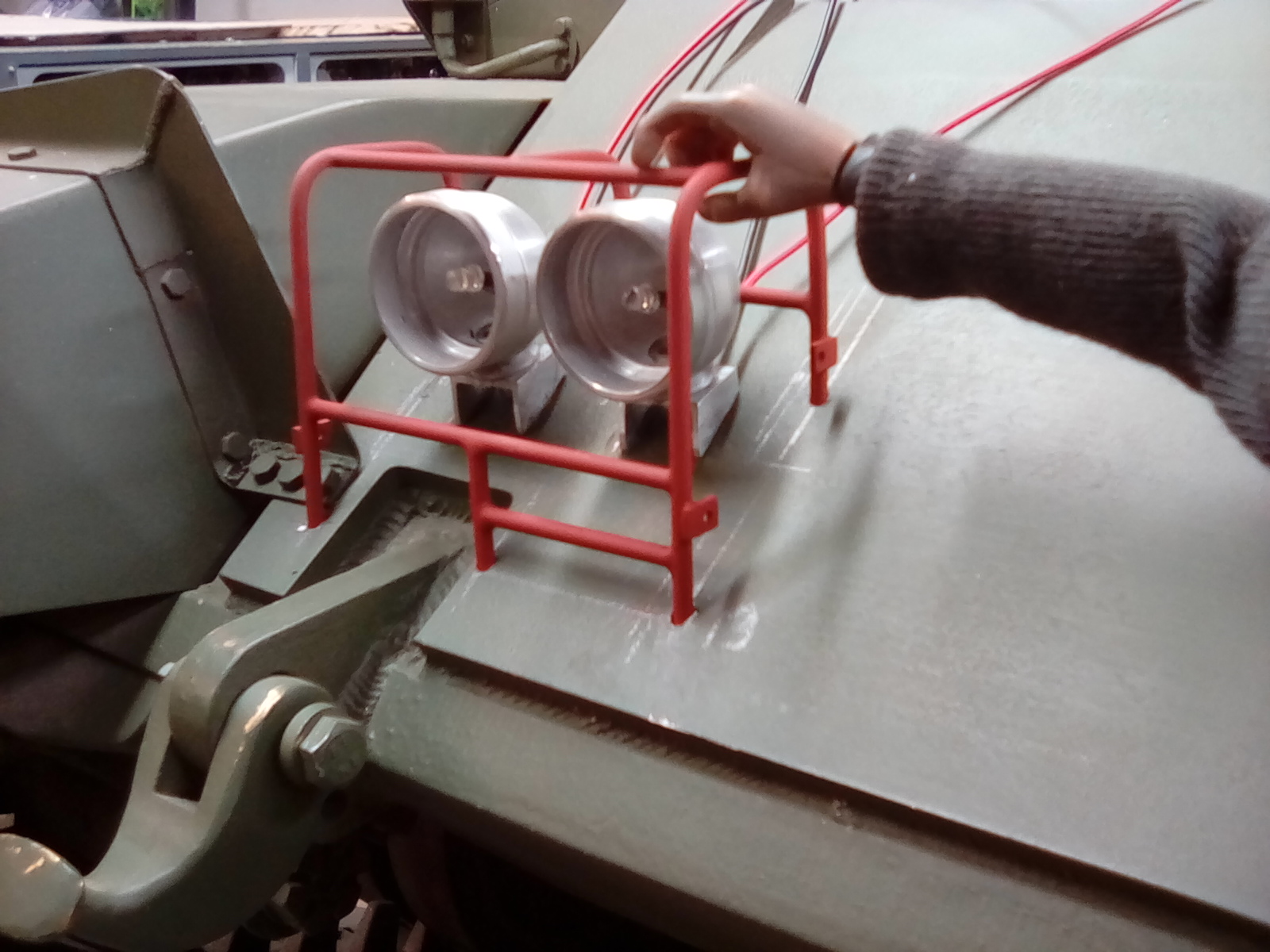

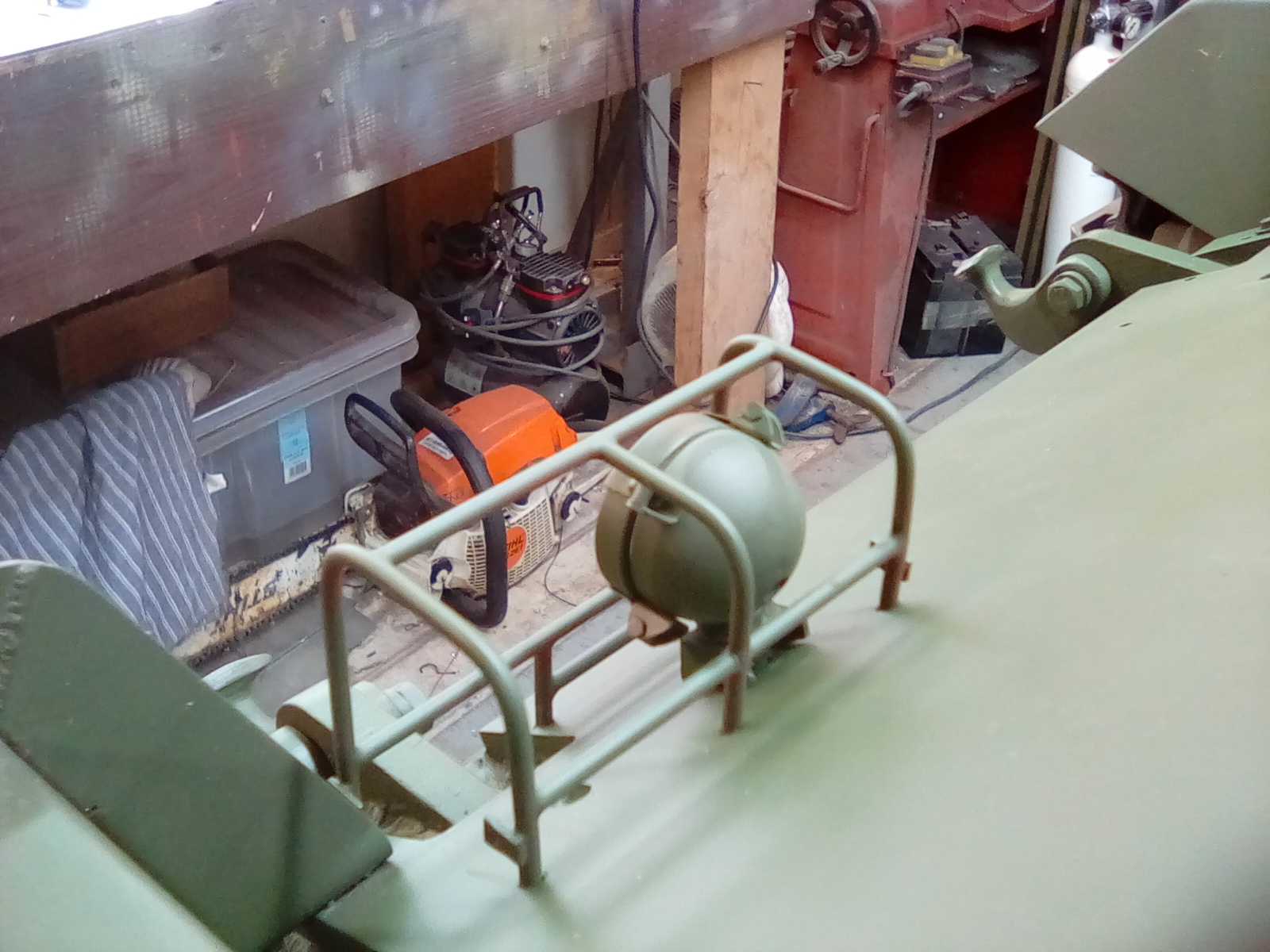

The light guards are now well under way

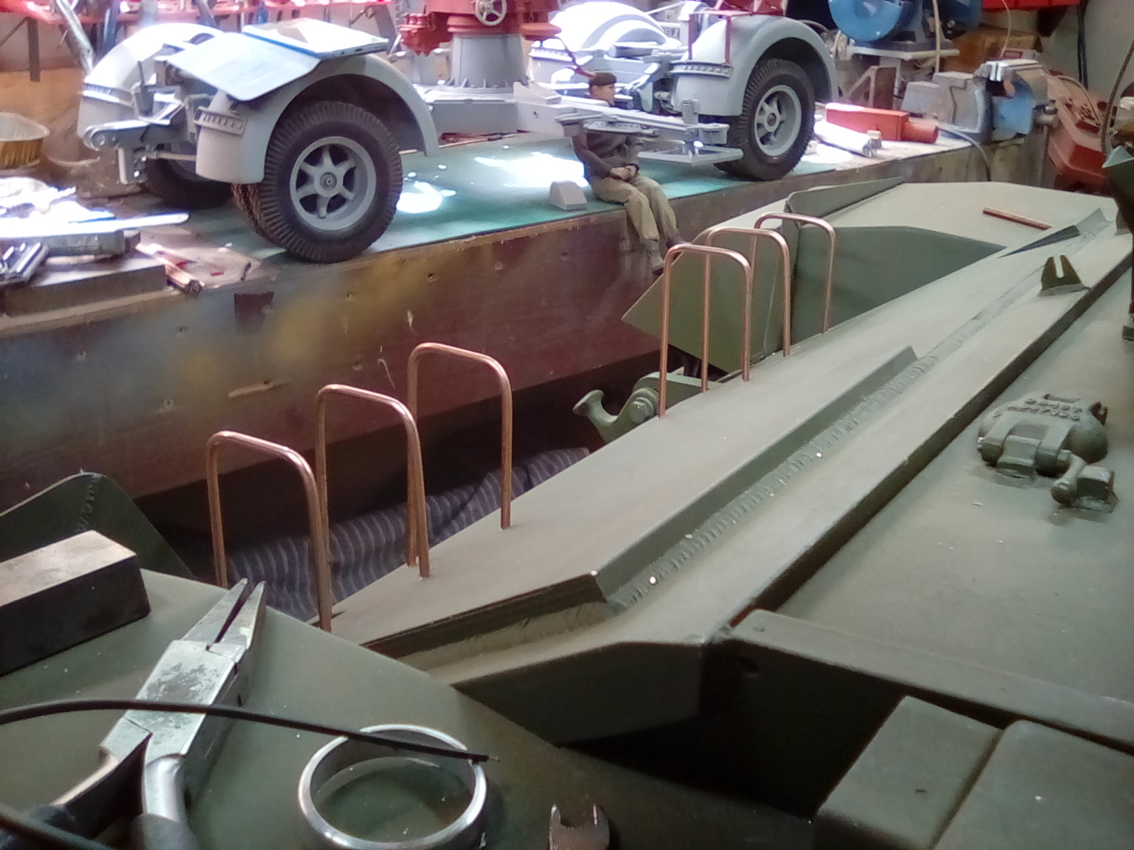

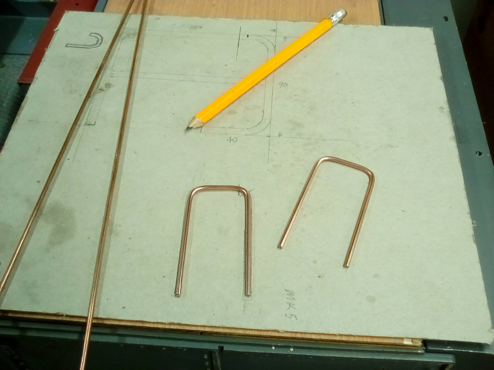

I have my own "bend allowance" system that works great for me
Getting the frame pieces all the same takes a little effort, all the hole depths need to be within .5 mm

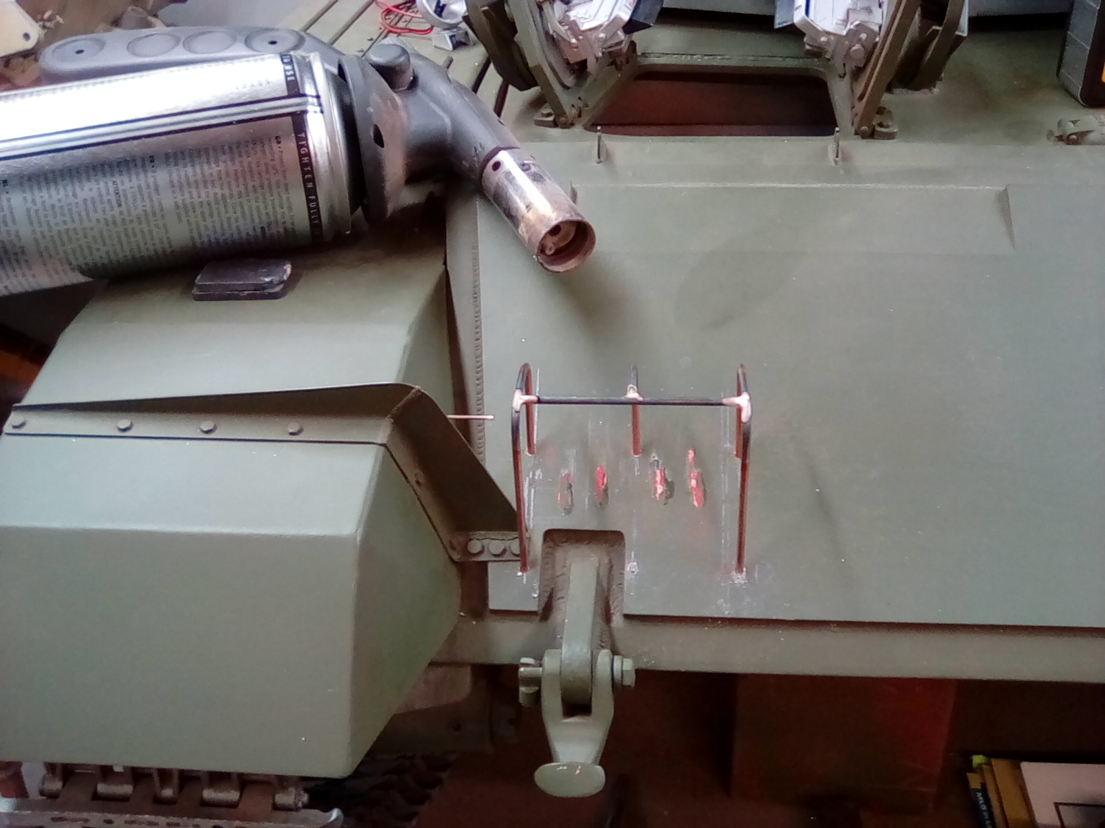

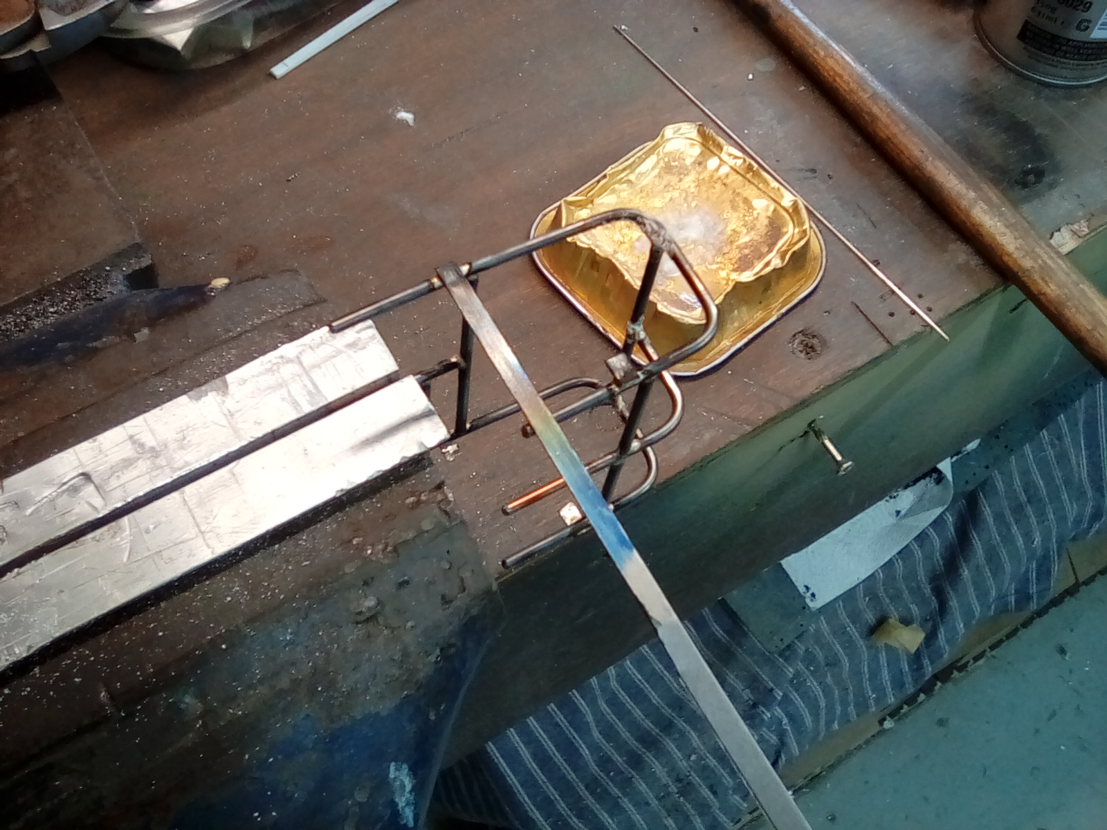

Tricky and delicate silver soldering
The copper covered welding rod silver solders perfectly
You need a good eye to keep the holes square and plumb
Using the in situ pre drilled holes as a jig you know that the frame fits perfectly and can be removed for further soldering and refitted without any problems, if the rod and or holes are out of plumb removal can be very difficult.

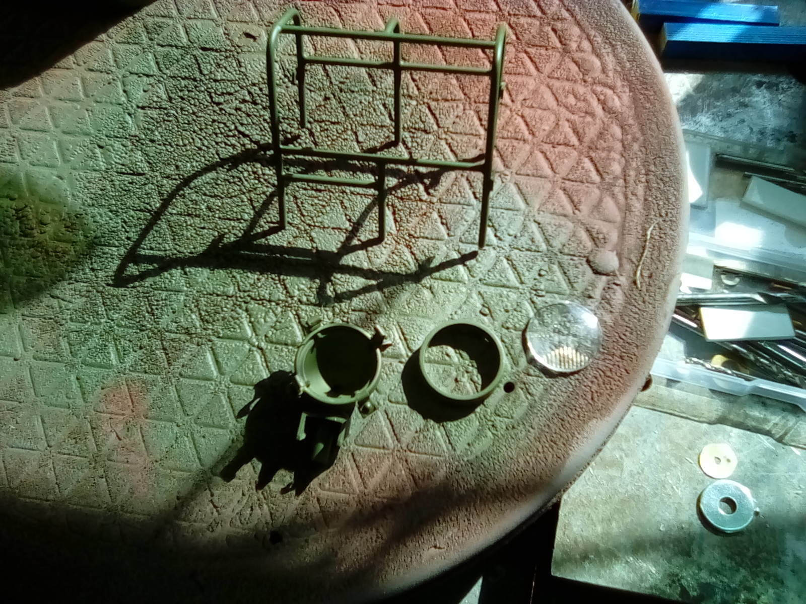

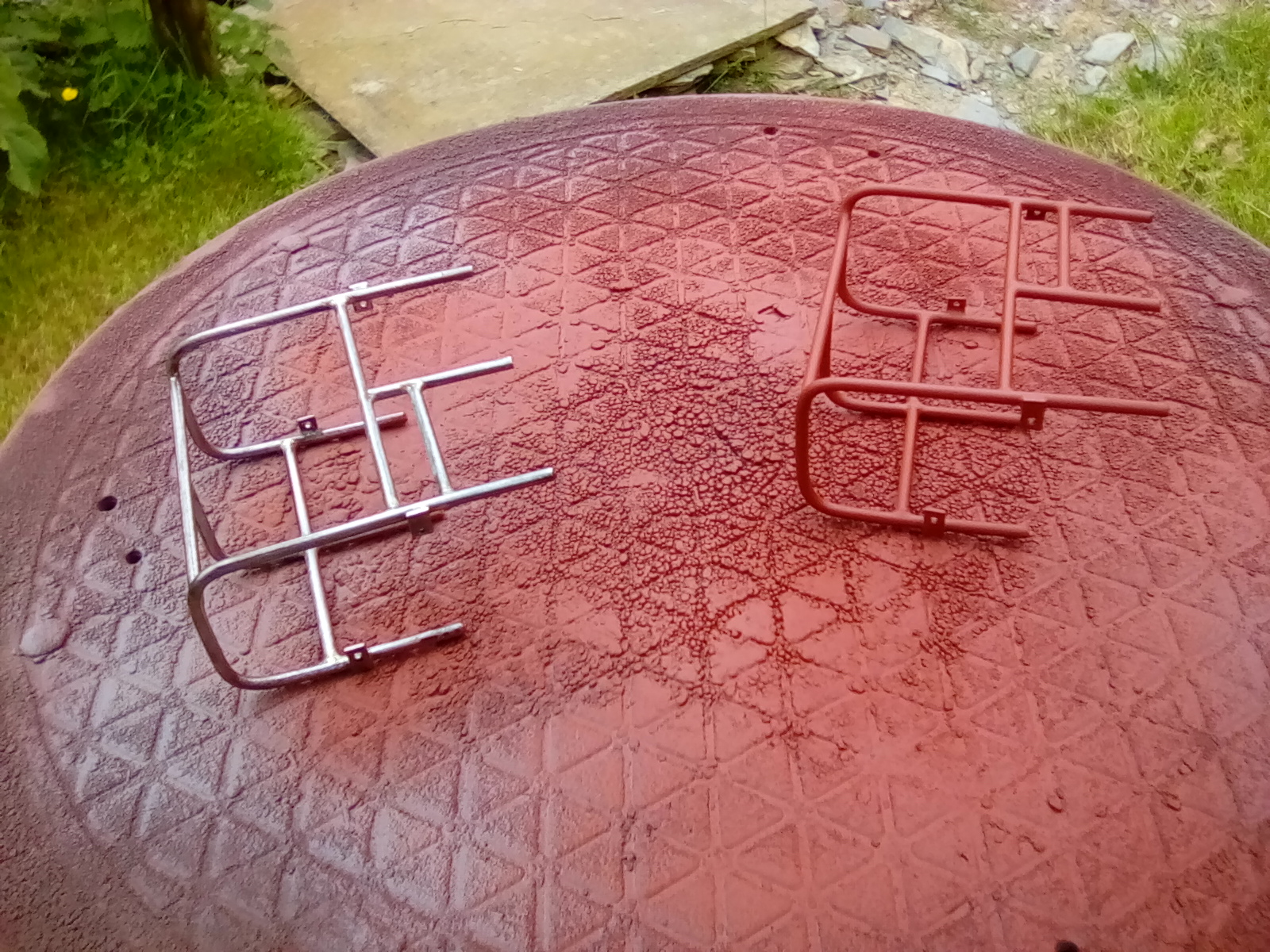

Re: Mr Dawe's Centurion.
All soldered cleaned up and primed
Note how much paint there is on the light guards , remove those layers of paint and our stock rod needs to be  1 mm less in scale in diameter

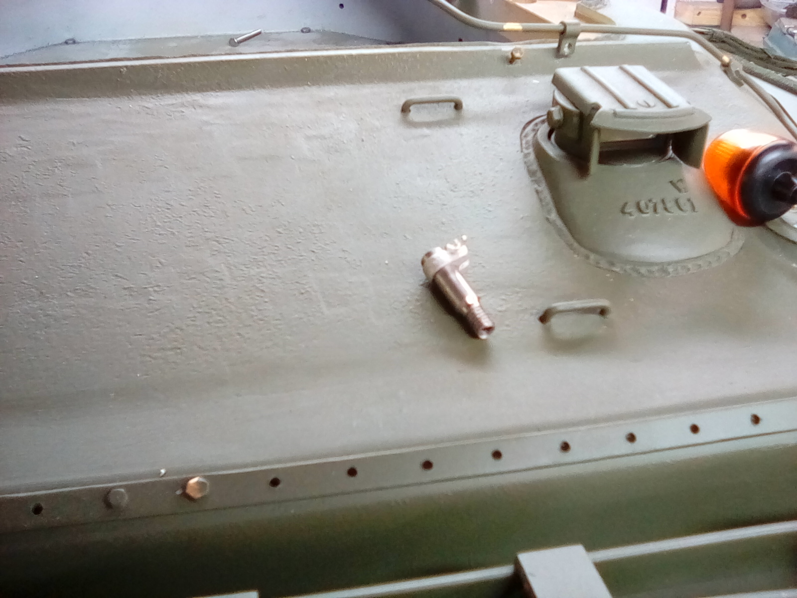

This piece of mild steel is for the tiny brackets x4 that are welded to the frame uprights

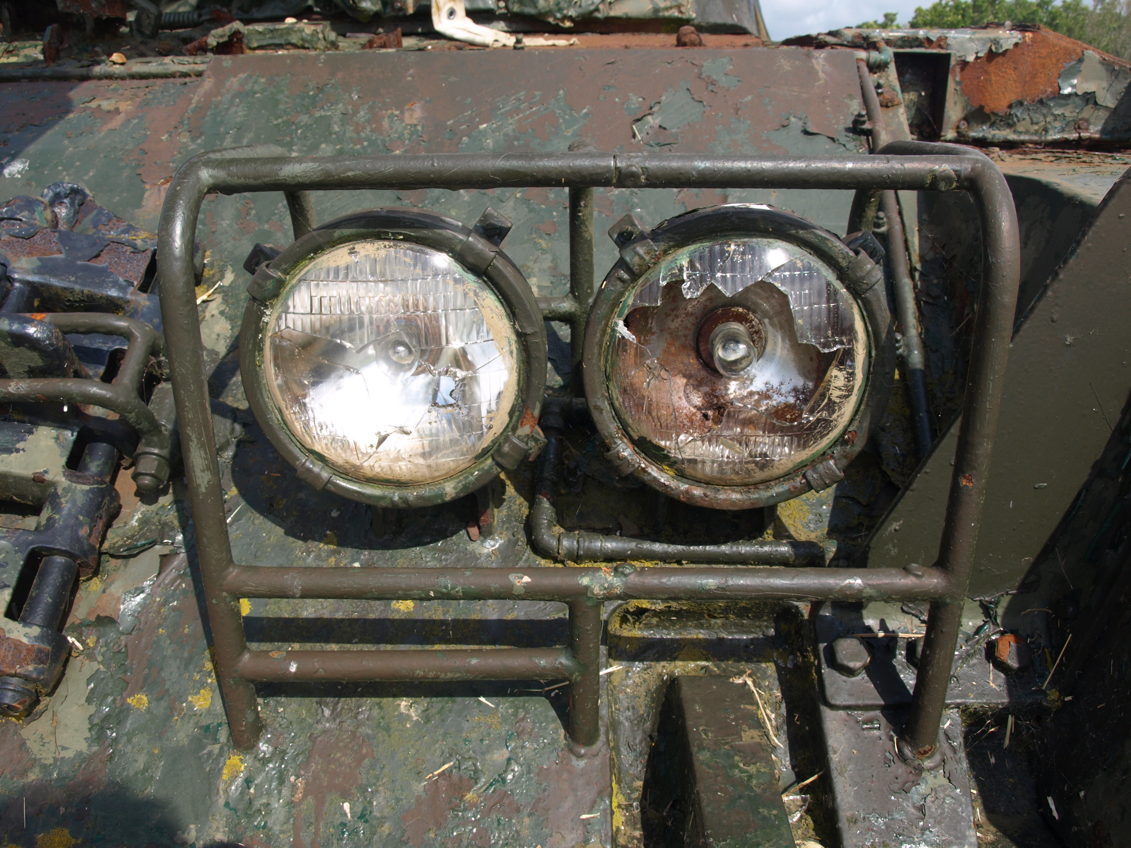

Not sure what these brackets were for.
And now onto the bezel fittings to include the awkward brackets, the conduit fittings are on back order from DD, well not really back order as soon as Dave gets a chance to cast them. A question for Dave, what diameter rod will I need for the conduit to fit your fittings please?

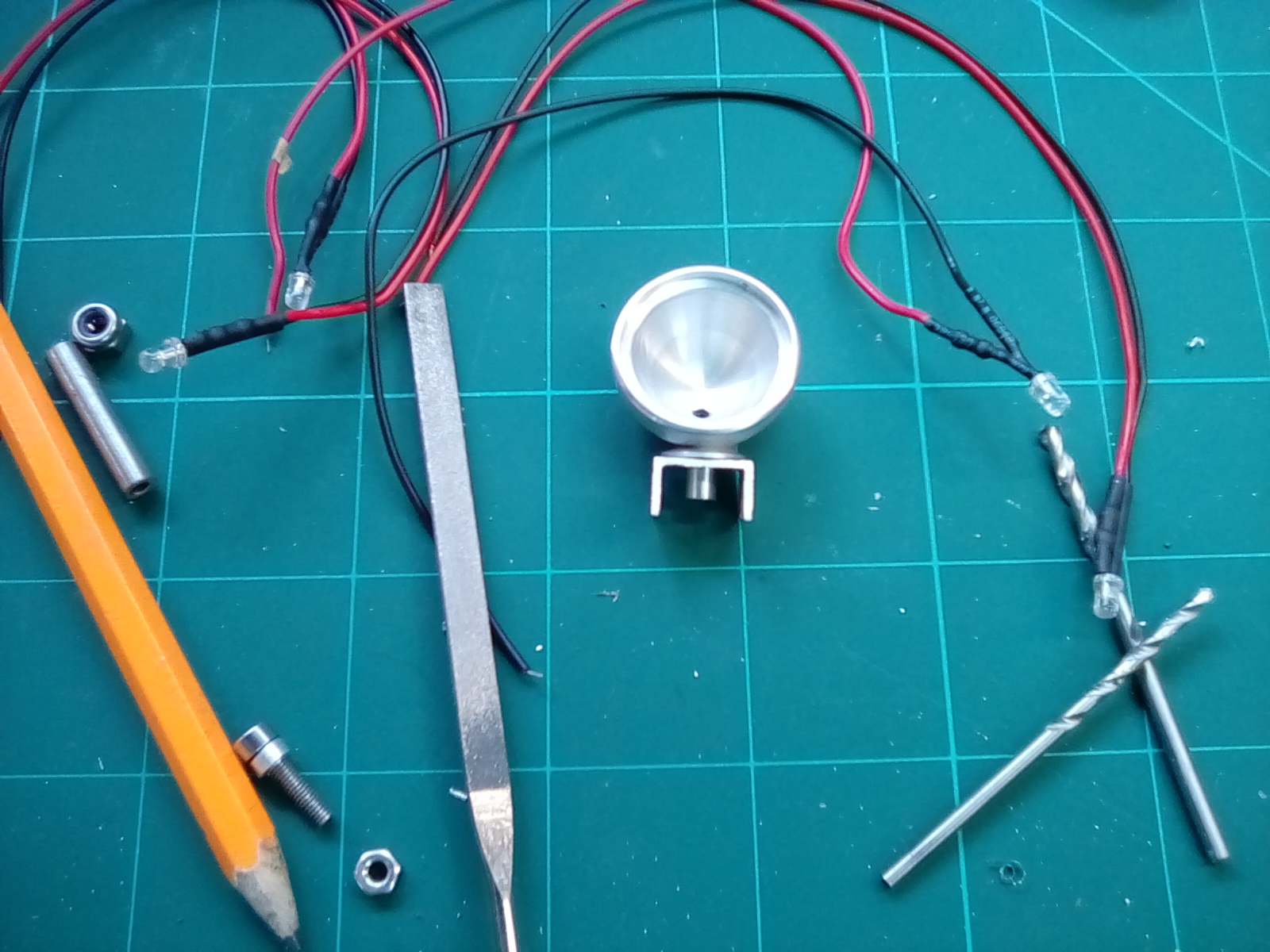

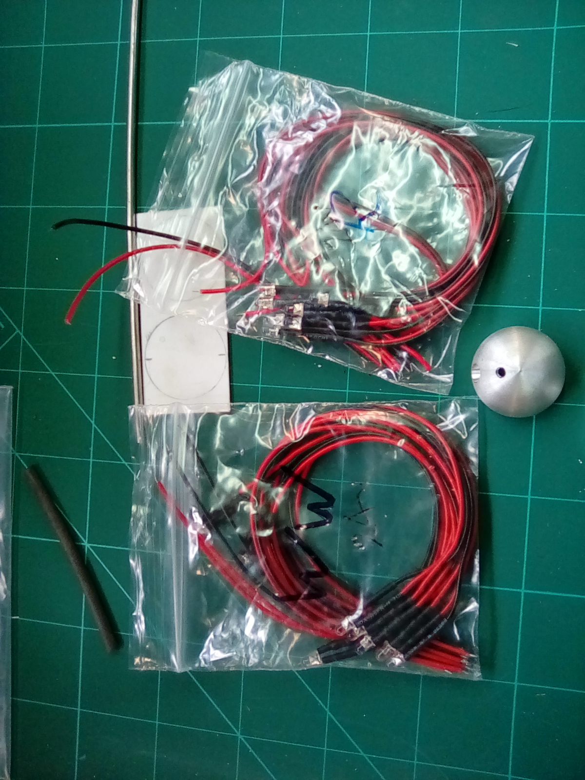

Change of plan regarding the led wires.
Led secret wiring
Led secret wiring

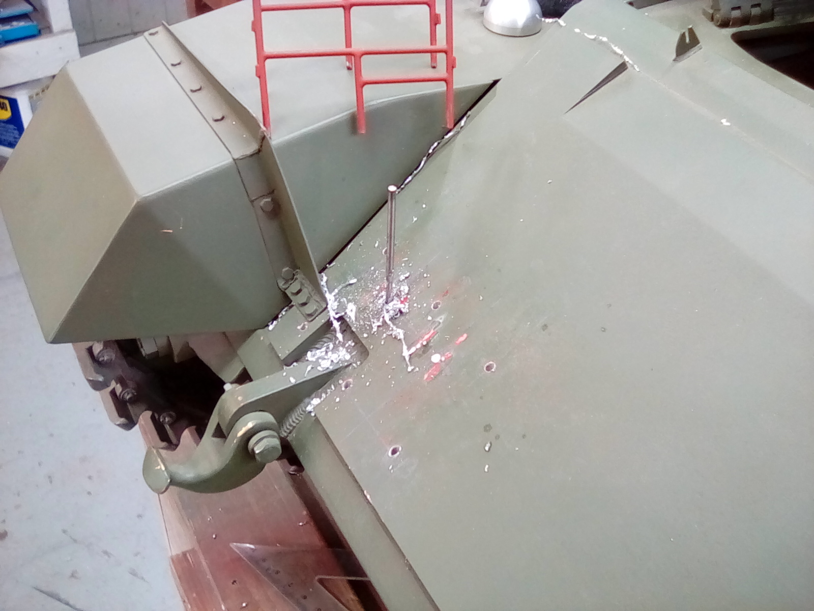

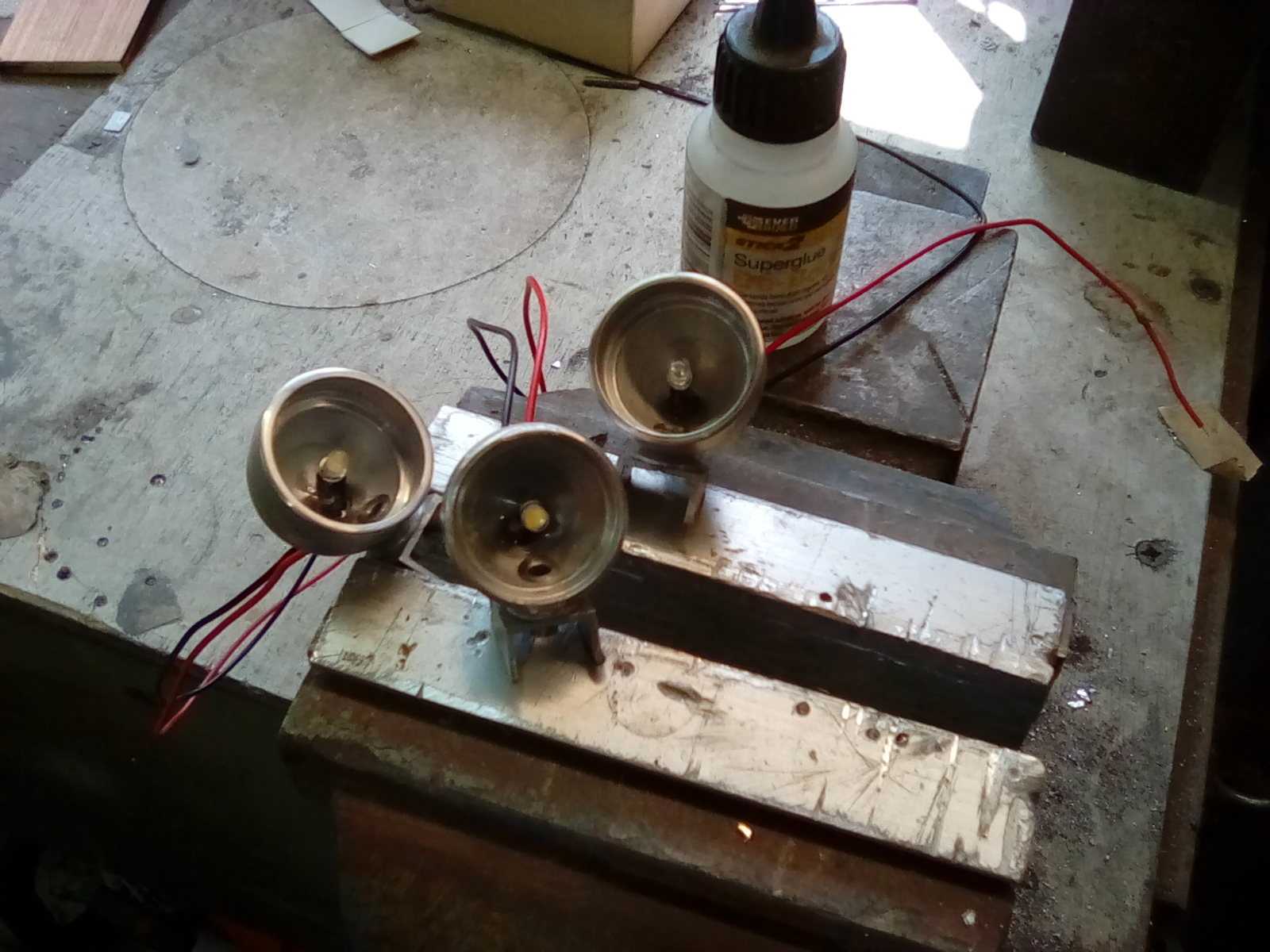

Dissolving the cyno so I can reroute the led wires

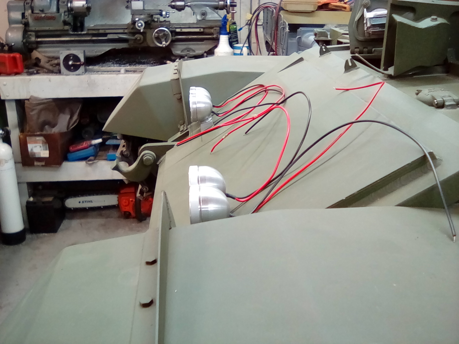

I've decided that the led wires must be hidden so the conduit looks perfectly convincing

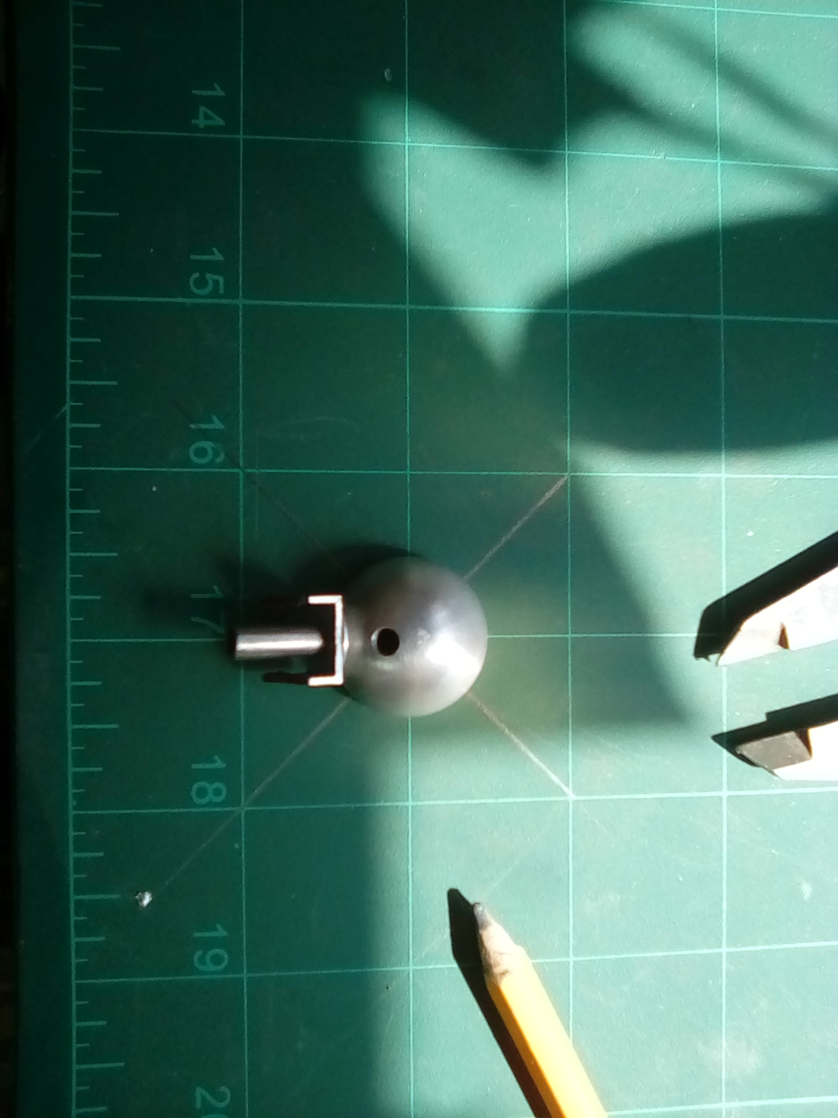

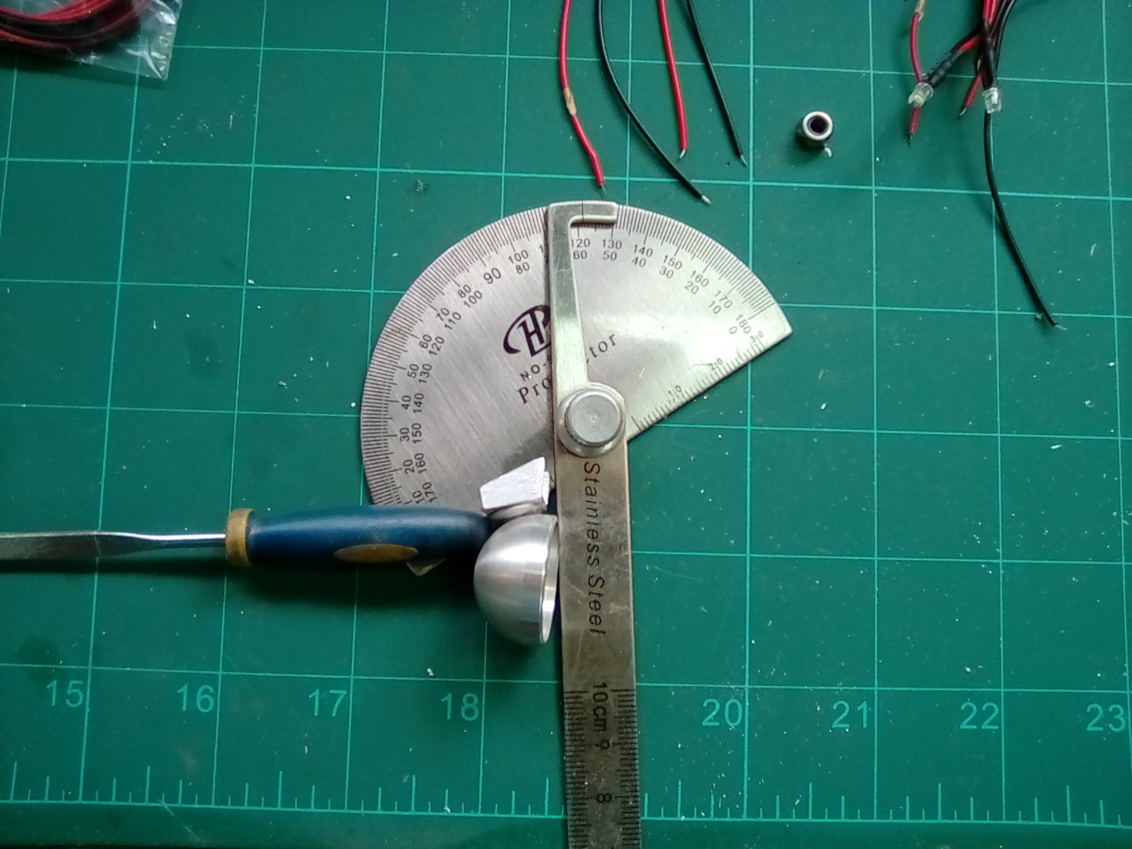

Yet another angle to work out

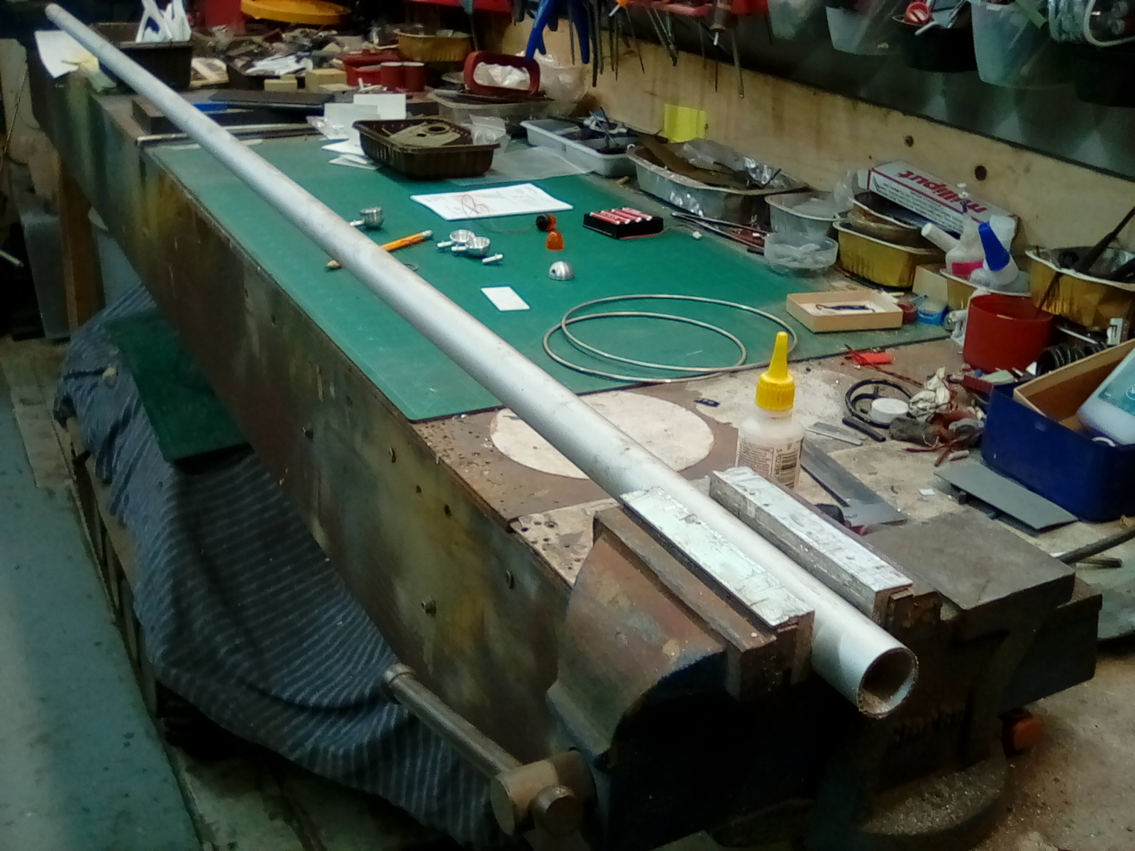

Extension mounting tubes not only to support the headlamp but to carry the cables into the hull.
Lines for reference just in case I make a cockup

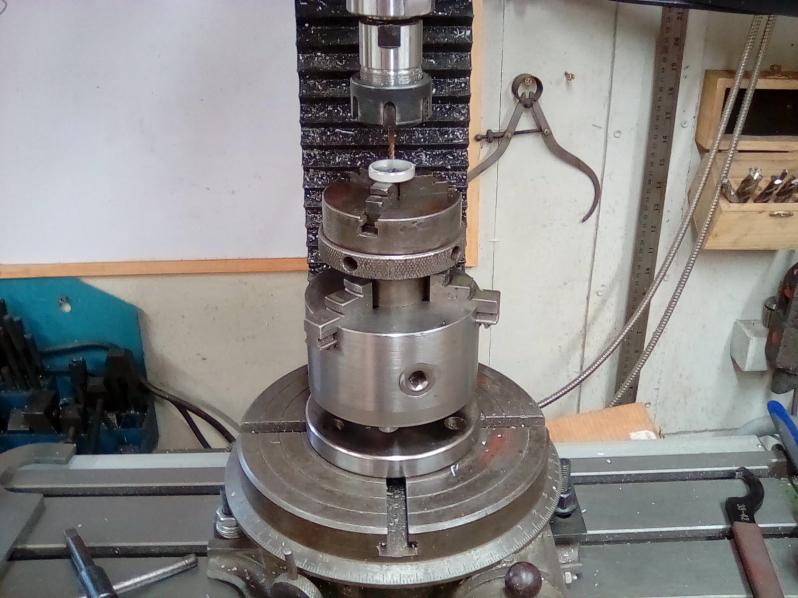

Centering is always a chore but it has to be done

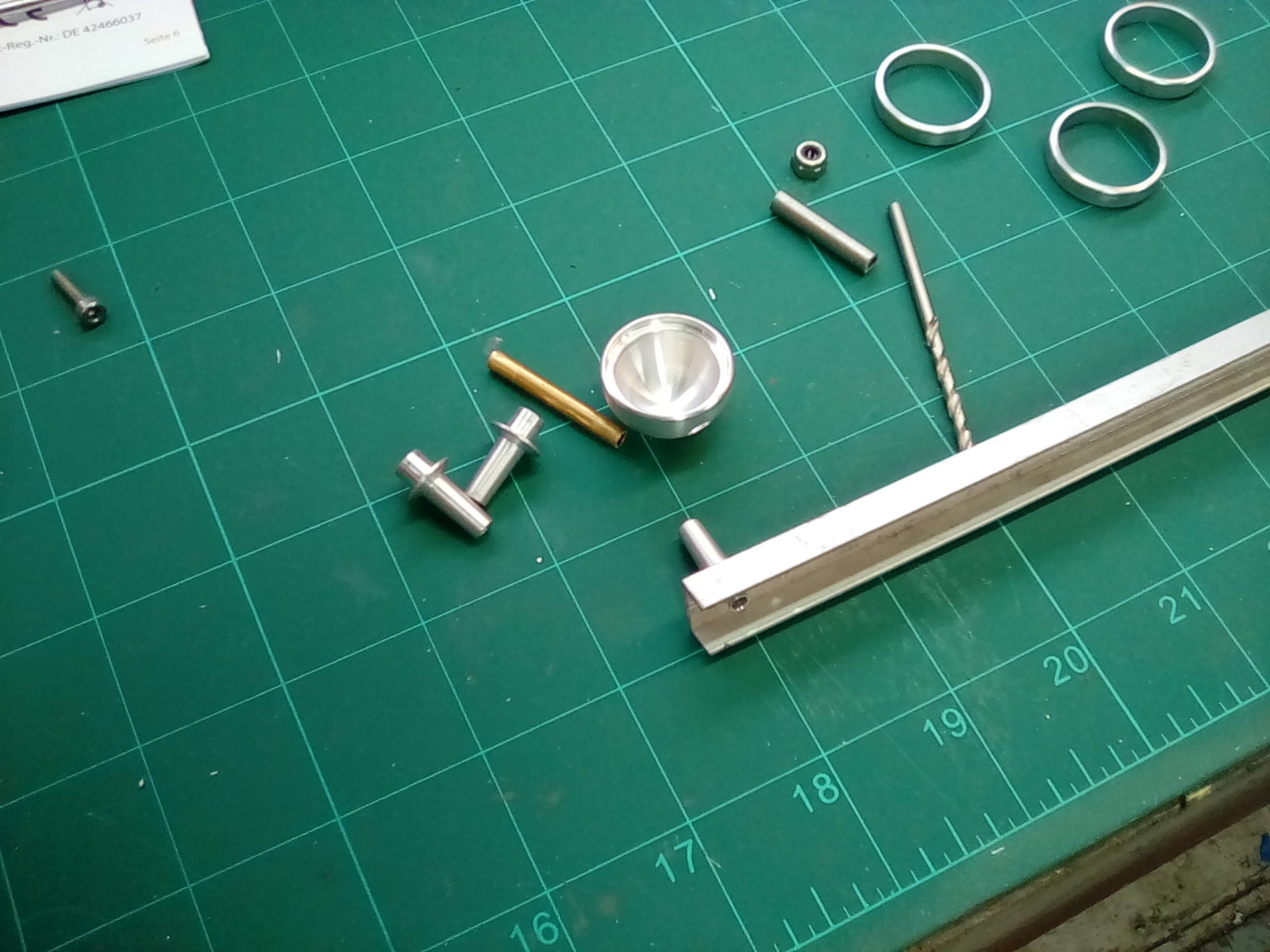

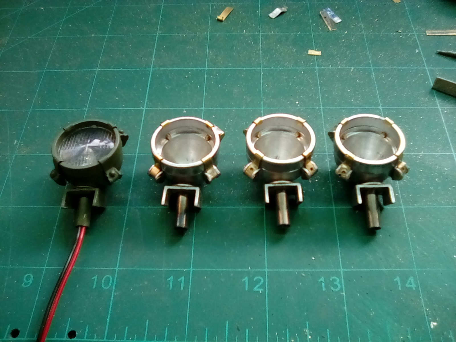

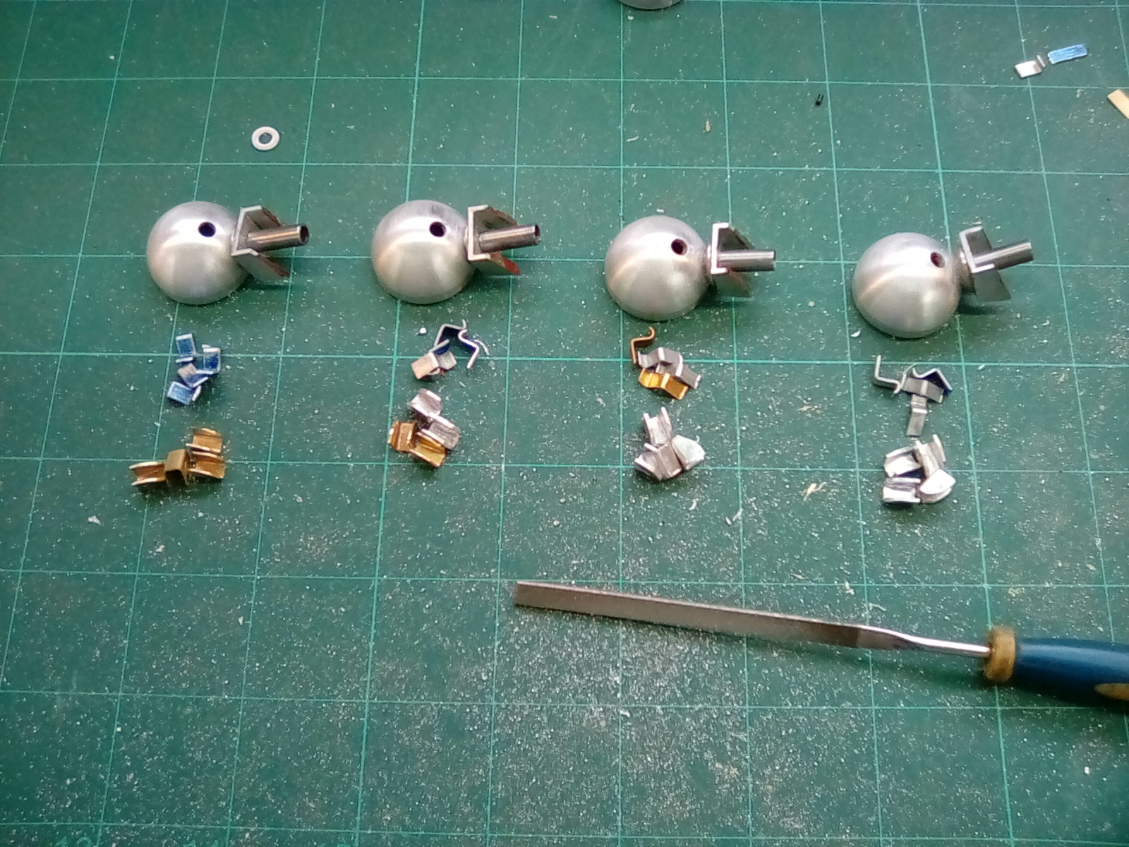

Making tiny parts for those headlamps
There's always a scrap piece of metal that works kicking around somewhere
These ears are to big just now but that's all planned.

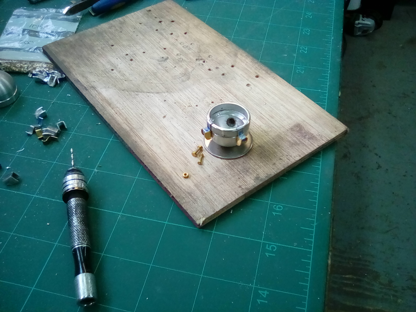

This all needs to be functional so in the future if an led needs replacing you can remove the bezel .

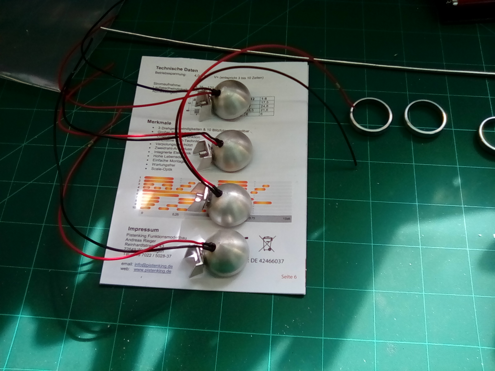

I need to reduce these fittings down by about 20% but that will be done once it's all in place, the parts are very fiddly indeed,  so best fix then file

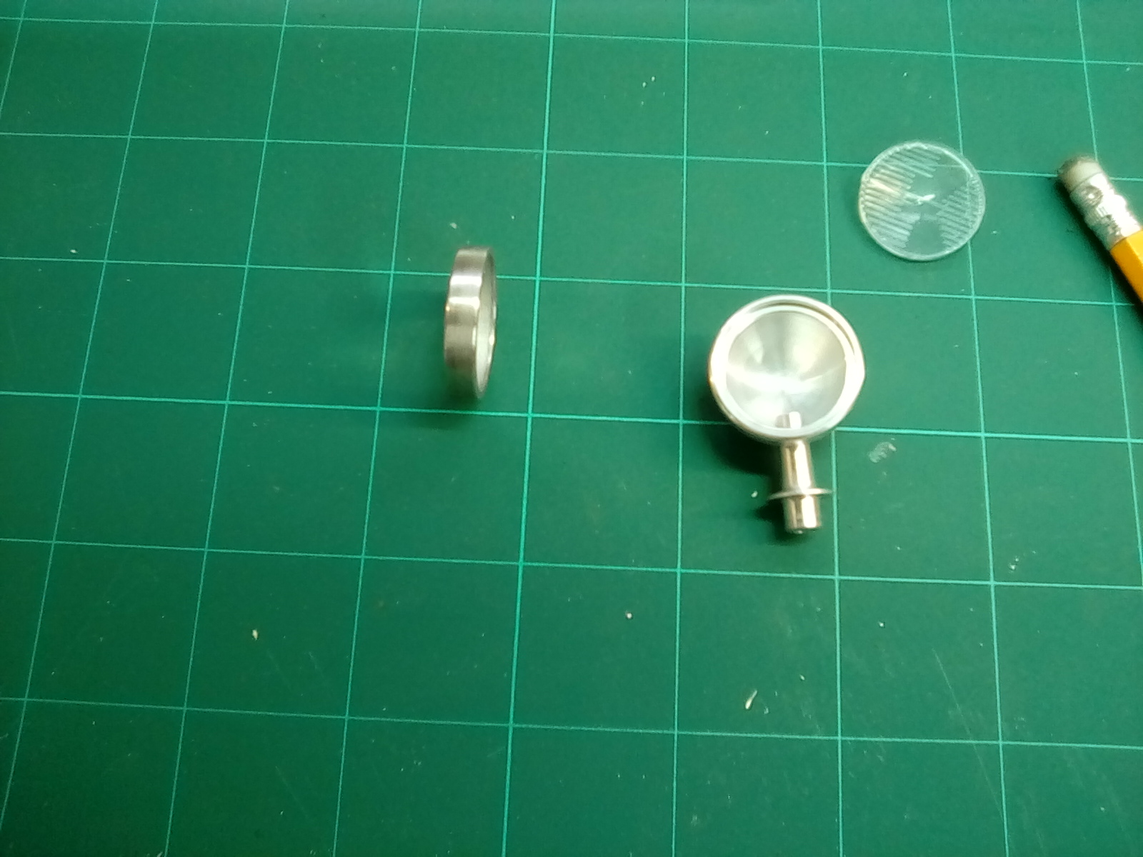

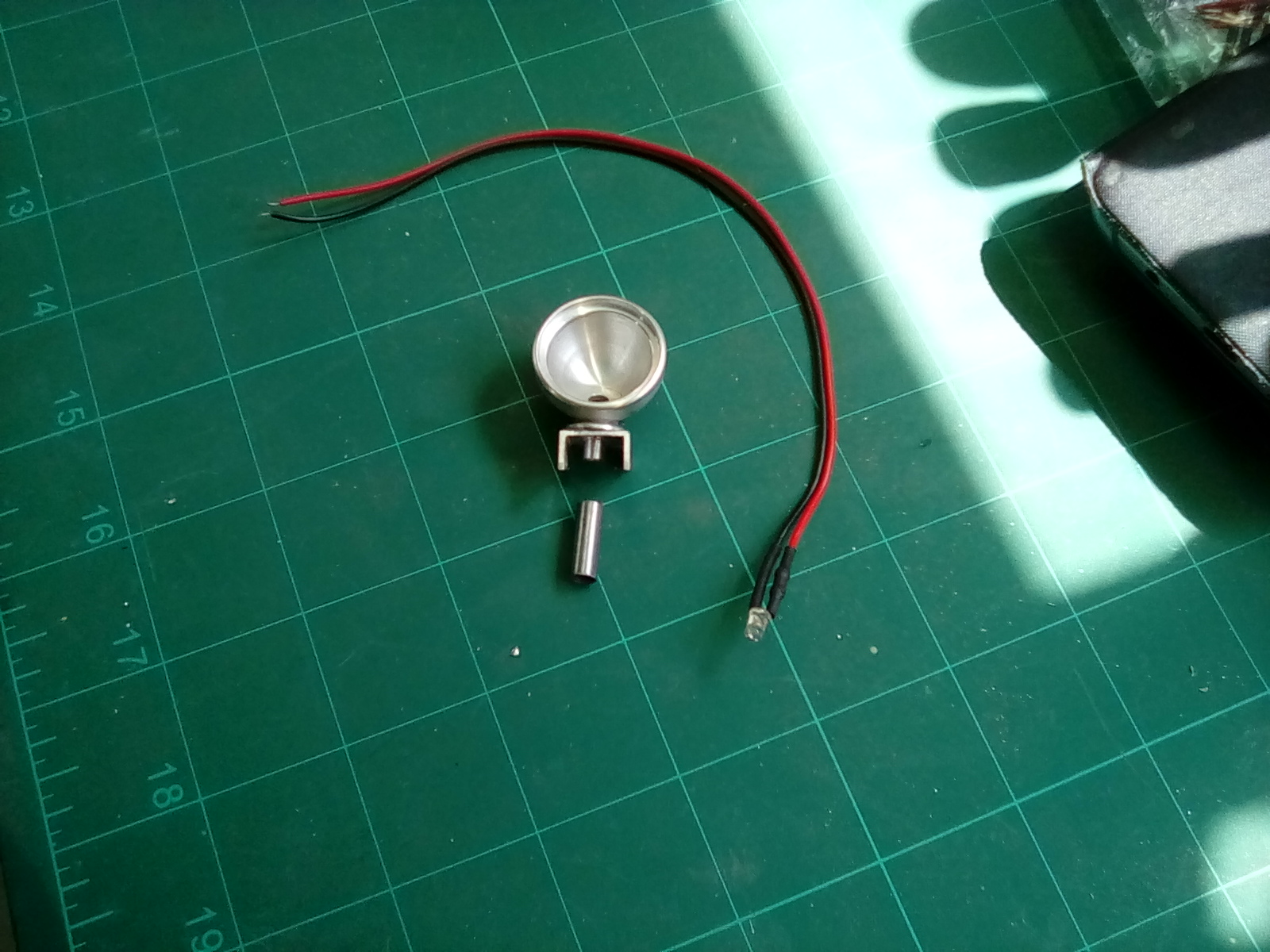

I decided to finish one lamp completely, really just to prove the concept.

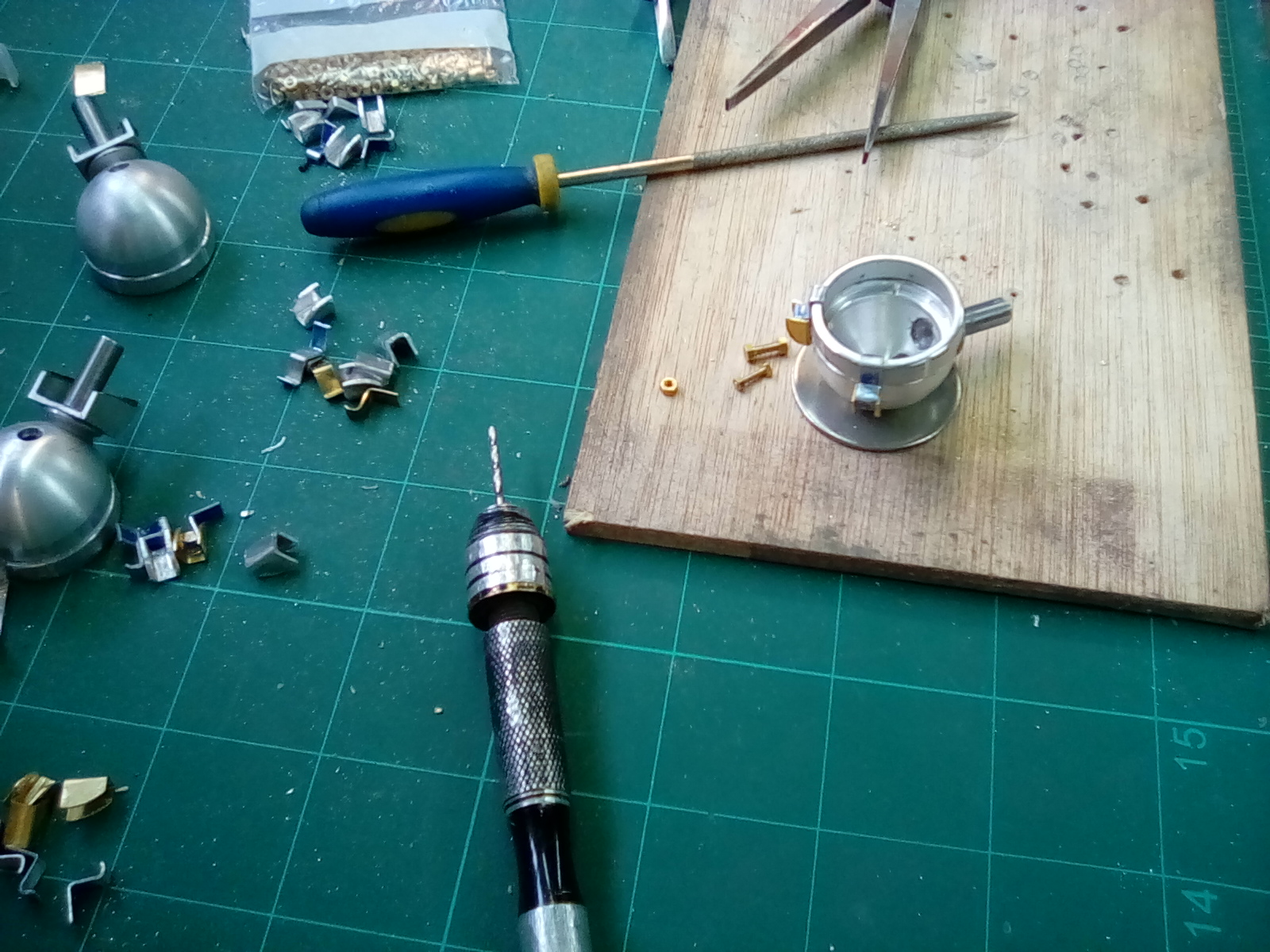

Pin drills
Pin drills

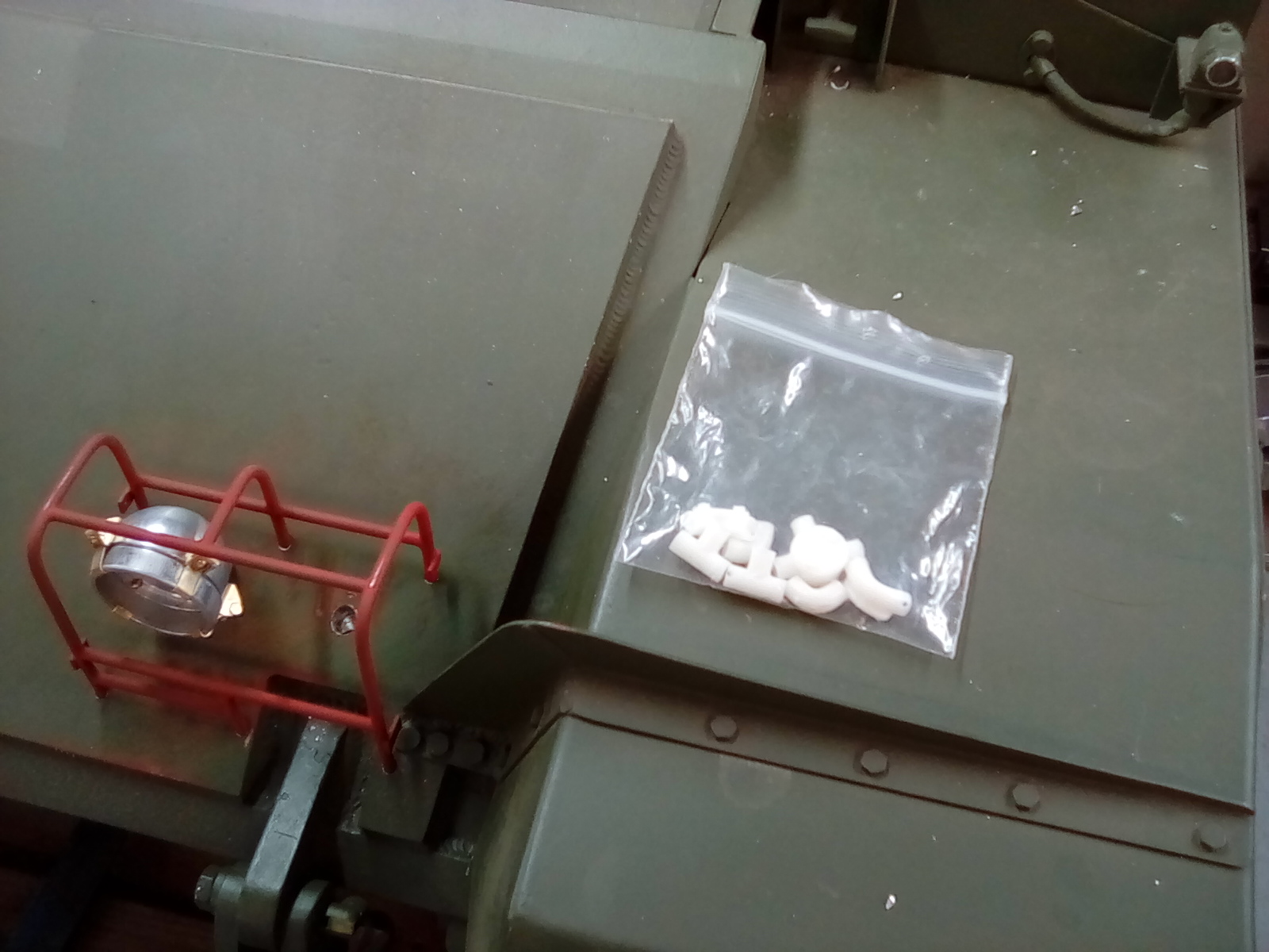

The resin conduit arrived today, these Dave has sent for patterns prior to the metal variety which will follow

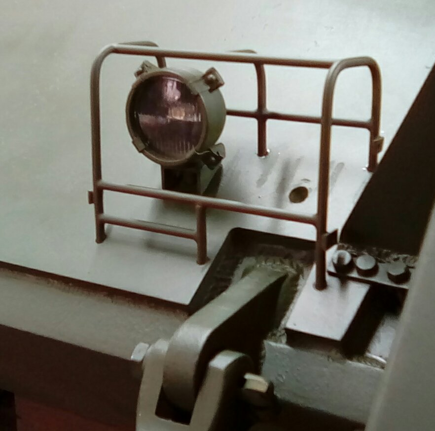

I'm happy with the result
My smallest tap
My smallest tap

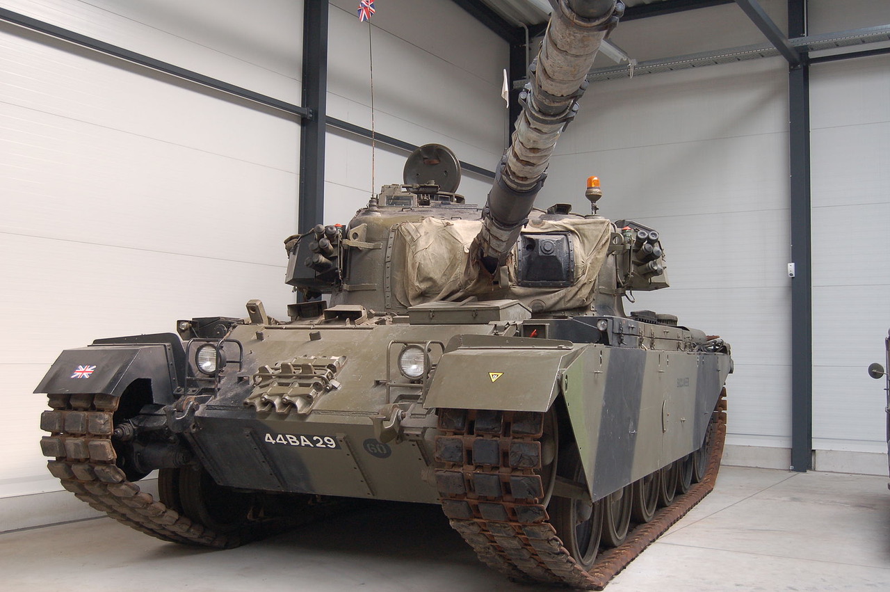

Anyone know which way up these light lenses go, more open part to the top or to the bottom?

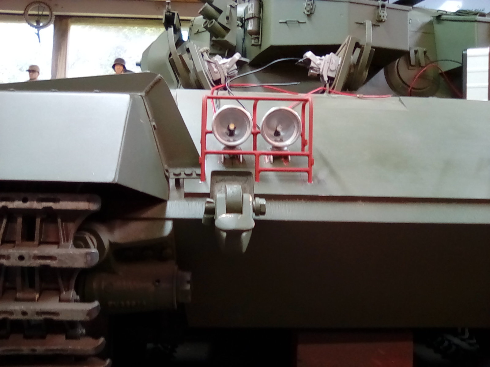

Nearly ready for paint.
Tiny screws, leds and some paint. Then mount and wire in to drivers compartment switch panel .
