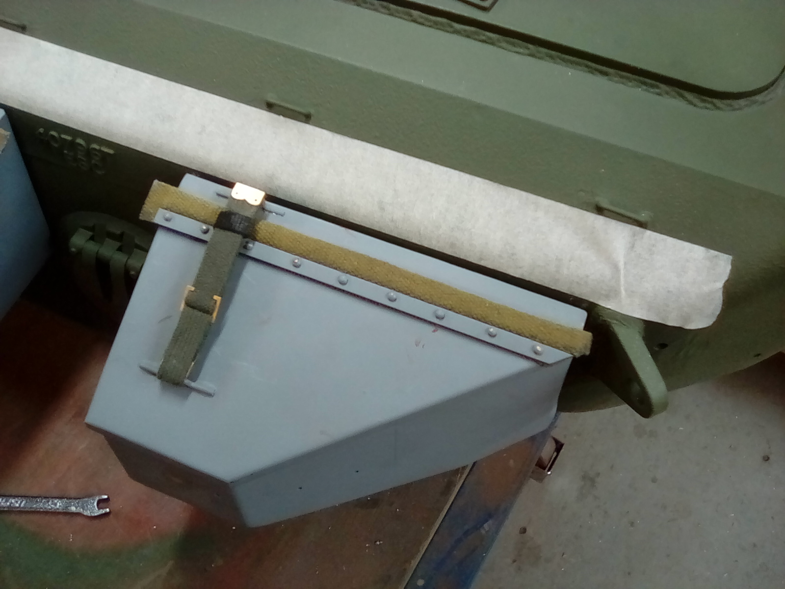

I'm not going to lie, this job is a nightmare but if you follow the correct order you will get there in the end.

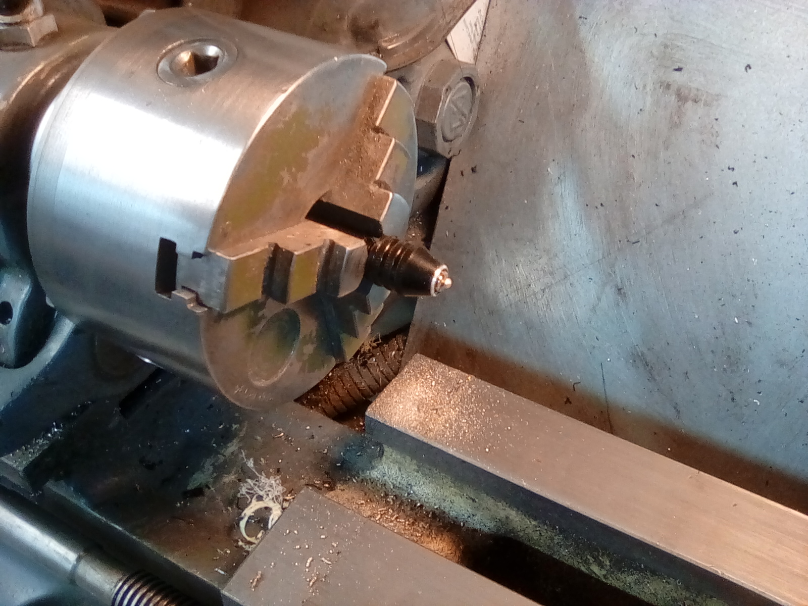

You will need to use bolts or " rivet bolts" I'm making them using the lathe

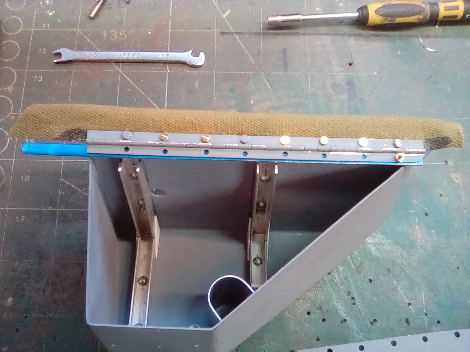

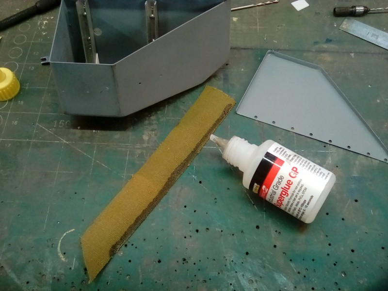

Start by fixing under the front section of the hinge, then under the rear, then fold over the rear and fix using rivet bolts and a metal strip over the front section, this covers the rear section fixings, now if this was real it would be water tight!
That was not easy, the ends of the canvas were sometimes left long but we may trim back as required

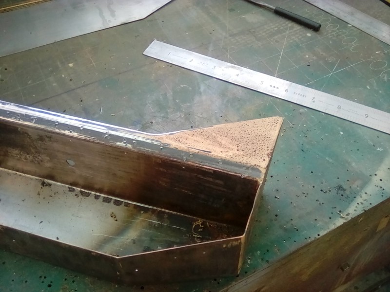

More tin bashing required
I'm not messing around removing the old hinges

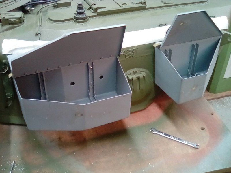

Grotty rear but substantial I suppose
The 2nd bin can sit in meths all weekend to remove The paint

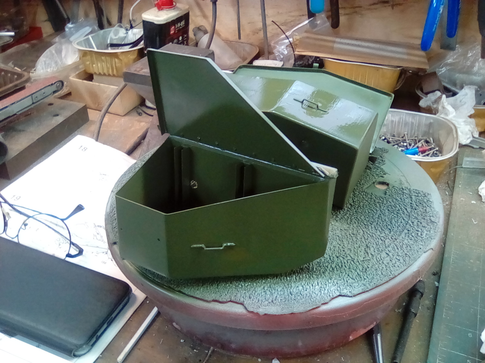

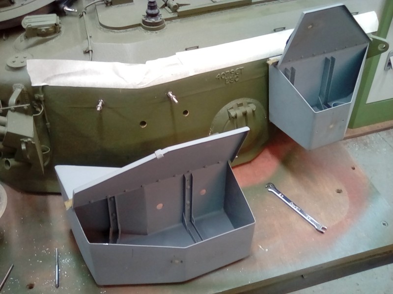

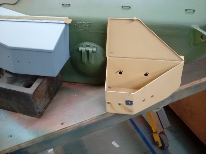

Note the bin standoff gap in these three photos
We are not happy with the single lock so the boss will order 3 more from Armortek.
Our compromise , the rivet nuts on the inside but I shall reduce them down as much as I dare

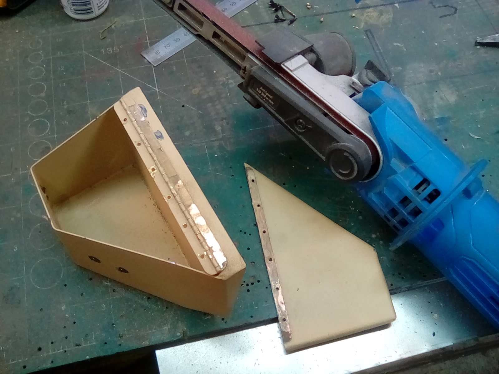

Thanks for the help guys , nothing very exciting I'm afraid just more of the rear small bin work. It fought me all afternoon!

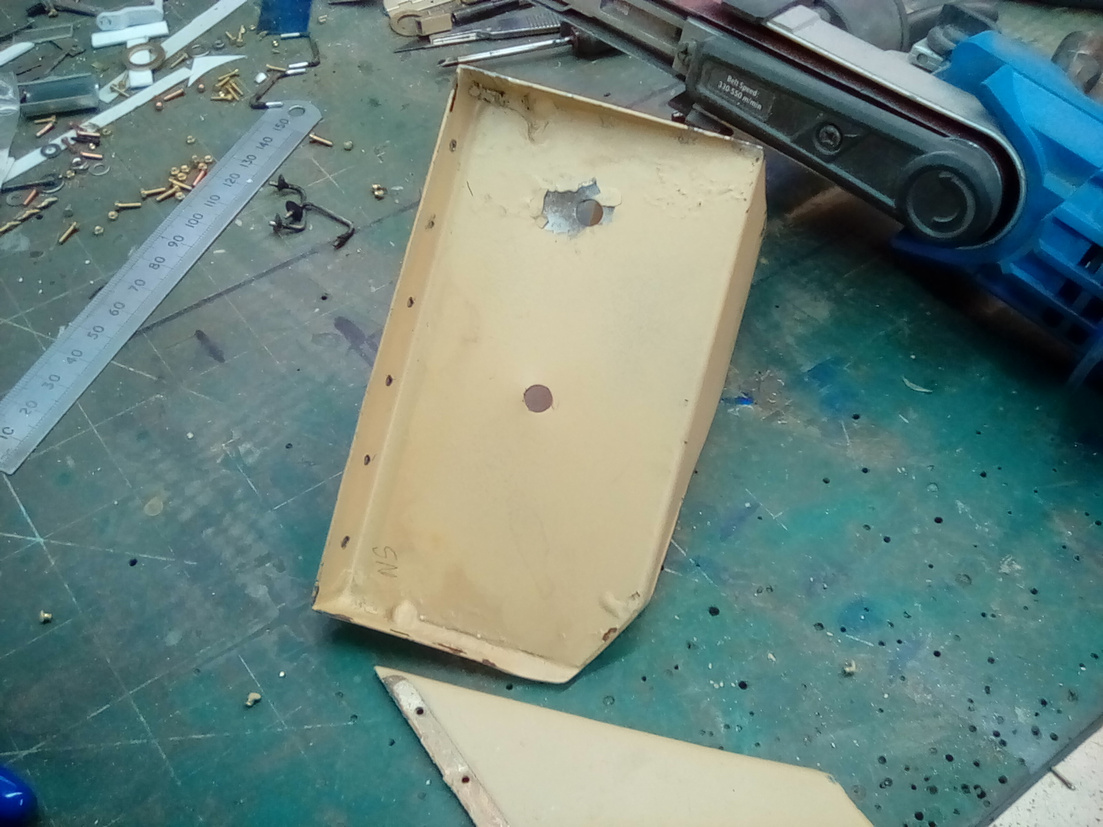

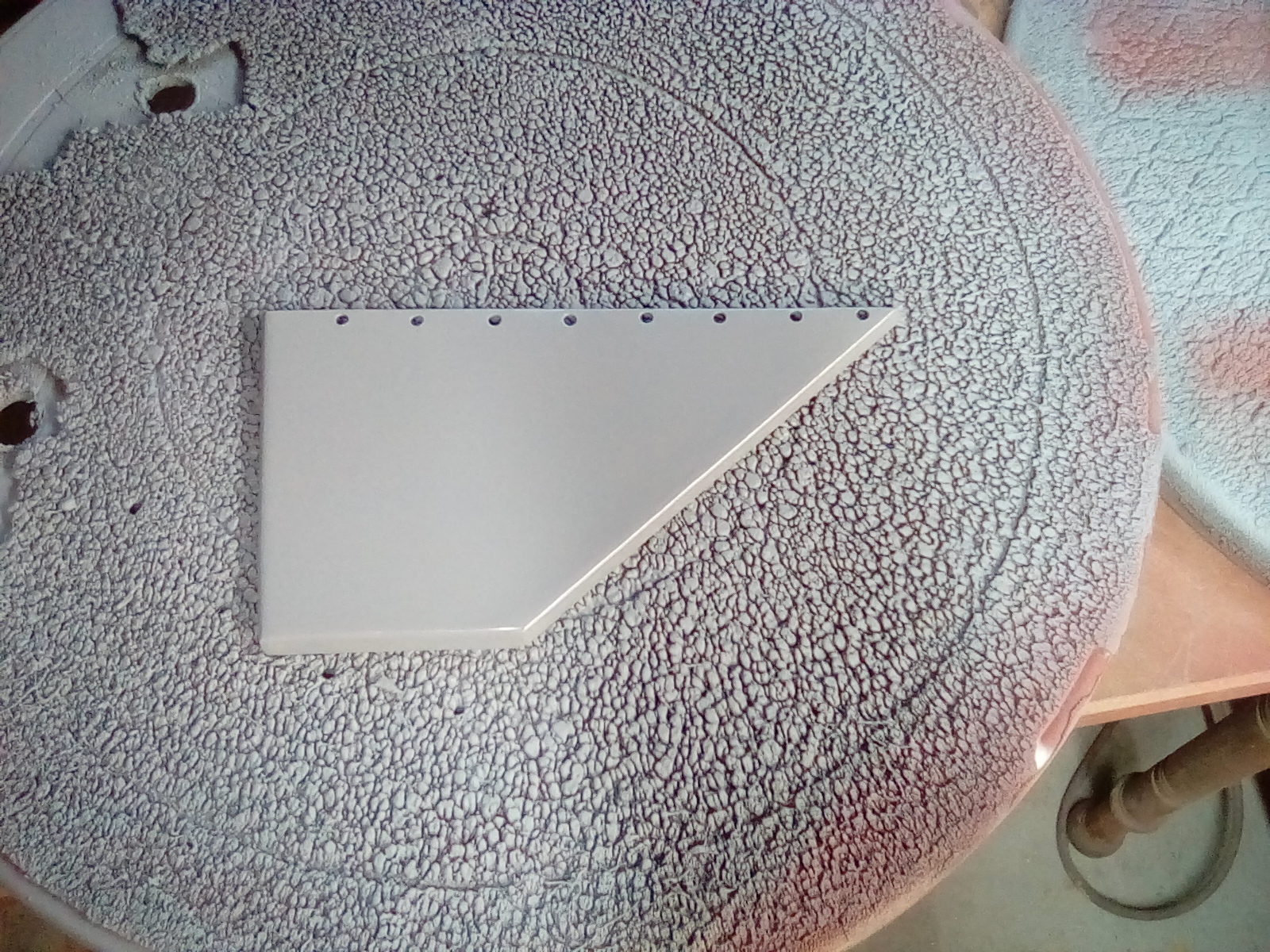

All the paint now removed

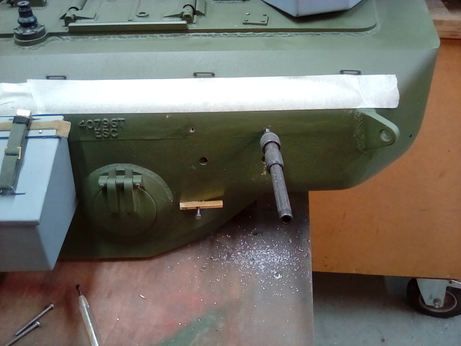

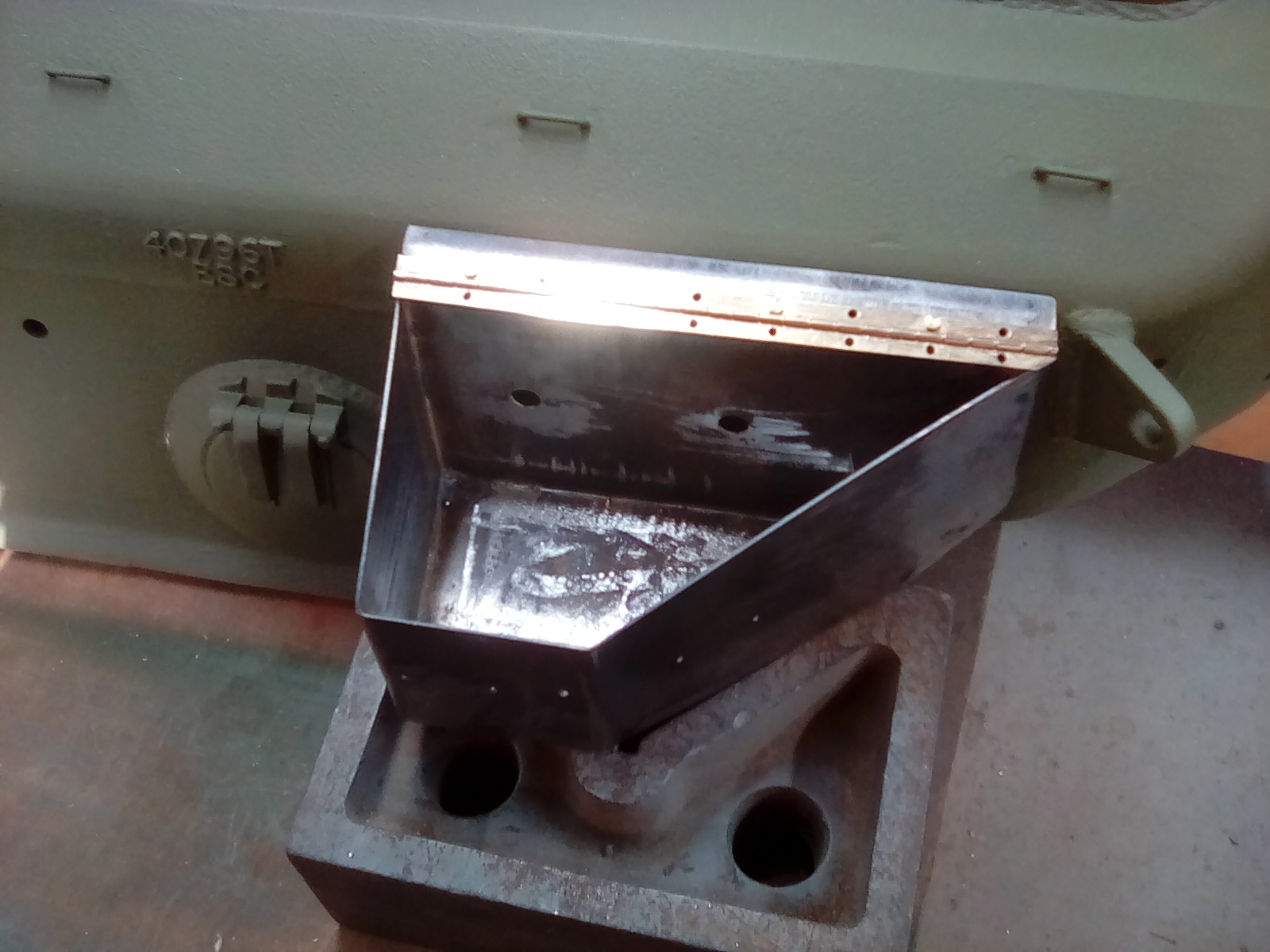

There's just no room for the fixings on the bin side, this is due to the top angle and radius

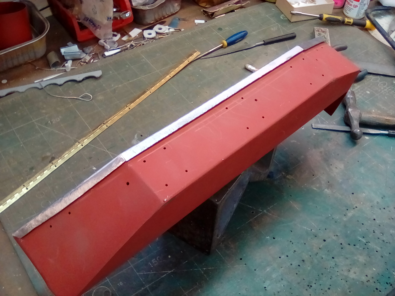

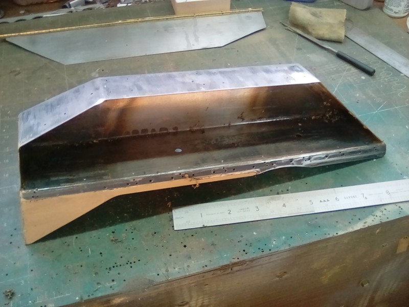

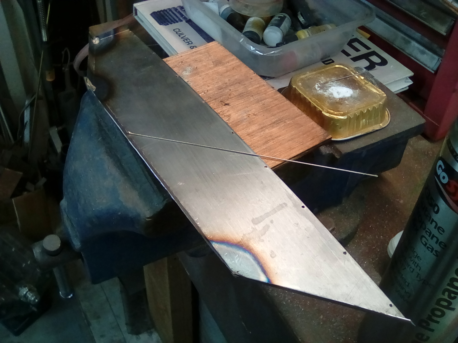

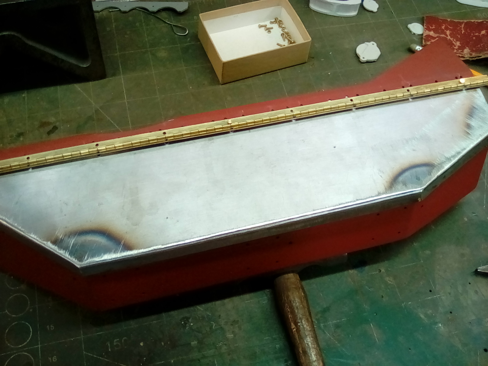

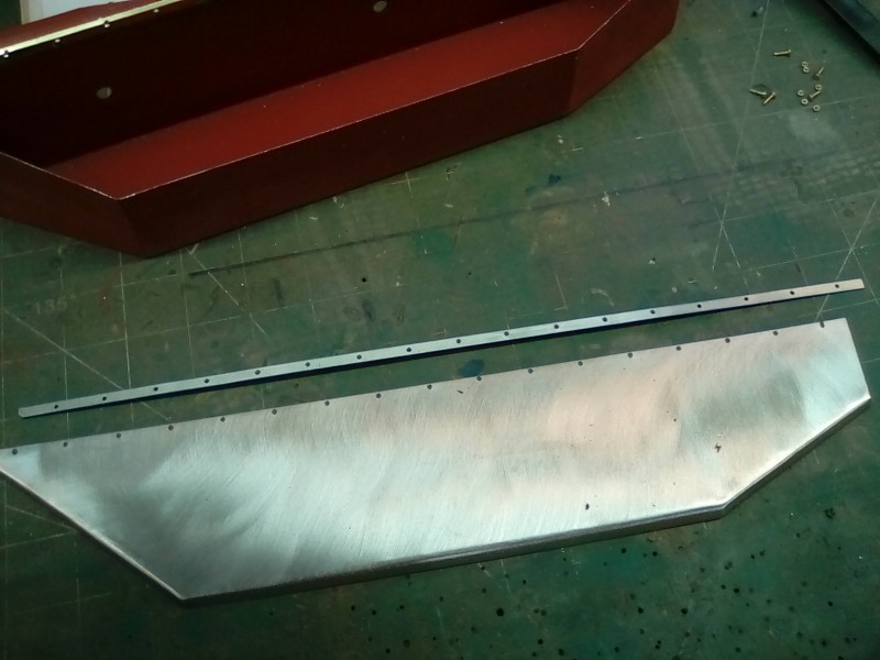

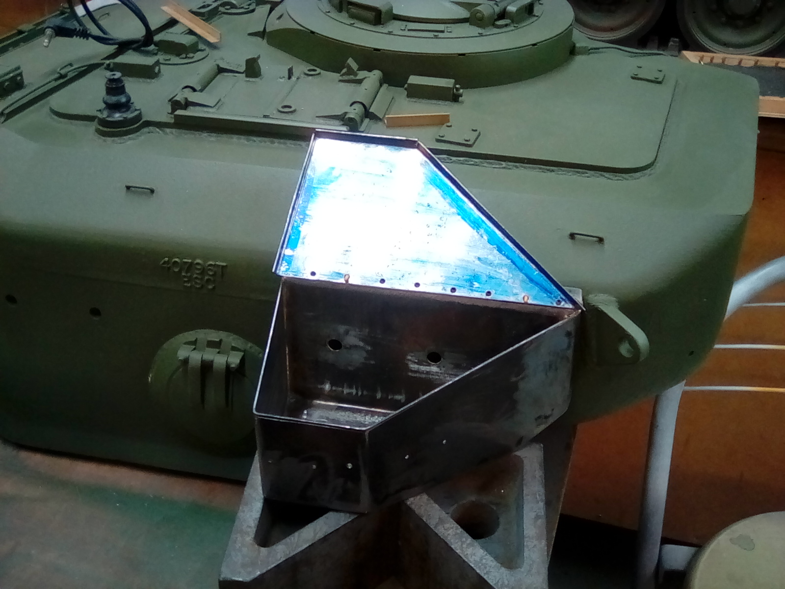

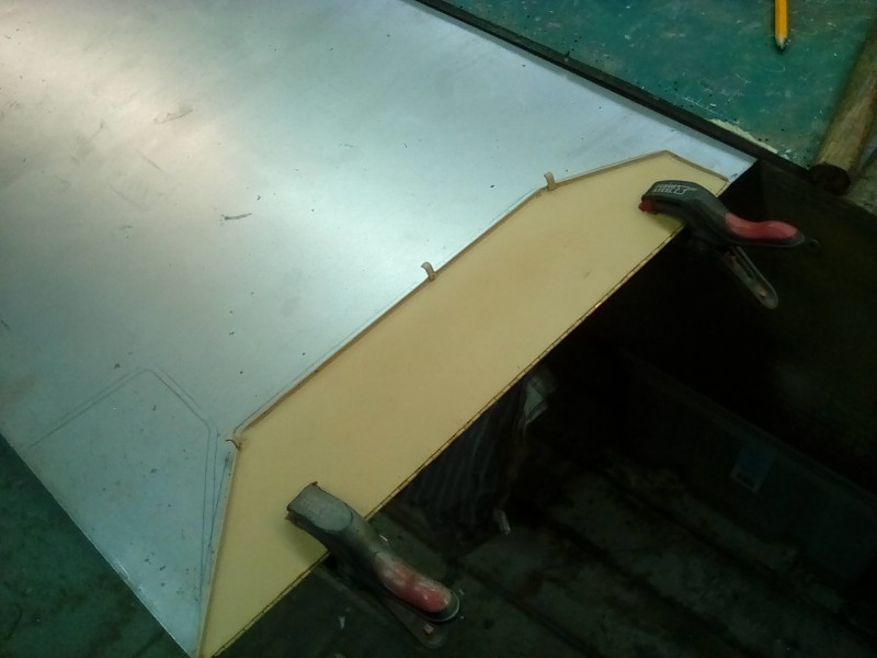

New steel lid cut out

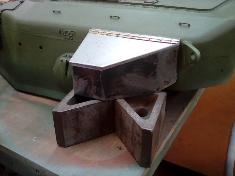

Tin work drop sides bent by hand again. I'm now happy with the fit although it's been a complete bugger, the tin work is designed for a 12mm hinge but to keep it scale we have to use a 9mm and that's where the problems start.

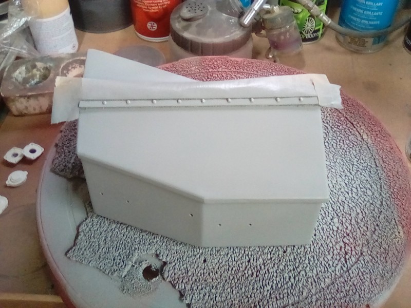

A thin layer of primer to stop any over night corrosion

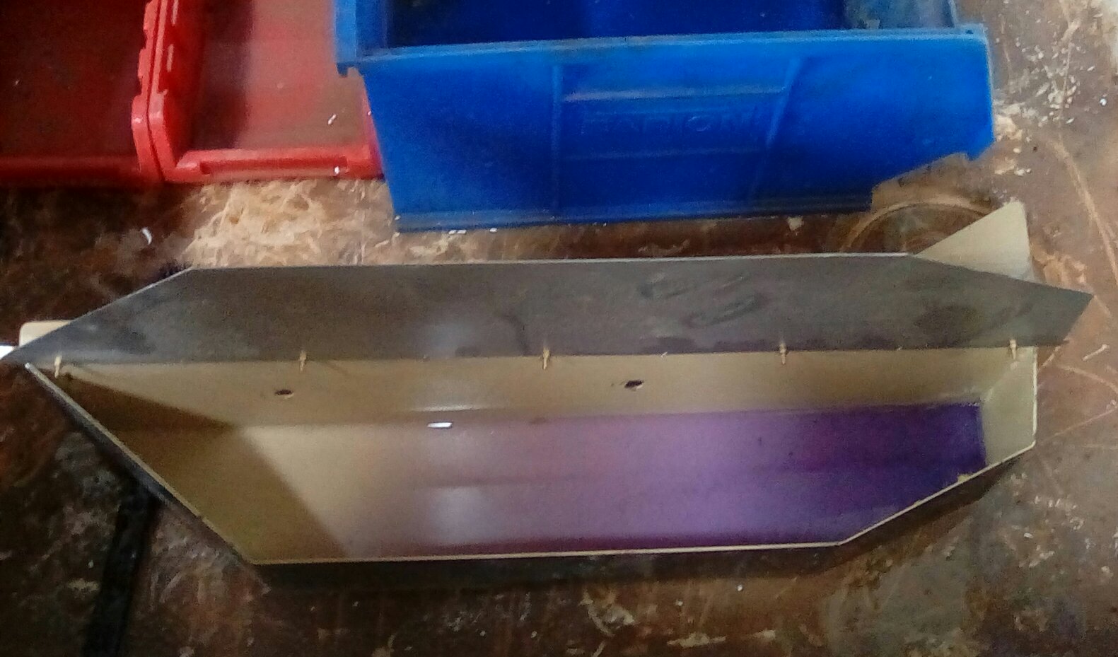

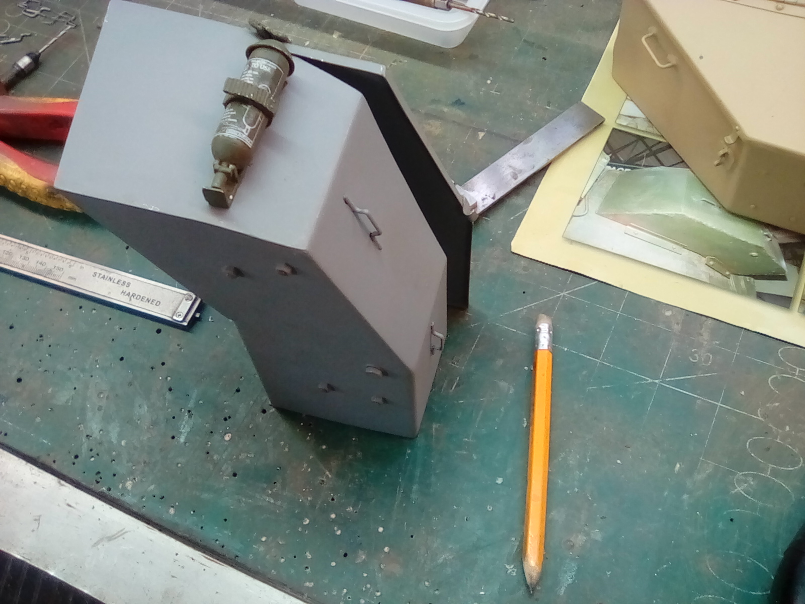

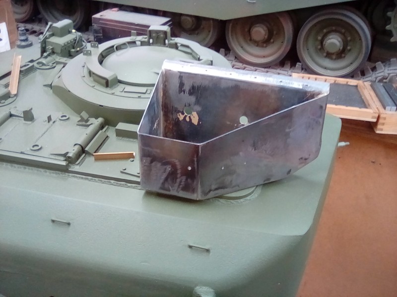

The winky pot, we are going to need to either find or make the older style " bee hive"  dome for this as the flat top section is not correct for the period. The dimensions are 18.5 OD, 15 ID, 25 high and tapering to 17 at the flat top, I have seen period " bee hive" panel lamps, anyone have a spare?

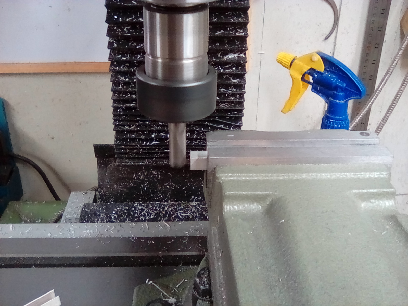

Milling the mitres
Milling the mitres

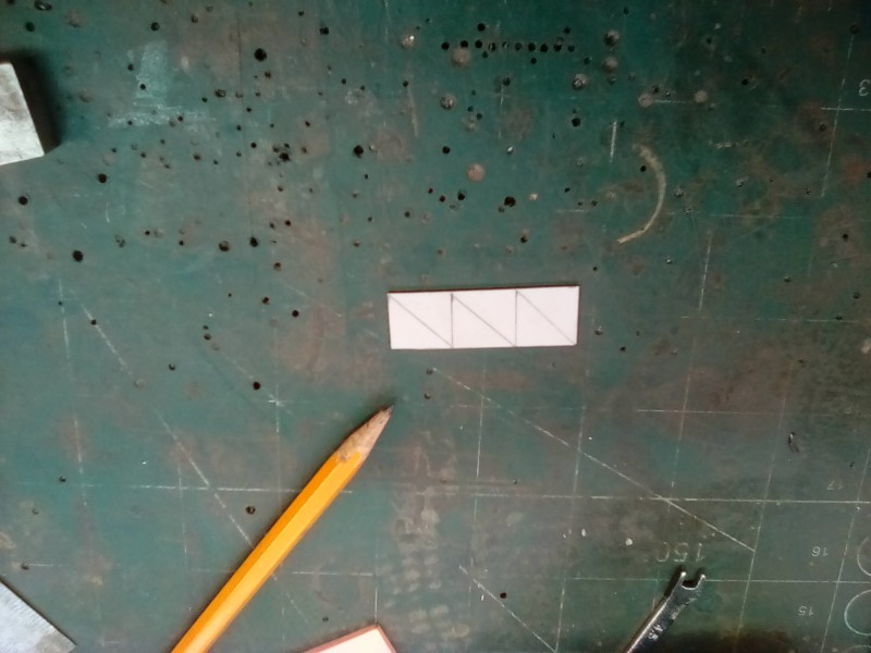

Card for the gussets

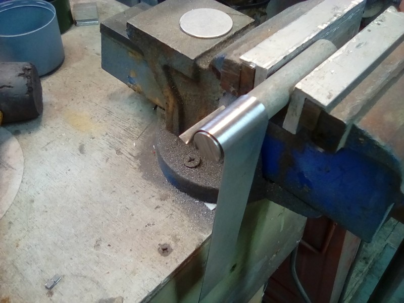

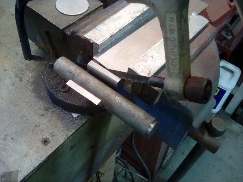

Forming the roll
Forming the roll

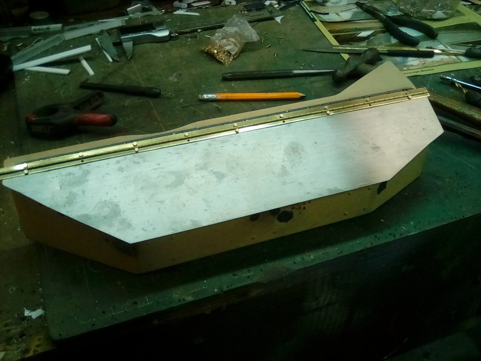

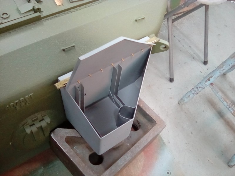

I suppose there's a lot going on in that small bin

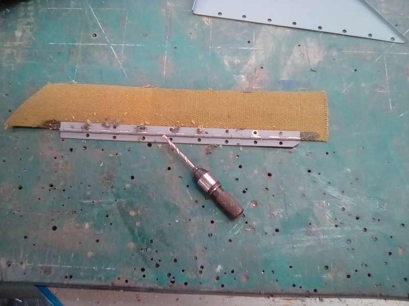

The cyno hardening allows me to drill away happily

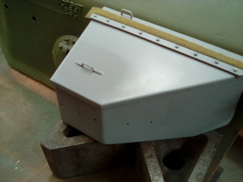

You have to wrap the canvas over the back hinge and fix over the front
Using a pointy thing to locate the covered fixing holes

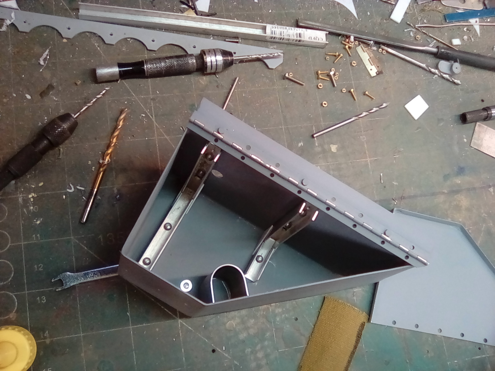

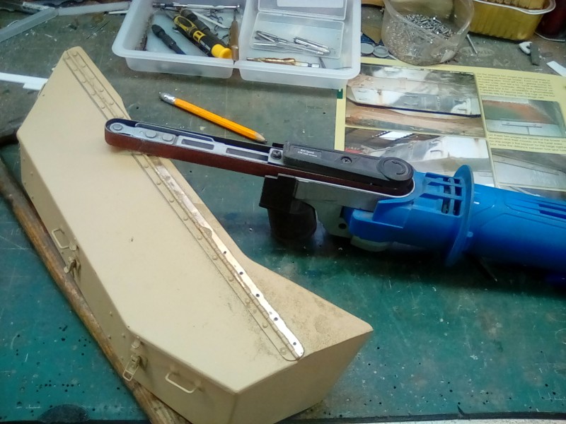

A bit of hinge trimming required, take out each of the tiny bolts and form rivet heads on the lathe, make and fix the tarp rings and straps, the tie down/grab handles to the front , fit the new latches, make and fit angle iron underbin supports and the stand off fixings and we are done, oh and the fire extinguishers and apply the top coat, quite a lot still to do!

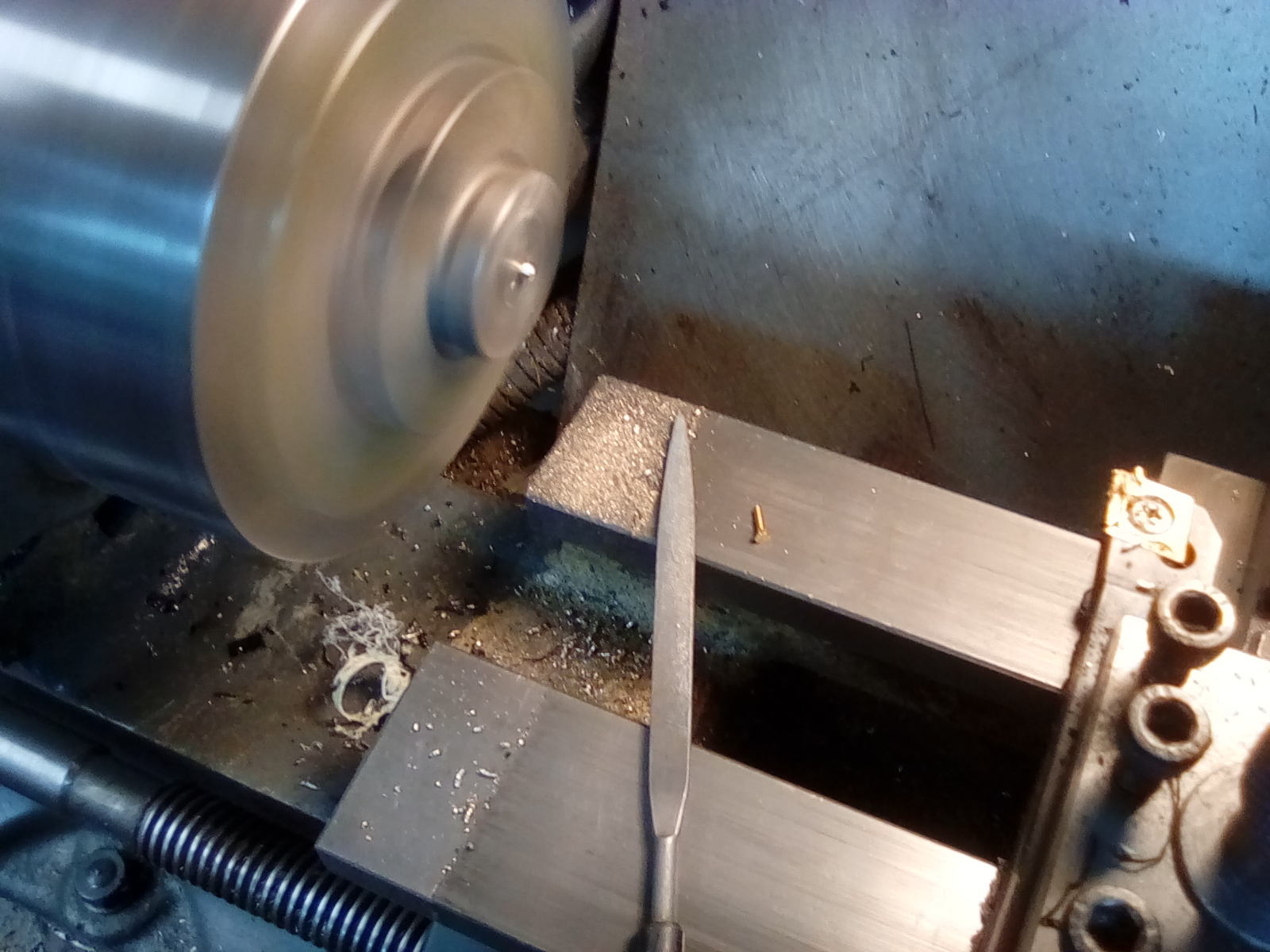

Now I know it doesn't look like I've done very much but I have at least perfected the tricky welded webbing loops along with the grab handle welded loops.
A pin drill collet is great for holding the tiny 12 ba bolts
All the tiny 12ba bolts turned into rivets, well this side anyway.

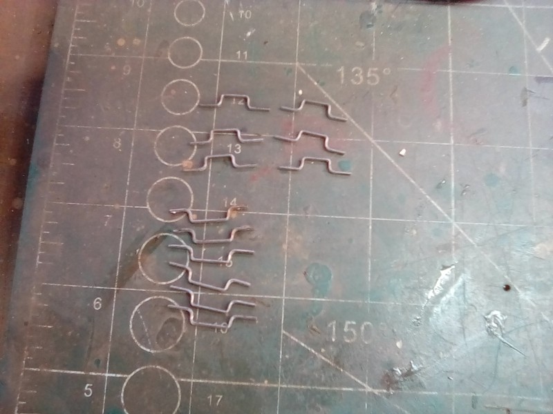

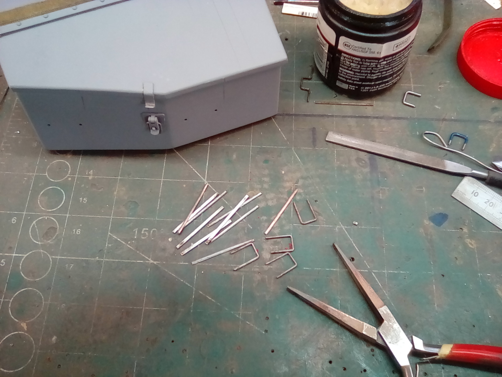

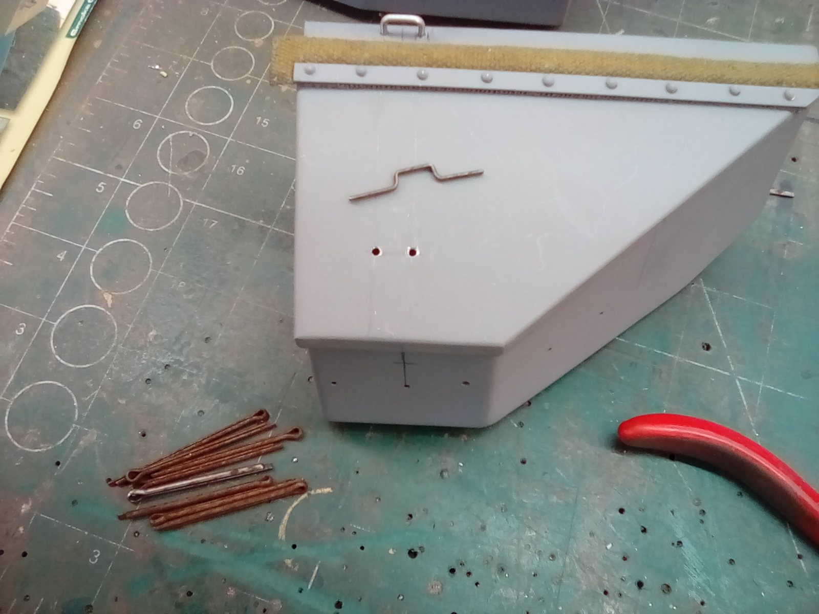

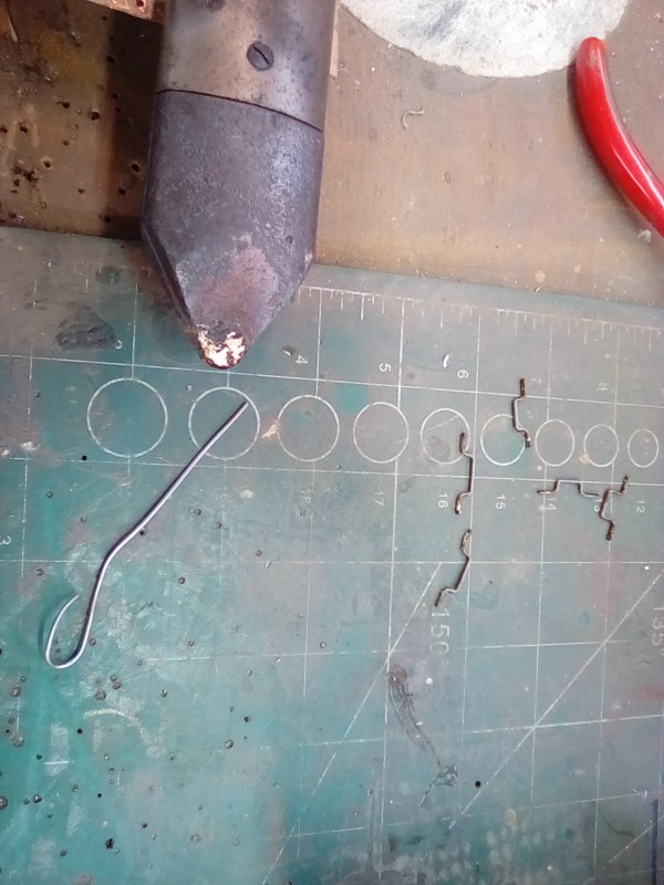

I looked everywhere for suitable wire for the handles, turns out split pins with their flat section are perfect for the job
This tool is great for the hard to get at angles
Old Smokey my big soldering iron will be easier than the chefs blow lamp

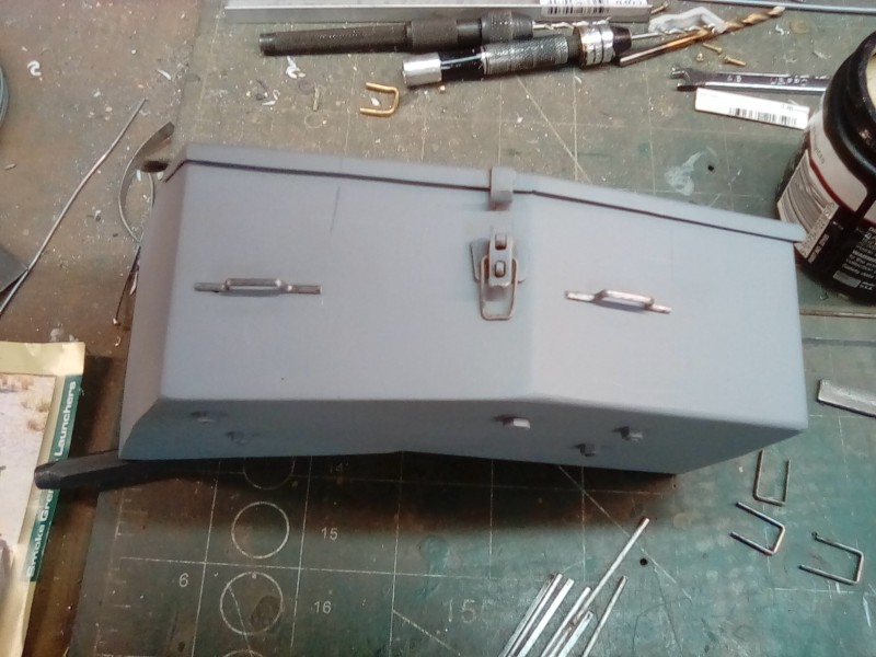

Slightly wider grab handles
I'm really happy with that look
Soft soldered and very strong with the nice flat section giving just a bit more surface area for the solder to stick to.

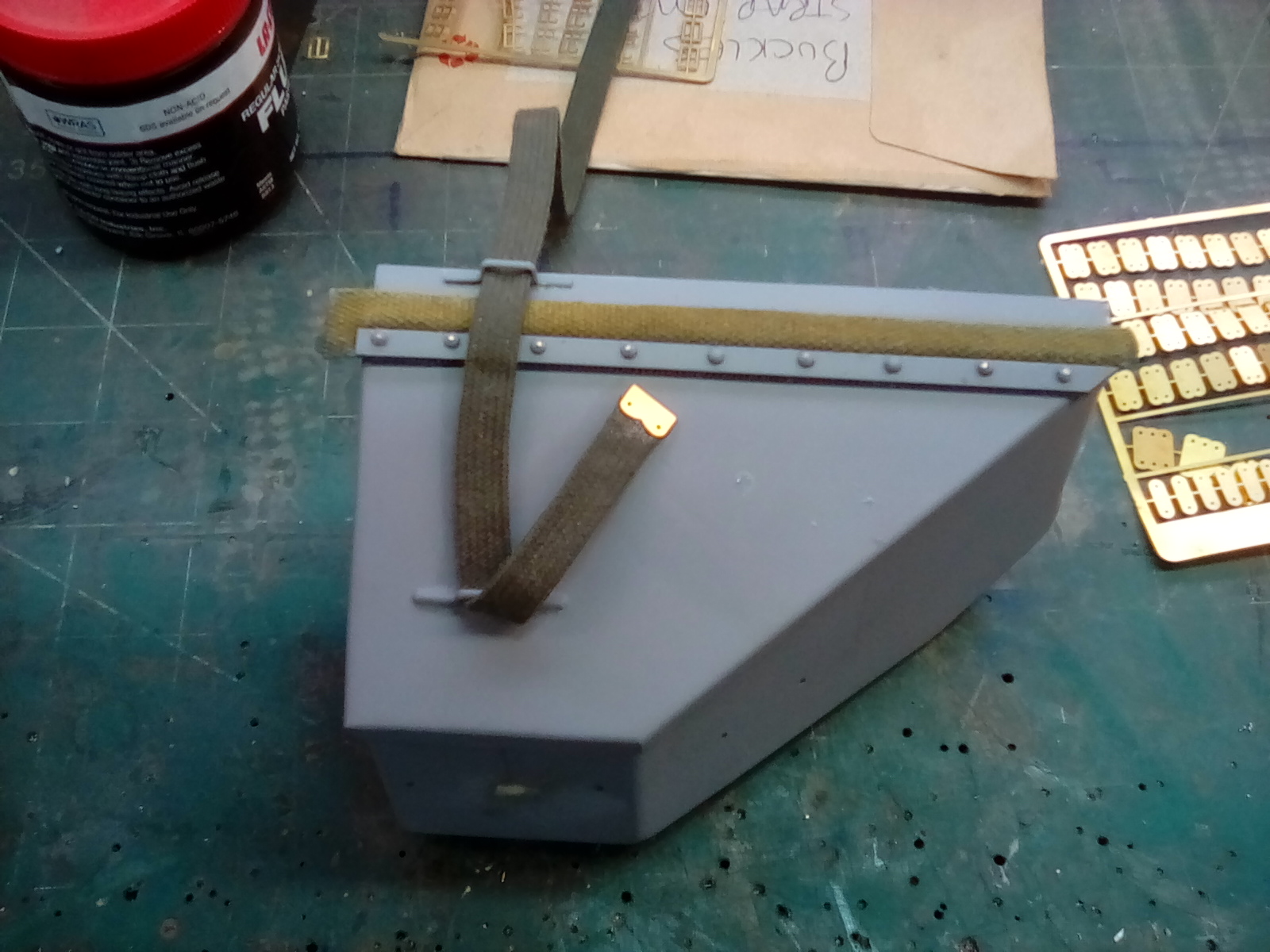

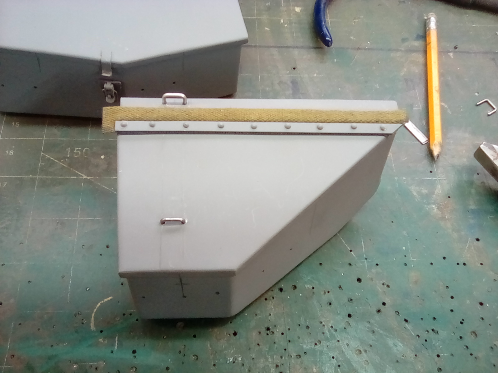

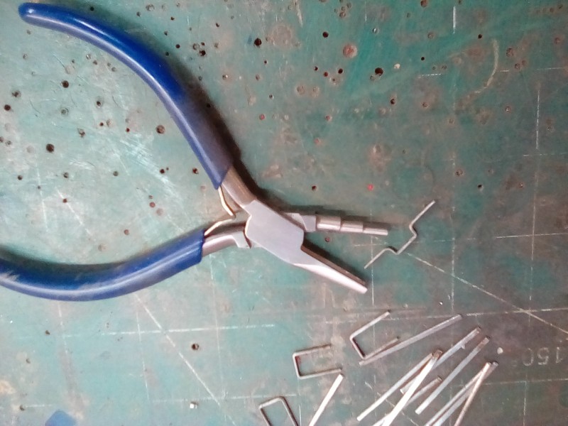

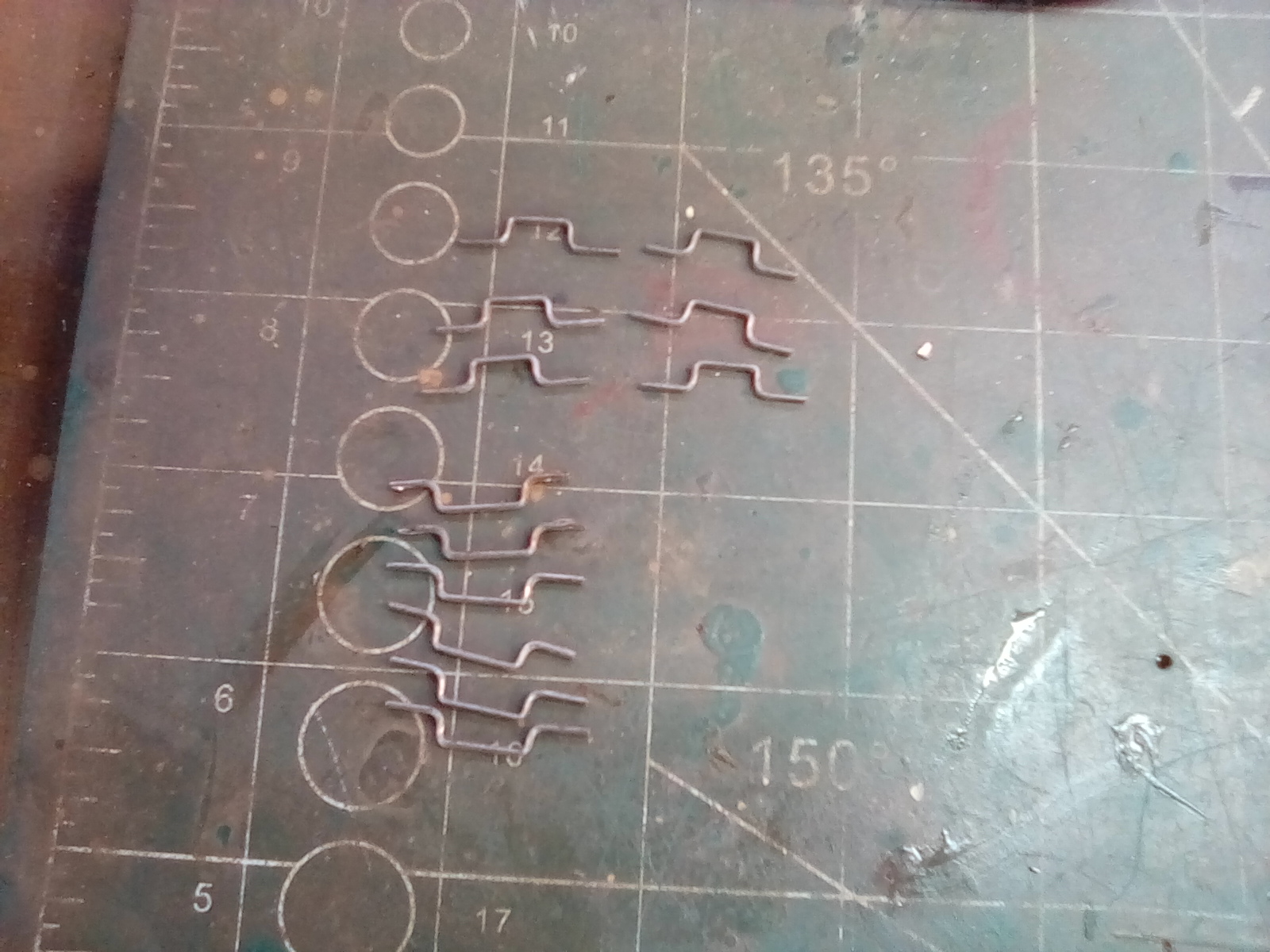

I've now bent up all the handles and the strap anchors for the big bin
We all know how to put these together
I'm happy with that
I'm happy with that
The straps will of course get in the way when it comes to the top coat

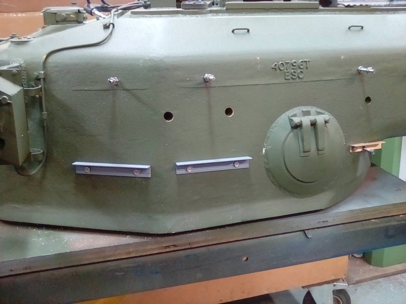

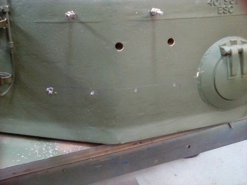

I think these mounting bolts need replacing
Careful drilling and tapping

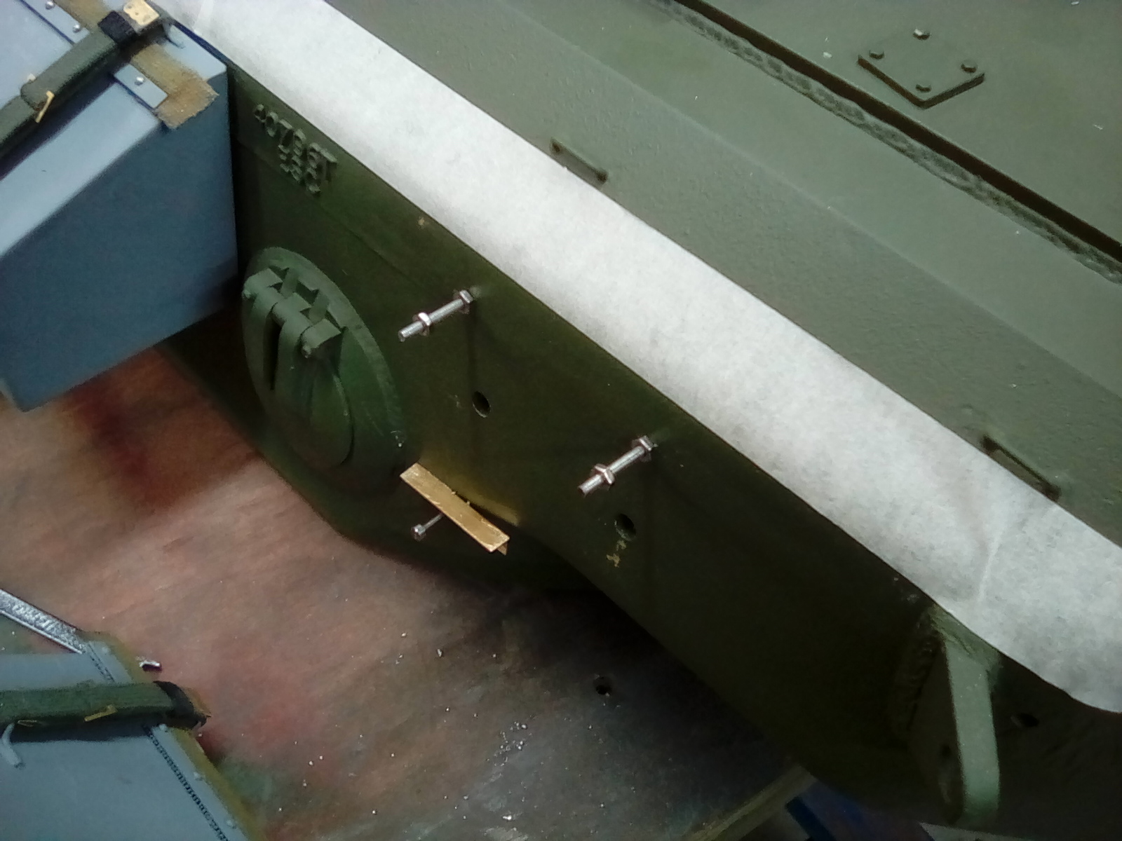

Two sets of nuts, the inner to lock the stud and the other to set the stand off gap.
The correct stand off gap
Getting the nuts started may be a faff
How will the bins mounting holes fit over the angled bolts I hear you ask
That front bin will fit with a little fiddling

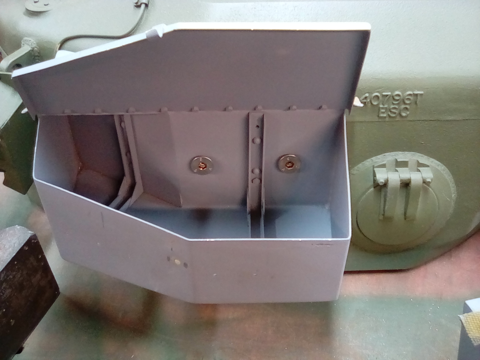

Re: Mr Dawe's Centurion.

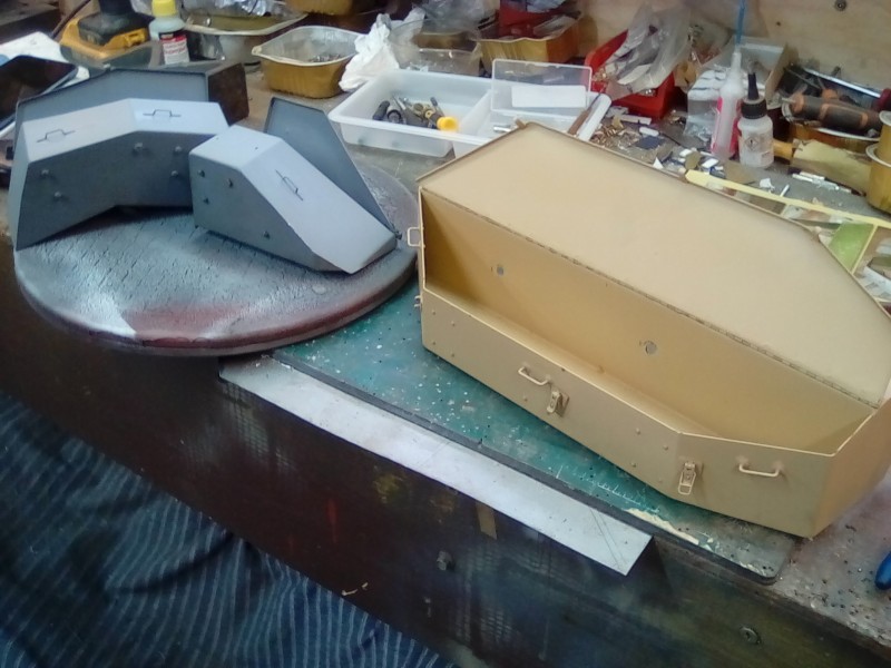

Almost done for the nr side bins
I really wanted to get started on the long bin but still have the odd job to do on the small bins

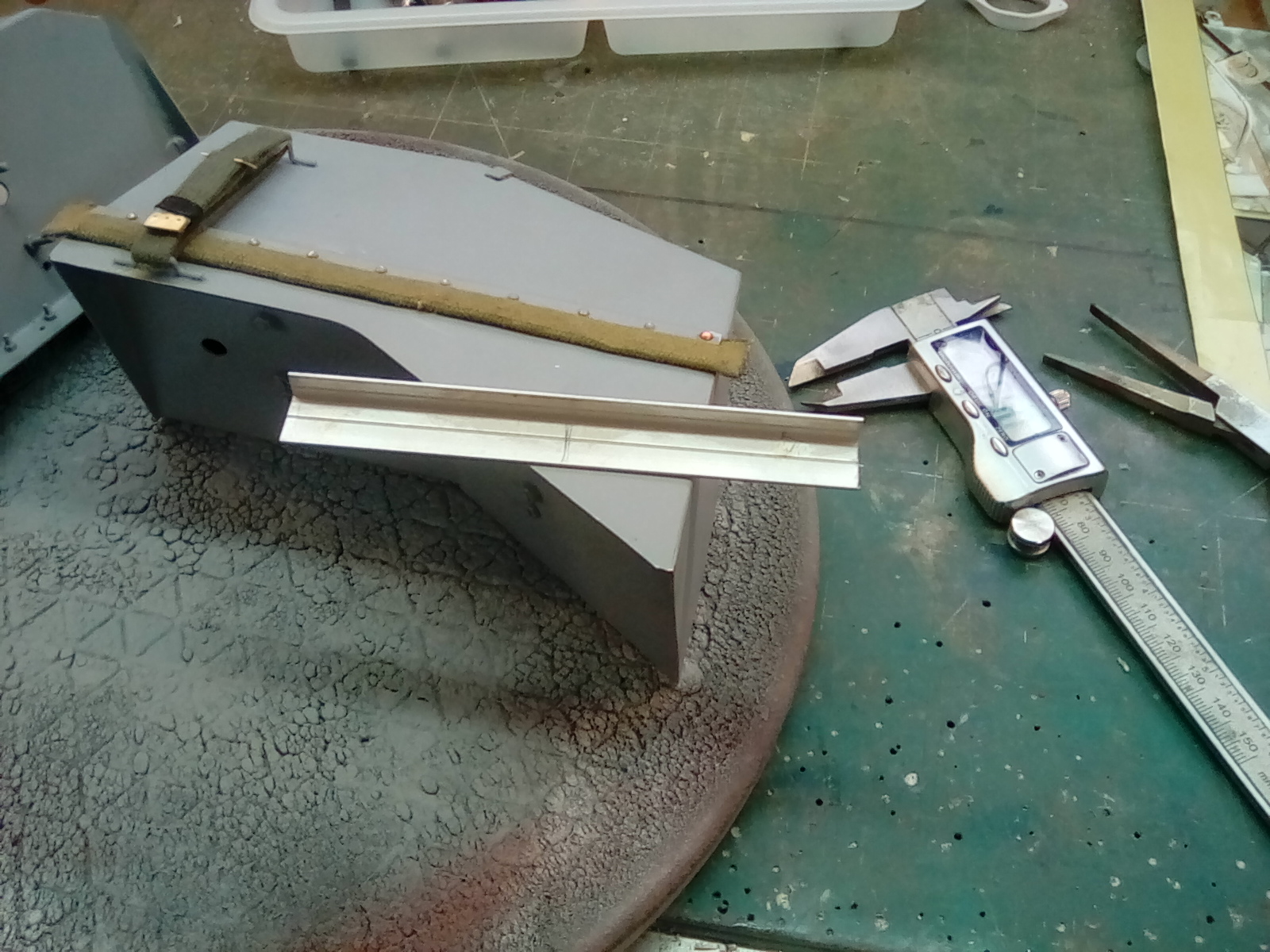

I don't have any equal angle so I better make some
Bin support m2 fixings
Equal angle bin supports now bolted in placd

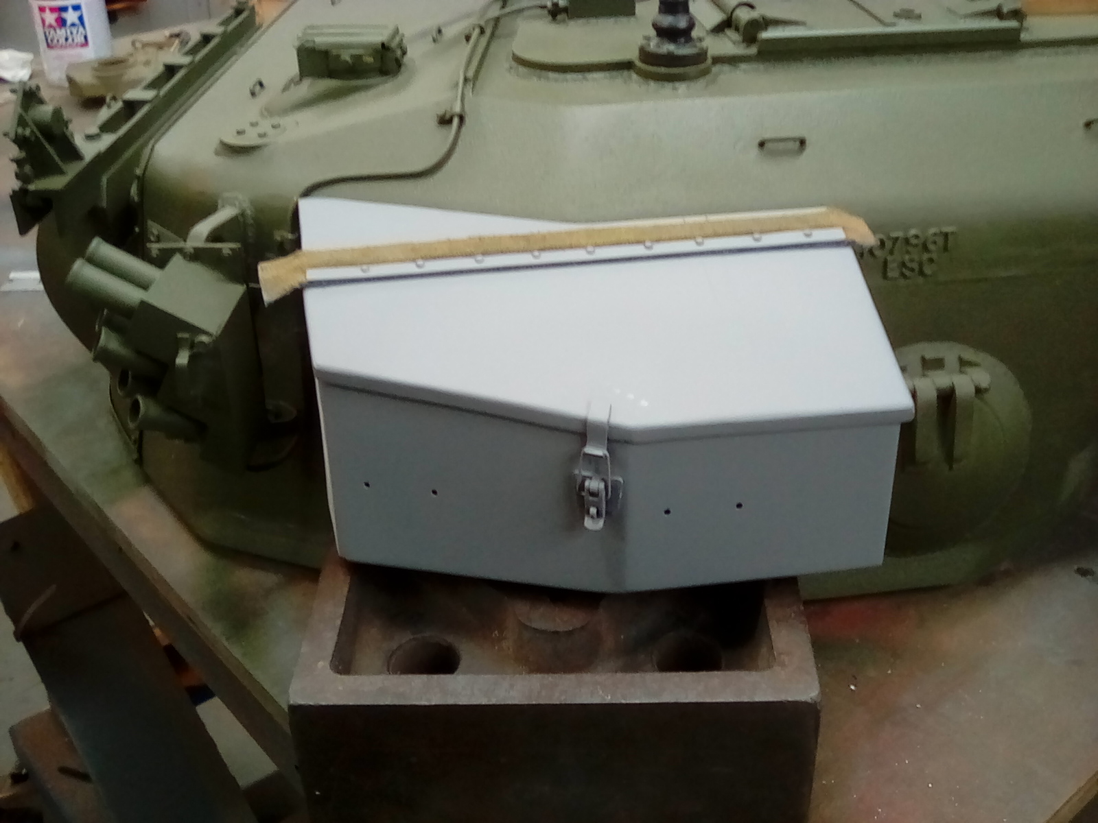

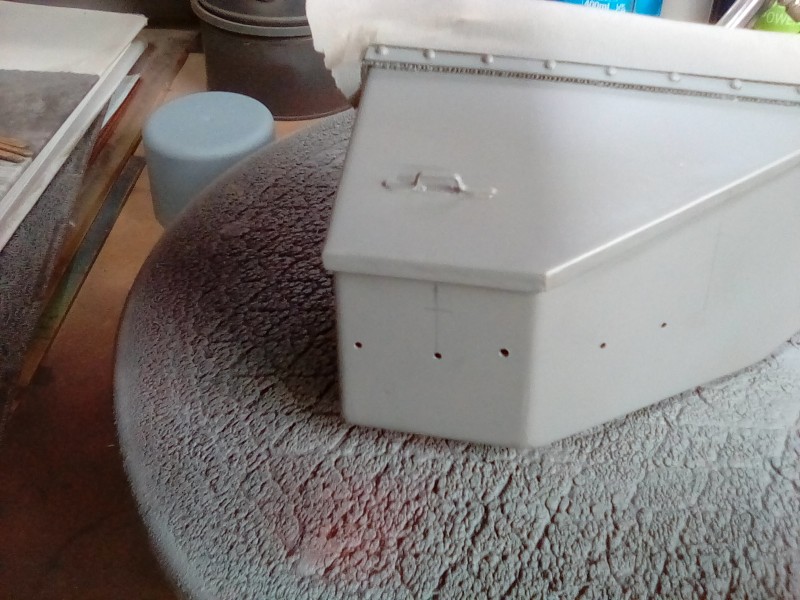

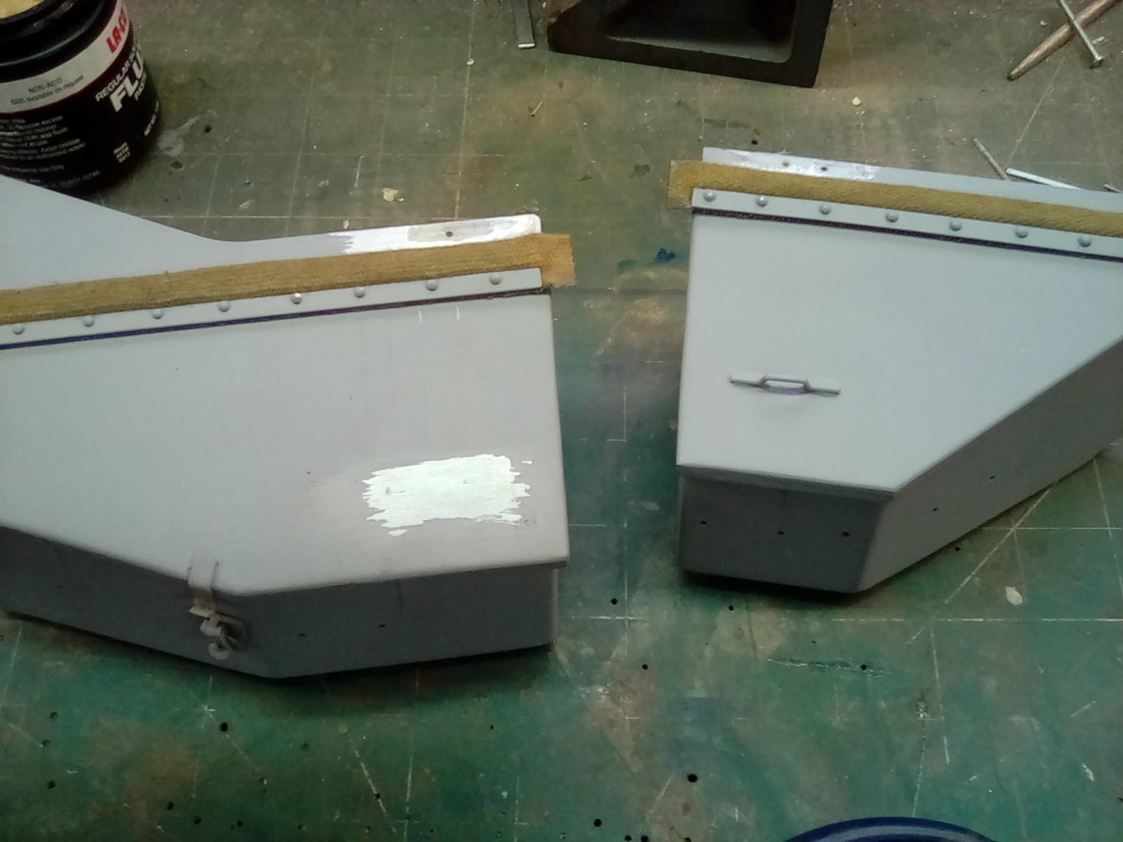

I best not top coat the bin lids just yet until I have soldered the new catches which should be arriving very soon

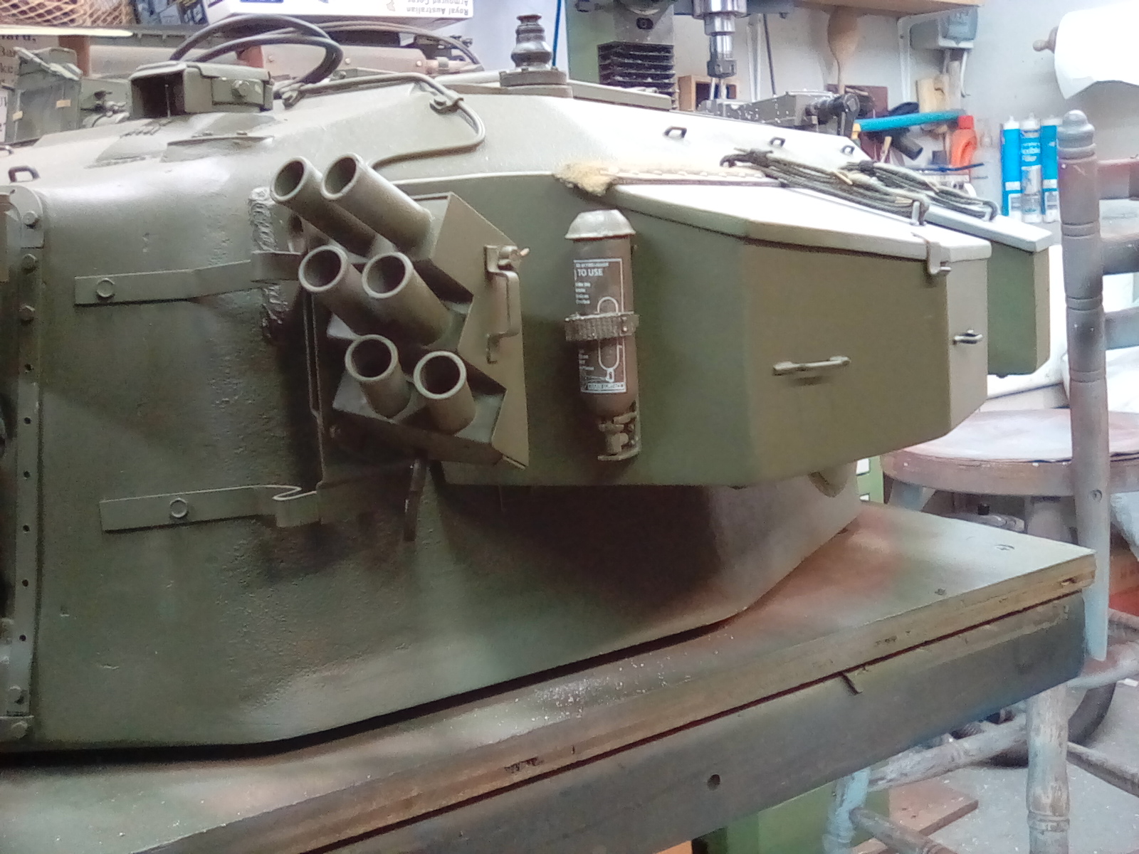

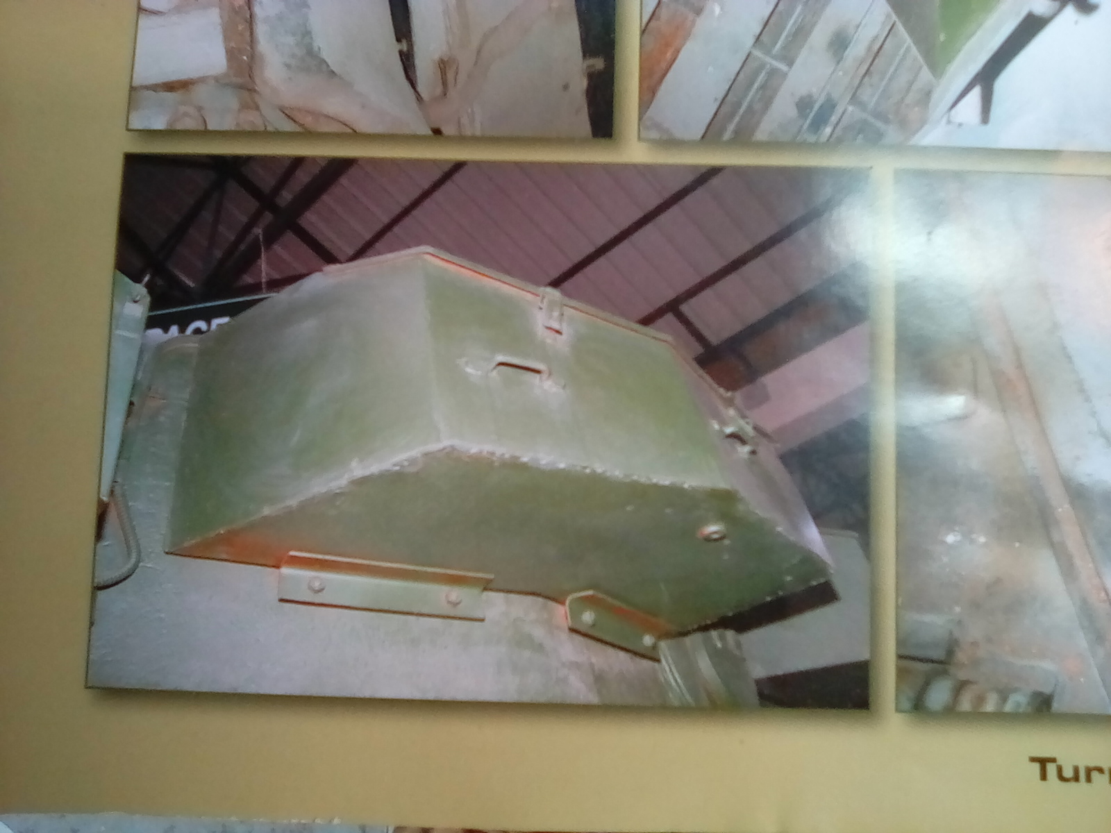

Now some vehicles did have two fire extinguishers mounted here

Marking out the new steel lid
That's better
That's better
Lots to clean up inside and out
More tin bashing
More tin bashing
It's fighting me again

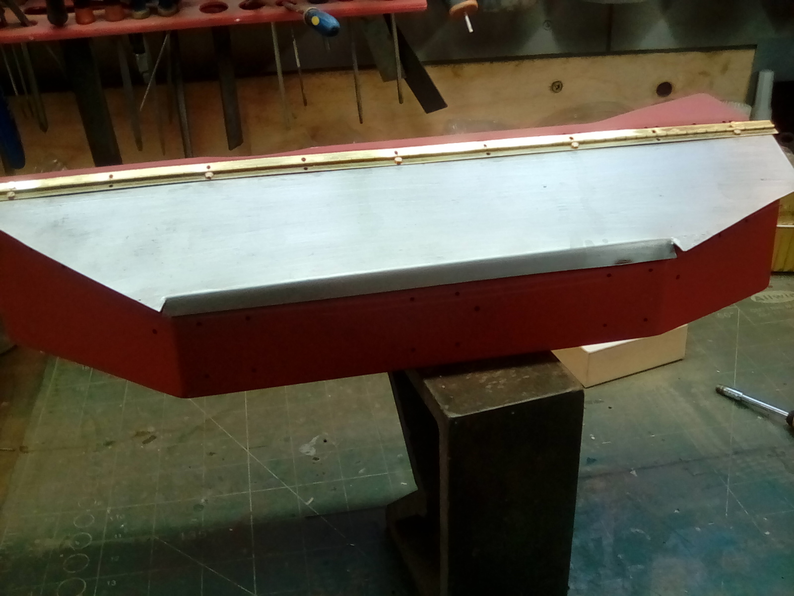

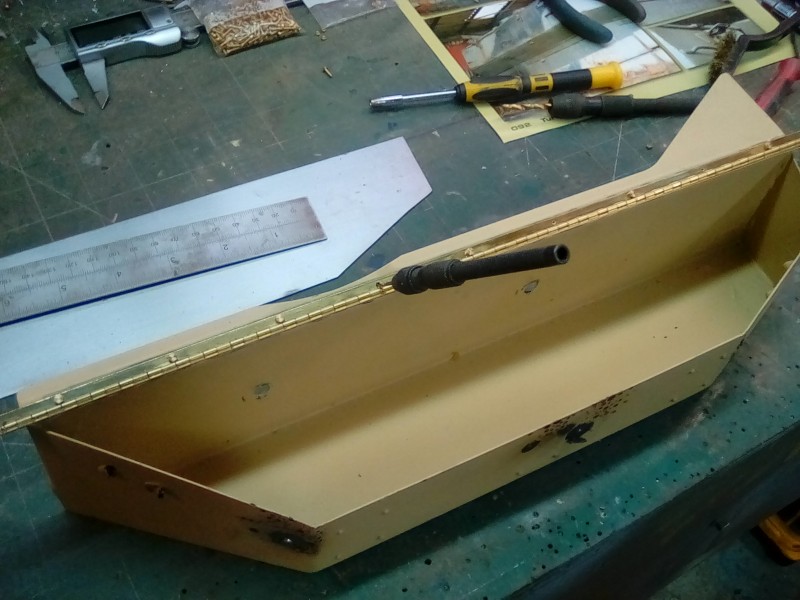

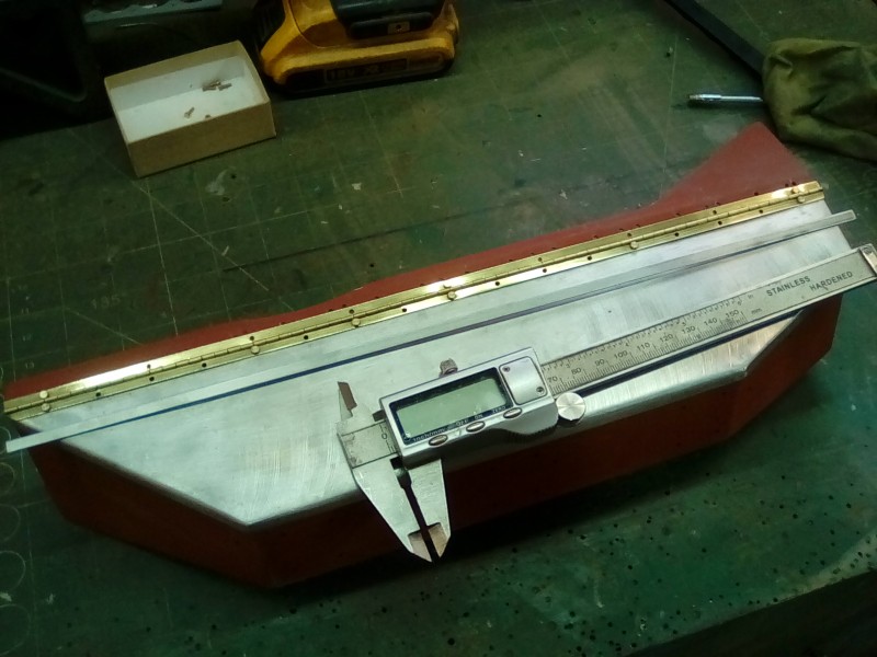

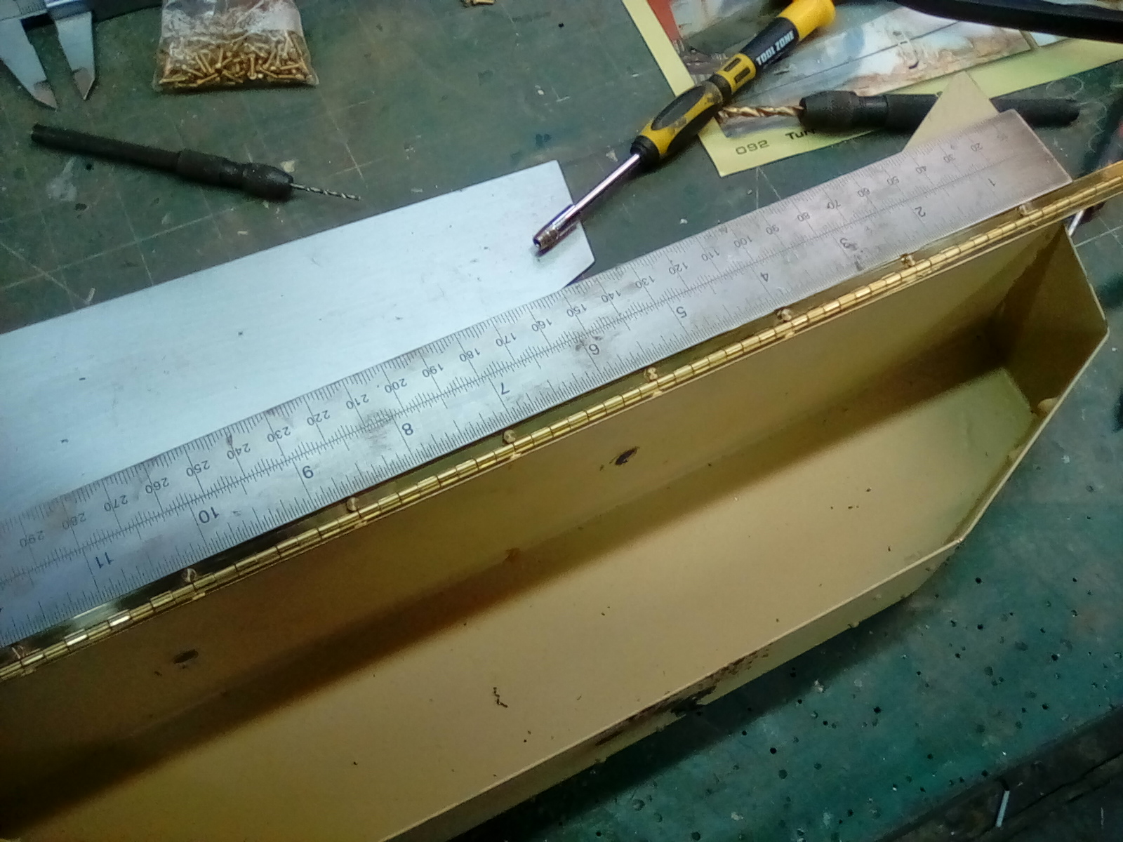

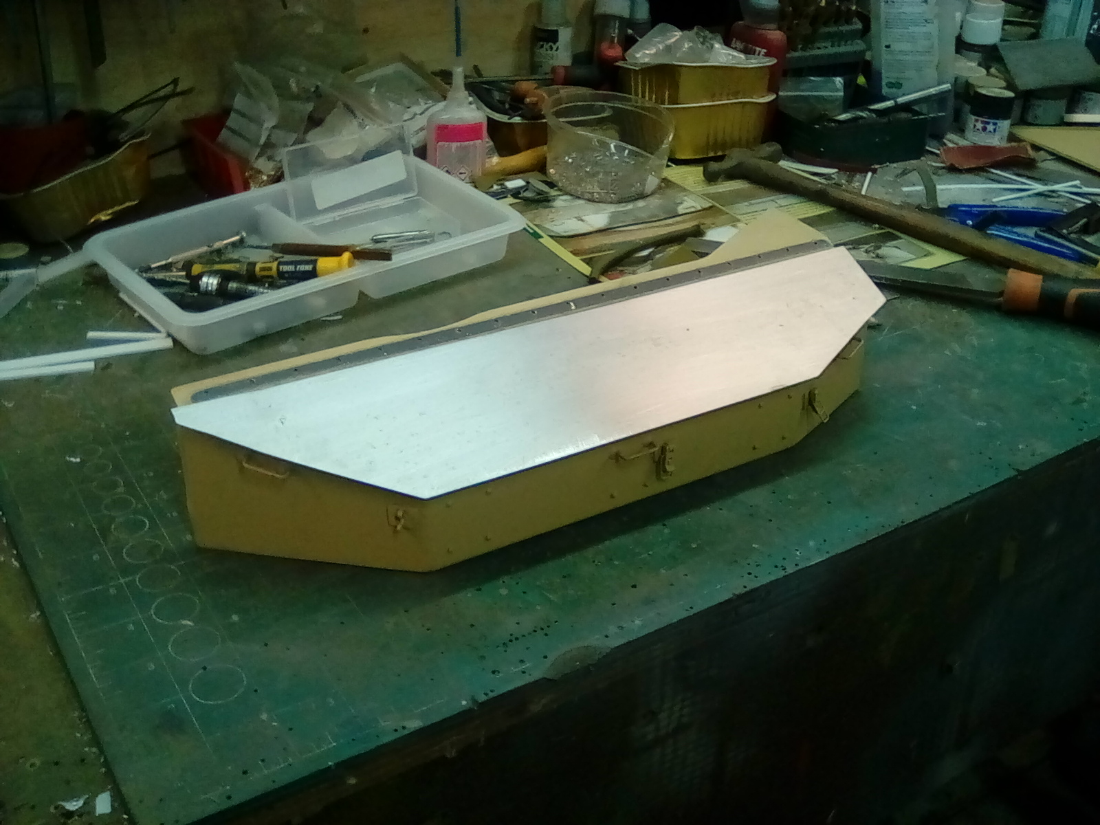

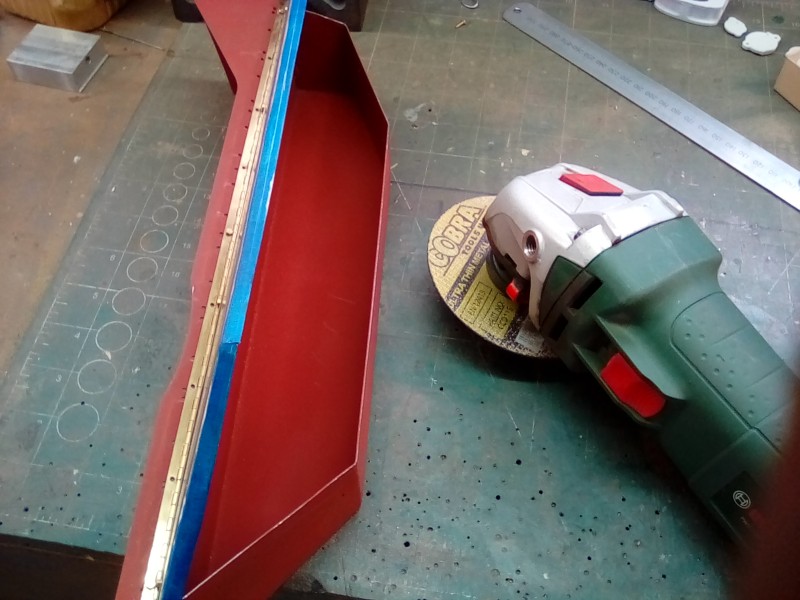

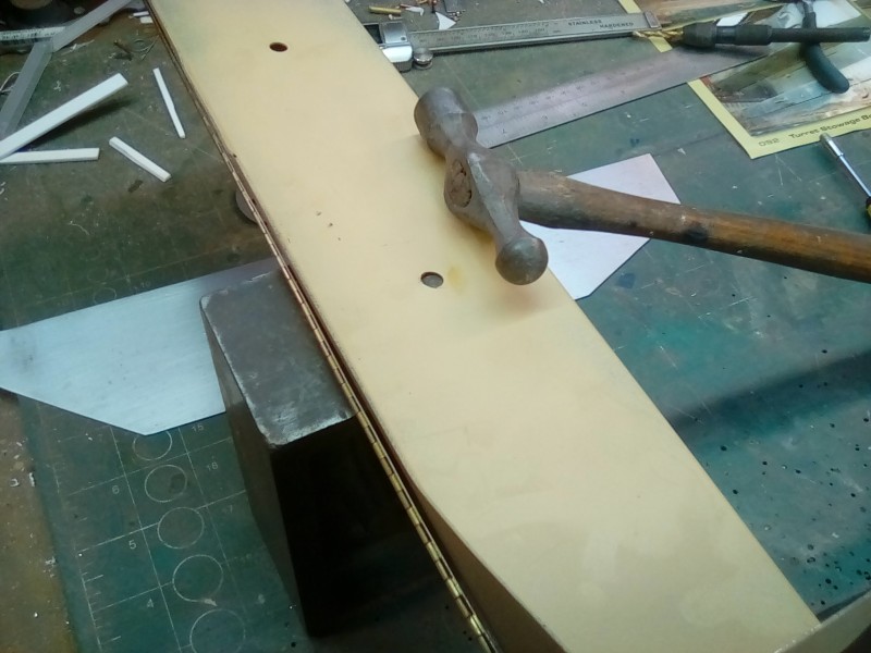

Use a straight edge to align the flexible hinge
If you take your time and it lines up nicely it will raise and lower without any binding

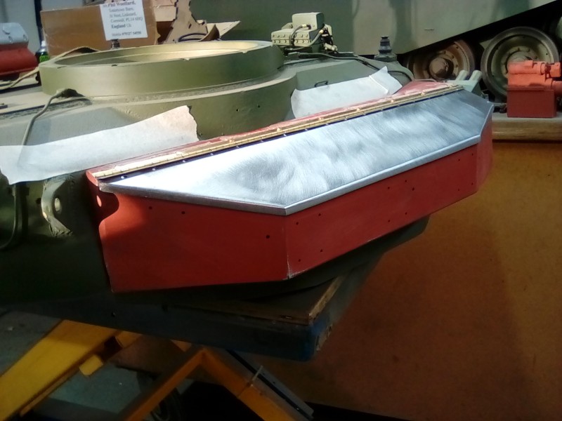

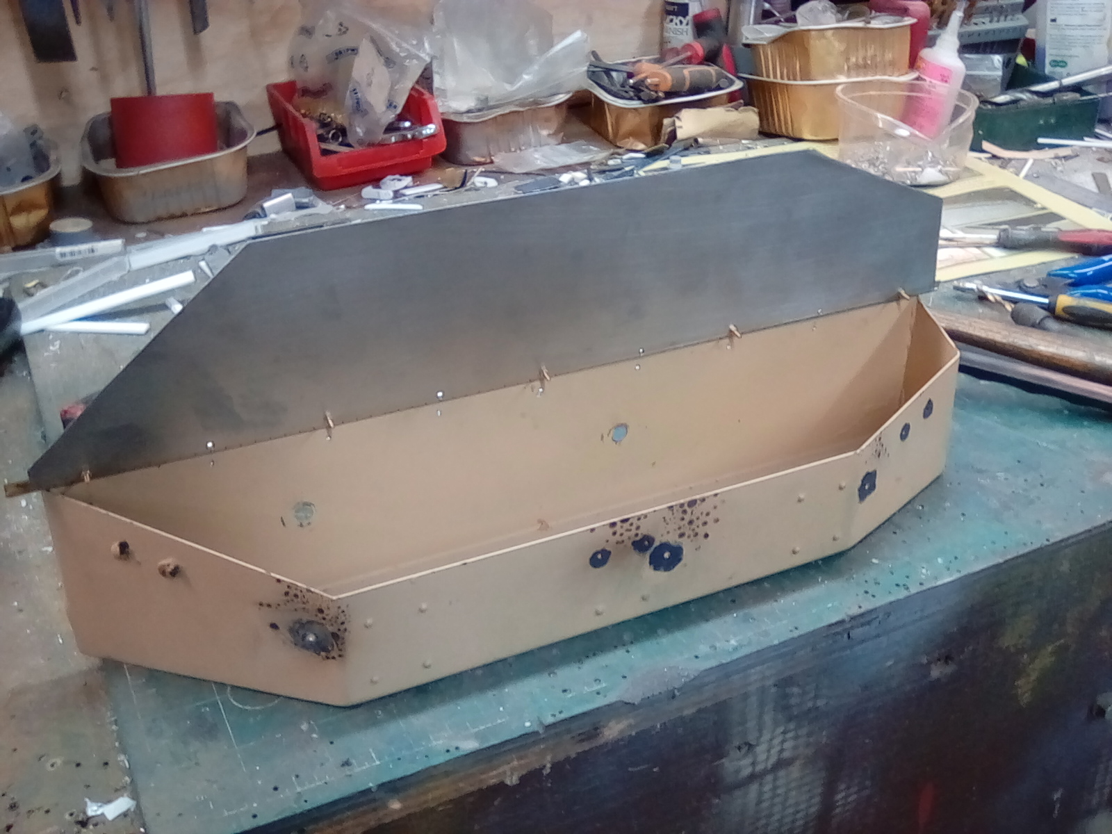

I'm happy with the new lid for now, I've left plenty of material overhanging the bin, this can be trimmed later after bending

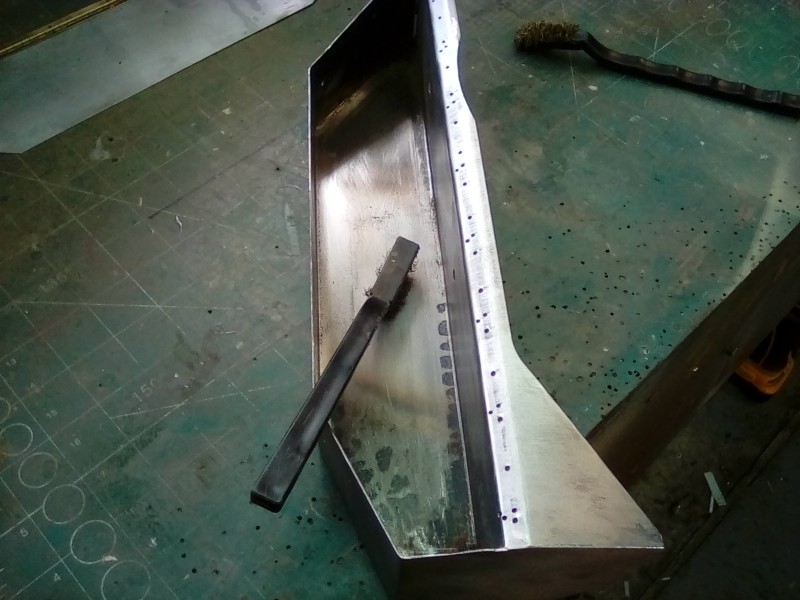

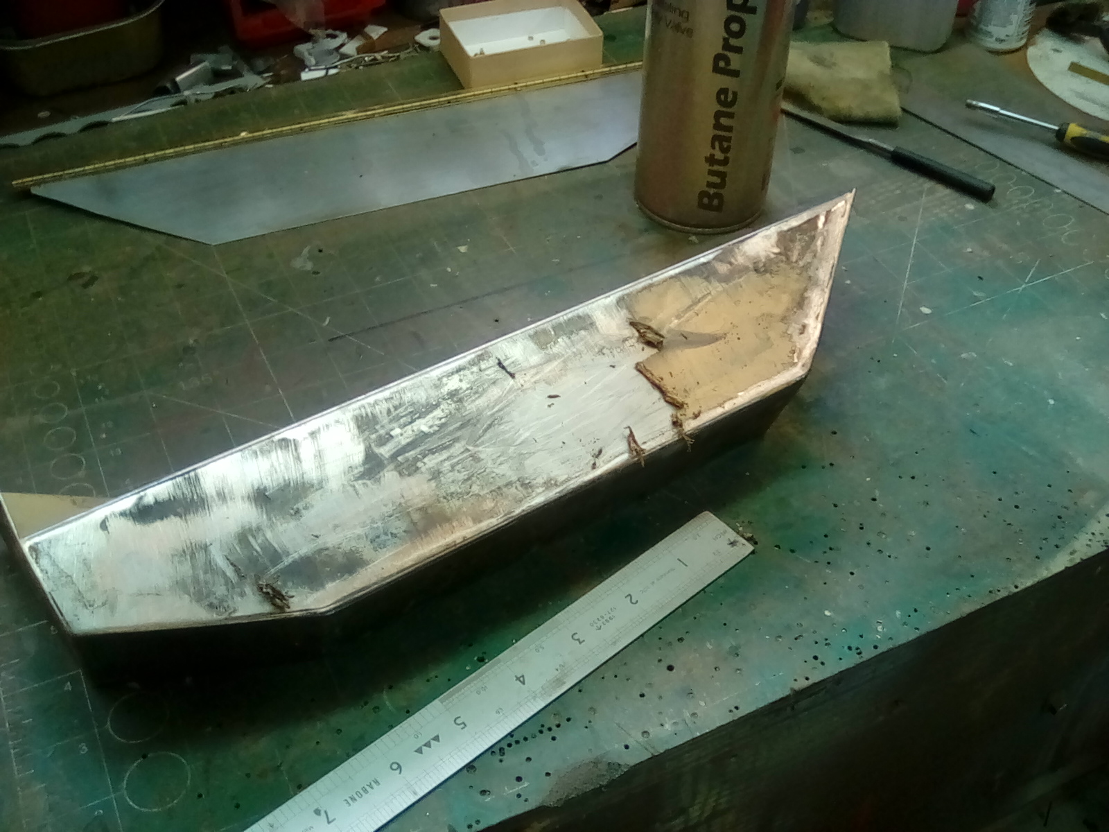

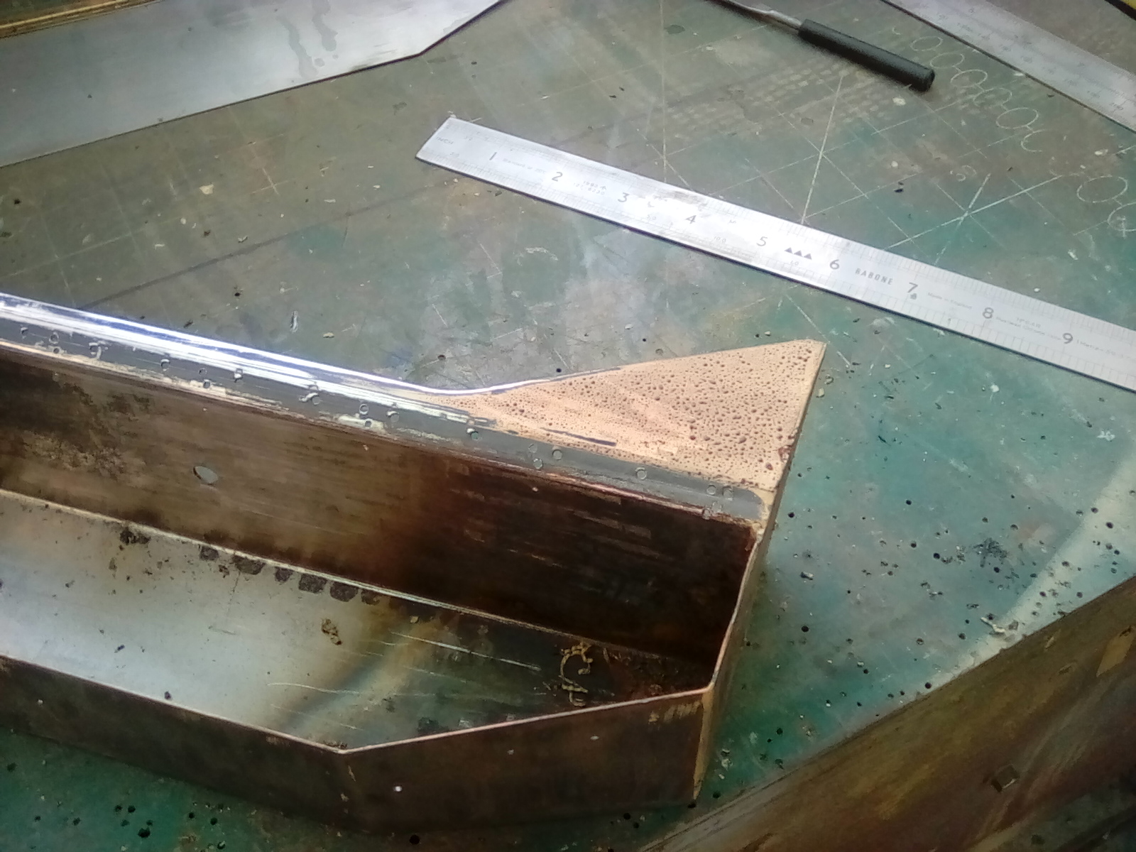

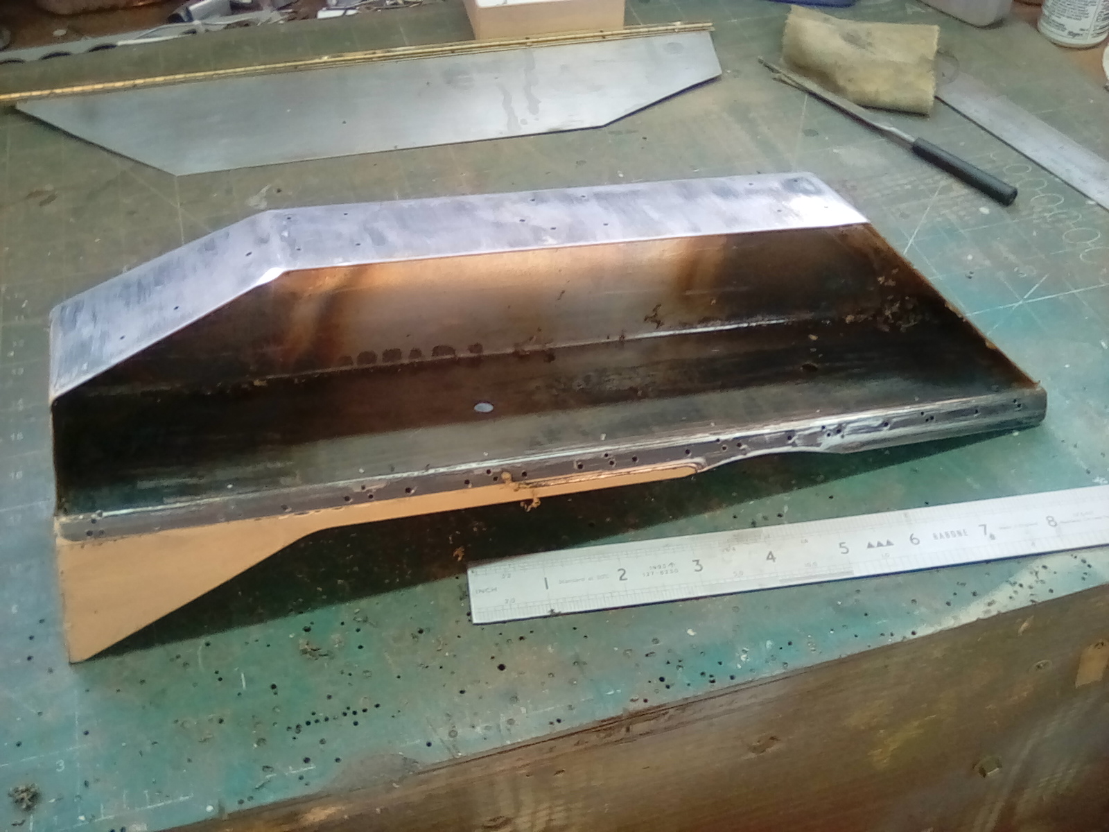

Finding and removing the rusted areas
A soaking in meths
A soaking in meths

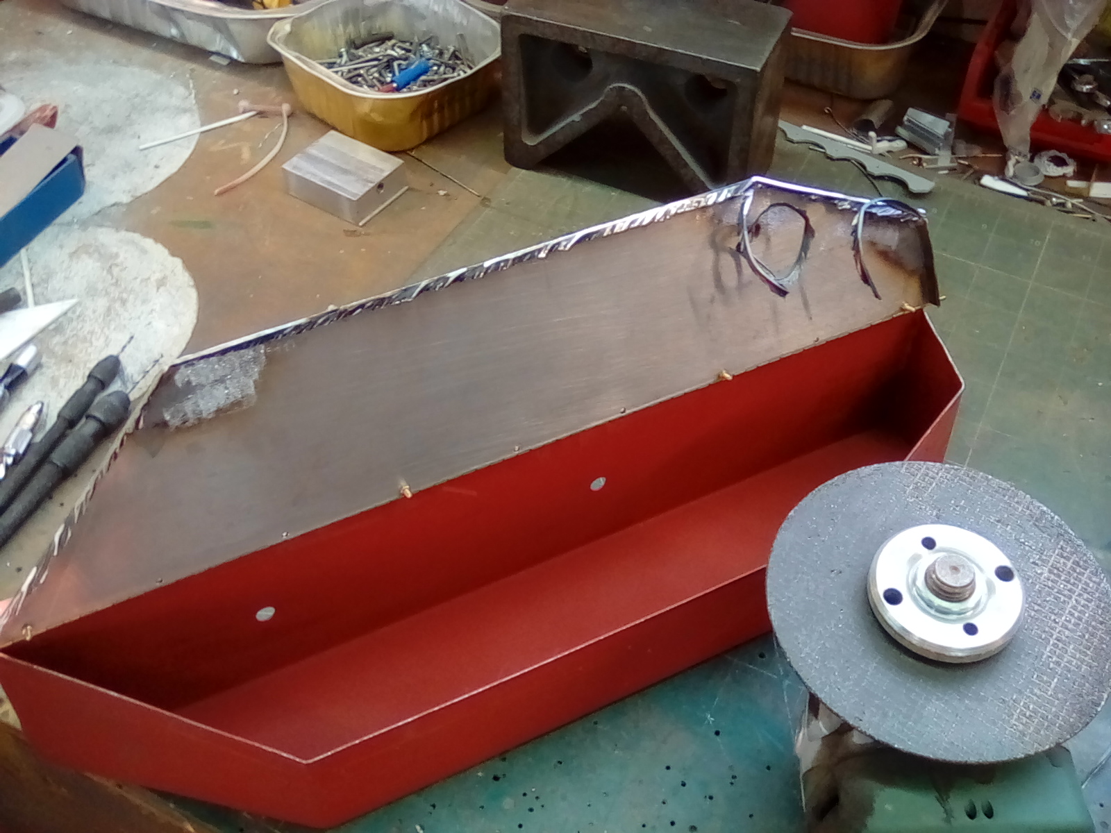

Paint removal and the steel lid bent up.
A little heat to help remove paint in the awkward to get to areas
Using my best rule to scrape away the paint
A new wire wheel removes the stubborn graffiti paint

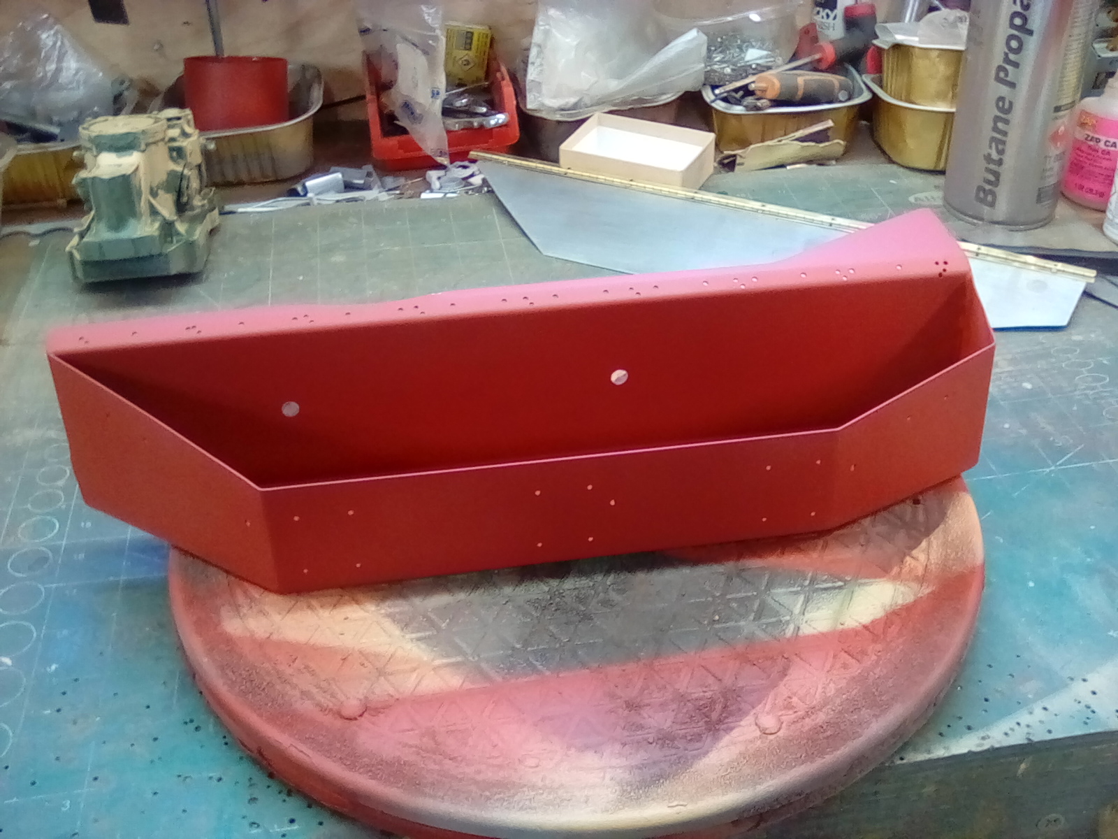

Red oxide to keep any corrosion away, even the acid on your skin will rust steel, in fact some apprentice engineers have to give it up if they suffer from "acid fingers"
I can't really tell people how to tin bash but just have a go, it's only metal.
The lower lid bent edges are ragged and will be trimmed down once I'm happy with the fit

Lots done to the long stowage bin.
Silver soldering the folded joins
All the joints done
All the joints done
It fits
It fits
I'm using the 100mm slitting disc to gently cut the spare material so I don't distort the folded sides
Now that's a ragged edge
Marking out this awkward piece
Bolting the canvas strap at either end so I can accurately spot drill the many fixing holes
Lots of 10ba fixing holes to be drilled
The canvas strap fixing piece all ready and out the way
Filling the old hinge fixing holes, this will of course need rubbing down
Red oxide to seal the inner lid , this won't really be affected by the soft soldering heat generated as I fix the strap anchors
It's nice to get this part out the way
Milliput filler in the old bin fixing holes
Marking out the cut out for the turret radius inner bin piece, there are two of these cut outs to do on this long bin.
