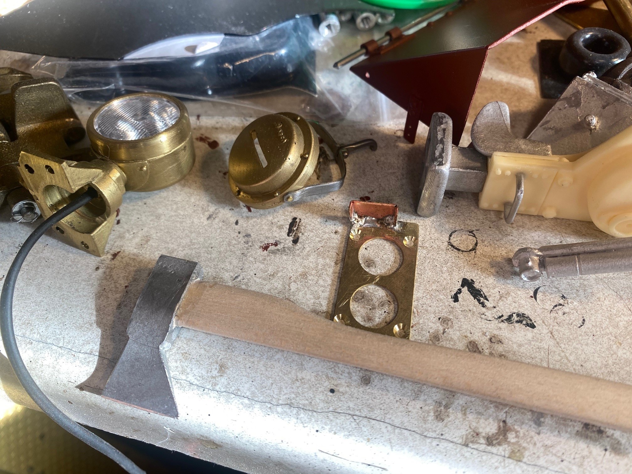

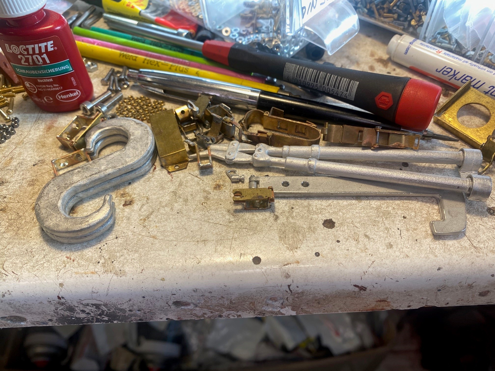

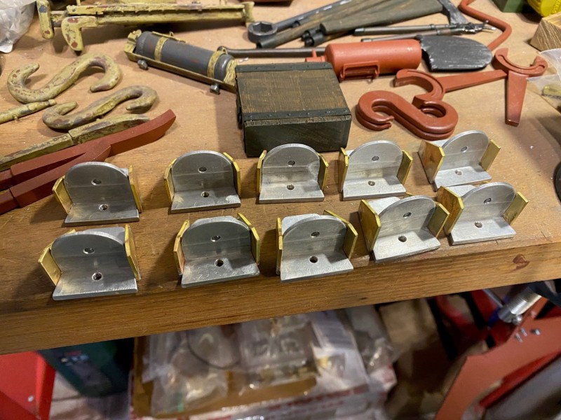

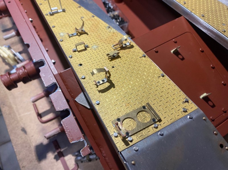

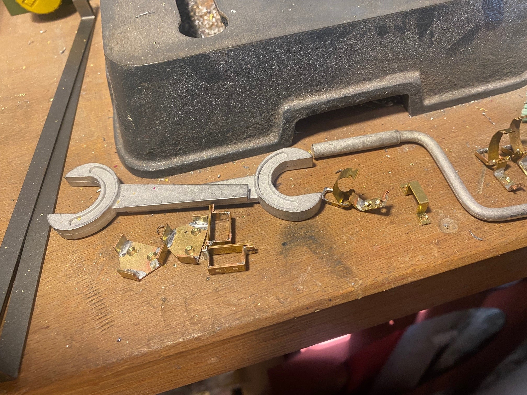

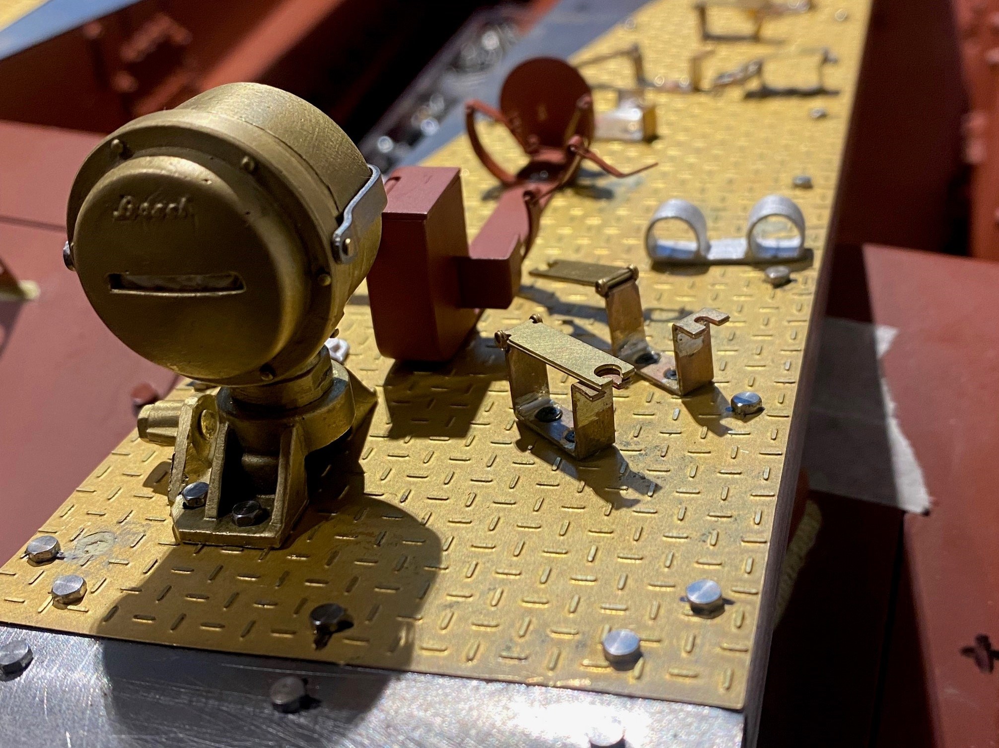

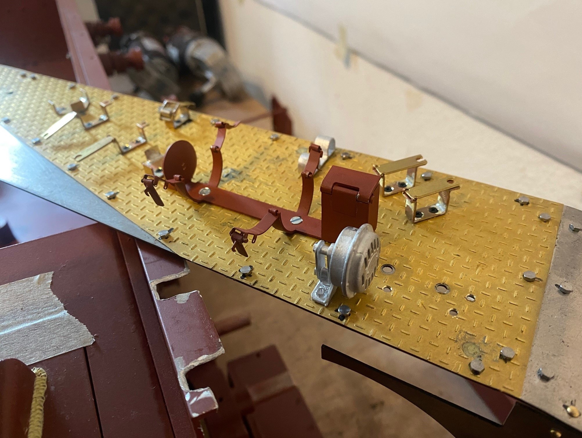

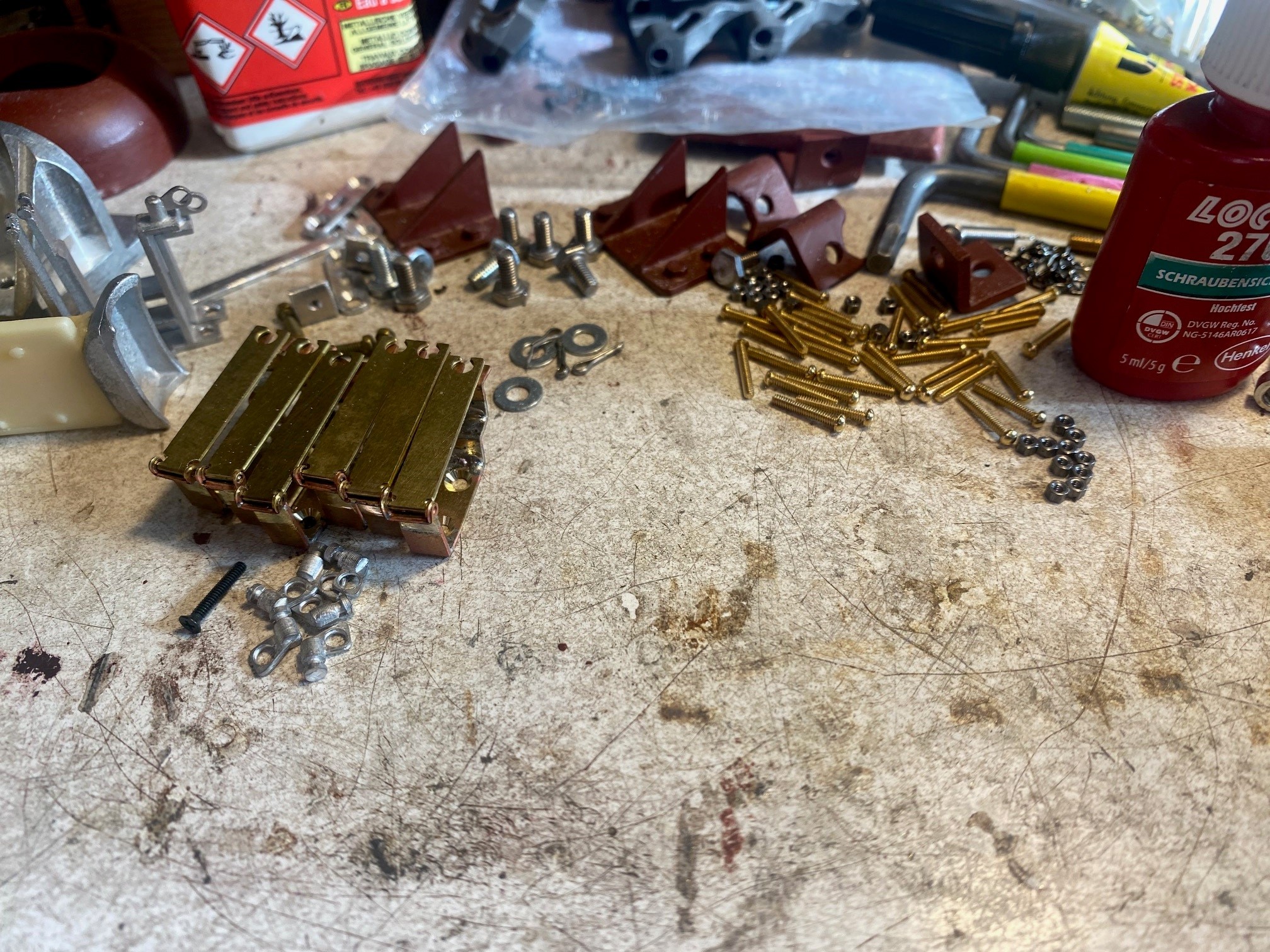

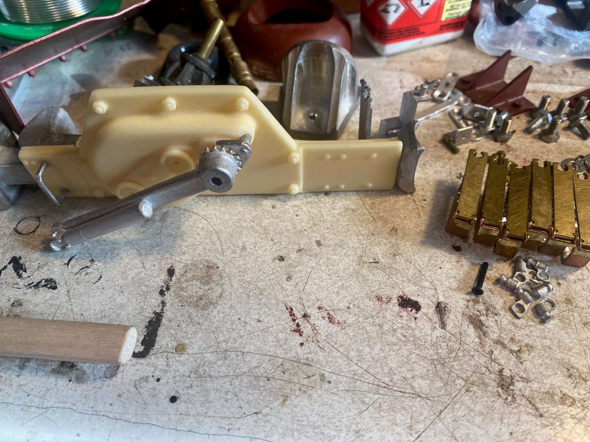

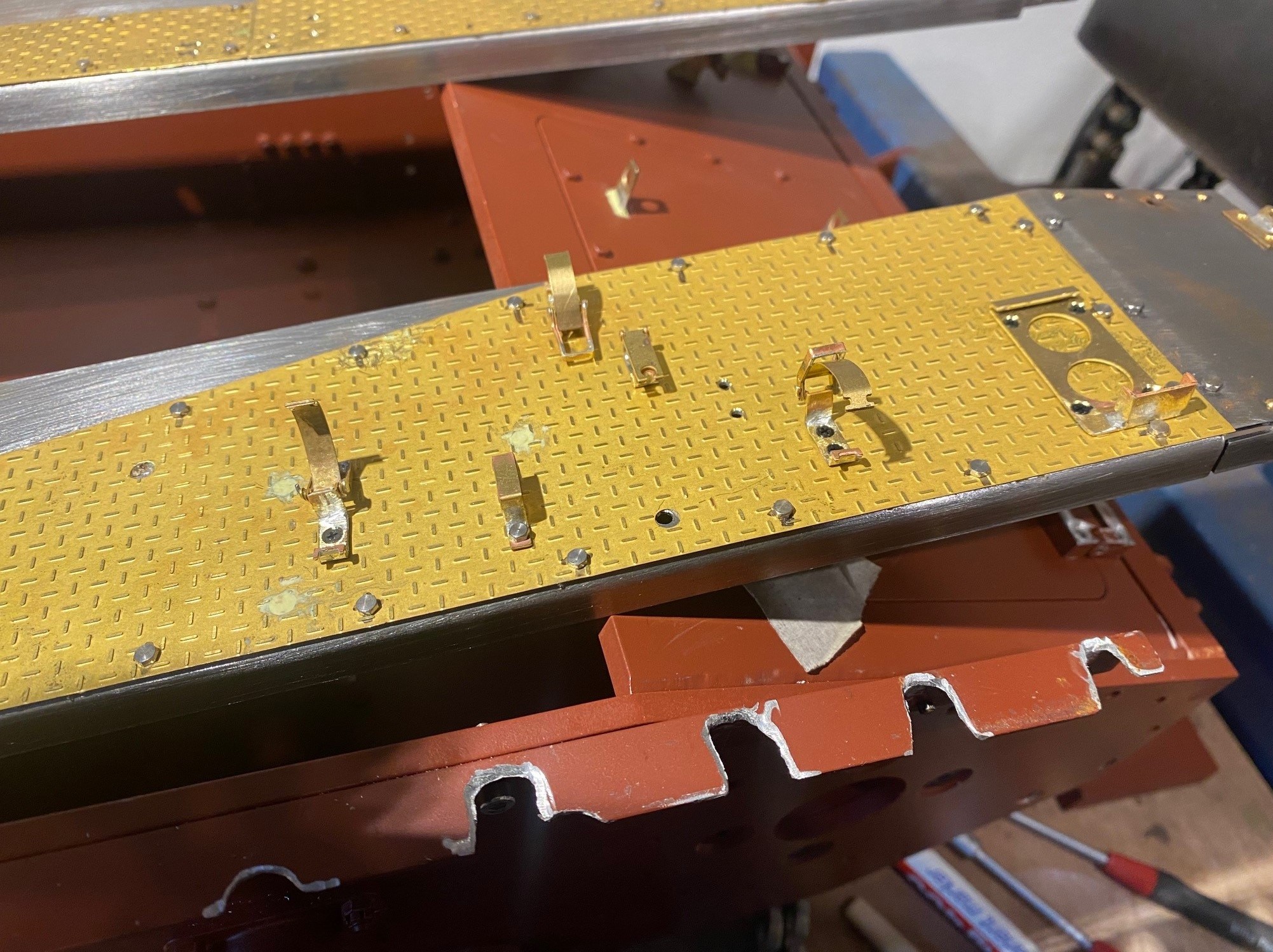

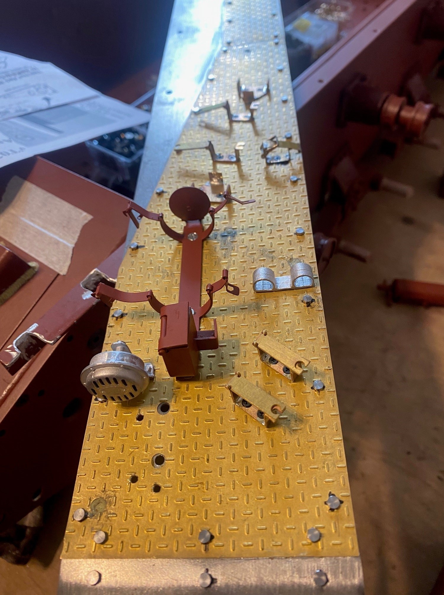

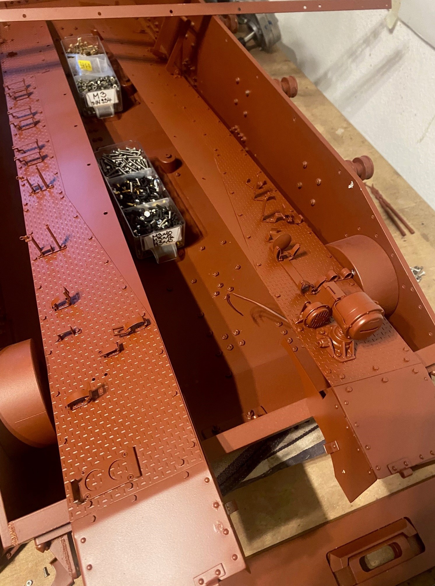

the next are the much holders for the tools, tracks and head light.
Regards Martin

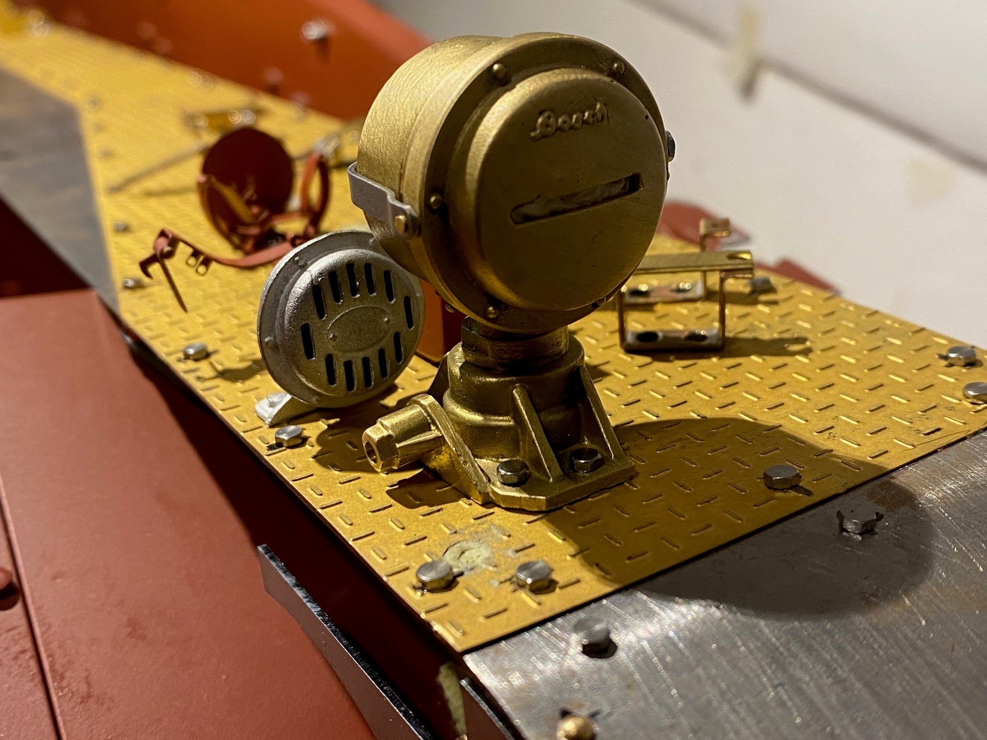

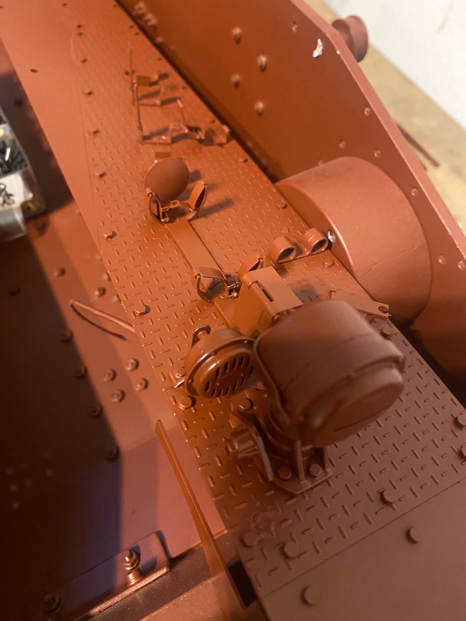

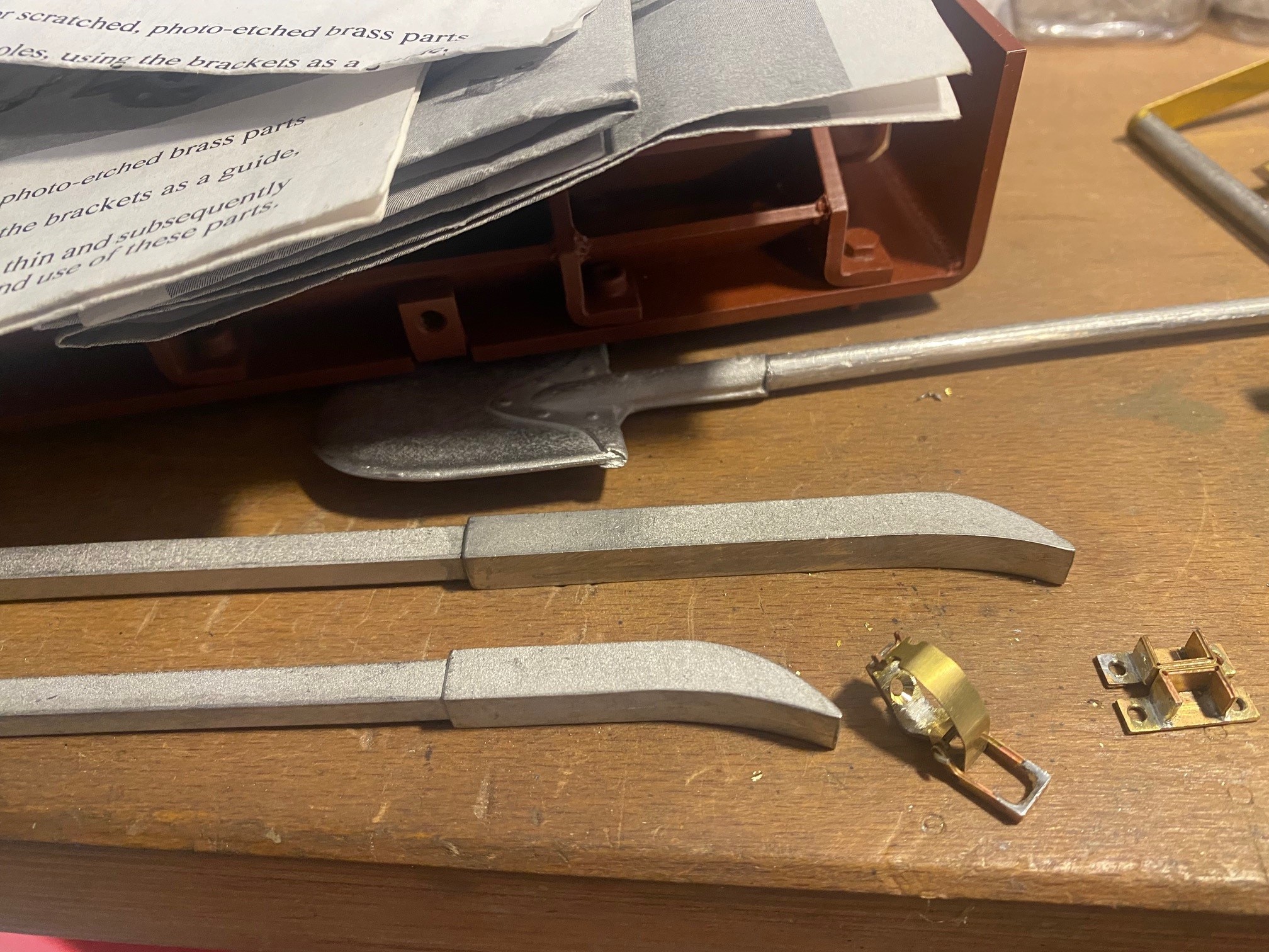

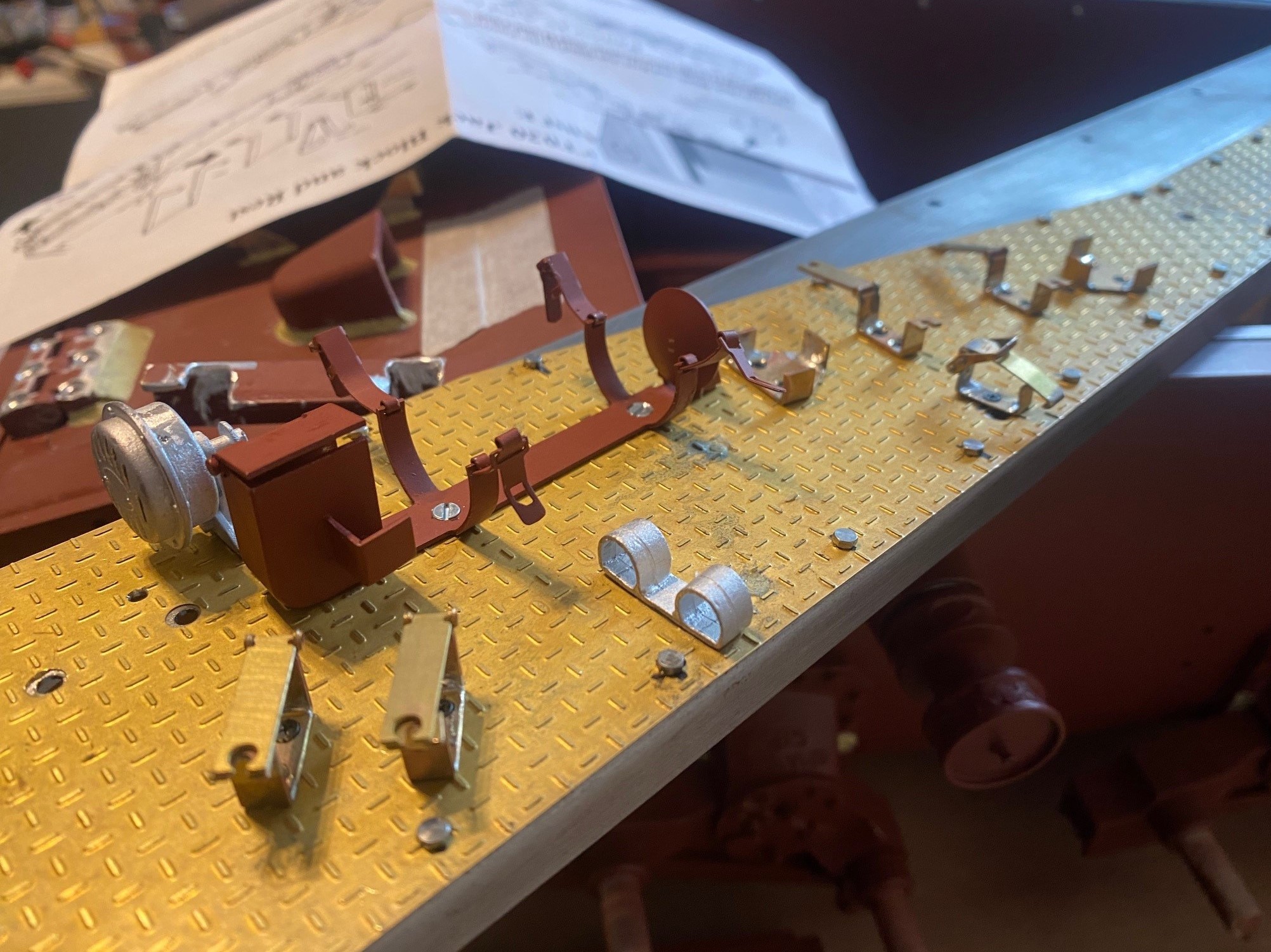

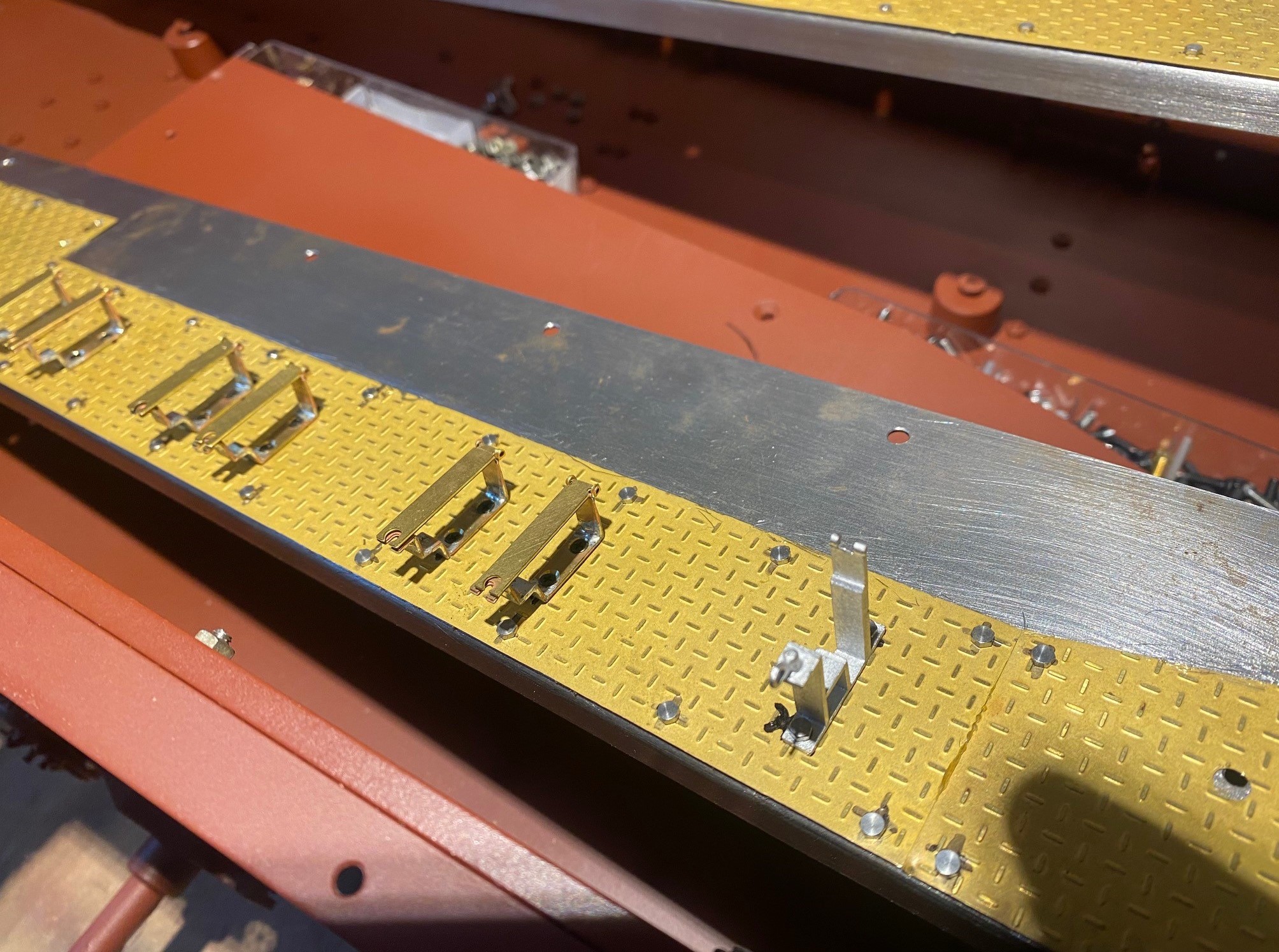

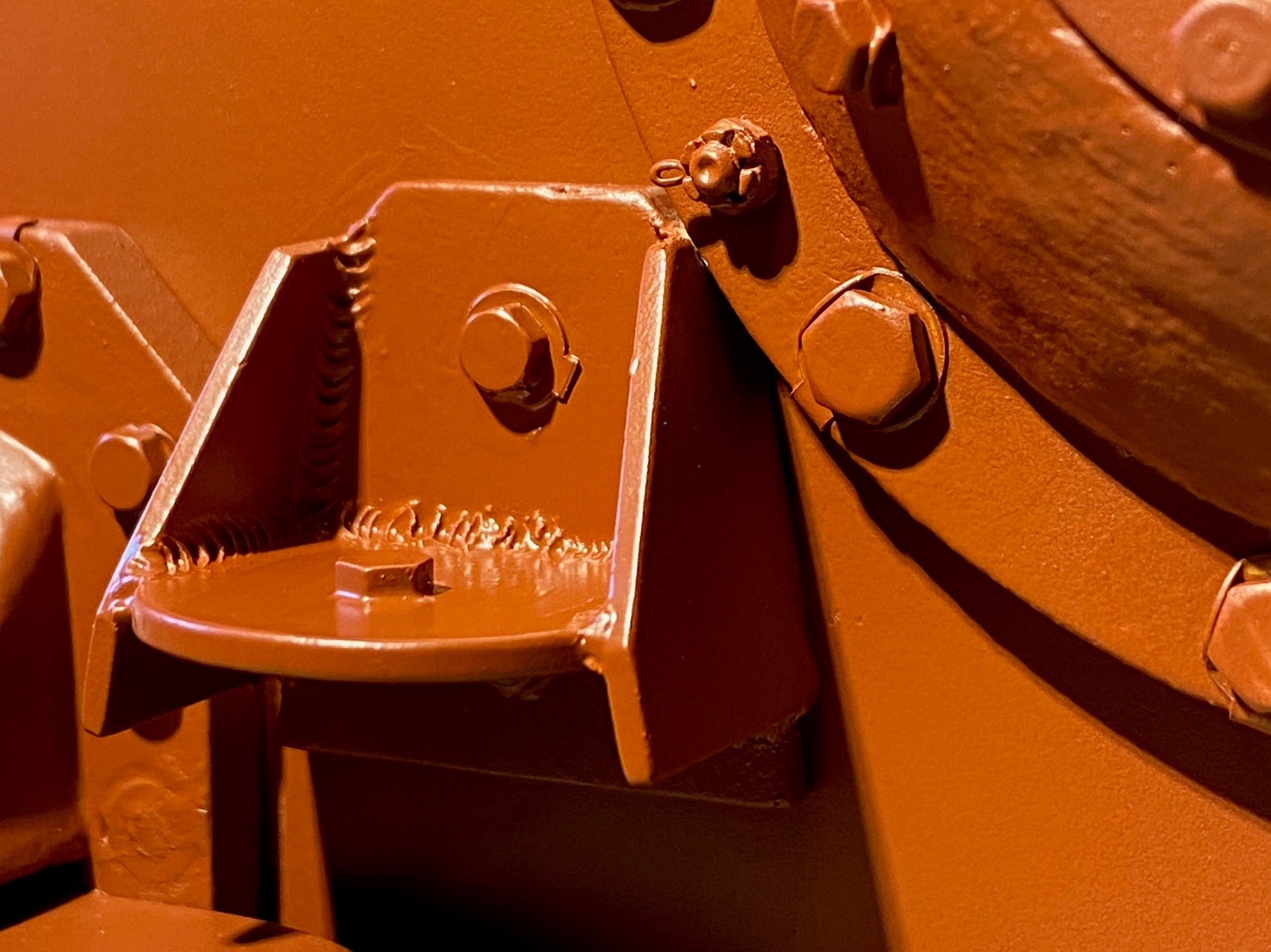

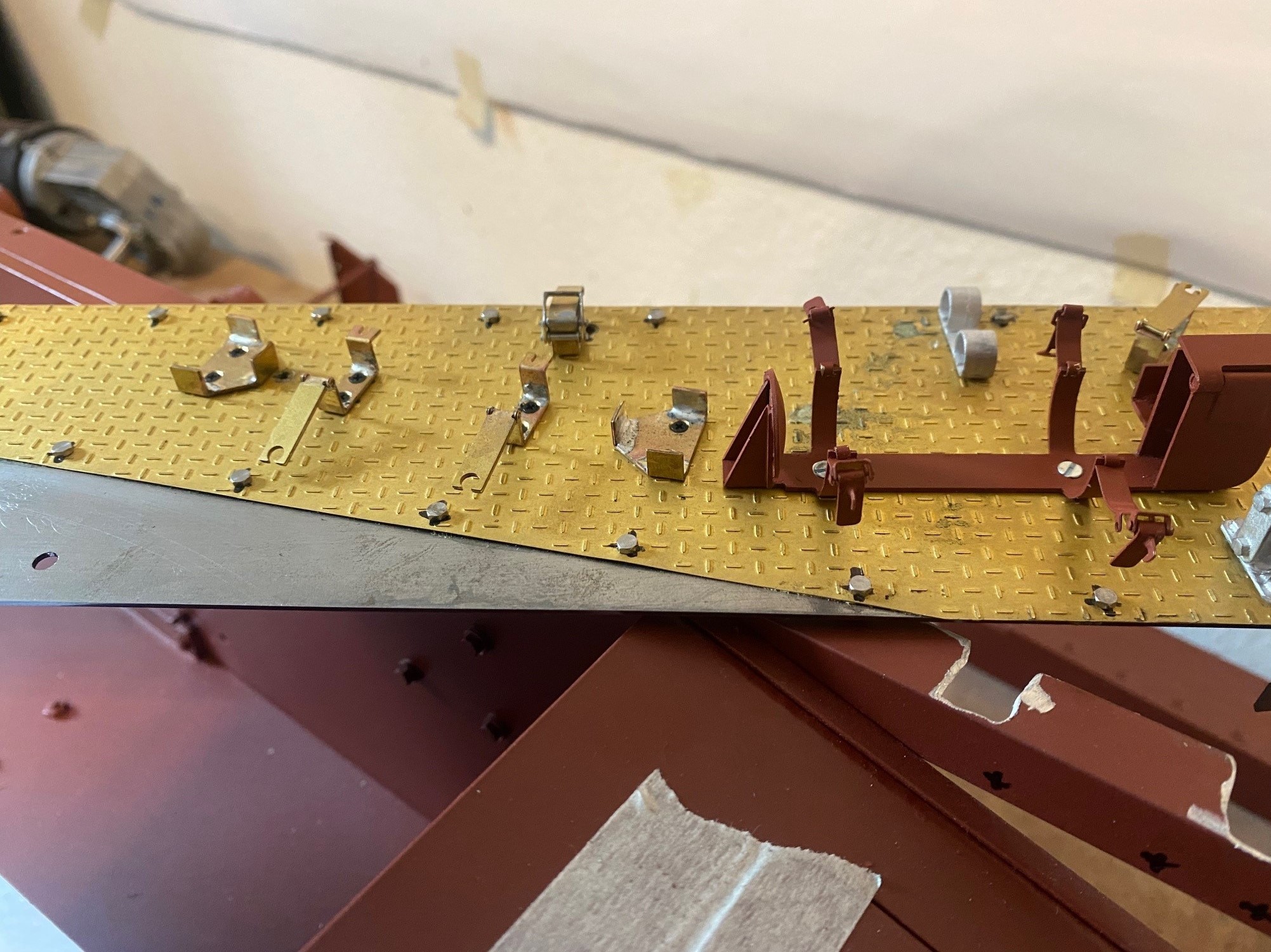

Here a small update. So many holders and tools..............
Regards Martin

It is with great pleasure that I follow your beautiful build Martin.
One question: Did you make the Fire Extinguisher Tetra and the bracket yourself?
Robert

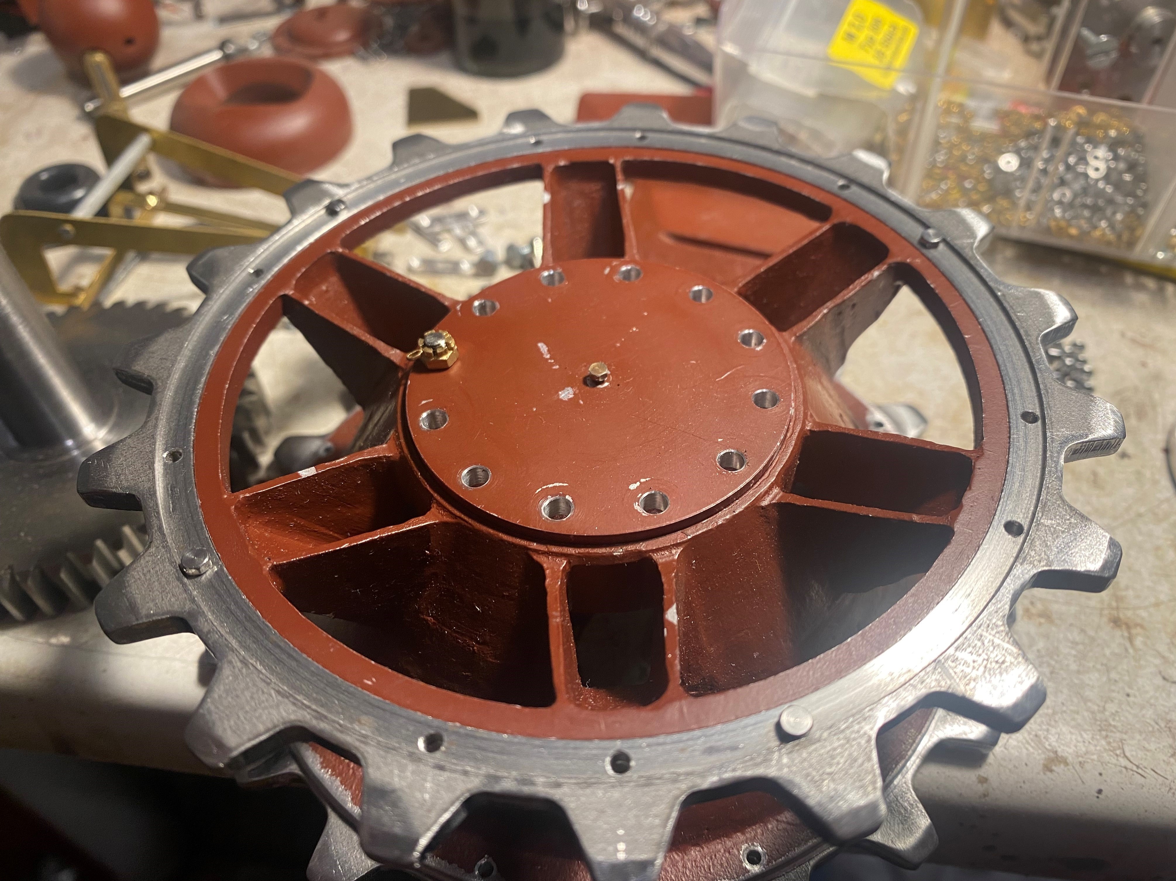

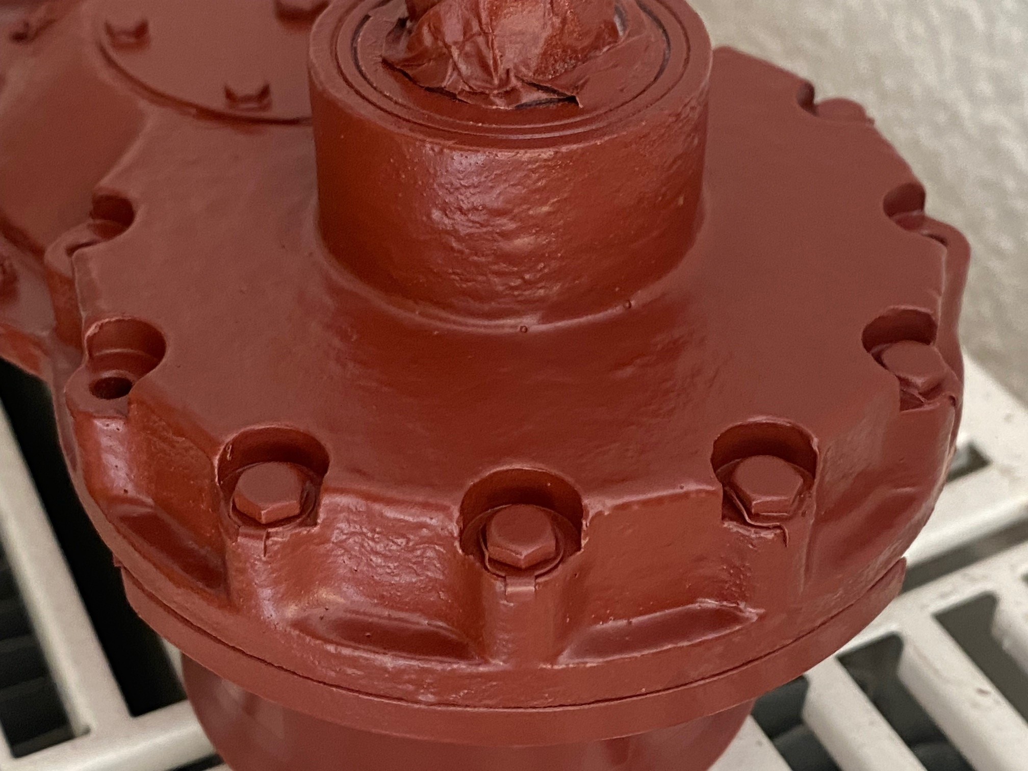

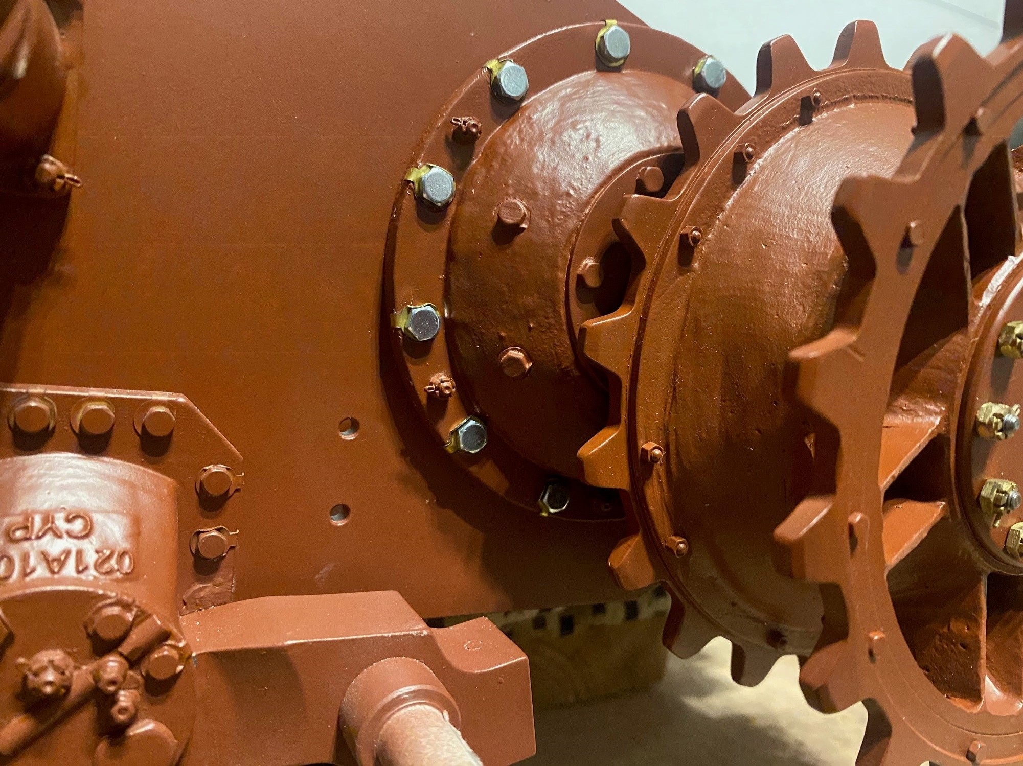

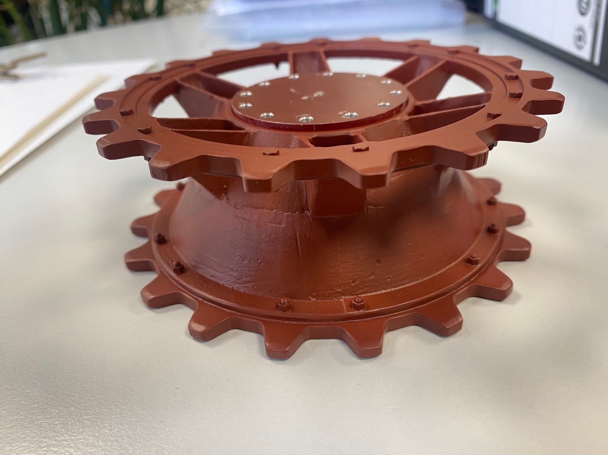

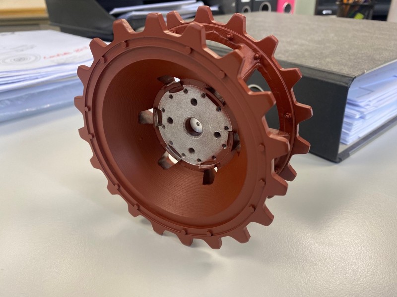

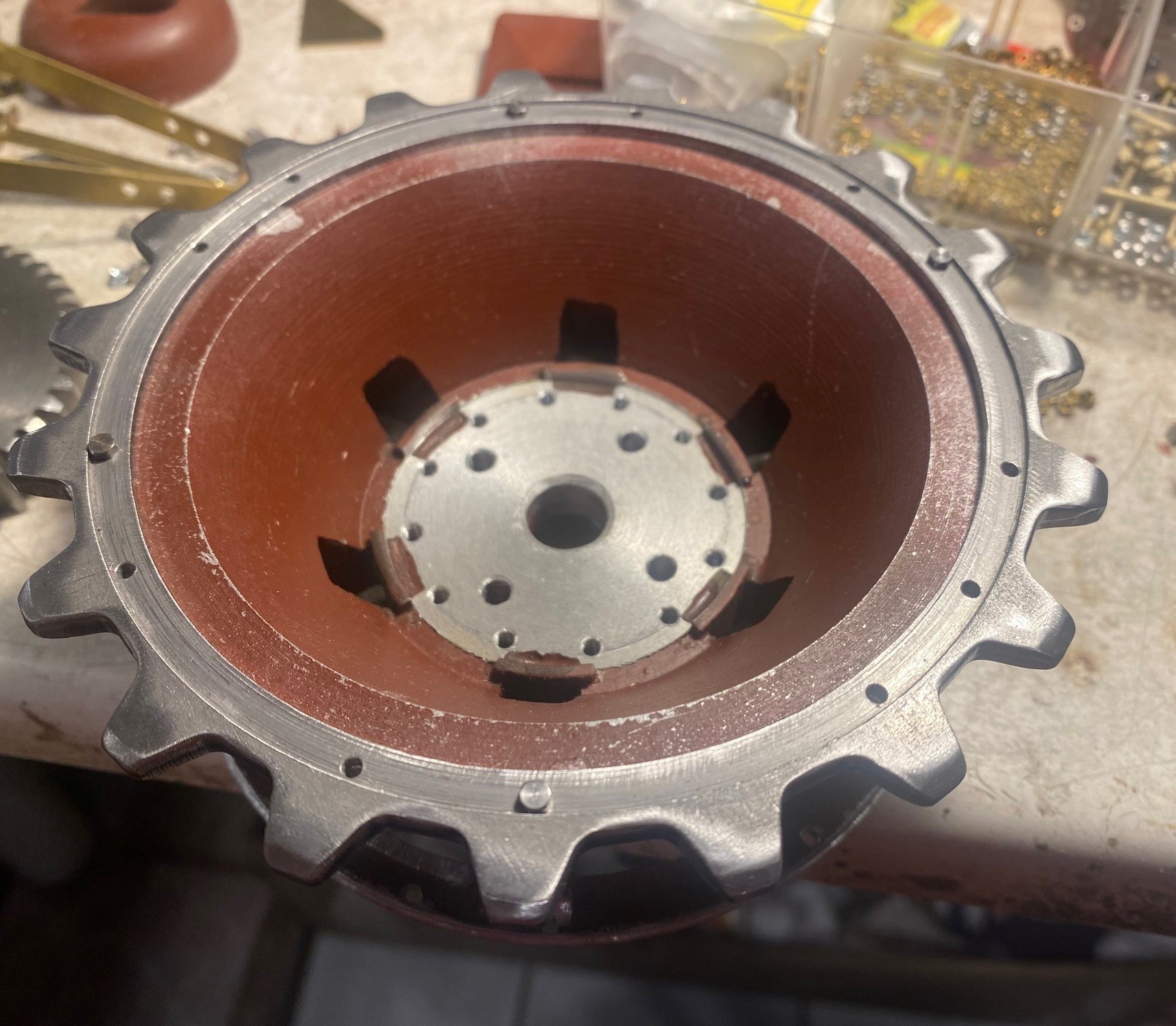

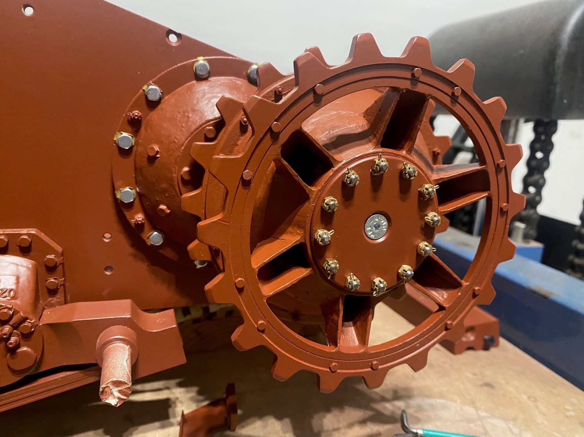

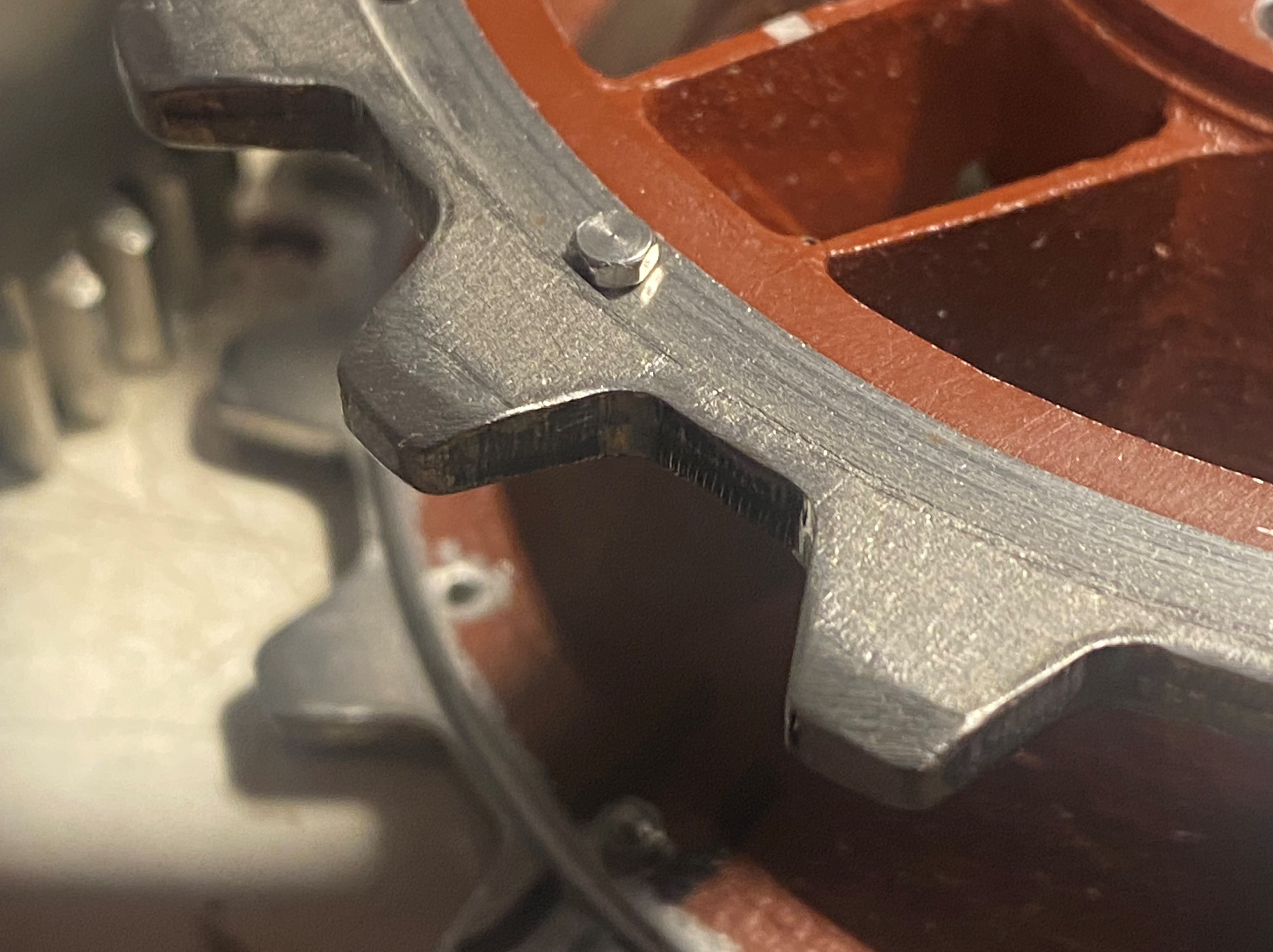

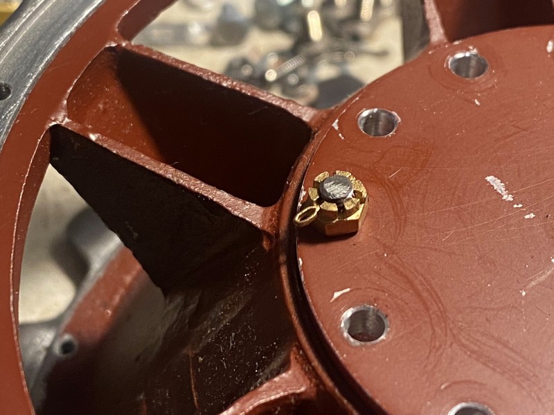

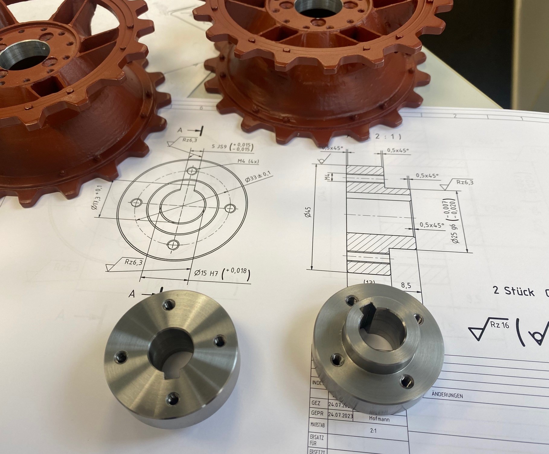

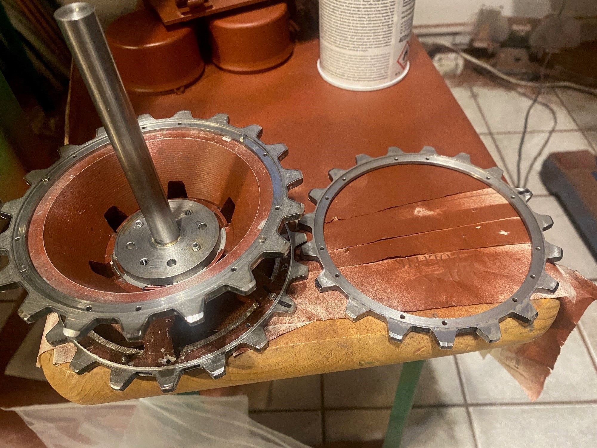

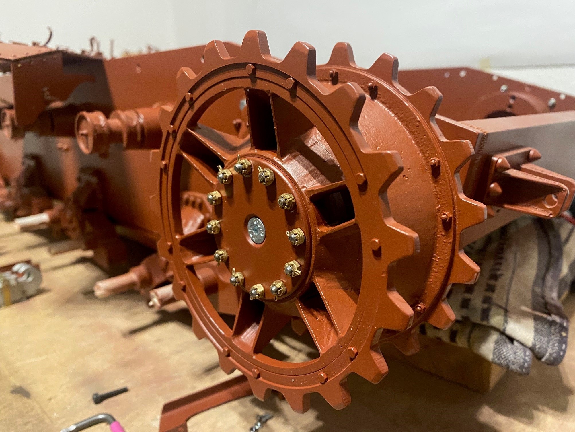

Here comes the next step: priming the mud guards, test fit of the final drive housing and begin to mount the casted drive wheels with the steel sprocket rings. The new challenge is to find a mount that works without a taper lock bush.
Regards Martin

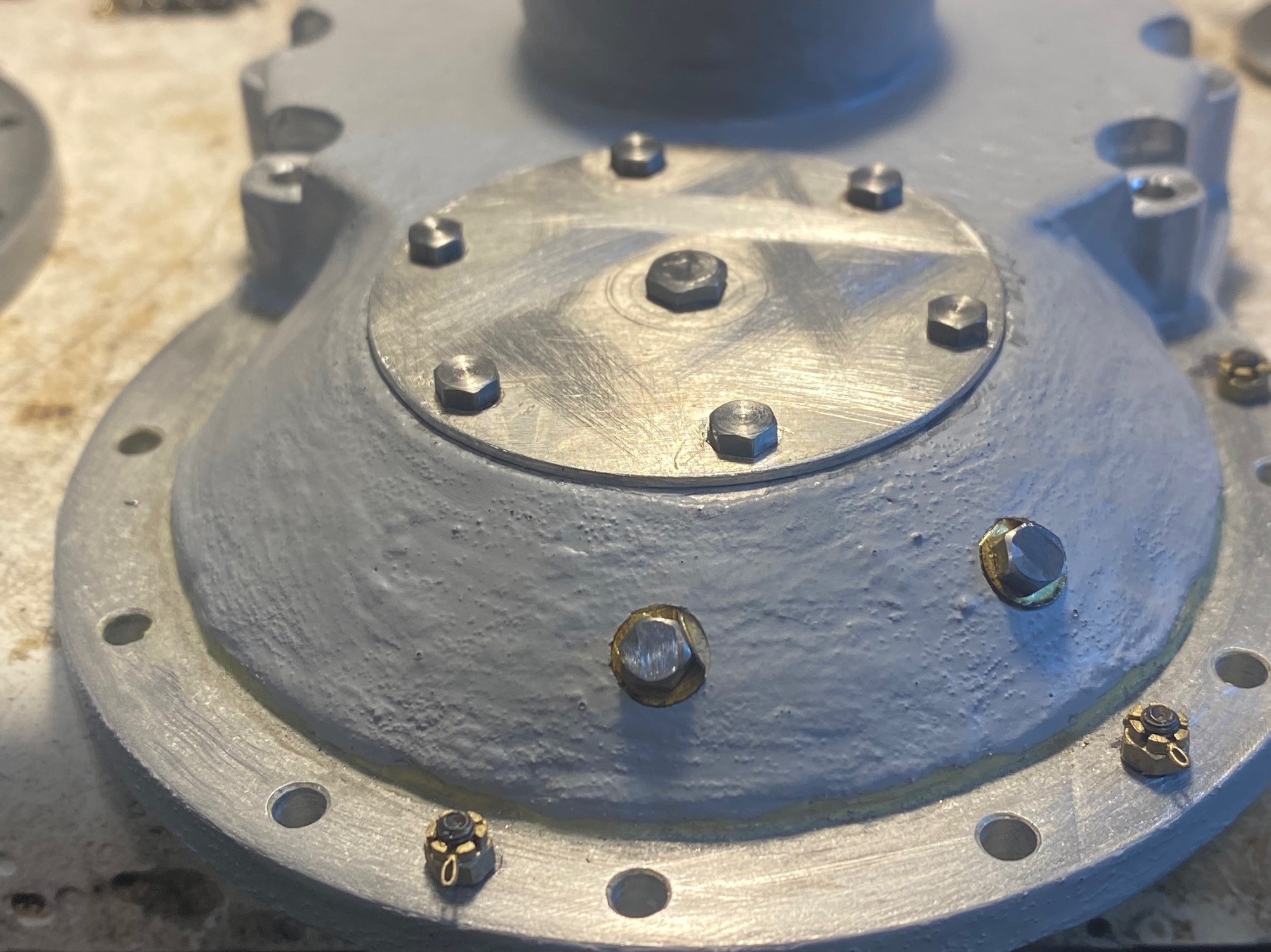

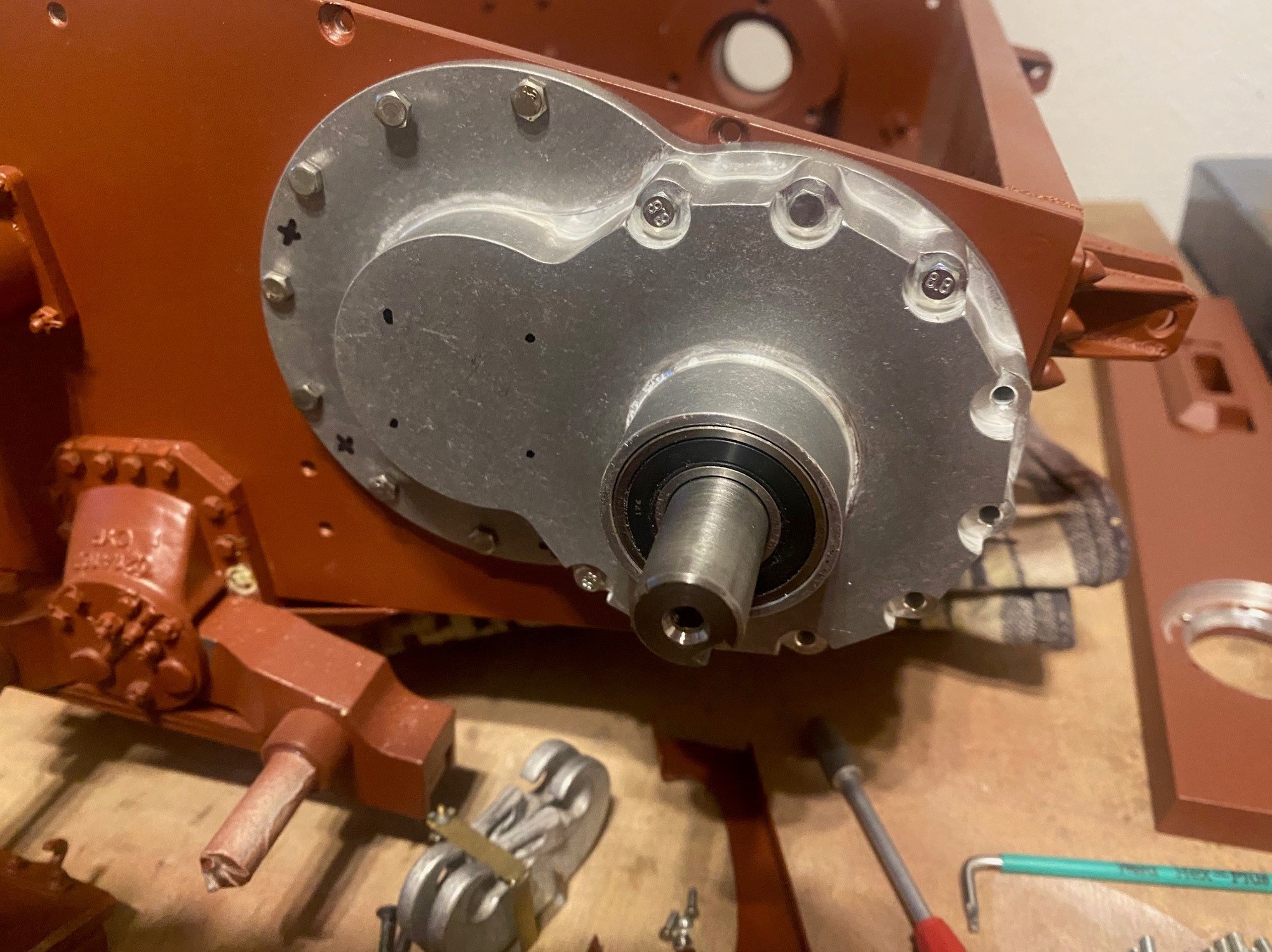

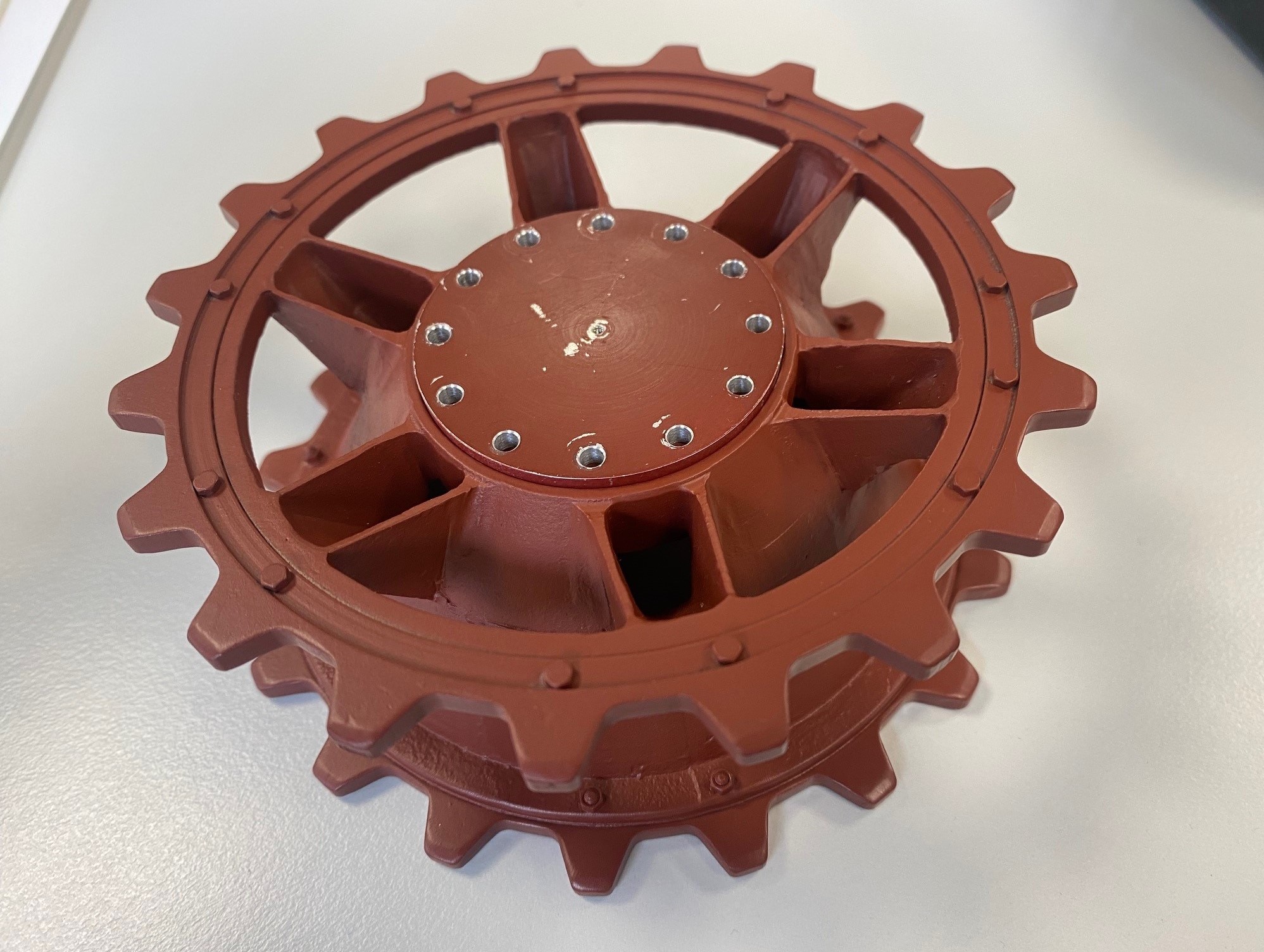

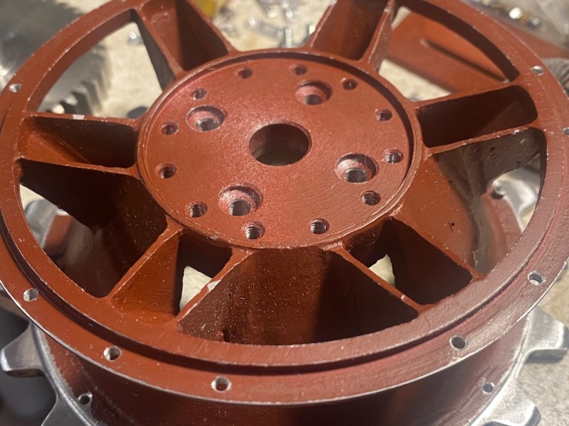

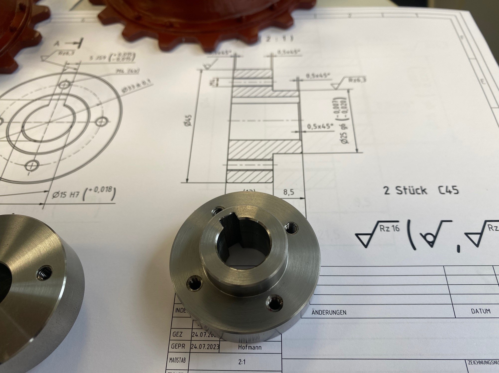

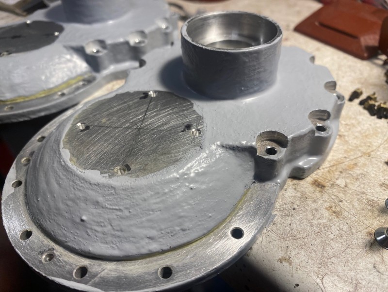

After making a drawing for the flange to hold the sprocket wheel, i tested the design - very good so far.
There are also some modifications on the final drive housings.
Regards Martin

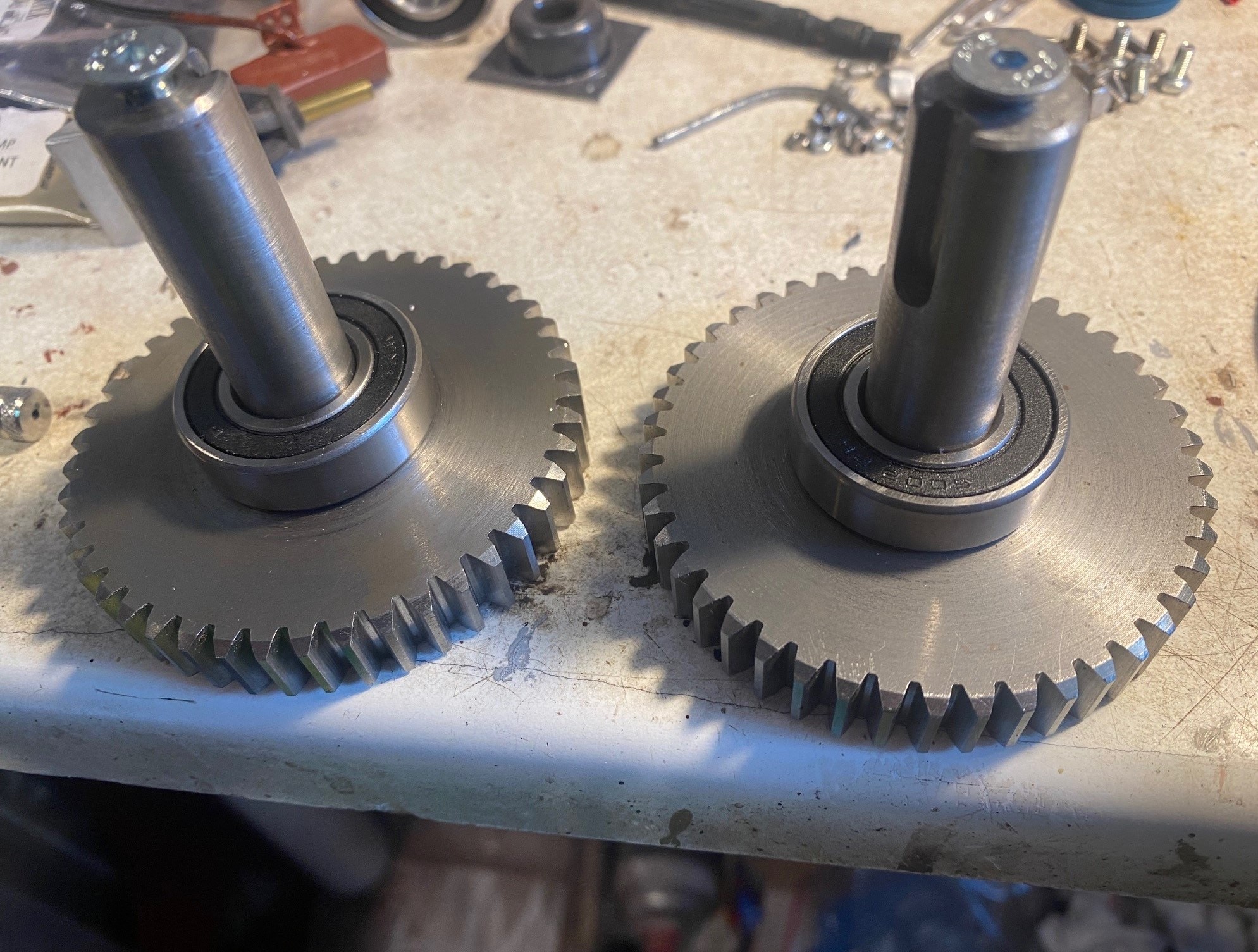

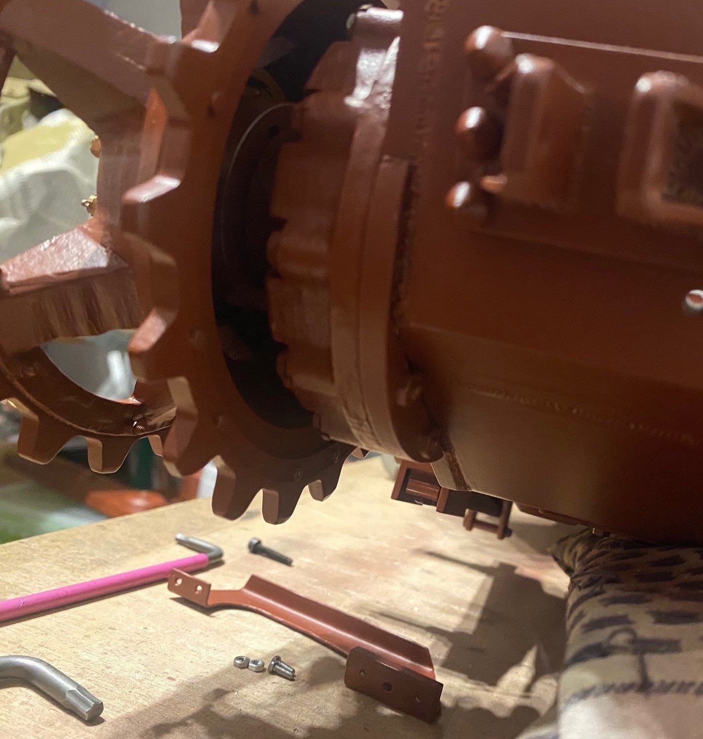

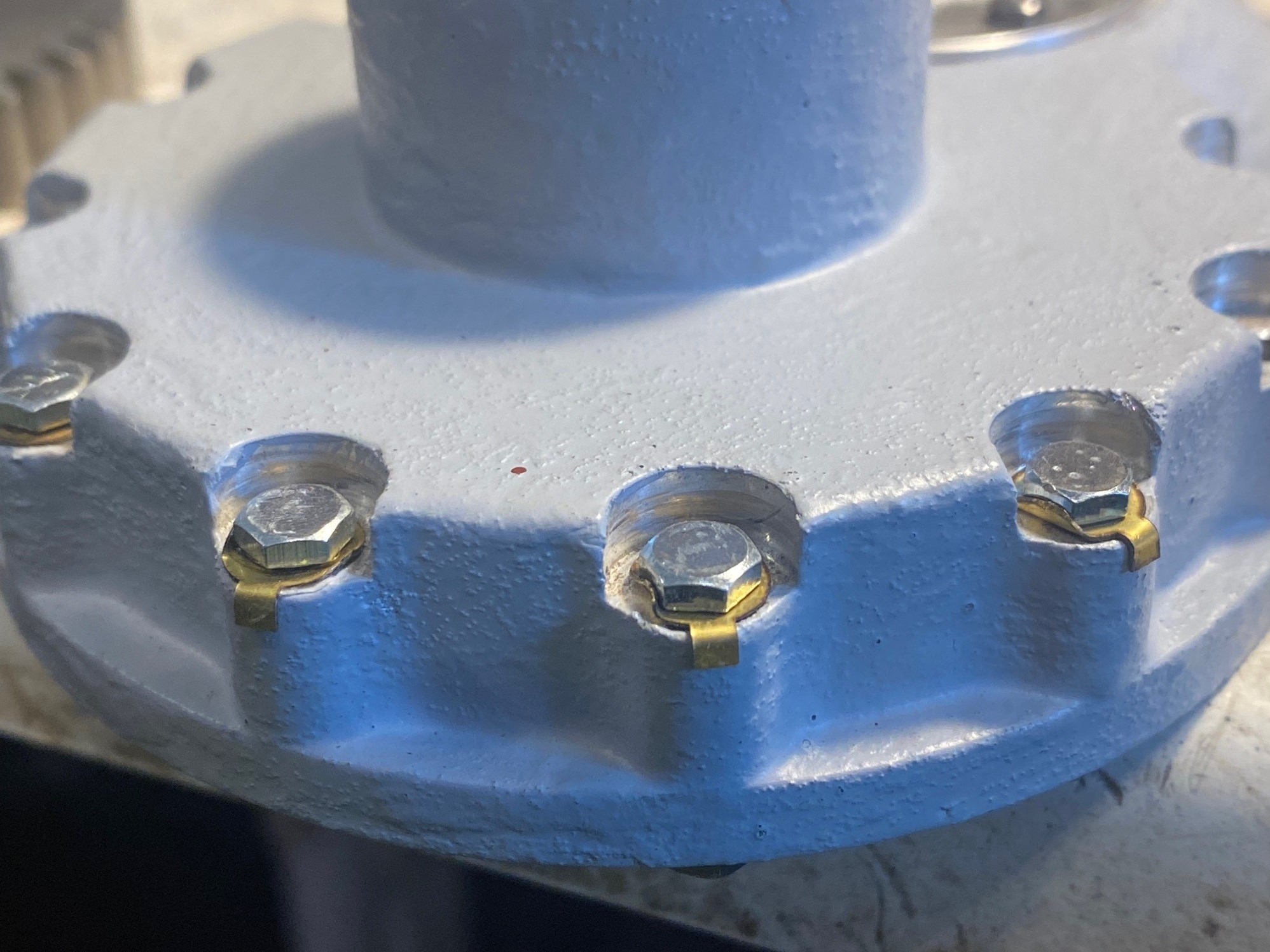

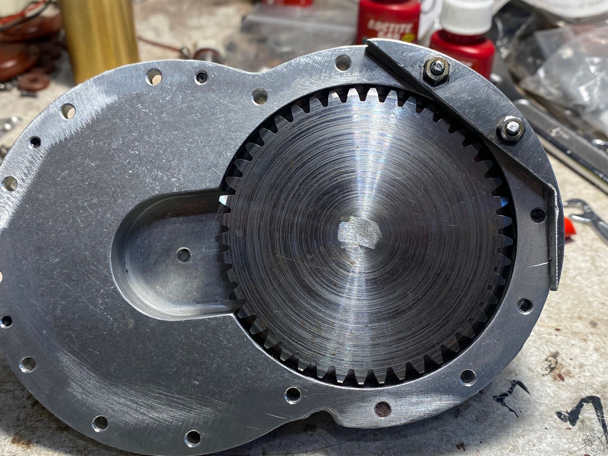

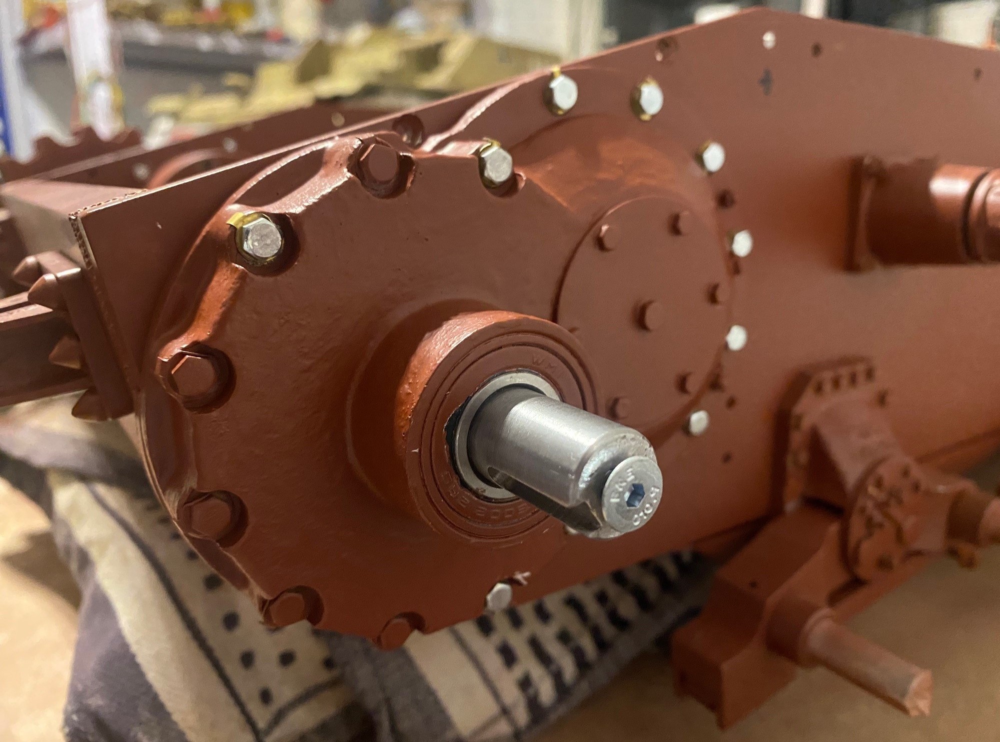

Here come a very small update from the Loctited ball bearings onto the shaft and the modified final drive housings.
Regards Martin

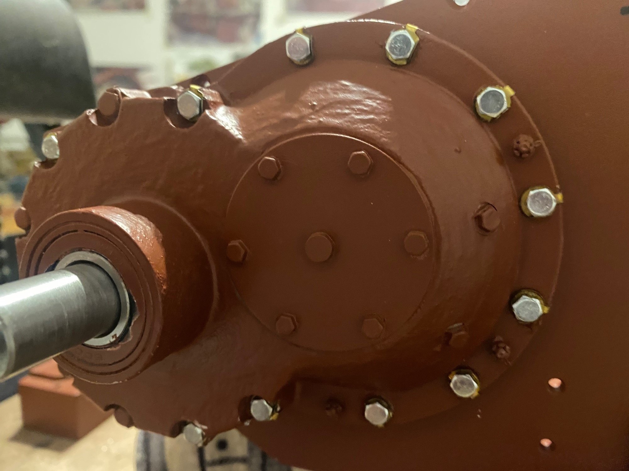

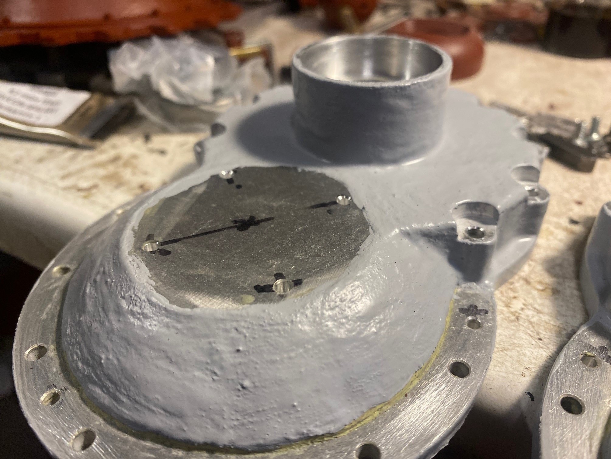

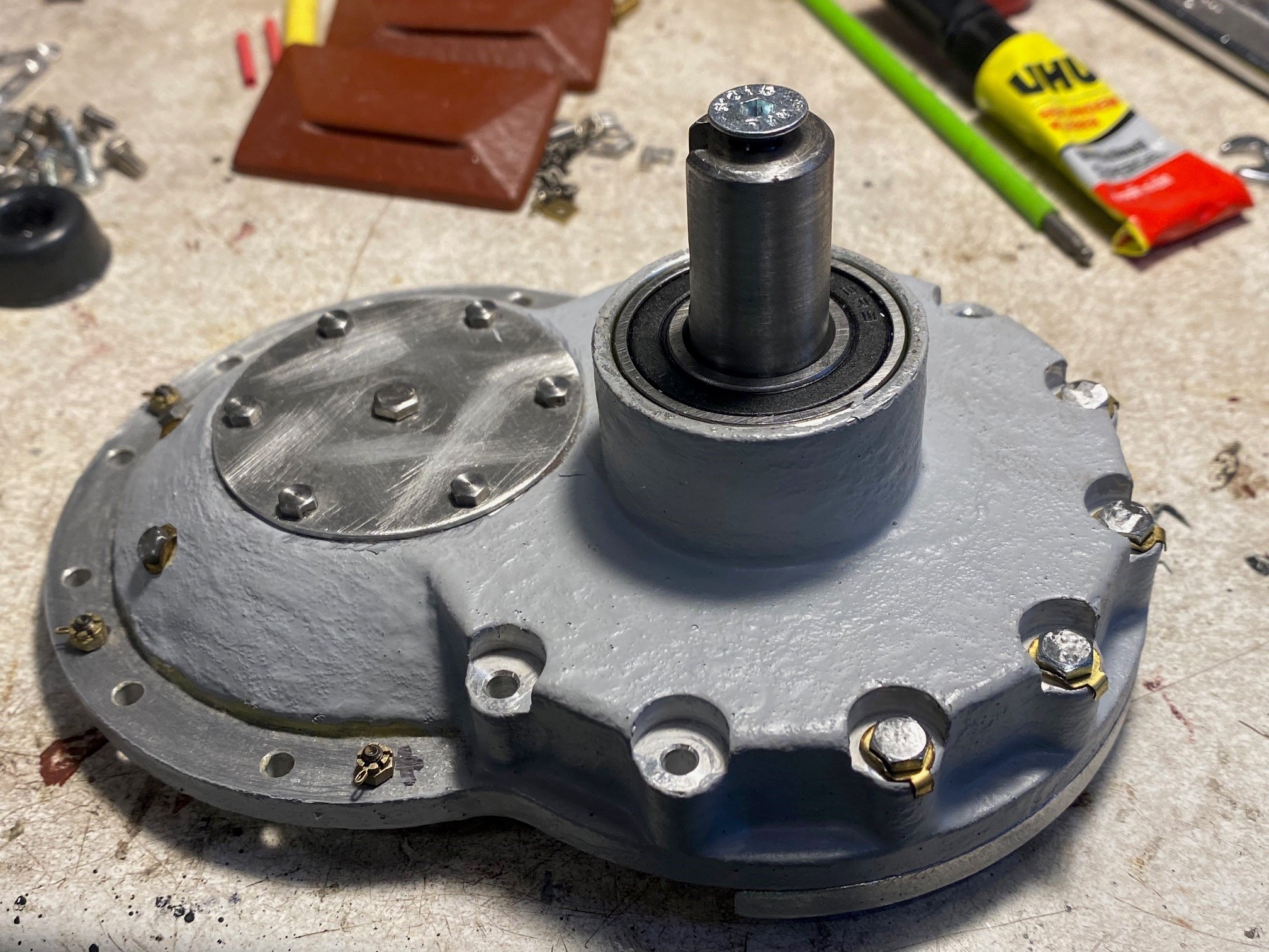

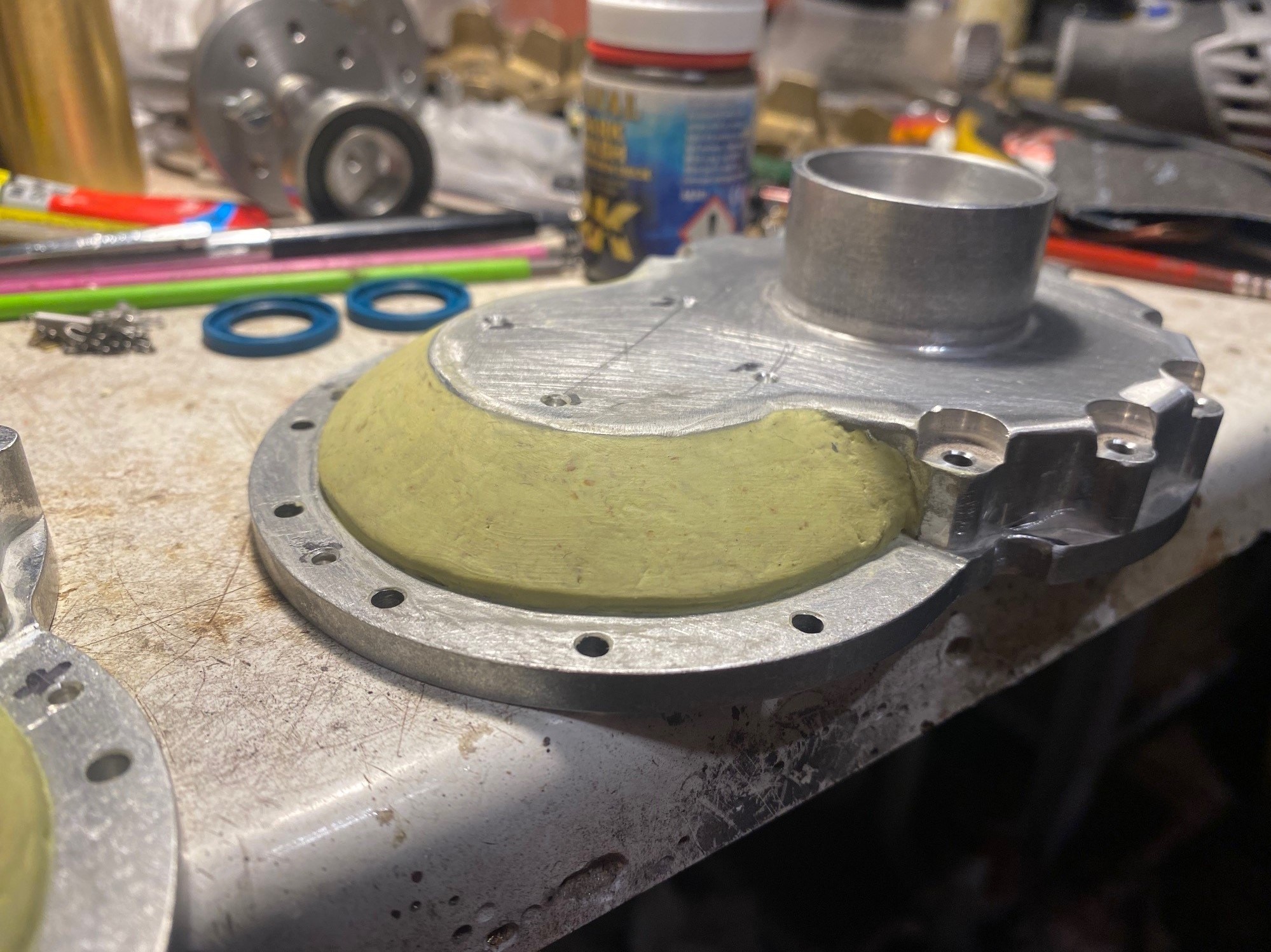

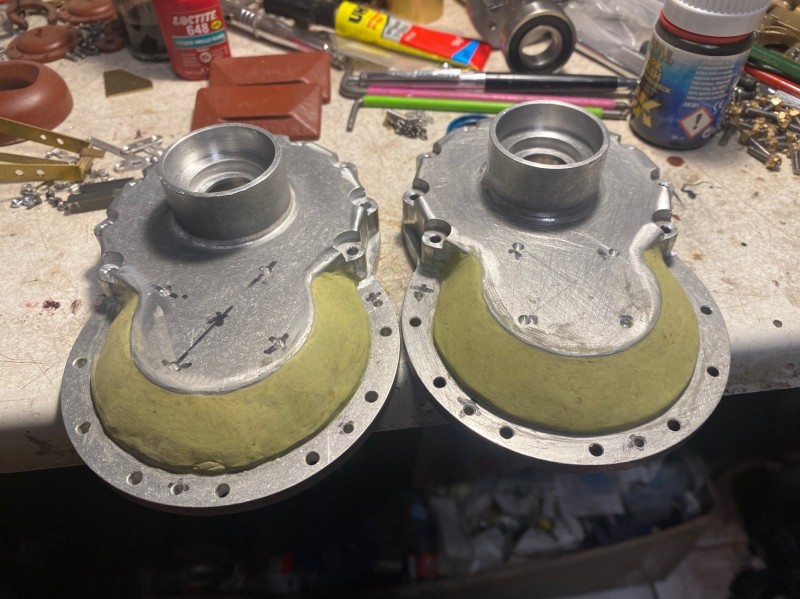

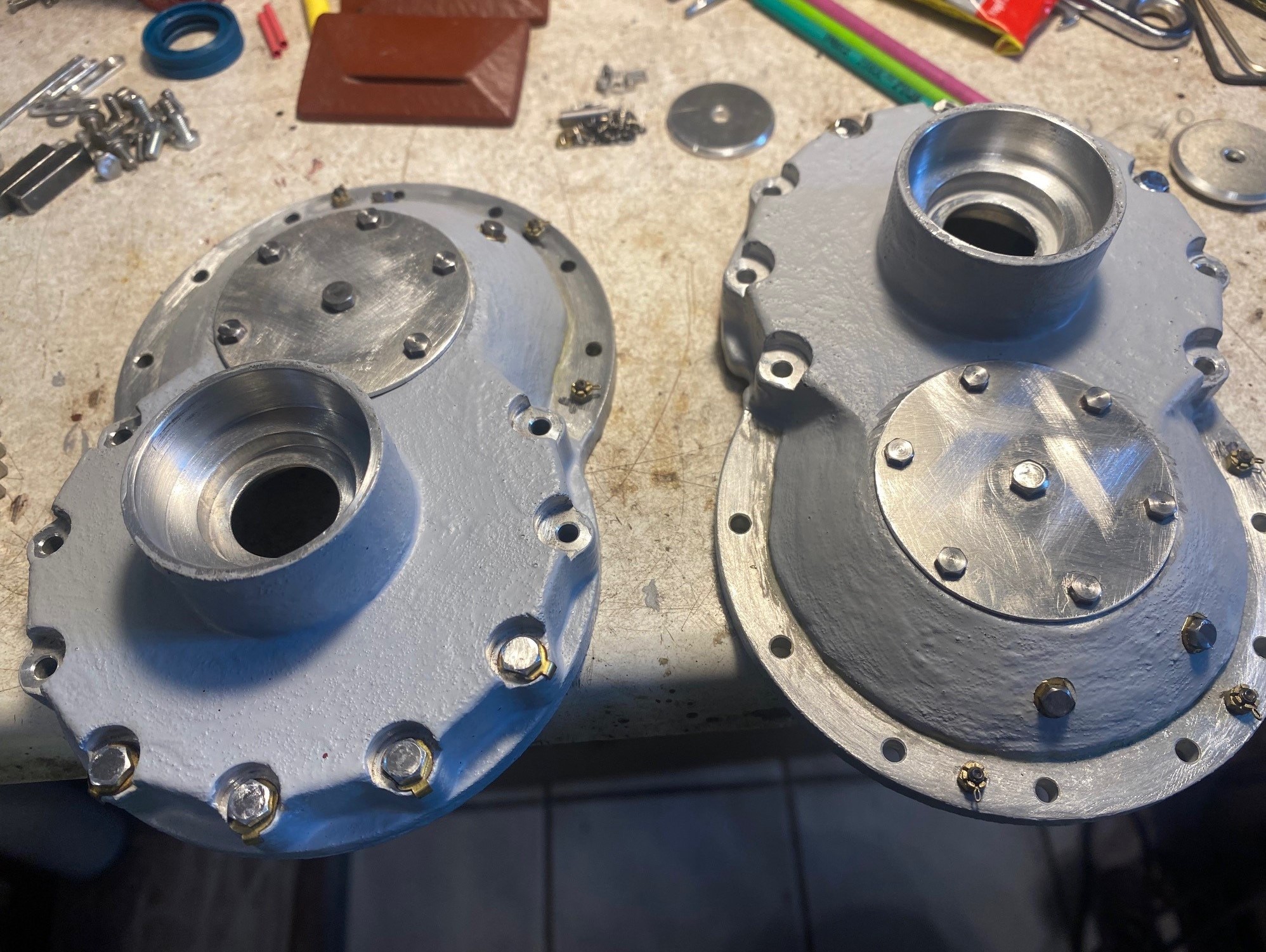

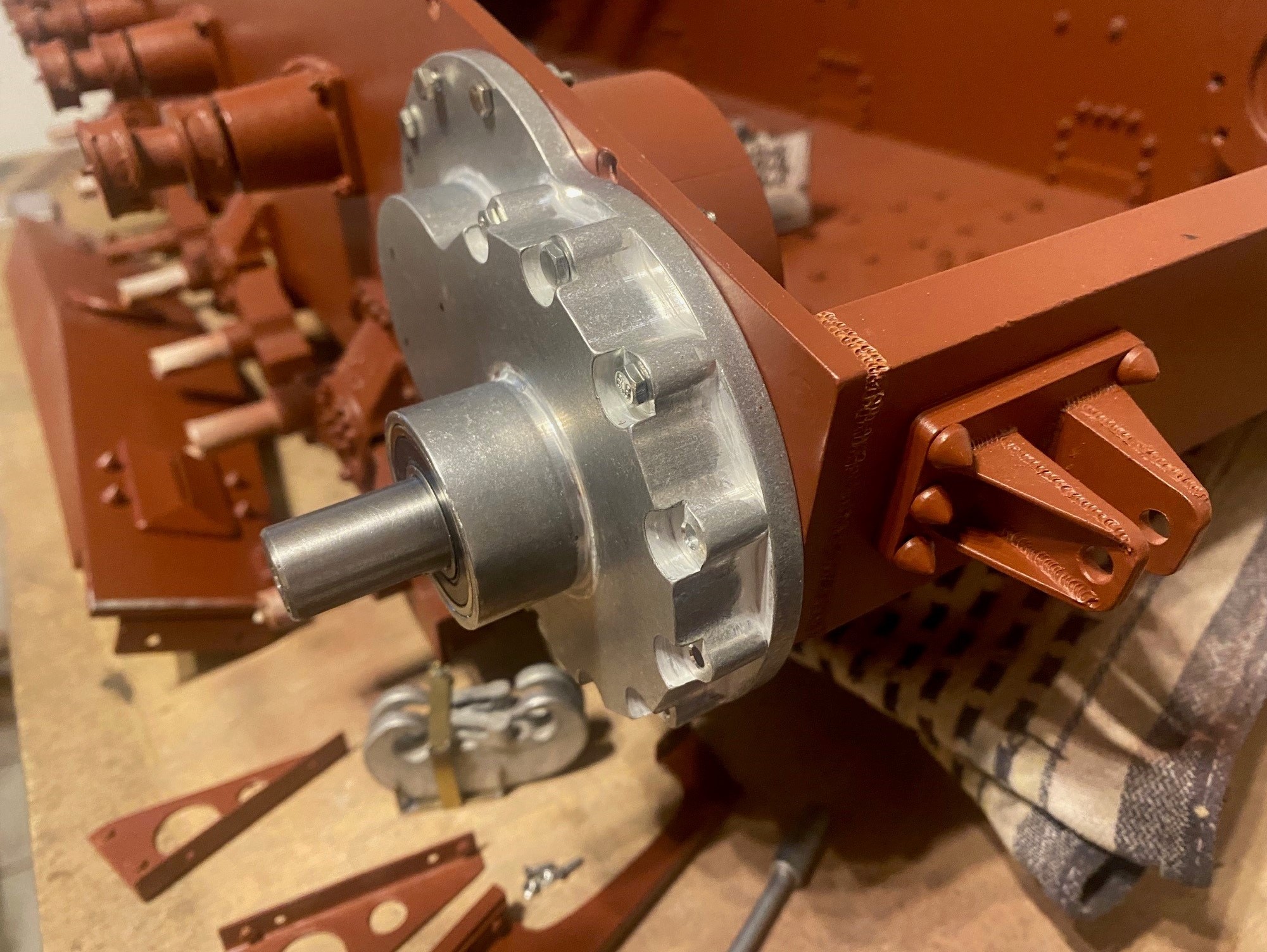

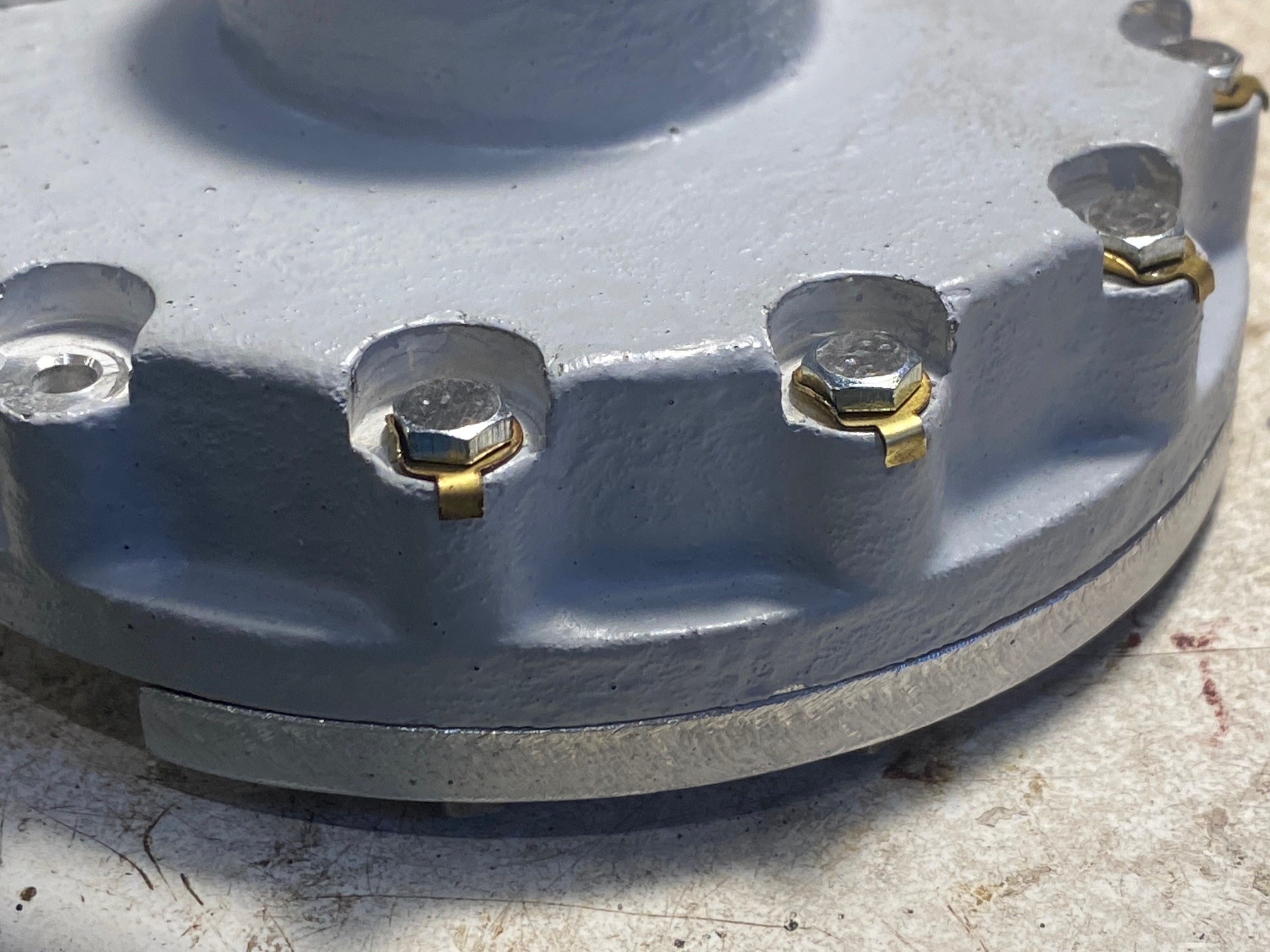

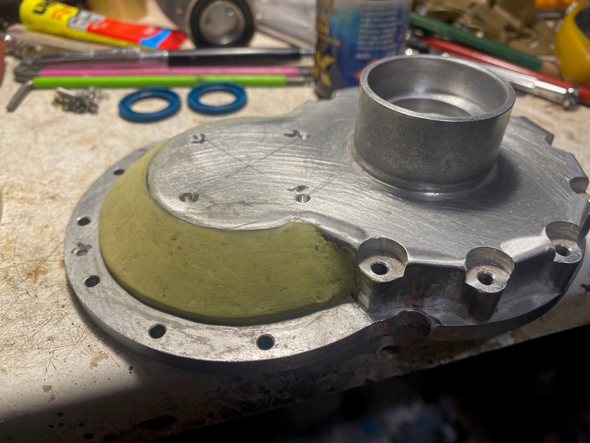

After a very long time, the time has finally come with a new update.
The final drive housing got a small laser cutted sheet inside the housing, because there was a gap so you could see the gear from the out side.
Now it is closed and no dirt can get in.
Regards Martin

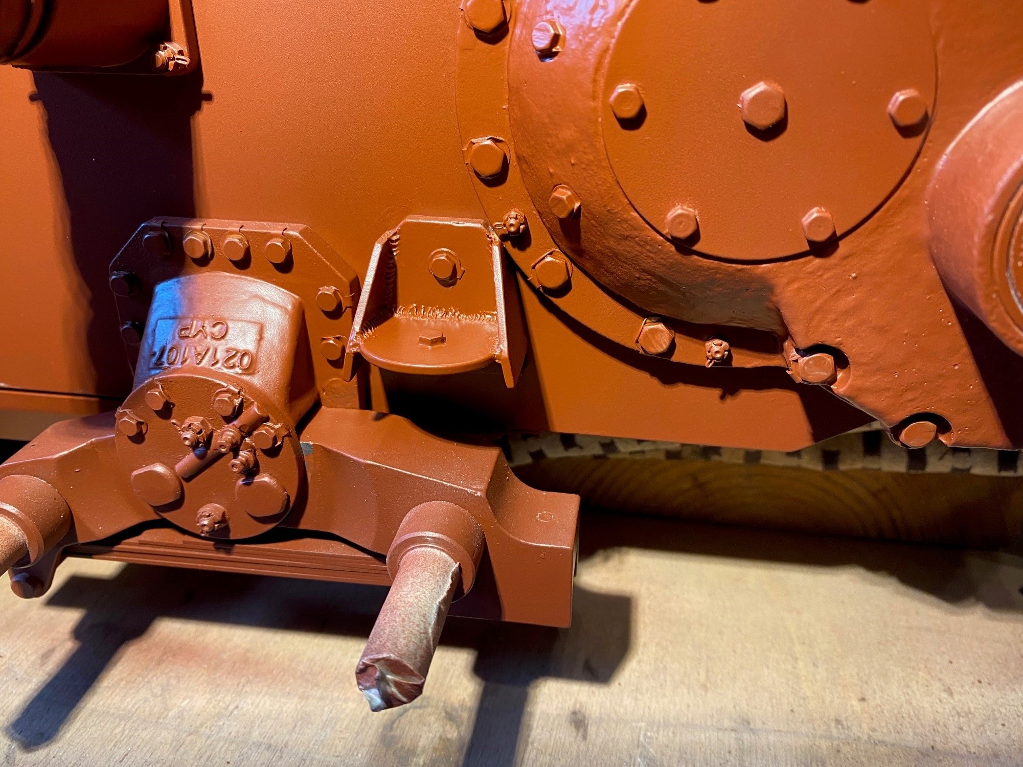

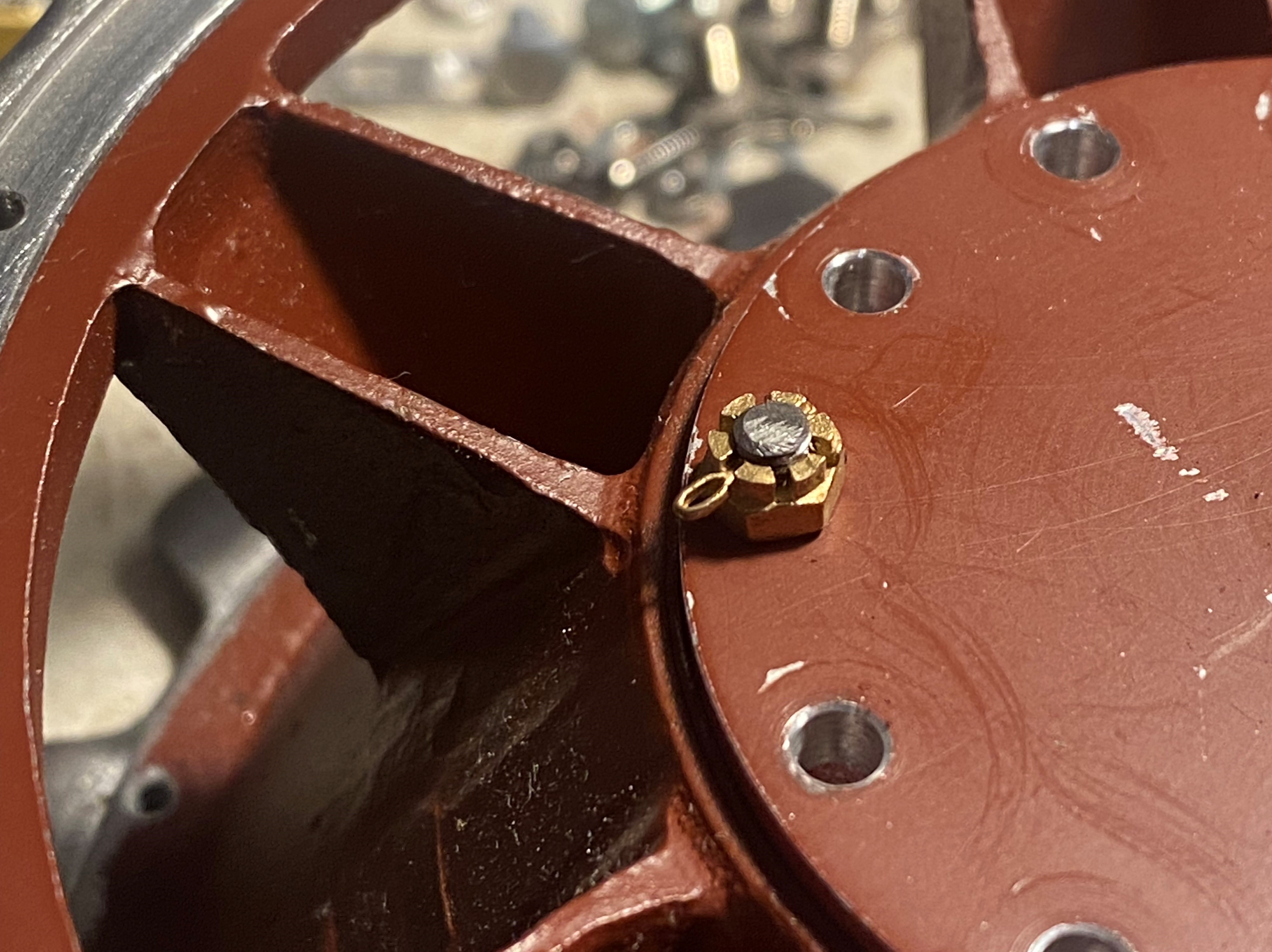

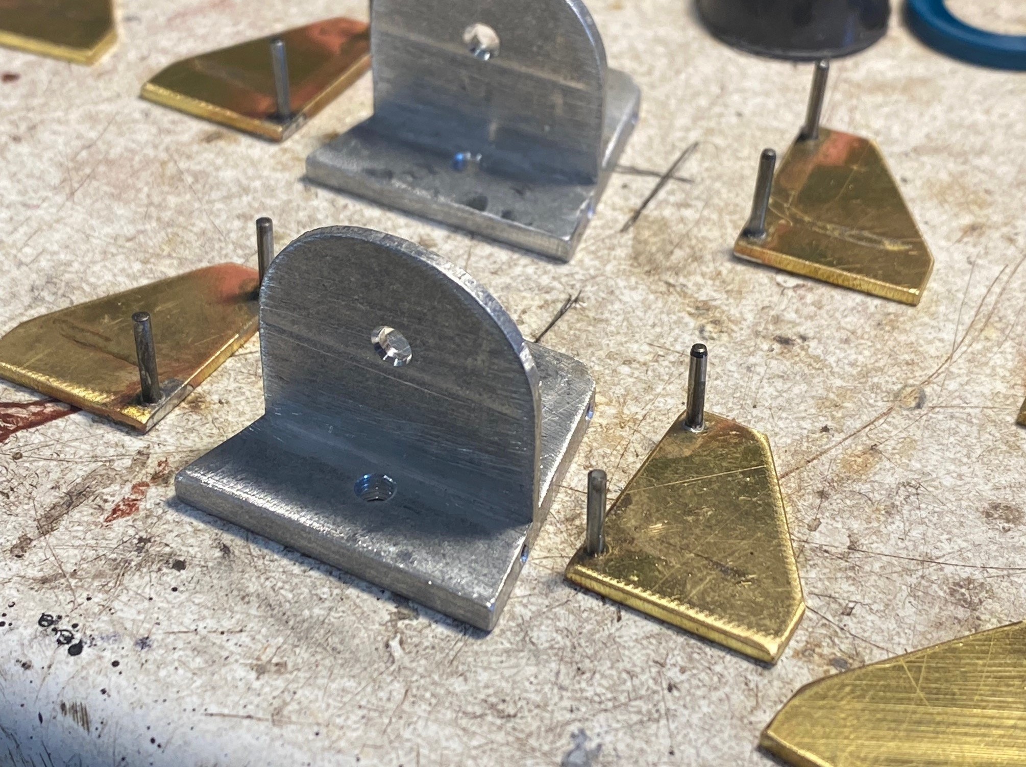

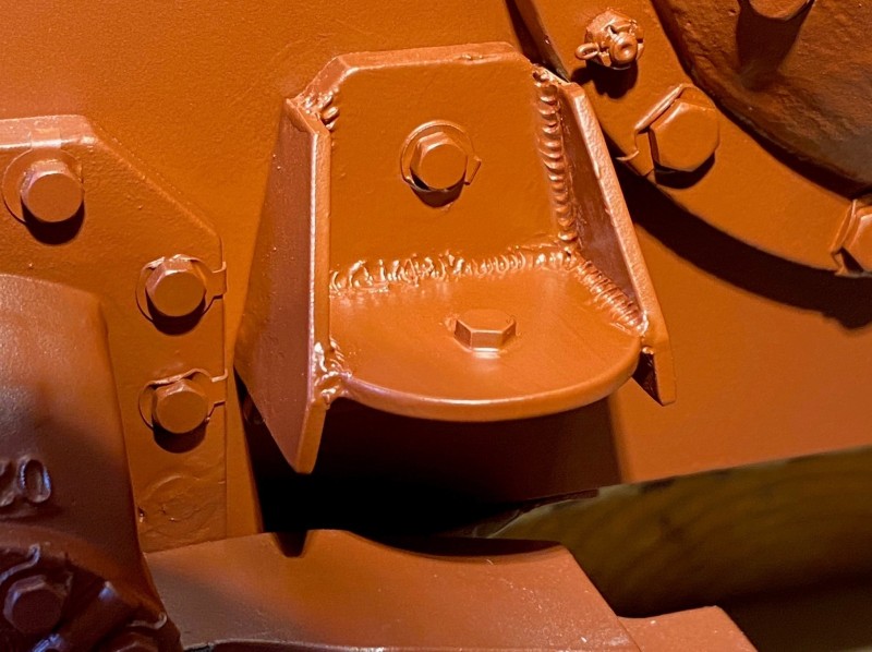

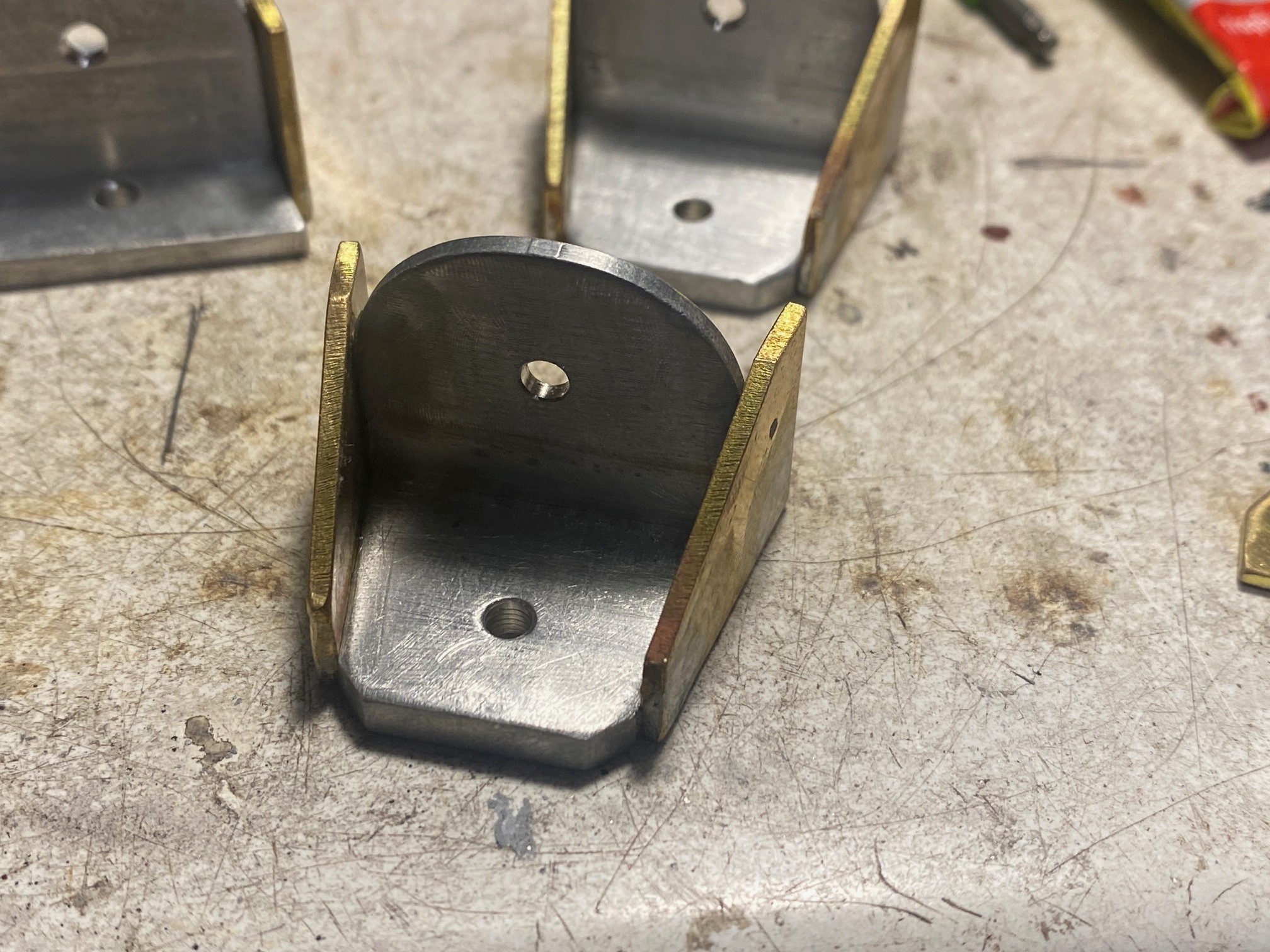

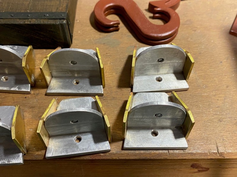

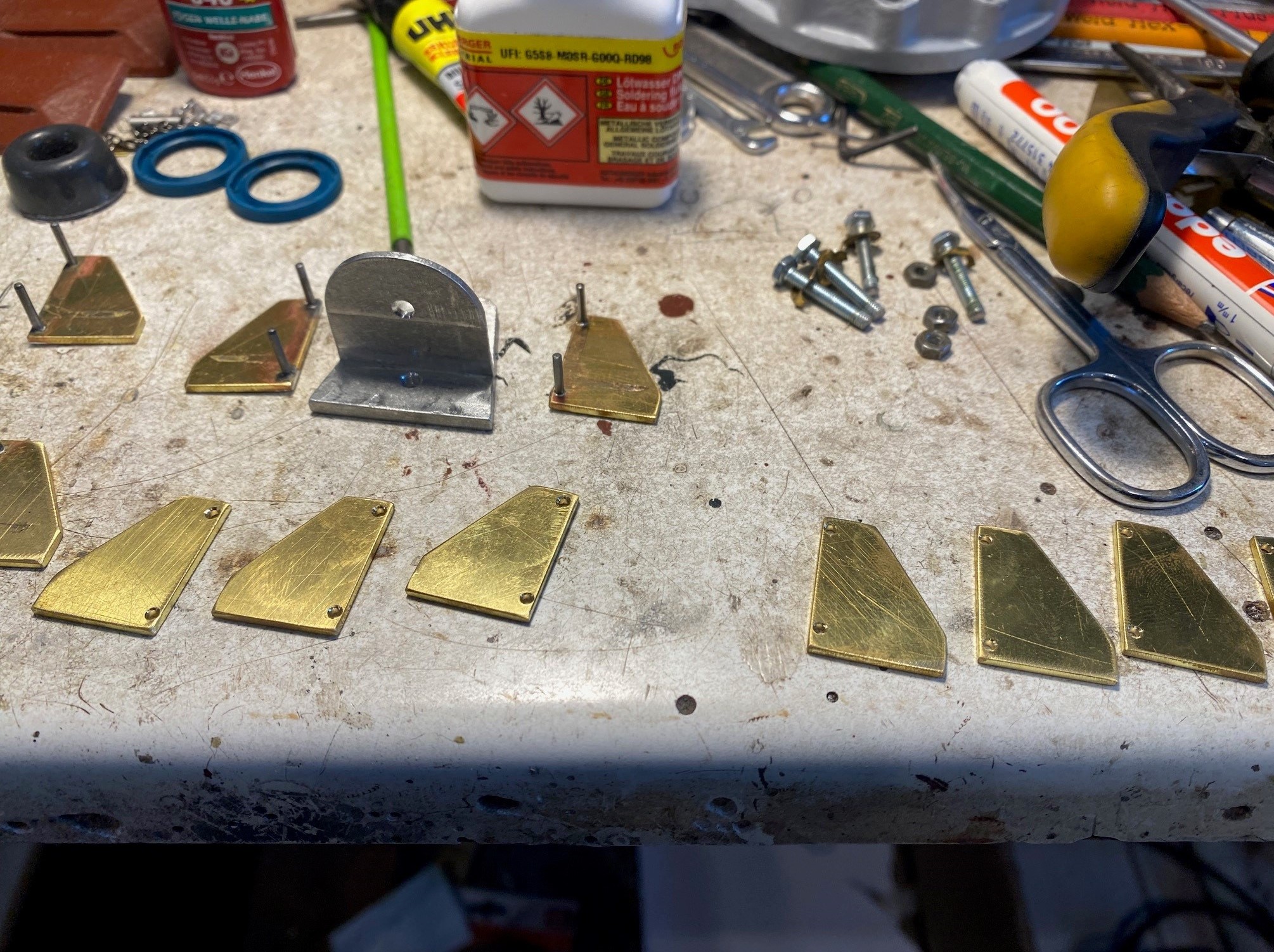

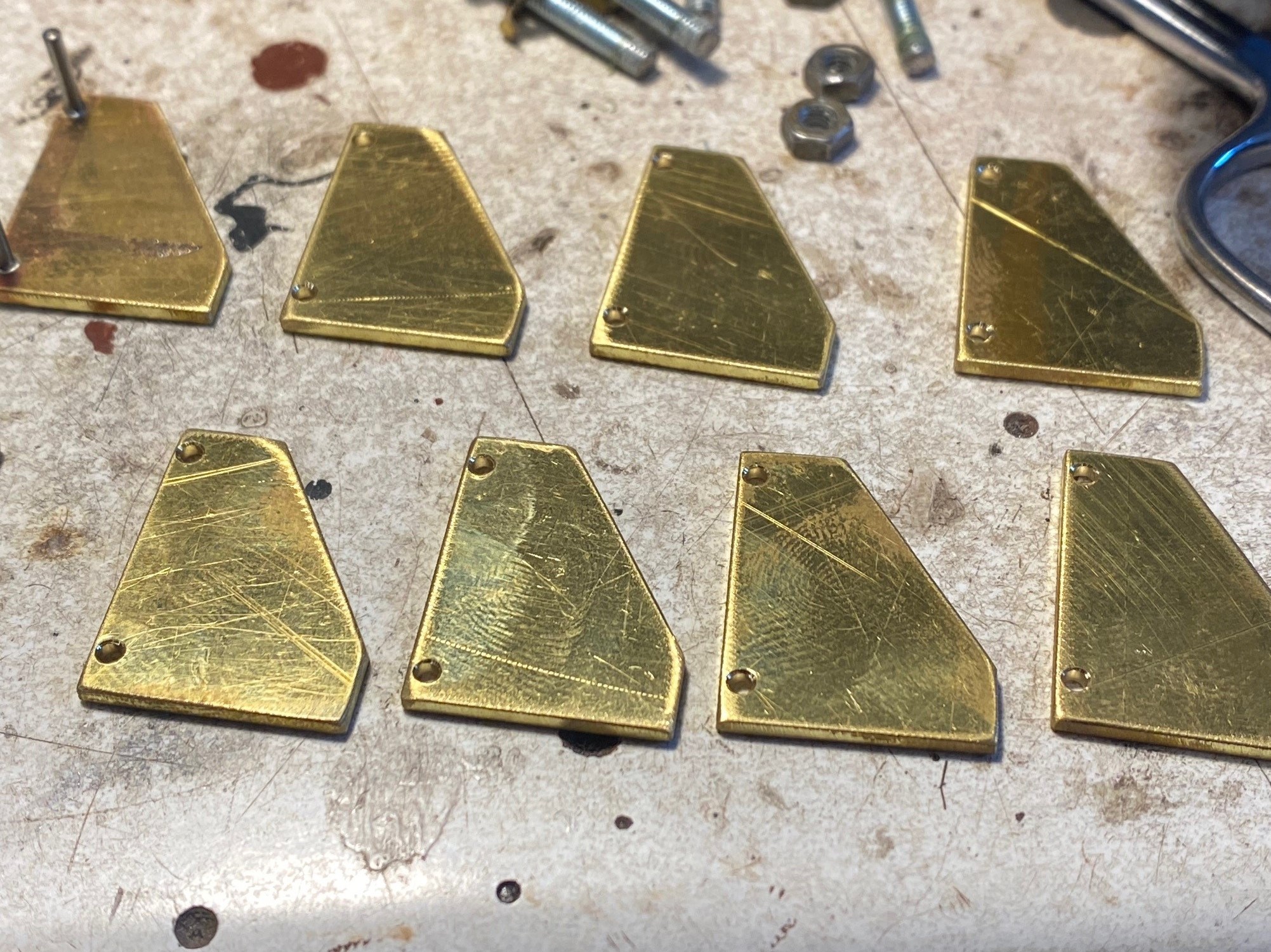

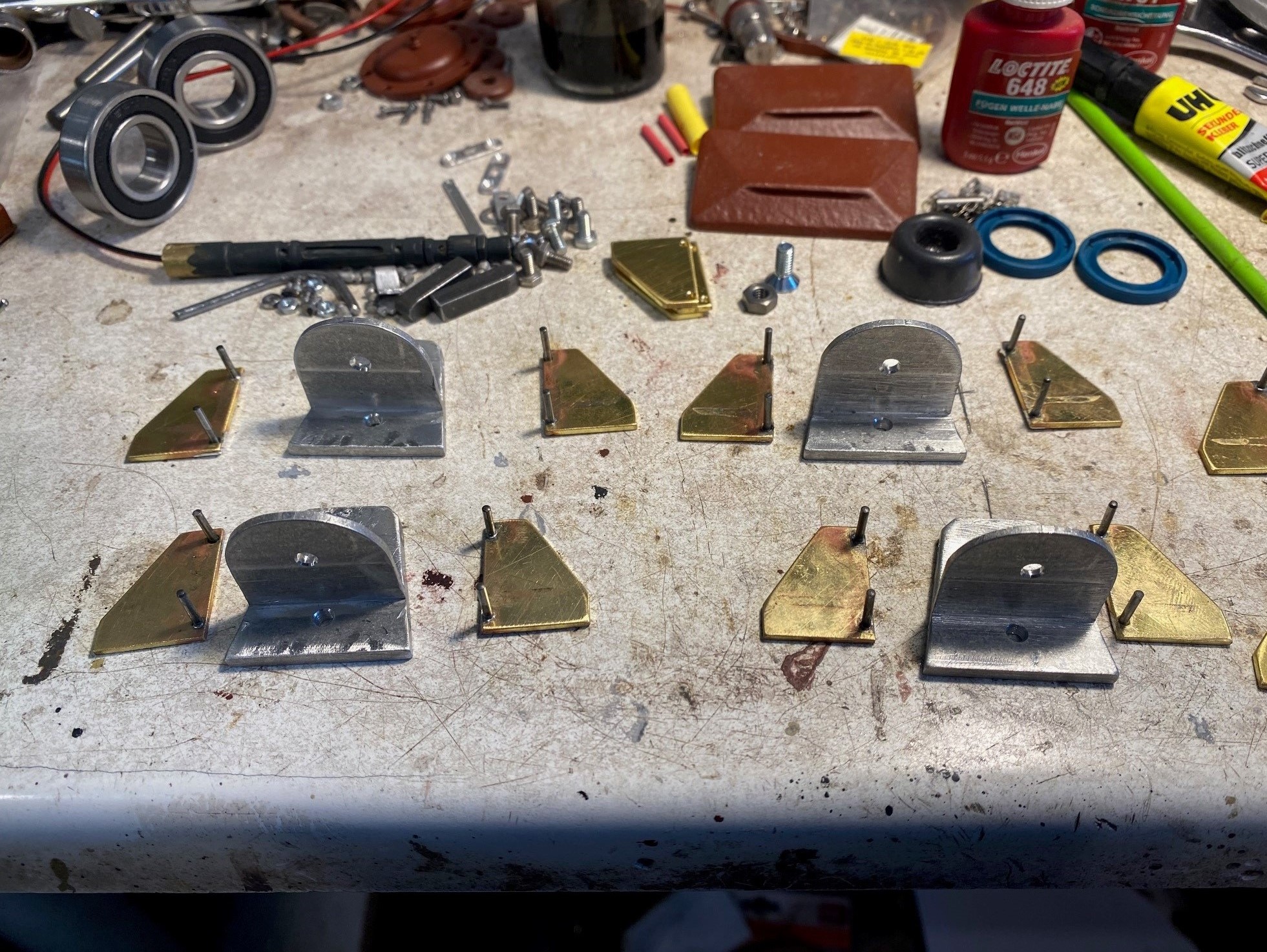

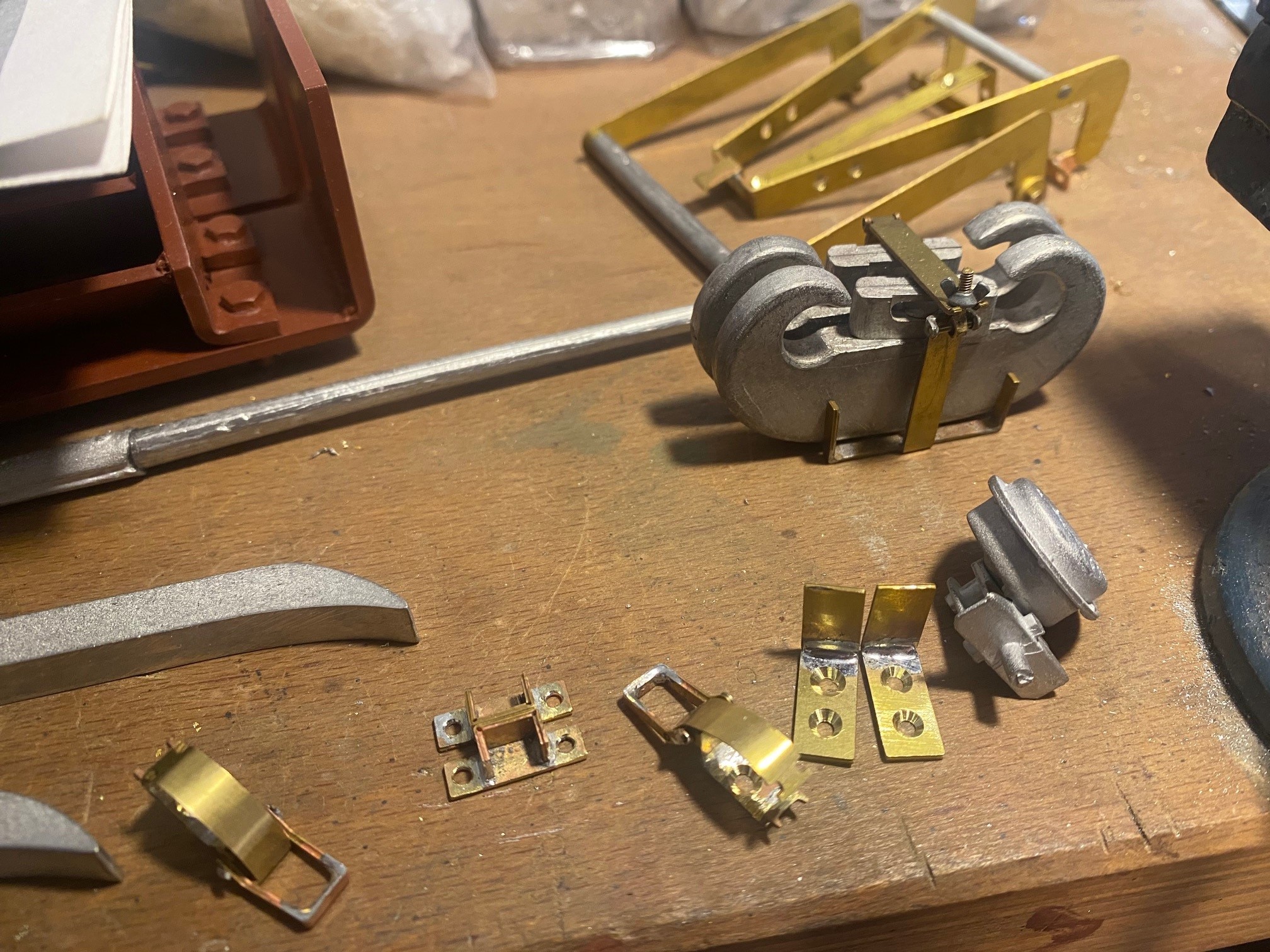

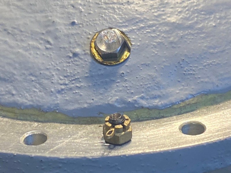

thanks for the nice words. Here are the next level of details from the bump stops. Ordered brass plates from a laser cutter, milled the origin bump stops from Armortek and soldered pins into the plates. After this i glued the plates into the holes on the sides. Make some welding seams and glued on a fake screw for the rubber - will follow after painting.
Regards Martin
