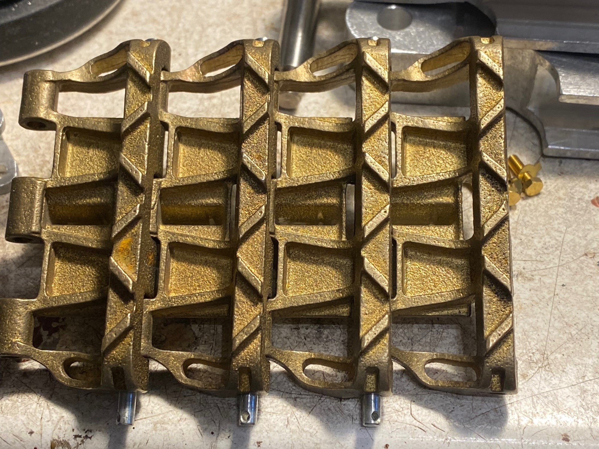

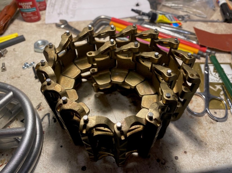

Great find Martin! THOSE tracks - Geisswerk! Fantastic. Will be watching!

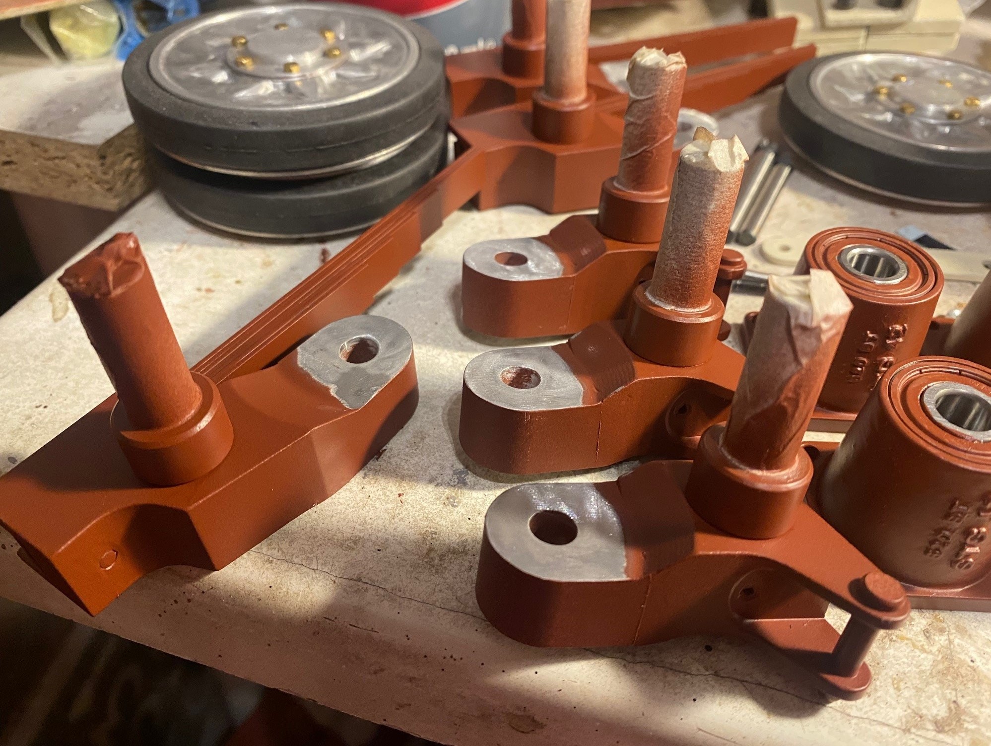

Re: Martin's Panzer IV
Hi Simon,
hi Bob,

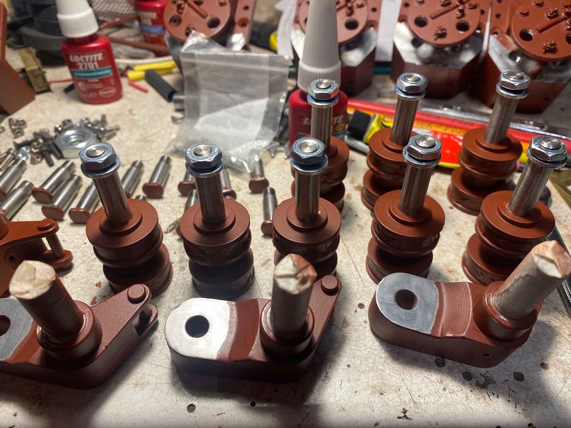

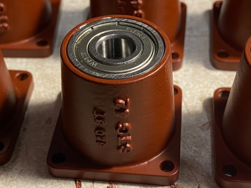

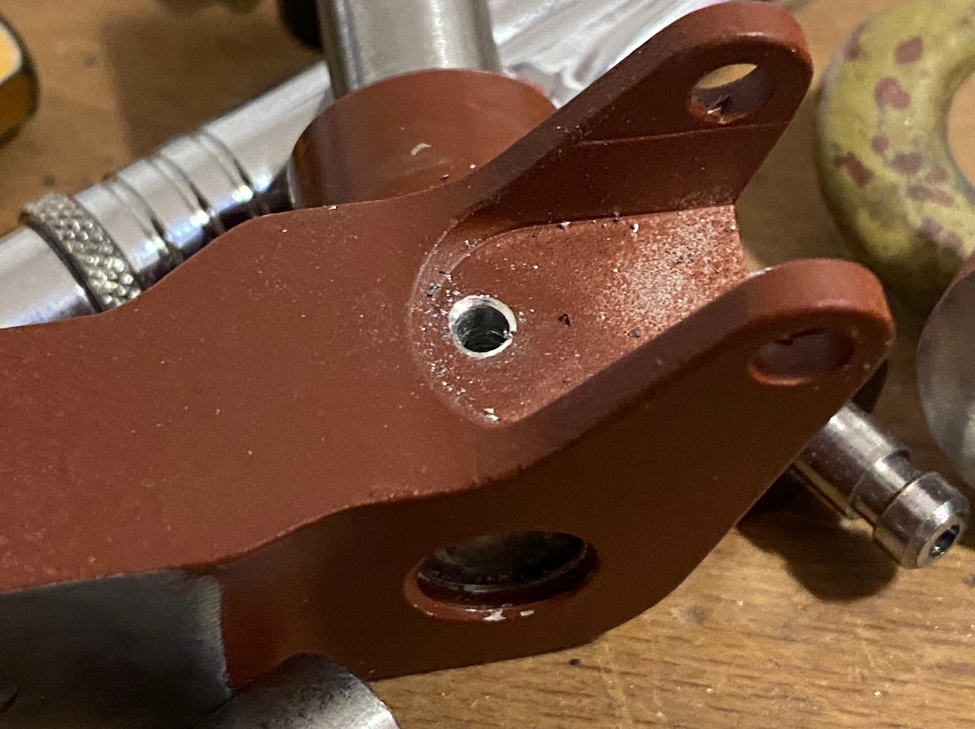

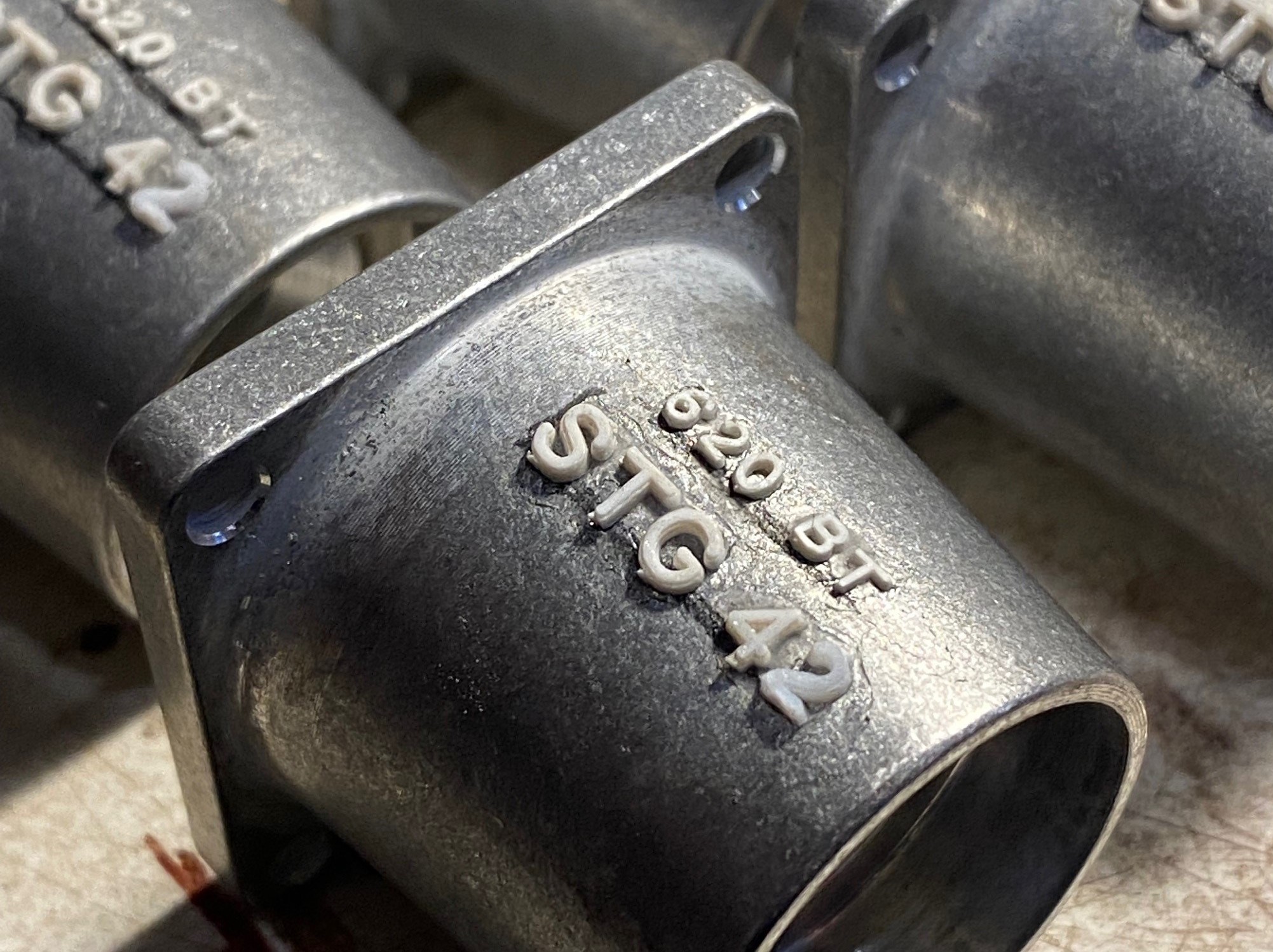

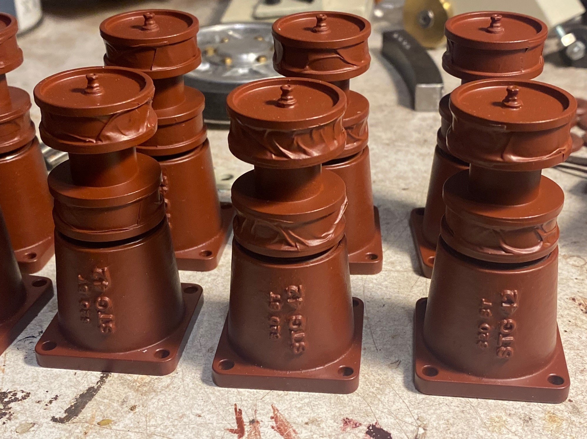

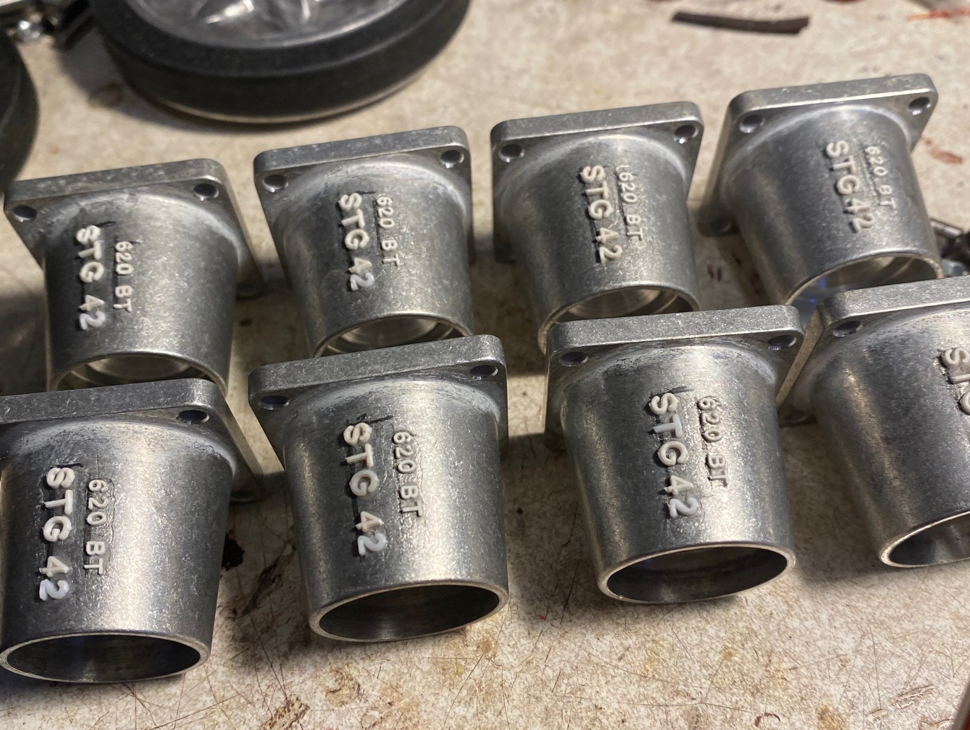

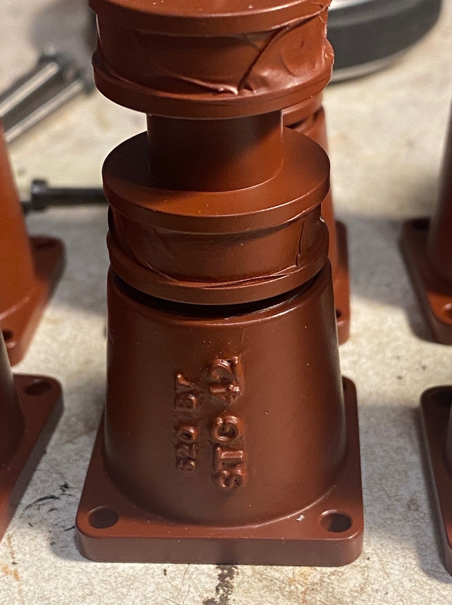

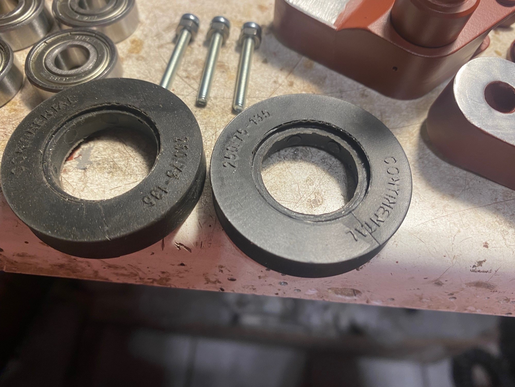

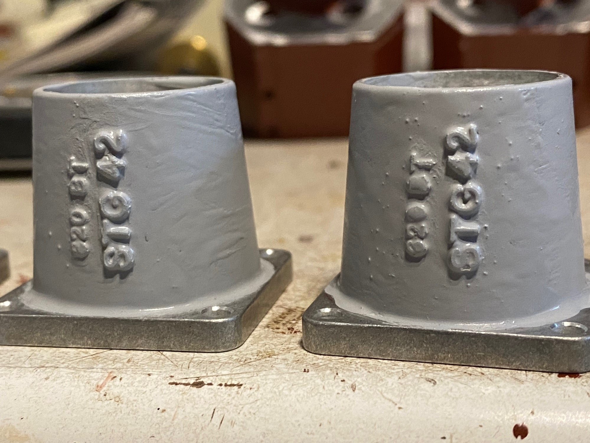

yes you are absolutely right the P IV is an absolut rare tank. Now i start with the casting numbers of the return roller housings, the leaf springs, the swing arms and the return rolls including the tires with numbers on.
hi Bob,
Regards Martin

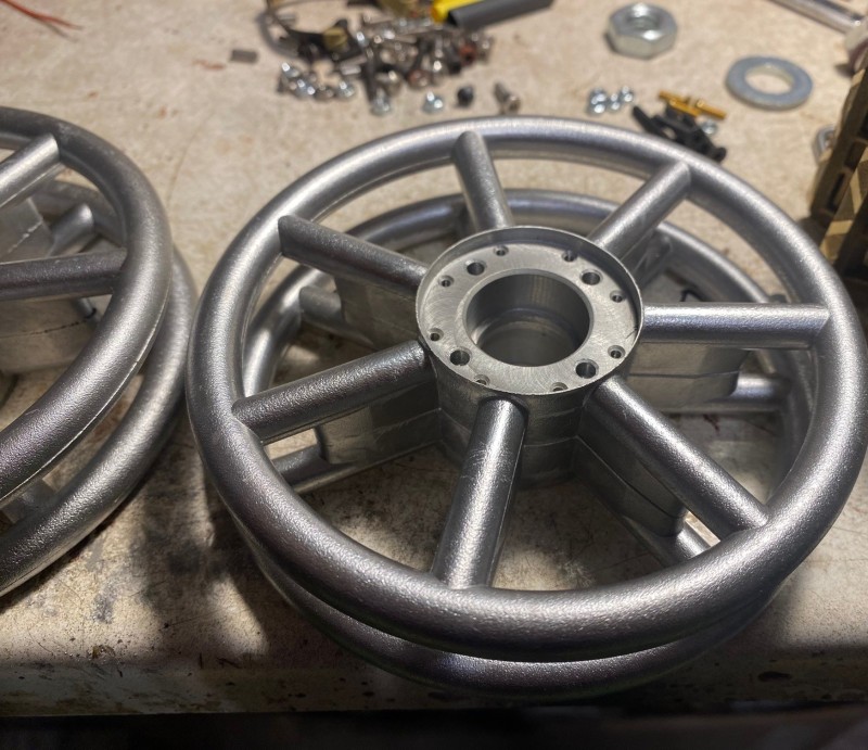

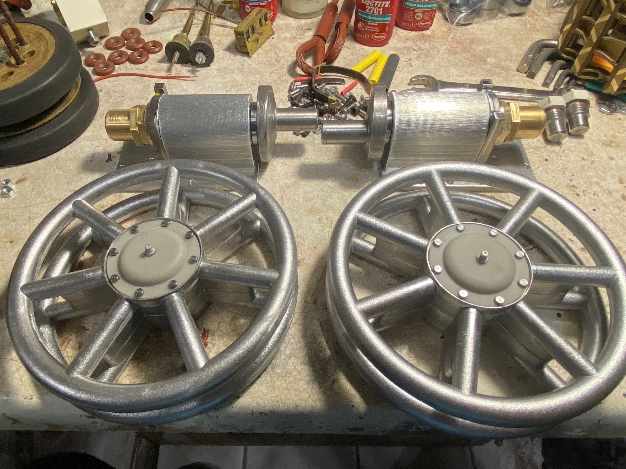

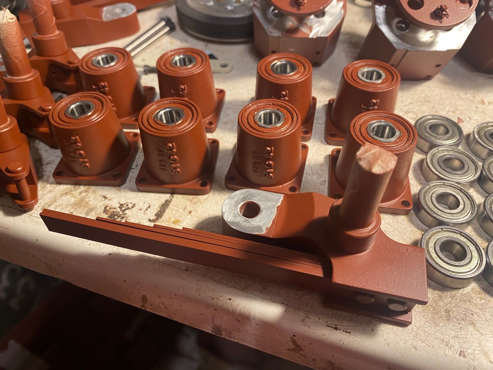

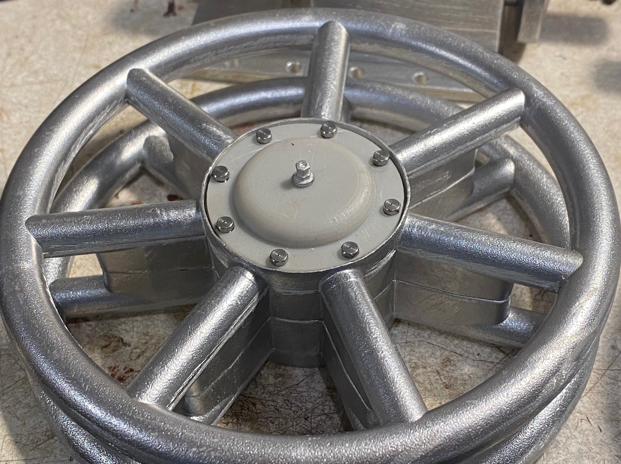

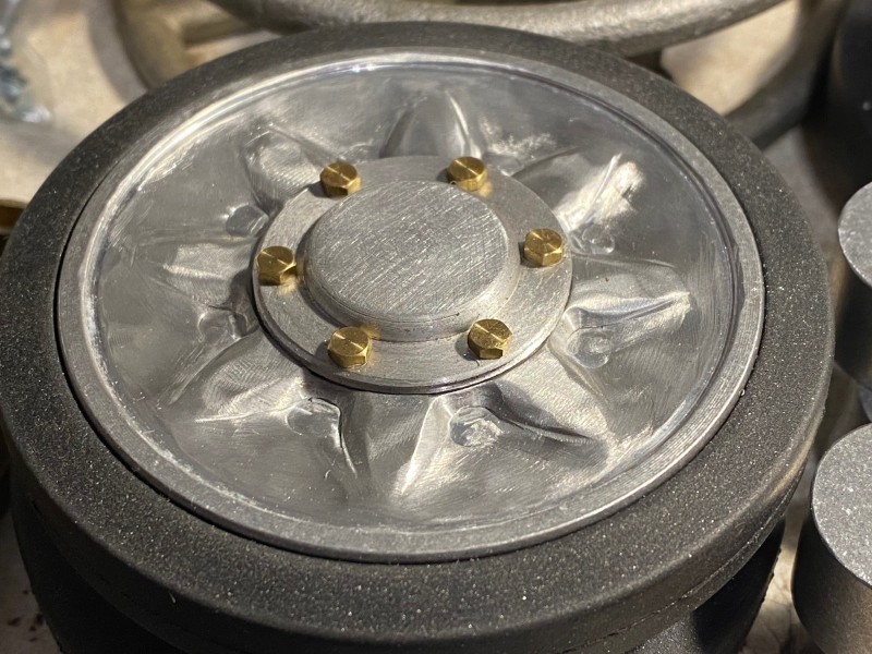

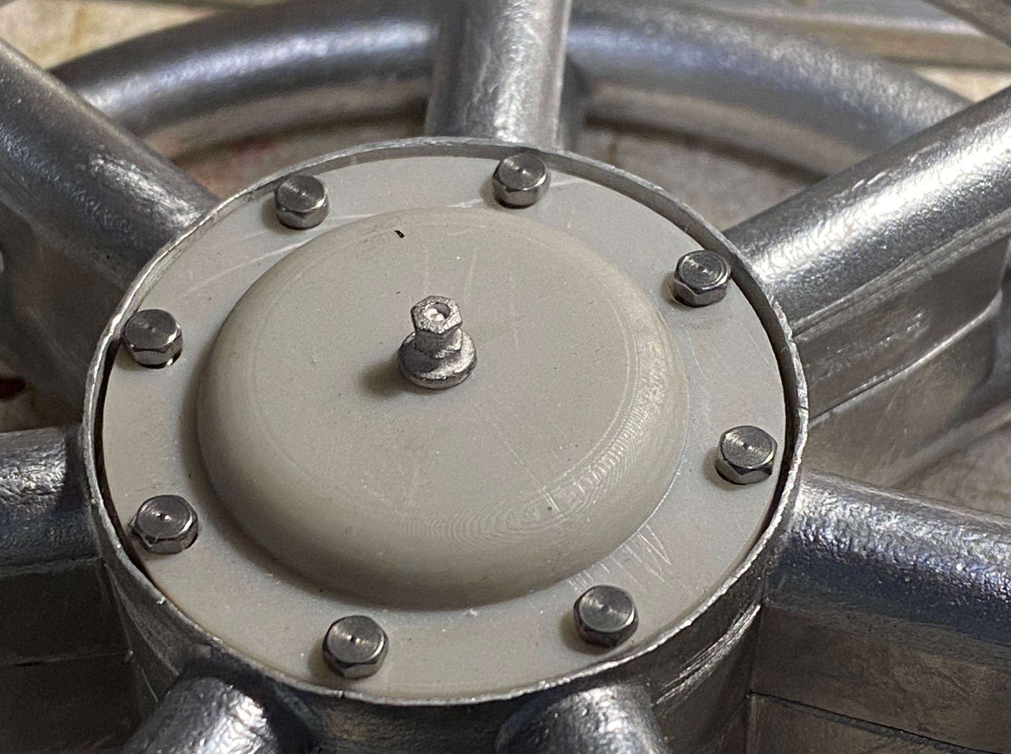

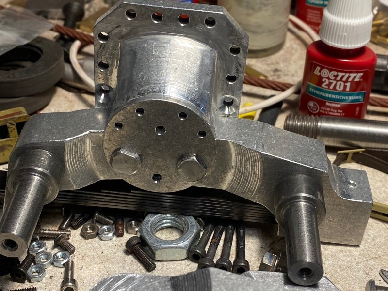

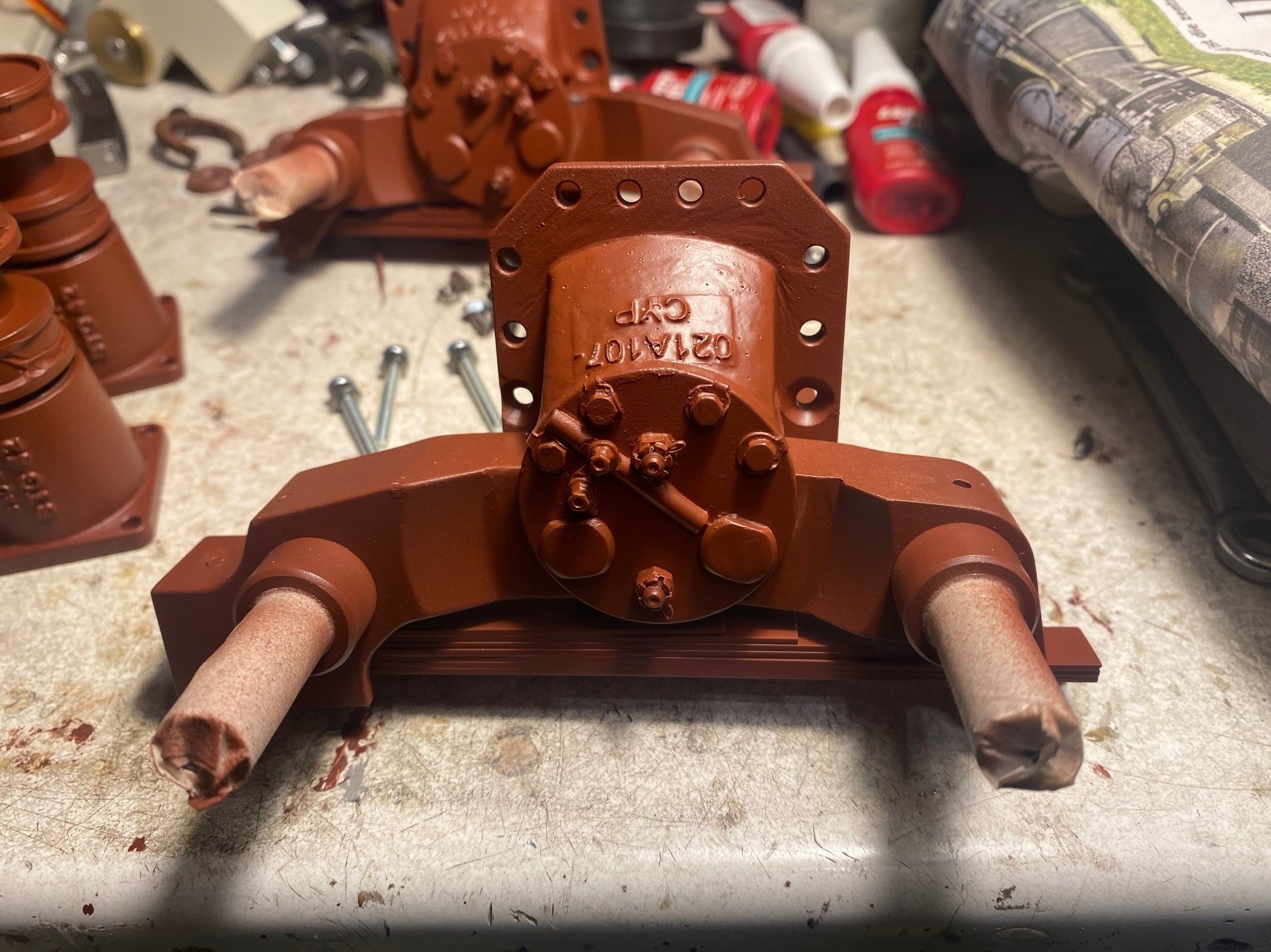

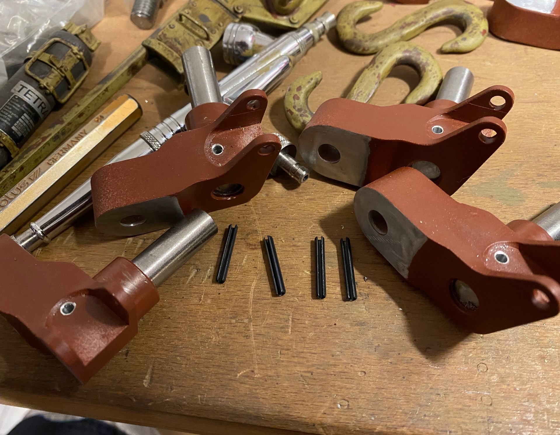

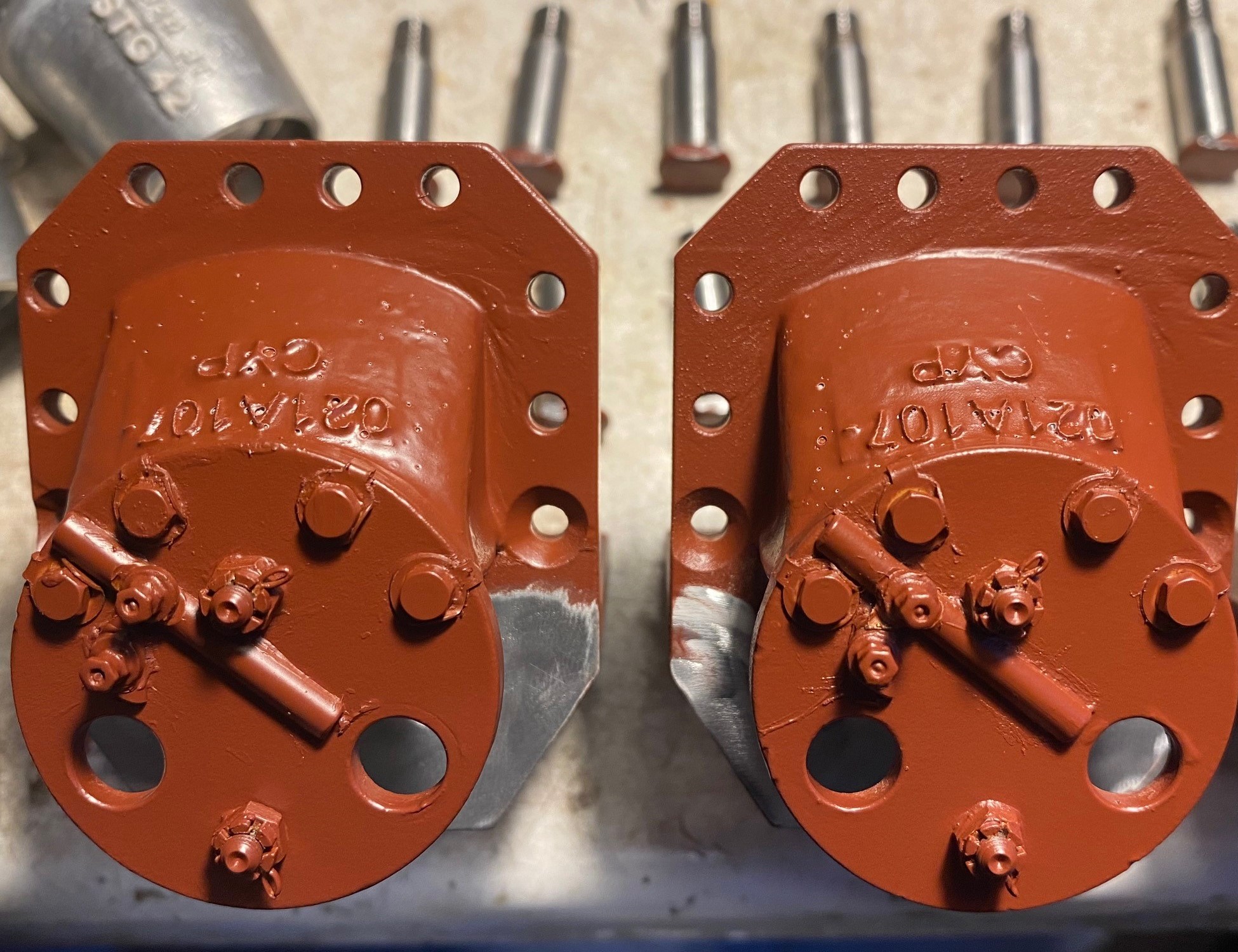

Some more progress with the boogies, the return roller bearings and the idler wheels. The wheels are from my friend Heiko and they are casted and machined by a friend of him.
Regards Martin

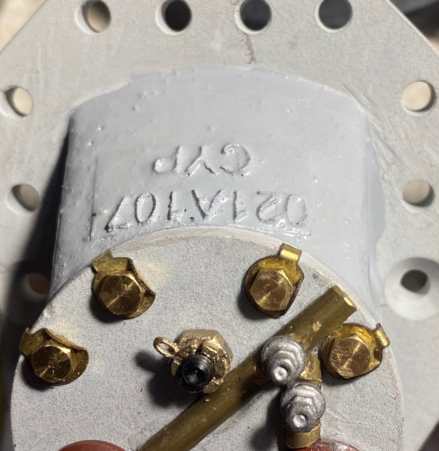

Looking great. May I ask where you got the letters for the casting numbers?Martin Hofmann wrote: ↑Wed Oct 26, 2022 1:34 pmHi Simon,

thank you so much for your kind word. The letters are from a shop in netherland - sorry i don't remember the name. For search use: plastic letters 3mm. Google will help you very fast. I think in this forum are also threads about this.

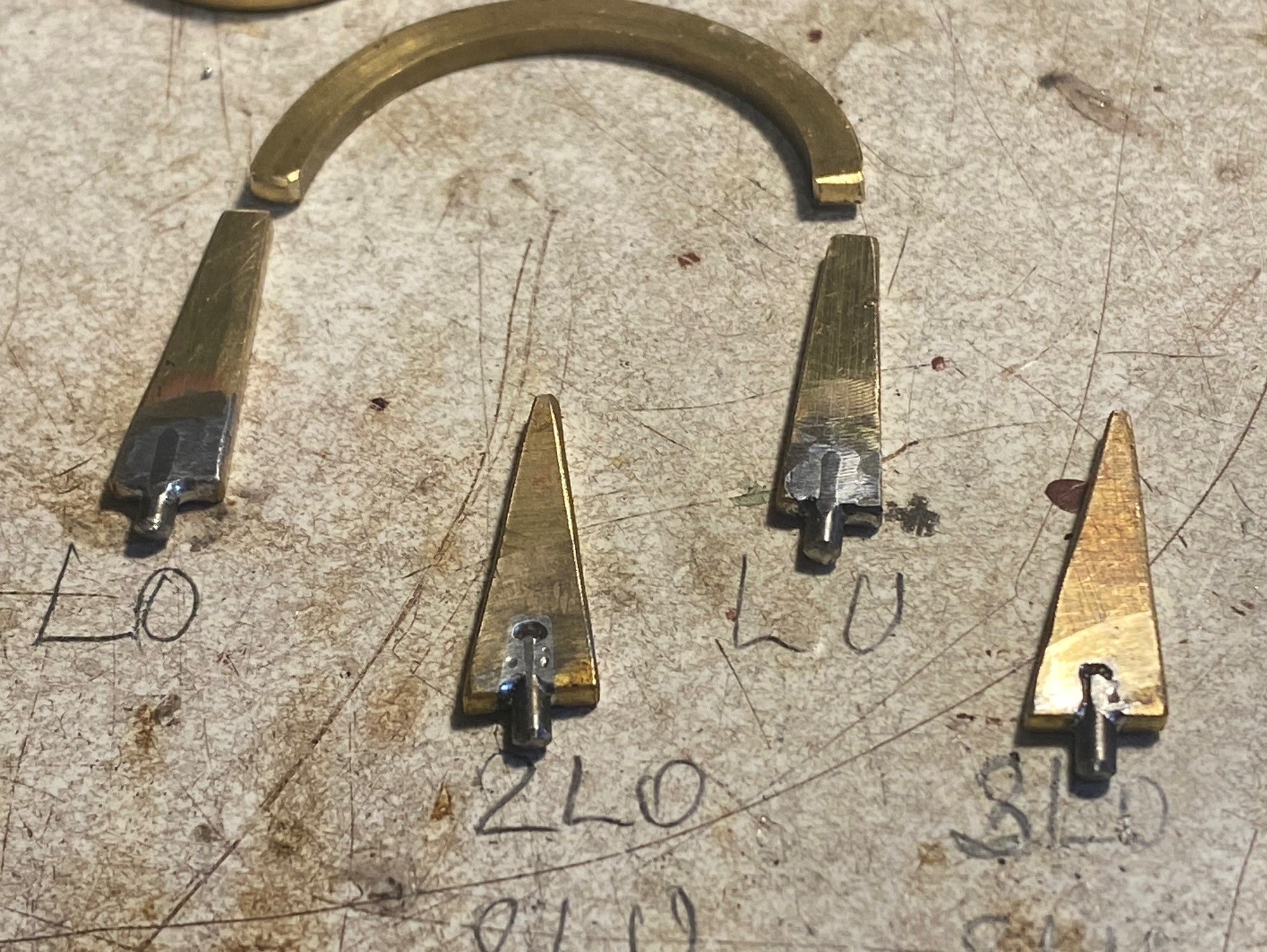

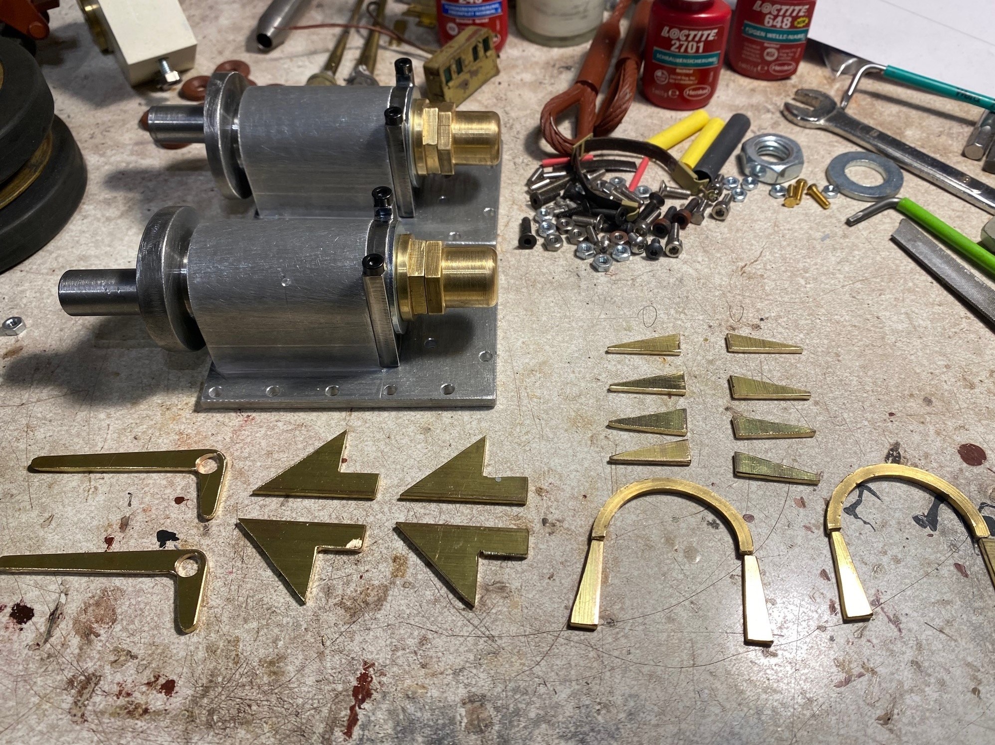

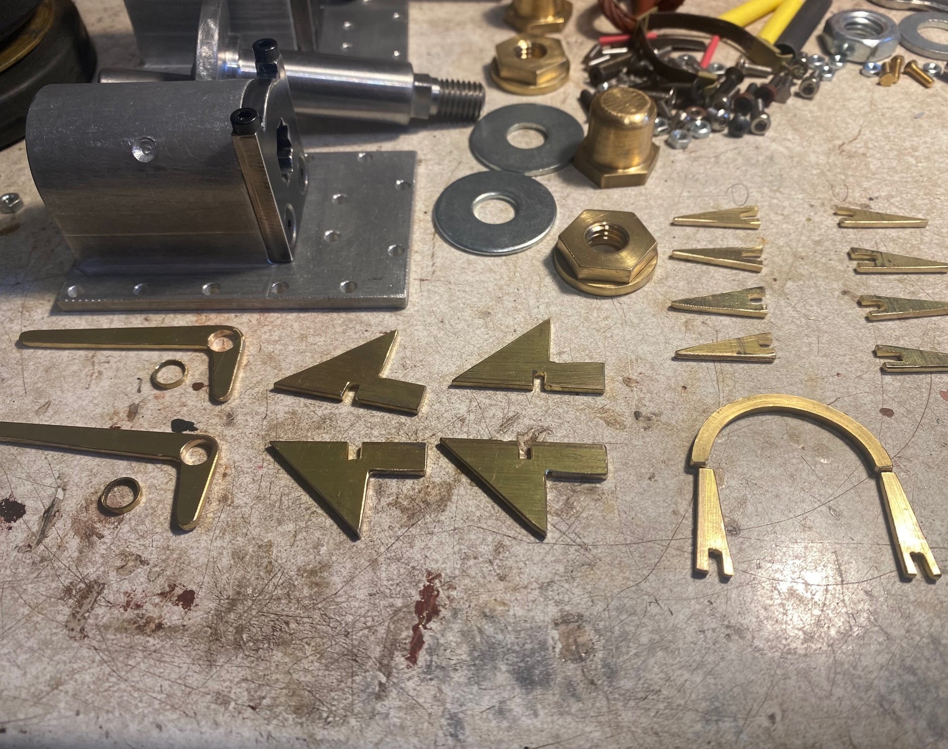

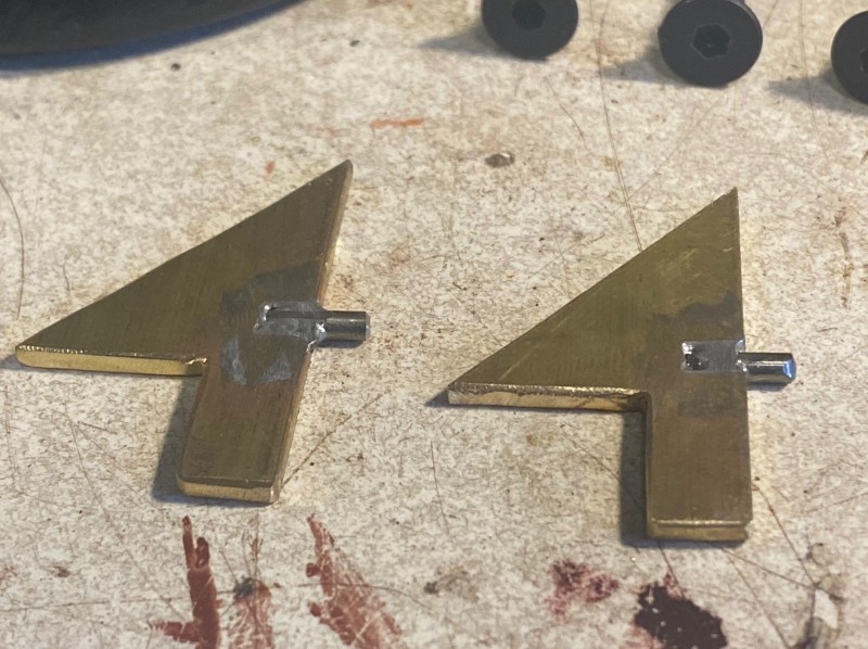

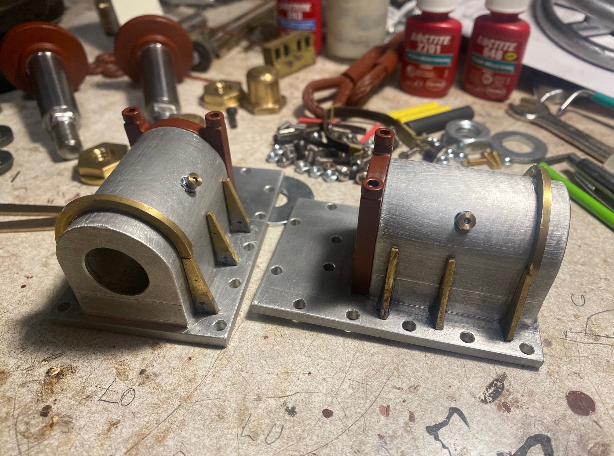

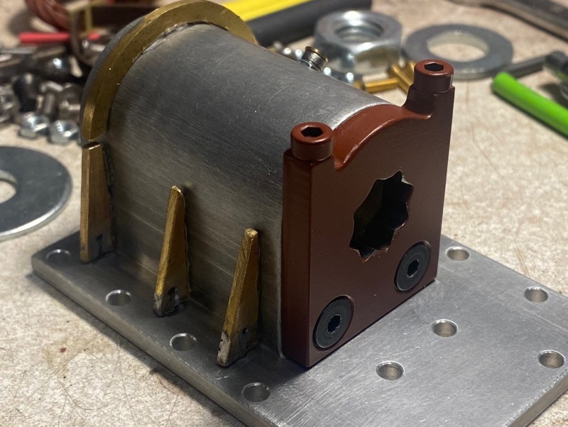

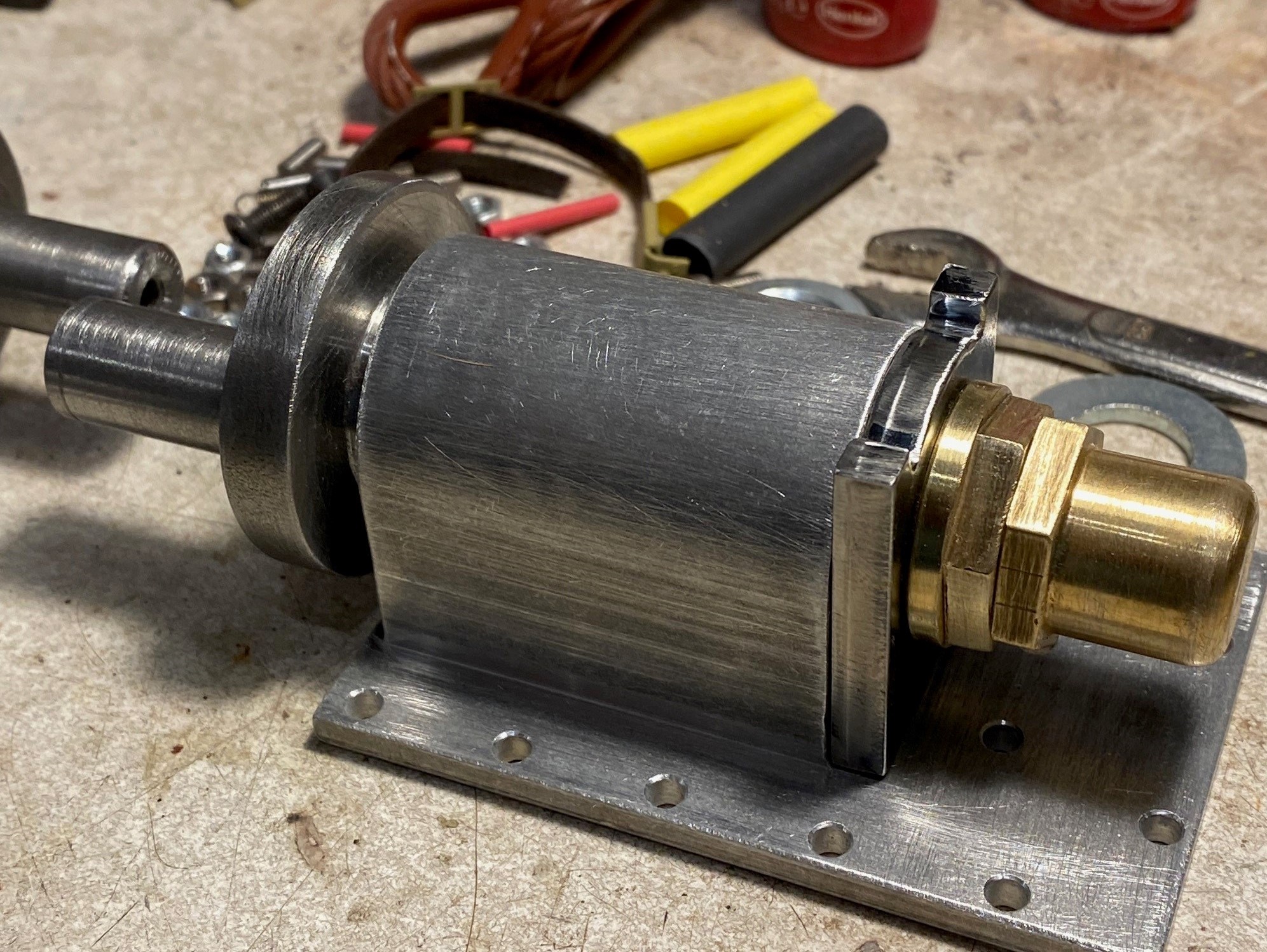

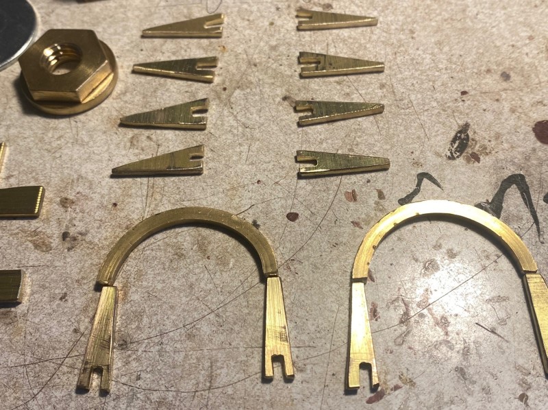

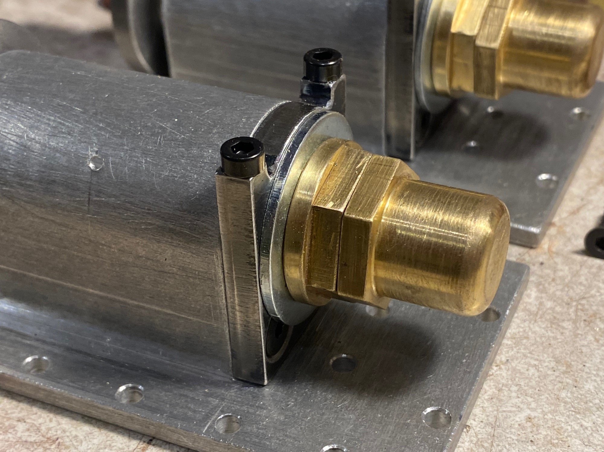

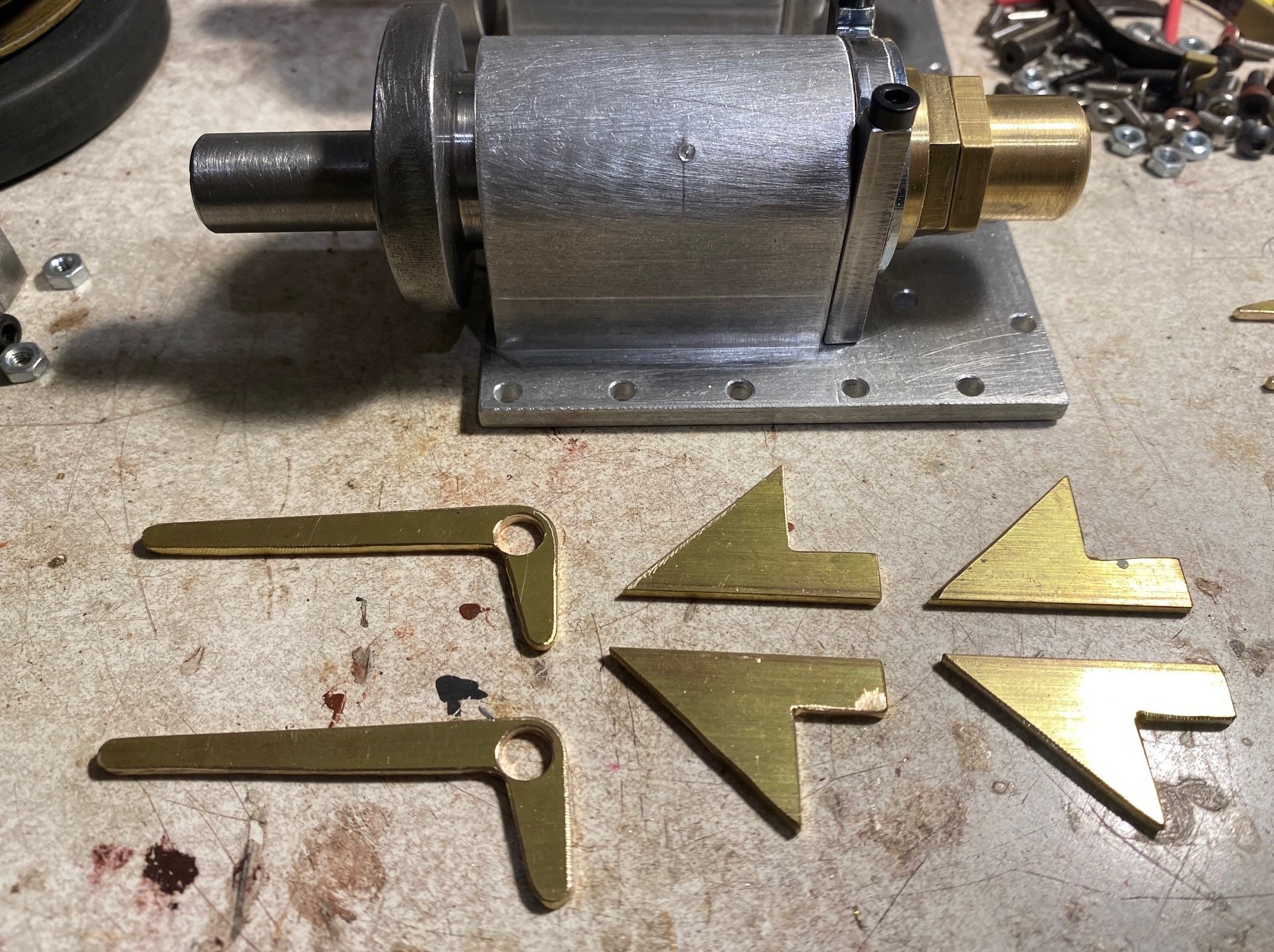

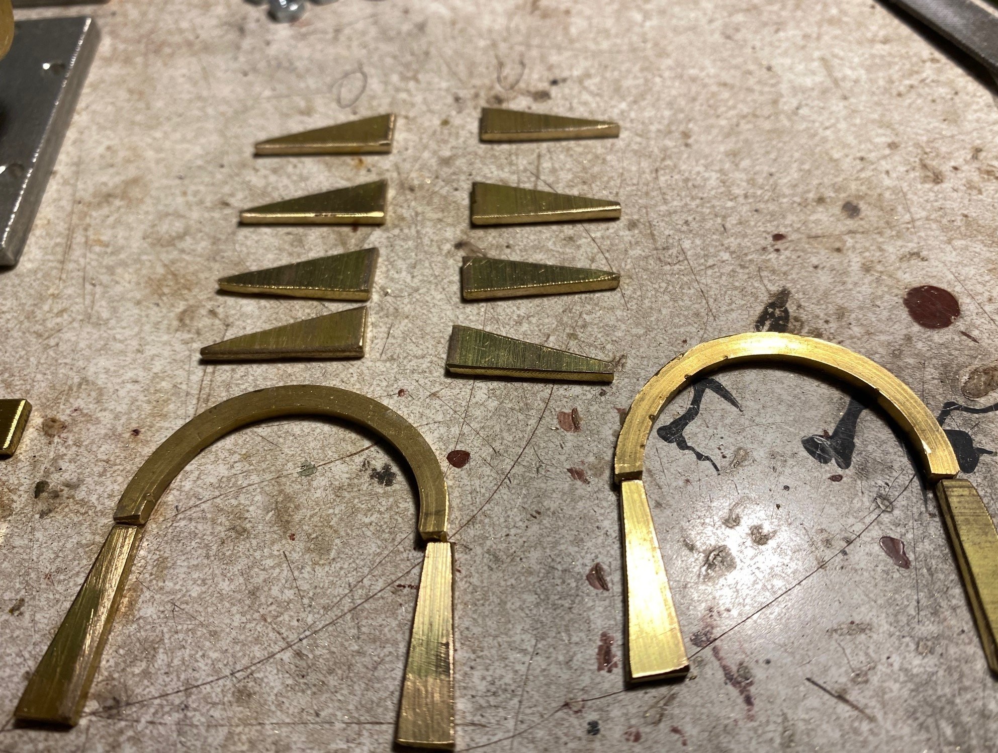

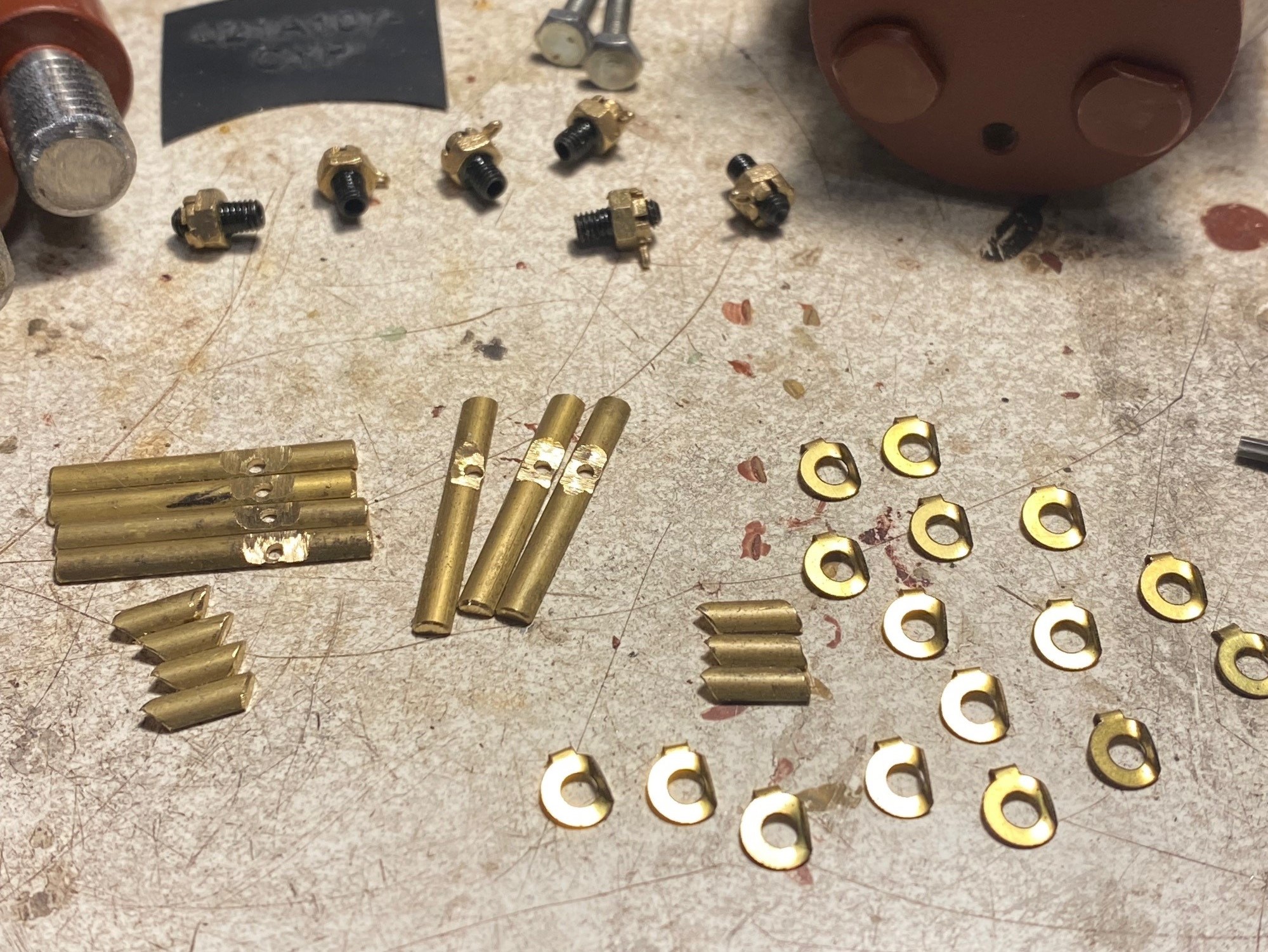

Here are the next step for making some ribs at the side of the idler mounting block. For better holding i make a slot into the rib and solder a pin into this place. The opposite side will get holes for good contact with the glue.

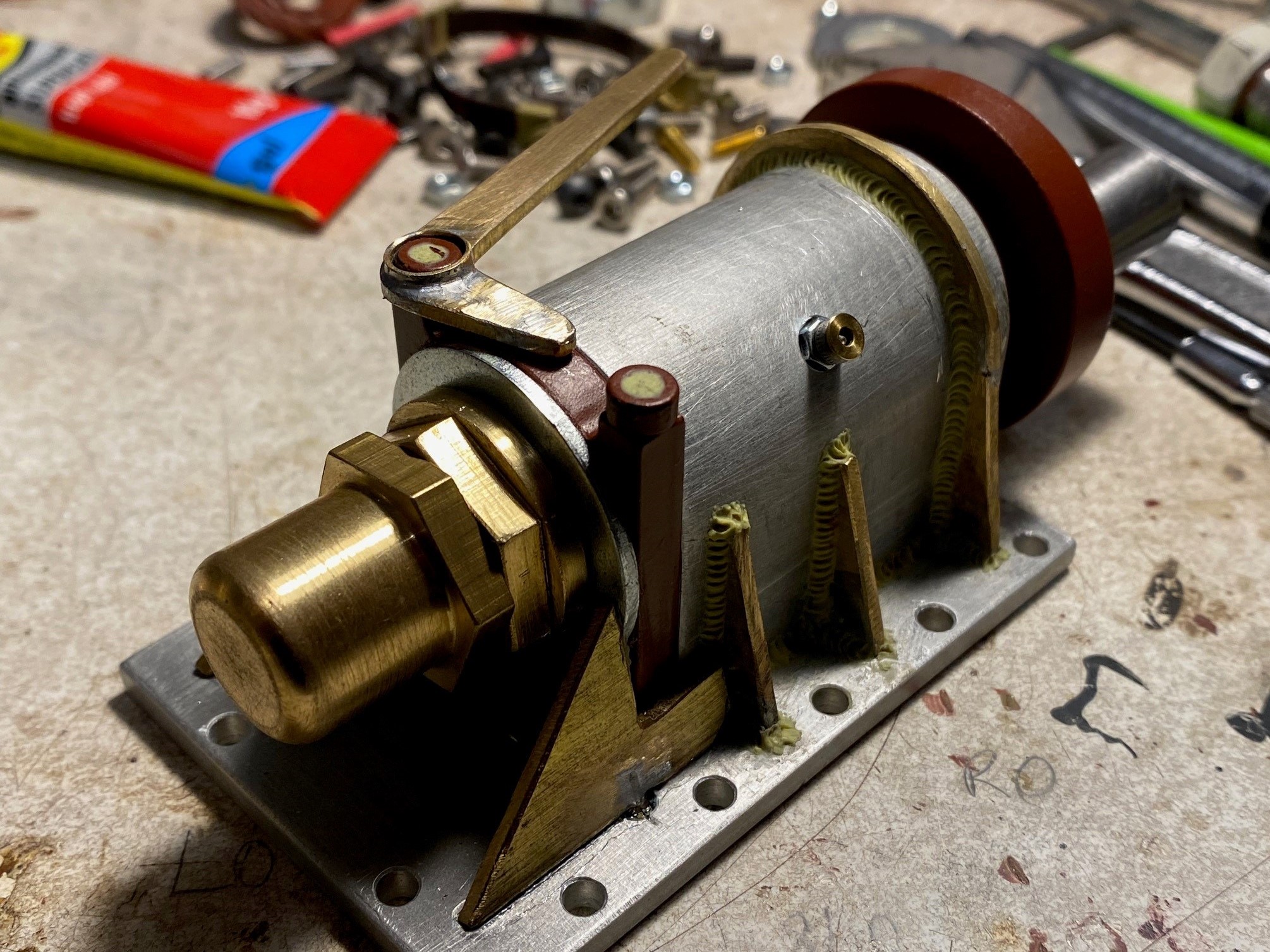

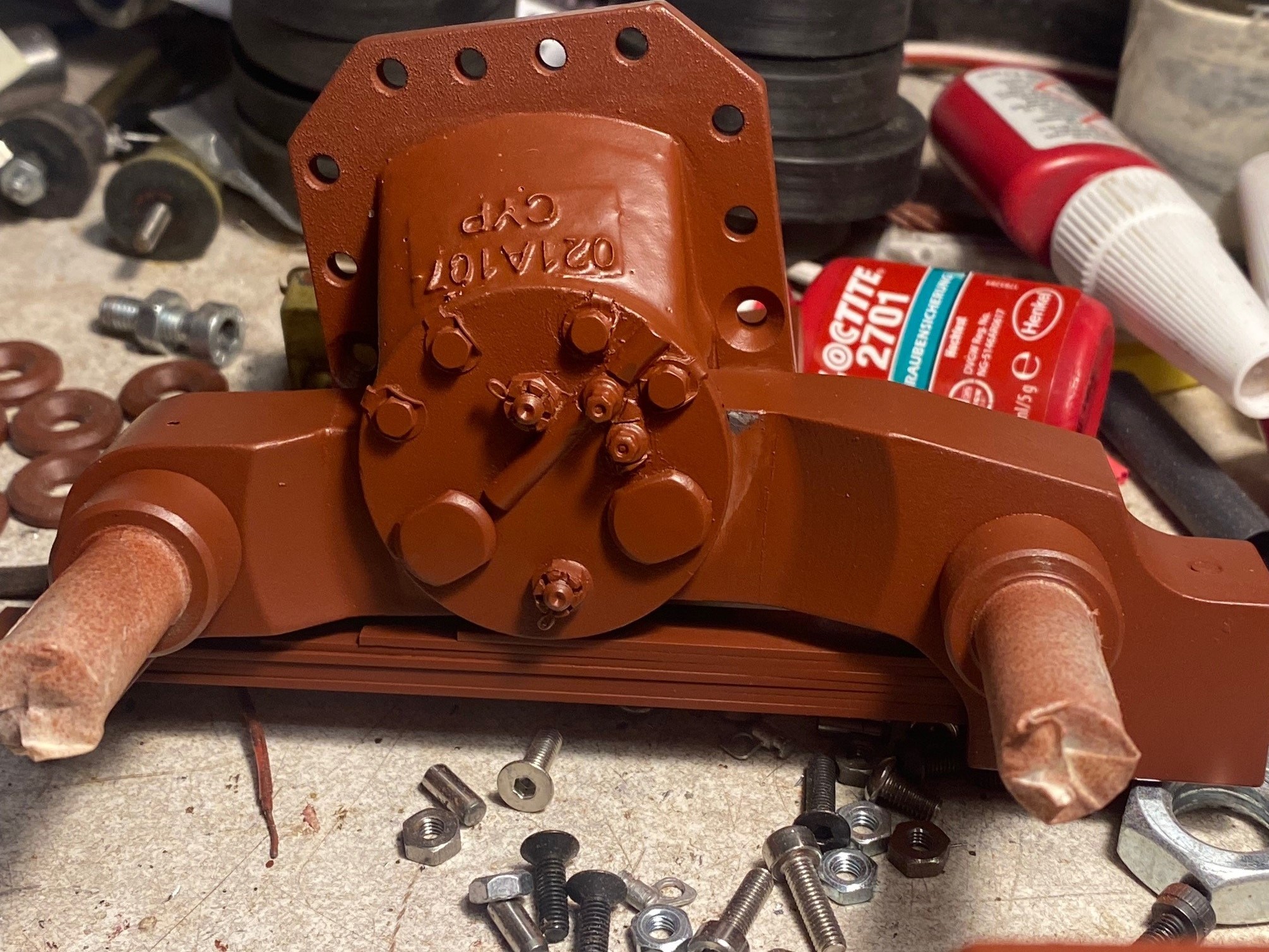

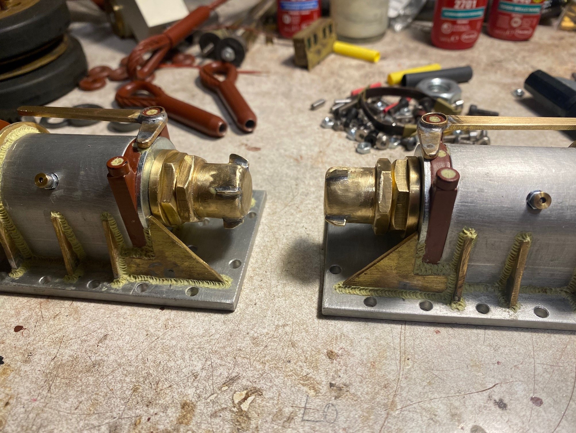

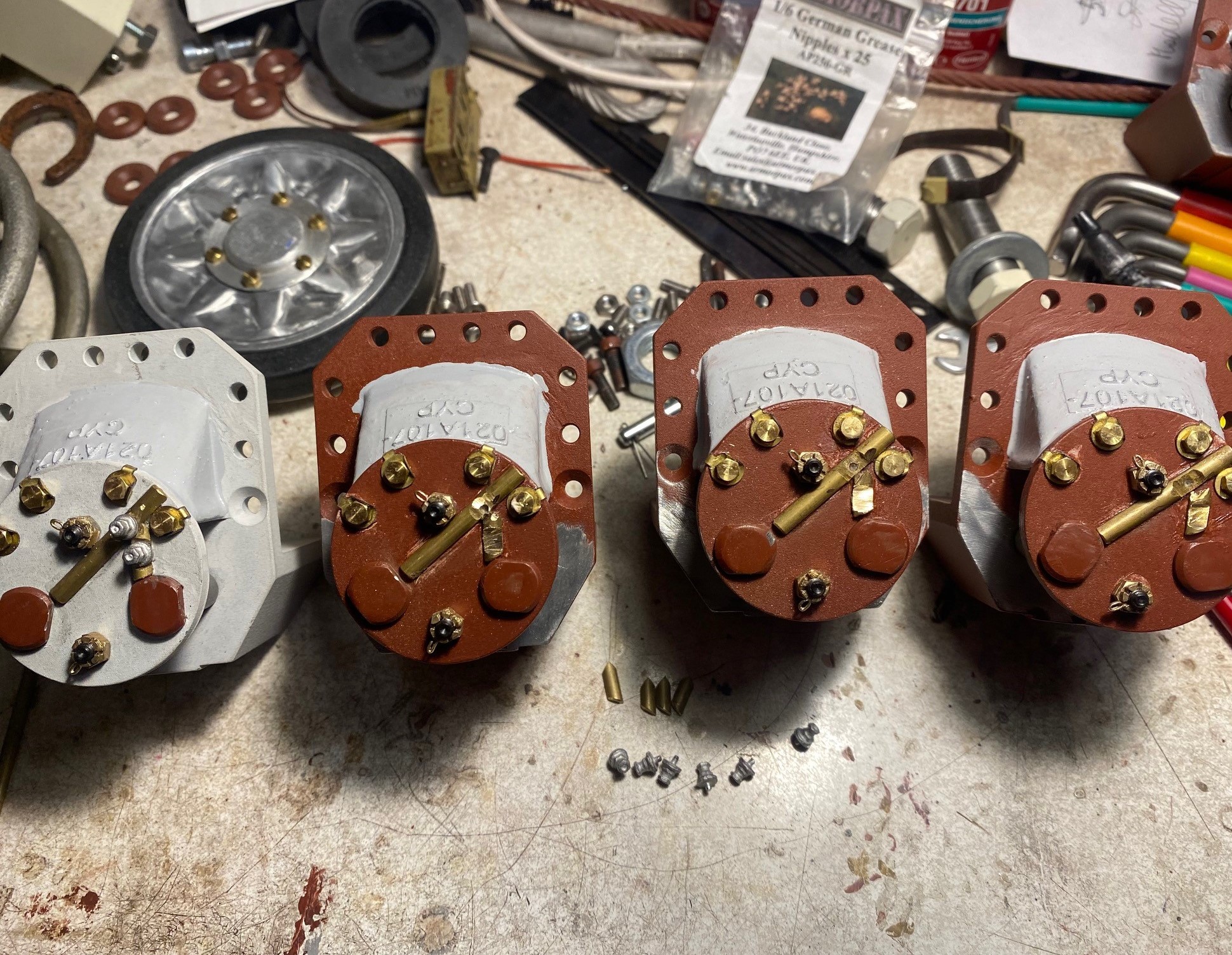

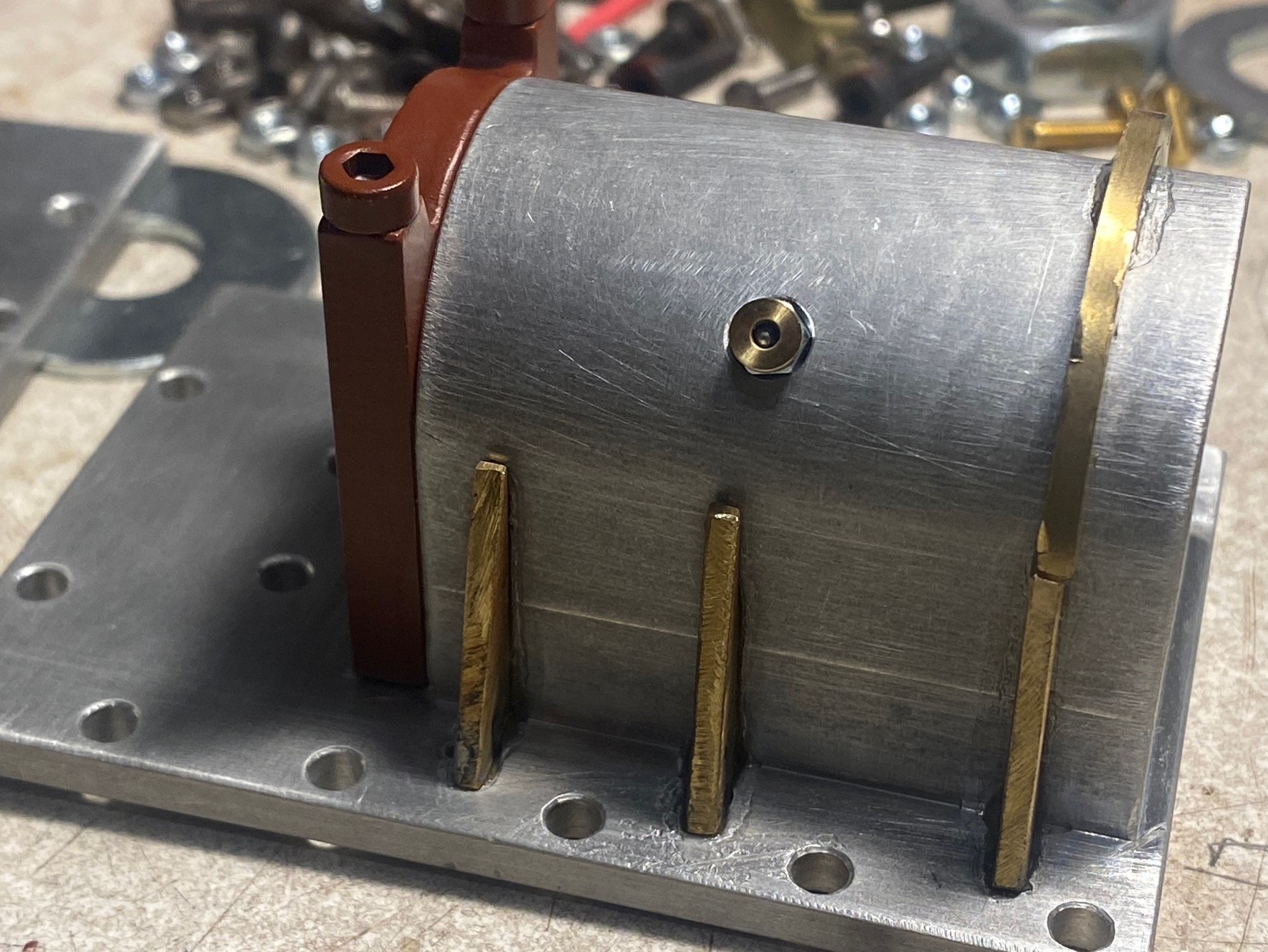

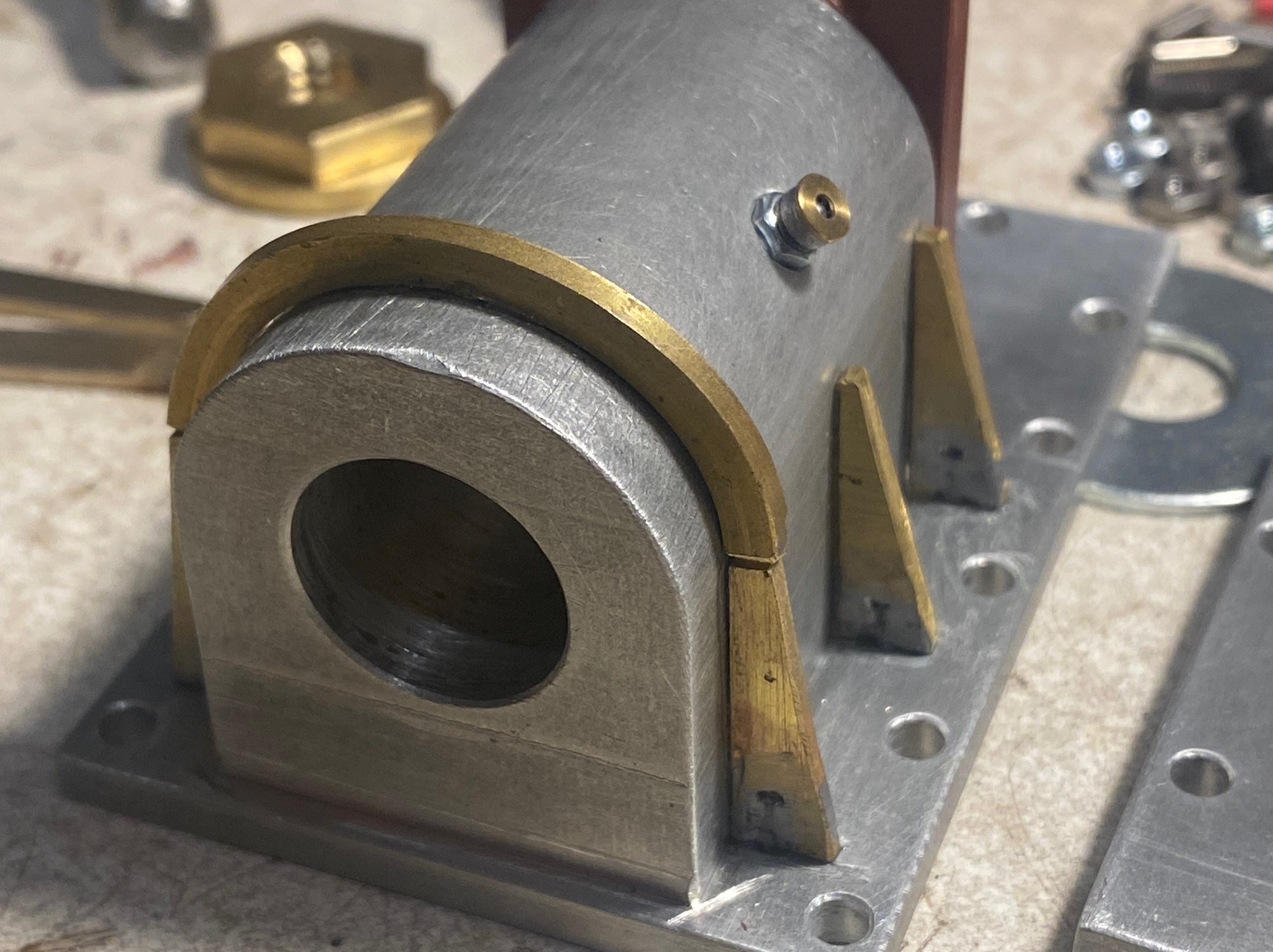

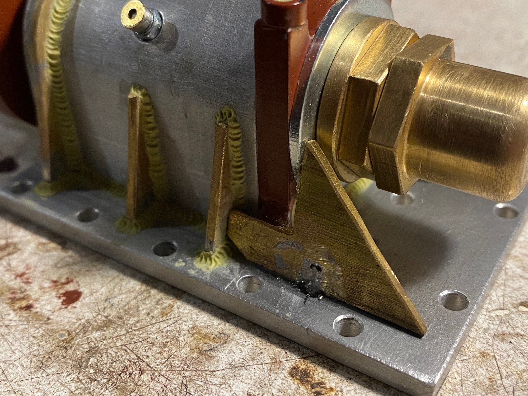

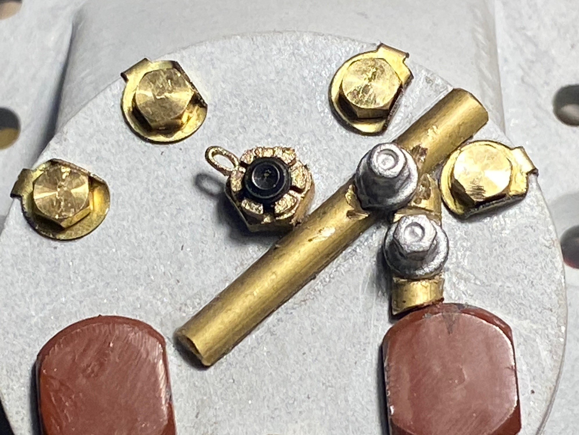

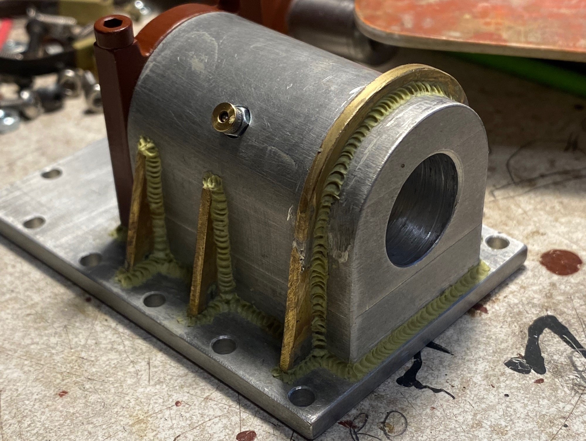

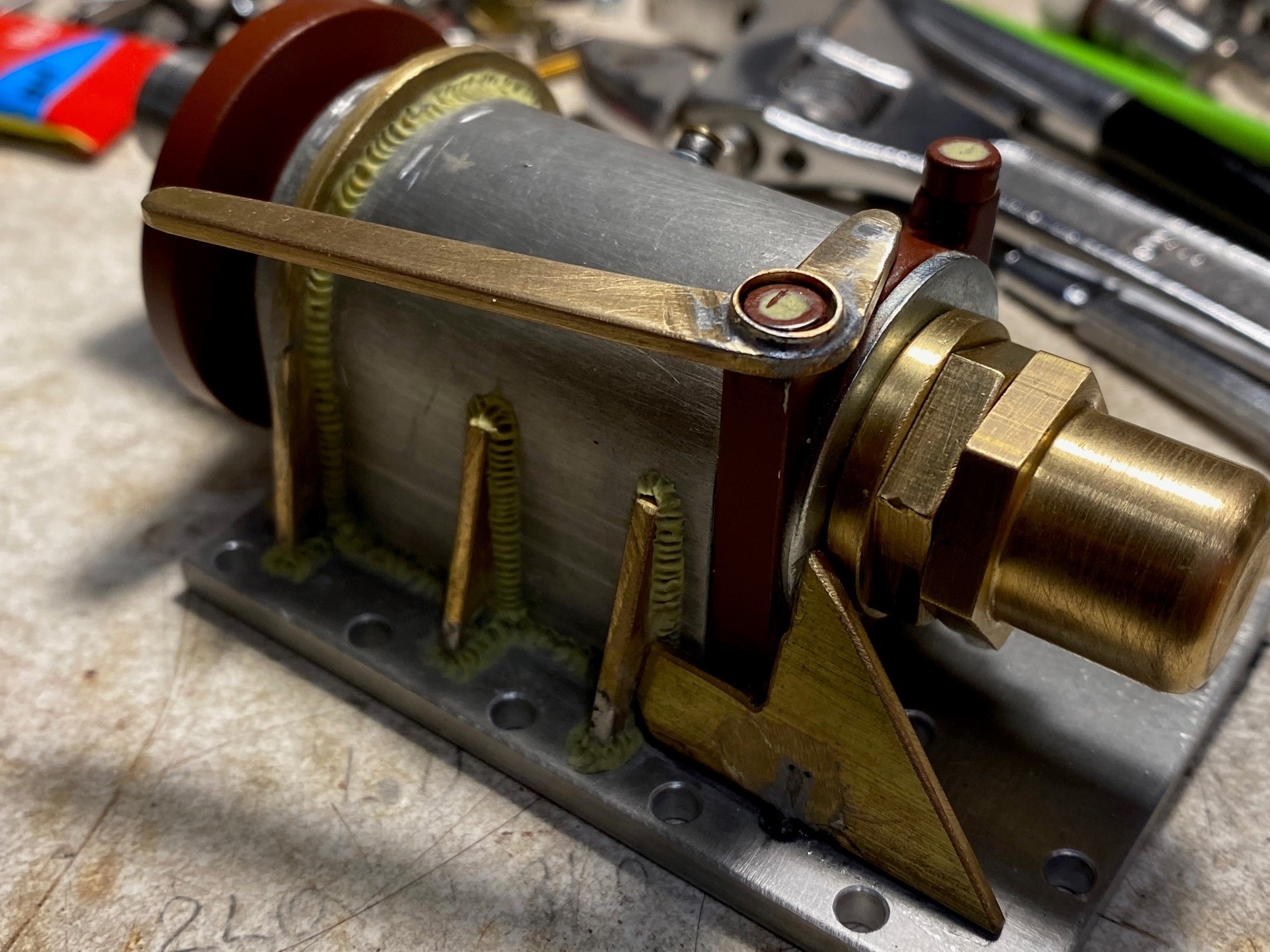

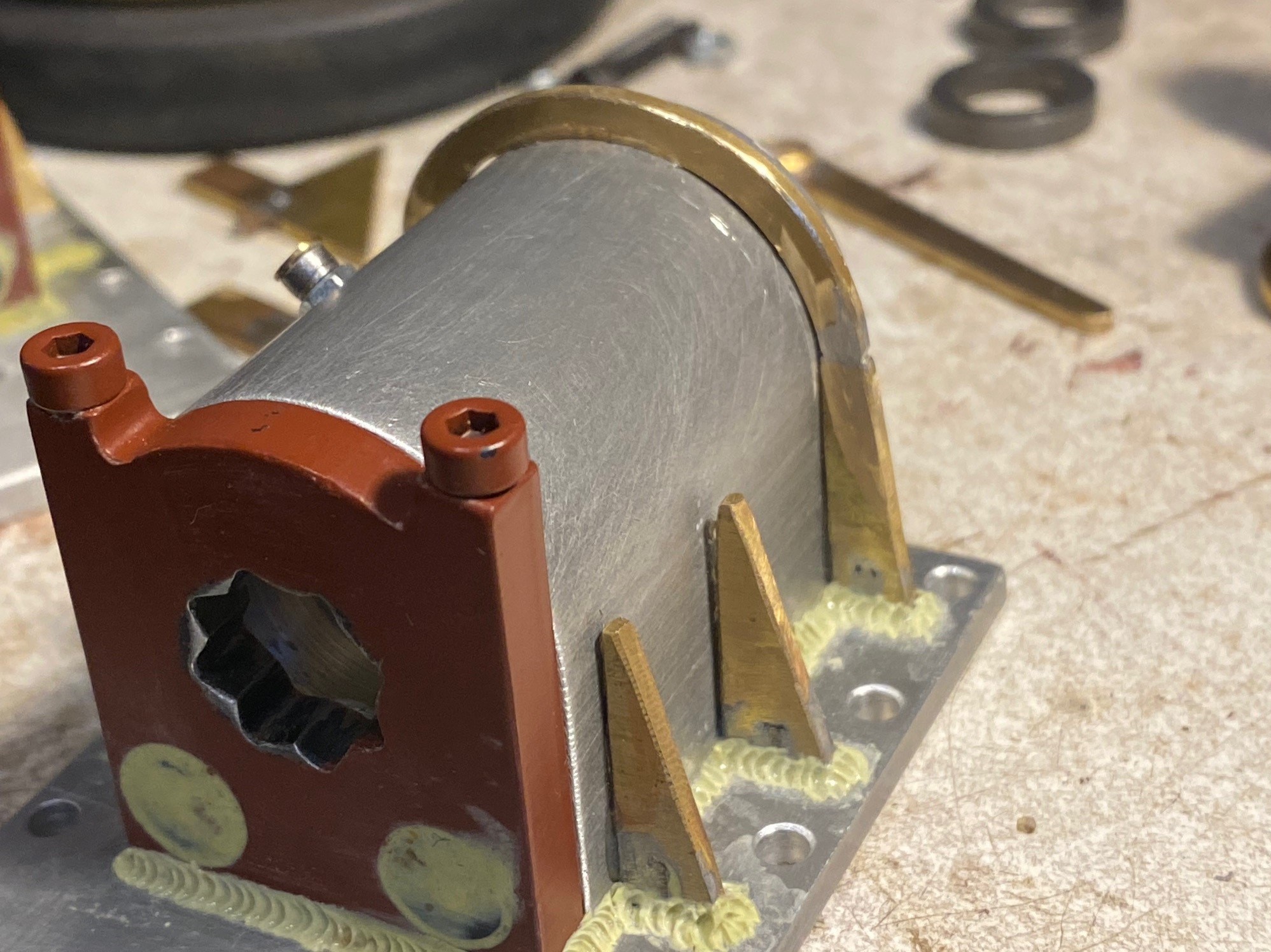

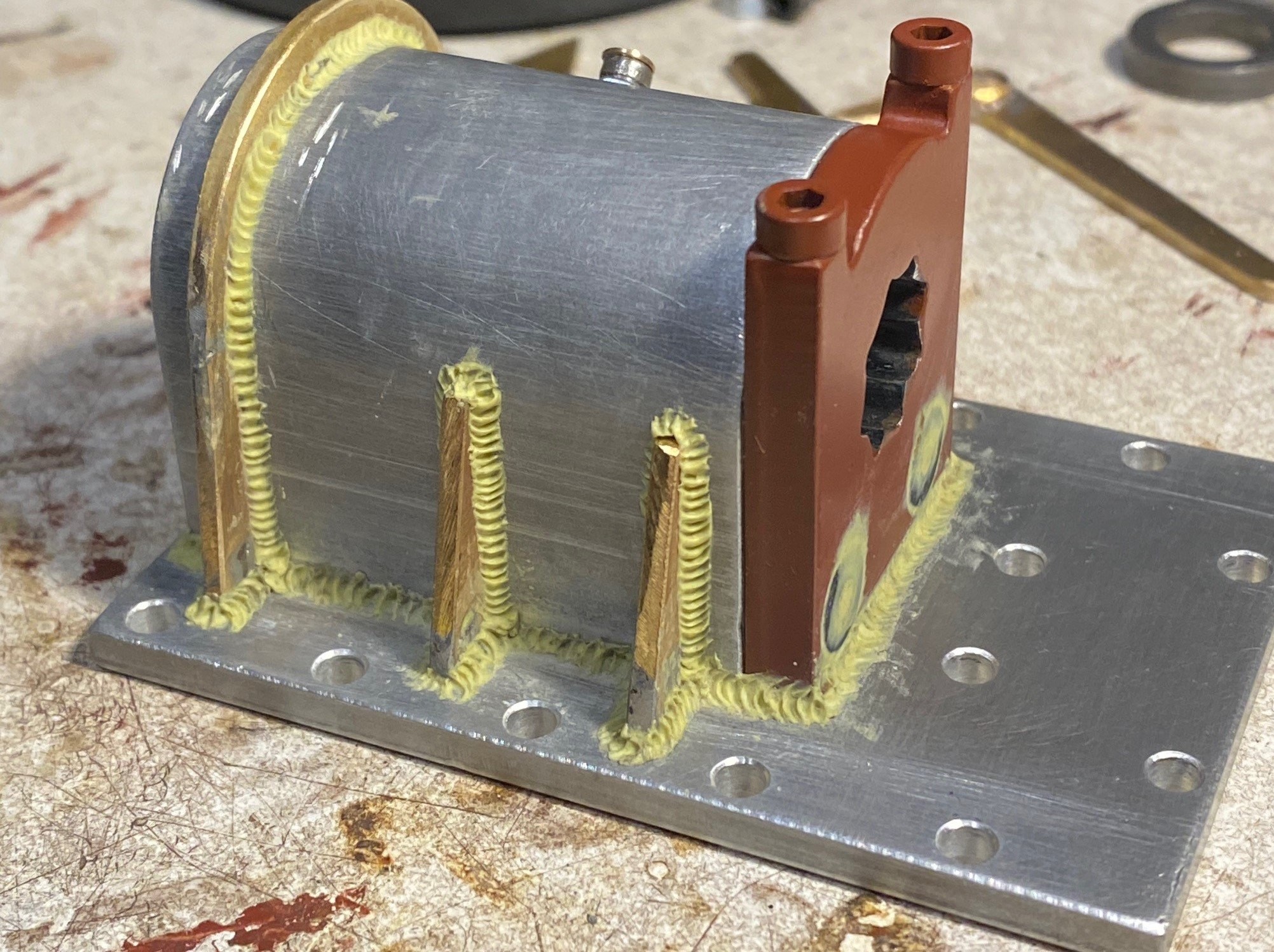

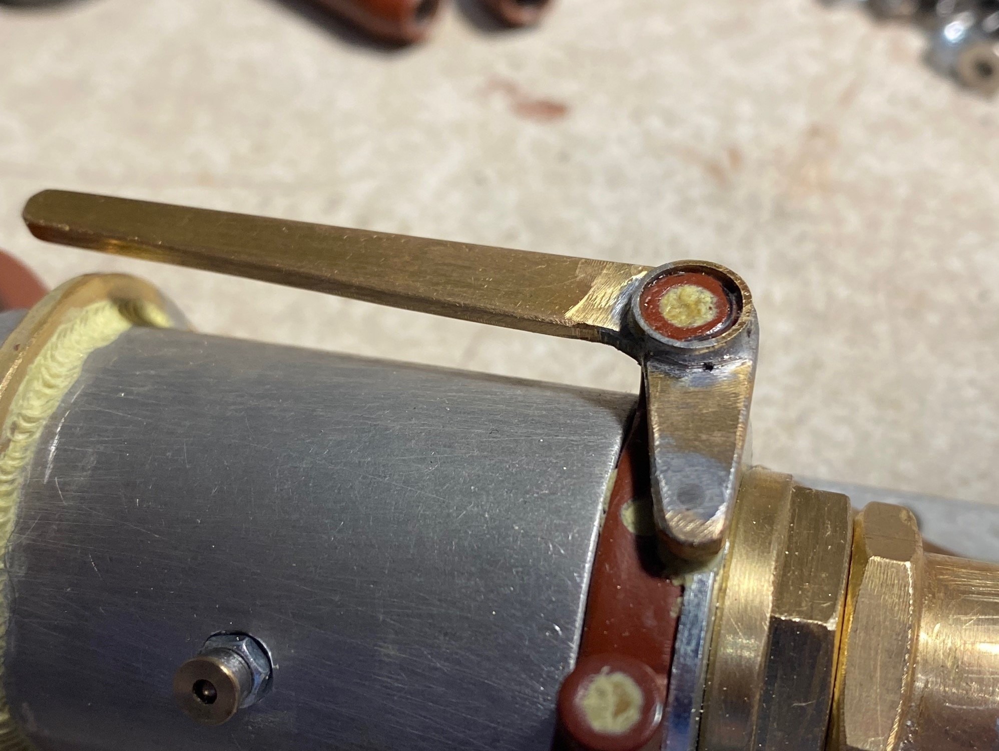

Now comes the mounting block with the ribs, welding seams, grease nipple and the lever on the top position.
But the ribs are not ready - the last welding seams have to come next.
Regards Martin

excellent work, indeed! My Panzer IV would be glad if it would look like yours.......

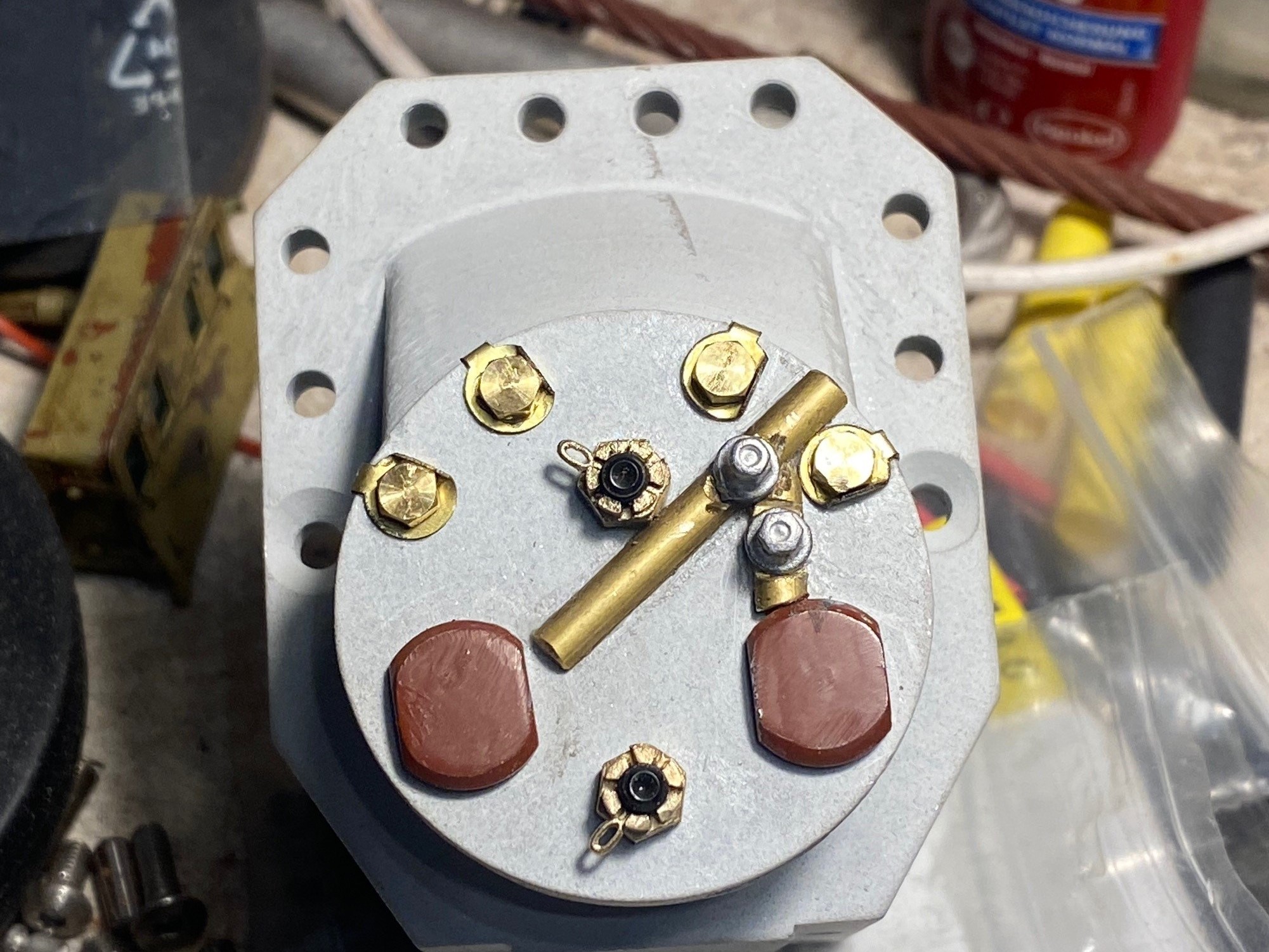

Hi Robert,
hi Gerhard,

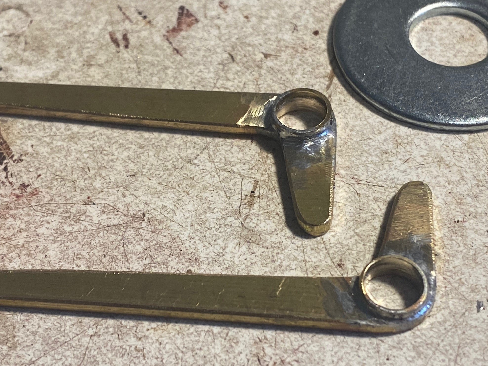

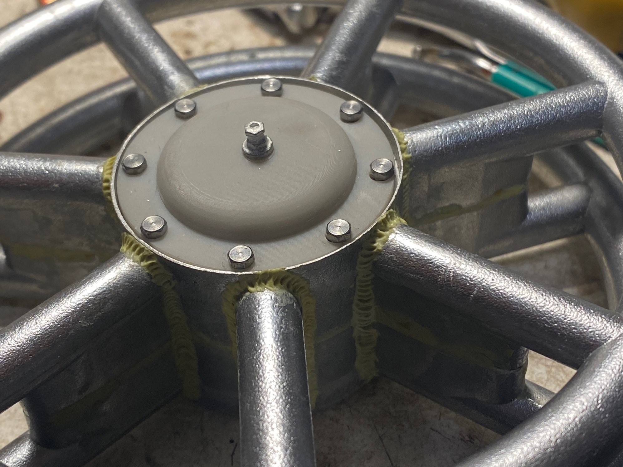

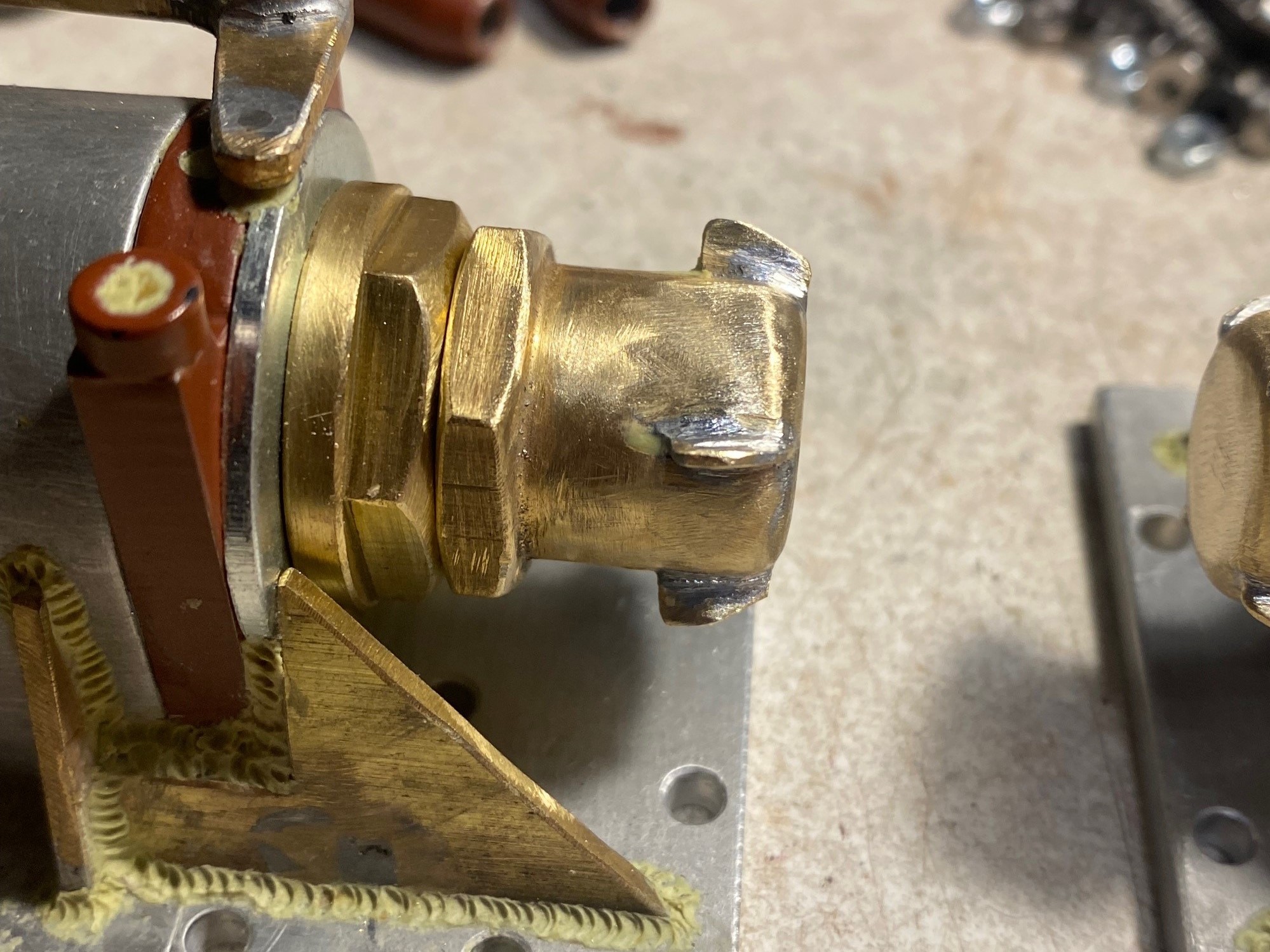

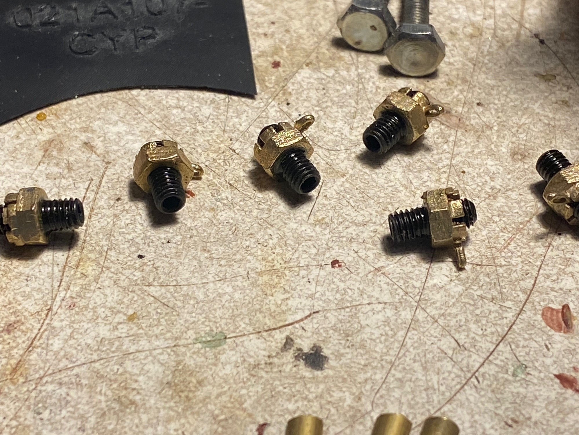

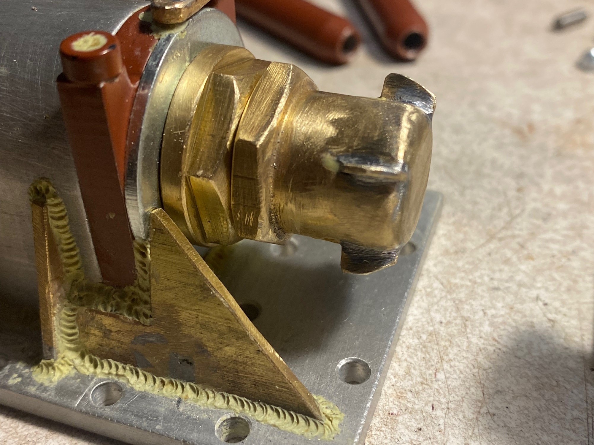

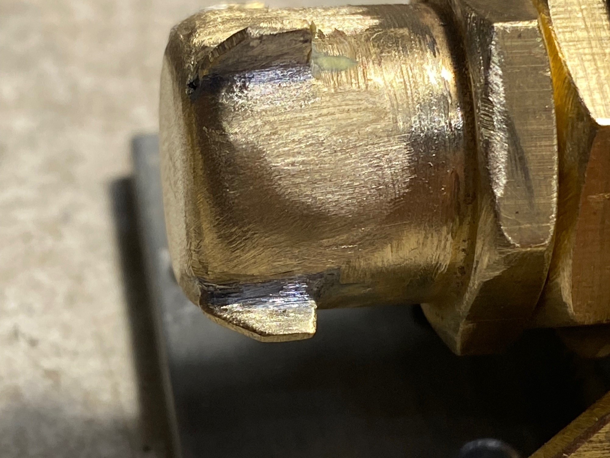

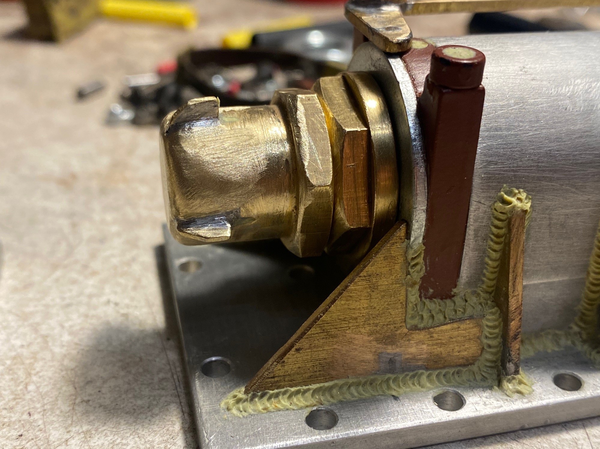

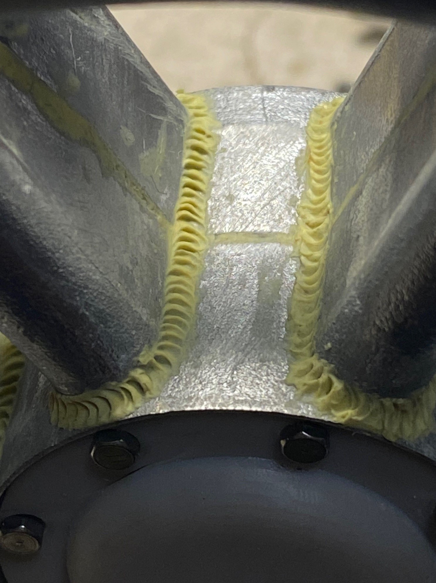

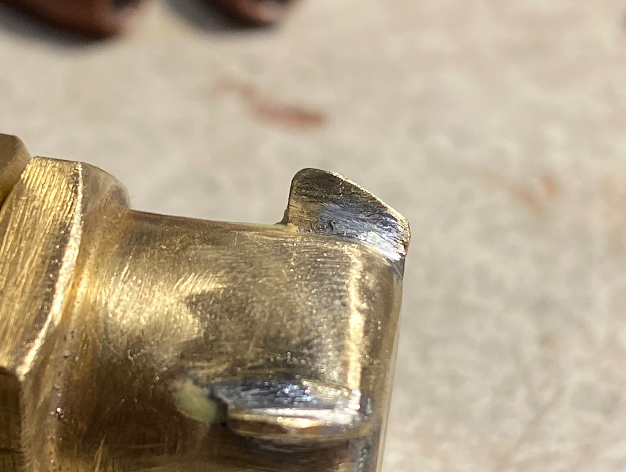

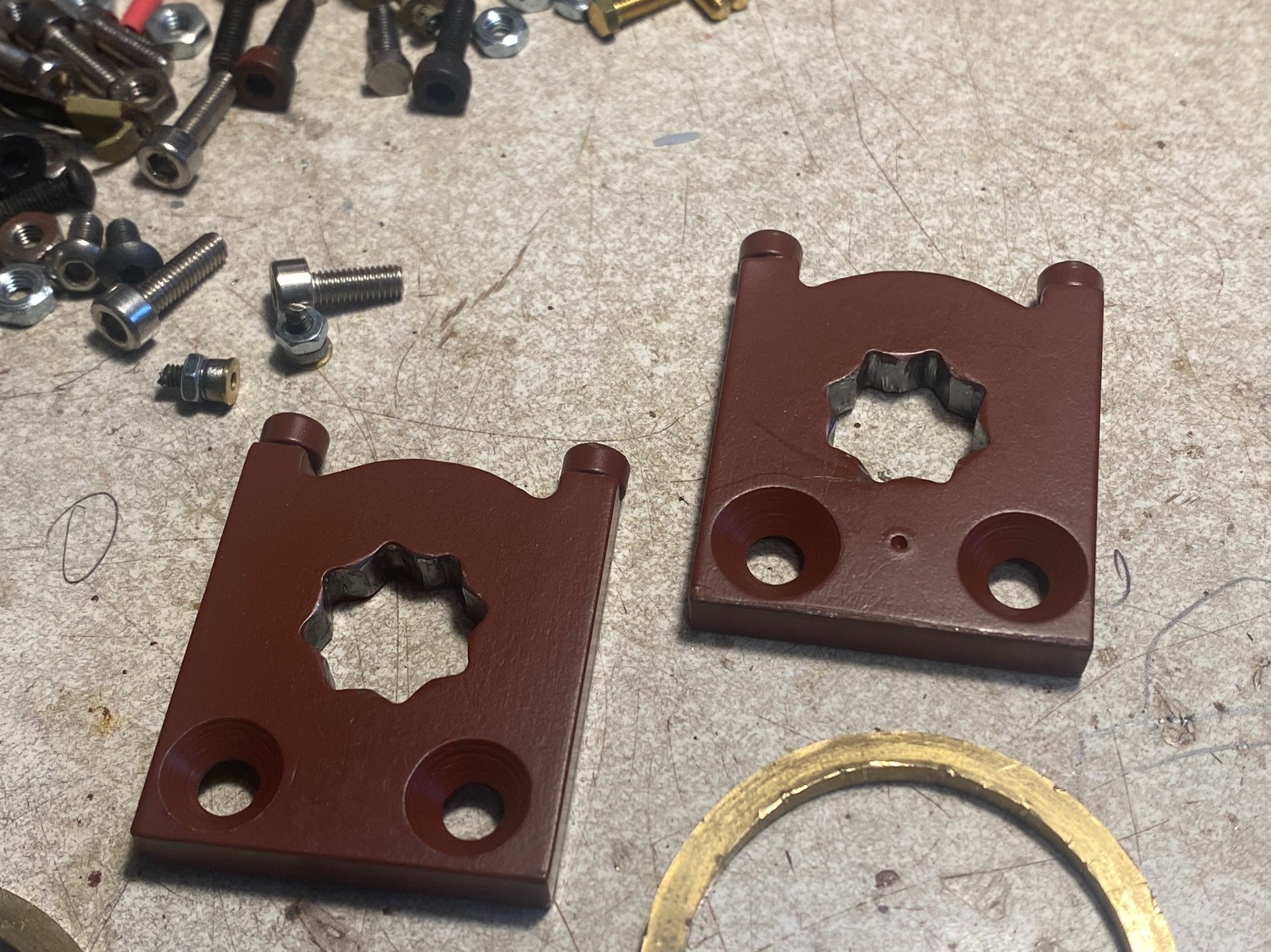

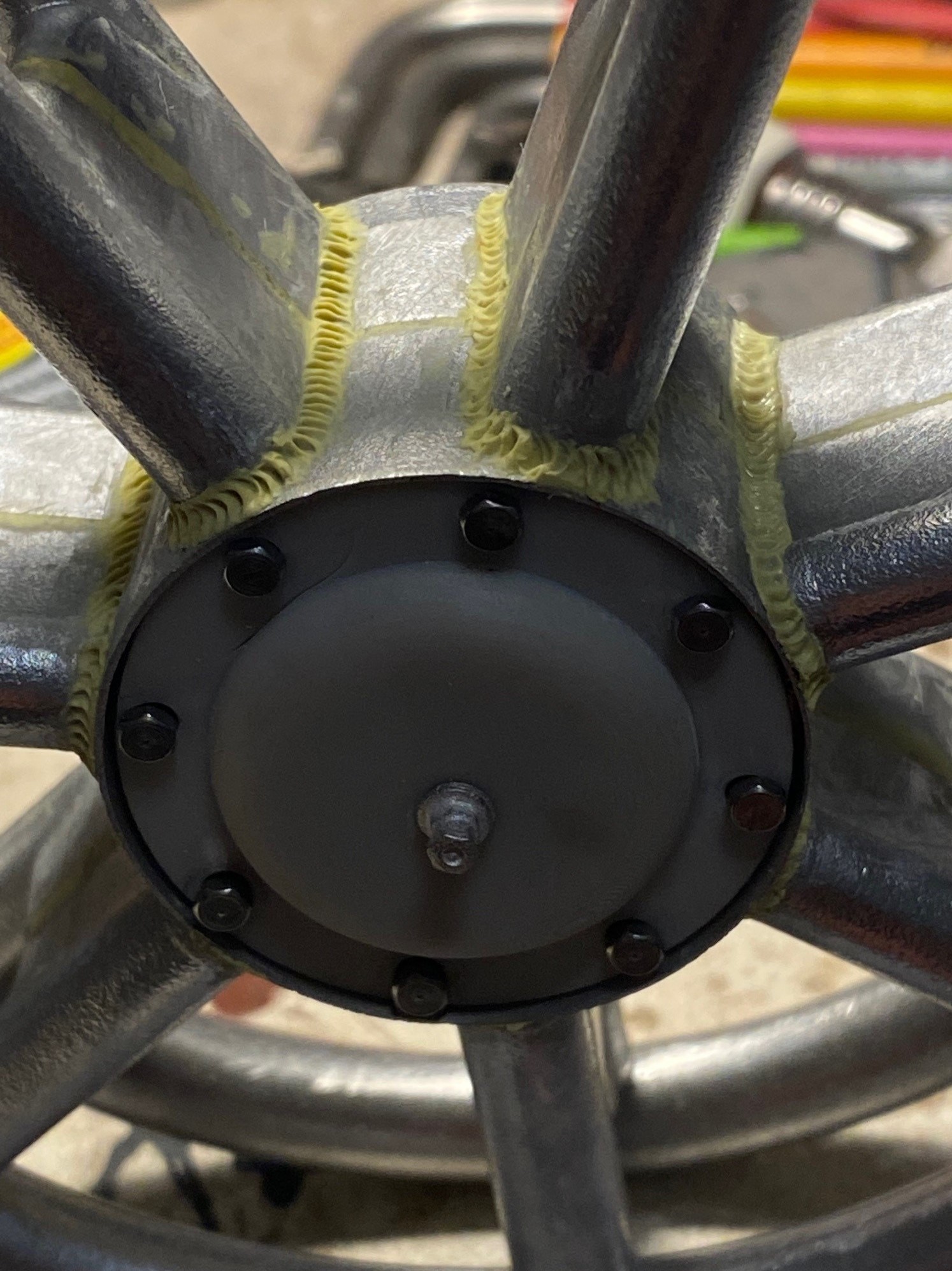

thank you guys for the nice comments. Here are the next update for the lever, turned to the correct position. The nuts got some "wings" on the outer diameter - soldered into slots, like the origin, and i start with the weldings of the idler wheels.
hi Gerhard,
Regards Martin
