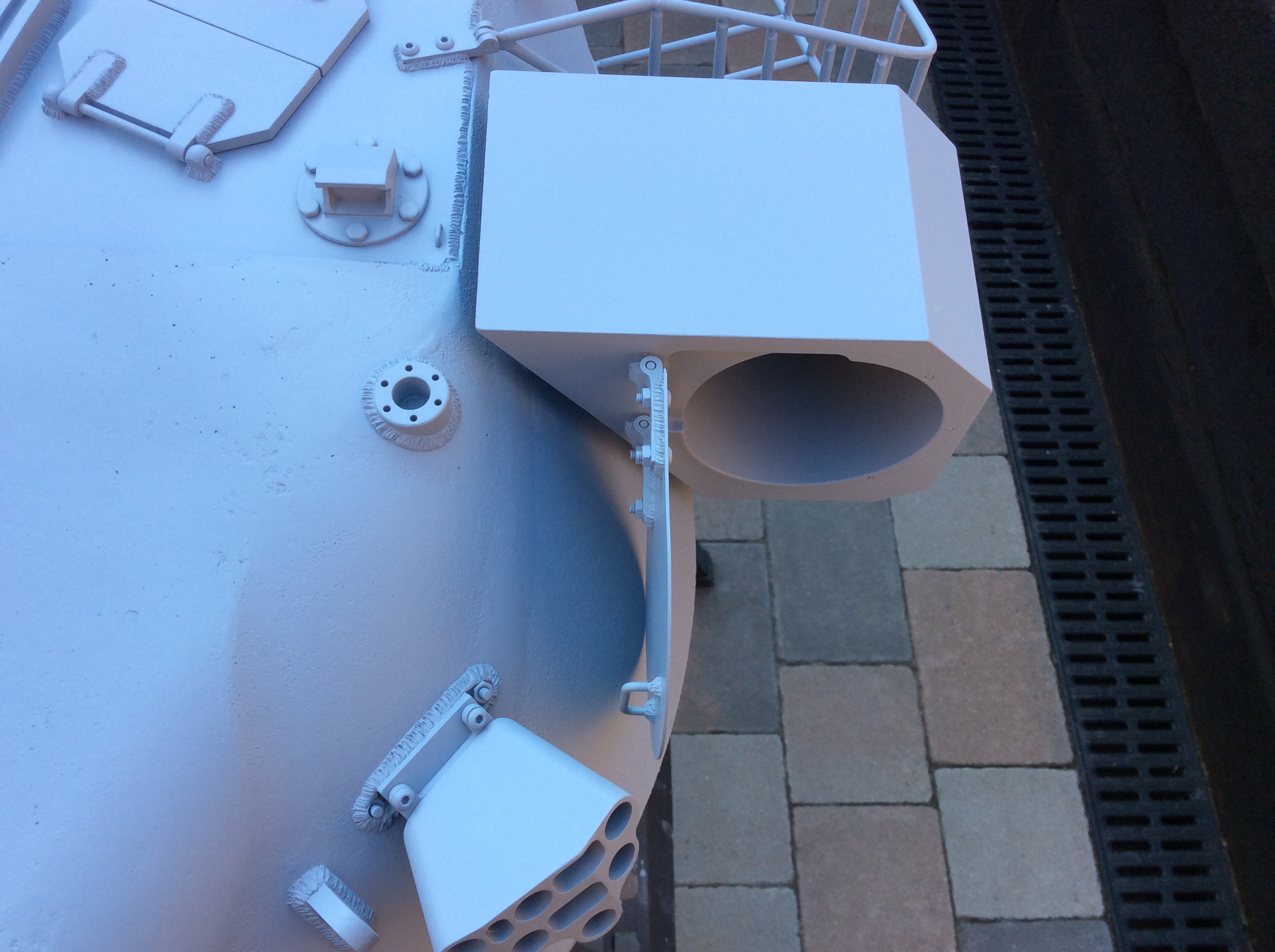

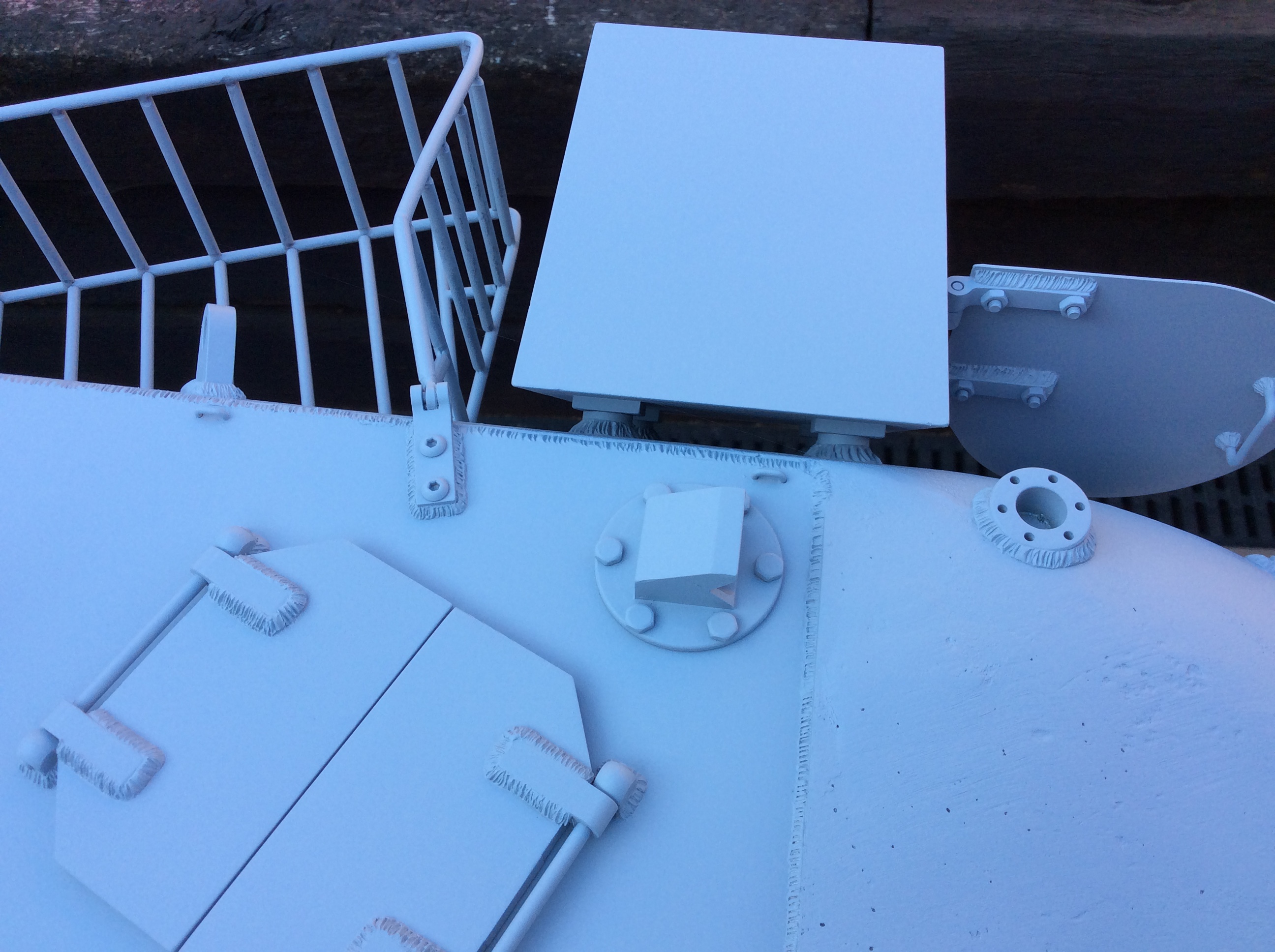

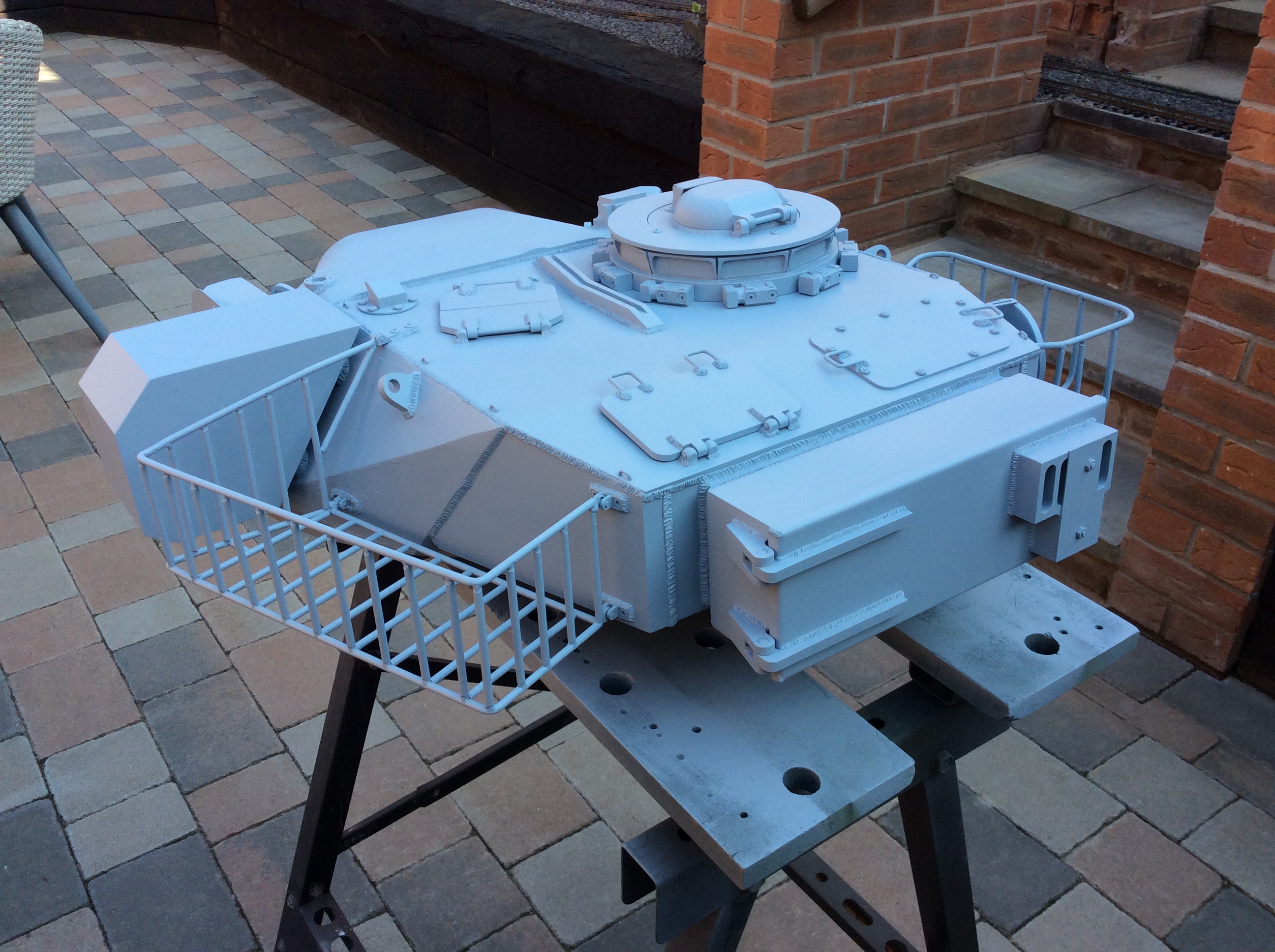

A little more acid etch priming of the last few parts today πŸ˜€πŸ˜€πŸ˜€

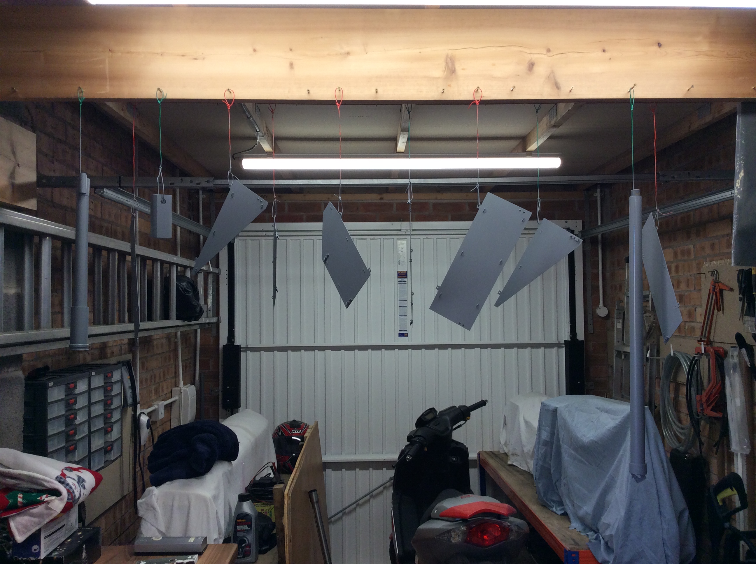

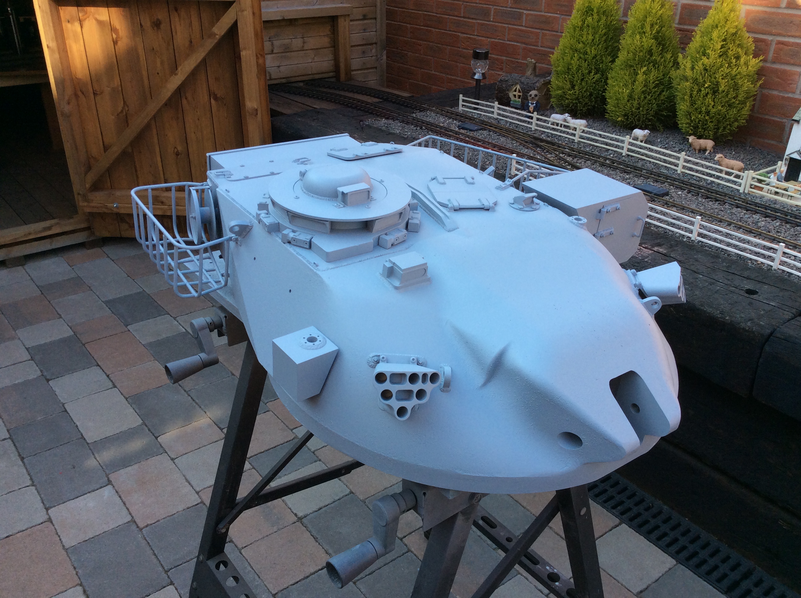

Remaining parts looking a lot better in NATO green πŸ˜€πŸ˜€πŸ˜€

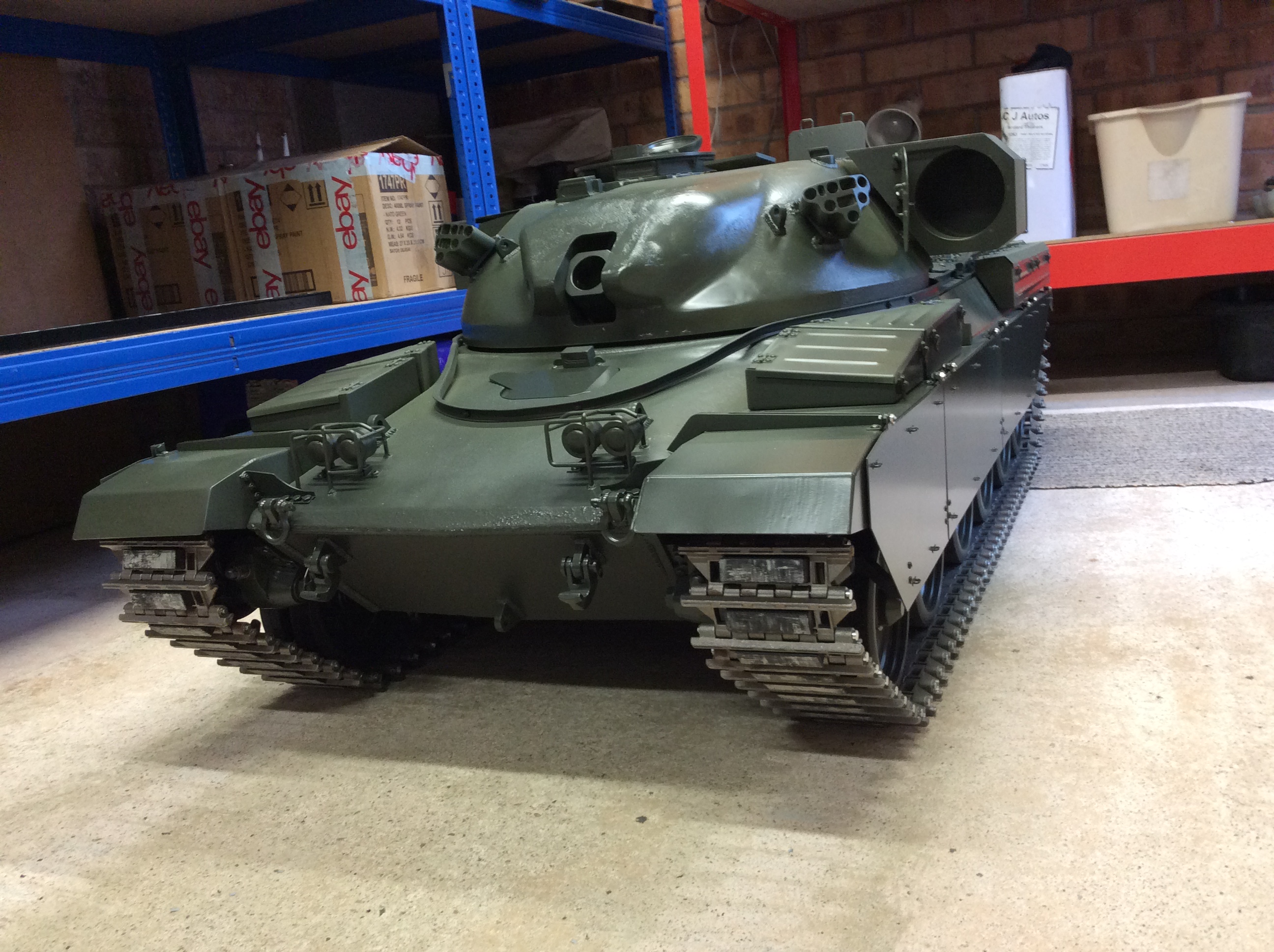

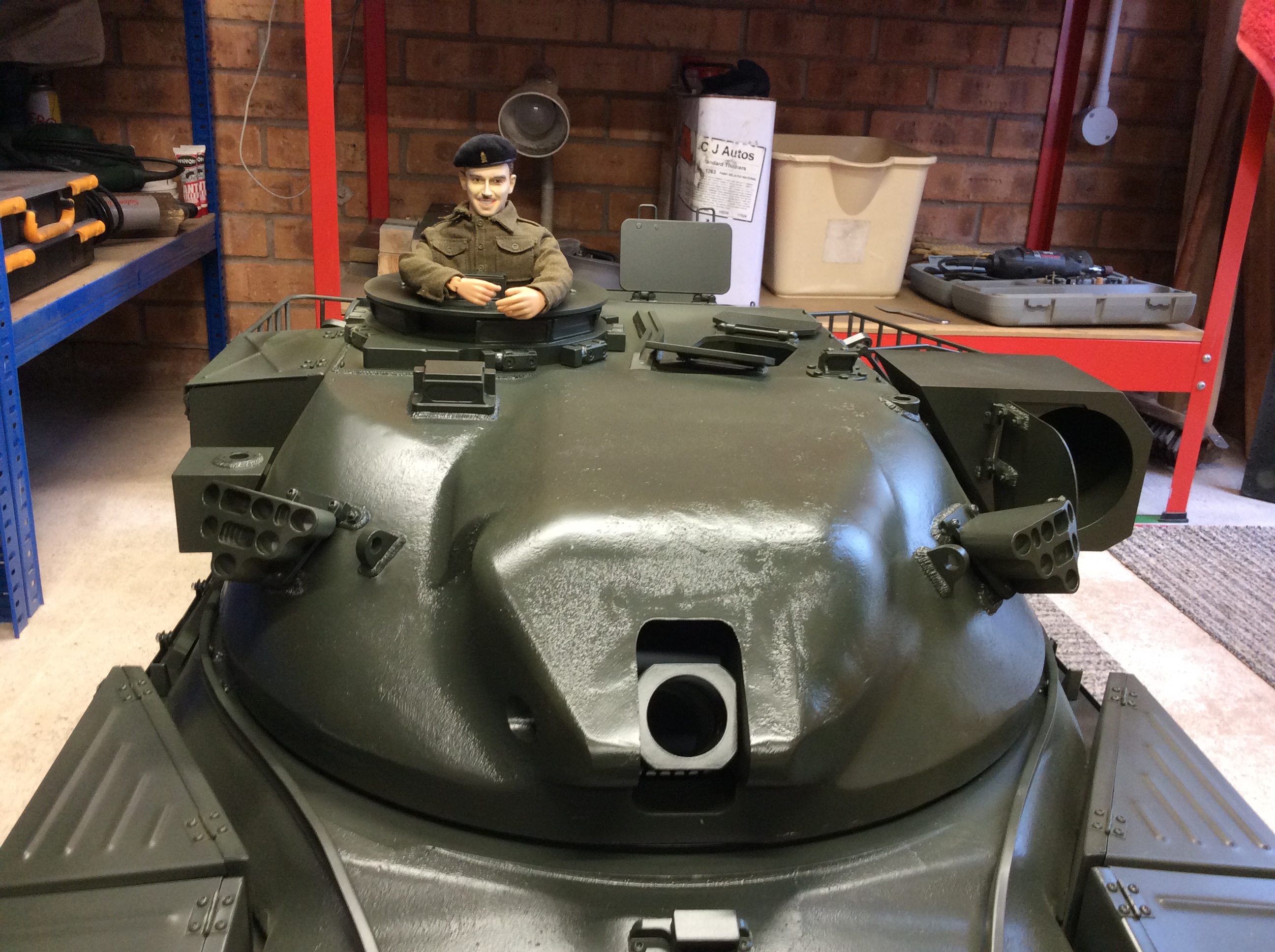

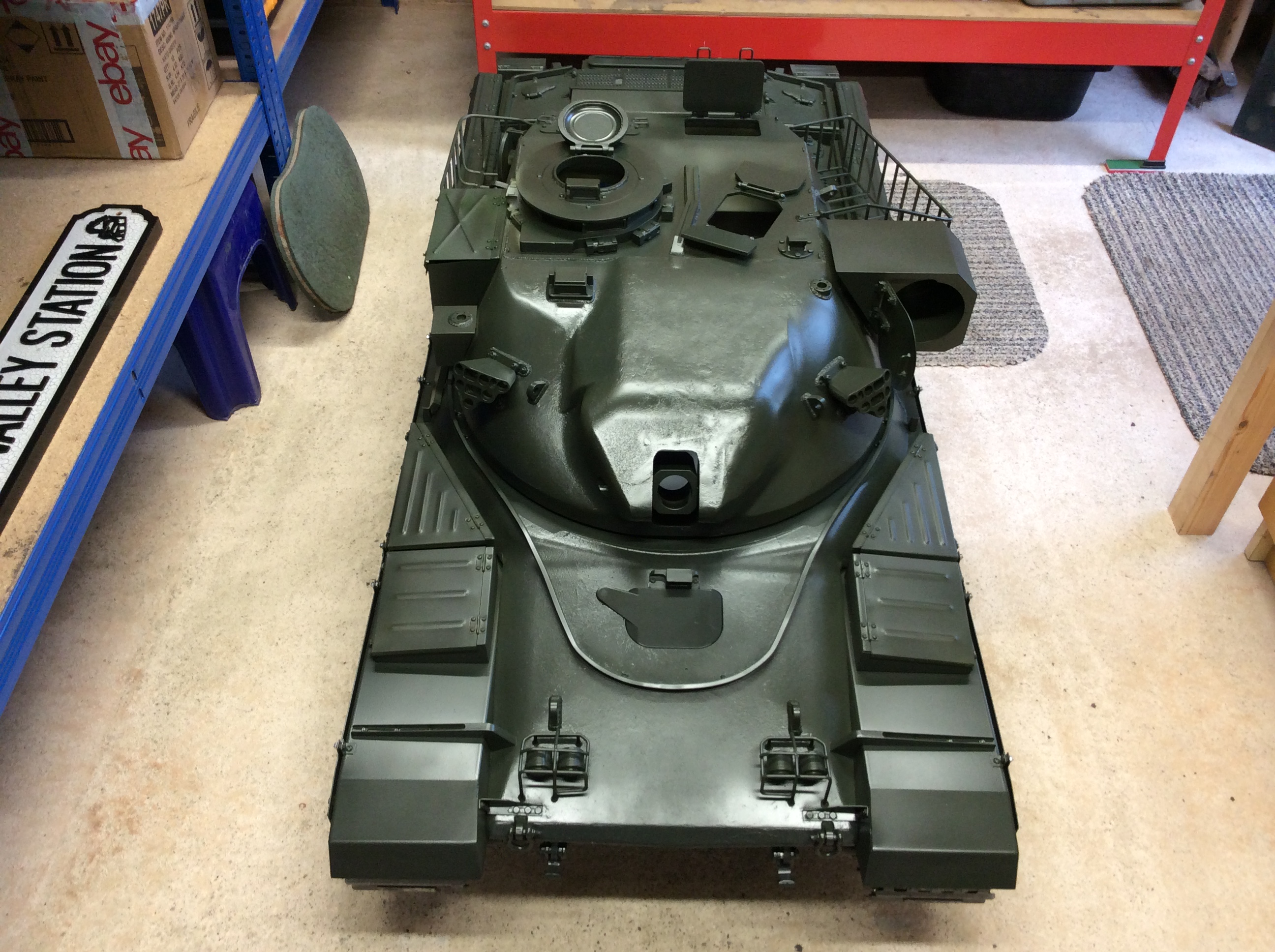

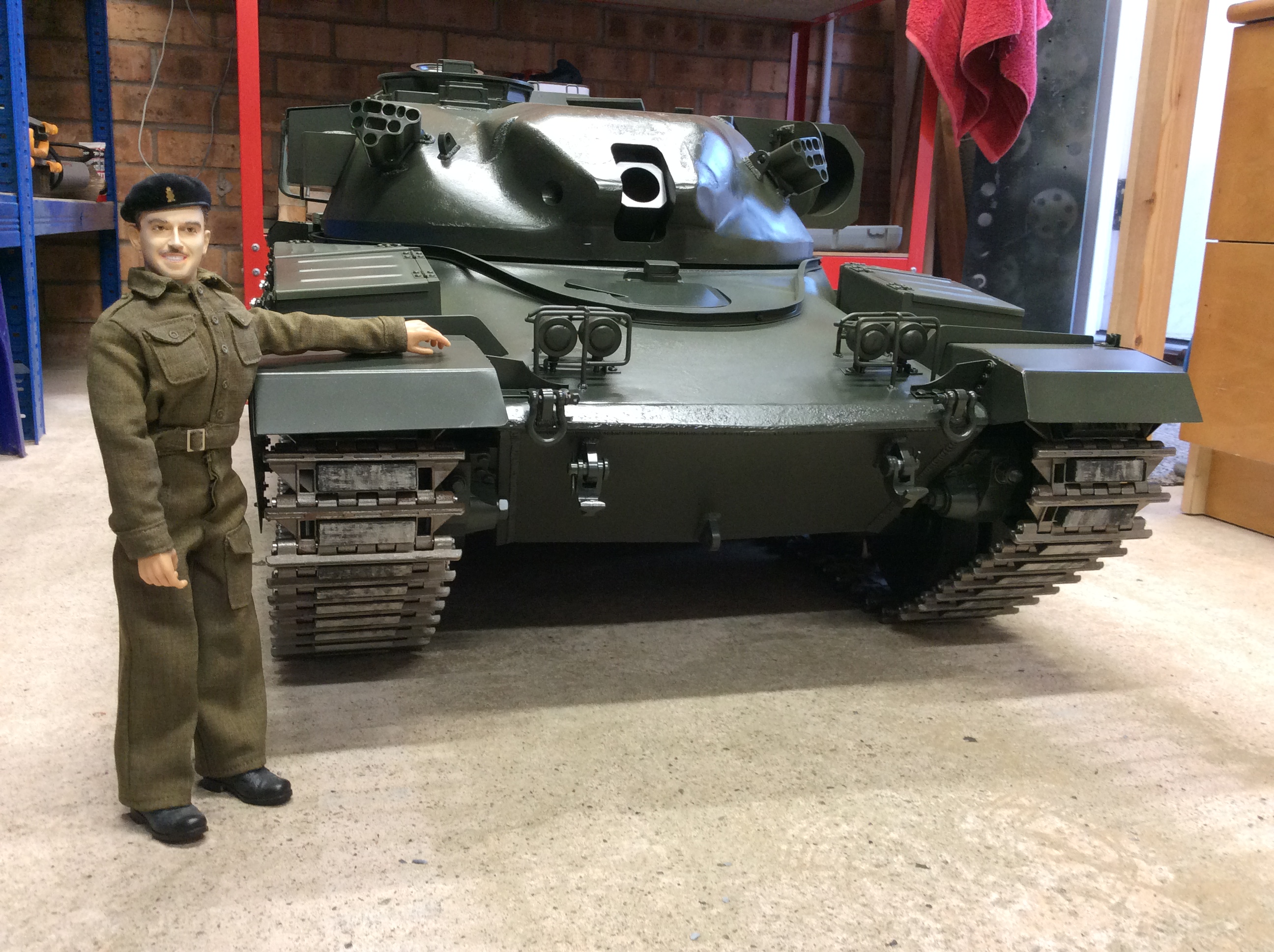

A little more progress. Bazooka skirts on plus turret test fit. A little more painting and finishing off still to do πŸ˜€
Manny Leung
Posts: 90
Been liked: 83 times
Re: Chieftain Build No.17
Post by Manny Leung »
Really excellent! Just to show in standard form the model is impressive enough. It inspired me to get off my arse to get mine built!

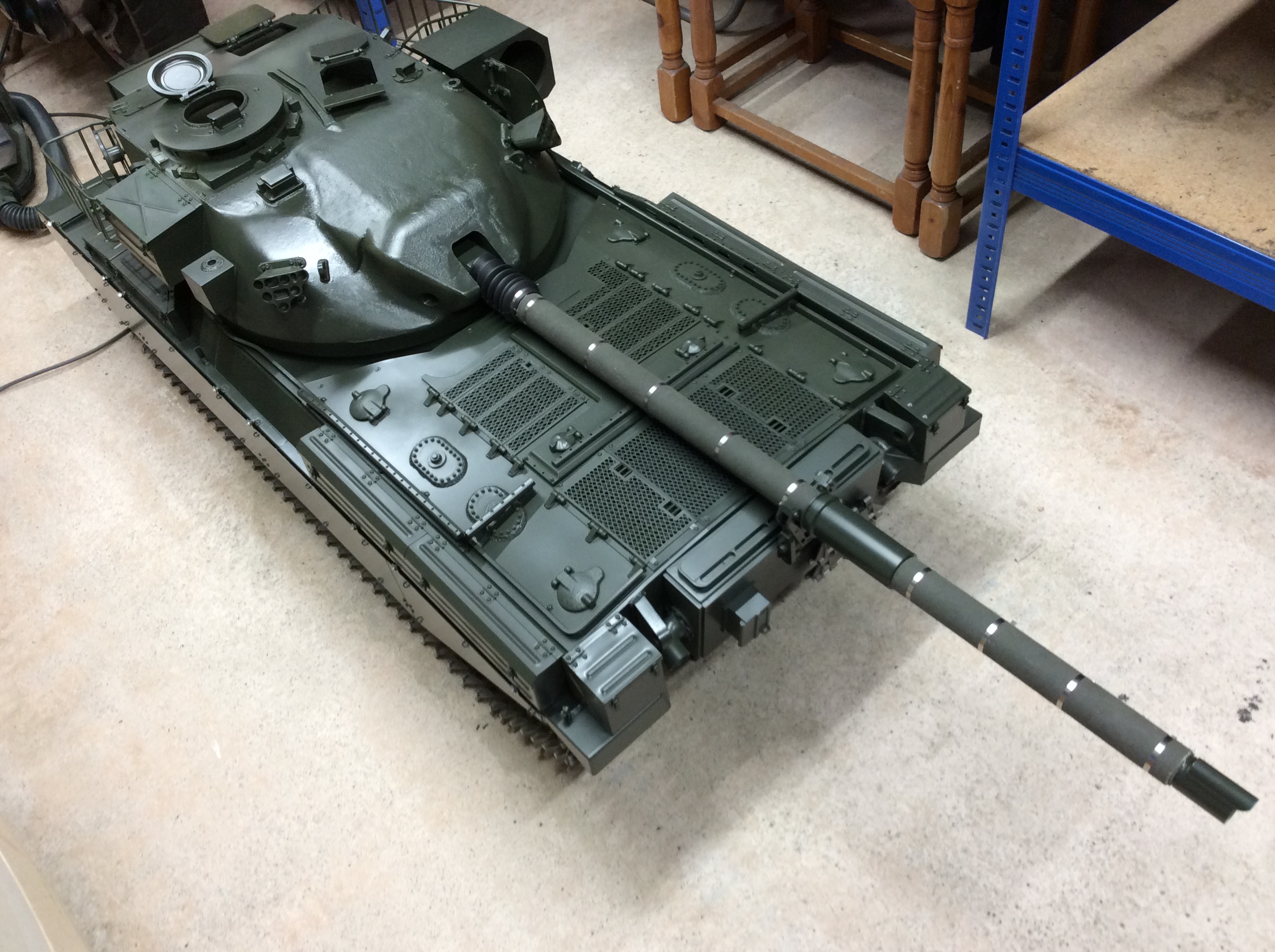

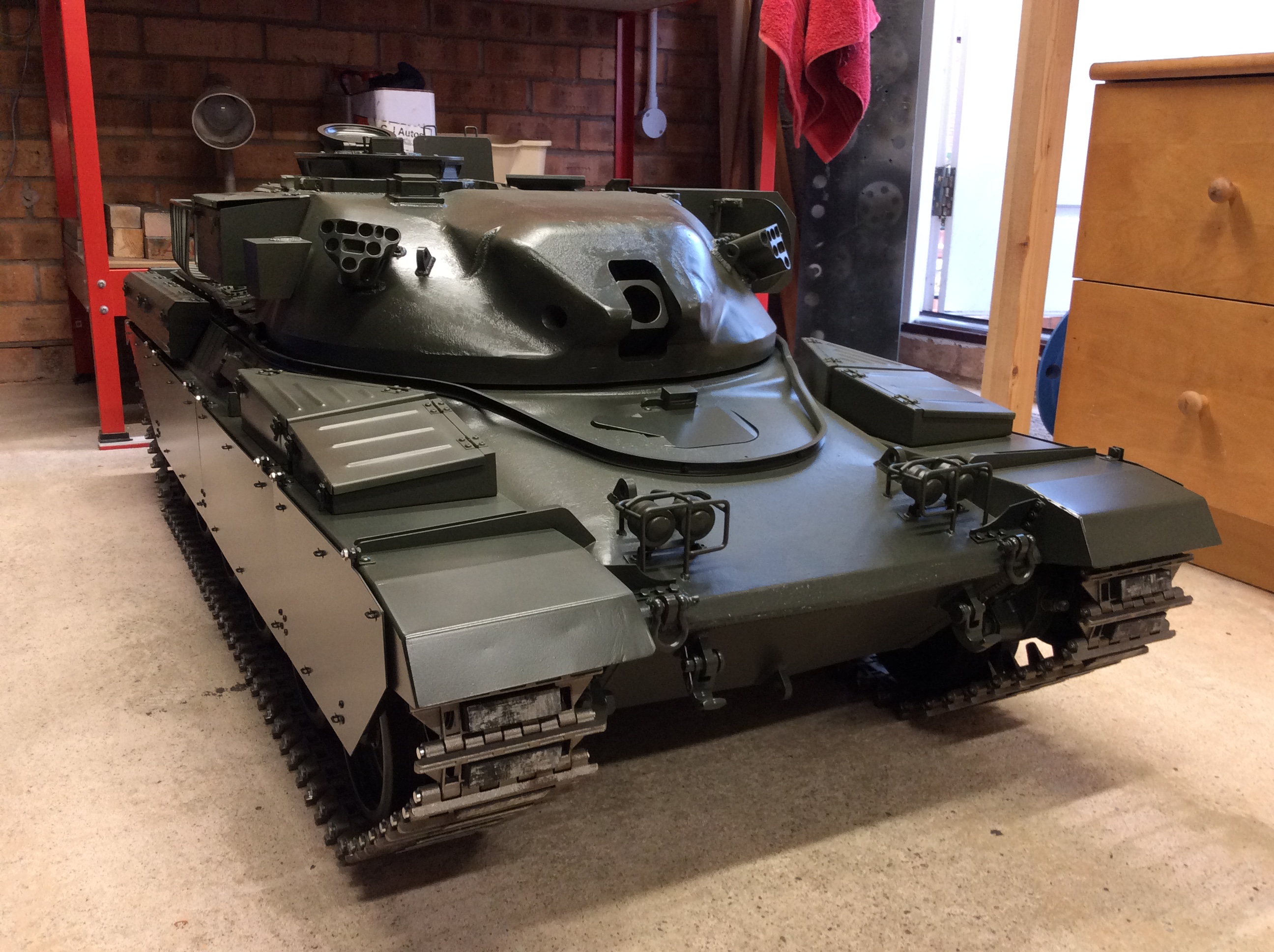

Now with the lagged gun barrel in place πŸ˜€
I am struggling to get the lagging clips tight, anybody else had this issue?
Thanks,

Looks great and a great job done. I think your muzzle reflectors on the wrong way round.
I do that sort of thing a lot but people are usually too polite to say something...... usually :lol:
I don't know how you got it together so quick. You must have a bigger hammer than me. :lol:
On stainless steel cable ties, I use a decent pair of pliers and a good yank on the strap, holding the fixed point firmly. I was thinking of using plastic cable ties first to provide a positioning place, when happy, cut them off one at a time and fit the stainless cable tie in the position left by the plastic tie.
Watch out on the cut ends of the stainless ties they could end up like razor blades. Blunt them off if you can.
Sounds good hope it works when I get round to it. :roll:

Thanks John just spent 2 hours removing the muzzle reflector 😩😩😩
All cleaned up and primed, repaint and put back together tomorrow πŸ˜€πŸ˜€πŸ˜€
