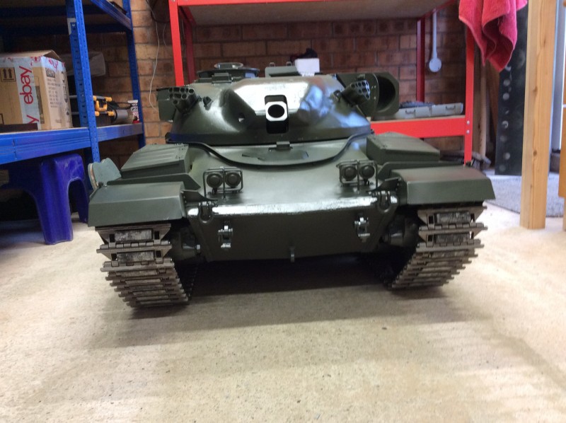

Looking good Mark, nice fit on the turret roof. 8)

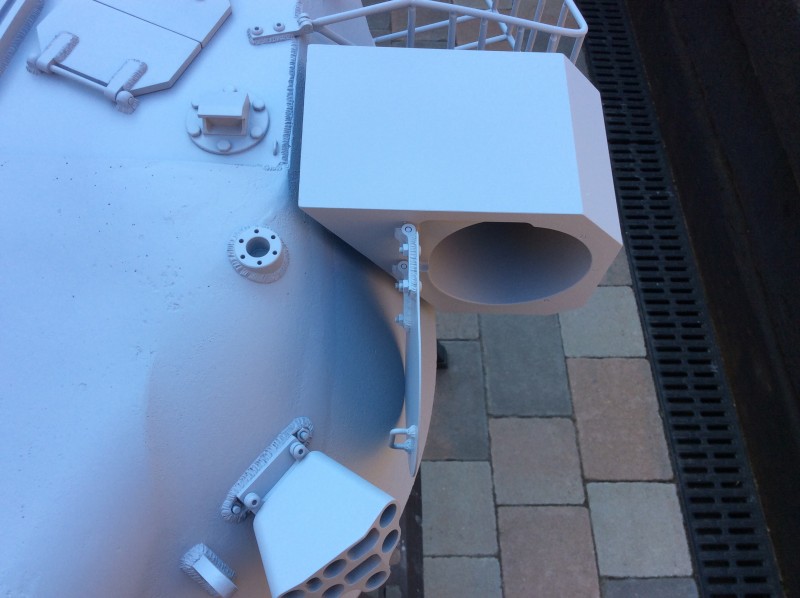

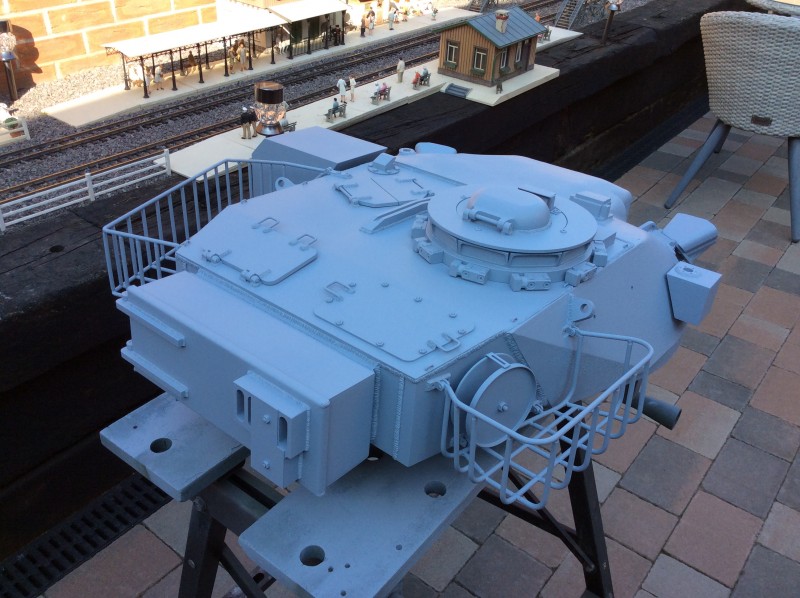

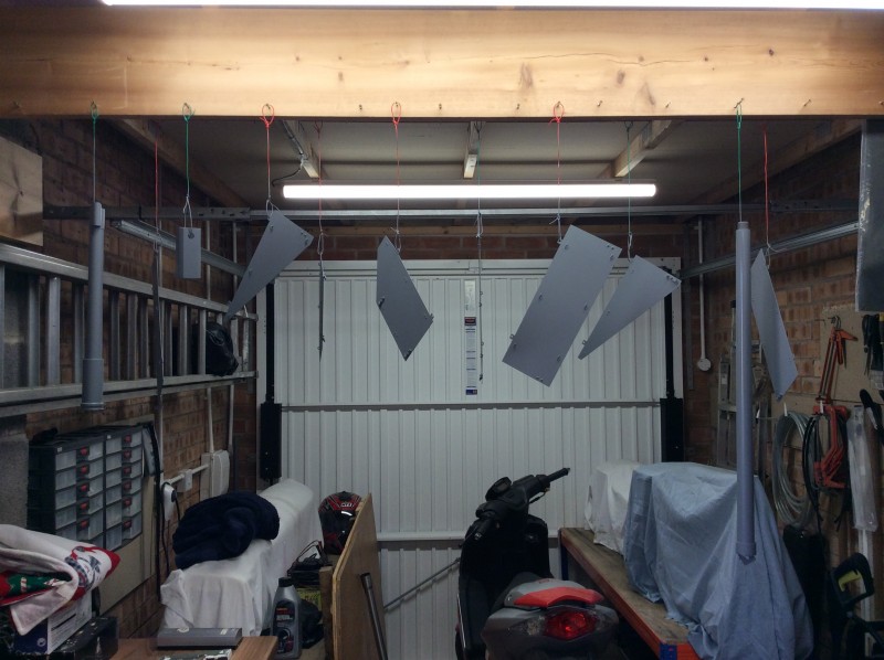

A little more acid etch priming of the last few parts today πŸ˜€πŸ˜€πŸ˜€

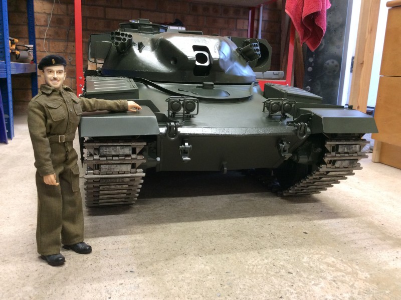

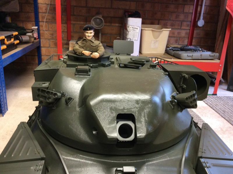

Remaining parts looking a lot better in NATO green πŸ˜€πŸ˜€πŸ˜€

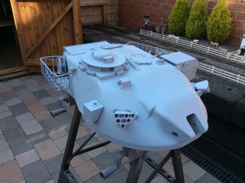

Hi Mark
Can I ask what paint did you use for the NATO green.
Mark Russell
Posts: 204
Joined: Fri Jul 17, 2009 1:22 pm
Location: Worcestershire
Has liked: 4 times
Been liked: 245 times
Re: Chieftain Build No.17
Post by Mark Russell »
Hi Steve off eBay
https://www.ebay.co.uk/itm/333055991423
Very good high coverage quick drying paint.

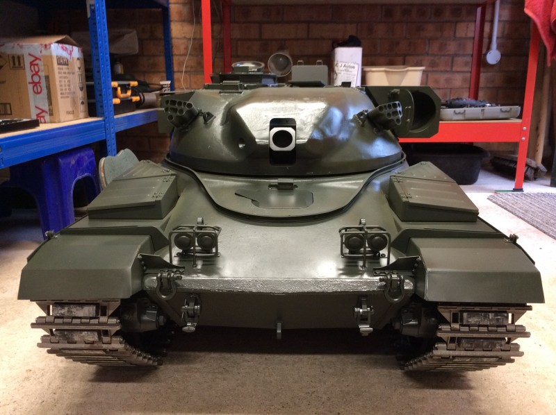

A little more progress. Bazooka skirts on plus turret test fit. A little more painting and finishing off still to do πŸ˜€

Really excellent! Just to show in standard form the model is impressive enough. It inspired me to get off my arse to get mine built!

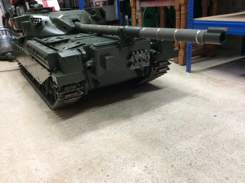

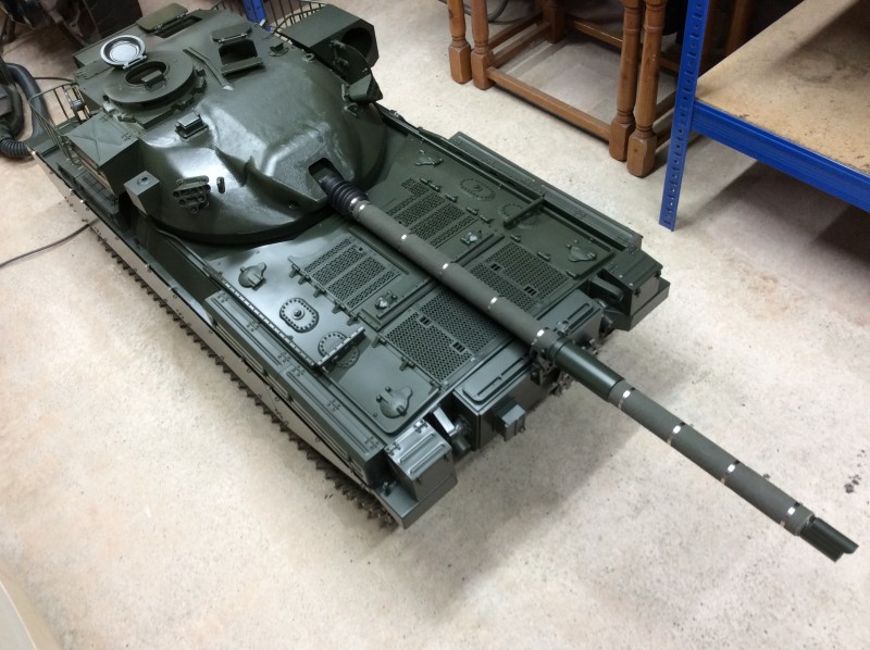

Now with the lagged gun barrel in place πŸ˜€
I am struggling to get the lagging clips tight, anybody else had this issue?
Thanks,

Looks great and a great job done. I think your muzzle reflectors on the wrong way round.
I do that sort of thing a lot but people are usually too polite to say something...... usually :lol:
I don't know how you got it together so quick. You must have a bigger hammer than me. :lol:
On stainless steel cable ties, I use a decent pair of pliers and a good yank on the strap, holding the fixed point firmly. I was thinking of using plastic cable ties first to provide a positioning place, when happy, cut them off one at a time and fit the stainless cable tie in the position left by the plastic tie.
Watch out on the cut ends of the stainless ties they could end up like razor blades. Blunt them off if you can.
Sounds good hope it works when I get round to it. :roll:

Thanks John just spent 2 hours removing the muzzle reflector 😩😩😩
All cleaned up and primed, repaint and put back together tomorrow πŸ˜€πŸ˜€πŸ˜€

Question about the nylon bearing for the main gun recoil - does this bearing slide with the gun barrel or does the gun barrel slide inside it? As it’s a tight fit onto the barrel and appears to slide in the housing, I’ve assumed this way round. But it seems to make more sense for the barrel to slide inside it? Anybody else at this stage yet?
