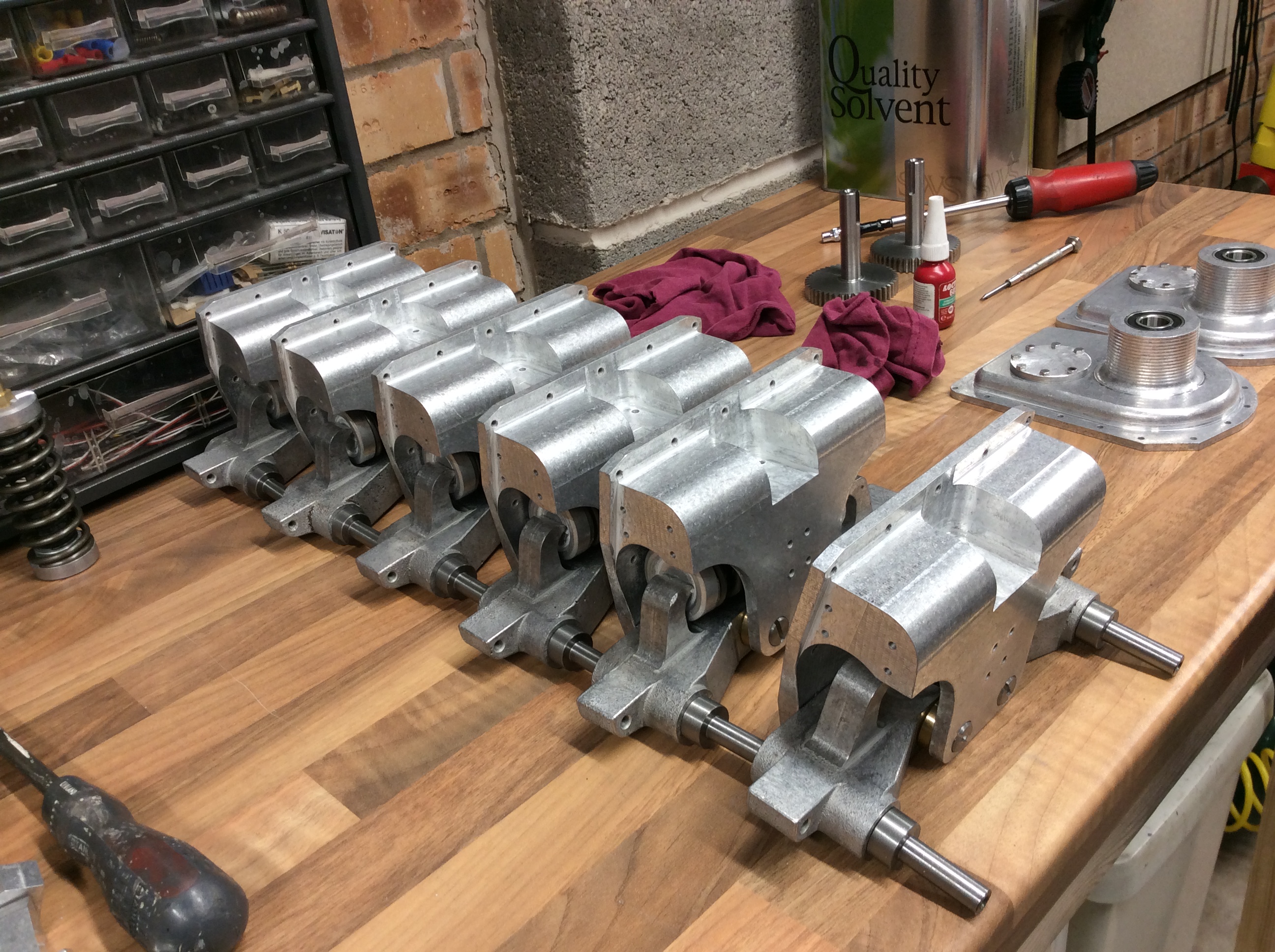

Whilst building the suspension units is it correct to fully screw home the part end threaded rods or should the brass end be left not fully screwed in? Thoughts appreciated.

In my case, there is no specific reference to the Neutral Point in the manual, and I used a double spring to respond to the compression stress, so I made all the female screws into the male screw. Whether this is correct or not is not correct.

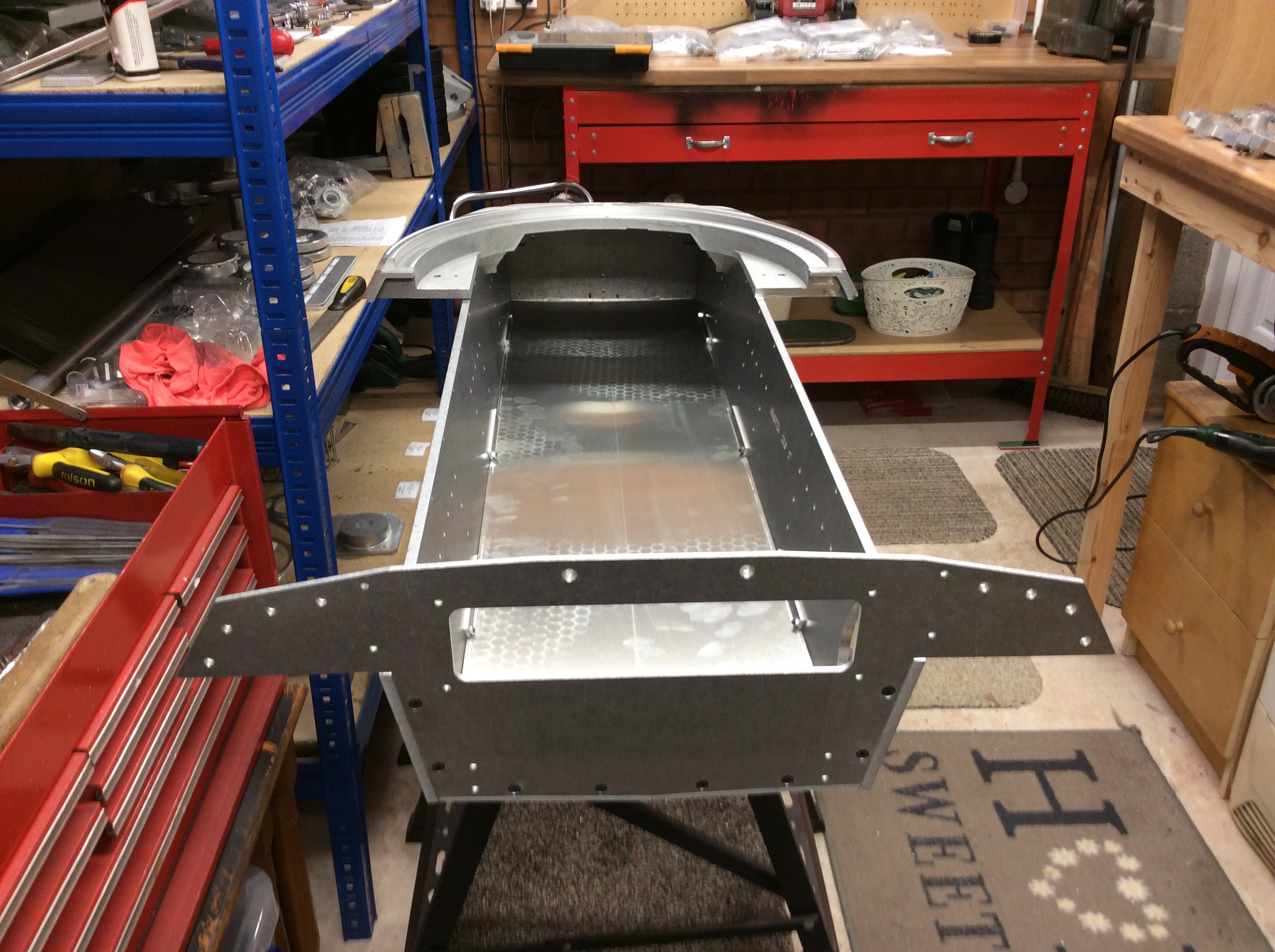

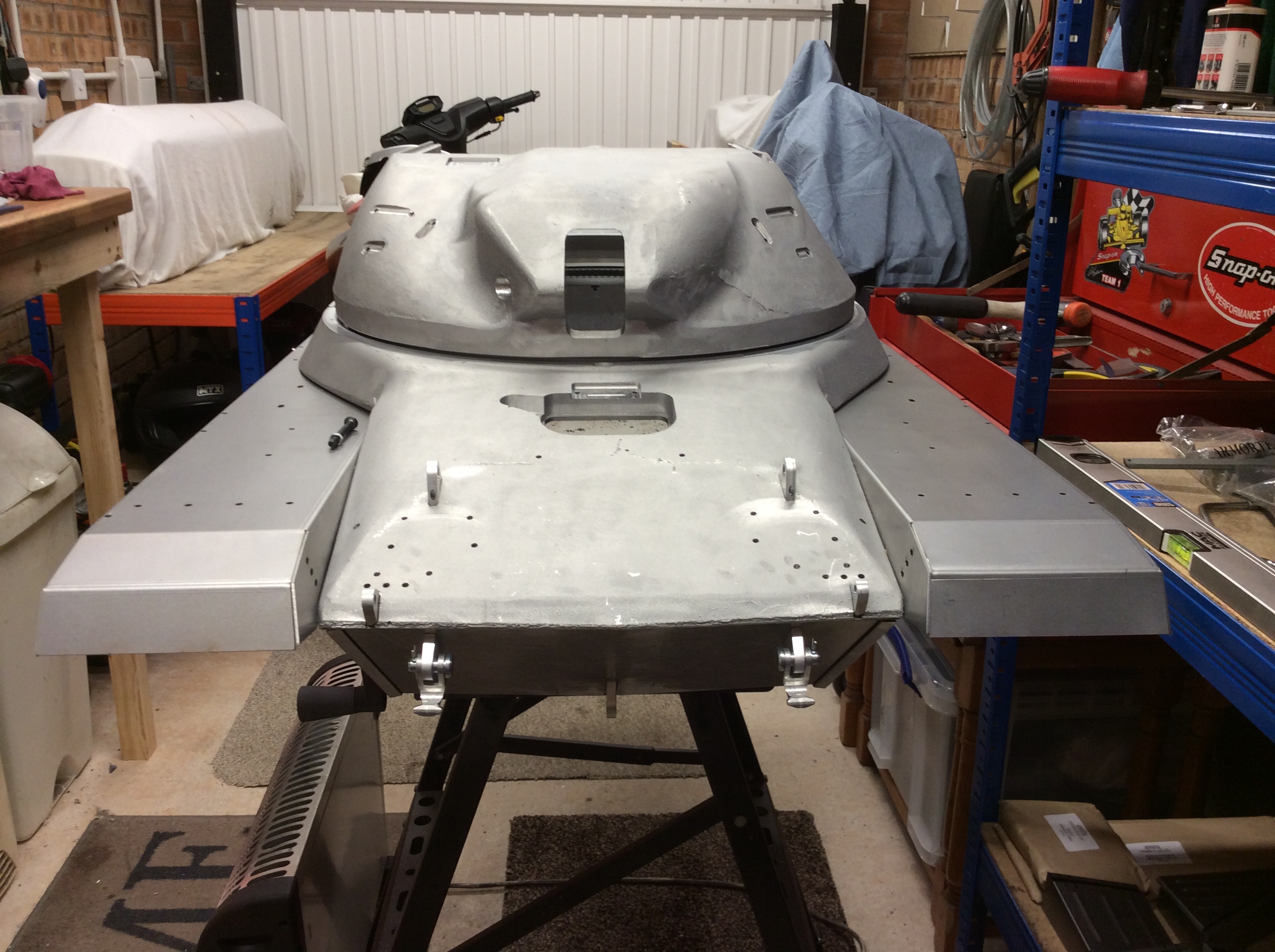

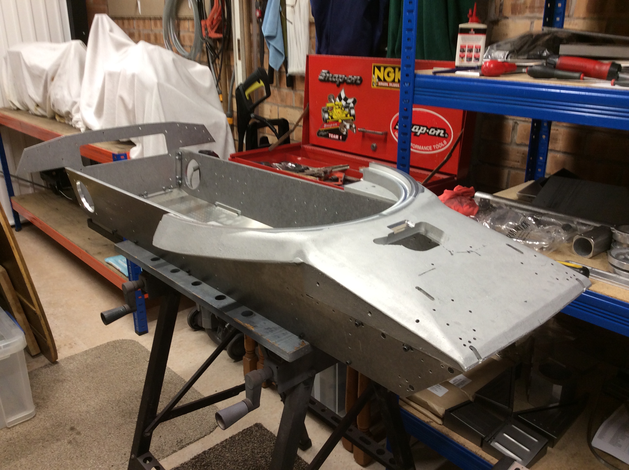

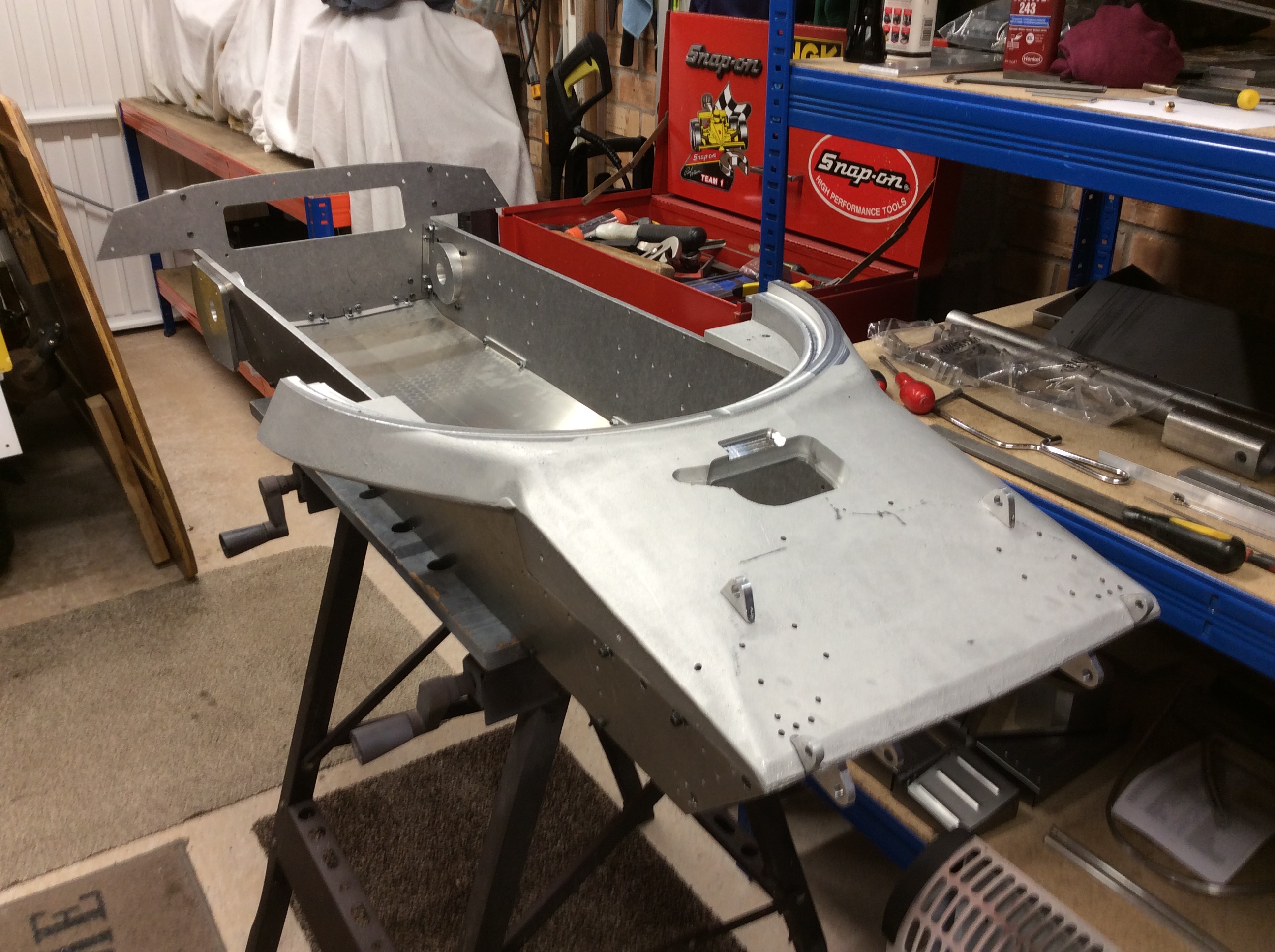

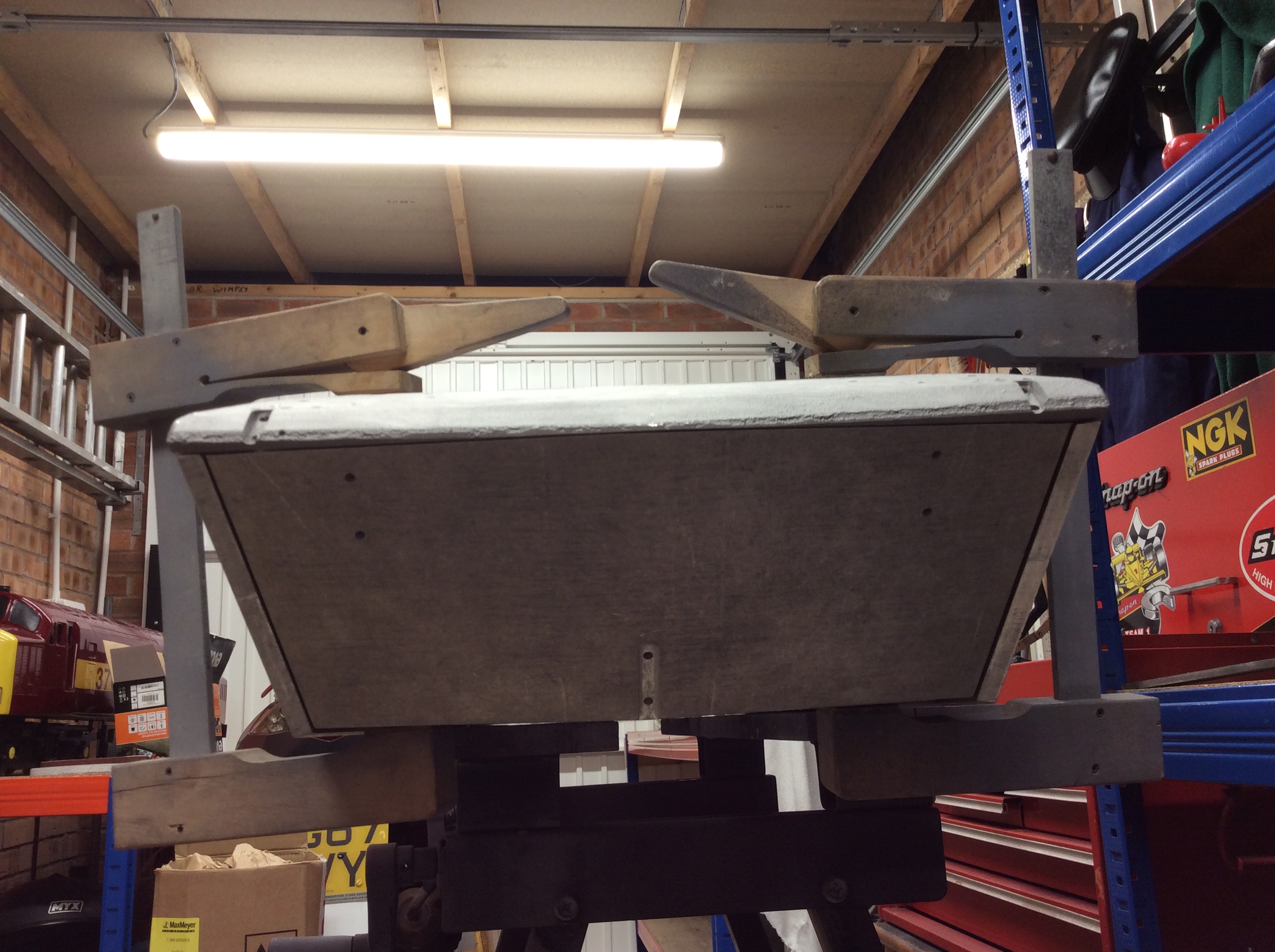

Some more pictures of my build. I seem to have Chieftain bits everywhere! Coming on slowly but surely but I’ve got the rest of the winter to go!

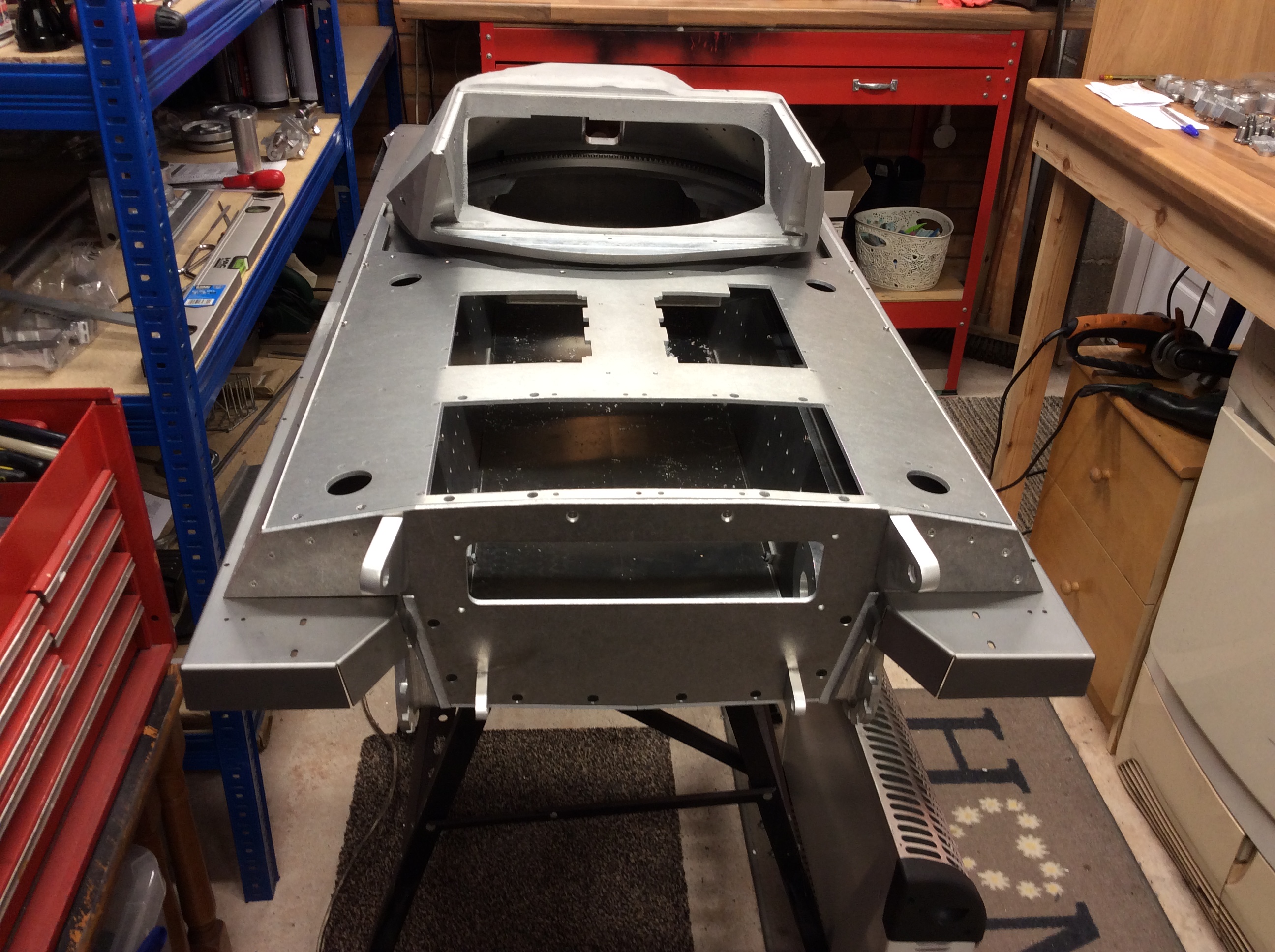

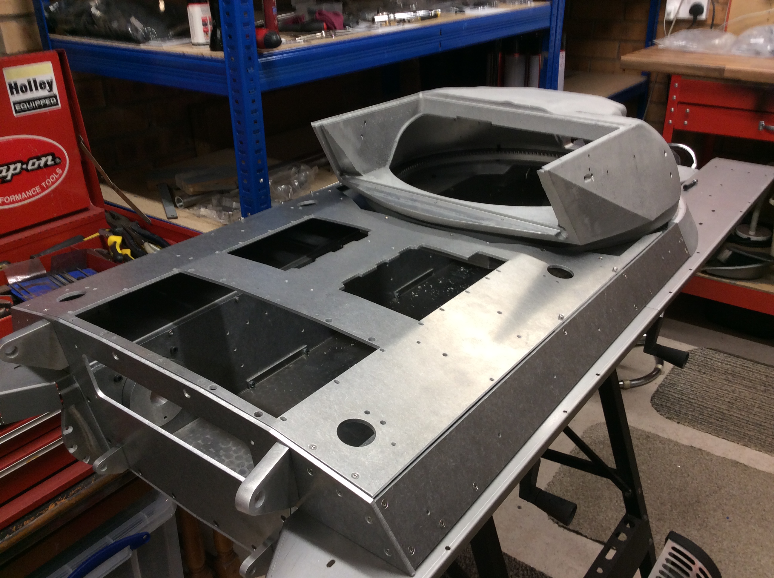

A few more images

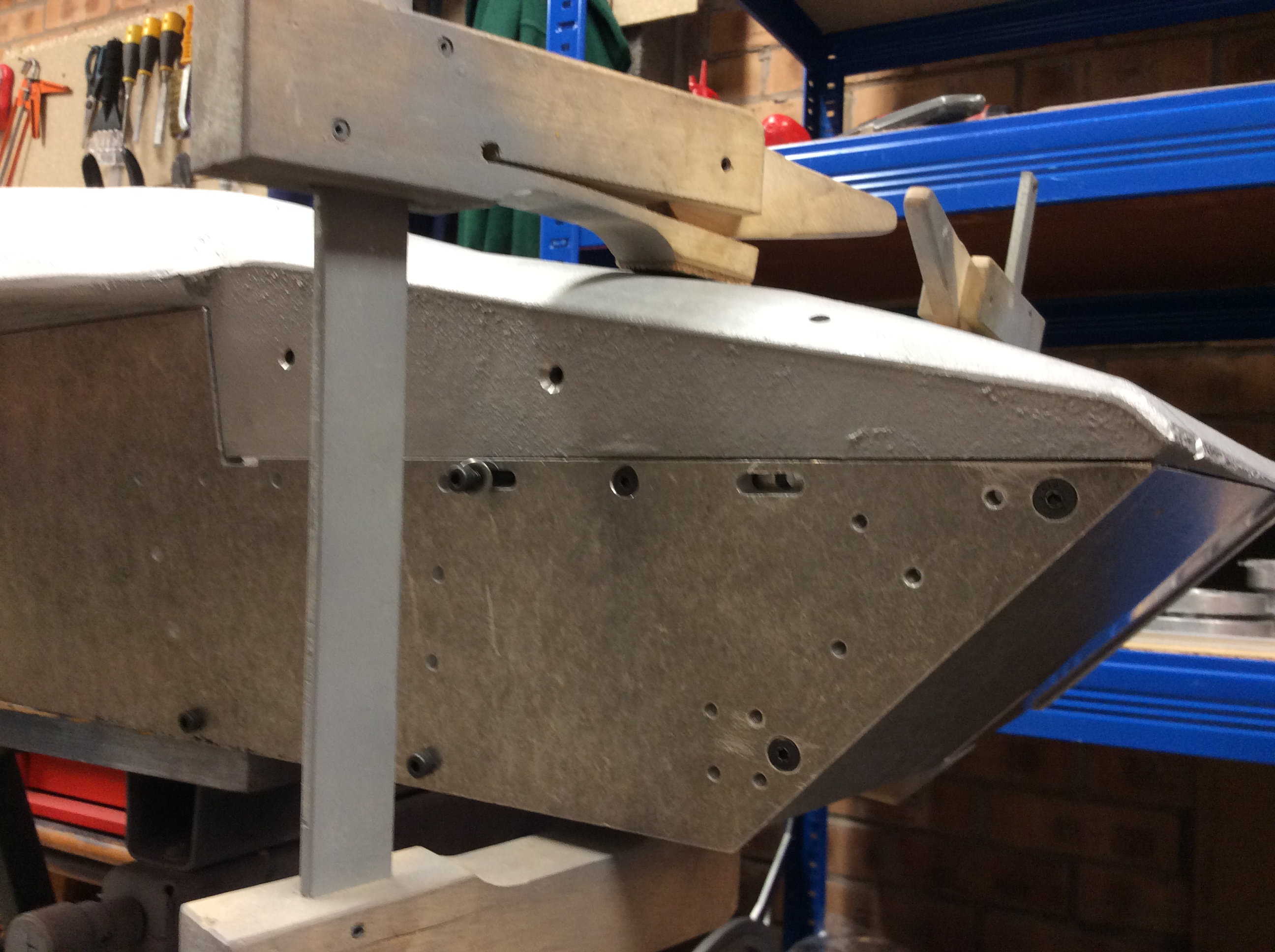

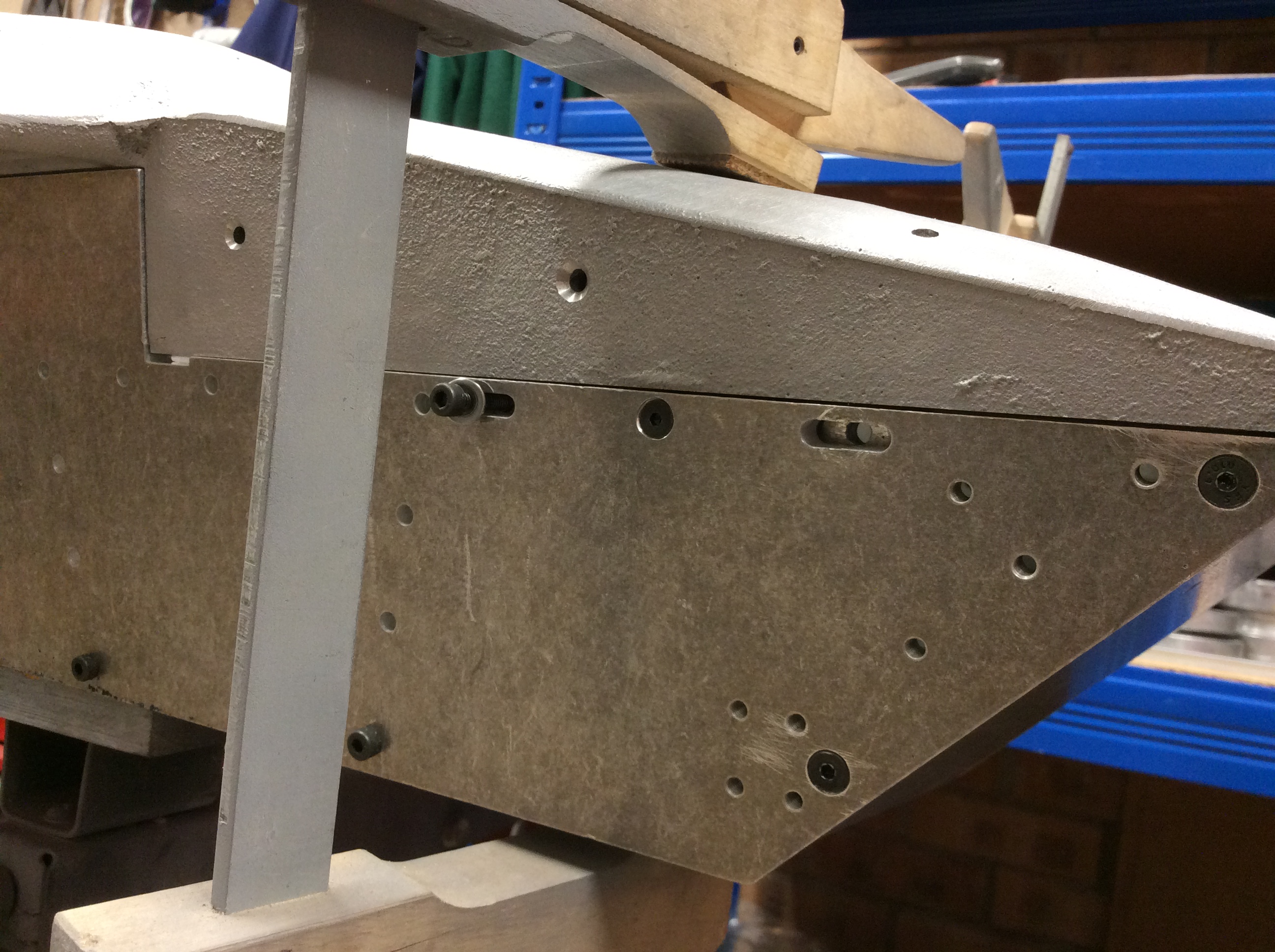

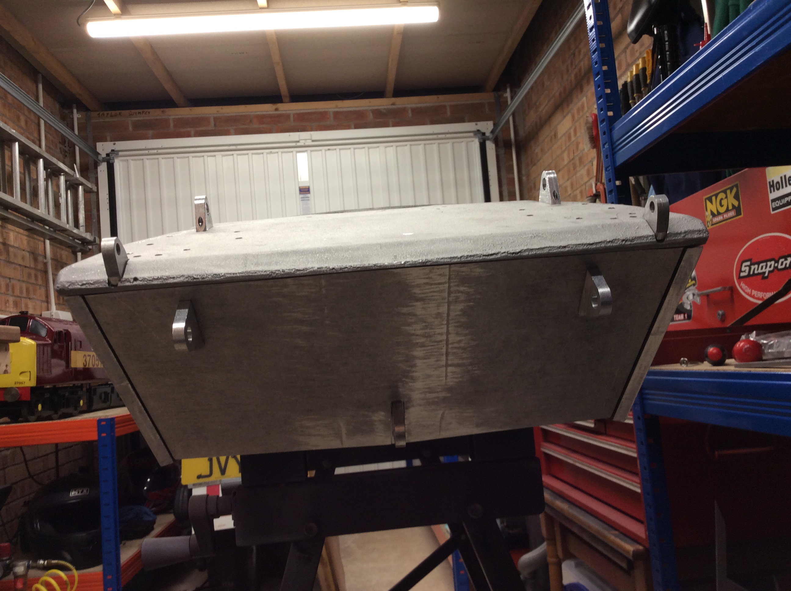

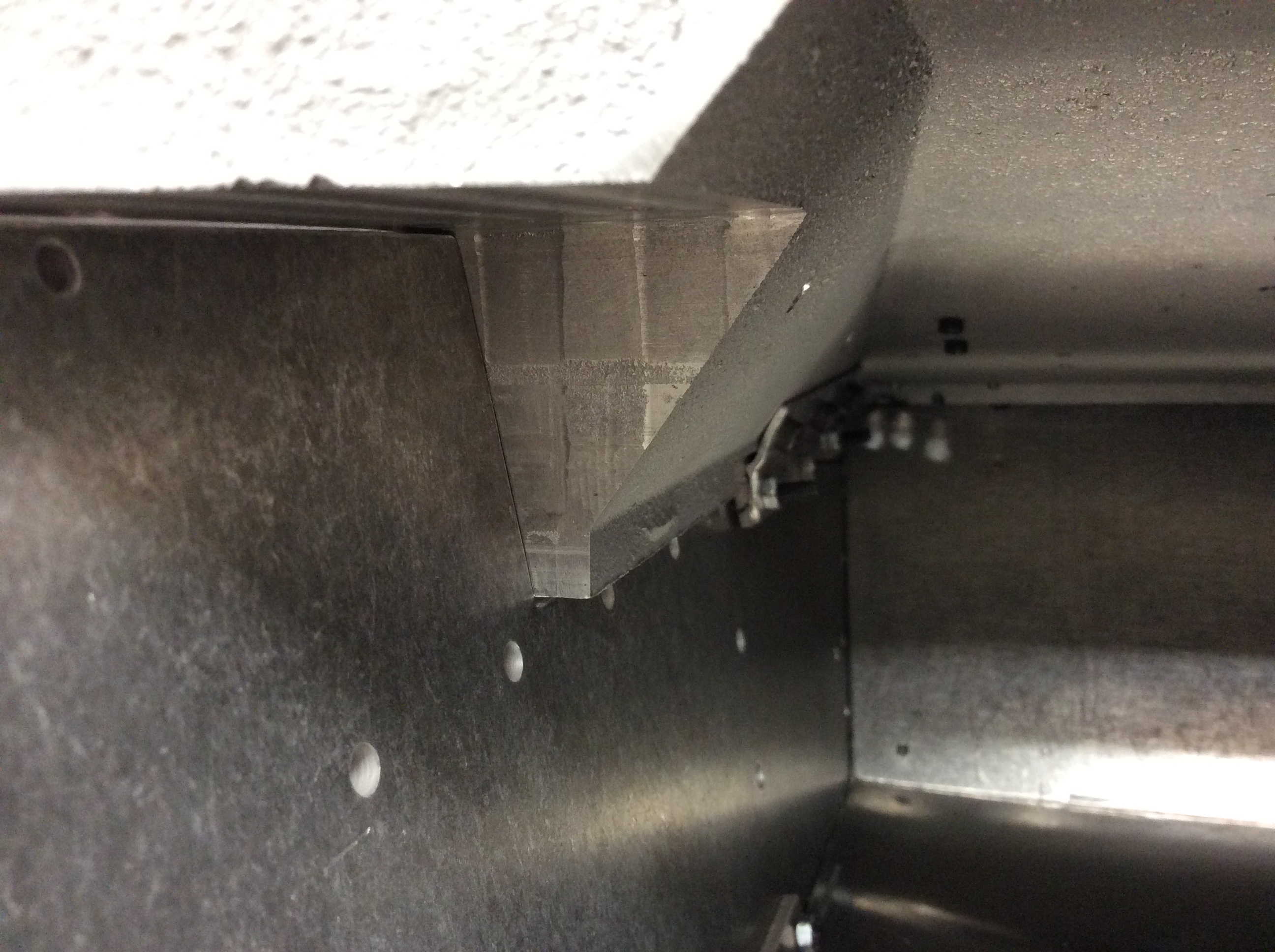

I had an issue with the front hull casting whereby the fixing lug on the left hand side fractured so I decided to reinforce it with an aluminium strip formed to the correct contour.
RH all ok
RH all ok
LH side now reinforced after lug fractured

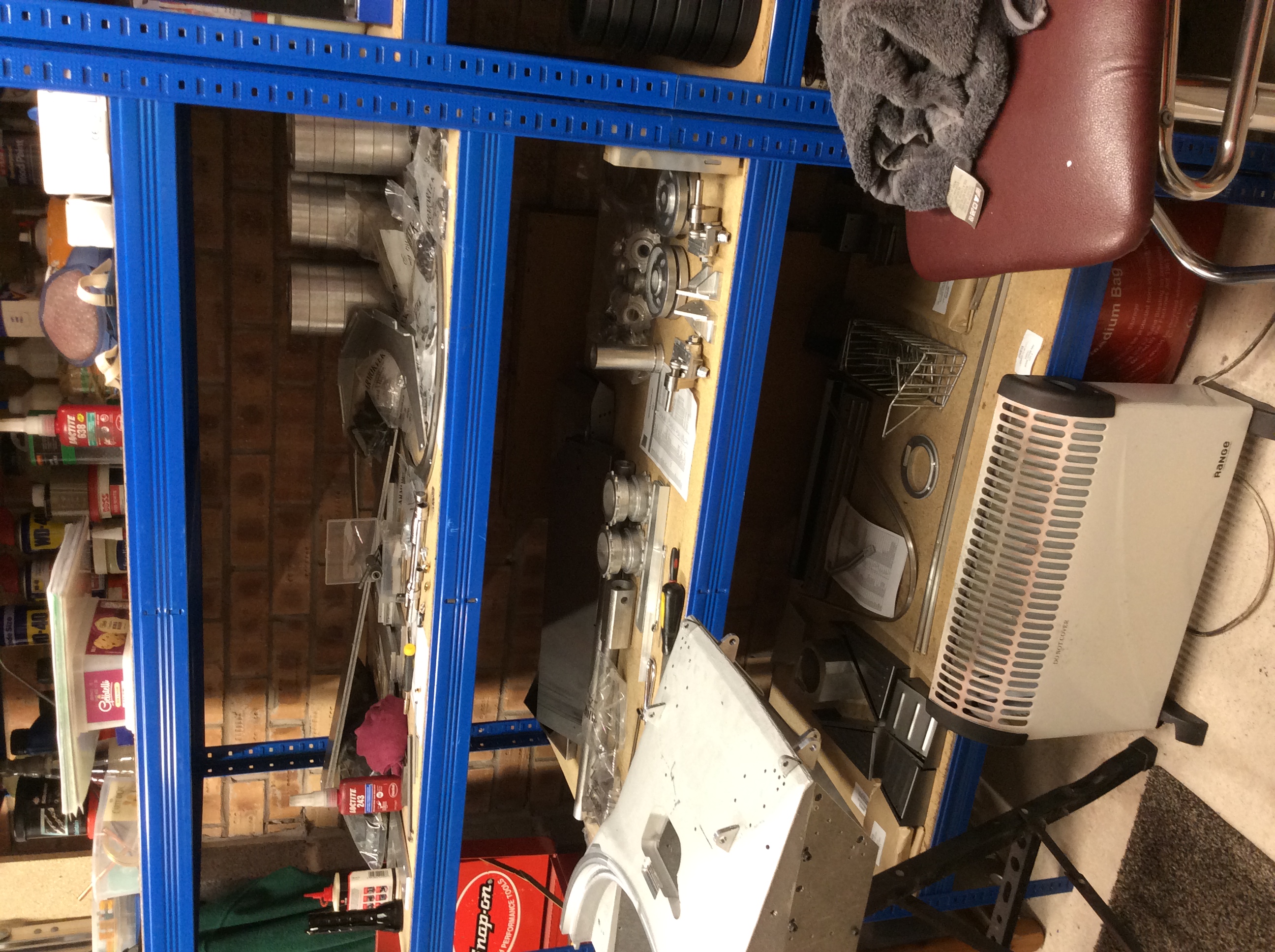

At the moment I'm on my forth coat of paint on the suspension bits. Primer etch, prime colour, top coat, part assembly and touch up.
and like yourself bits everywhere. I found space on top of the wardrobe to keep all the bits together until needed.
Final suspension full assembly will need a fifth coat. Crazy.
But the only way I can see to completely paint the whole assembly without dunking it in a tub of paint. :roll:

Some work on the suspension unit shock absorber parts. To remove the machining marks I use a power file and then “polish” them with a brass rotary brush mounted in a power drill secured in a vice. This leaves a mottled type finish which I think looks good and imitates a cast product.
