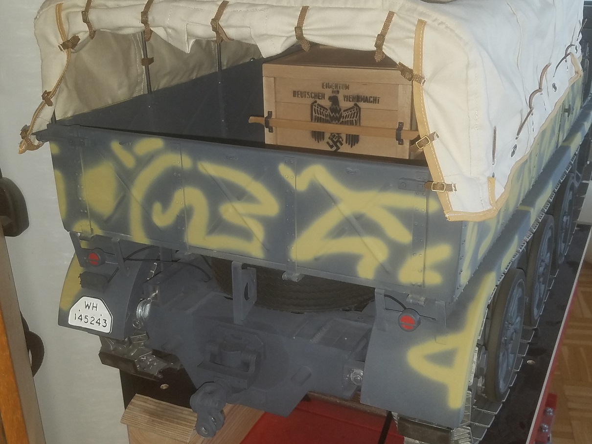

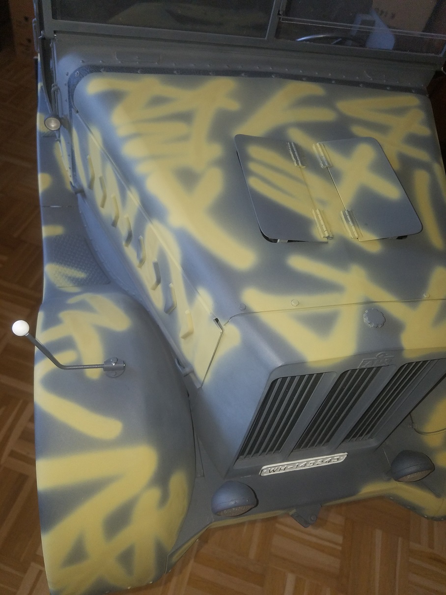

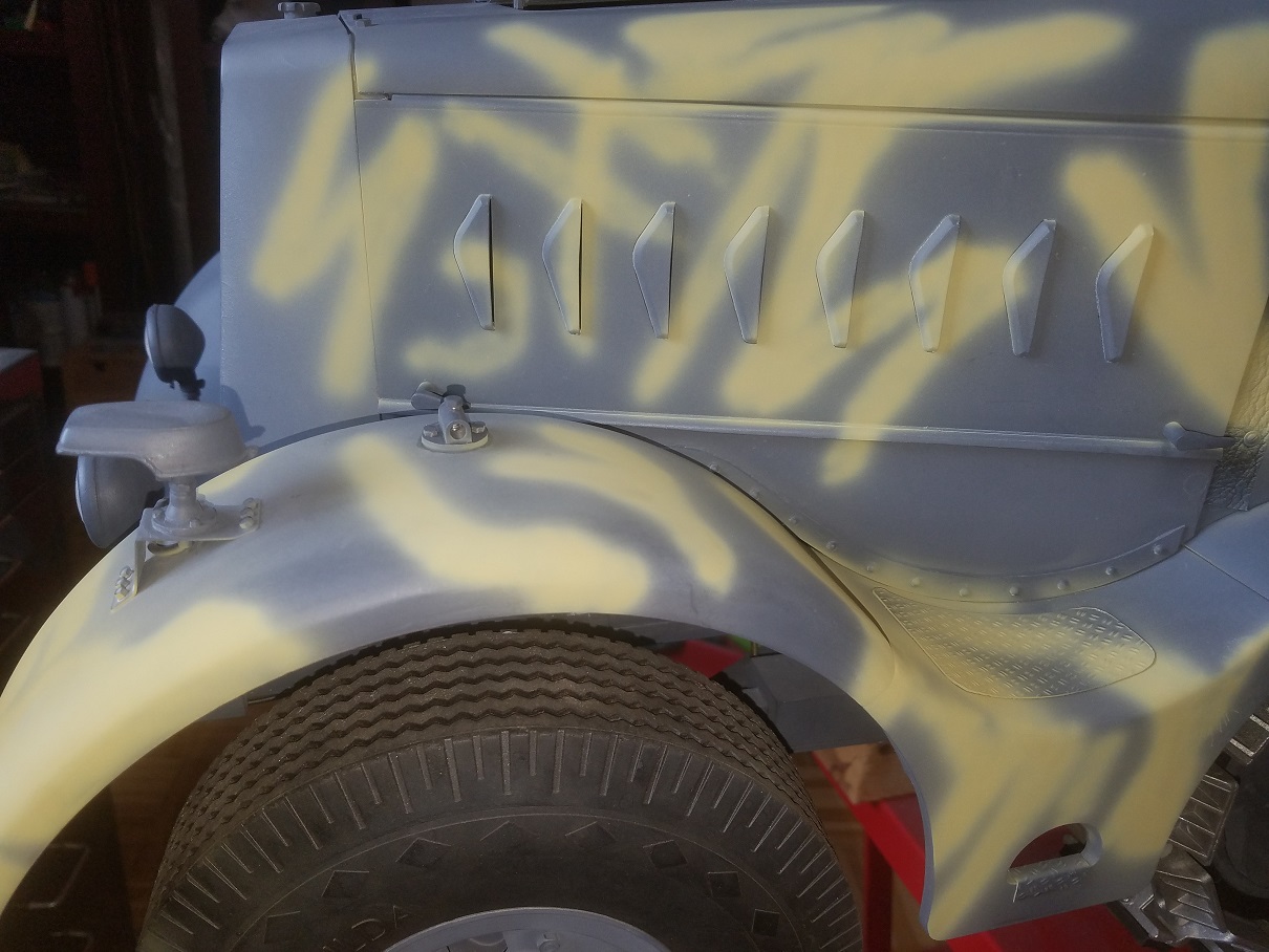

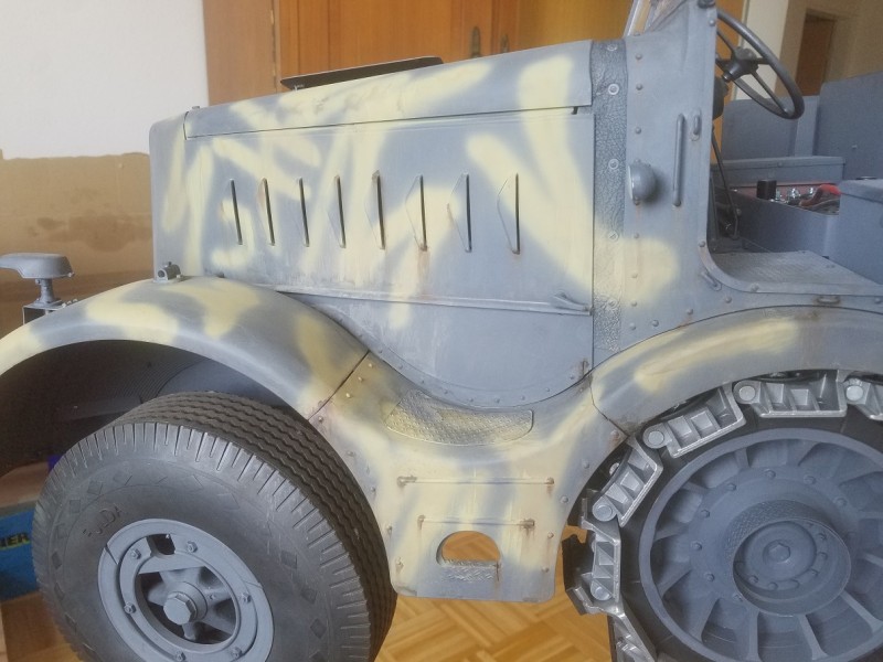

Did some paintwork today.
It looks diffrent to other tank paints, but its frm al real Famo. With some weathering I think its looking good

Thank you Simon,
I did'nt realy know if it looks good or not. It's verry special, but verry rare indeed.

I have to get used to it, weathering will really make it shine. But what I really like is how well you replicated it, skills!

Oh my god Florian, I had the shock of my life when I seen this, it looked like Chinese graffiti !!!, HOWEVER - I think if you blend it in a bit it could be a really good look, sorry don't mean to offend but its better to be honest

Good morning Adrian,
i thought the same when i was done.
Well, the first camouflage is not finished. weathering follows soon.
Lets have a look how its shows if finish.

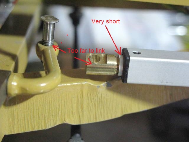

Far behind your building progress, I read this thread almost everyday for good ideas. Today I just need to ask for your opinion.
On your 28 Jan 2019 photo, the linear actuator (CP0314) for steering shown a longer white rod (see the red arrows) : When I try do the same thing, found the white area shown on my linear actuator is very short. So short that it can't link with the steering arm. Did I do it wrongly, or missing something? I have tried to pull the white rod outward, but just failed.
Do I need to do so by bench testing, ie, by connecting the battery, and connect R/C Tx, Rx, and the Motion Module? If no, what else should I do?

The actuator in your picture is completely retracted - this would be its position when the wheels are turning right. If you connect it to power it should centre (extend to its mid point).Chang wrote: ↑Thu Jun 11, 2020 4:56 amWhen I try do the same thing, found the white area shown on my linear actuator is very short. So short that it can't link with the steering arm.
Do not force the white rod by hand - this will damage the actuator.

Kian is on the right way. Don`t try to pull or turn on the liear servo.
You have to connect the servo wiht the steering from the axle. Maybe the Wheel is not strait in front. - If this, you have to adjust it on your controler.

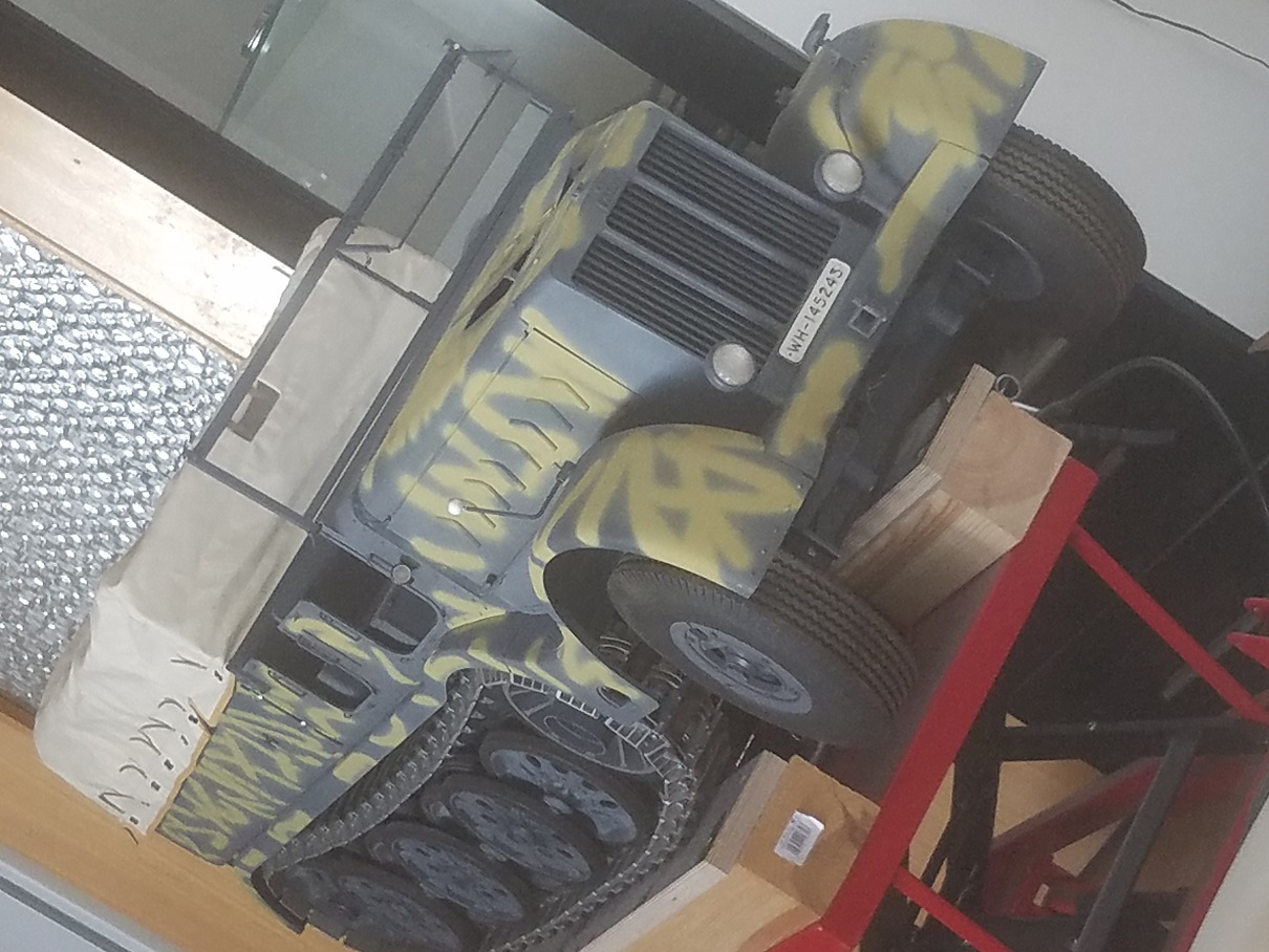

I start weathering my Famo, because I am waiting for some stuff for my seats...
