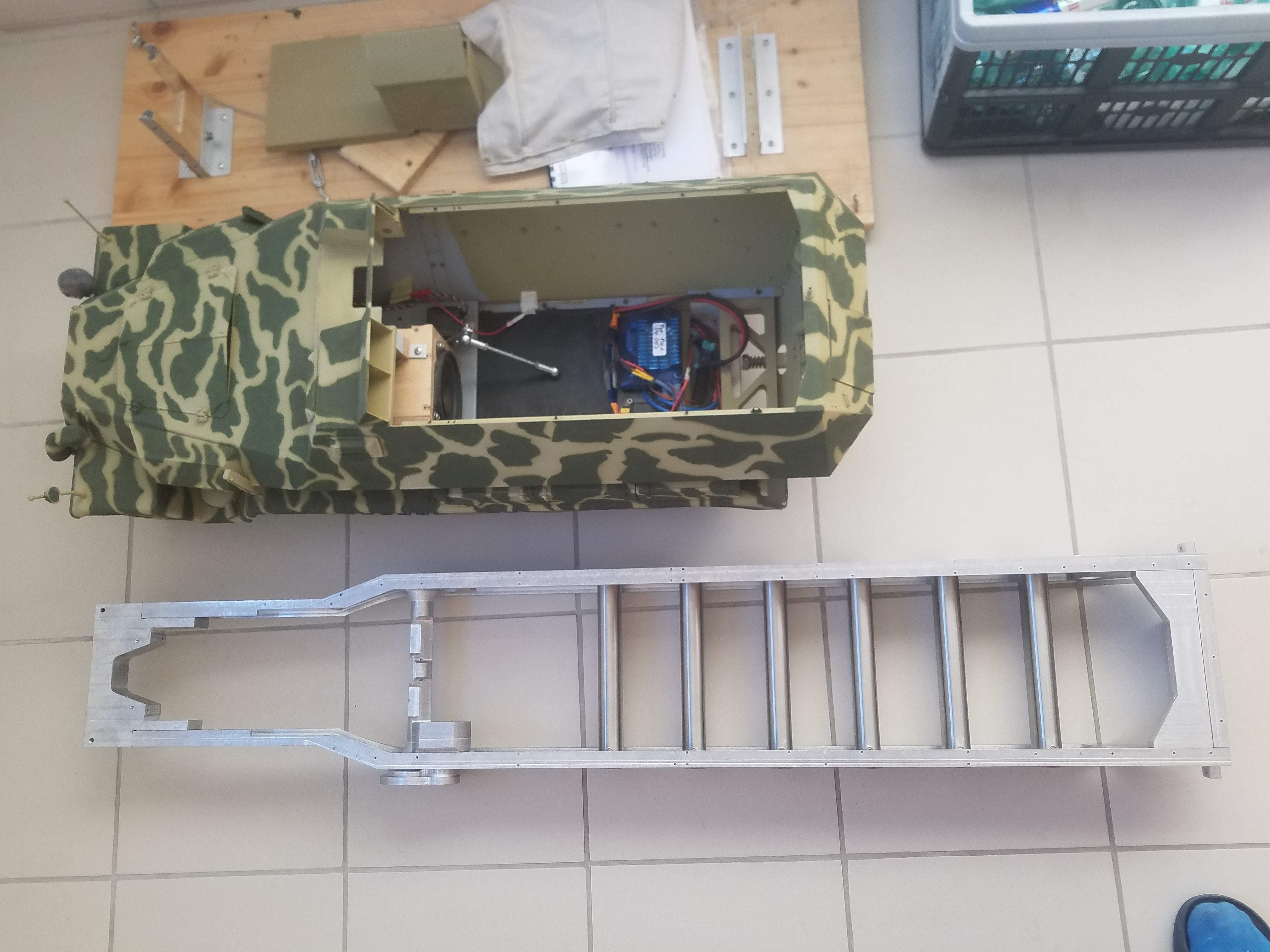

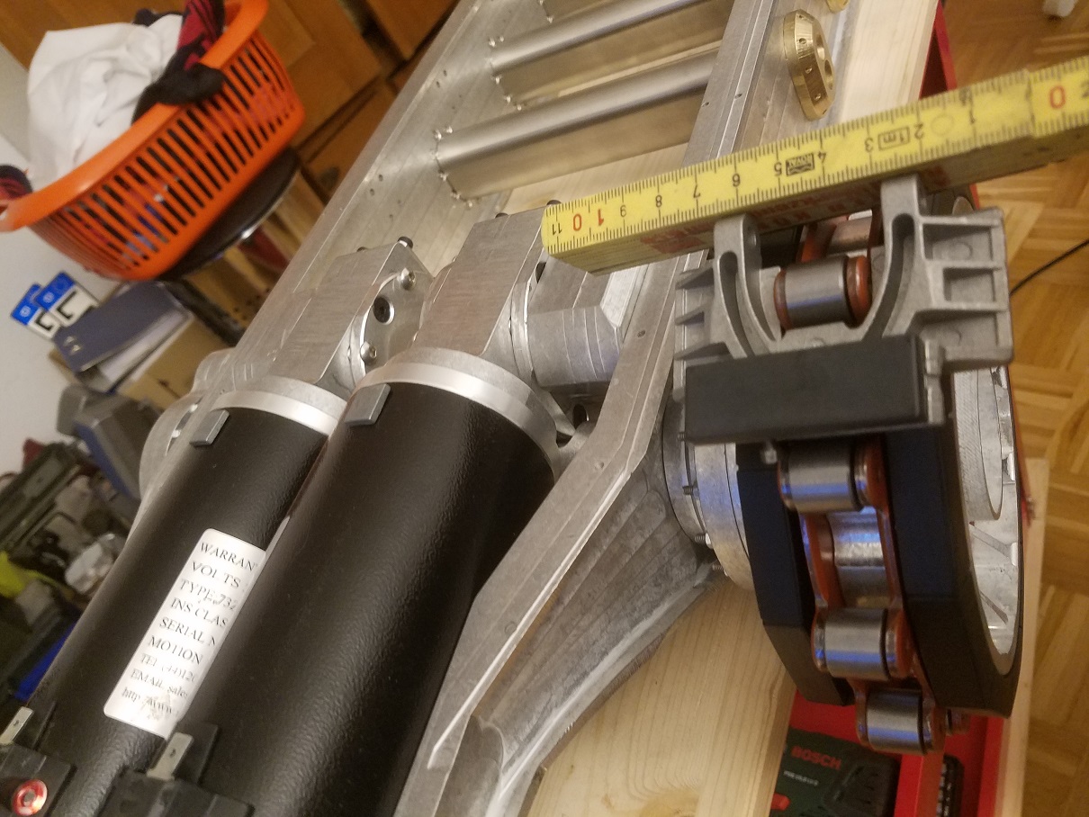

Re: Florians FAMO build
Those wheels will be magnificent Florian, soon you will need two people to turn the Famo over! Regards Phil.
For the rubber pads of the chain I am still looking for a hexagonal screwdriver M3x6. I have a manufacturer who could make this custom size for model screws:
https://knupfer.info/shop/index.php/deu ... -kopf.html
They only offer M3x8. But maybe you can make M3x6.
Is there anybody, want this special model hex srews? You would need about 600. This would looking awesome scale.
Is that the screw head you want in the photo of your track link?
- Posts: 678
- Has liked: 297 times
- Been liked: 645 times
Yes Phil, look at the left side from the gun. the nuts in the front wheel is the same size.
I'll make you some pictures next week.
