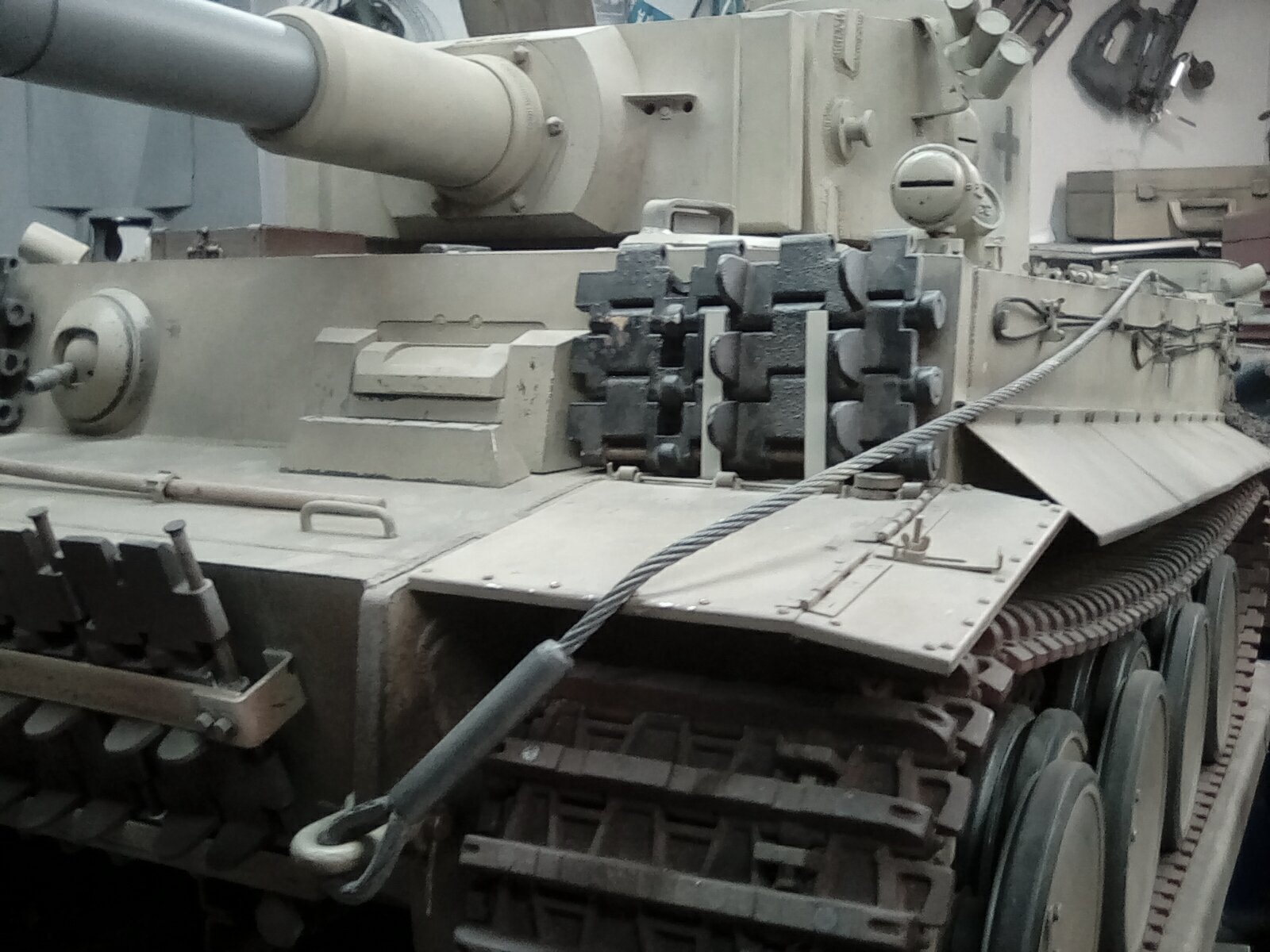

I've also been doing some more research on 331 and have found some very interesting photos showing the spare track stowage at the front.

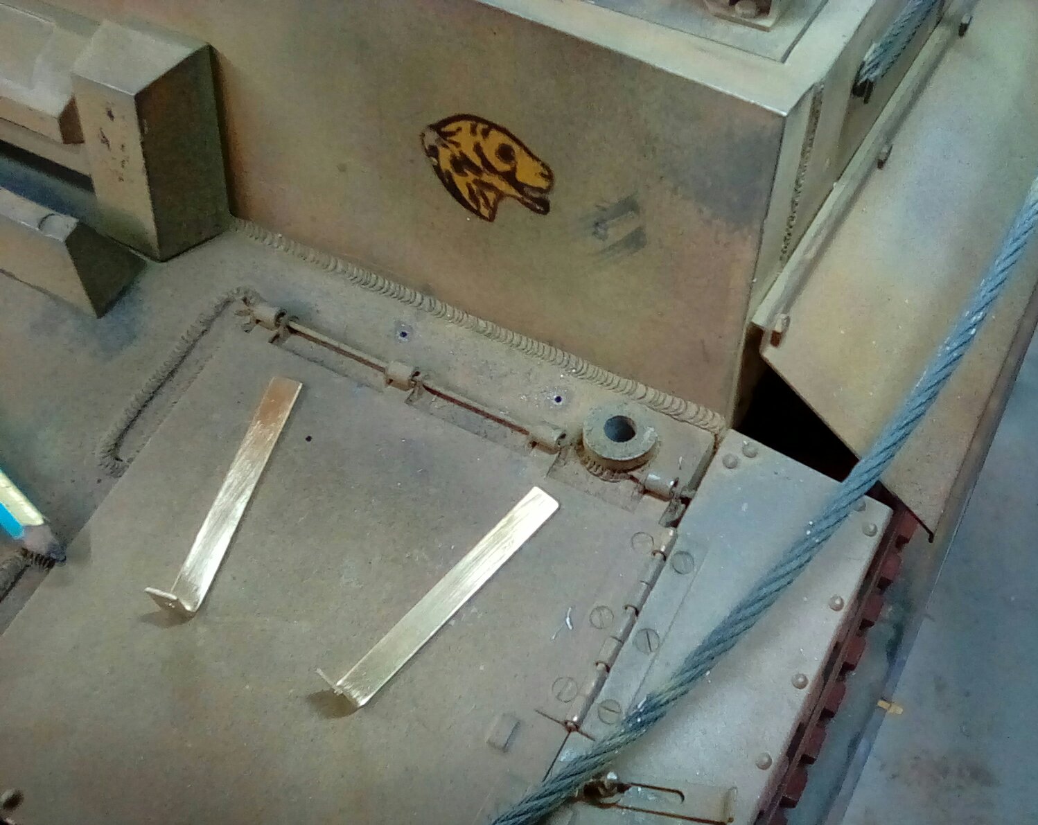

I can't quite see the brackets that hold the spare track, some units used welded flat stock in pairs some units simply wired them to the hull.

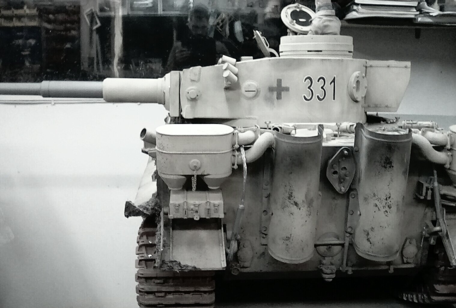

Stencils all done in black with hand painted white surrounds.

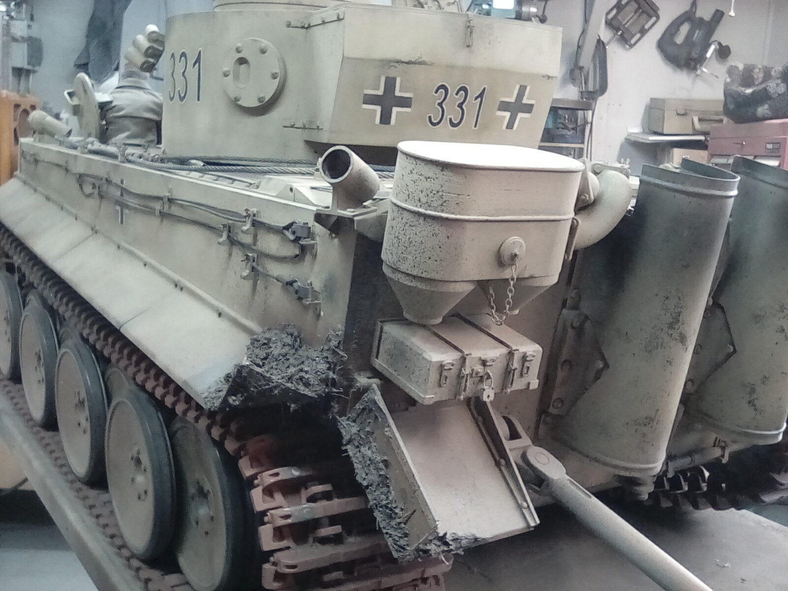

More details added to 331 8)
I would like to add the field modification of the basket that was attached to the left rear of the turret stowage bin , if anyone has any information regarding this I would be very grateful, over to you Kent?

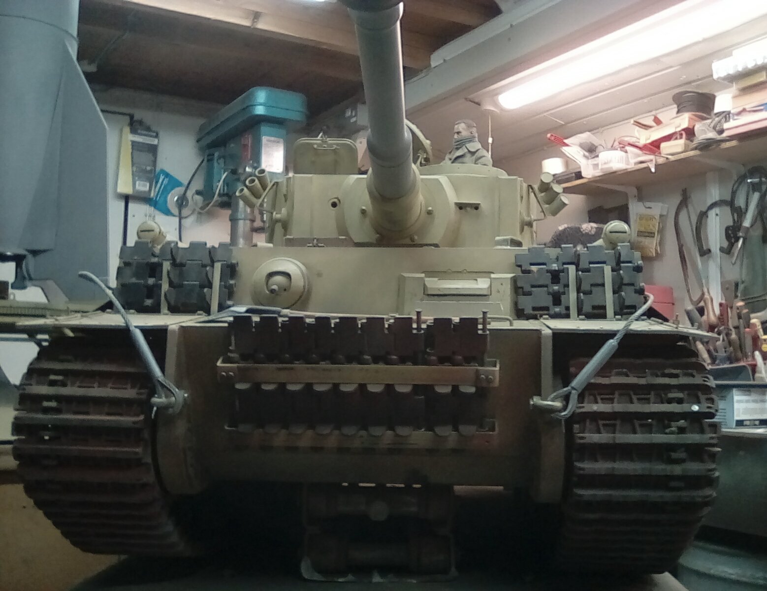

It's a look I've always admired, the glasis up armour.
Often overlooked piece, the optics eyebrow.
I've been dressing the Tiger1 just the way the unit had it, well over a period of say 6 to 10 months, and a lot can change over that amount of time in combat.
That iconic profile is coming together, although she's not sat on the suspension just yet so she will sit lower, more squat and more aggressive.  I shall wait for the steel tracks to arrived before that happens.

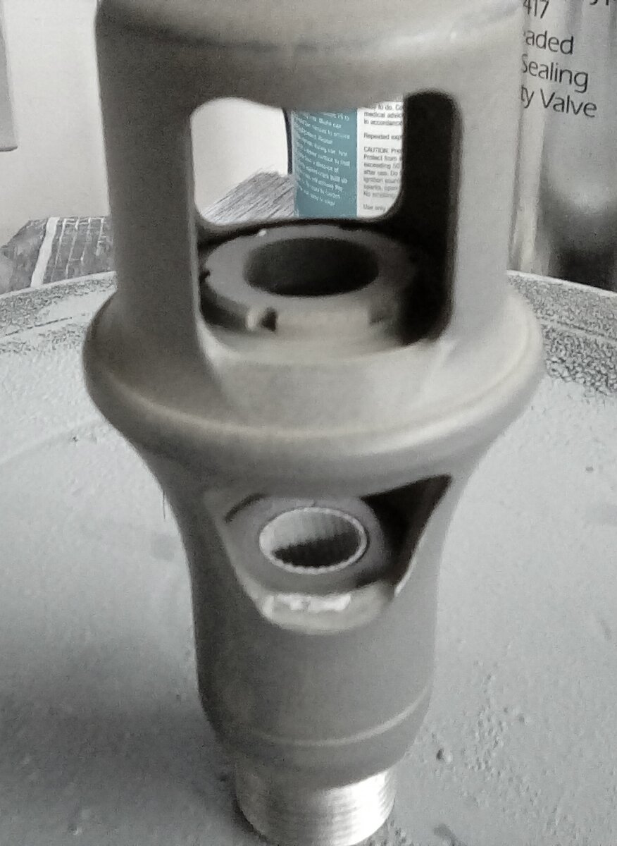

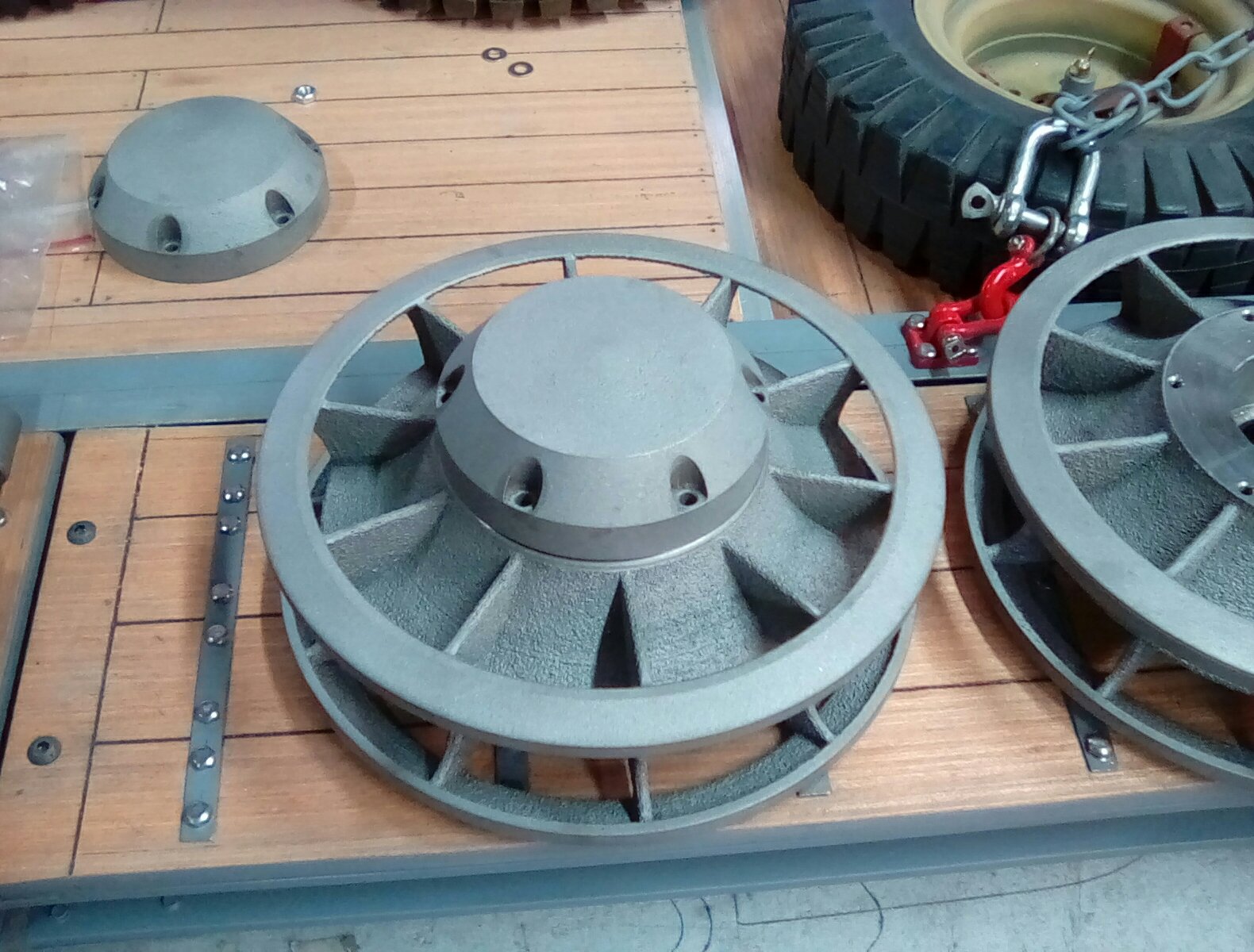

The idlers arrived from Liam today. 8)
Superb craftsmanship, the metal 3d printing "rings like a bell"! You could not distinguish the item from cast ali.
Locking tabs to add when I'm happy with everything.
Has liked: 790 times
Re: Early or mid ? Tiger 1 build by Phil Woollard
Idlers look impressive. Are those representing the large (700mm) idlers?
Posts: 4279
Has liked: 2280 times
Been liked: 7192 times
Yes Vince and the quality is amazing, it takes 3d printing to yet another level. They have to be machined with conventional tooling to finish. I can see Armortek using this medium in the future. 8)

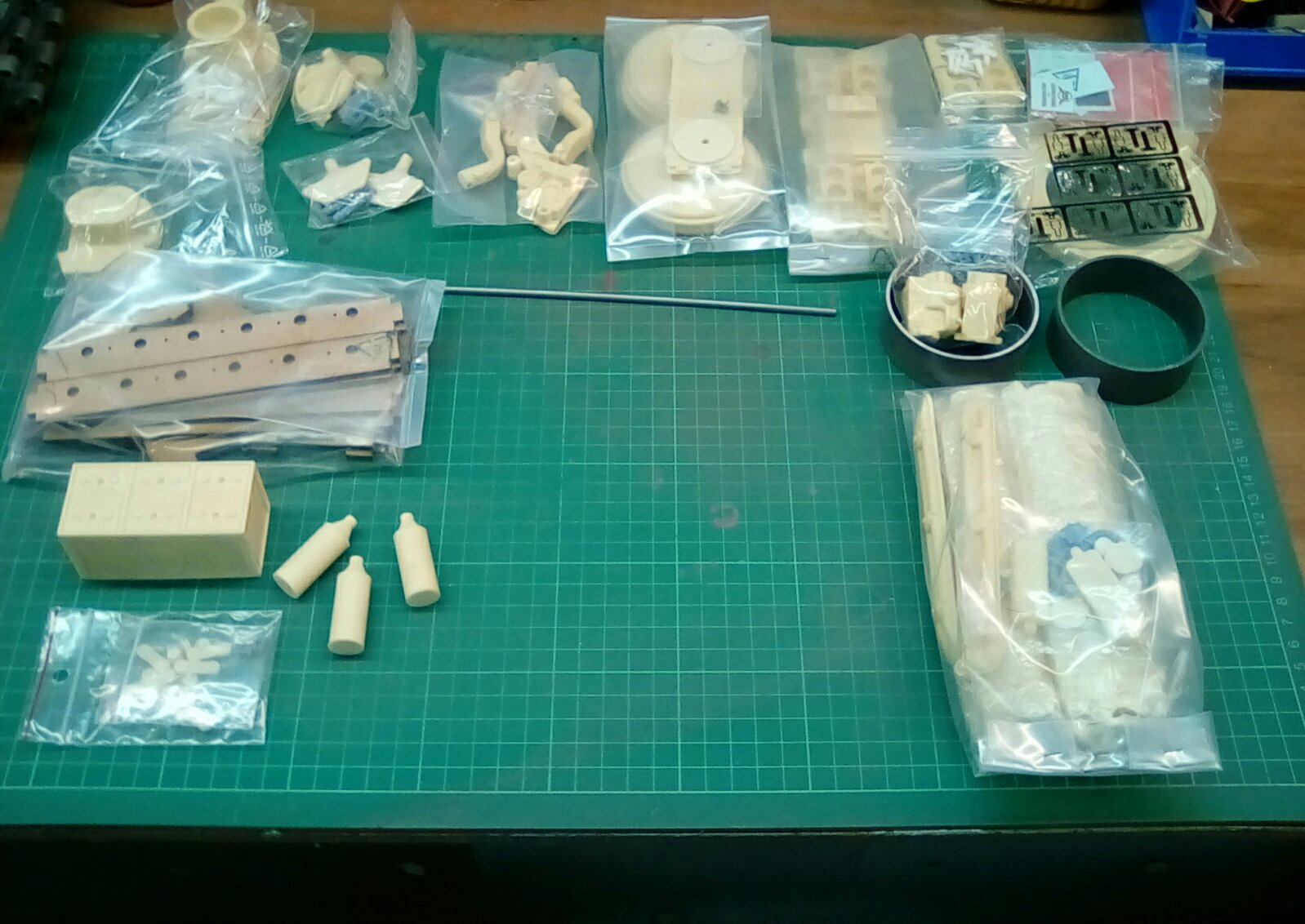

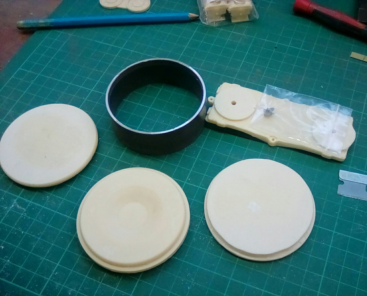

Making a start on ivano's superb Maybach.
Ivano sent me some of his beautiful parts to review, so that's what I shall do.

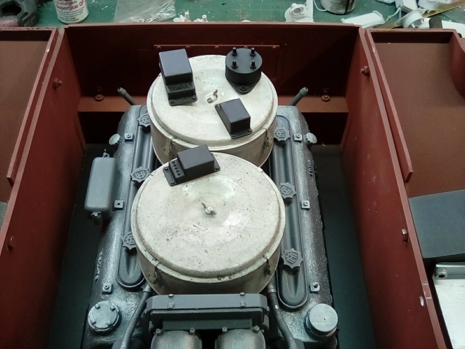

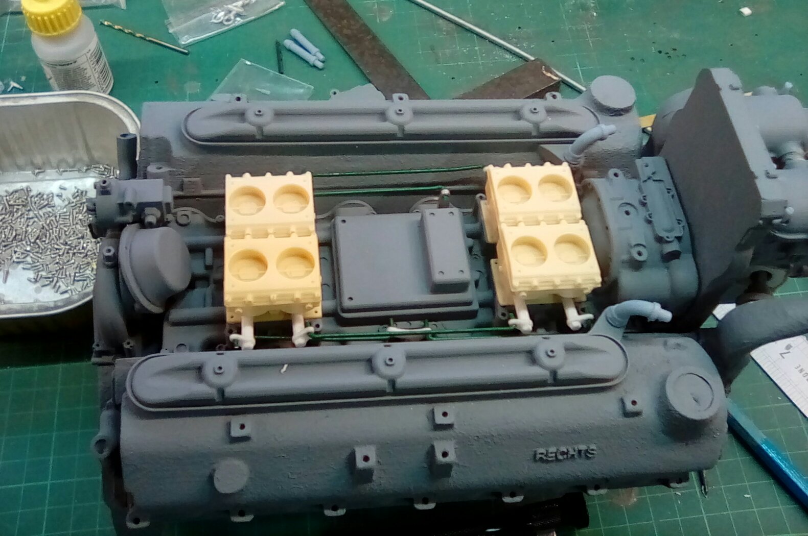

The hl230 goes together. 8)
Ivano's Maybach goes together quite easily.
The air cleaner parts awaiting fitting.
If you have a lathe this job is a whole lot easier but a file will do.
Finding the center of the air cleaners while they are in the lathe.
Carburetors go in.
Carburetors go in.
I love ivano's air cleaner latches.
Carburetor linkages made and fitted.
Checking the fit after cutting the engine in half!

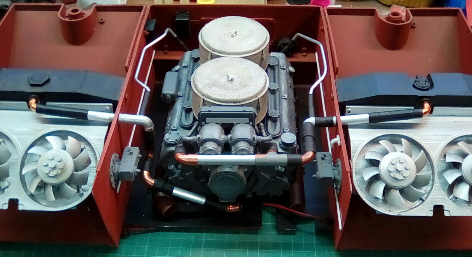

Anyways some more work done to 331's engine and engine bay. 8)
Exploration20@outlook.com
As the whole unit is modular it can be pulled out and worked on in relative comfort.
Lining up the fan gearboxes.
The electrical regulators and connection boxes ready to go in.
Lots more to add like the wiring.
Good to see those fan gearboxes in place. Did you re-scale them?
