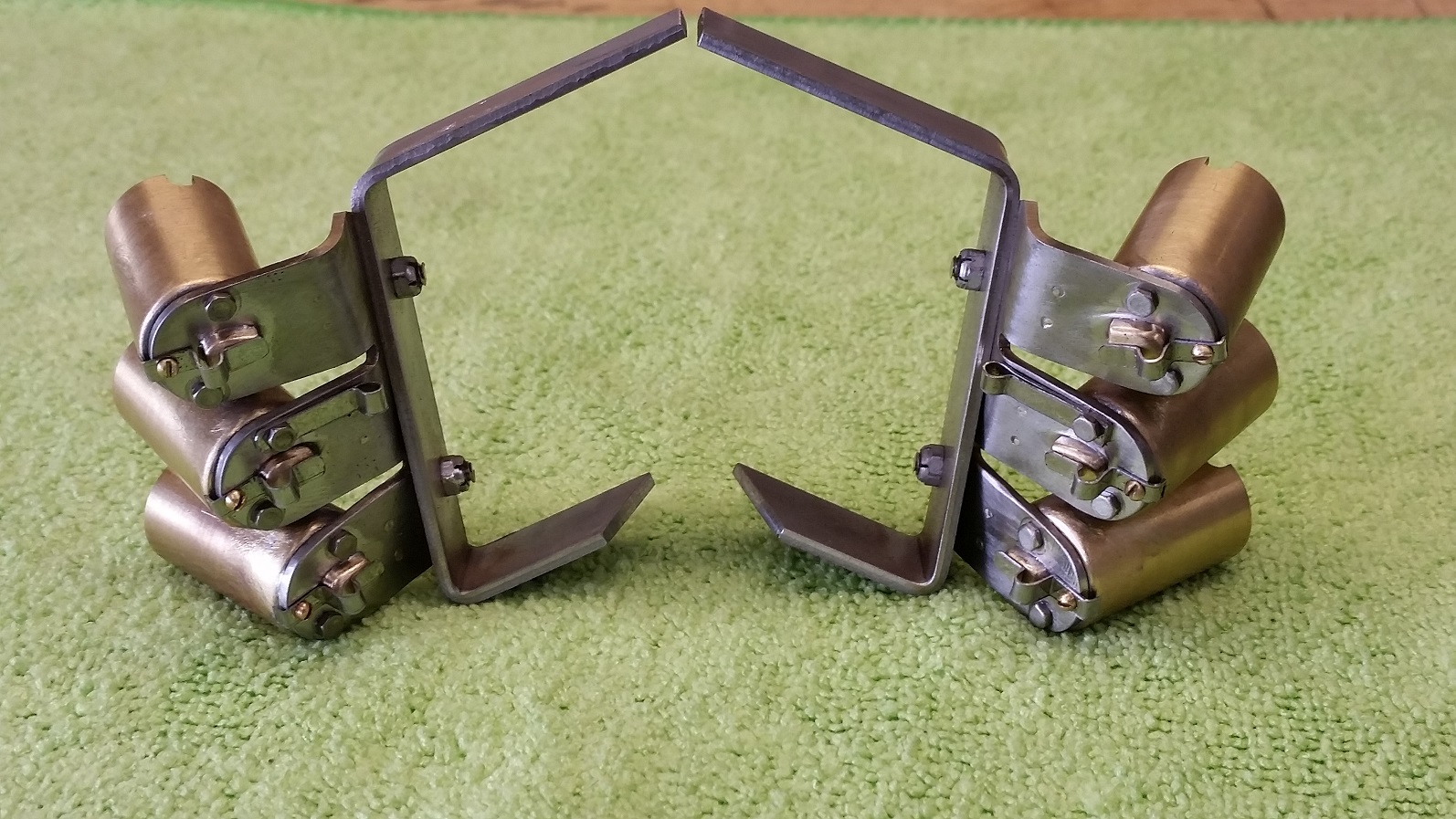

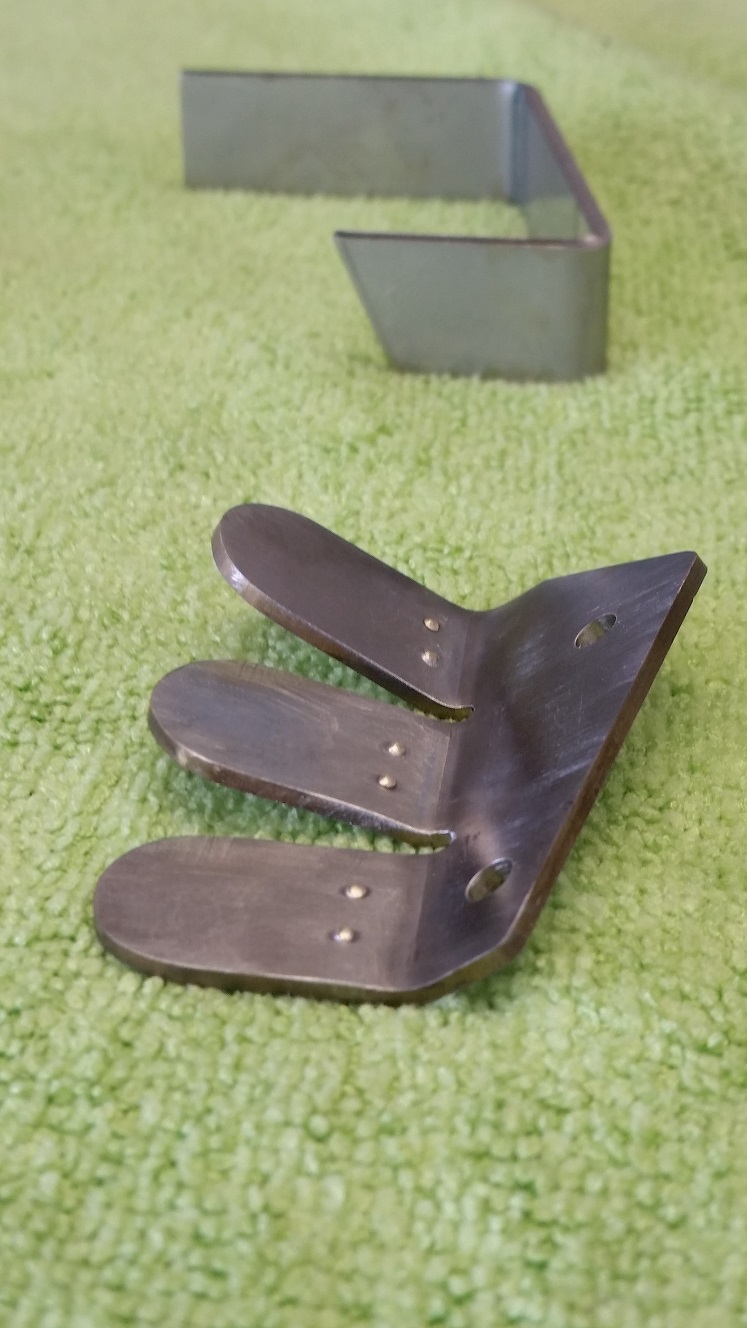

Not sure what they are or their purpose ...they look like rivets..I added them anyway

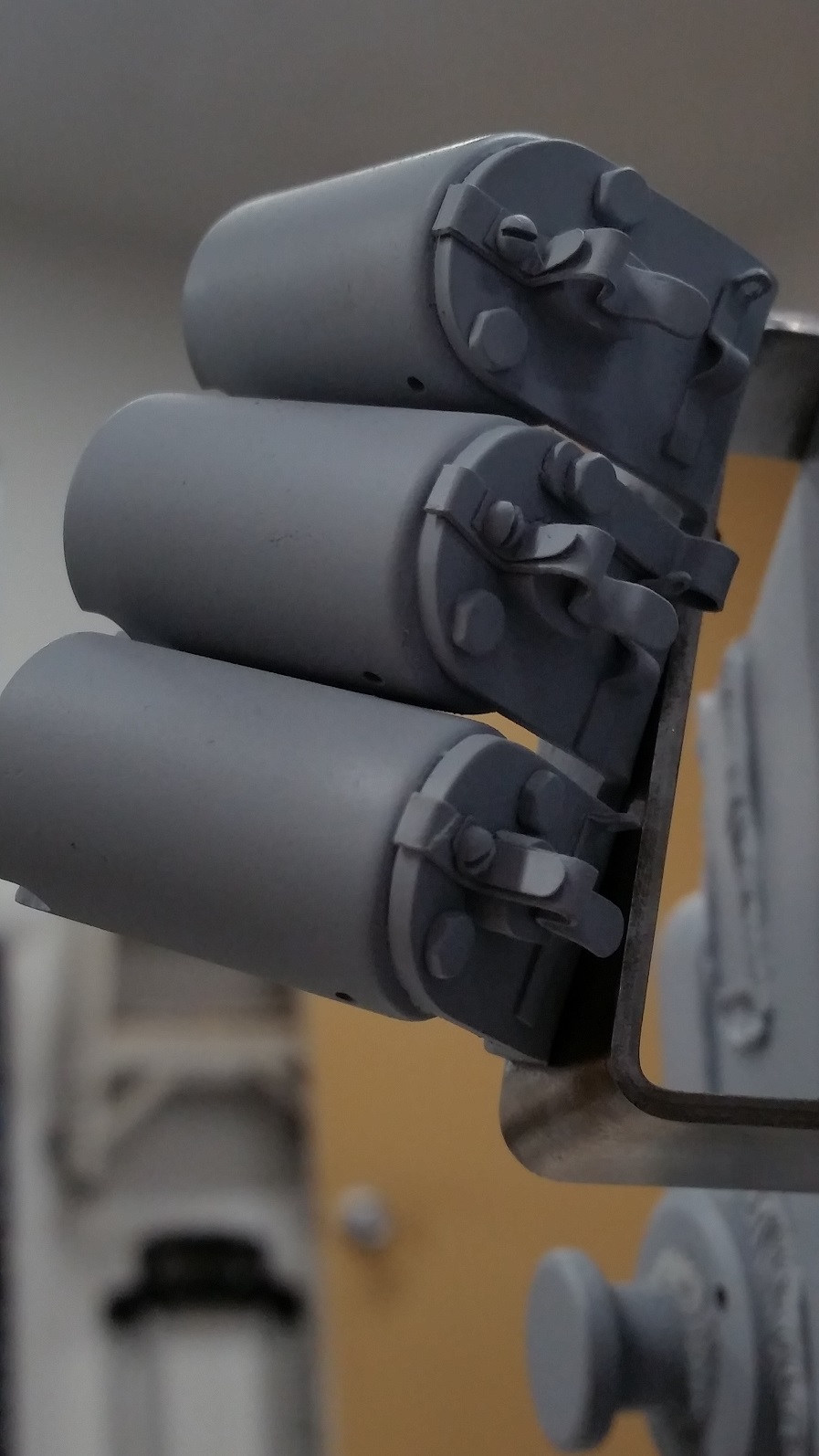

Finished detail work...I will add wiring once painted...tomorrow will install to turret

Re: Tiger build
The rivets look like hold on a mounting point for the end of the chain which attaches to the plug at the back of the firing tube.
I would guess the plug was detached whilst the canisters are loaded, so that there is no chance of one going off as it was being loaded. If you were stood behind when plugging them back in, it might still be a shock but not ruin your day quite so much.

Thanks Adrian :D

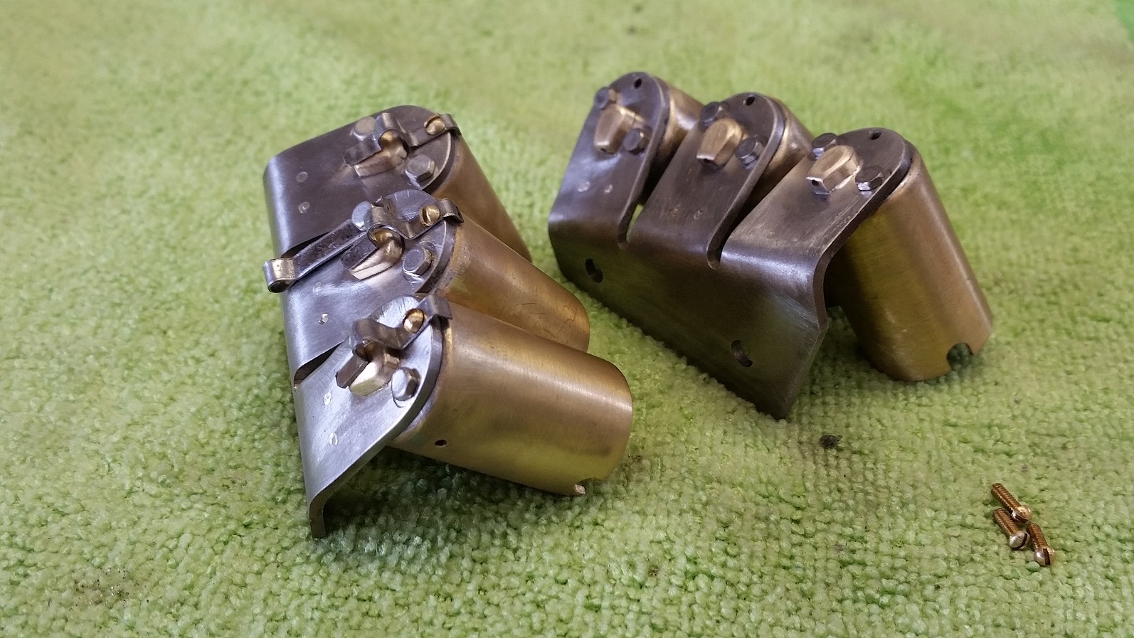

Reworked the back end of the smoke dischargers after looking at Adrians awesome photo...closer to scale now

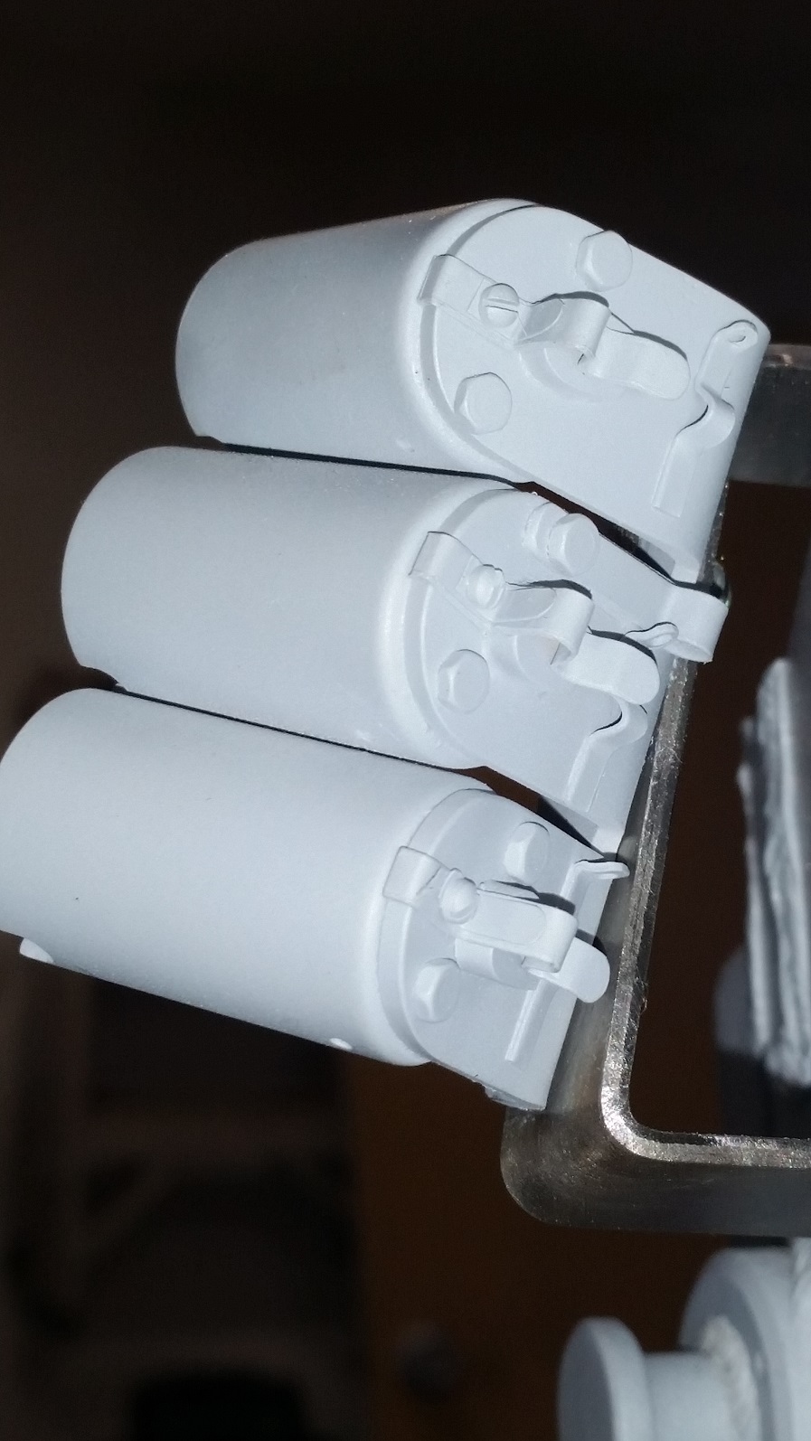

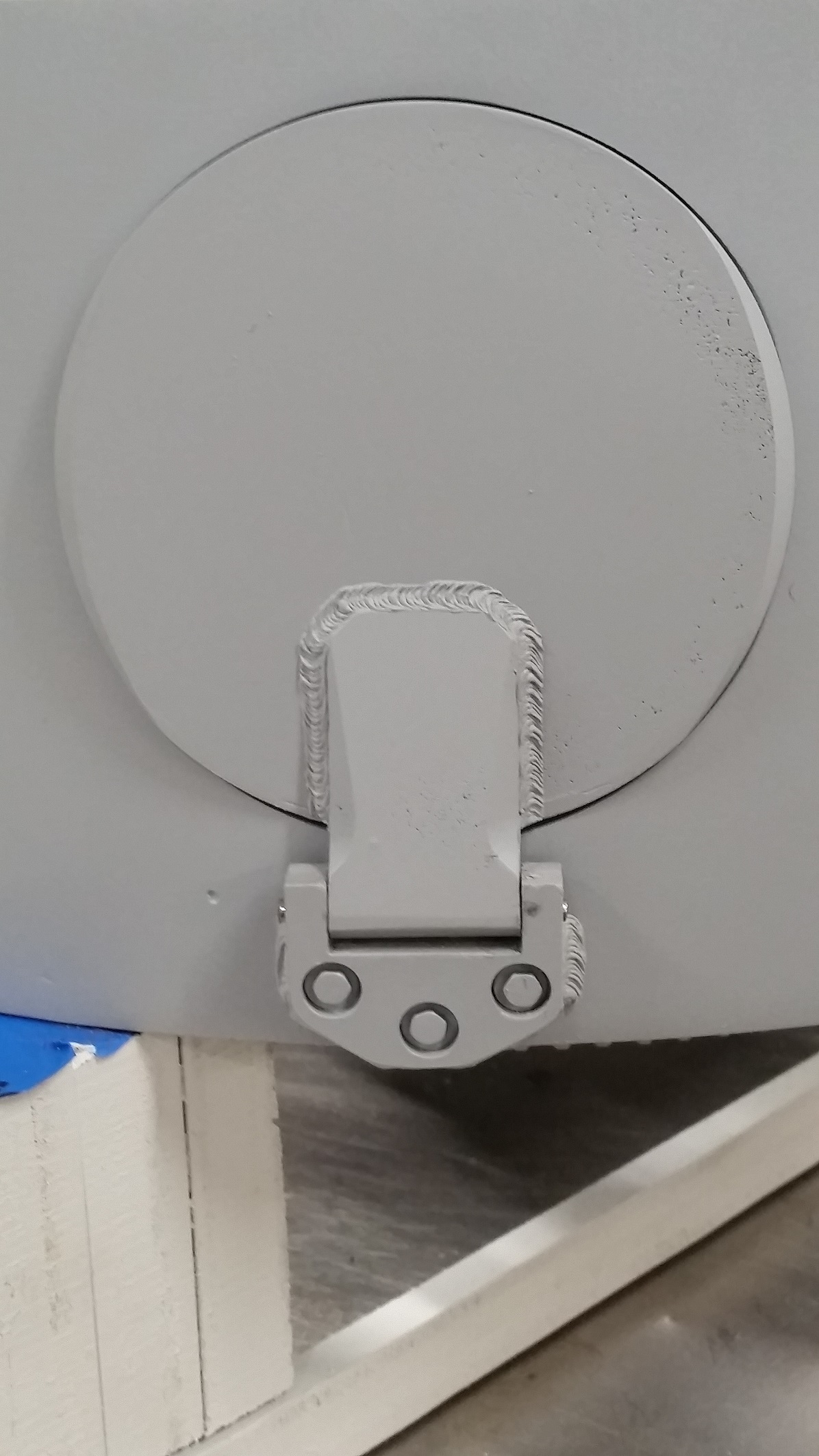

Reworked for a few more hrs then installed smoke launchers and escape hatch

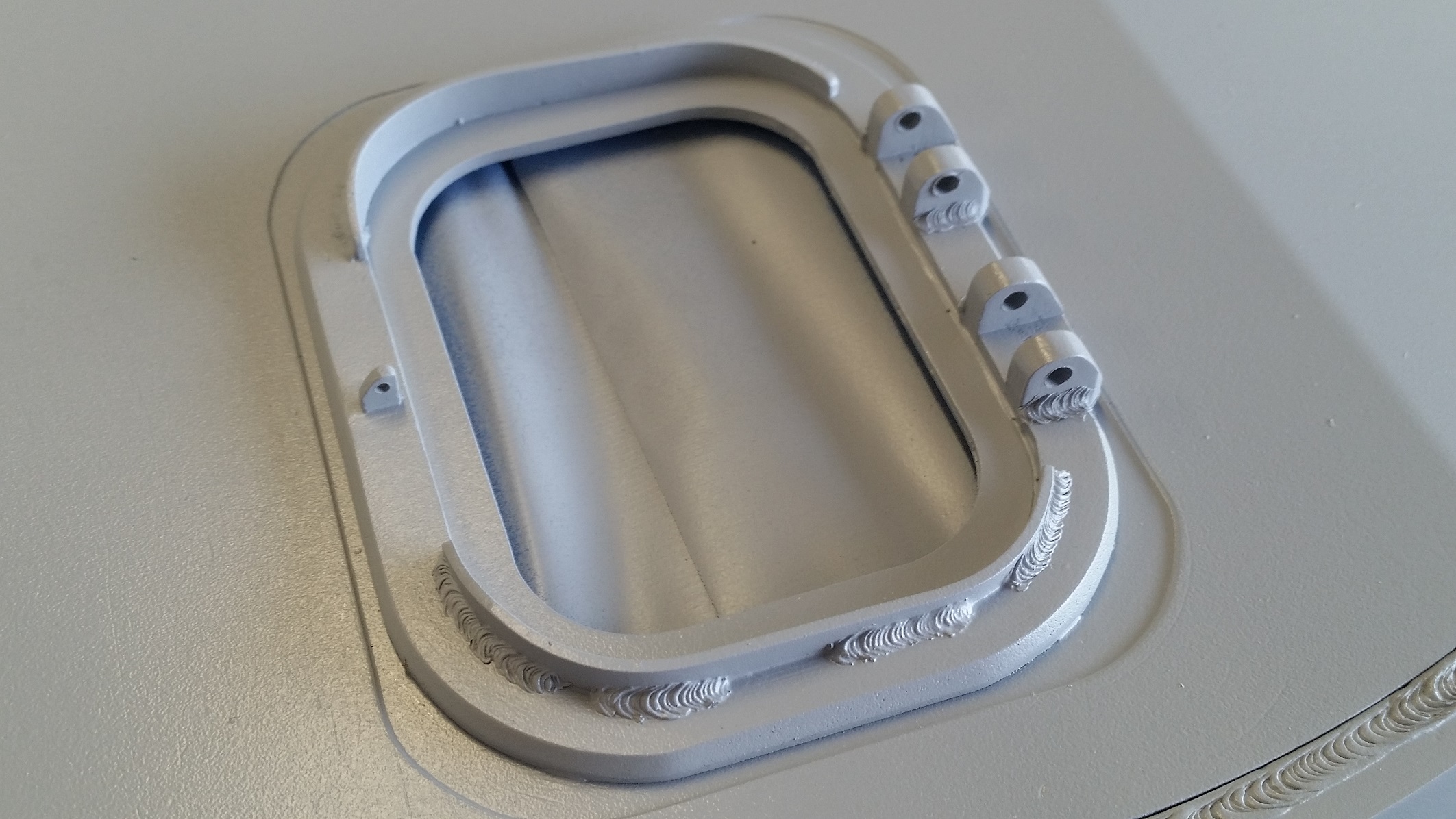

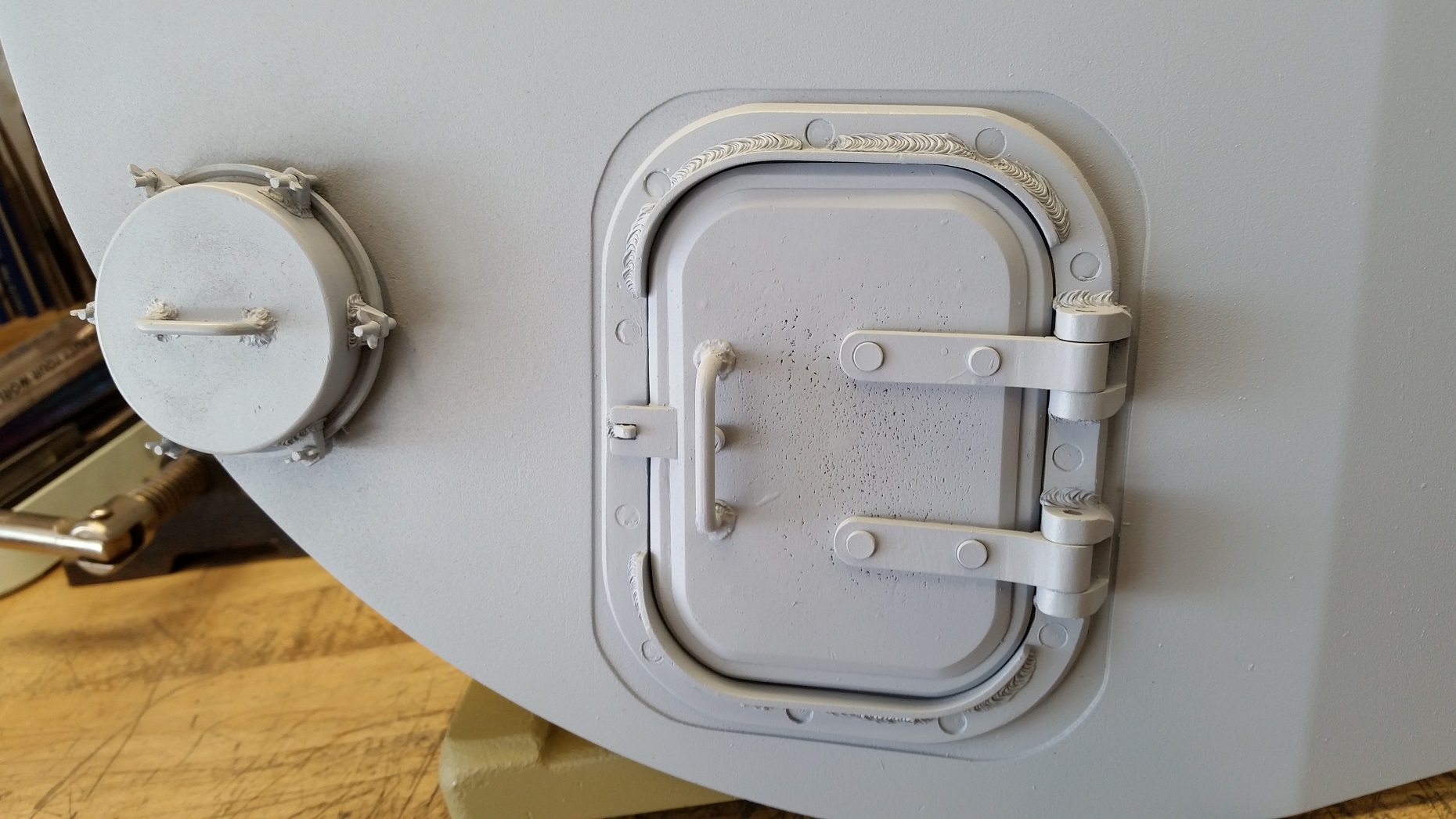

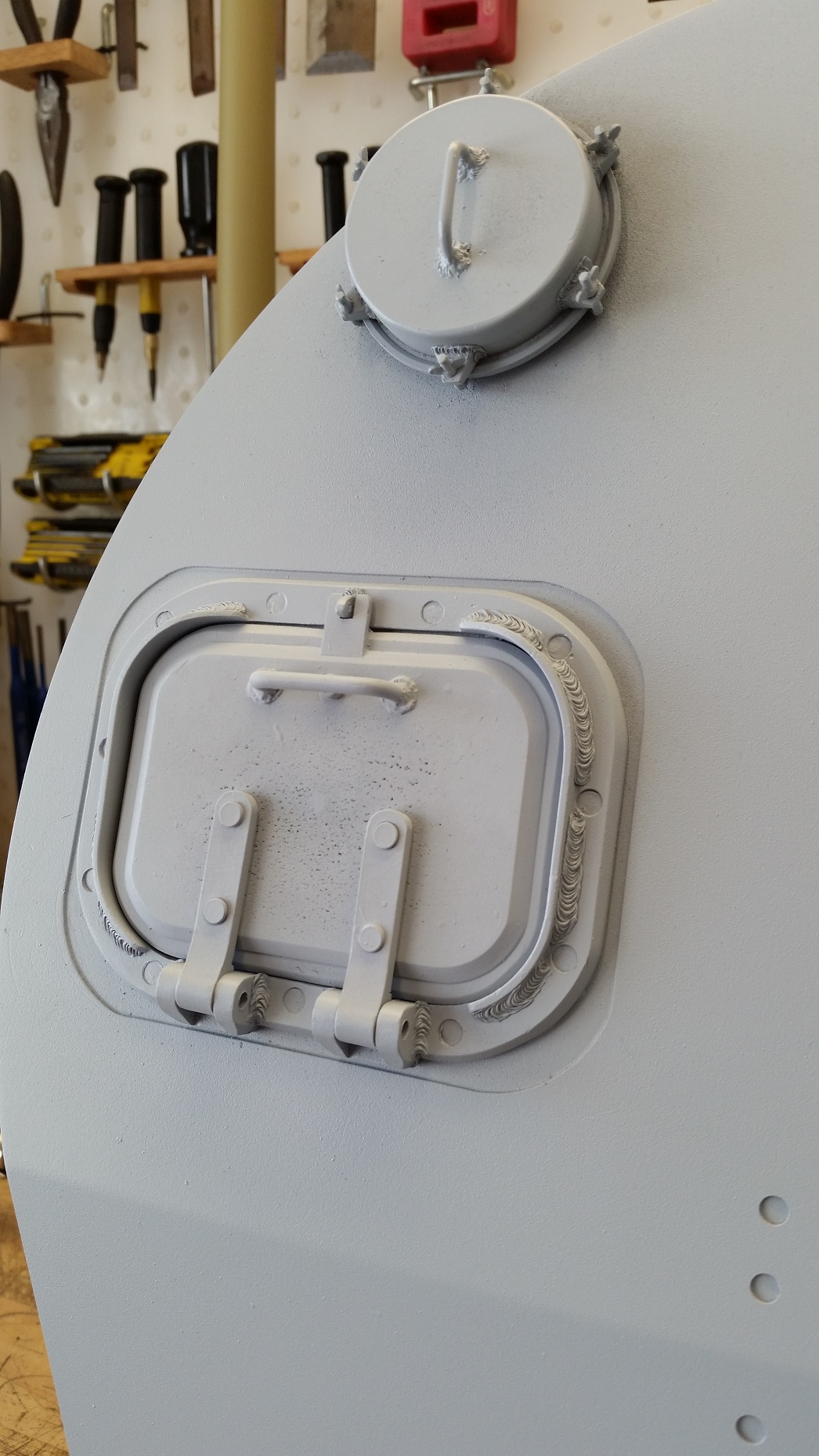

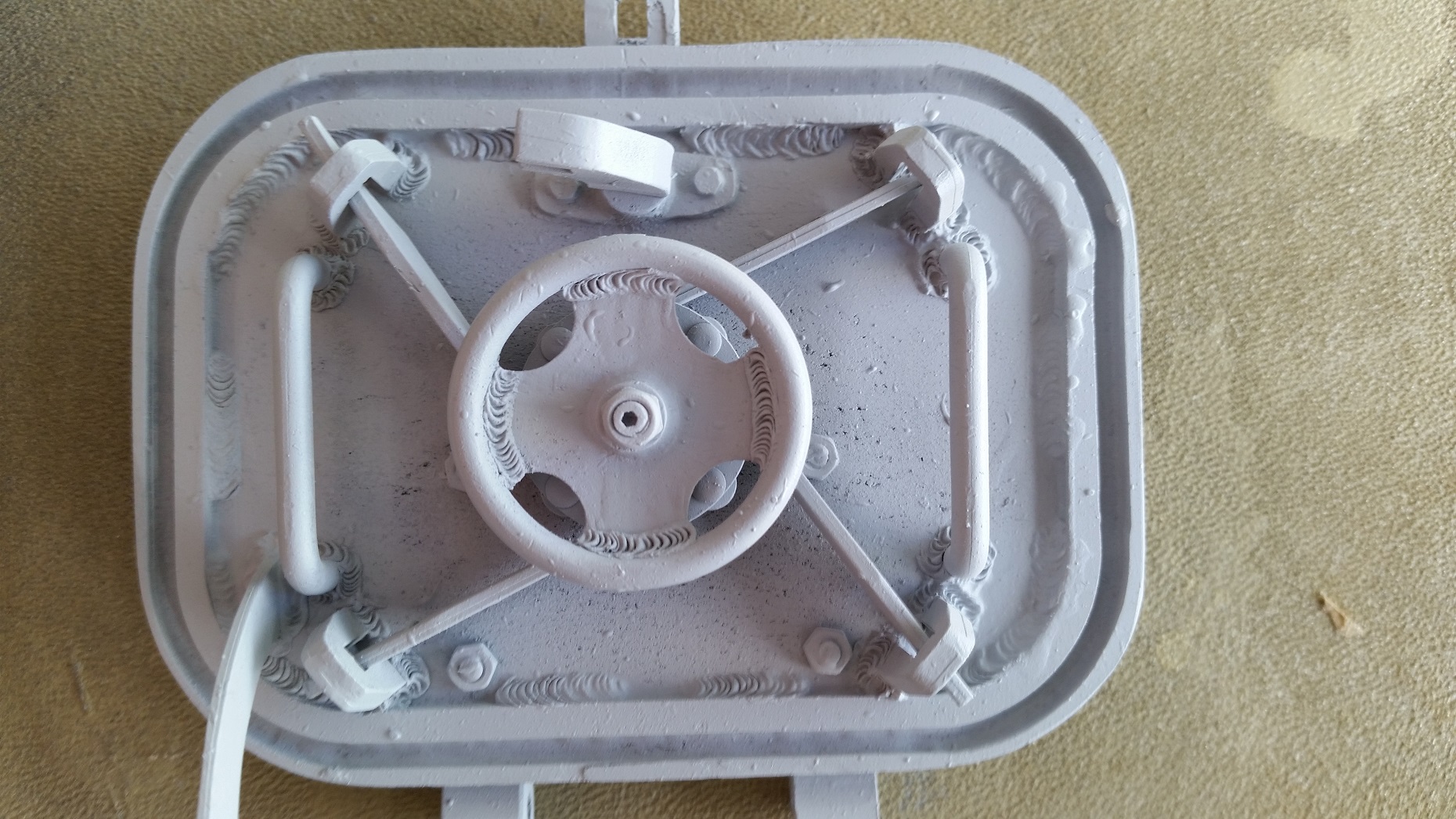

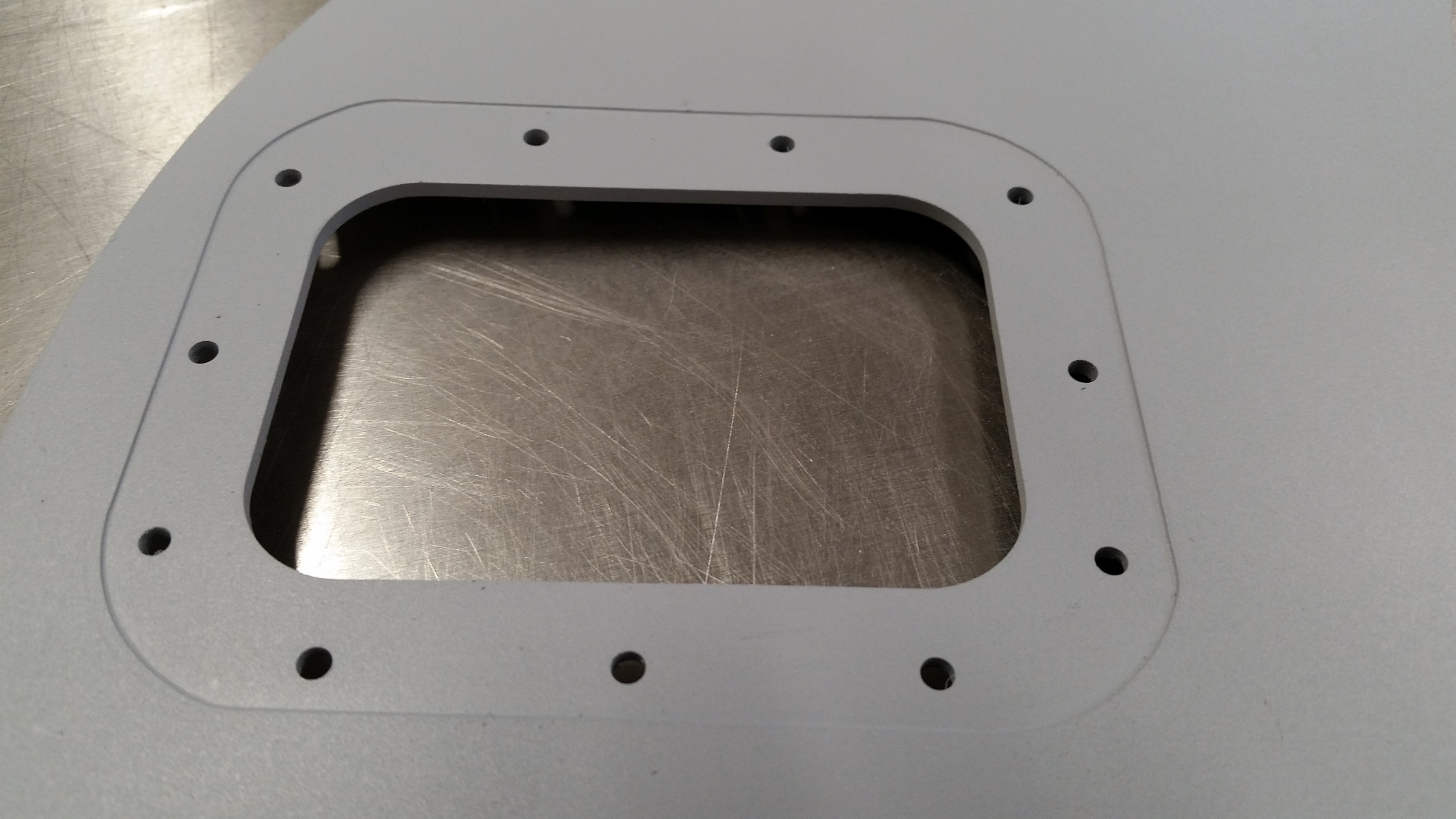

Cut shallow recess surrounding loaders hatch and started work on hatch and vent
mark j. radick
Posts: 214
Has liked: 394 times
Been liked: 538 times
Re: Tiger build
Post by mark j. radick »

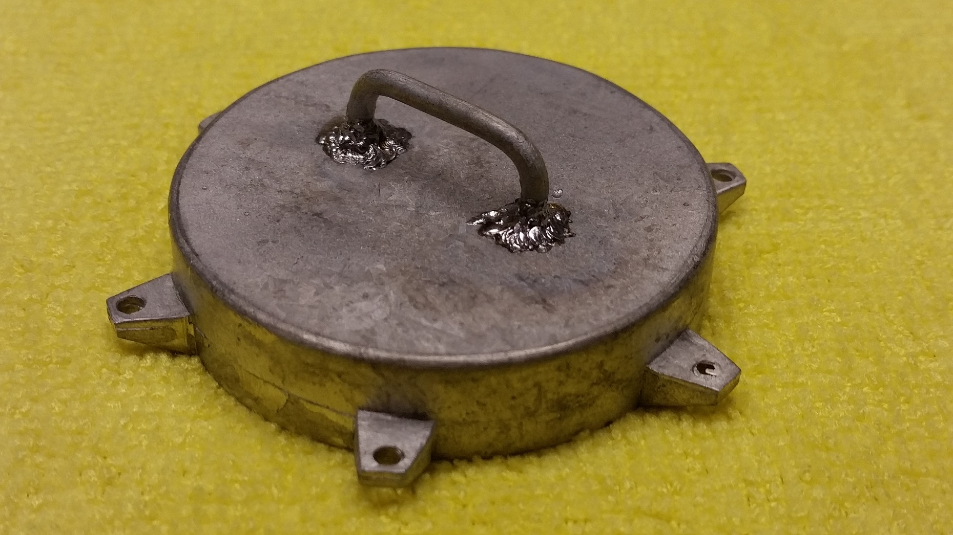

Adhering the handle to the vent did not appeal to me as there is very little surface area....so I soldered it...most "white metals " can be soldered but you need much experience as it is temperature critical and easy to destroy the piece...no need to add simulated weld now :wink:
