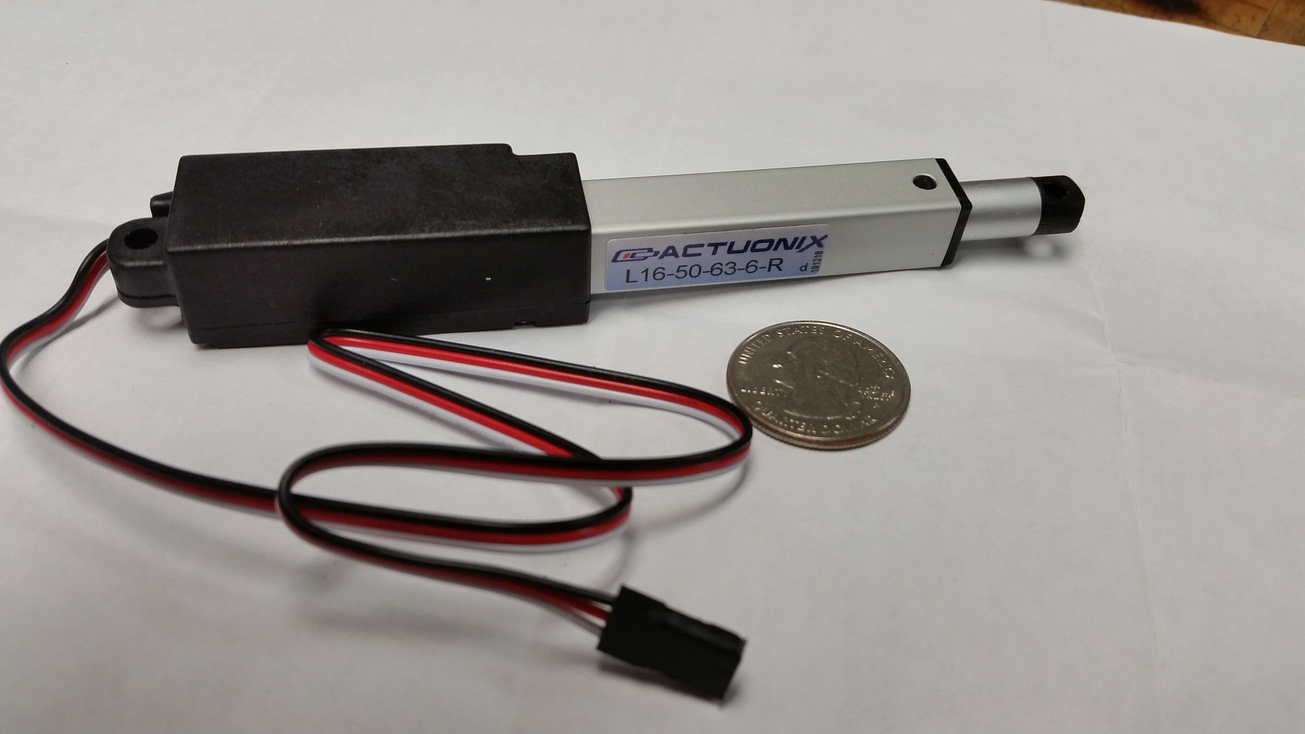

Re: Tiger build
I'm using this linear actuator for barrel elevation... it is very strong...I just don't want to mess around with limiting switches..these are great and plug into the receiver like a typical servo...........
Specifications
Peak power point: 75N @10mm/s
Peak efficiency point: 38N @15mm/s
Max force (lifted): 100N
Back drive force: 46N
Mass: 56g
Positional accuracy: 0.3mm
Max side load (extended): 40N
Feedback potentiometer: 9kΩ±30%
Input voltage: 5-7.4V
Stall current: 650mA
Specifications
Mass: 56g

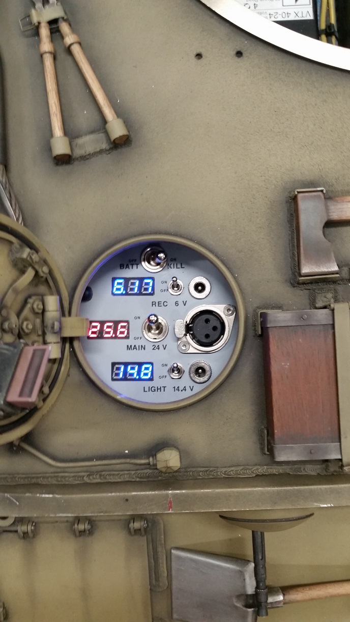

Now you don't.....
i would have liked to place the switch panel under one of the rear hinged grates but removing the Feifel filter ducting would of been a hassle...so I mounted the switch panel under the machine gunners hatch but I made it so it could swivel out of the way, this way I could place a figure there if I desired and no interference with periscope..

Re: Tiger build
Fantastic build there Mark - beautiful bit of engineering. One question - is there any particular reason you are using a separate battery for the radio equipment, rather than a simple battery elimination device?

Re: Tiger build
Hi Mark
I like you idea having the control panel swing out of sight. If you don’t mind I may try a similar set up when I get round to my Tiger.

Re: Tiger build
Go for it Steve ! and post plenty of pics !Steve Norris wrote: ↑Sat Feb 01, 2020 10:52 amHi Mark

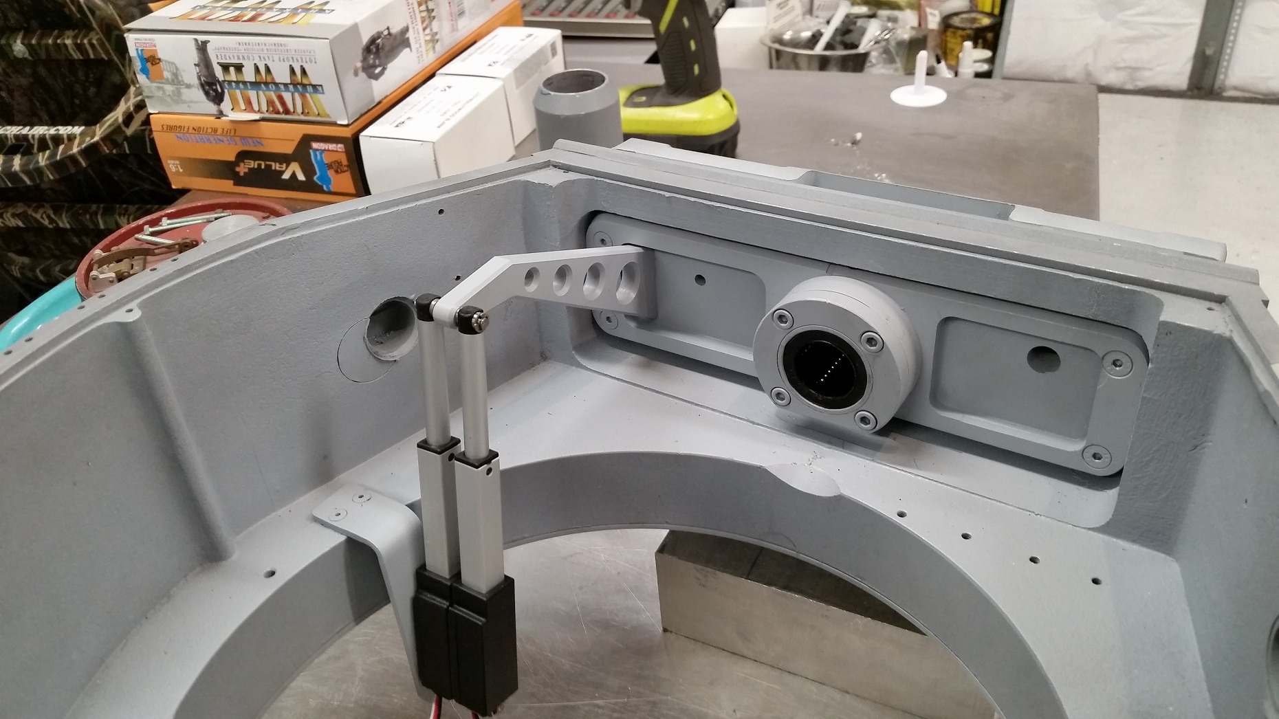

Re: Tiger build
Installed linear actuators and linear bearing. I doubled up on the actuators for extra strength and holding ability...worked great even with a 5 pound weight hung just behind the muzzle break and no counter weight needed...plus having the same control as a standard servo like servo travel and speed...also working on a blank firing system

Re: Tiger build
Really cool additions Mark, following with interest. Those actuators make for simplified mechanism for sure. Will be interested to see your blank fire, recoil ideas.

Re: Tiger build
That looks like a very robust and yet simple system
I would caution against having anything which sits down below the level of the turret, as it makes it a pain if you have to take the turret off "in the field", unless you have some form of frame on which to sit it.
