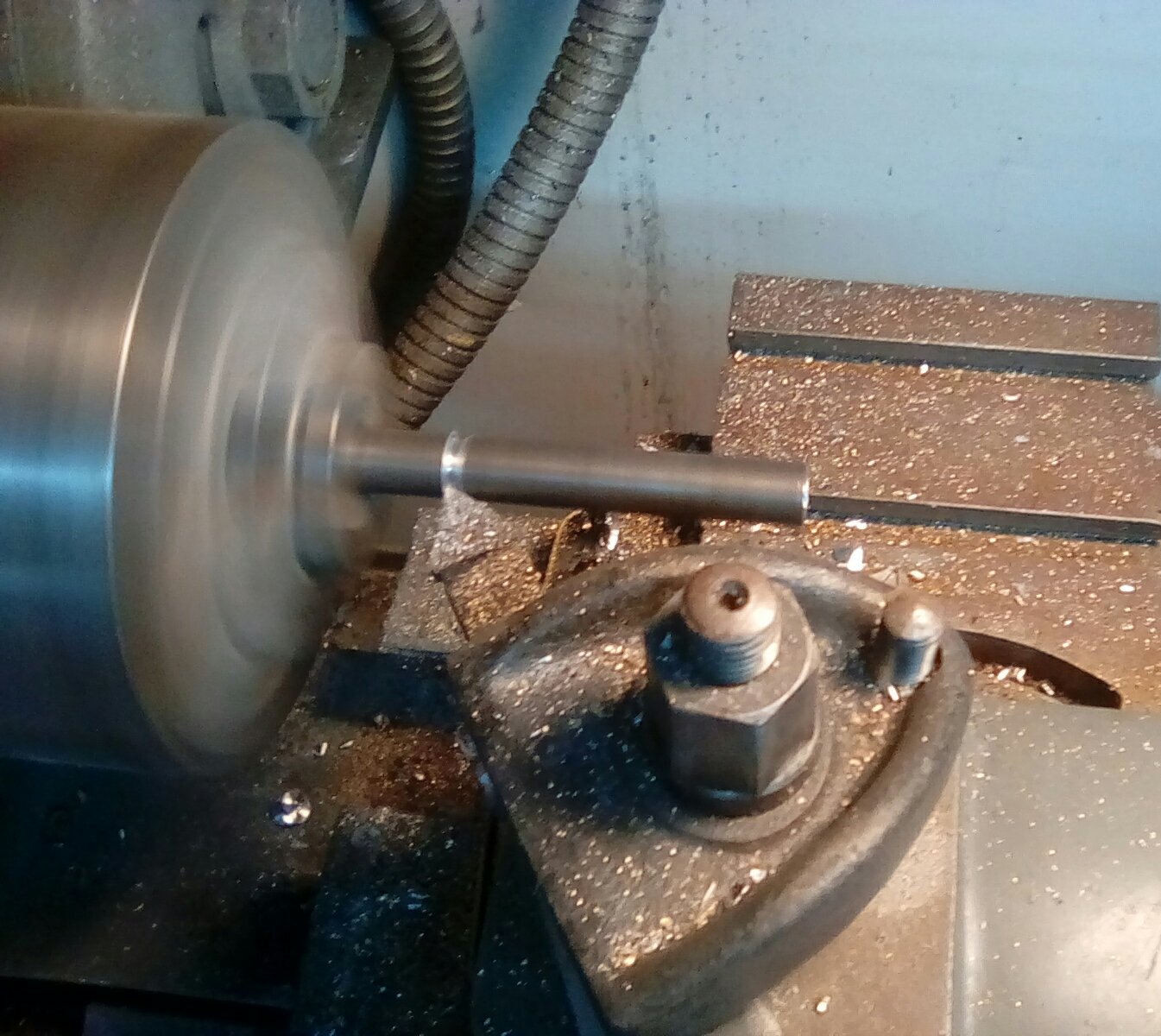

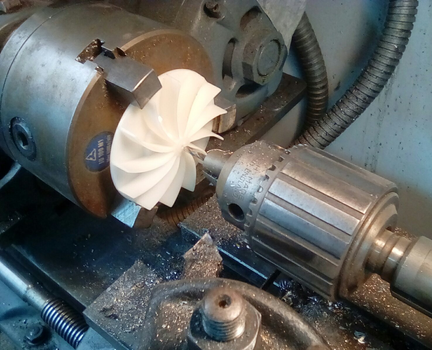

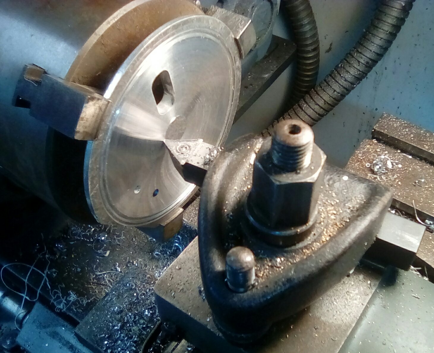

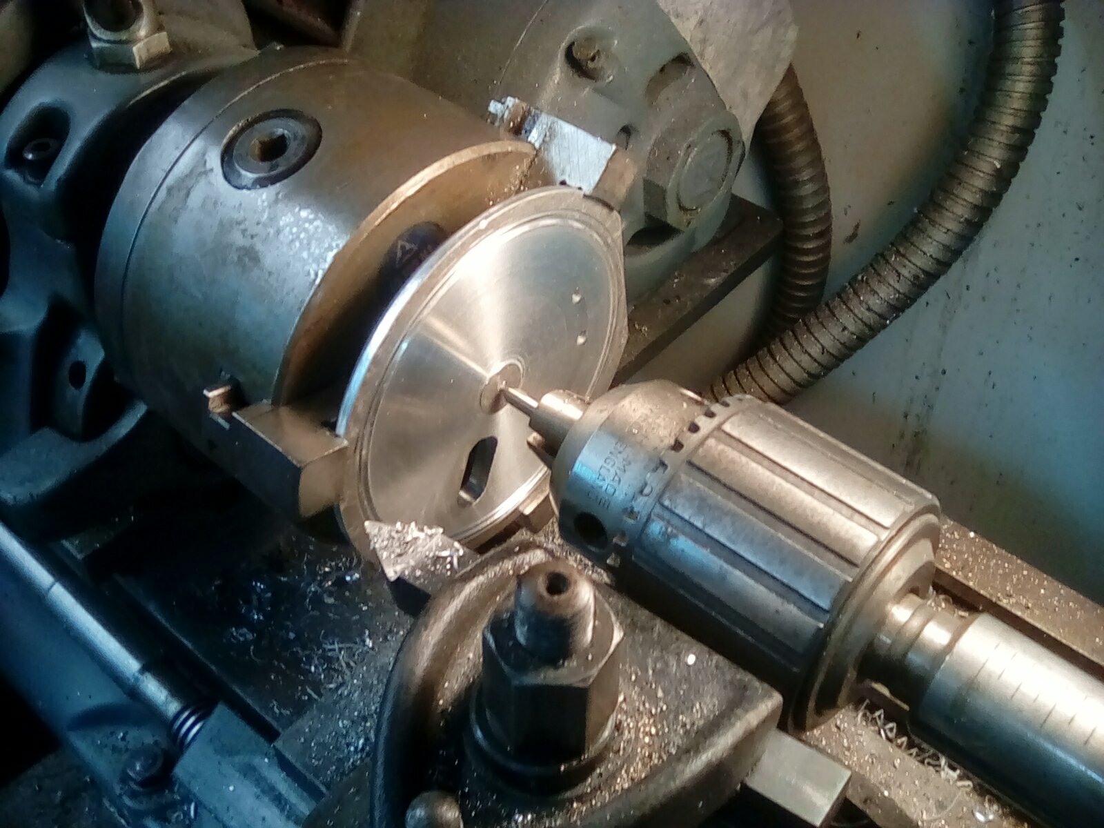

Balancing the smoke fan, first by drilling the mount centrally something the manufacturer just couldn't get right.

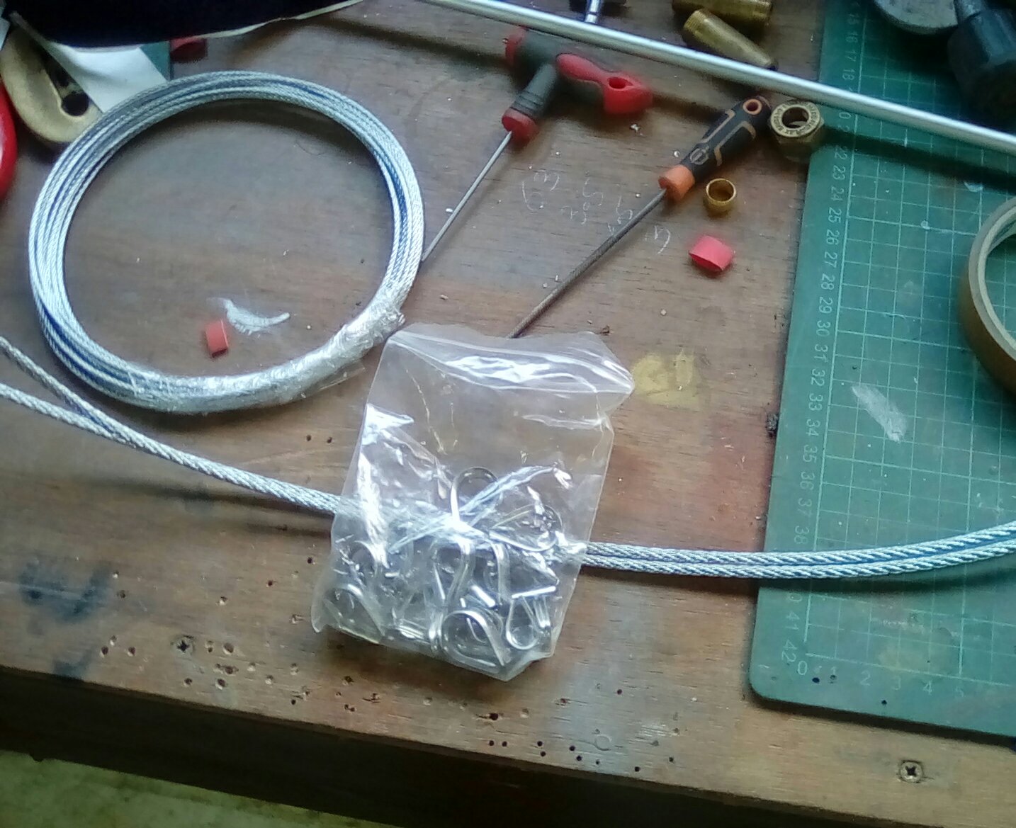

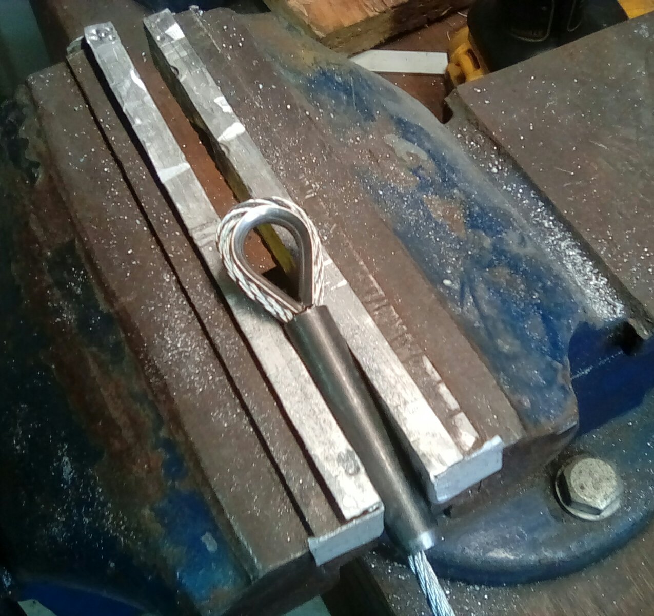

Ive been busy making more correct tow cables, just got the track pulling rope to do.

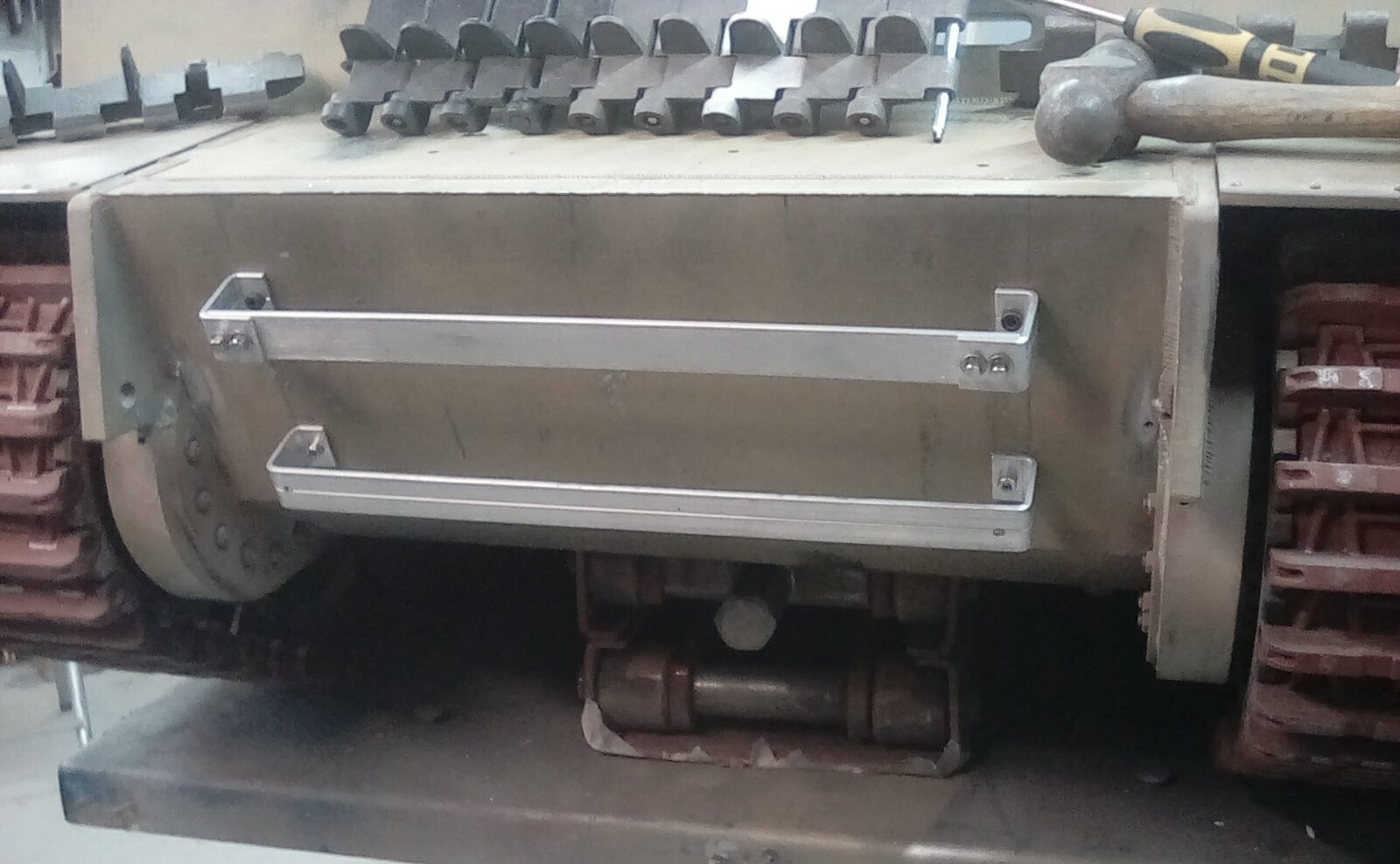

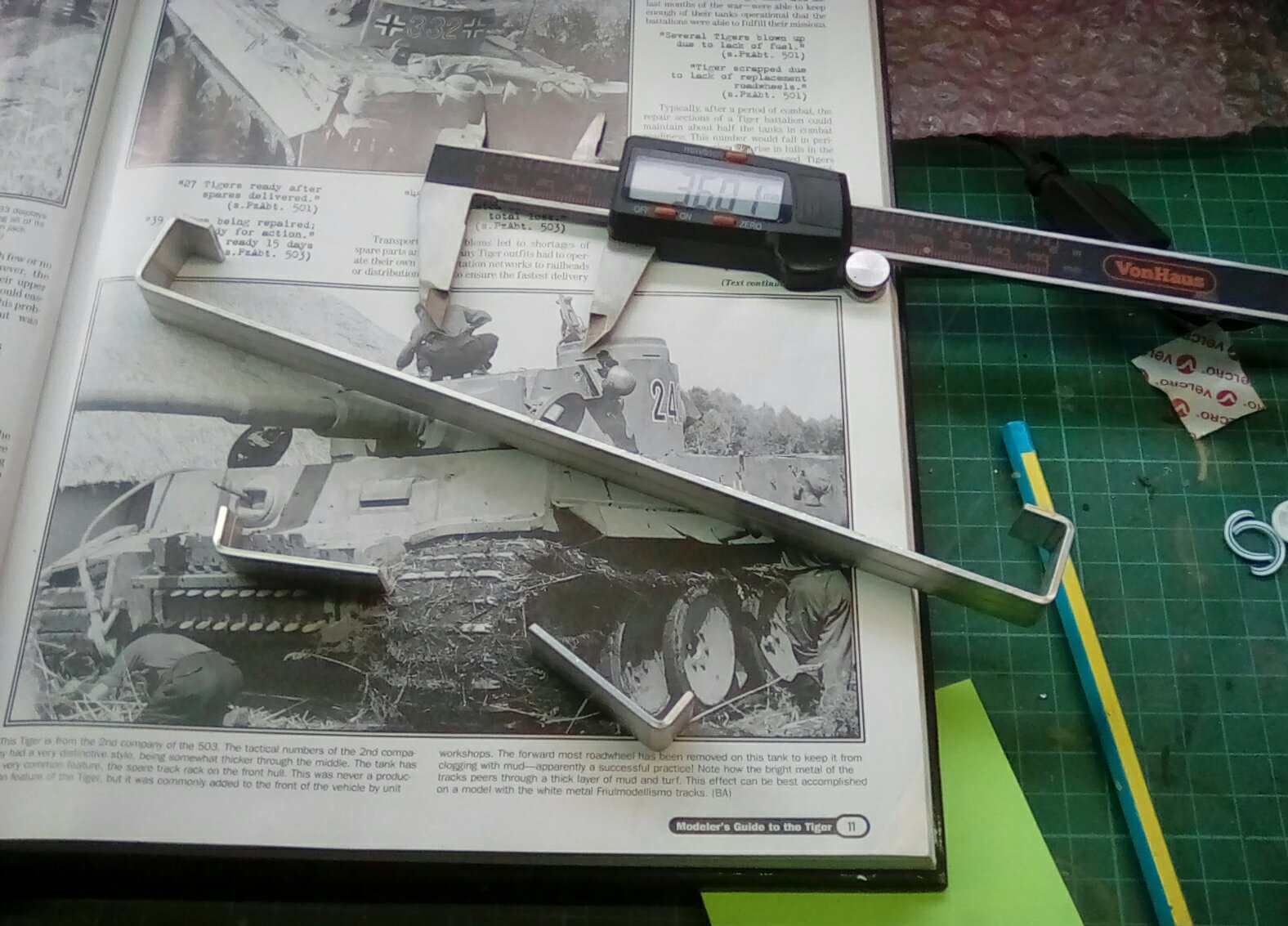

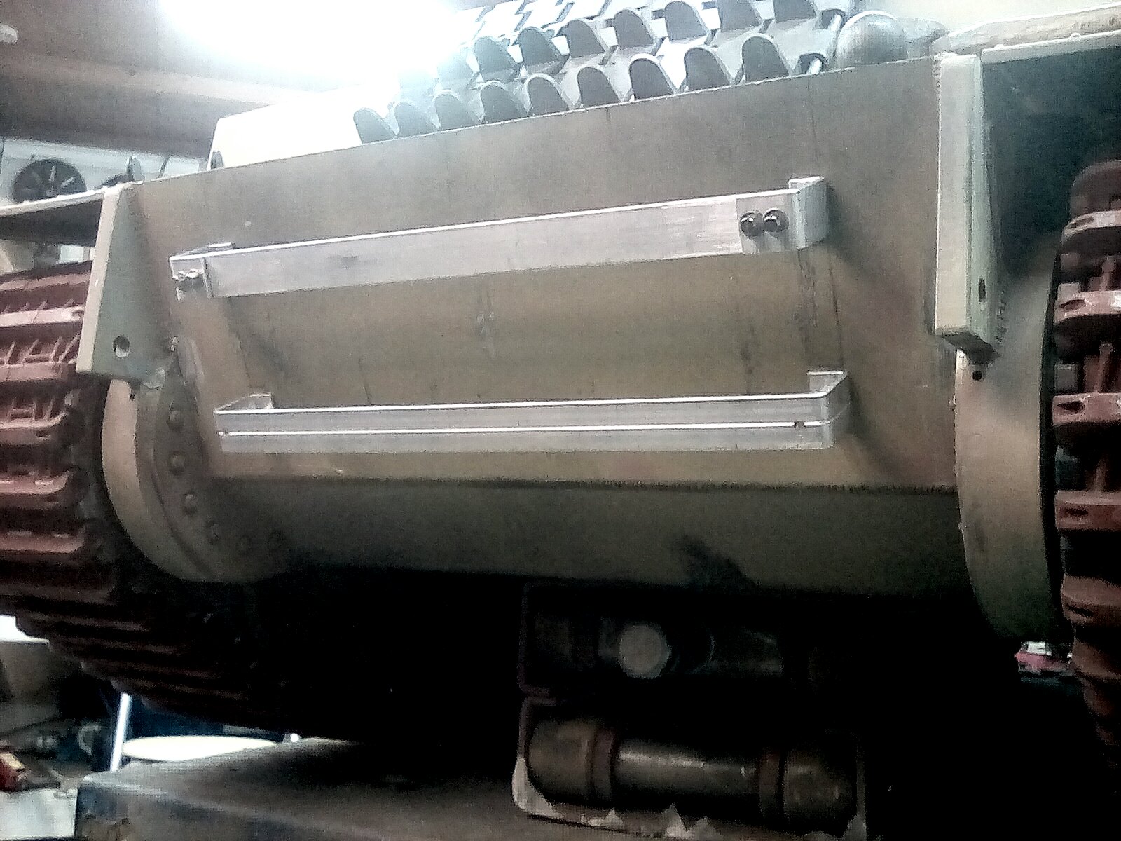

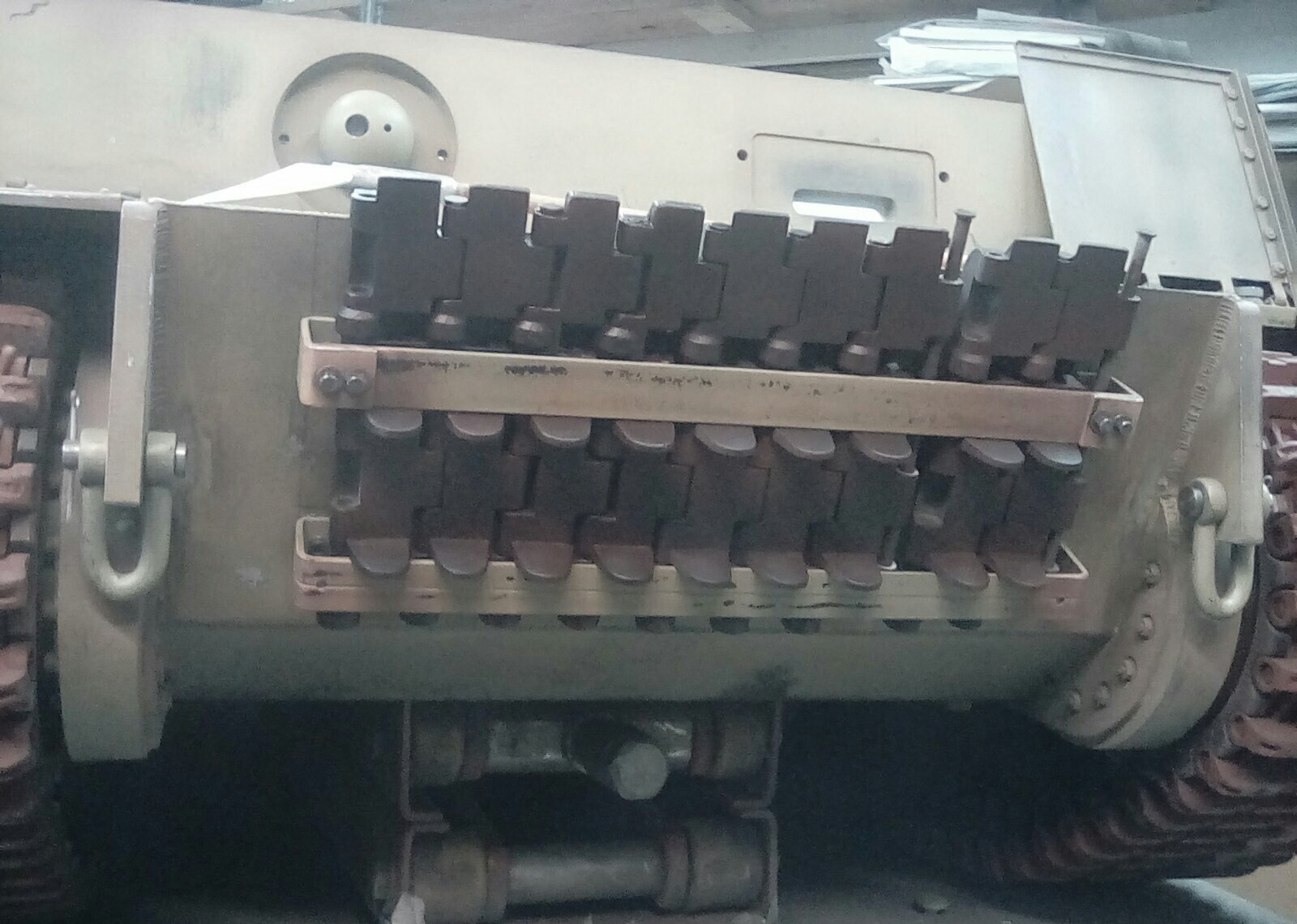

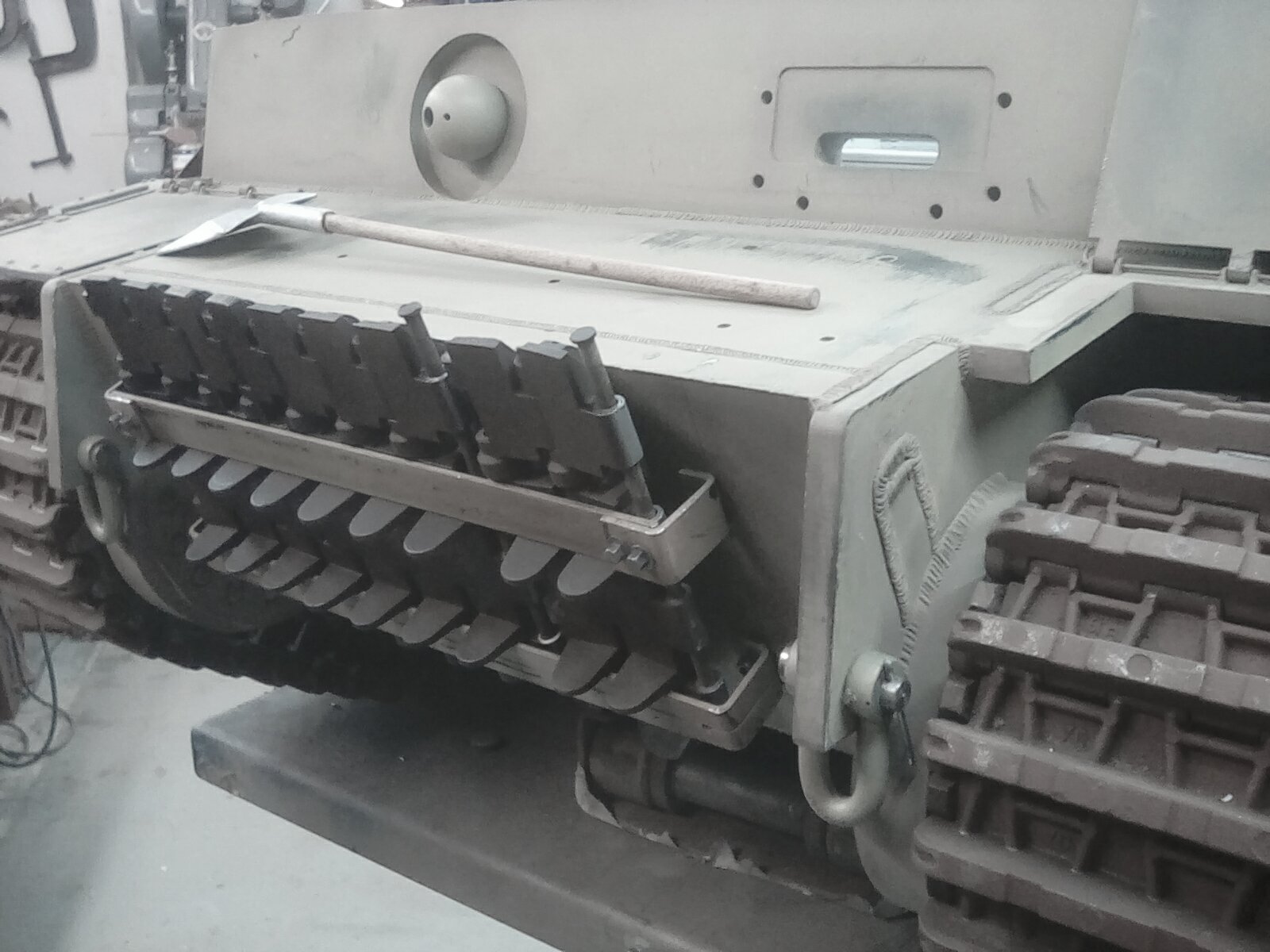

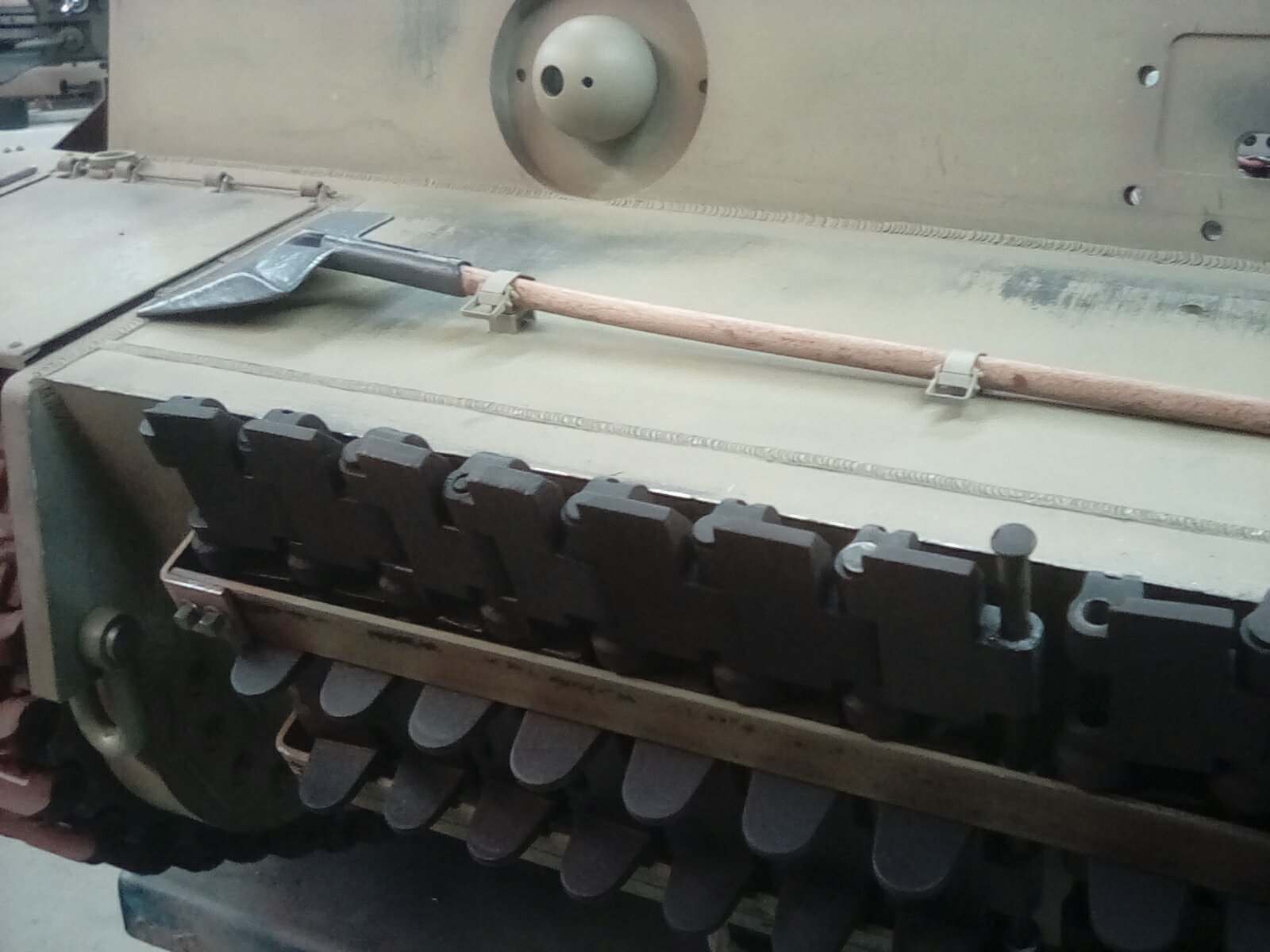

I just had to manufacture the early track hanger that the 503 used, the only compromise is the way I have had to fix the hangers to the front plate.
So the top section unbolts, you slide the track in and bolt it back up. The track cannot fall out as the horns are below the horizontal top piece.
More photos to follow.

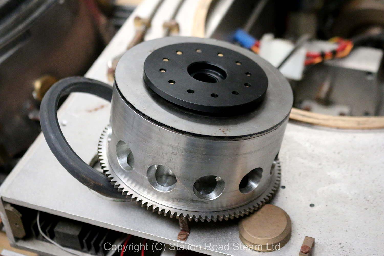

The last line is not strictly true, there was one other firer built by Winson/Modelworks. It to my knowledge was rarely used due to being rather expensive to discharge. :shock:
Fully loaded it would have cost £40 or there about's, (12x electrically fired maroons). The literature failed to mention that. :lol: :lol: :lol:
Rattled the factory windows when it was demonstrated to me, when the smoke cleared I thought they'd deafened me.

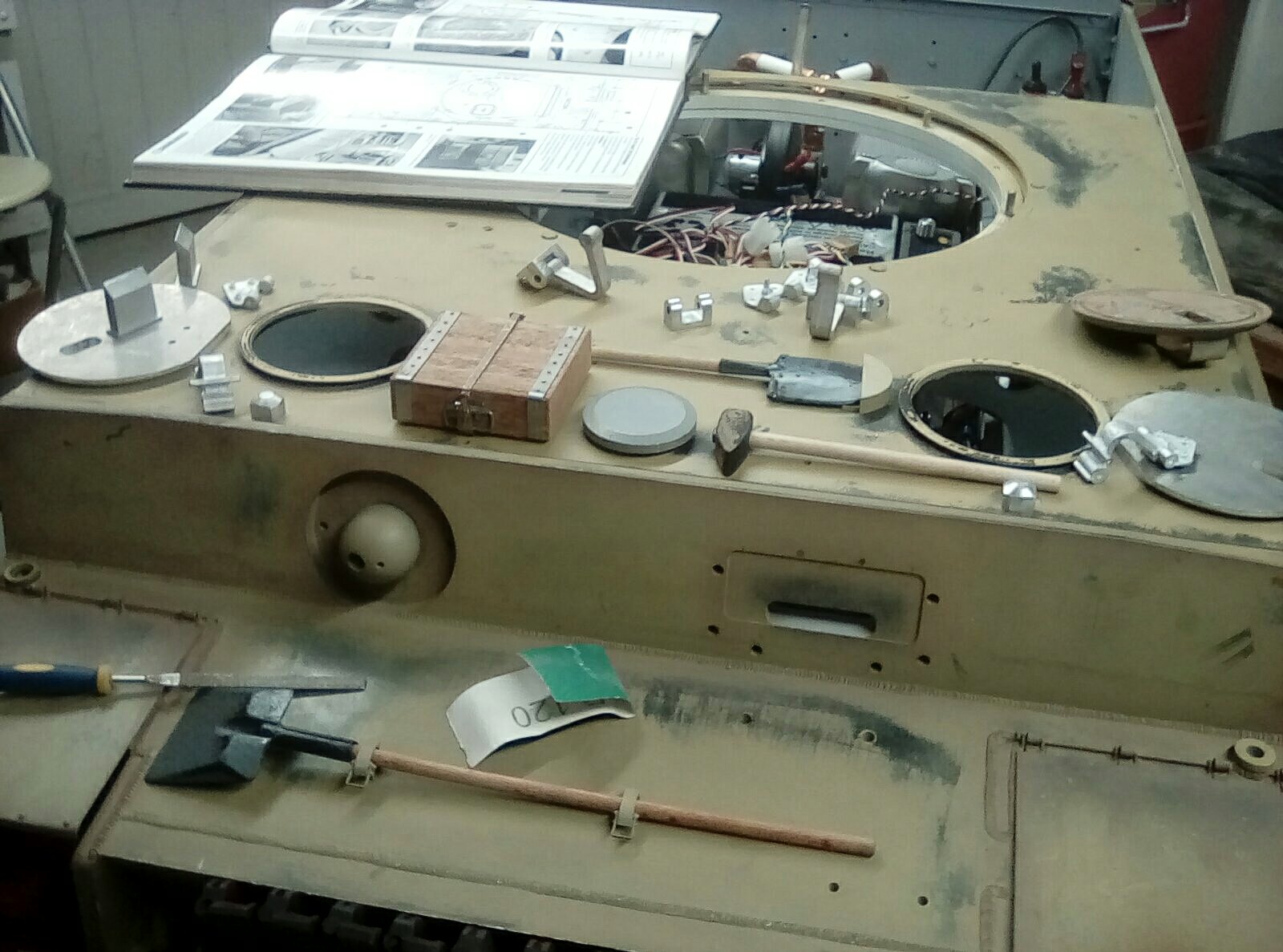

Some more progress on 331.
Debrightening the reduced head fixings by simply heating each one to "cherry red".

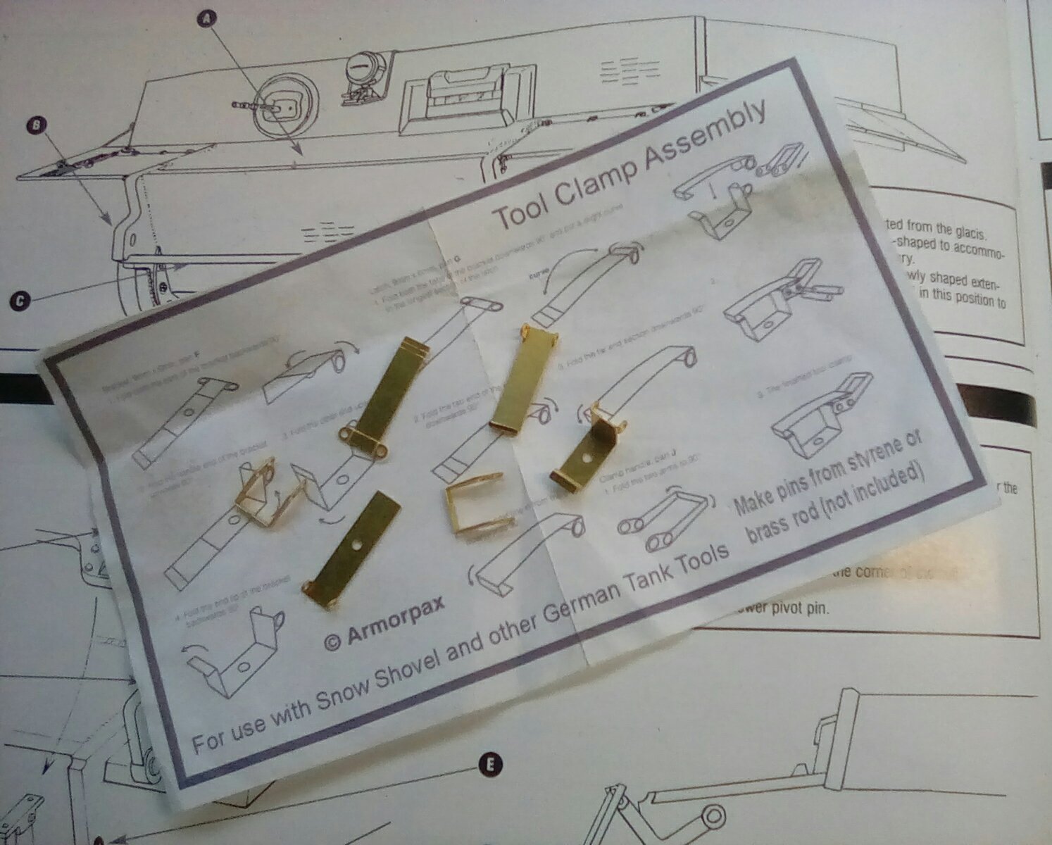

Dave s wonderful tool clamps.
Imagine how good this will look with Liams steel track links!

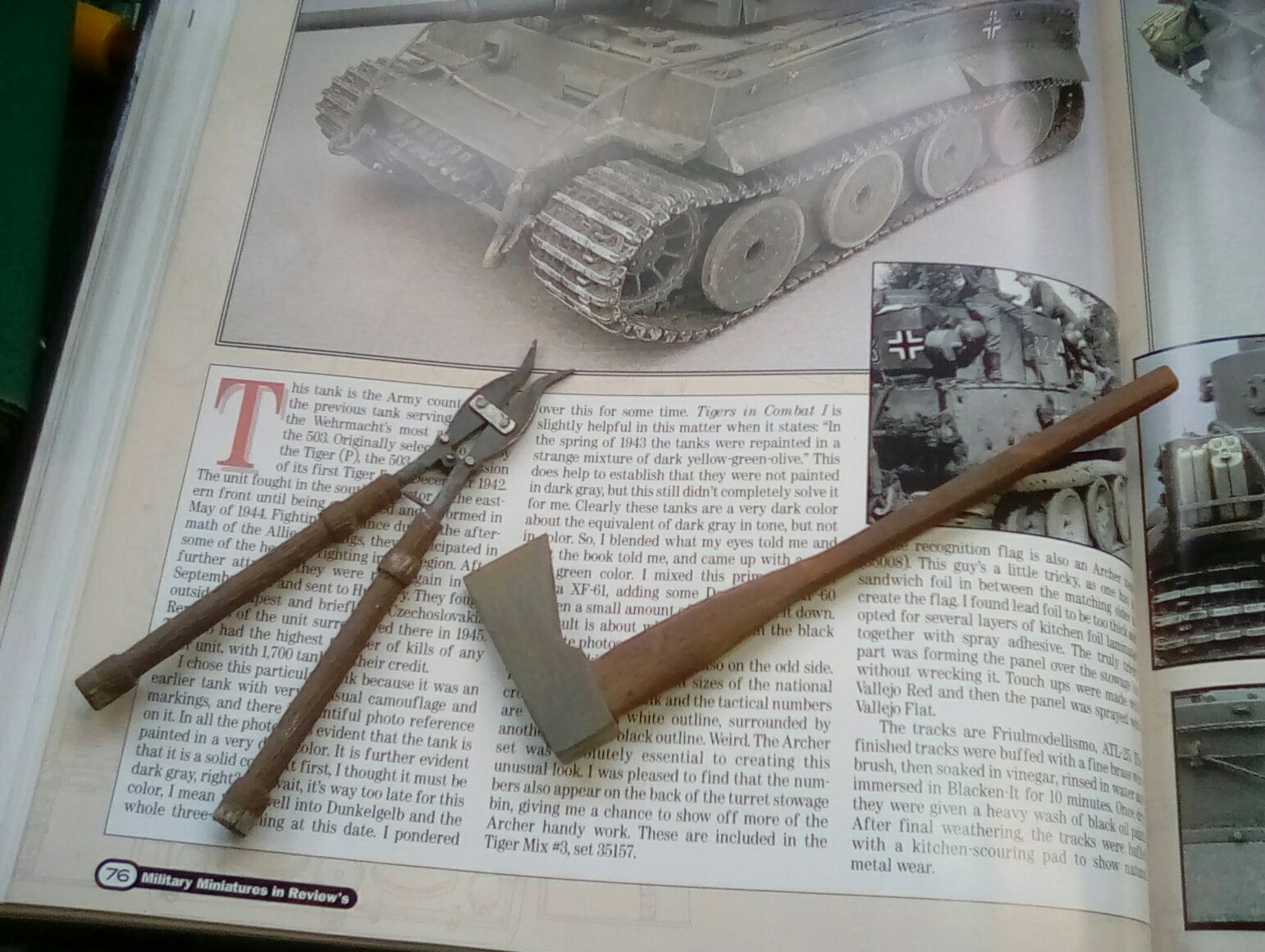

I'm making the tool handles from ash and beech.

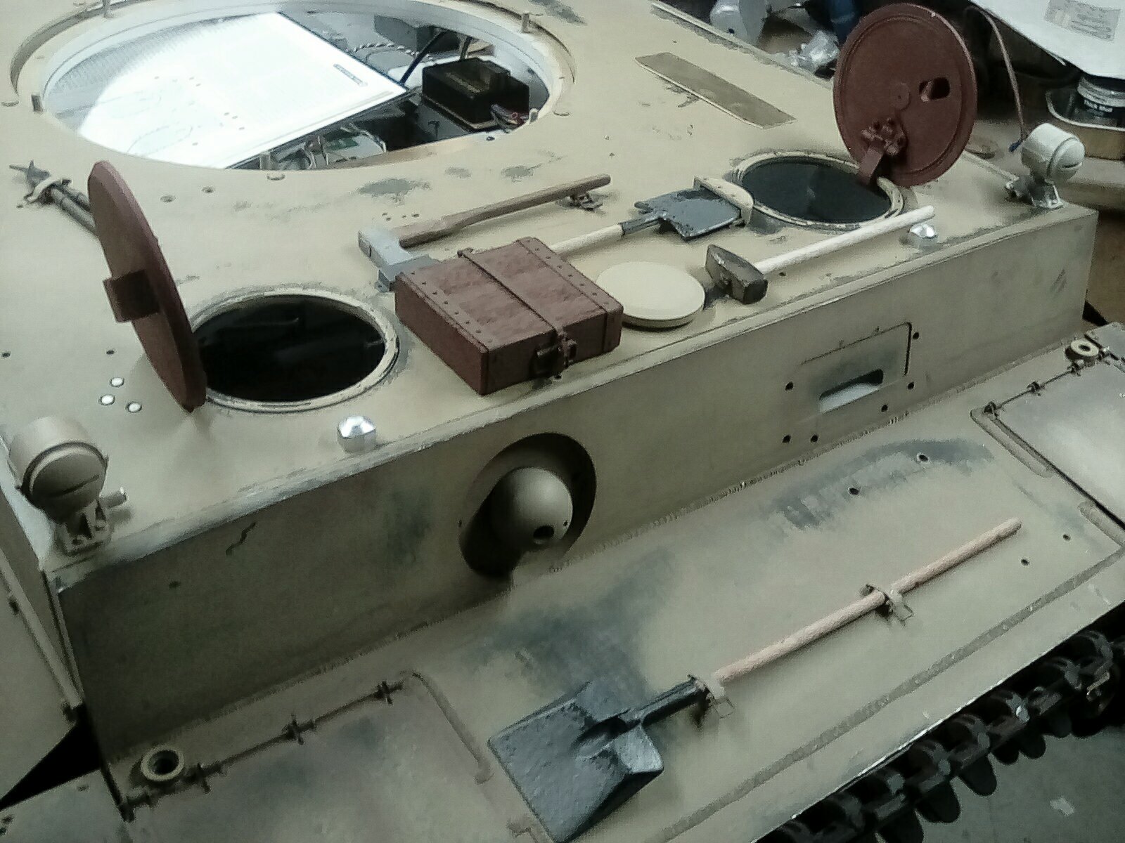

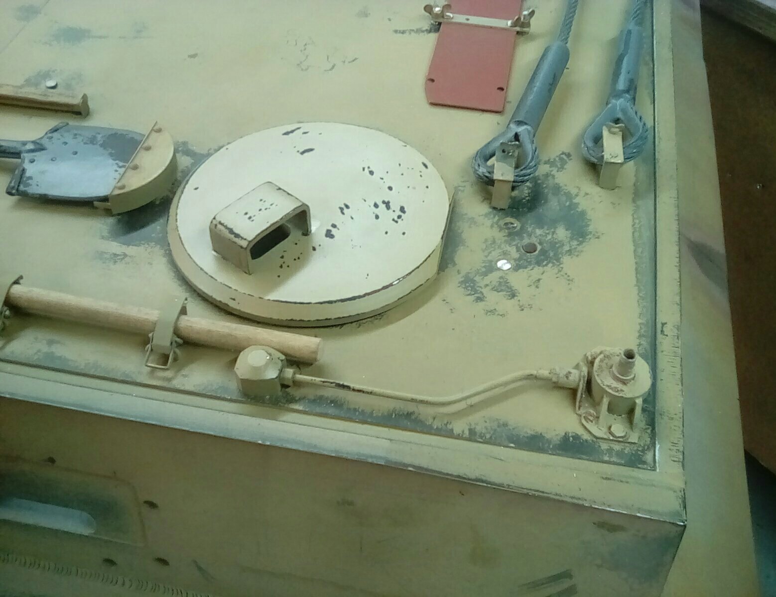

Lots done. 8)

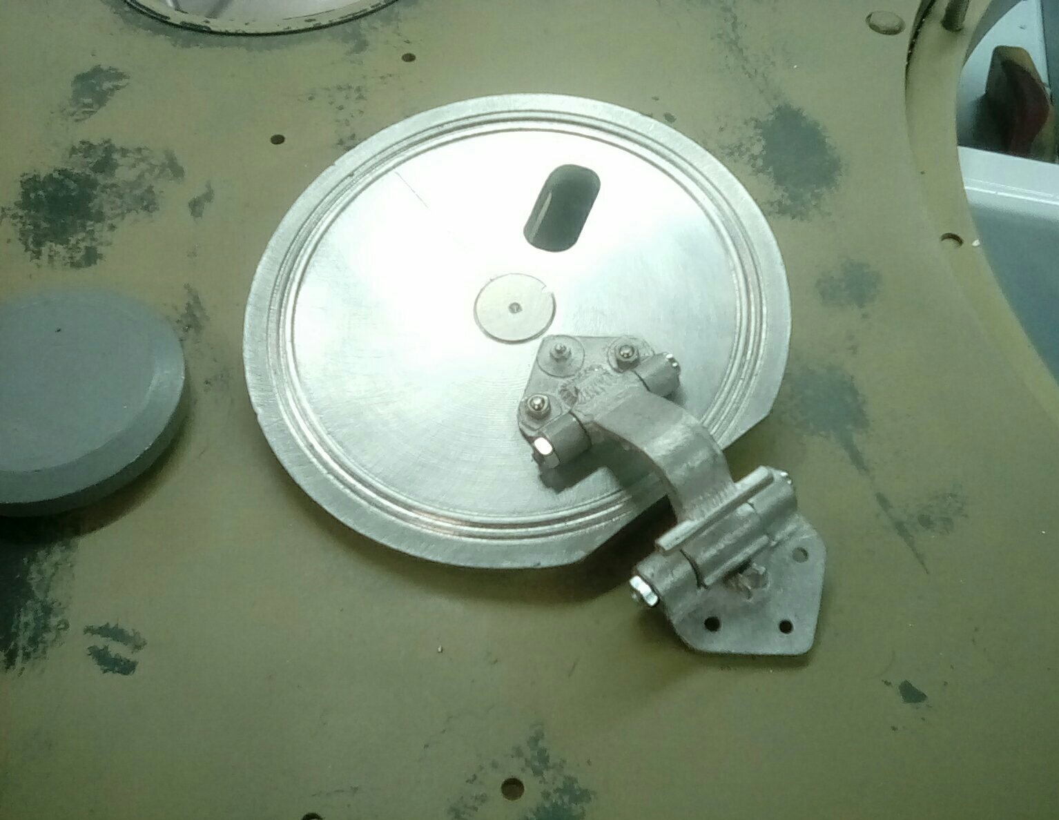

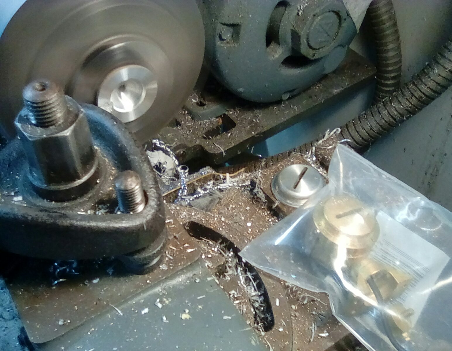

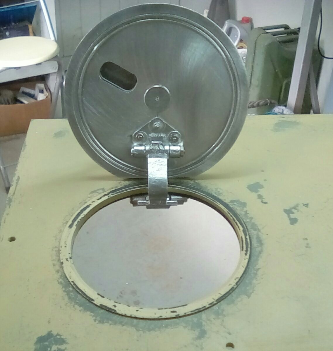

Turning the detail into the stock hatches.
I'm using Armorpax detailing parts , I just don't have all of them yet.
Setting it all out as I go.

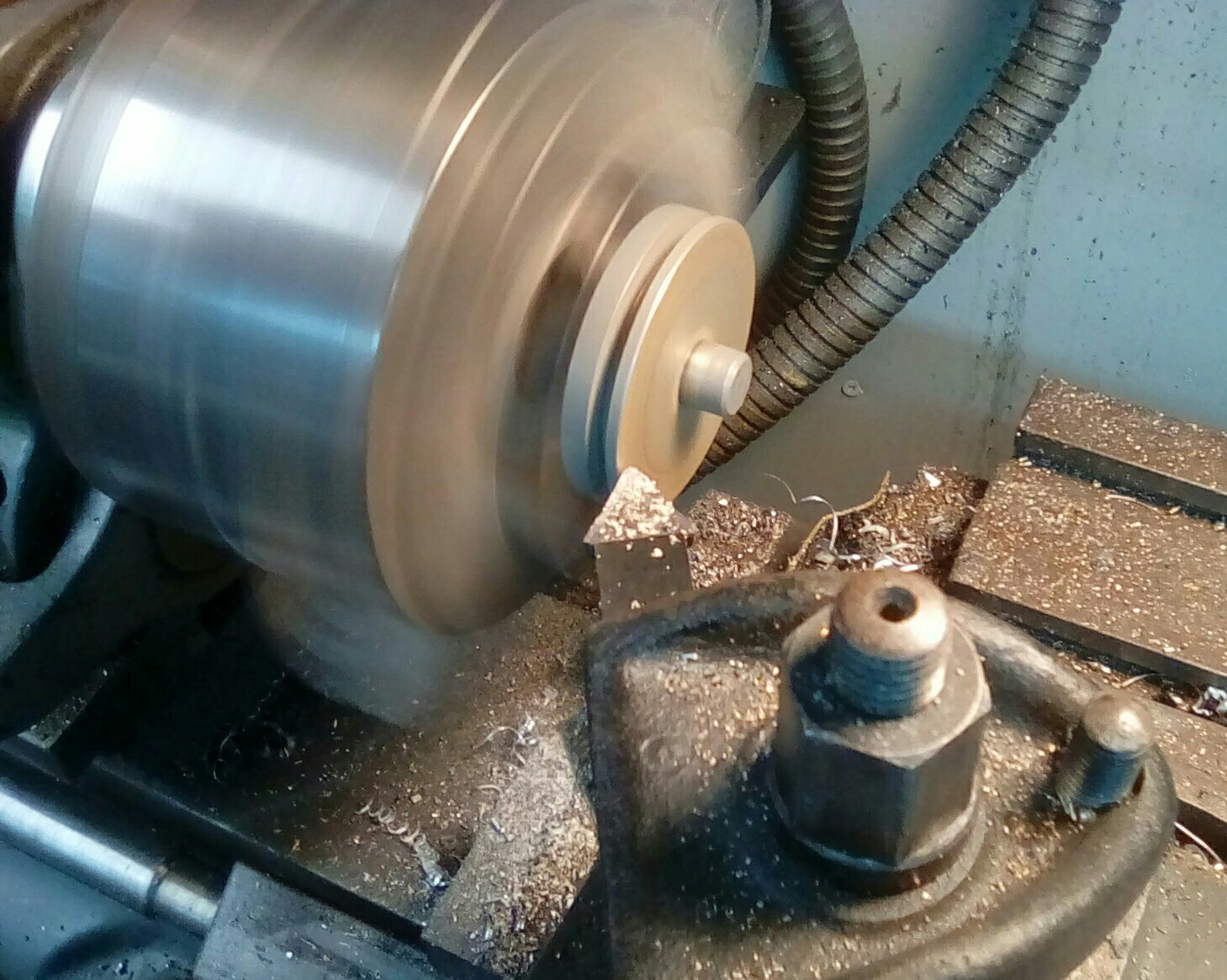

Turning down the front compartment deck vent.

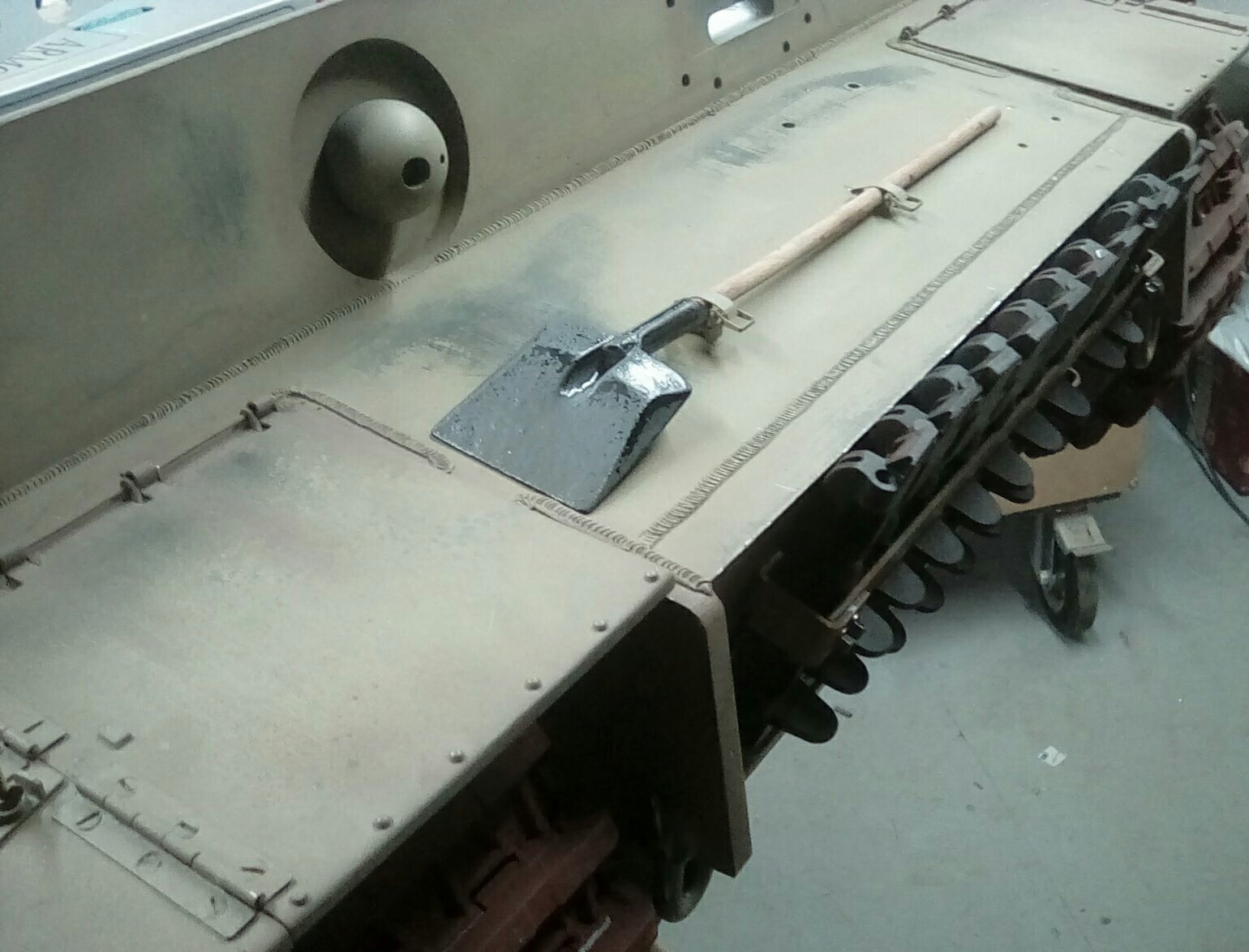

Sorting the tools.
Sorting the tools.

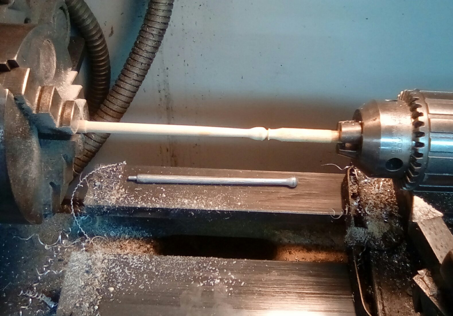

Making those tool handles, this one is for the deck shovel/spade.
The stacks finished and the rain guards working nicely.

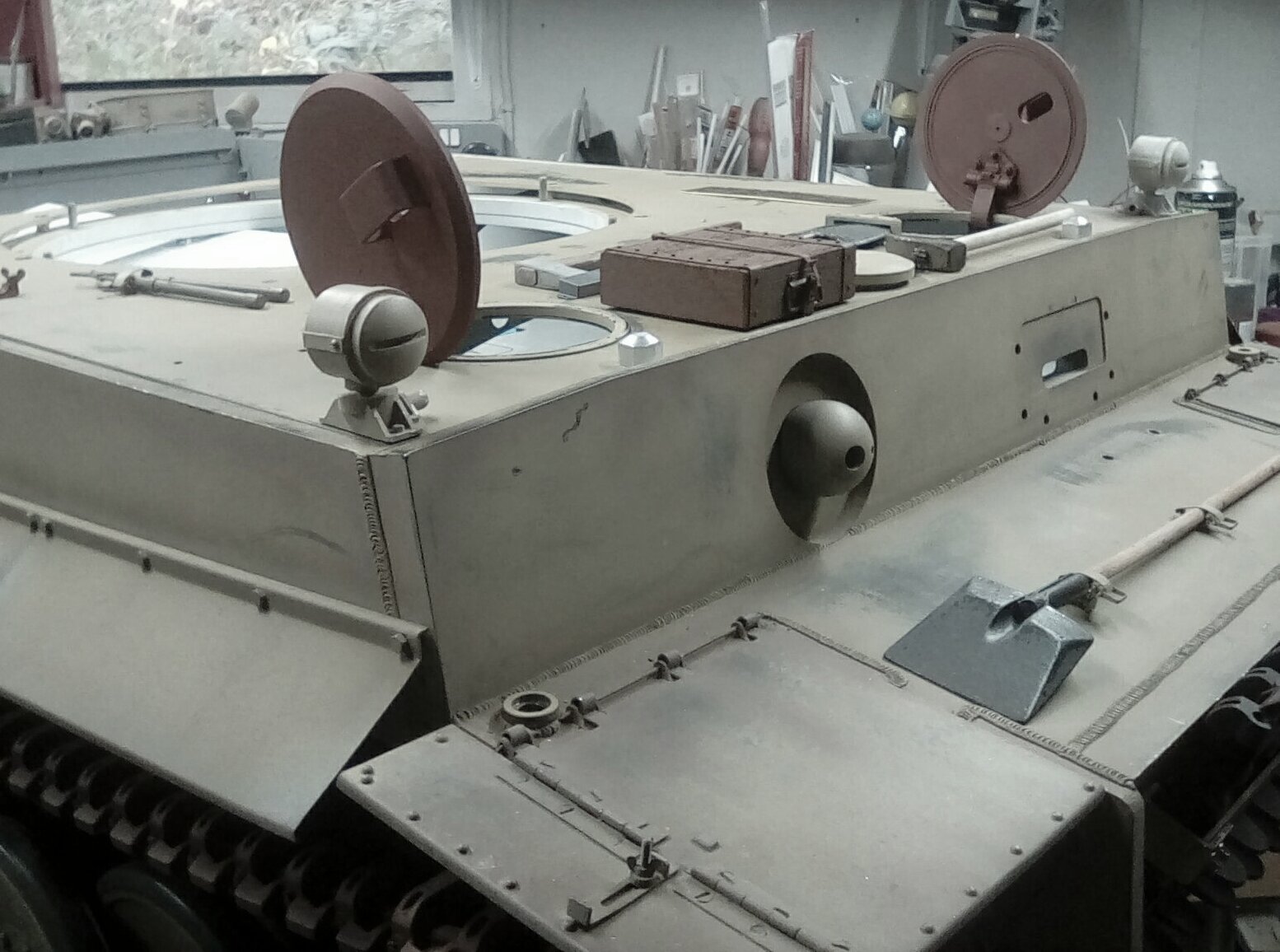

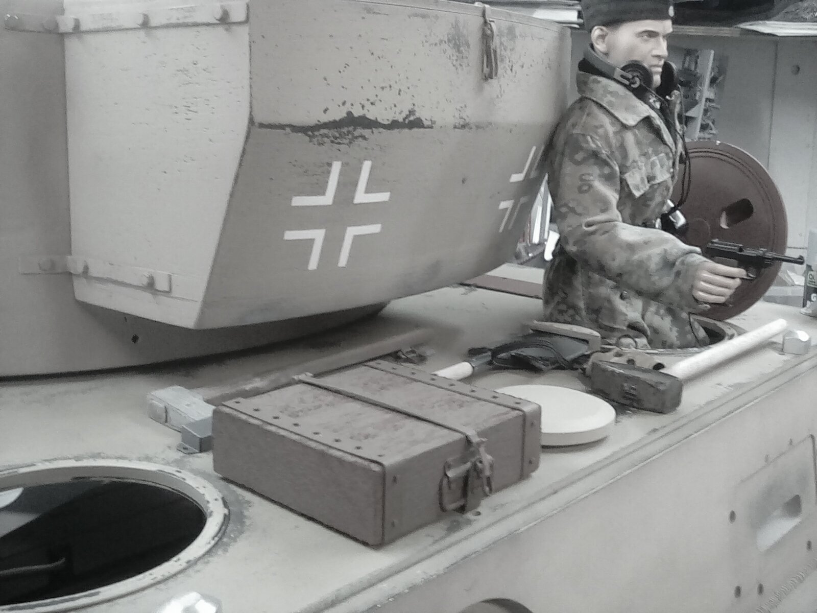

Adding the front deck details, I'm enjoying this build very much it's a good time of the year to be in a cosy workshop. 8)

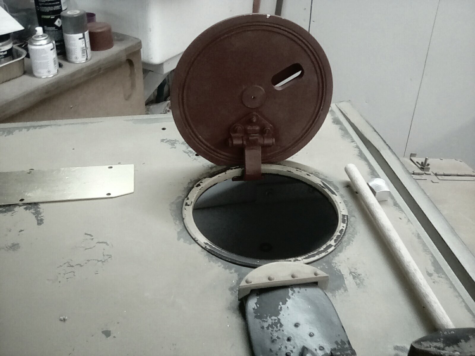

The stock hatch looks just fine with Daves parts, I'm ordering the rest of the hatch details from Armorpax right now.
The stock hatches do open and sit nicely on the deck.
It's getting busy on that front deck.

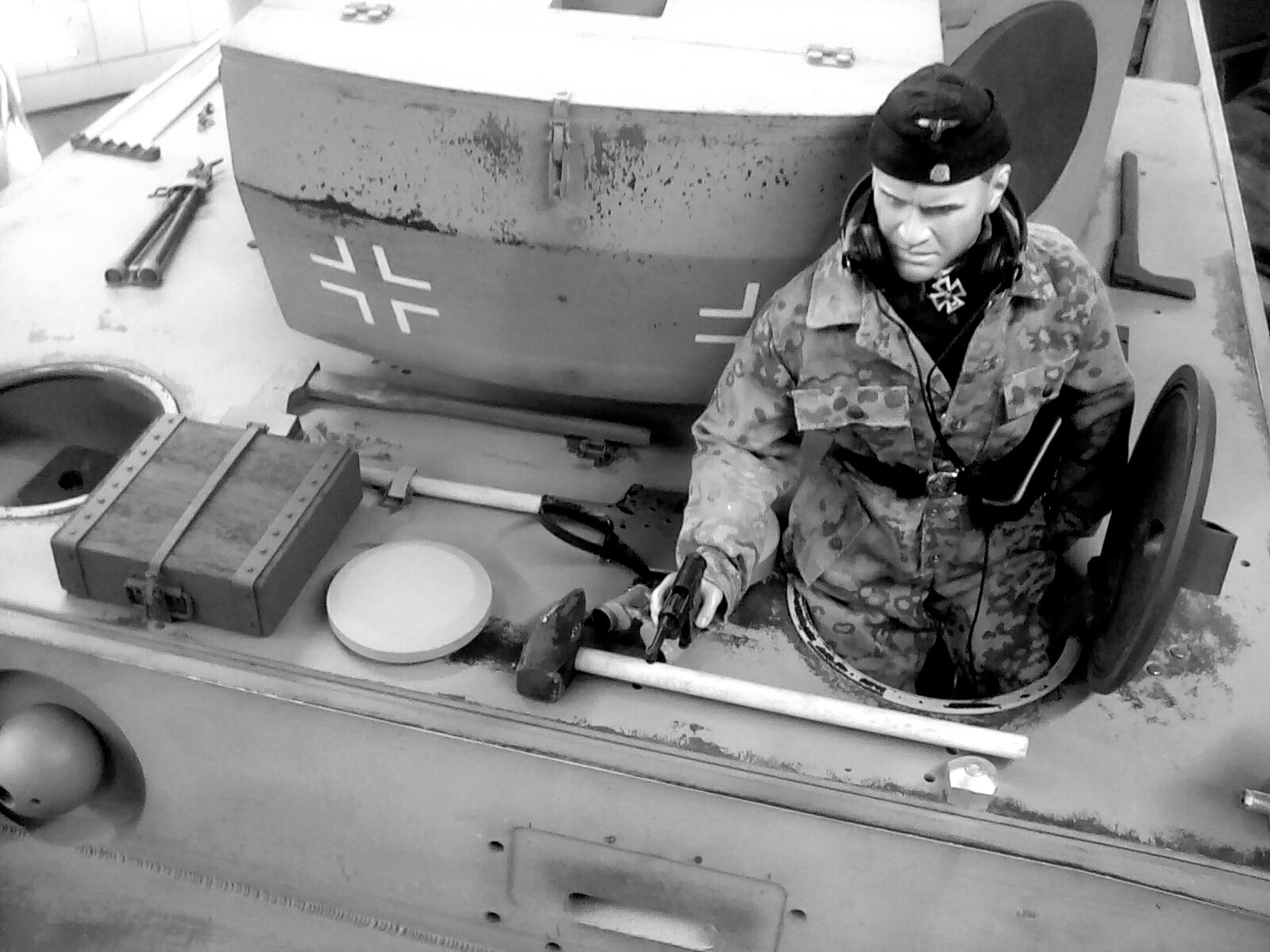

You may wonder why I bother taking these little diorama's photos, well they do help me with the build, colour checking, detail considerations things like that.

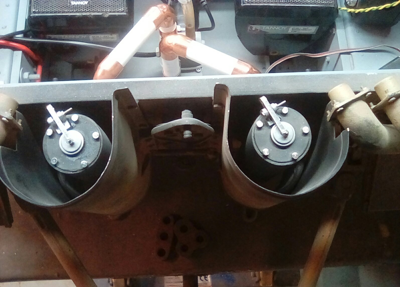

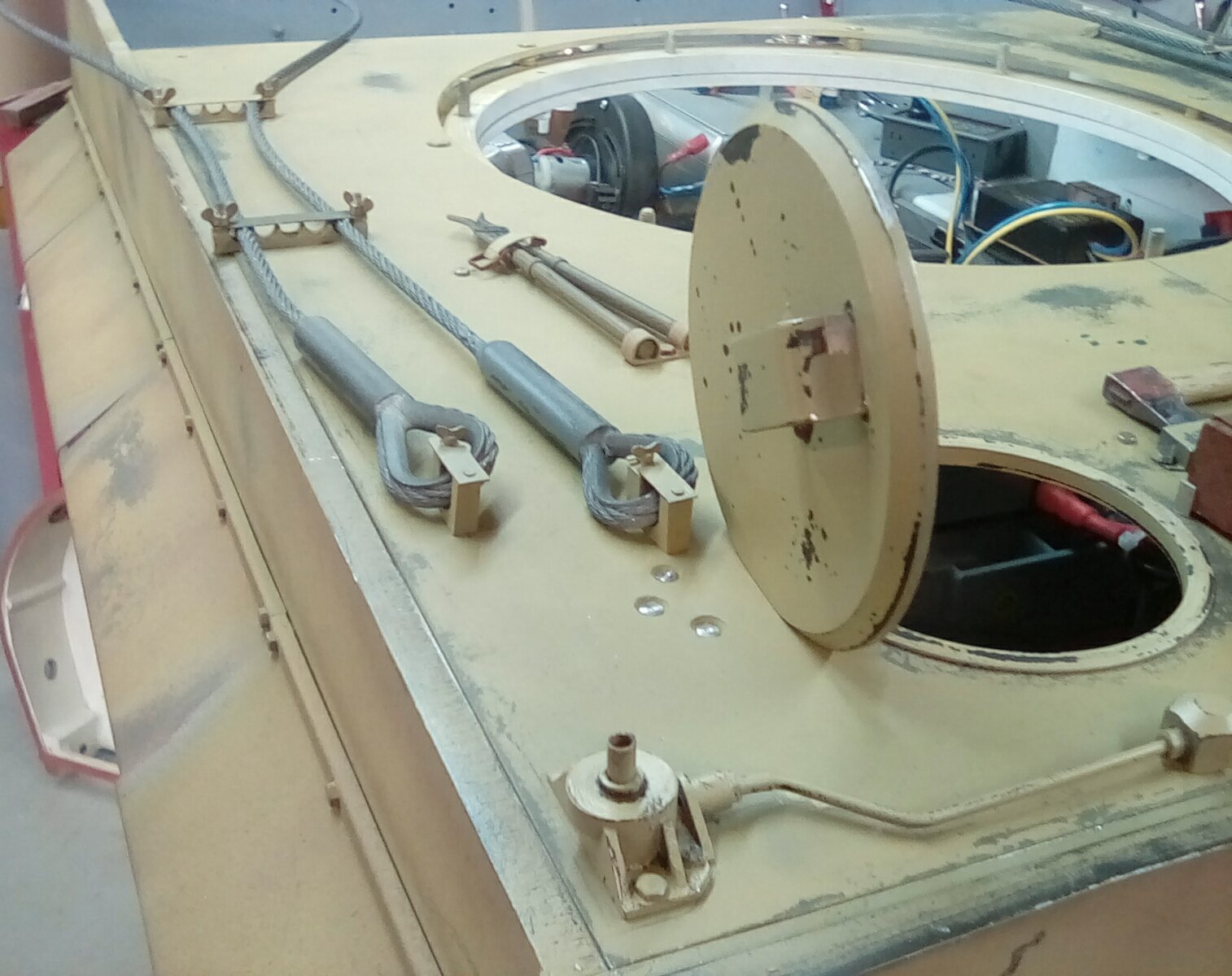

More done to the deck fittings.
I've been using one of Steve's beautiful creations as reference for my take on the head lights. If you cut them down on the lathe they can be put back together more like the expensive examples.

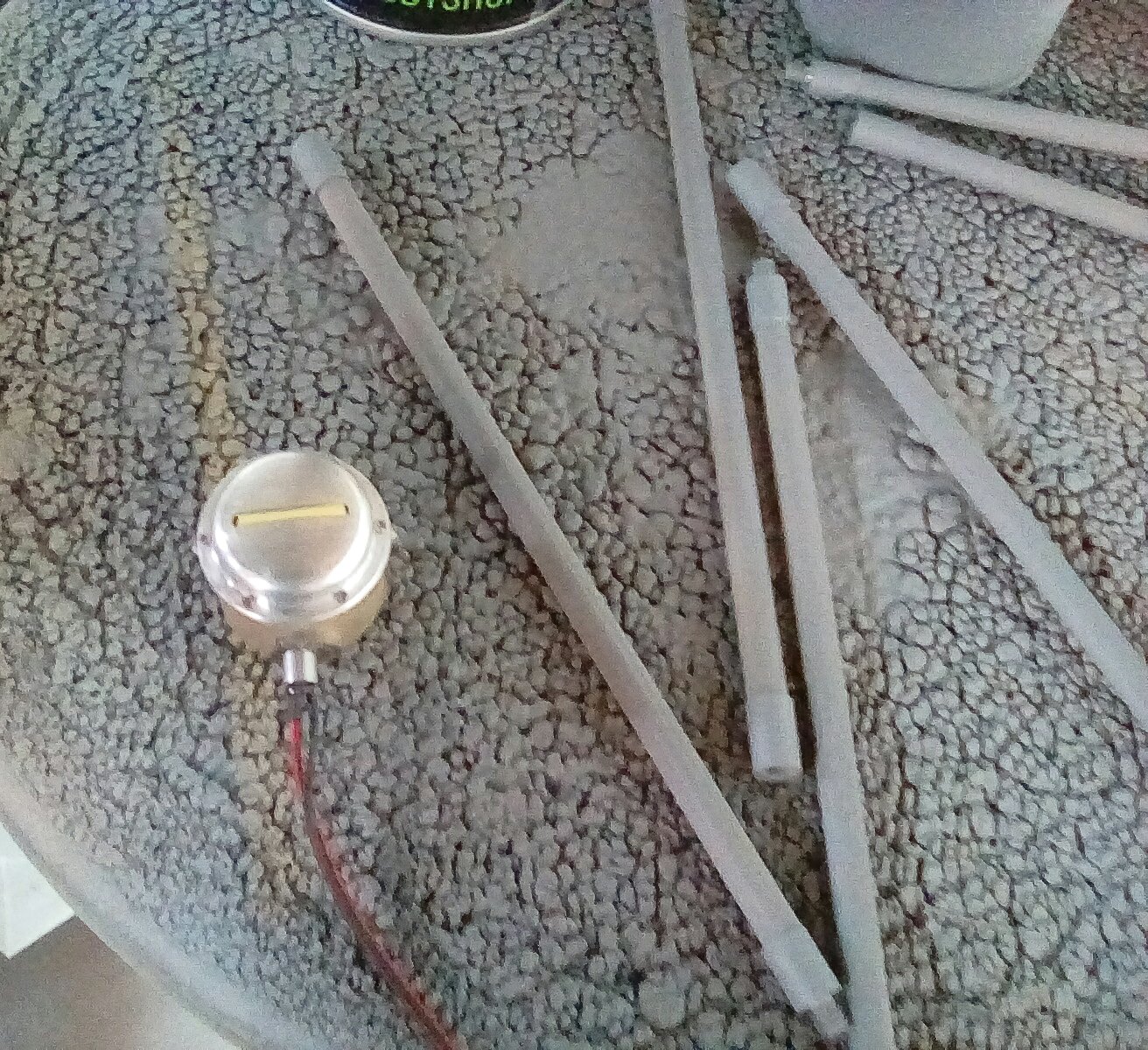

I didn't have the correct long pry bar so I've made one from steel.
The tow cable brackets are bolted in place, brass wing nuts where ever possible.
The head light mounts have been detailed and the conduit made up both sides, I do like the twin head light early look.
Made up the barrel cleaning rods, the kit pack is very good quality. The head lights have been cut in half, a reflective paint to the inside, a simple lense made, a soft white led mounted and fine screws hold the front bezel in place.
