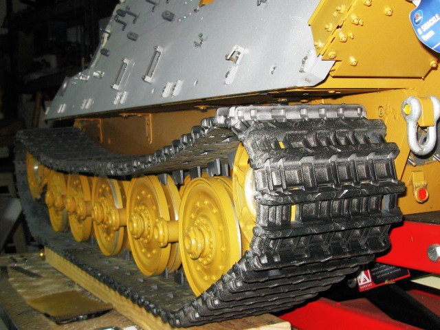

Replace stock's Idler wheel's cranks by Liam Mahoney's upgrade parts received last week.
With stock's part , the idler wheel already touch the rear bottom of sponson.
1-6 JT-106.JPG (210.01 KiB) Viewed 4422 times

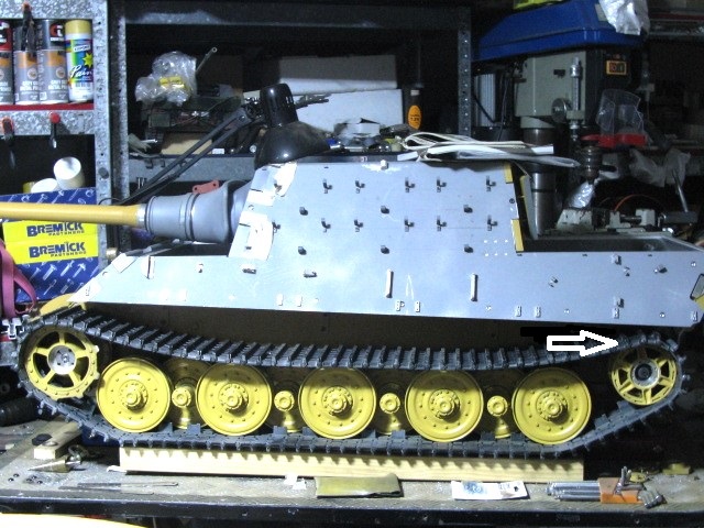

With Liam Mahoney's Idler cranks , the Idler wheel does not touch the rear bottom of the sponson by about 0.8cm.
1-6 JT-122.JPG (137.8 KiB) Viewed 4422 times
Side View.
Side View.
1-6 JT-121.JPG (88.51 KiB) Viewed 4422 times

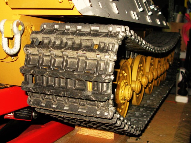

Left hand side view from rear.
1-6 JT-120.JPG (96.52 KiB) Viewed 4422 times
Right hand side view from rear.
1-6 JT-123.JPG (106.13 KiB) Viewed 4422 times

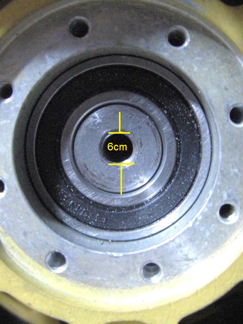

At the end , allow me to remind one thing :
The hole's diameter of the stock's part is 5mm, locked by M5x12mm countersunk screw;
Liam Mahoney's part is 6mm , need locked by M6x12 or 15mm countersunk screw.
Need M6x12mm countersunk screw instead of M5x12mm one.
1-6 JT-124-2.JPG (108.53 KiB) Viewed 4422 times

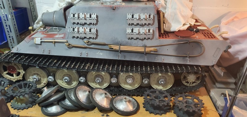

I didn't realize the idler wheel can touch the rear bottom of sponson, I'm assuming this is at max adjustment.
A picture of mine
