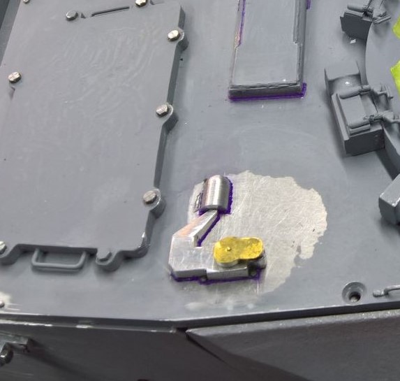

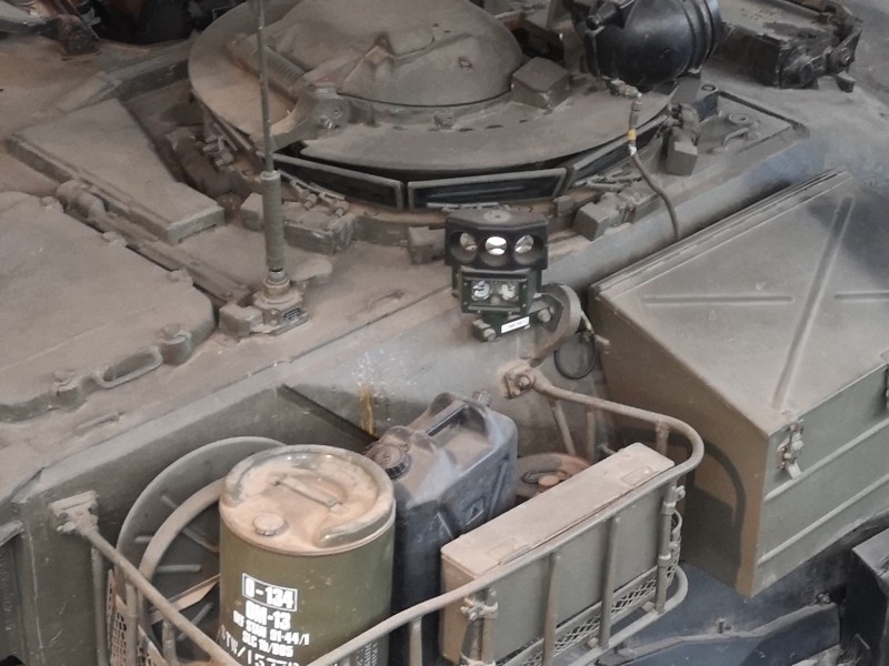

Hi Steve.
Is this any good:-
Trip hazard 1a.jpg (50.17 KiB) Viewed 3038 times
I can supply dimensions if required.
Cheer
Charles

Hi Vincent and Charles.
Thanks for the posts, both are very useful.
There are at least 2 variations of the installation, one as Charles has done and another with the ir detector as per Charles set up but with a longer cable conduit and the armoured shroud further inboard. My plan is to do the second version.
Charles, if you have some dimensions it would be greatly appreciated.

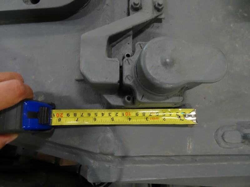

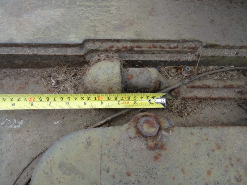

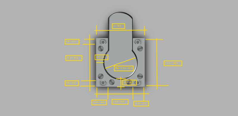

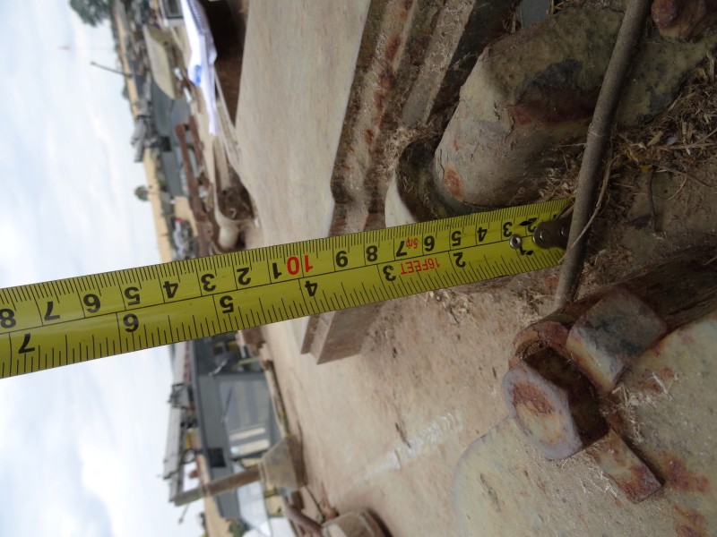

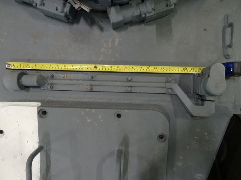

Hi Vince,
I am interested that you are interested : 8)
Do these help ?
Chieftain was designed in imperial, so I find that most measurements only really start to make sense when rounded to the nearest 1/8 of an inch or so.
