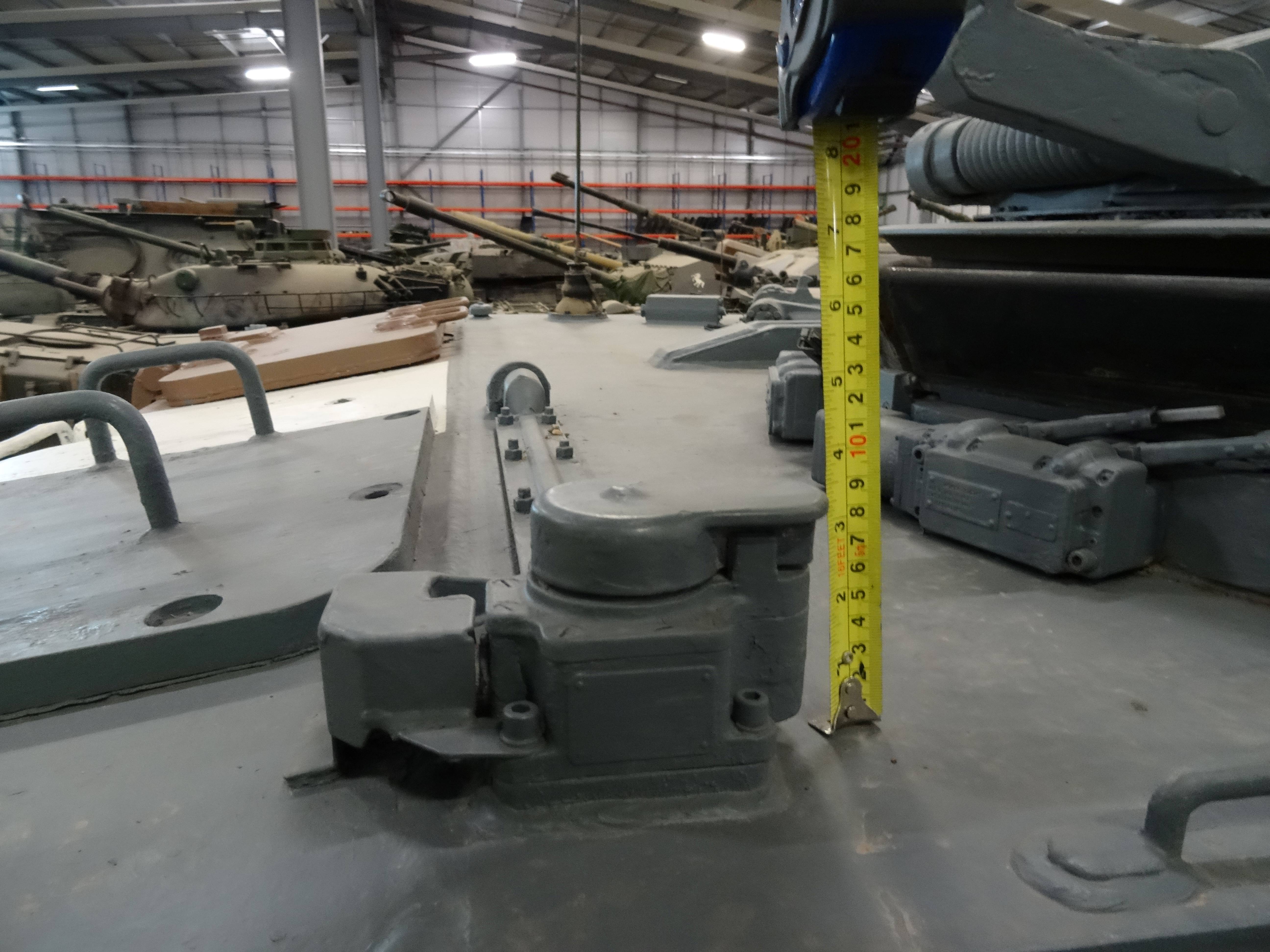

Hi Steve.
Is this any good:-
Trip hazard 1a.jpg (50.17 KiB) Viewed 3035 times
I can supply dimensions if required.

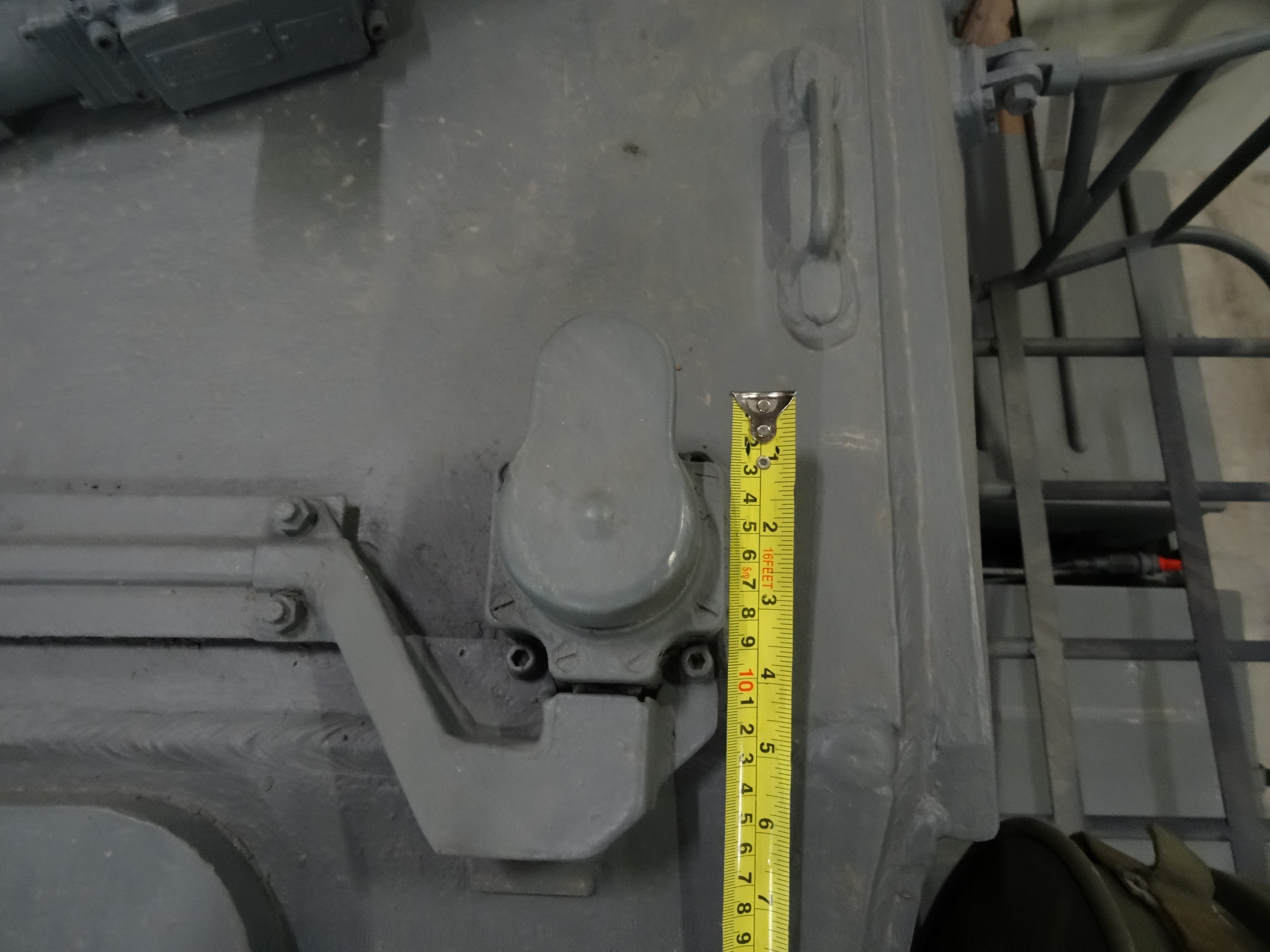

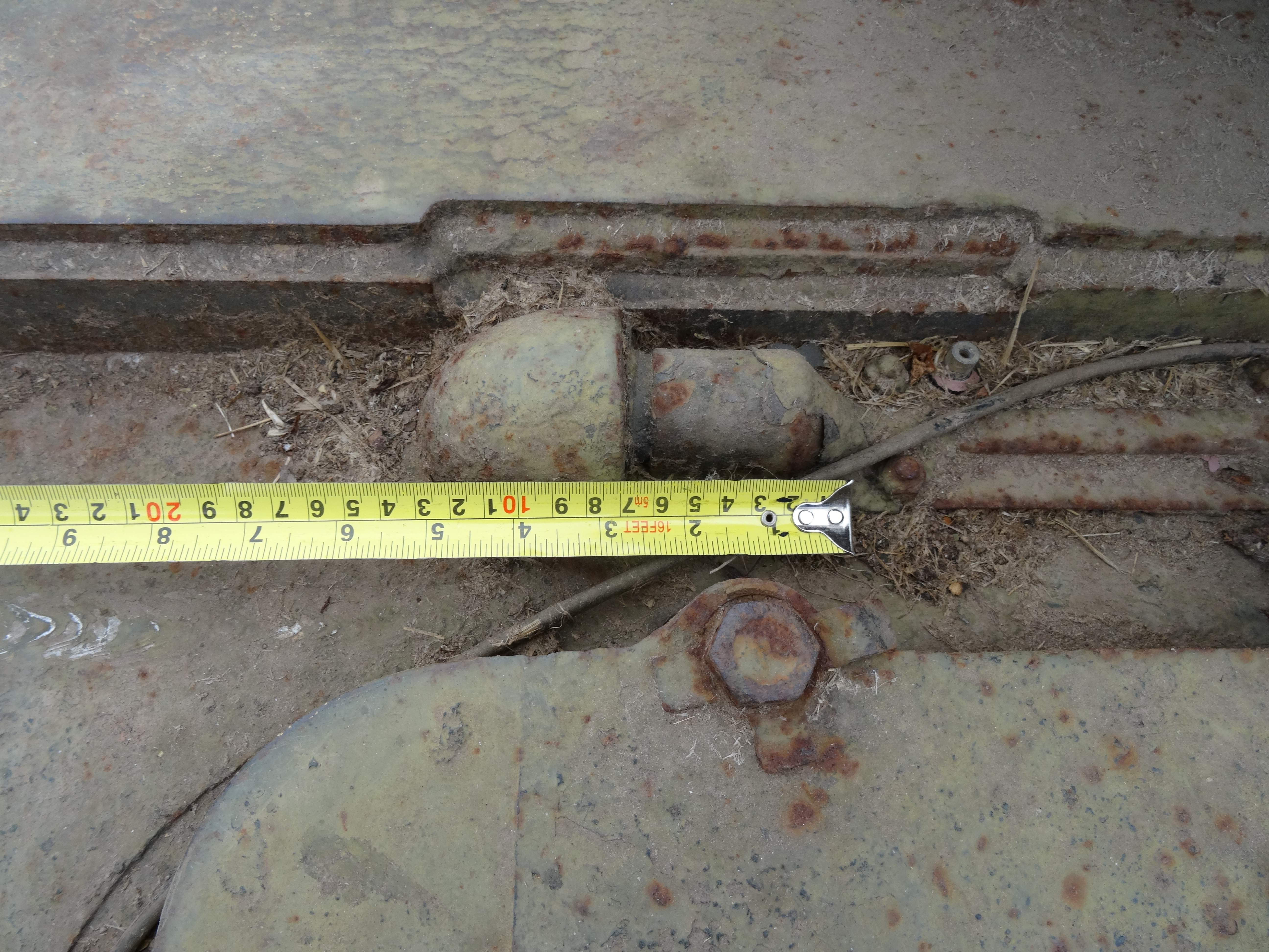

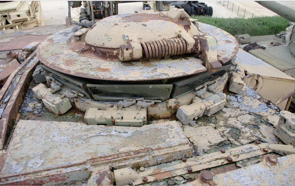

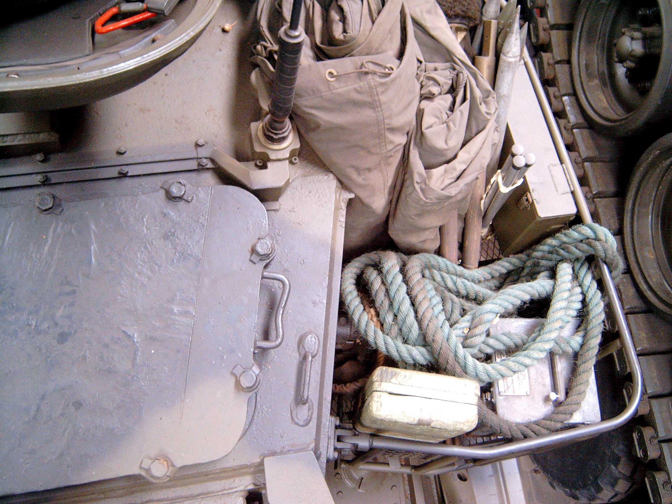

Here's a few alternatives, with or without detector (weather protection plug cover in place). Best guess for sizing
What sort of dimensions Charles?

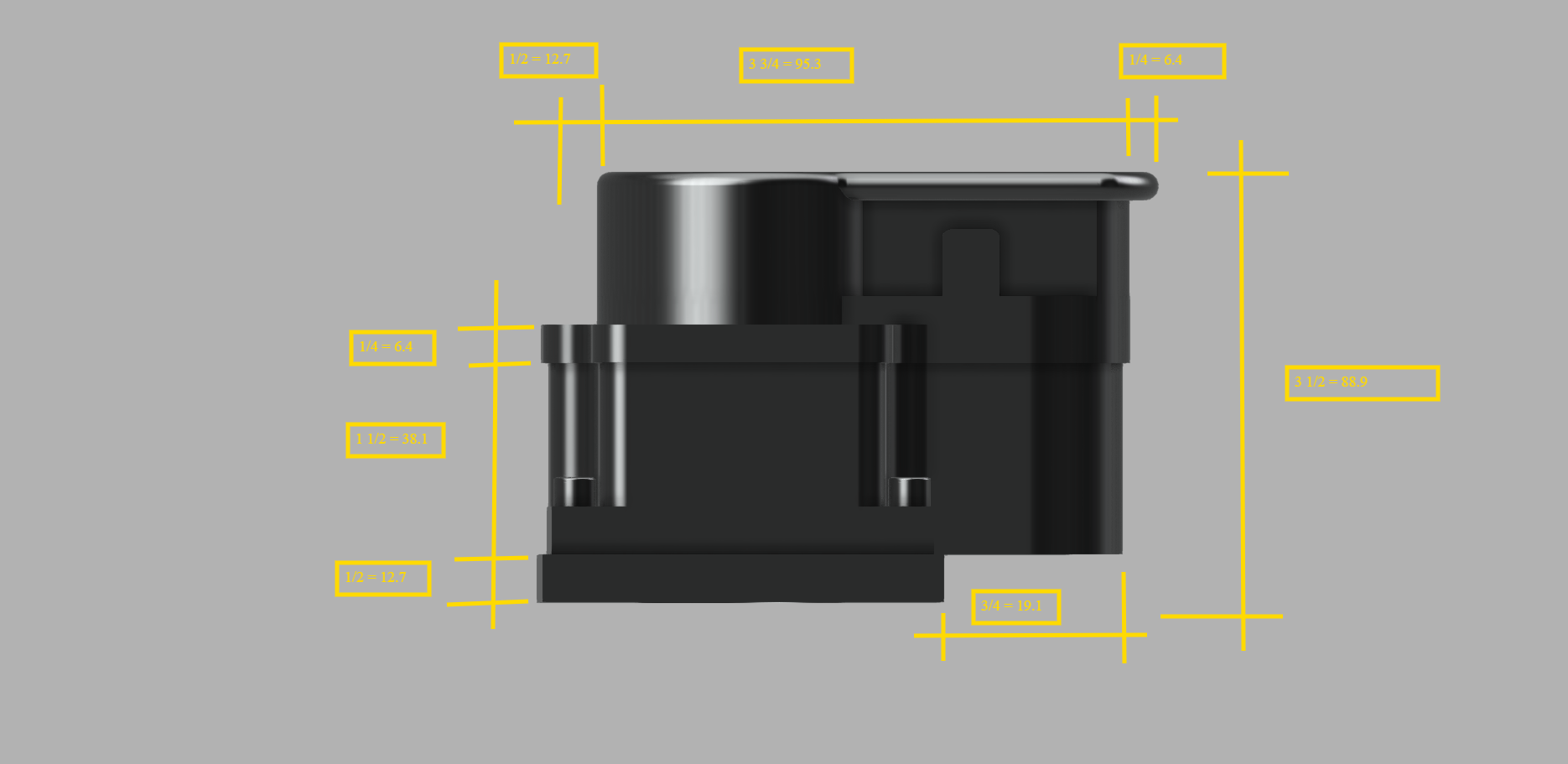

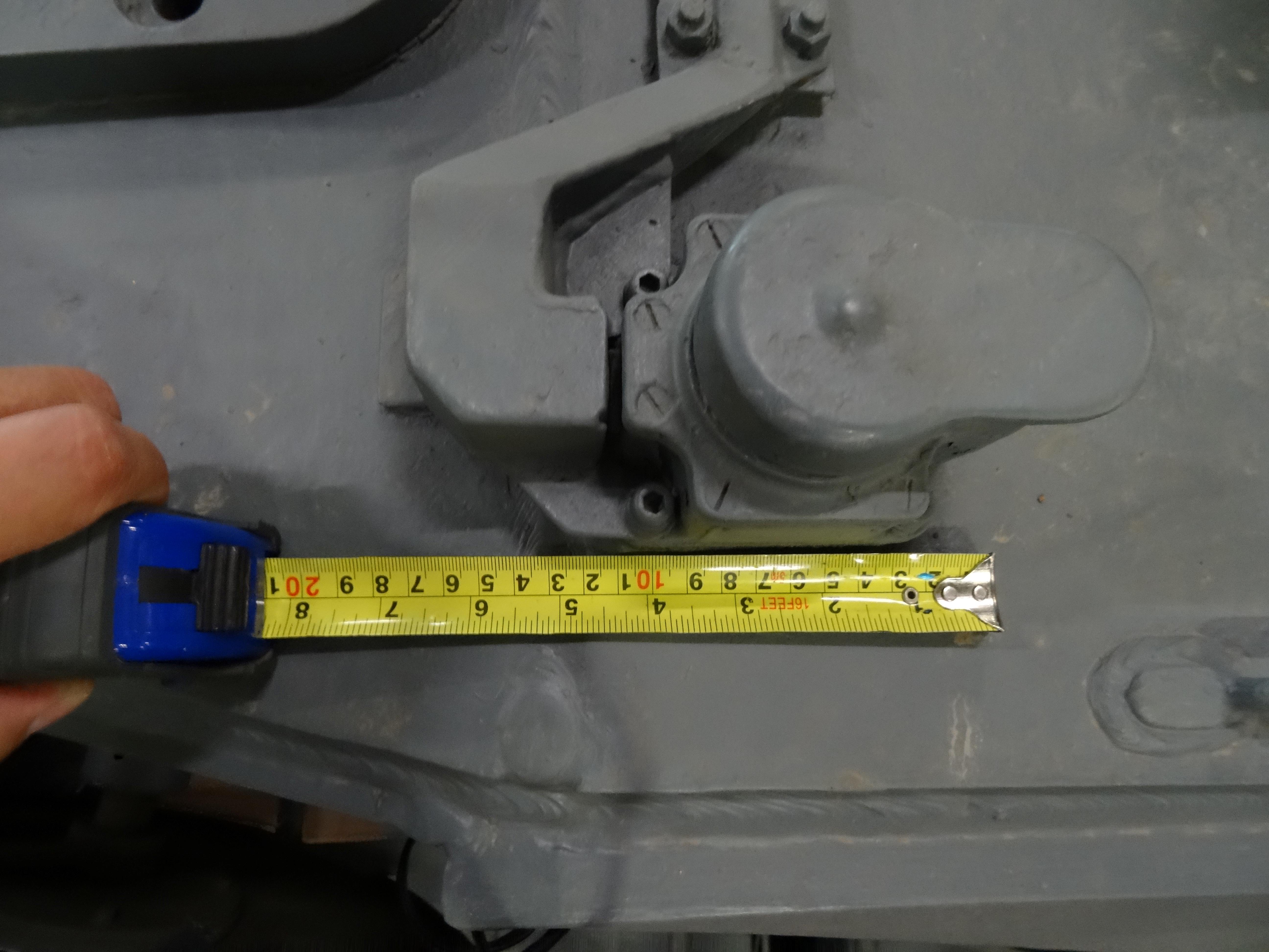

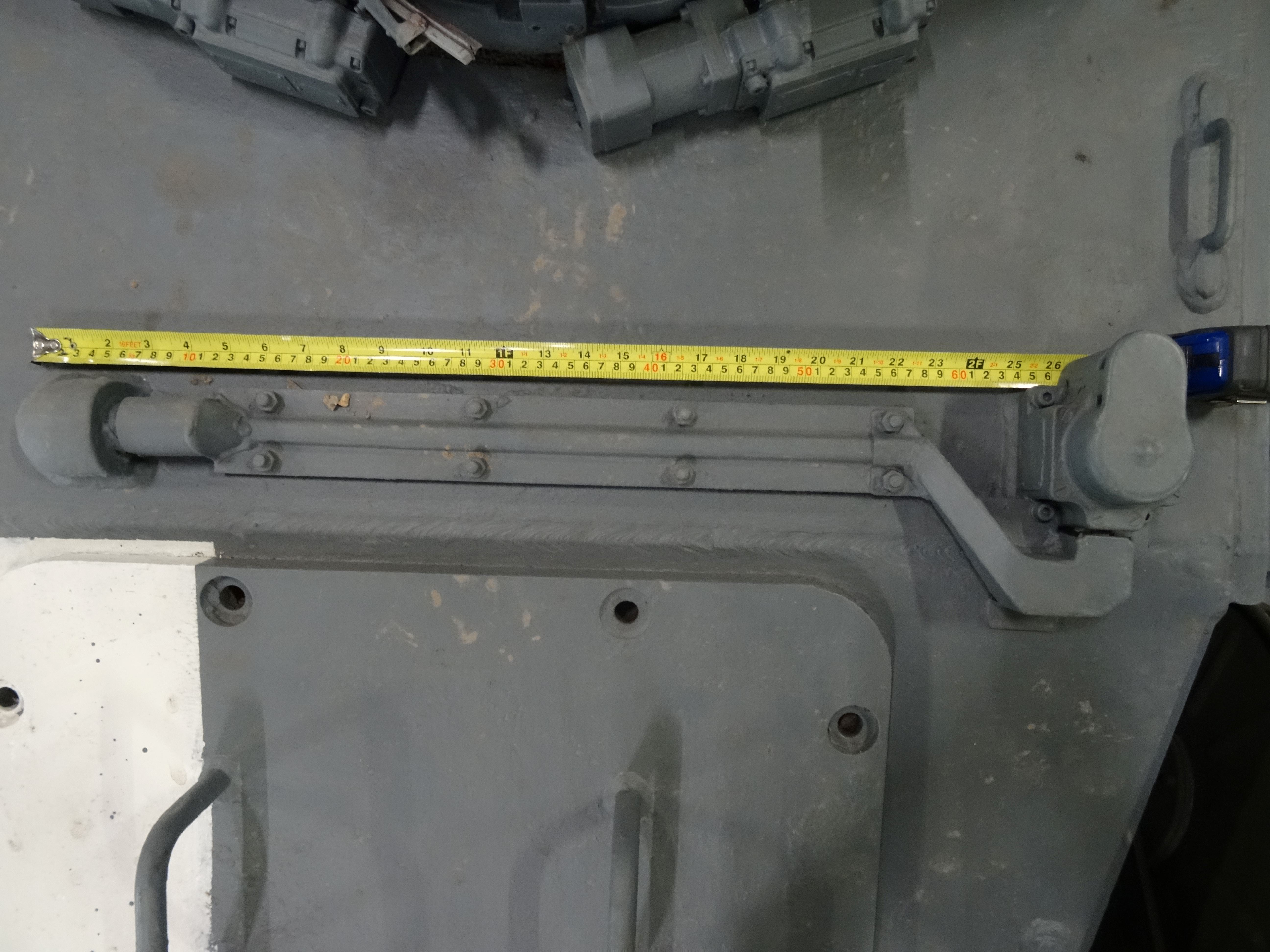

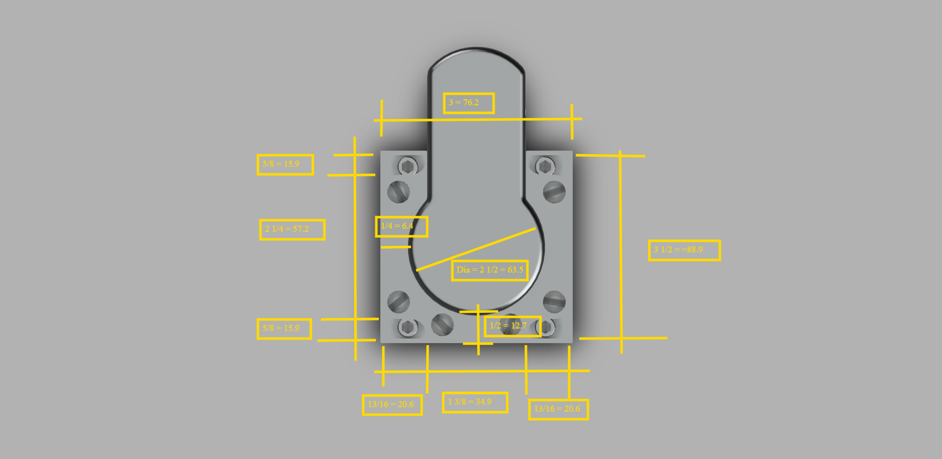

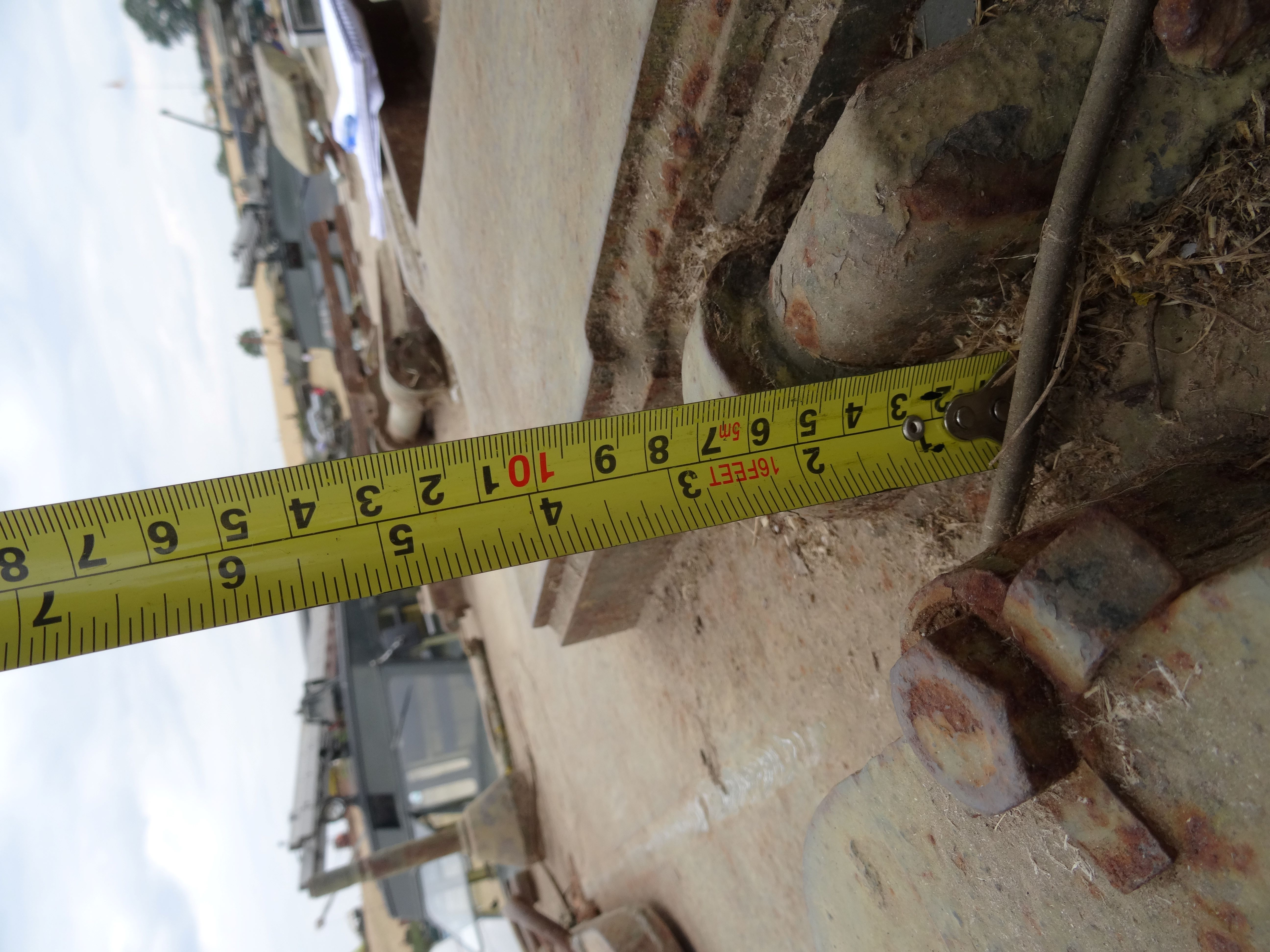

Hi Vince,
I am interested that you are interested : 8)
Do these help ?
Chieftain was designed in imperial, so I find that most measurements only really start to make sense when rounded to the nearest 1/8 of an inch or so.
