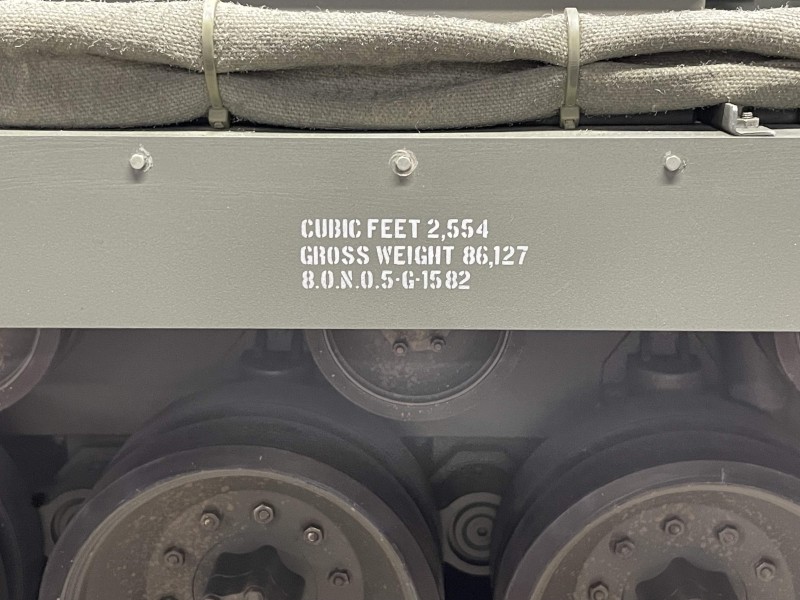

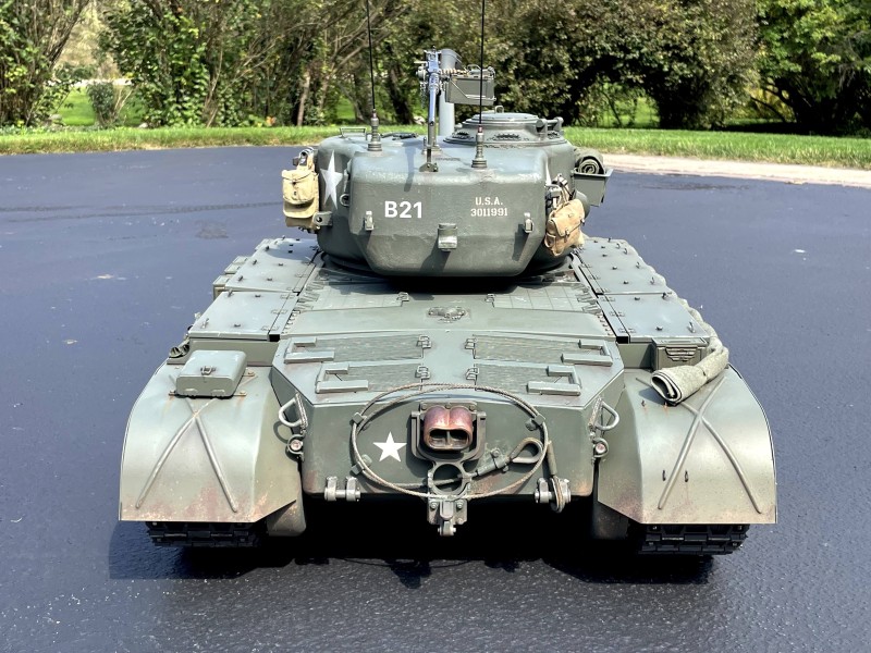

Here are some additional and final stencils I applied tonight. I created these with a graphics program and sent out to a vinyl cutter service. I am done.

Re: Ray's Build ... So far

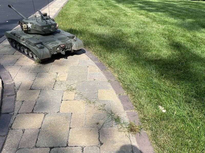

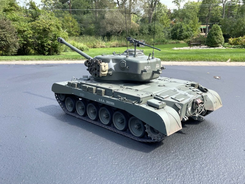

Took the first run outside today and it ran very well. These are the first pictures in natural daylight.
-Ray

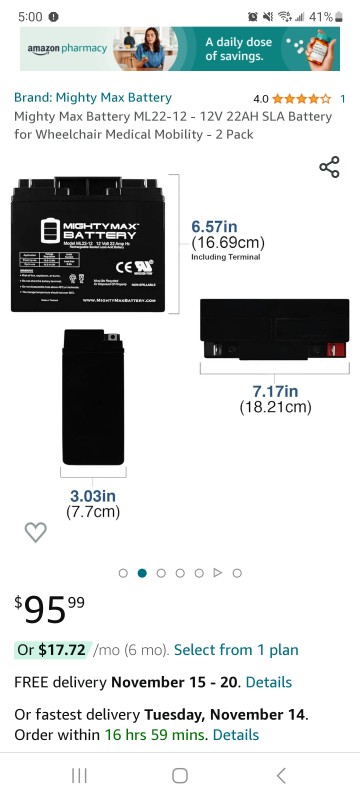

Re: Ray's Build ... Battery question
Ray or anyone will these batteries work for the M26 are they the ones you spoke about?
12V 22AH SLA Battery for Wheelchair Medical Mobility - 2 Pack
