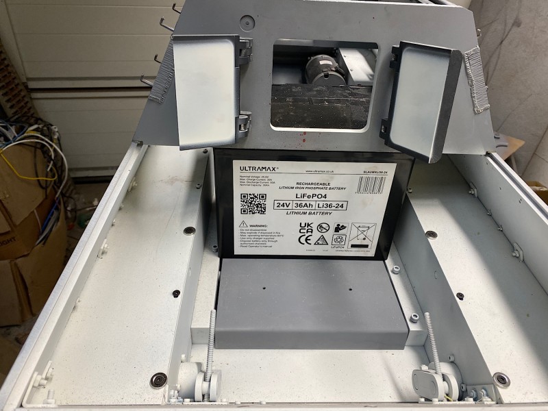

Thanks for the reply, I can confirm it will not fit under the turret area as I tried adding the turret ring and there is zero clearance even with the battery tray upside down to give an extra 5mm. I tried it in the engine compartment but I will have need to install the track adjusters and idler axles and again it looks very tight and may block access to the exhaust outlets as well.

Well I took the plunge and got the 24v 36ah battery. It is indeed huge, but I think I can make it work.
It won’t work with the stock recoil unless moved back a long way.

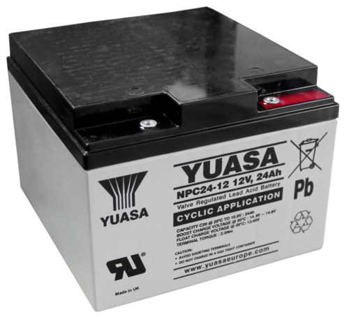

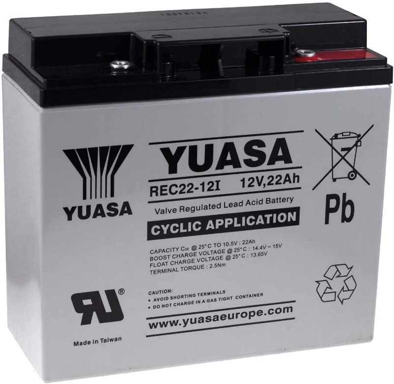

Below is a picture of my charger and two sizes of batteries I am thinking of buying. My Tiger currently uses 2 of the larger size battery
167L x 176W x 126H (inc. terminals) but I can save 6kg in weight if I use the smaller batteries, any thoughts on this?
Are these batteries a good choice or is there a better SLA option?
Thank you
Two of these below
or two of these below

The smaller double 22 Ah option is the simplest. It gives adequate run time and allows space in the hull for other equipment. The can be put upright or flat depending on how things are going to be fitted in. I have them flat to optimise space and to achieve a centre of gravity with the track centre, some thing that enhances the tanks operation no end.
