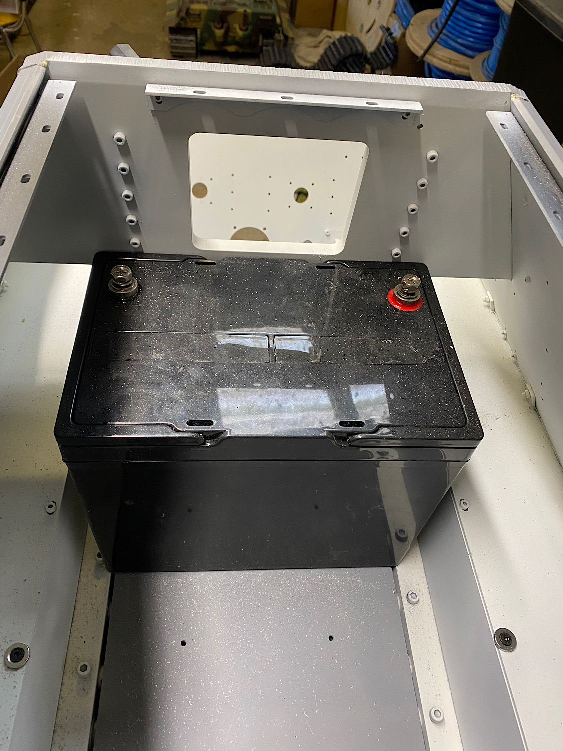

Well I took the plunge and got the 24v 36ah battery. It is indeed huge, but I think I can make it work.
It won’t work with the stock recoil unless moved back a long way.

I can't see there being a problem if the BMS for one cuts in, it'll just isolate the battery and break the circuit. I prototyped a dual battery voltage monitor system for the LA batteries but haven't run it in the tank yet - must get on with that.
I've always used two chargers when using separate batteries. Ctek battery chargers have floating outputs, so I can charge the batteries whilst still wired together, though best practice would be to separate them before charging.
My Tiger has two 22Ah batteries lying nose to nose under the turret. I'll take a shot today as I need to get it out to work on the engine deck.

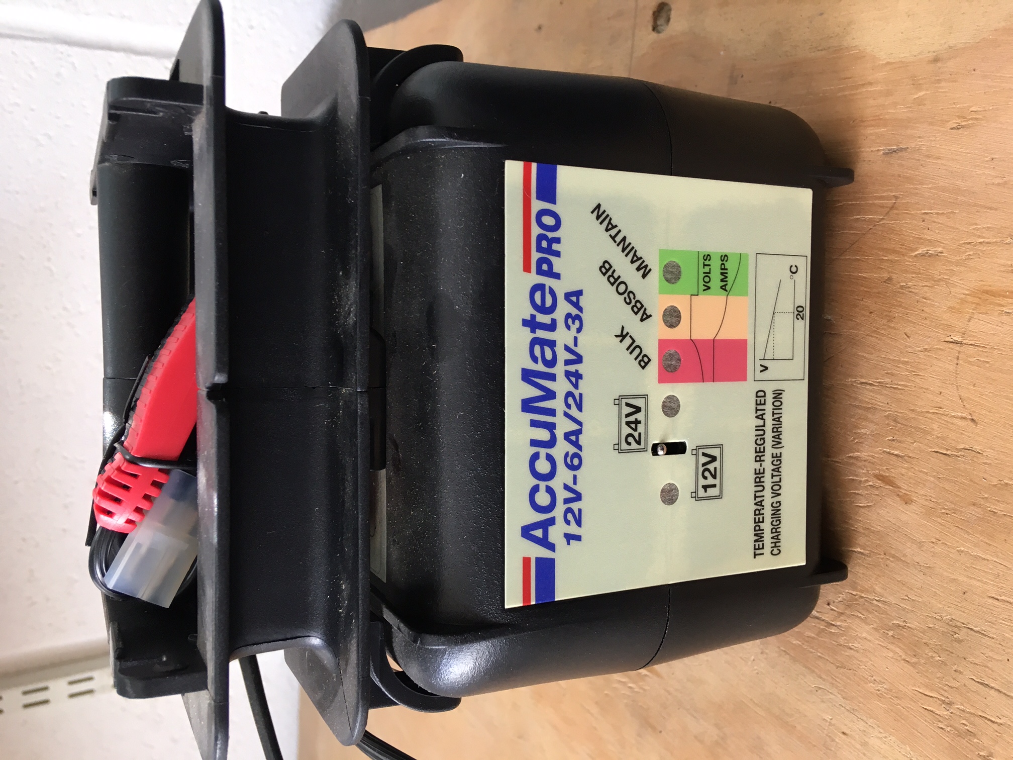

in your special situation I would (exceptionally :wink: ) support Stephen's statement: no games, but a simple change SLA against LiFe (WITH built-in BMS), and you have a good chance to may use even your actual charger. All other solutions (like my usual preferation of 8 single LiFe cells without BMS) I would recommend for new models and for people who are willing to get familiar with handling the LiFE technology.

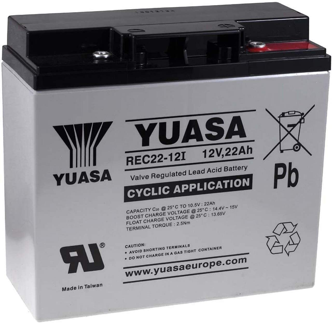

Below is a picture of my charger and two sizes of batteries I am thinking of buying. My Tiger currently uses 2 of the larger size battery
167L x 176W x 126H (inc. terminals) but I can save 6kg in weight if I use the smaller batteries, any thoughts on this?
Are these batteries a good choice or is there a better SLA option?
Thank you

The smaller double 22 Ah option is the simplest. It gives adequate run time and allows space in the hull for other equipment. The can be put upright or flat depending on how things are going to be fitted in. I have them flat to optimise space and to achieve a centre of gravity with the track centre, some thing that enhances the tanks operation no end.
