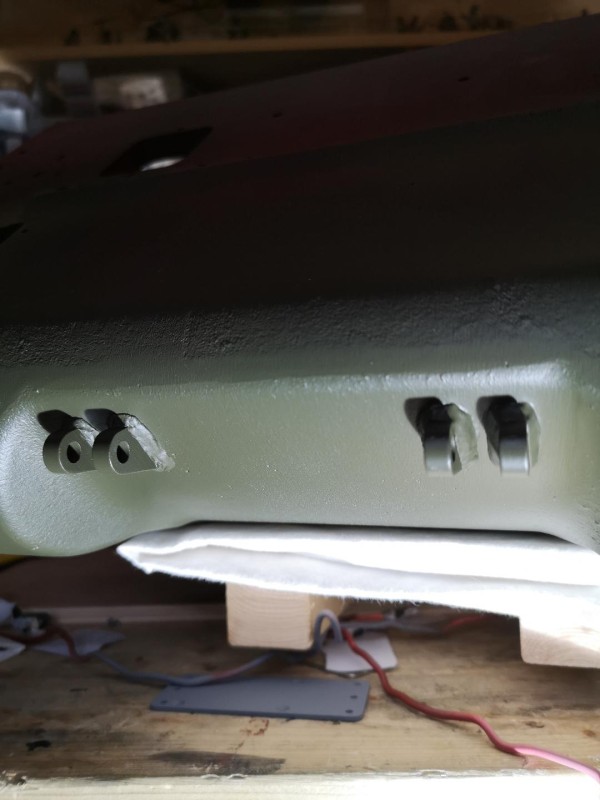

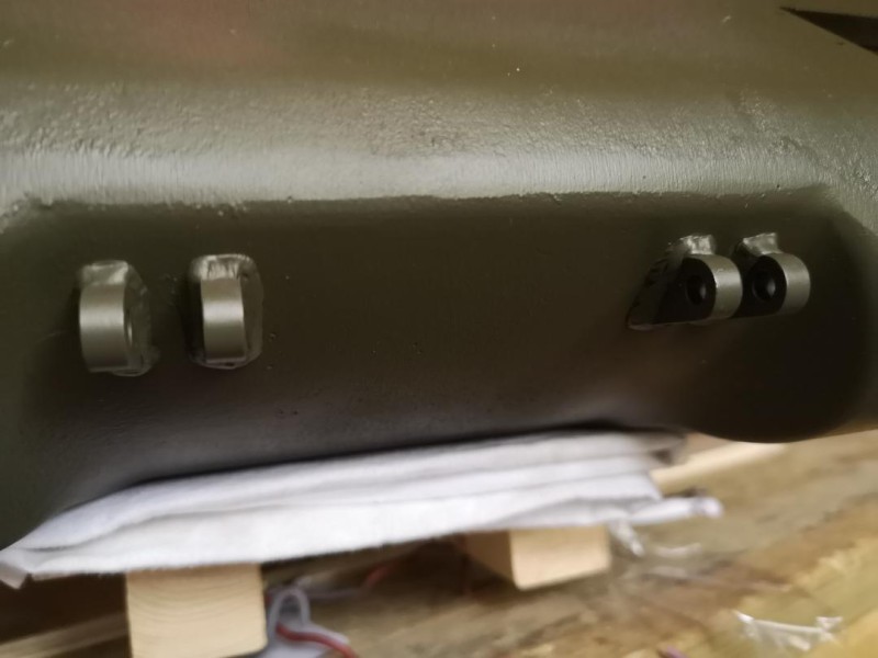

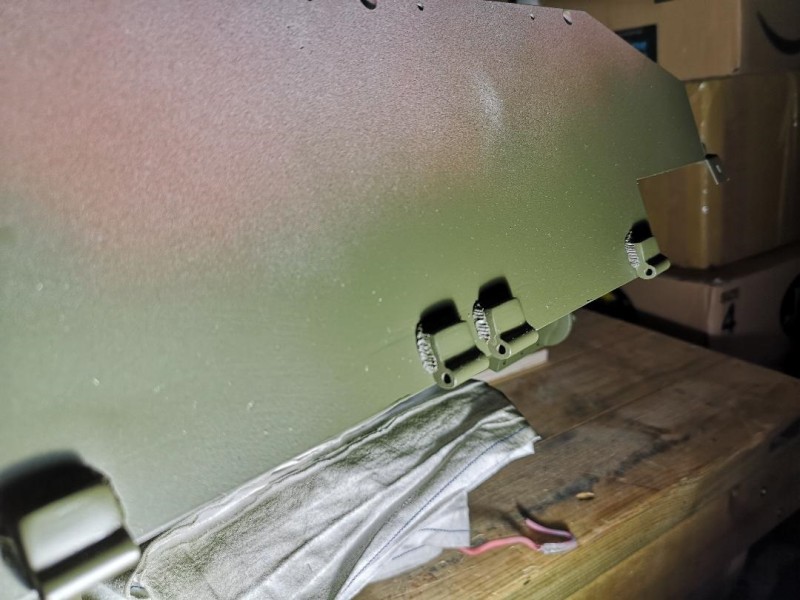

Slow but steady progress being made.

Rear hinges for exhaust grills slightly modified. Countersunk then countersunk bolts fitted. Milliput used to cover and then sanded down to original shape and then milliput used to form welds.

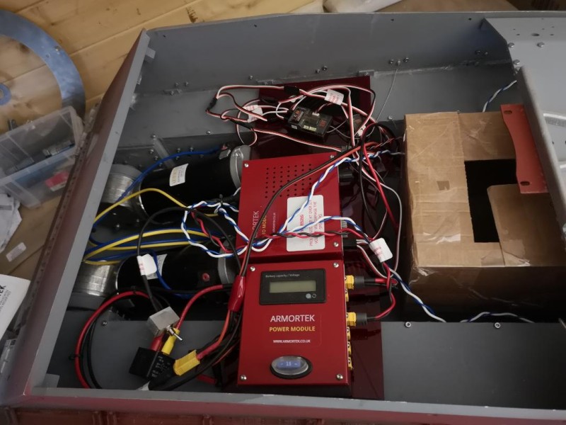

Experimenting with placement of electronics. Made up a dummy battery using cardboard box :D

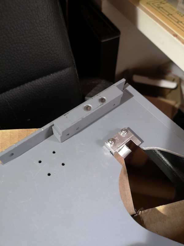

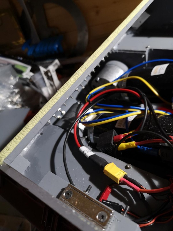

I have been trying out different methods that will enable me to have just one of the top decks permanently fixed and the other removable, to enable easier access to the battery and for maintenance. In the end I decided having the back deck fixed would be more beneficial.
I used Neodymium magnets, aluminium bar and steel strips to provide a retaining mechanism.
