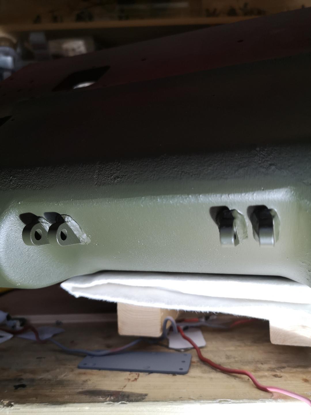

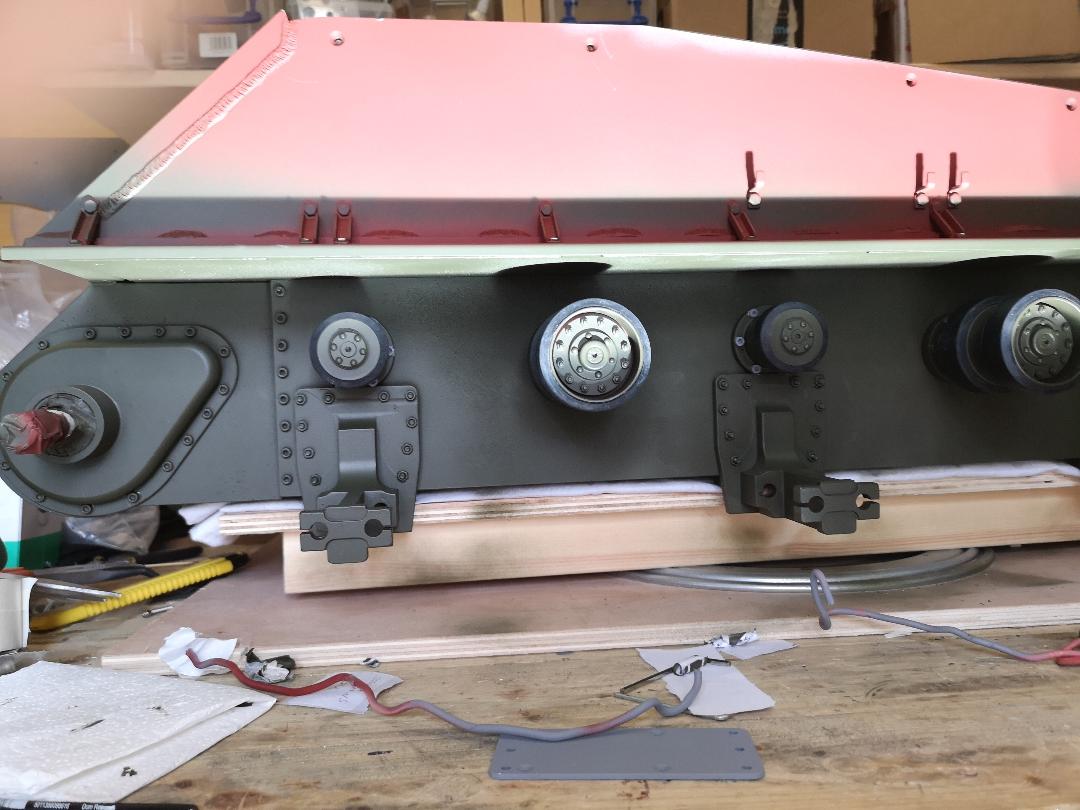

Slow but steady progress being made.
Rear hinges for exhaust grills slightly modified. Countersunk then countersunk bolts fitted. Milliput used to cover and then sanded down to original shape and then milliput used to form welds.

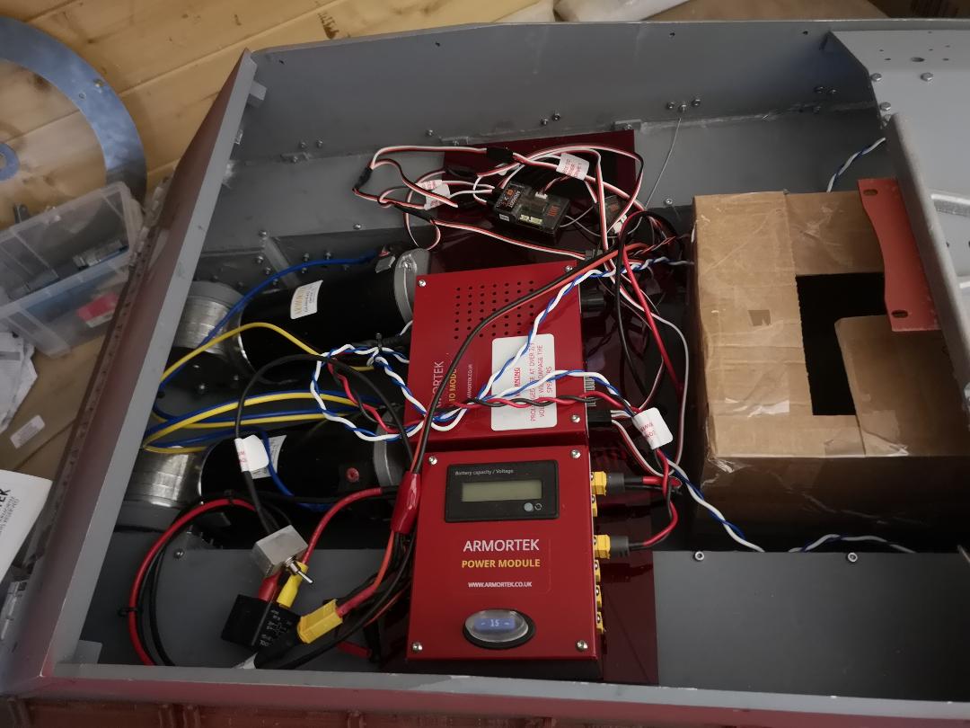

slow but steady progress being made.

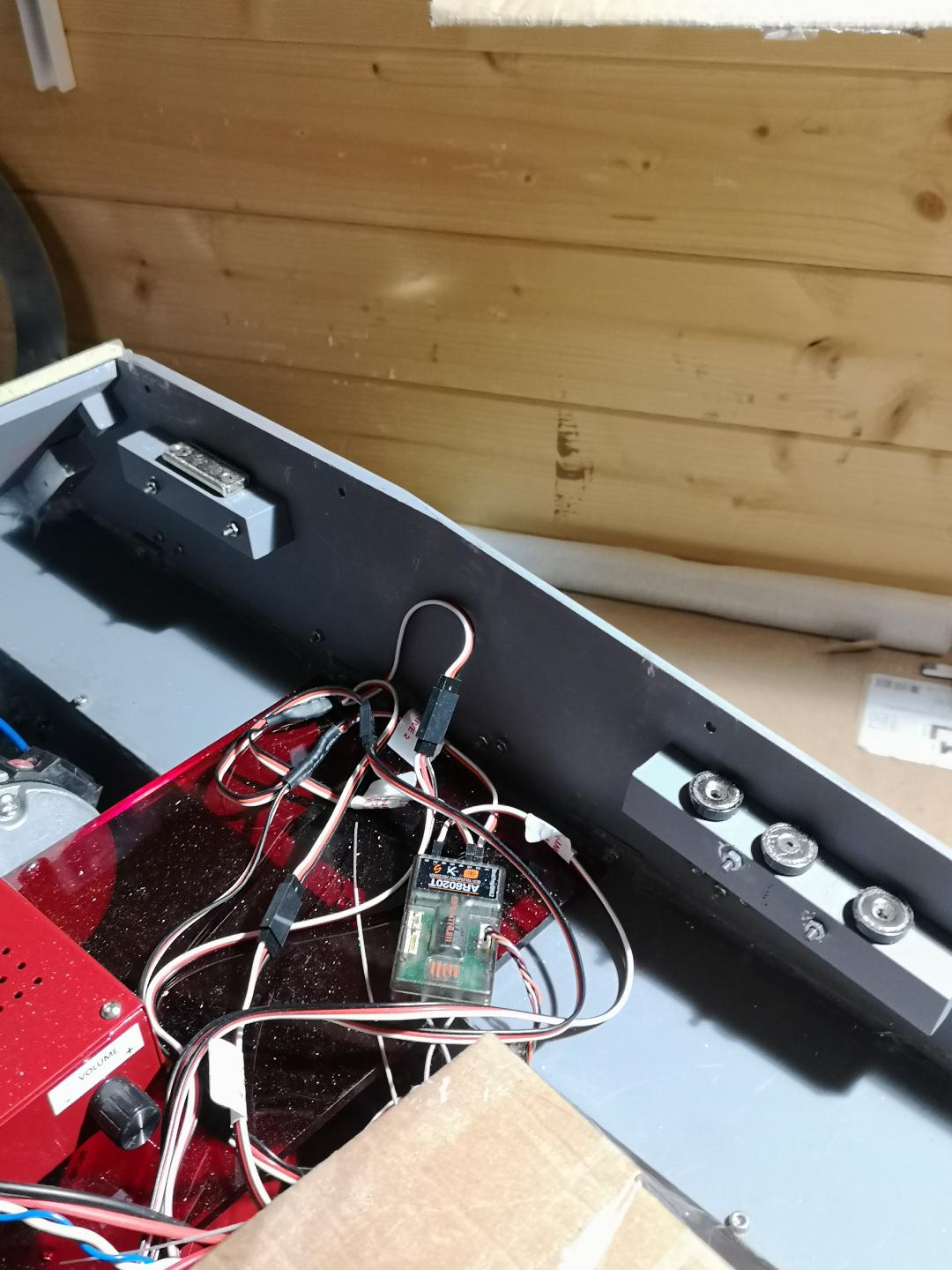

Experimenting with placement of electronics. Made up a dummy battery using cardboard box :D

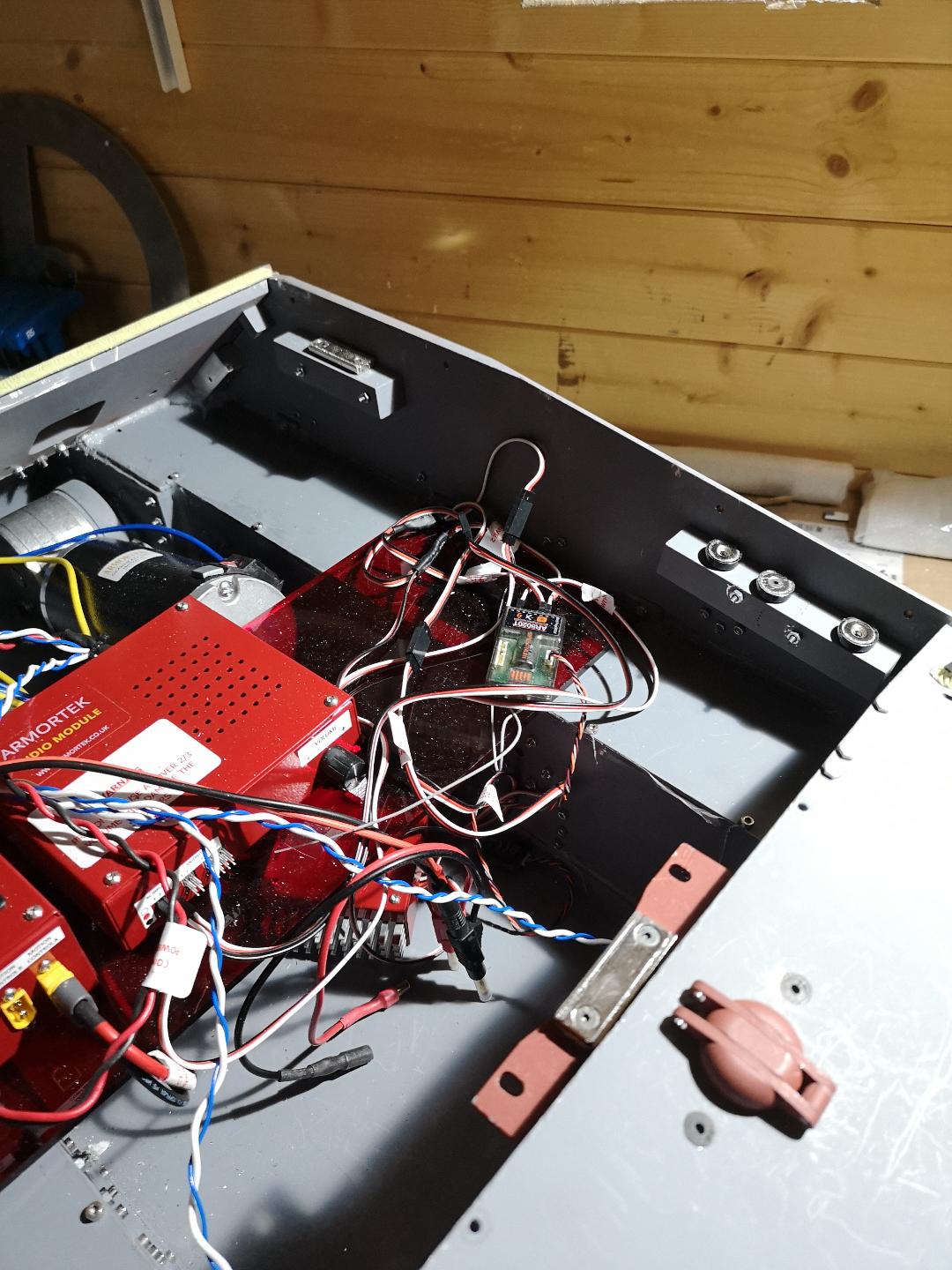

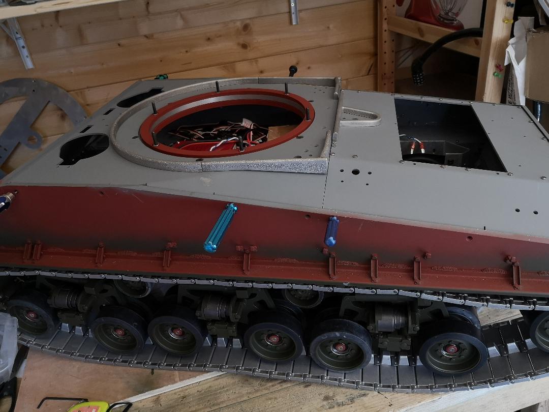

positioning top deck. Thinking about fixing back deck permanently, but possibly finding some way to allow front deck removal for easy access to electronics and batteries. Will take a bit of pondering I reckon.
Posts: 2349
Re: Sherman M4A3 HVSS Build
Looking great. I was thinking of fixing the upper deck (with turret ring) permanently - but making the rear deck removable. Possibly held in pace with magnets. I'm still pondering too. Great progress.
What did you use to goop the inside seams? I'm thinking of using paintable window caulk.

Hi Bob,
I used normal clear silicon sealant from a hardware shop. I found one which came self contained and ready to go, as it had a pumping lever on the tube already, so no need for a dispensing gun. The tube was also sort which made it easy to get into all the little nooks and crannies.
I had considered making the rear deck removable, but it would only give access to the smoke unit and speakers.

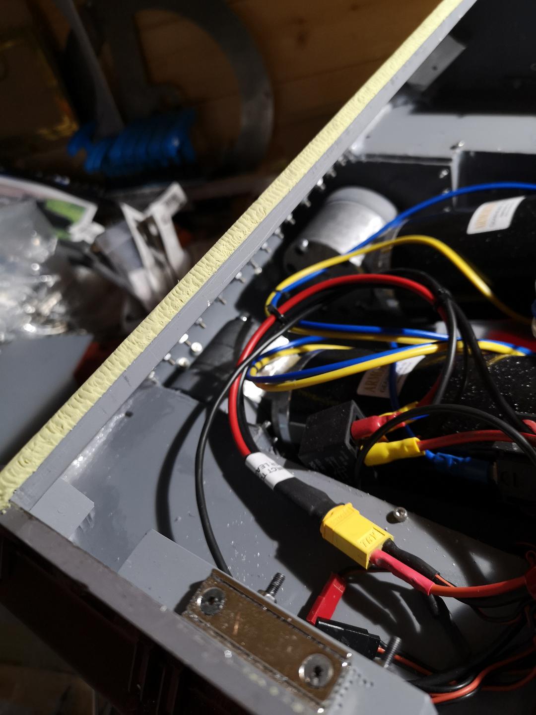

I have been trying out different methods that will enable me to have just one of the top decks permanently fixed and the other removable, to enable easier access to the battery and for maintenance. In the end I decided having the back deck fixed would be more beneficial.
I used Neodymium magnets, aluminium bar and steel strips to provide a retaining mechanism.

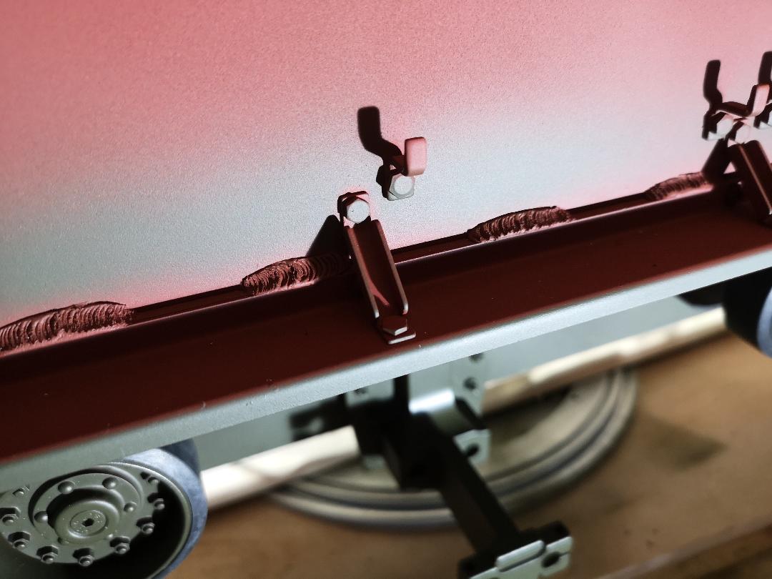

Having decided to make the front deck removable I still want to try and have all the weld lines. At the front where the top deck meets the sloping front armour I fitted a section of 3mm right angle brass strip to the top edge of the front armour. This was placed so as to enable the front edge of the top deck to slide underneath at an angle, and then when the back is lowered it fits flush underneath it. I then ran a line of milliput weld along the V of the brass strip. Hopefully the brass strip will protect the milliput weld from damage when the top plate is taken in and out. It seems to work so far. I now have to figure out how to do the side welds.

One idea is to machine a step into the hull upper parts, so that you can lay a bead of weld in the step, and it comes up with the hull when you remove it.
When you put the weld on the lower part, there's always a risk of damaging it as you put the hull down. With it on top of the aluminium, it's much more protected.

One reason I went for the method I chose is that the weld is on the main body of the tank and is therefore not going to be bashed around by moving. If I put the weld on the top deck (which will be removed at some point) there is always the chance it could get knocked while separate from the tank. With my current setup, the top deck slides in at an angle underneath the brass strip / weld bead and then as I lower the back end it fits up snugly from underneath. I suppose only time will tell if it works.....but I don't envisage having to remove it very often.
