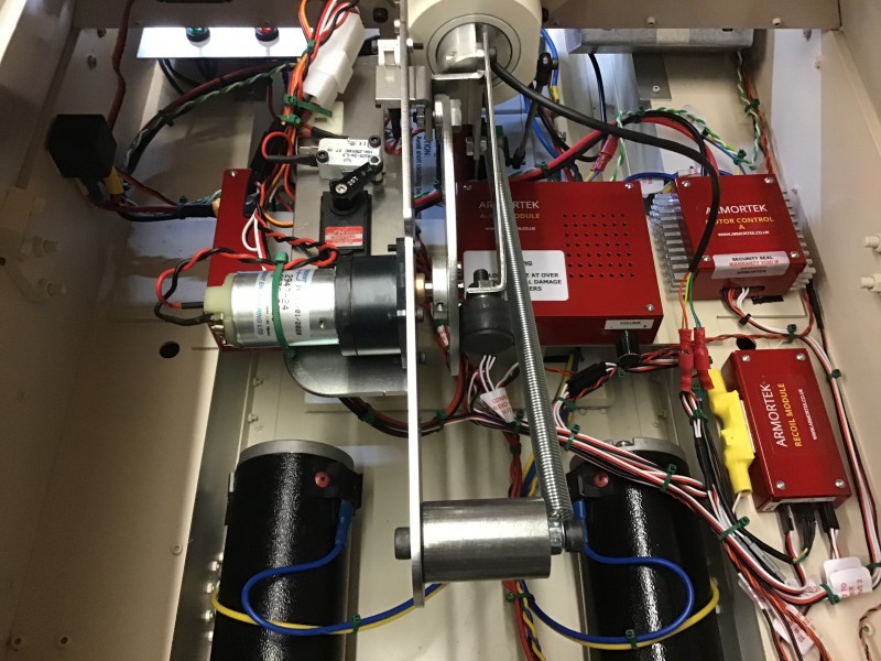

I have recently installed the recoil in my Elefant and everything worked perfectly after a little bit of messing around withe the 2 switches. The only thing extra I did was to add a rubber stop to stop the slide smashing into the end of its slot on full recoil.
Not the best photo but it may help.
I am away from home for the next week, if you are still stuck when I get back I can post some better photos.
