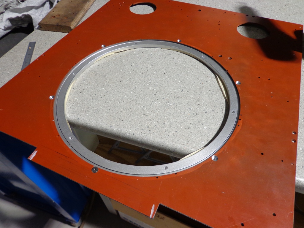

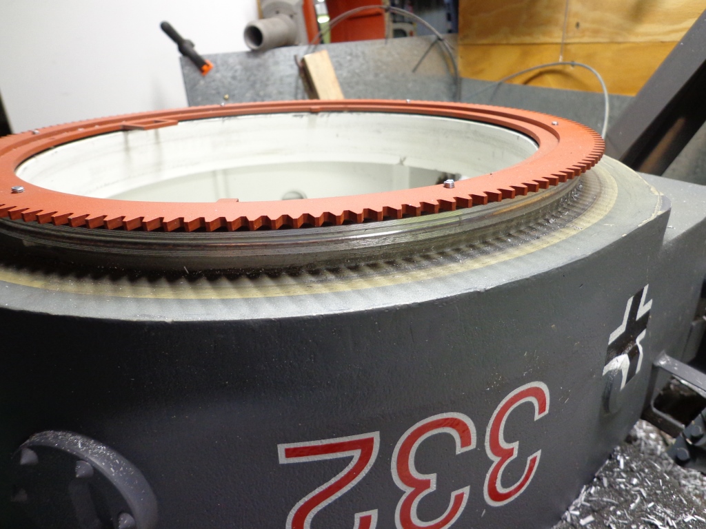

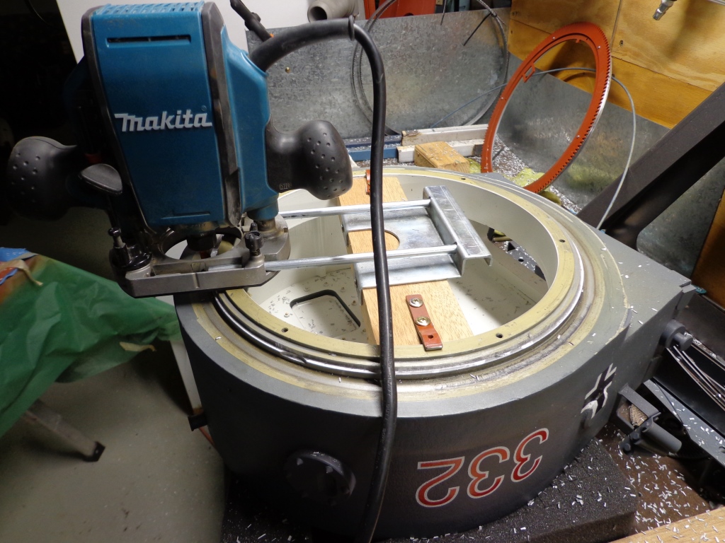

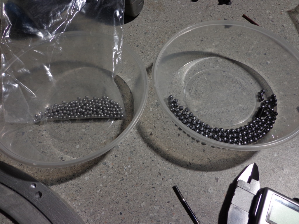

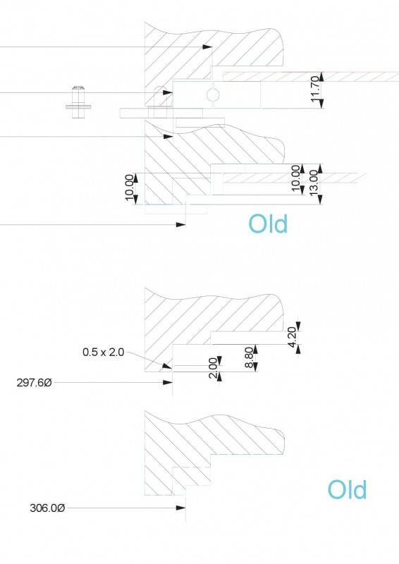

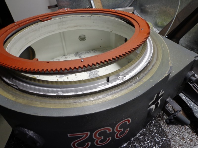

Here is a quick look at what I did a few years ago, the bearing is off ebay, router and a block of wood to steady it small cuts (the casting is very soft), cad off to the laser cutter for a new main gear and spacer, a few holes and 2 clips to hold the turret on. I also put smaller ball between each of the standard ball to stop the pinching that was happening then a little graphite powder and it is good to go. Pm me if you would like the dxf file for the laser cutting?
Liam
Liam

yes, I have seen this topic, but I must confess that it is not clear to me how the work was done. Unfortunately with the translator everything becomes very difficult. I searched on the Internet for a rotating crown (bearing) with the inner diameter equal to the diameter of my turret (28 cm). But I found only 25, 30 or 35 cm. Perhaps the new tower has other diameters ?? !! Thank you

I measured my bearing and it has an outside diameter of about 350mm and an inside diameter of about 300mm. Something like this:
https://www.ebay.co.uk/itm/Aluminium-La ... 01m_Vffa-A
The hull roof hole diameter is about 325mm so it seems to be bigger than yours.
Try and get in contact again with Armortek to see what they say. Sometimes when they are busy they may take some time to respond.
