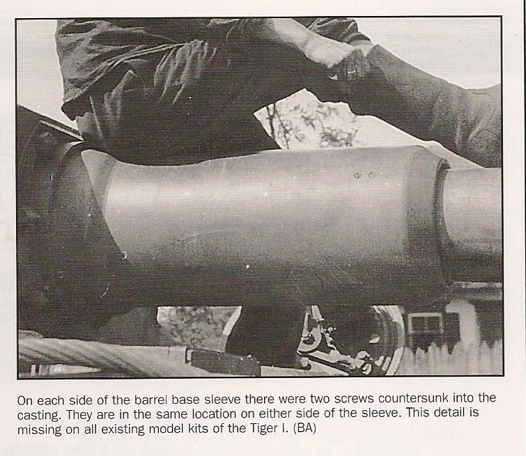

Hi,does anyone know the locations of the barrel sleeve (oil?) plugs? Are there four or six?
Thanks.
Has liked: 1040 times
Re: Barrel Sleeve
If you mean these on the Walzenblende, gun mantlet:
Tiger gun mantlet.jpg (243.23 KiB) Viewed 3834 times

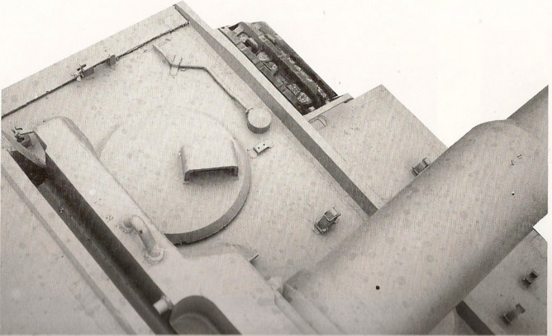

ie two pairs at two and ten o'oclock but this appears to show one pair at twelve:

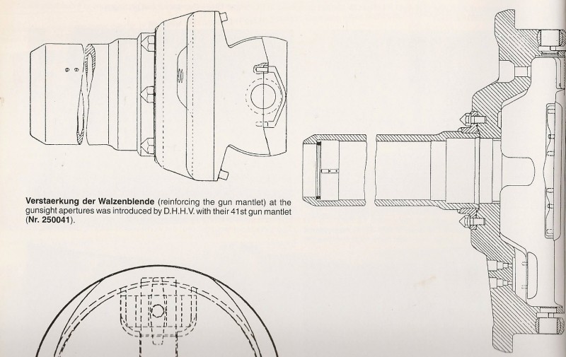

Similarly, Jentz and Doyle clearly show the ten and two positions:
Tiger gun mantlet 5 1.jpg (99.46 KiB) Viewed 3834 times

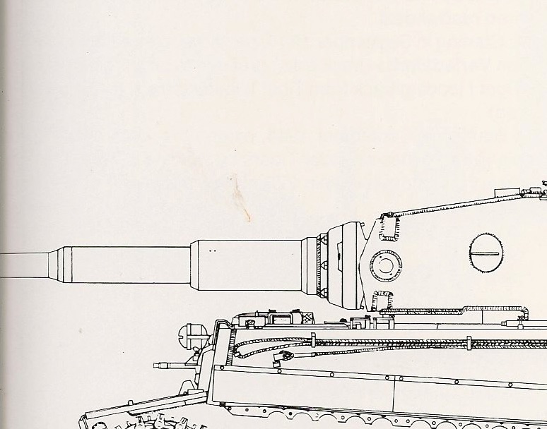

But they also show what appear to be different configurations:
so to answer your question, I'd suggest the answer is probably four, two pairs at two and ten o'clock. Given that the gun mantlet was changed in Nov 1942, to strengthen the gunner's eyepiece aperture, I suppose it's possible they changed from one pair at twelve o'clock to two pairs, to increase the circulation of lubricant. But that's speculation. You'd probably be safe with the two and ten configuration.

There was 6 screws placed 2, 10 and 6 o’clock in pairs and their purpose was to hold the ”Dichtung” in place.
There was also a drain hole at 6 o’clock.
Drawings here at David excellent tiger1.info site.
http://tiger1.info/EN/Mantlet-sleeve.html
The photo with the screws at 12 o’clock from the Bovington Tiger show the Britts replaced the sleeve upside down :shock:
Hope this helped.

Kent, thanks. That explains the Jentz and Doyle diagrammes but how do you explain the second photo I posted which clearly has two screws at 12 o'clock. Was it possible to fit the sleeve upside down maybe?

Yes, the sleeve is by misstake replaced by her new owner, the Britts, upside down.
Please note the drain hole that can be sen in the photo, it is supposed to be placed at 6 o’lock or be useless....

No the photo show the Aberdeen Tiger1 with its liftning lugs on the mantlet so it is the US who failed here, sorry.... :oops:

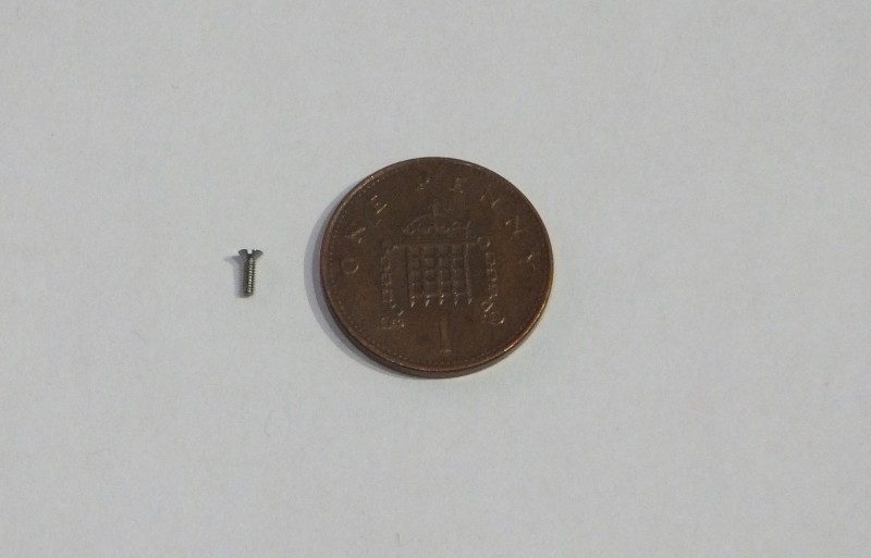

Anyone considering this addition, you will need M1.2 CSK slotted screws.
Mine have just arrived and I have no idea how to countersink a hole that small :lol: :lol: :lol:
