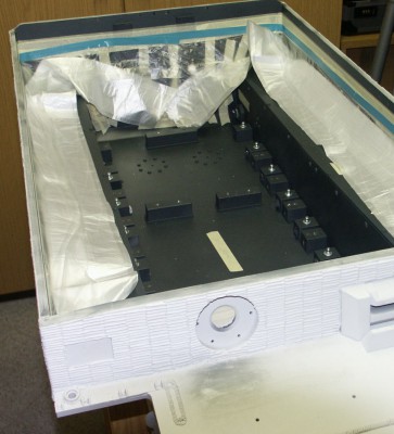

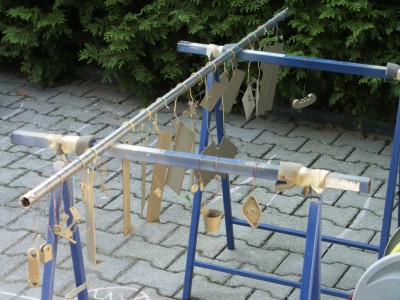

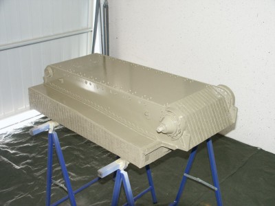

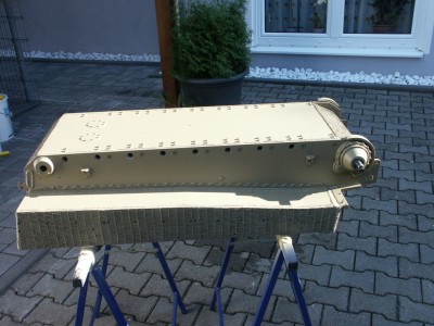

Hi Guys,
today i show you how to paint the tank:
After applying the Zimmerit, I have sprayed this layer with plastic primer.
Then I have painted the Zimmerit with Etch Primer.
(Spraying is not necessary, it makes no difference in the end.)
All components now have the same characteristics before the 2K painting starts.
Very important when you use matt colors
I only used 2K paint.
My 1K primer is not dissolved by the 2K color.

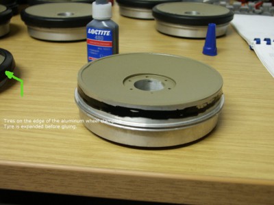

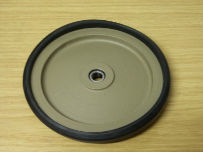

2K colors facilitates future work, such as the sticking of the tires, etc.
I will also show how to stick the gummy wheels.

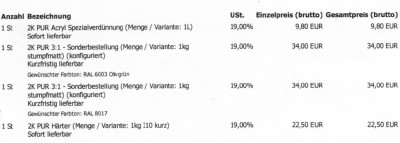

My materials:
RAL 6003 - olive green custom-made in 2K / http://www.militaerlacke.de
(all parts approximately 350 ml)
RAL 1817 - reddish-brown custom-made in 2K / http://www.militaerlacke.de
RAL 7028 - dark yellow Mipa 2K-Purlack http://www.frickwork.de
(all parts approximately 1500 ml)
I want to mention here that I have compared many color manufacturers with museum vehicles.
The aforementioned colors are very similiar with the museum vehicles.
It is very difficult to find the hue of that time.
The colors of the museum vehicles have also changed through the ages.
I tried to find the most suitable variant in two years.

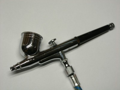

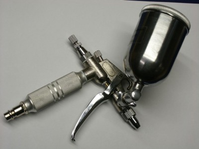

Tools:
Spot Repair Spray Gun 0.5mm (omnidirectional) for larger parts
Airbrush gun with nozzle 0.3 and 0.5mm
Greetings,
Detlef

! Warning error RAL 1817 - Reddish-brown is RAL 8017!

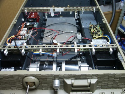

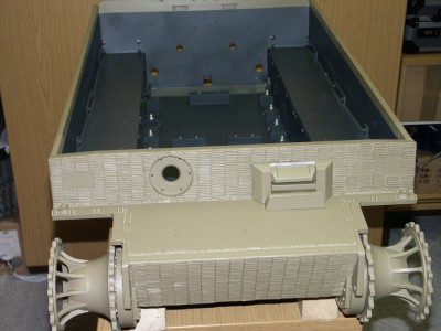

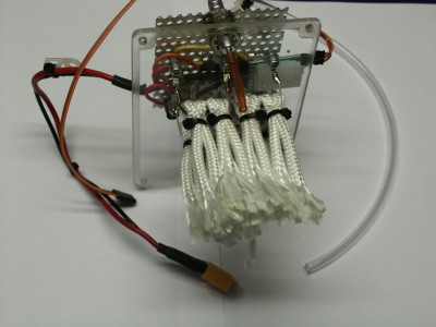

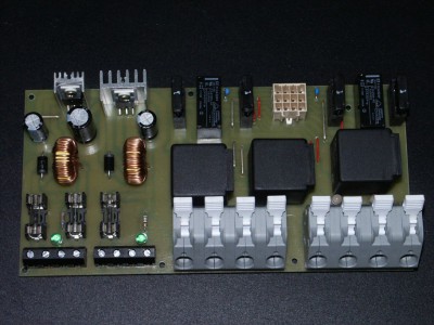

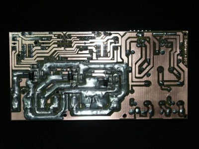

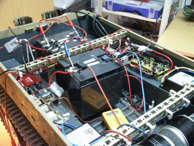

Here you can see my mess

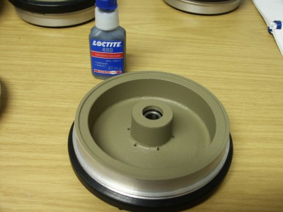

Next time: stick tires
1/3
1/3

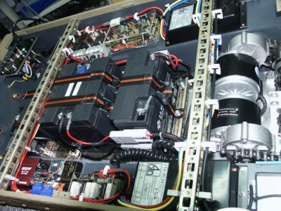

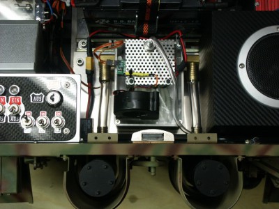

Re: Detlef's Tiger 131 / s. SS-Pz.-Abt. 101 Normandy

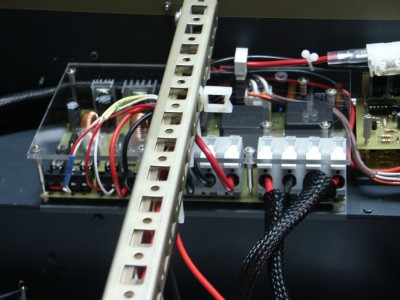

The last remaining space is filled.
Benedini Smoker in a different way.
Next time: stick tires!

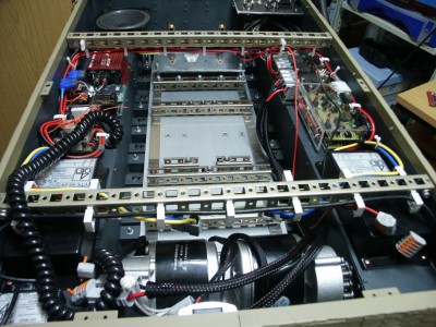

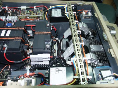

Hello!
A note for those interested without Armortek kit experiences.
The tiger shown here should not be understood as a deterrent.
My Tiger 131 is my own chaotic model.
Today Armortek kits are now so perfect that the assembly can be built with little effort and simple tools.
The electrical-electronic component is easy to install.
The company Armortek offers everything to produce a working model with nice special features.
Also the support of Armortek is excellent.
The Model kits focus today in the paint and surface design.
Most Scale components (special screws, cables, brackets, tools, hoes,drives etc.) I have made myself of solid material.
The manufacturer Armorpax offers very nice pieces at reasonable prices.
My images are to be understood only as an inspiration, for example, How can I attach a cable differently.
Greeting,
Detlef

Hey Guys!
Today:
How to stick the wheels.
Materials:
- Aceton (for cleaning)
- 3x 20g Loctite 480 (+/-)
- Cloth (for cleaning)
Attention!:
- never paint adhesive surface
- clean surfaces with acetonDon’t worry, the wheels wont be destroyed by the aceton
Before sticking the wheels, you have to put them on the edge of a wheel (for stretching).
So the adhesive is not pushed down during fixing.
The edge has the ideal level for stretching.
Now you have to coat the glue, but not to the brim.
Hold the wheel perpendicular and turn it regulary, then the glue will not flow to the bottom
Don't worry, you still have a lot of time!!!
Wheel flat on the table top.
Now you have to pull of the wheel from the other wheel and immediately put on the wheel you have to stick.
Now the high reaction of the glue starts!!
Attention!
The tires must be in a short time have the correct position!
Don’t look at the pollution.
Press something on the tread!
Pay attention to the position.
Attention!
After hang up the tire you have just a few seconds to positioning!!
Stretch the last wheel with your hands.
The advantage of a 2K paintwork is:
After all wheels have been sticked, you can clean every wheel with aceton.
Wipe from the inside out.
You have a lot of time.

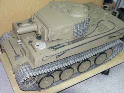

Here you can see the result:
Greetings,
Detlef
I’ve destroyed my first wheel because of a wrong position.
I could remove the rest of the gummy just with a lathe.
This glue is briliant
