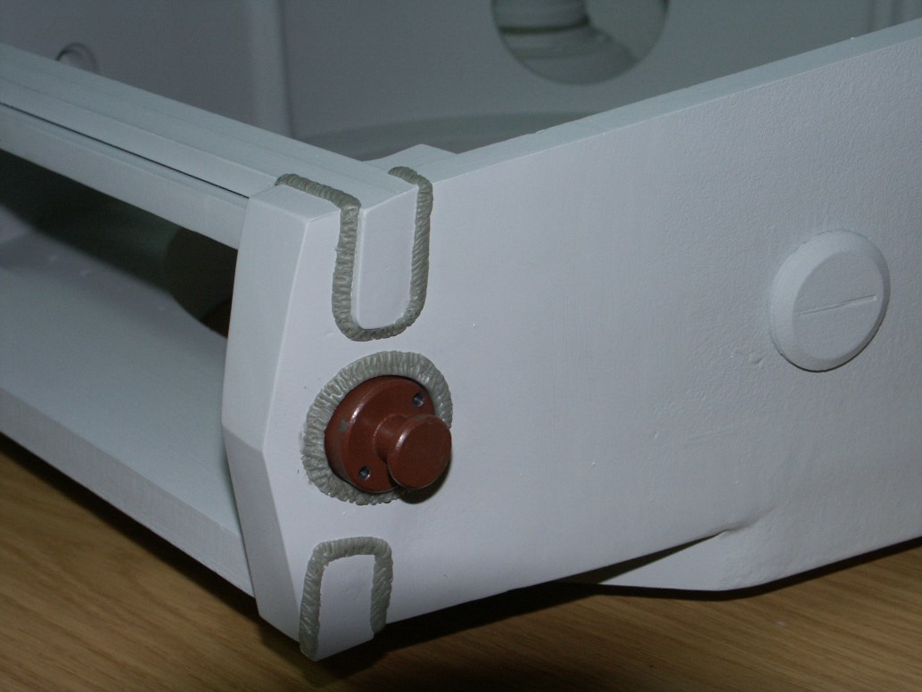

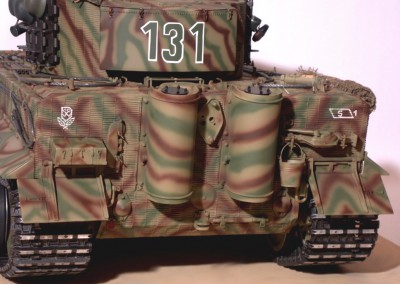

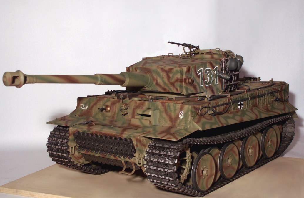

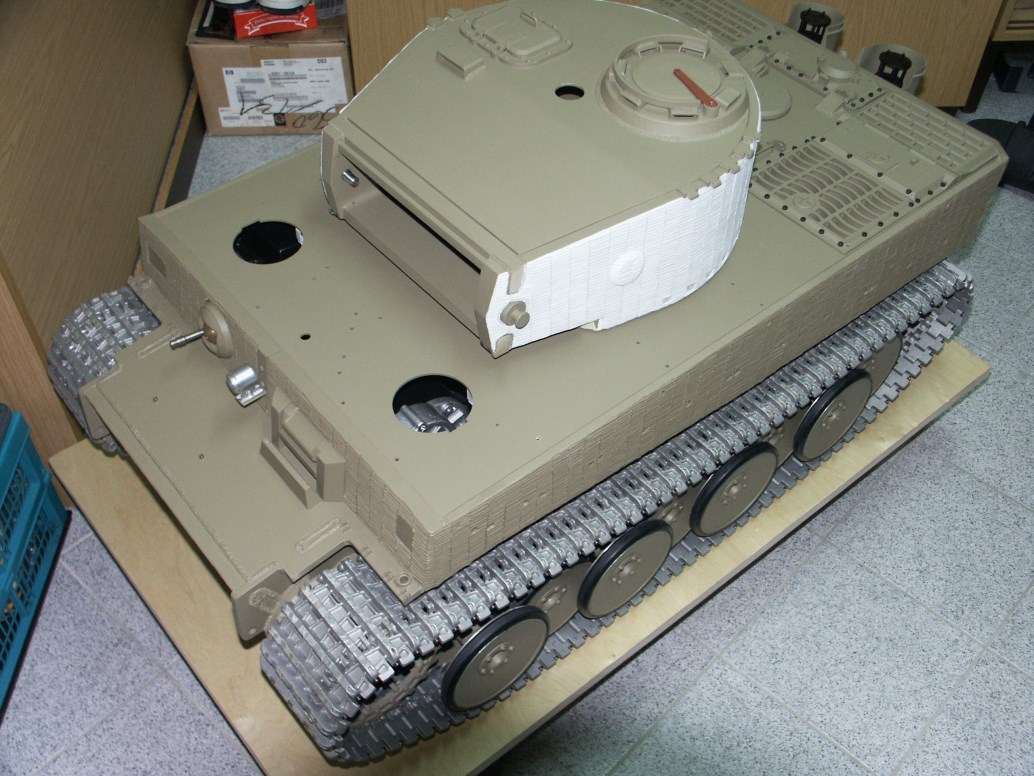

The result:
This Tiger is based on Tiger "131" from 1 / heavy SS Panzer Division 101, with Untersturmführer Walter Hahn
Weight: 167 Kilos
Engines: 2x 350W
Battery capacity: 4x 12V/17Ah
Board voltage: 1x 24V
Supply for RC and sound from the drive battery
Benedini sound and smoke
Integrated charger (Single charge)
Greeting,
Detlef
Weight: 167 Kilos
Engines: 2x 350W
Greeting,
Detlef

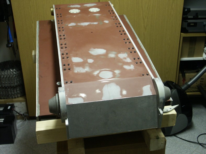

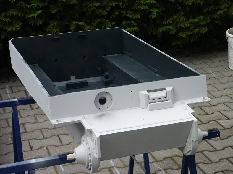

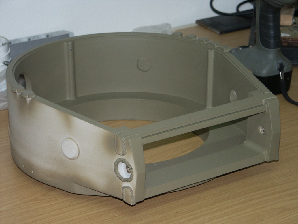

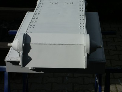

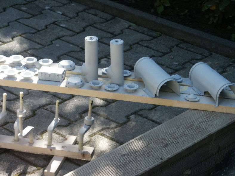

Hello!

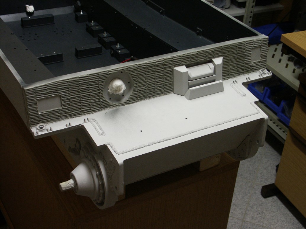

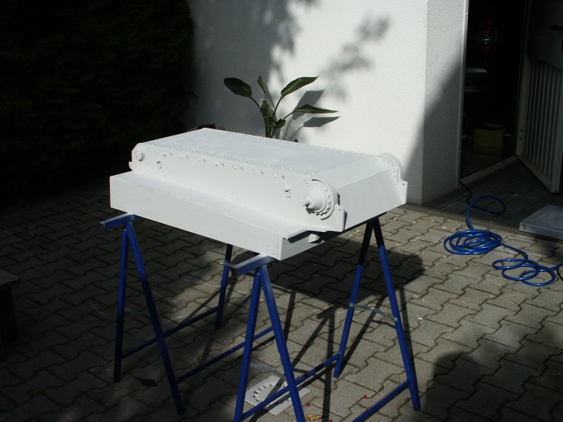

Cleaning, filling, priming
After assembling, all screws and unevenness must be leveled out with 2K Aluminium spatula (previously degrease not forget).
I used 2K Aluminium spatula from the hardware store.
Please, never use your finger as a sanding block, it is always caused by irregularities.
Each location has to be filled and sanded twice.
My important cleaning agent is acetone.
Before you paint areas, you have to degrease them with aceton
Primer: 1 K Etch Primer
Supplier: http://www.militaerlacke.de/
Consumption for spray painting of all parts: approximately 1200 ml
Dilution for cleaning the equipment is very important.
Other solvents like nitro, etc. do not work with 1k etch primer!
I could start painting after two hours with the 2K
(Parts have been lying in the sun).
I recommend to treat all parts made of brass and aluminum with this primer (also the small brass parts of the company Armorpax).
Parts of zinc always pre-treated with zinc cleaner before priming.
Greeting,
Detlef
Greeting,
Detlef

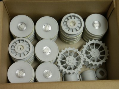

Re: Detlef's Tiger 131 / s. SS-Pz.-Abt. 101 Normandy

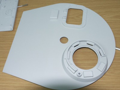

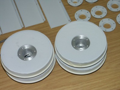

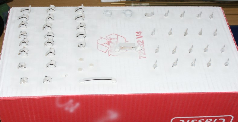

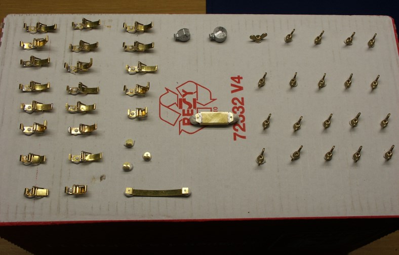

Small parts I glued on a cardboard with tesa power strip.

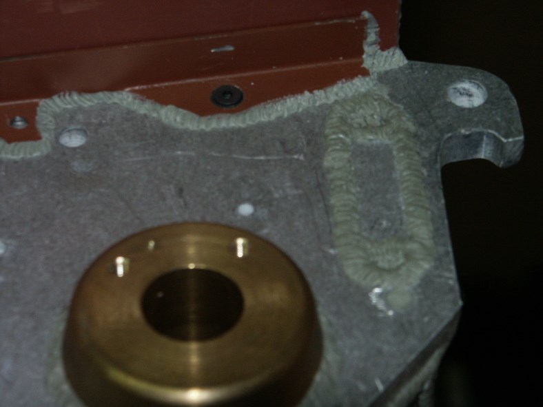

Hello Paul,

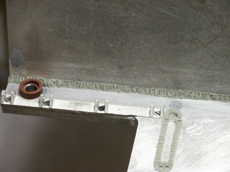

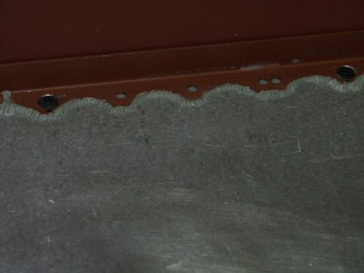

Thanks for your reply.
I haven't sealed it, these are the welds with Apoxie Sculpt.
Sealing off wouldn't be easy to do.
Greetings,
Detlef
Next time Zimmerit!

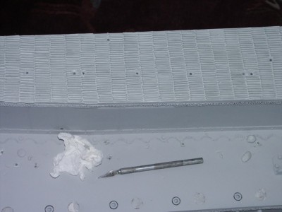

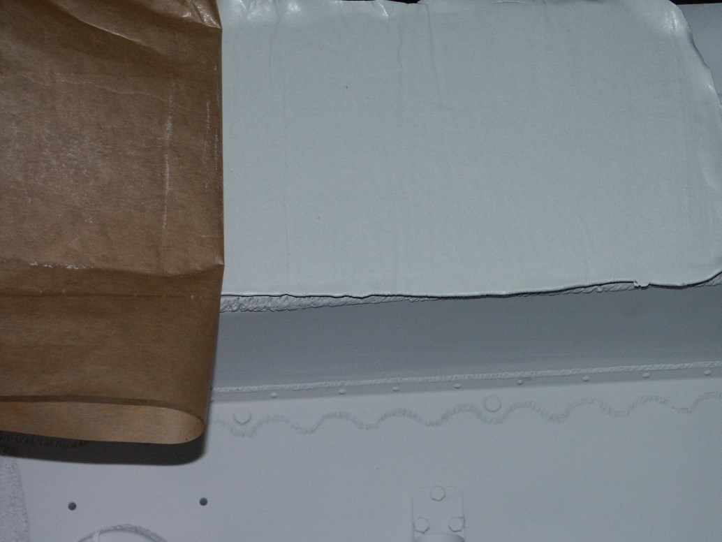

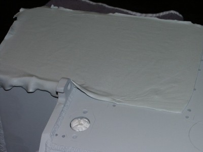

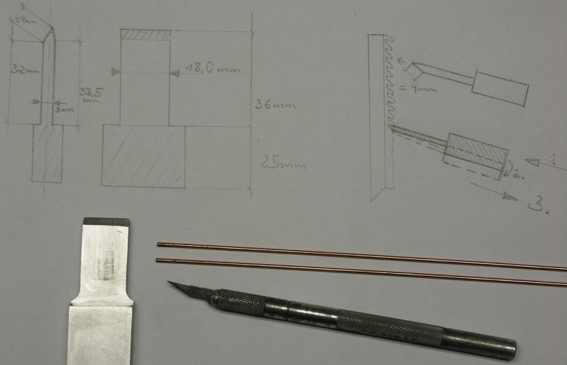

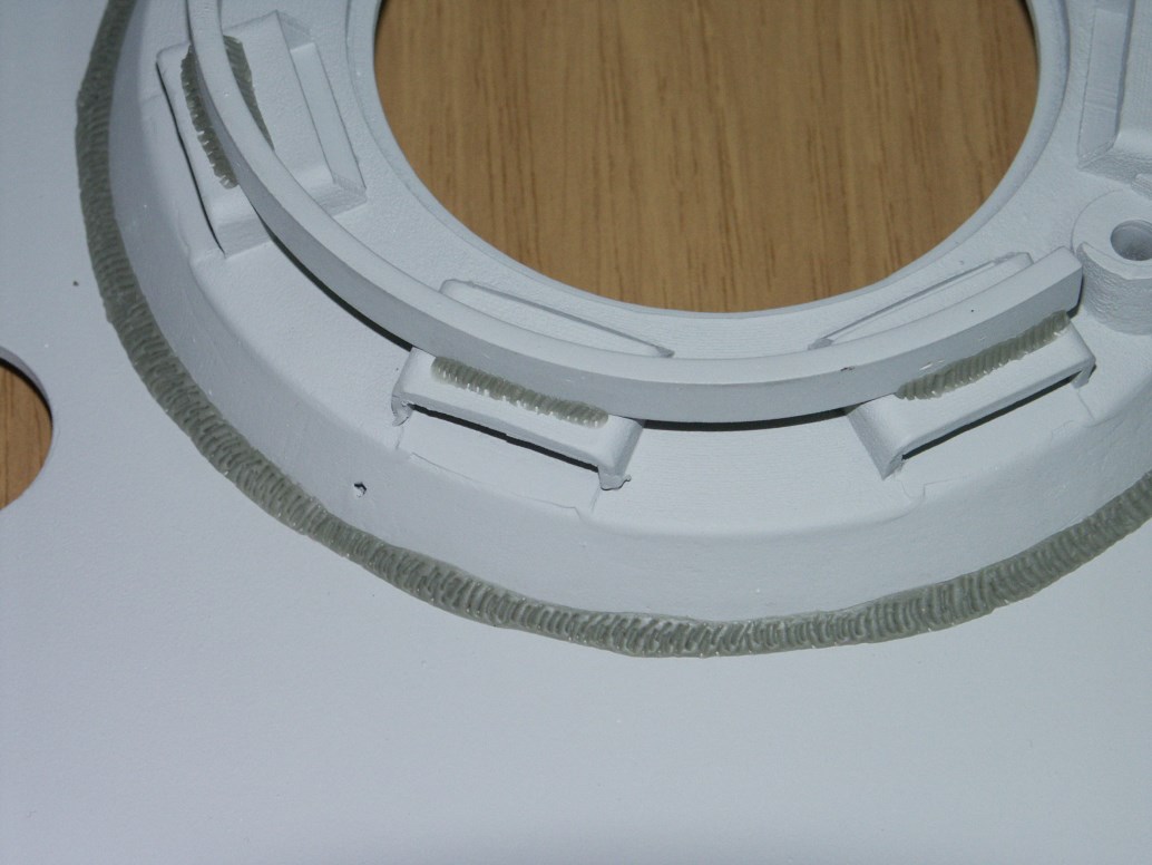

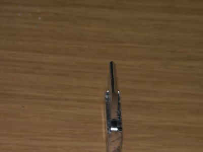

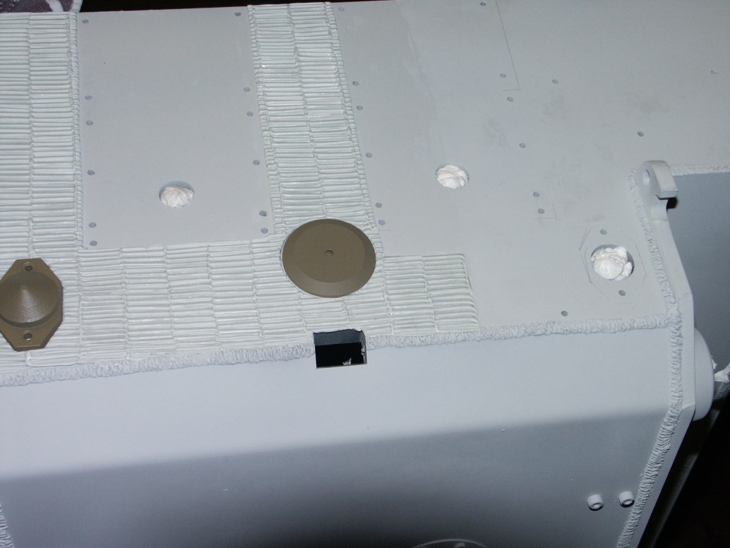

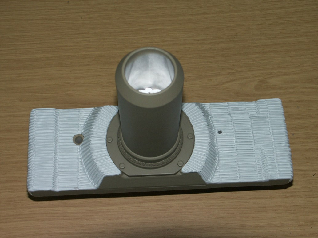

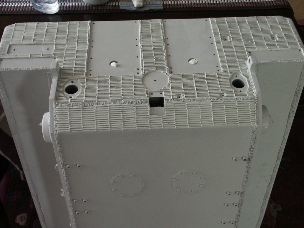

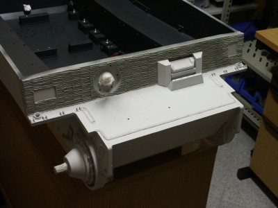

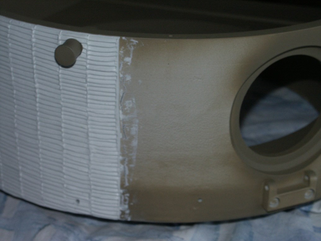

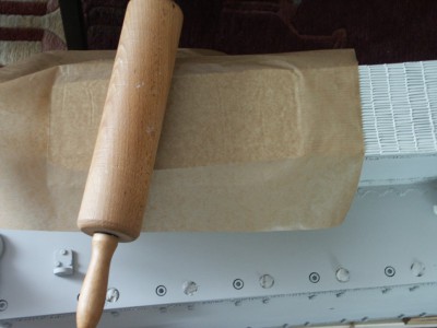

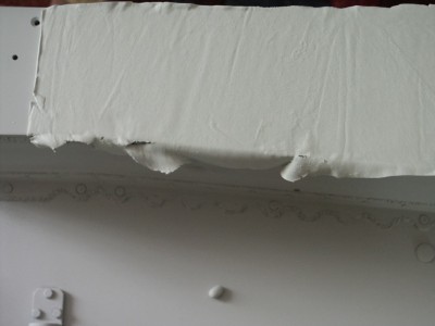

Hi Guys,

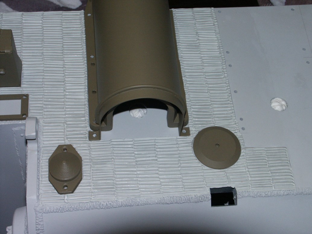

today I will show my way to manufacture Zimmerit.
The basic idea comes from Rich Stinchcomb.
I changed the way to work a little bit.
Material:
Apoxie Sculpt Total Consumption: 2,2kg (Zimmerit and welds)
Tile adhesive is very sensitive against shocks.
Also the suction behavior during painting changed the Strucktur of color significantly. To repair with apoxie sculpt is easy and durable.
4 layers of baking paper
2 straight welding wires 1.5mm
cutting knife
rolling pin
Material:
cutting knife
rolling pin

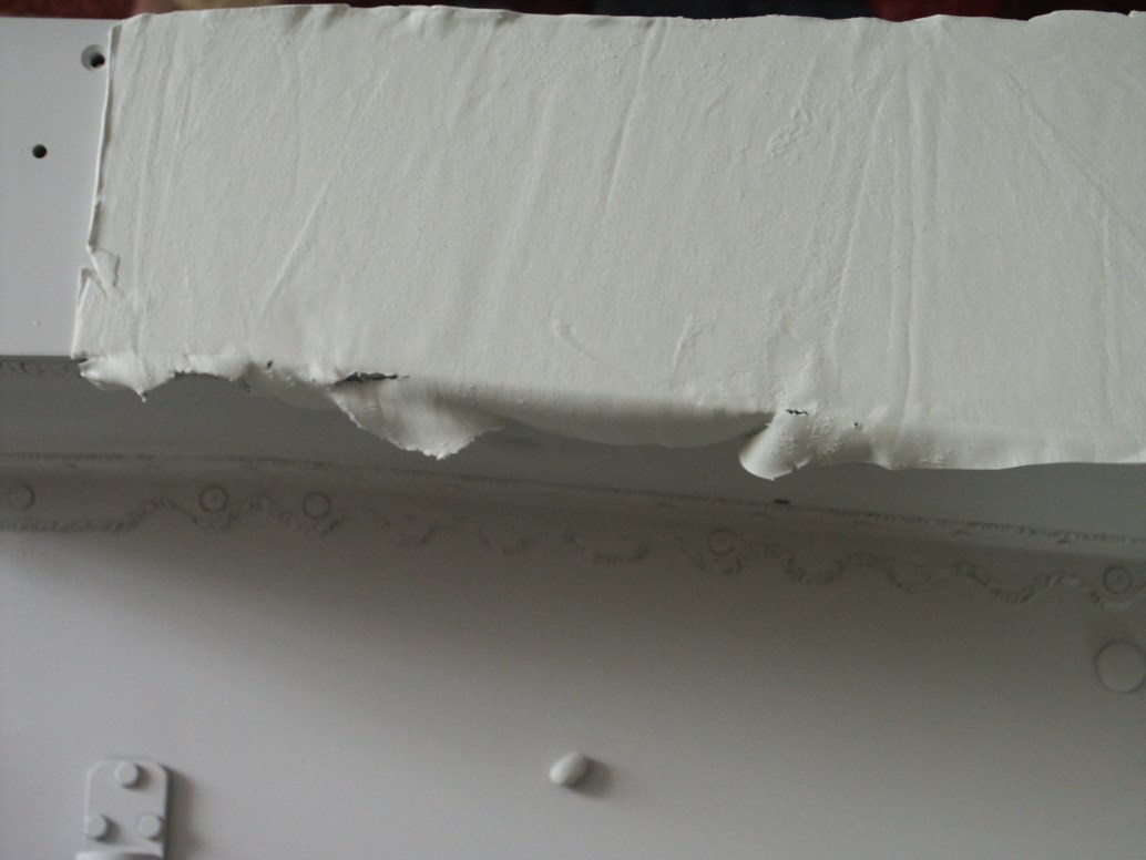

Hi Guys,
I forgot something important!
After coating, I lightly sprayed the area with osmosis water.
Otherwise Aapoxie Sculpt would adhere to the modeling knife.
The result would be bad.
(@ Iacopo)
Thank you for your friendly feedback.
I am very pleased.
I hope it's interesting for others.
Greetings,
Detlef
Next time: paintwork!
(@ Iacopo)
I am very pleased.
Greetings,
Detlef
