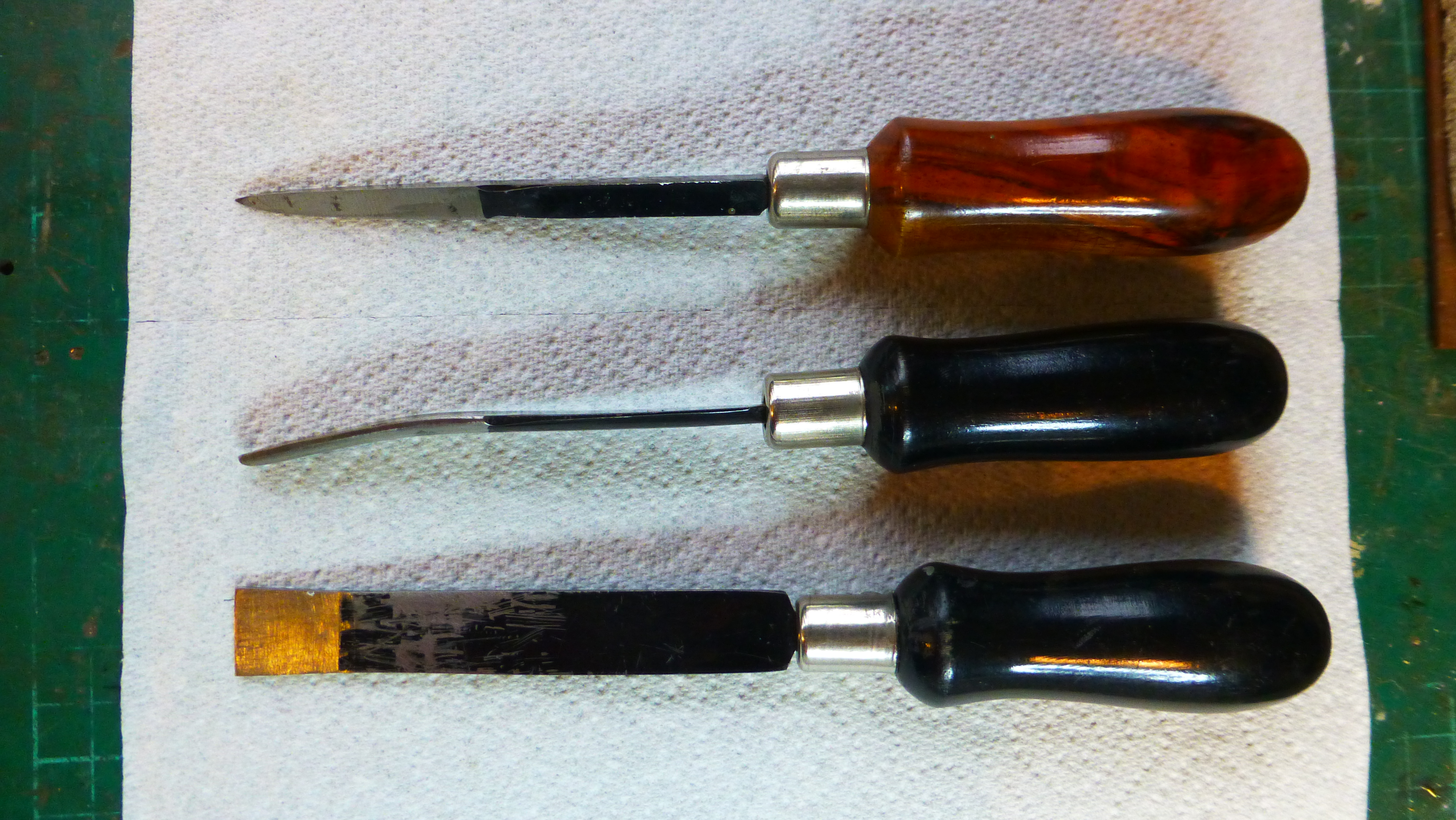

Strangely, the humblest of tools are often the most effective.
No self-respecting engineering apprentice would have been without a set of engineer's hand scrapers. They cost very little but are essential for removing burrs, sharp edges and any irregularities in surfaces. They are simple to use, effective and cheap. An example:
http://www.ebay.co.uk/itm/like/16127606 ... ue&ff13=80
The fits of Armortek parts as designed are very precise on tolerance and as manufactured are very accurate. Scrapers provide a finish to the parts removing any manufacturing witness marks and allowing a perfect fit. It's generally the case that if an Armortek part appears not to fit, it's either been fitted incorrectly, or it's not been cleaned up mechanically. It's highly unlikely to be a manufacturing or design issue.

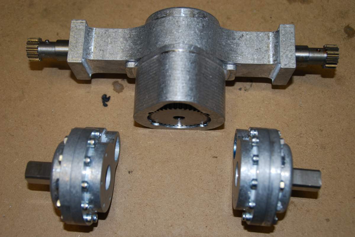

I have a question in regards to the Drive Axle. When incerting the Pinnion (JO441) into the Pinnion Gear (CM0249) does the pinnion (JO441) incert into the I.D.of the Pinnion Gear (J0441) all the way as far as possible before screwing in the GRUB M4x6?
The way I set mind up (see picture) is that I made the pinnion gear (CJ0441) just meet the Front/Rear Differentail while the main Gear pinnon (CM0249) rotate freely and smoothly.
As as result you can see from the picture that the back-side of the pinnion in the I.D.(CJ0441) is not flush with the Gear pinnion (CM0249). Should this be ok before closing the Gear Box.

Hi Tom,
Yes you'll have to set CJ0441 back as far as it can go, once in the housing CM0112 with the bearing 608ZZ in place and bolted down. Then you'll have to set the gear CM0249 back as far as possible, sitting behind the Housing CM0112 about 1/16th of an inch. Now lock your set screw, or Grub as the Brits call it. The reason why CM0249 has to be set back. When you get your Motion Pack, you will get a new part called a Trust Pad CM0116. A brass pad that mounts between Motor mount CM0108 and Gear CM0249. It prevents Gear CM0249 from working forward and flopping around.
I learned this the hard way once i received my Motion Pack, my gear CM0249 was set flush with the housing CM0112 and i couldn't get the Motor Mount to bolt flush because the Trust Pad couldn't go in because it was hitting the Gear CM0249. So' i had to re set it. I hope this helps, Tim
