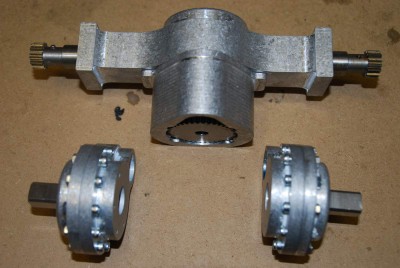

Tom, the reason I enlarged the radius on the bearing seats, rather than filing down the stems was because the parts fit together with no gap without the differential inside (Try this and see?).
So filing down the stems wouldn't really solve the problem in my case, and I couldn't reduce the bearing size, so the bearing seats got the rework. Hope this helps.

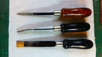

Strangely, the humblest of tools are often the most effective.
No self-respecting engineering apprentice would have been without a set of engineer's hand scrapers. They cost very little but are essential for removing burrs, sharp edges and any irregularities in surfaces. They are simple to use, effective and cheap. An example:

The fits of Armortek parts as designed are very precise on tolerance and as manufactured are very accurate. Scrapers provide a finish to the parts removing any manufacturing witness marks and allowing a perfect fit. It's generally the case that if an Armortek part appears not to fit, it's either been fitted incorrectly, or it's not been cleaned up mechanically. It's highly unlikely to be a manufacturing or design issue.

I had no problem with mine going together, although there are some burrs inside the housing that have to be removed or they may wind up in your gear teeth. I put thin layer of silicone around mine, i have it full of grease. That way when in time the grease breaks down, it won't leak out. Those gears all work well togehter, my 039 is now running.

On mine, I had already done extensive deburring, cleaned the edges, etc. The parts fit fine without the differential inside. When checking the bearing seats after deburring, visually as well as with a depth gauge, bearing in place, etc - the bearing seating seemed to be cut slightly too shallow(vs undersized), more on the larger part. I am more particular about areas like these with moving parts. Mine was a smaller gap than in Tom's picture.
Careful profiling and slightly more material removal closed the gap (I used a small/correct diameter flap sanding drum - nothing major). It was an easy fix and nothing to complain about.
