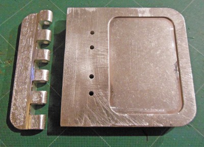

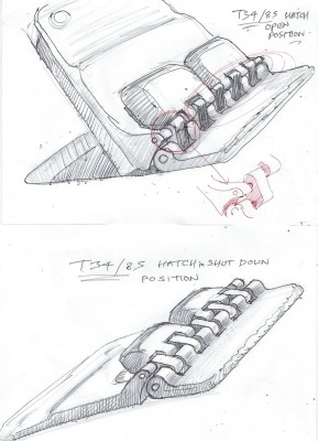

Hi Bodo,
I was going back over Armortek T34 POSTS section (Re: T34 Idlers. Thur Jan 03,2013.) recently and noticed your very own workmanship on making your own excellent detailed parts on your T34/85 driver's hatch, which I have followed from your pics, using them as reference to create my own drivers hatch for my T34/85 kit.
So far I have finished making the top hinge and ready to have a go at making the rest of the hatch with workable prisms etc.
From your own attached images I can see most of the hatch, but not clear how you made the other hinge parts which houses the periscope prisms covers area.
I have attached a few pics to show you how I made my first hinge and some drawings of the whole hatch.
I have circled the areas in red that I am not sure about and ask you if you be so kind as to show me how you made your own hinges in that area!
As you know it takes a lot of time to recreate, upgrade parts etc to one's tank, but I just want to get it right, and try not to make any mistakes, and seeing you had made your own, I would be very grateful if you could tell me how you did yours?
Or if you have any good references or technical drawings on the driver's hatch and it's hinges that would be good too!
Needless to say your workmanship is excellent and look forward to other upgrade parts you are making for your T34/85.

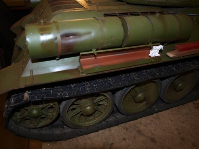

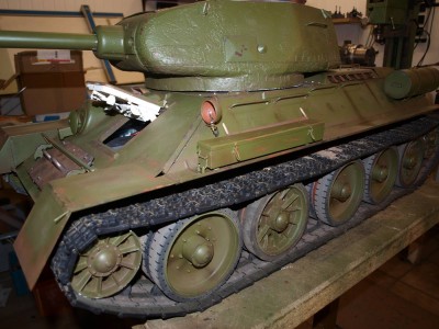

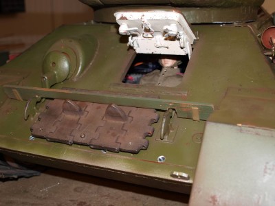

after a longer break from the T34 I restarted this project. Now I am nearly finished. I have added a lot of details and replaced a few components, you can see on the pictures.
Bodo
replaced roadwheels and sprockests.
working drivers hatch.
damaged spare tank.
damaged spare tank.

Destroyed searchlight and stowage bin.
phil fitzpatrick
Posts: 2020
Location: Sambourne uk
Been liked: 223 times
Re: T34 Idlers
Post by phil fitzpatrick »
Hi Bodo
Your T34 looks very nice,you have done some great work on it,I like
the damaged fuel Tank.
Phil
Kent Wiik
Posts: 425
Location: Northern Sweden
Has liked: 6 times
Been liked: 194 times
Re: T34 Idlers
Post by Kent Wiik »
Hi Bodo,
Good to see your work again and wow that is one good looking T34.
Nice to see how you got the correct height of her and the so characteristic T34 track link hang on to the wheels.
Well done!
Is that the brass track links from Geisswerk?
Kind regards
Kent

Posts: 2062
Re: T34 Idlers
well done bodo, a russian masterpiece, model or real tank? hard to tell, superb, regards simon manning.
Ian Rodney
Posts: 480
Been liked: 53 times
Re: T34 Idlers
Post by Ian Rodney »
Hi Bodo,
Great looking T34 you've got there, like the overall paint job on the outside….hope you solved the problem of the commanders vision blocks!
Ian
Bodo Langbehn
Posts: 109
Joined: Wed Jan 06, 2010 11:07 am
Location: Germany Black Forest
Been liked: 25 times
Re: T34 Idlers
Post by Bodo Langbehn »
Hi again,
thank you all for the nice comments about average skill!! Especially to Ian, who sent me some significant drawings concerning the vision blocks, I have to rework them again.
The paintjob isn`t finished now, I have to add mor weathering, when the tank is complete finished.
Bodo
