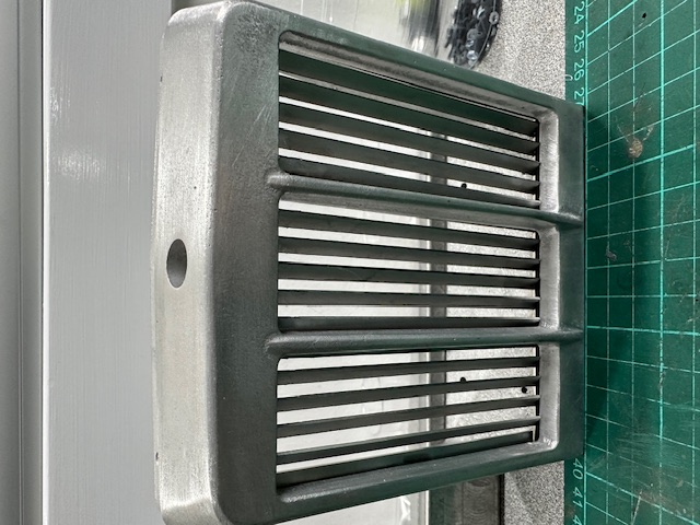

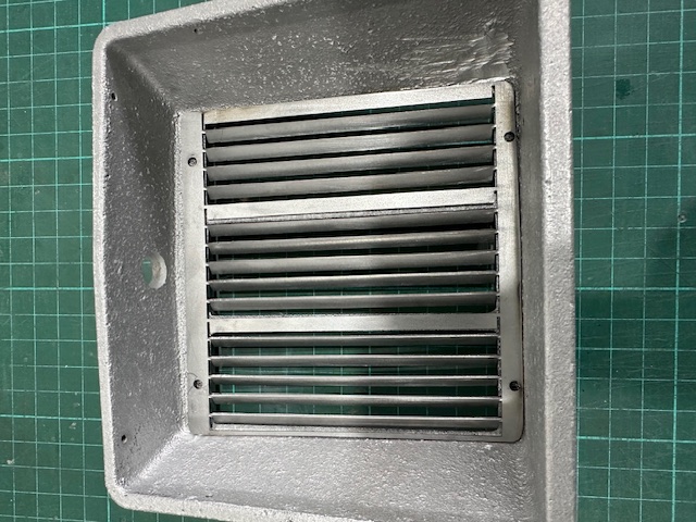

Took a while to workout which slats not to bend to fit behind the front cast ribs . I'm just wondering what type of scale and pattern material to use to simulate the radiator behind the slats ? ...Dale
