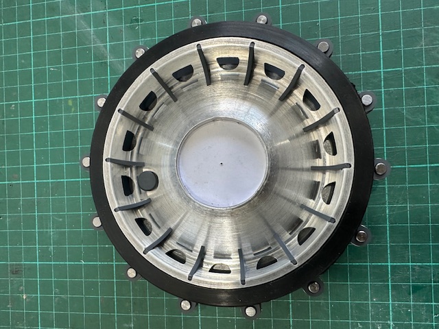

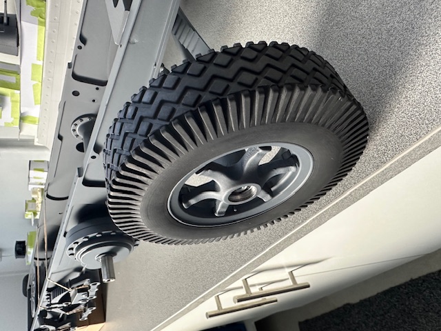

I'm after some tip's on the best way to get the front tires onto the rims ? Dale
Derek Attree
Posts: 1307
Location: london
Has liked: 219 times
Been liked: 200 times
Re: Dale Sdkfz 7 build
Post by Derek Attree »
Hi Dale
Not opened my kit yet but on the 2014 build the recommended way was to boil the front tyres to soften them and the push the hub in place , I seem to remember using a block of wood and a rubber mallet.
But it maybe different for the current model 🤔
Regards Derek
Colin Stevens
Posts: 65
Joined: Fri Dec 20, 2024 10:57 am
Has liked: 48 times
Been liked: 144 times
Post by Colin Stevens »
Mine fitted on real easy, just eased them on.

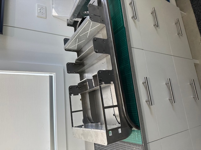

Little bid of work going on . I'm not sure if I'll stop working on running gear for now , and move onto top superstructure . May be Simon could chime in on the idea ? Dale

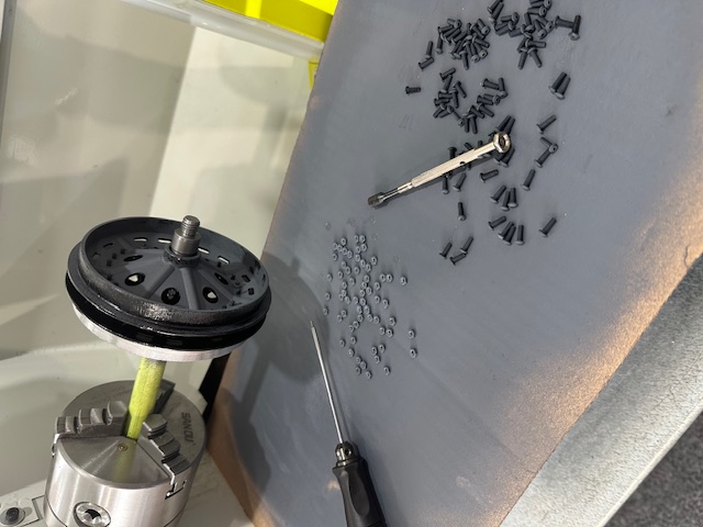

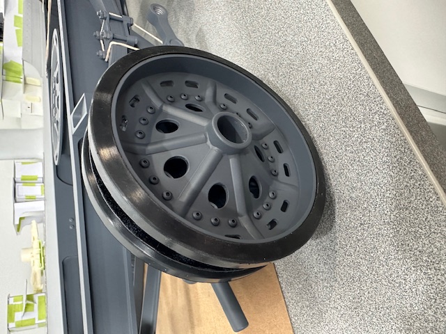

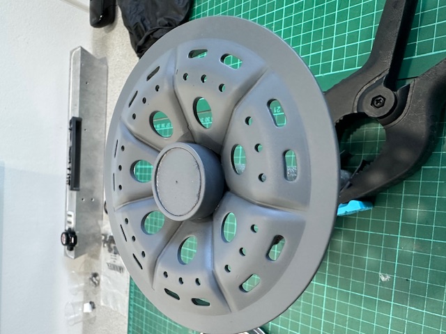

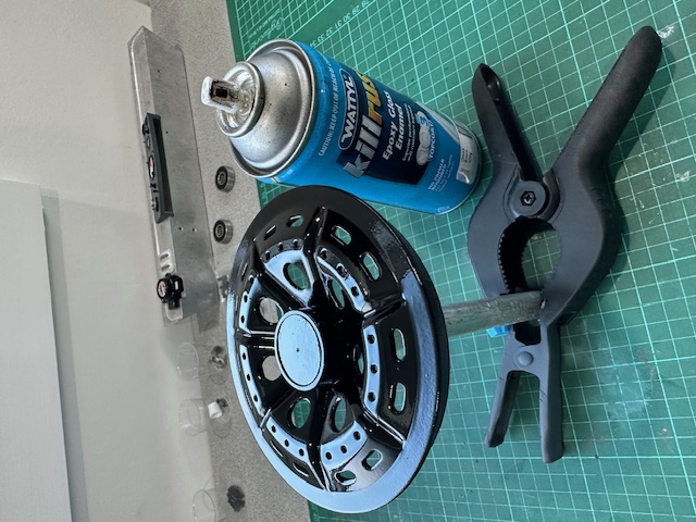

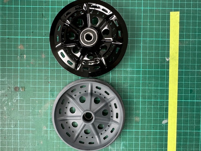

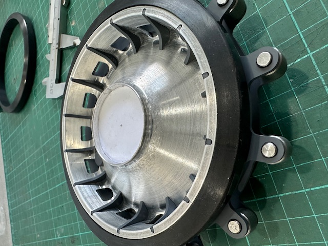

This is how I'm doing my double road wheels . First clean with prep wash , then etch prime both sides , I decided to use kill rust one step gloss epoxy paint which is a very slow drying up to 16 hours on the inside of the wheels It's a very tuff hard wearing top coat as this will protect against rust and wear as I don't won't to have to go back in between the wheels again . Adding all the nuts and bolts on my bench was a pain so came up with the idea of setting up in my lathe all the nuts and bolts were primed first as this will give a better coverage for the final coat of paint on the out side of the wheels , before I glue the rubber tires on .Dale

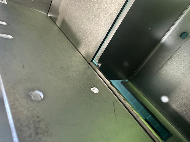

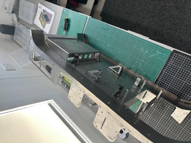

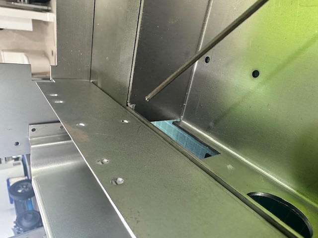

I'm not sure how the other kits are I needed to cut a notch in the top corner of the lower rear floor to bring up to there correct height .Dale

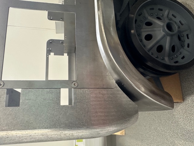

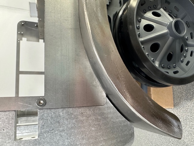

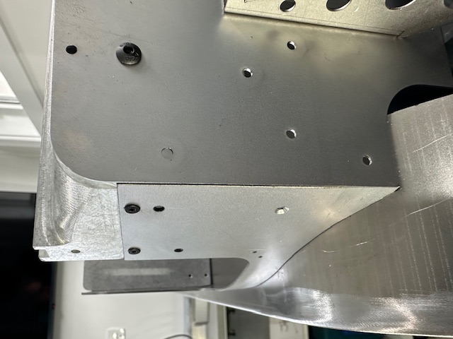

Looks like I need to drill tap and counter sink a M3 bolt to pull up the mud guard to the rear cast end .. Did any one else have the same ?
I think I have worked out how to have the top hull be able to lift off and still have some fasteners to hold it down Dale
Colin Stevens
Posts: 65
Has liked: 48 times
Dale jordan wrote:
Wed May 14, 2025 5:21 am
Yup, going to be drilling and tapping to pull the rear mudguards up. PLease post on your idea to remove the body work. I have had to remove the first small support to get the body work off.

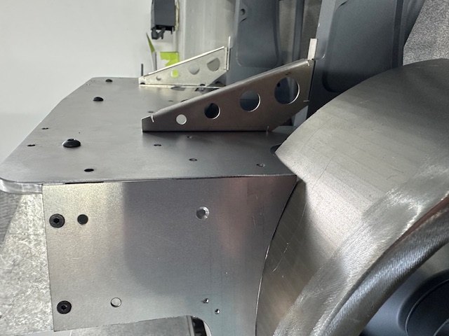

Dale jordan
Posts: 1455
Been liked: 512 times
Post by Dale jordan »
I fixed the gap forwards and aft with the guard when I put a straight edge on it I found it was bowed in the middle fix now . The front side panel up the front on the lower end where it bends over the mud guard needed bending out at the bottom to a line with the fire wall .Dale
