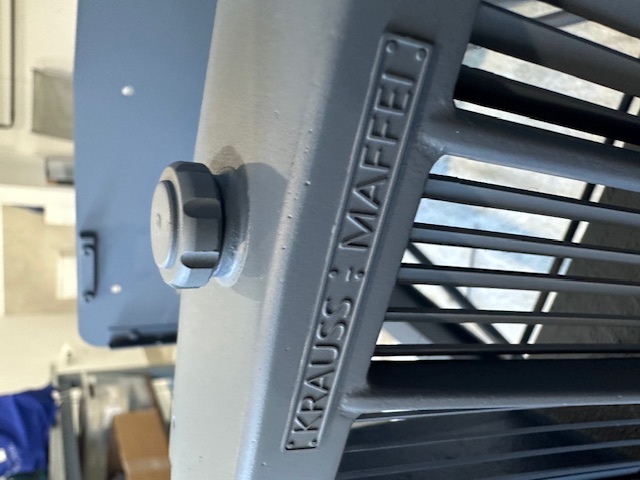

Took a while to workout which slats not to bend to fit behind the front cast ribs . I'm just wondering what type of scale and pattern material to use to simulate the radiator behind the slats ? ...Dale
Dale jordan
Posts: 1460
Been liked: 525 times
Re: Dale Sdkfz 7 build
Post by Dale jordan »
Little bit of detail work machined up a new radiator cap and flange .Dale
Posts: 2355
Has liked: 163 times
Been liked: 849 times
Outstanding Dale - that detail looks awesome!
