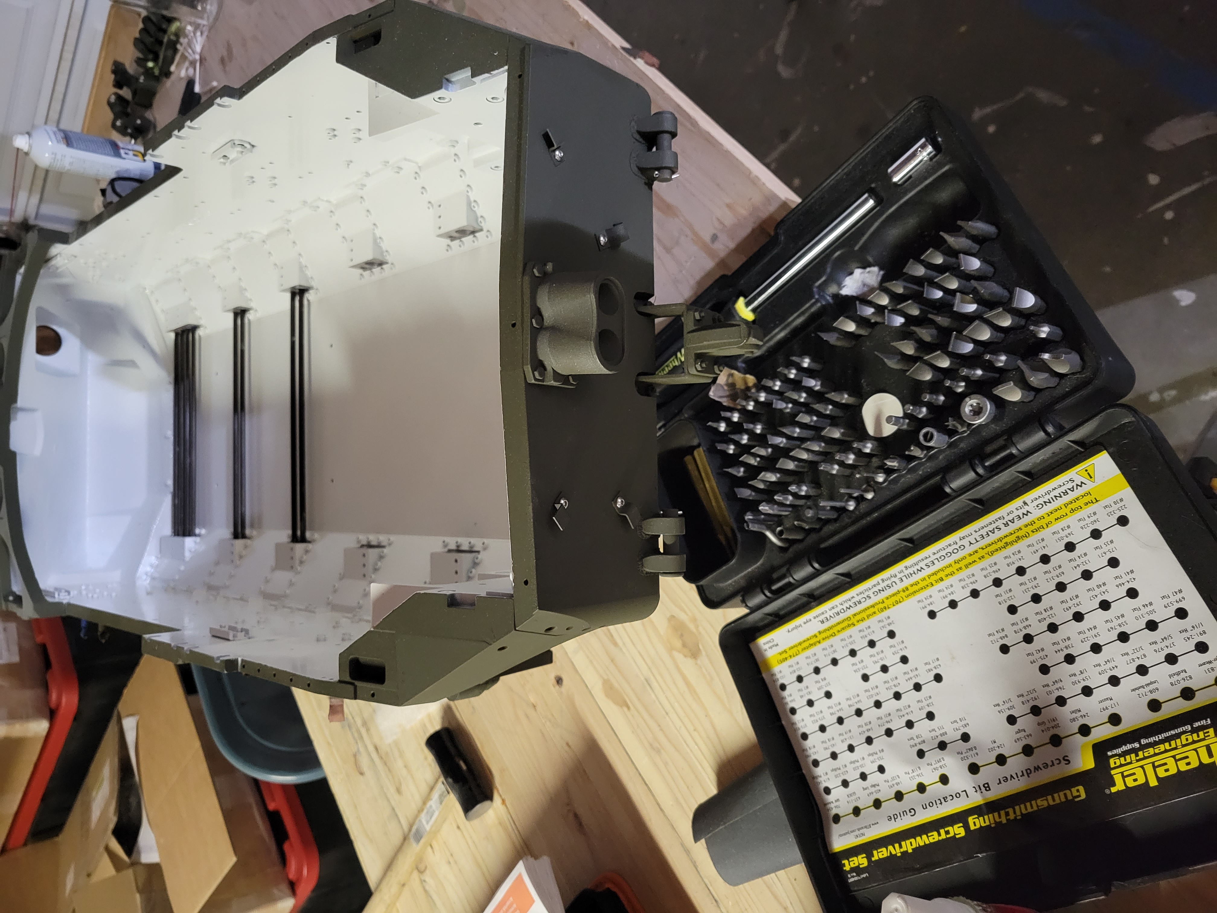

Progress so far and Doc had to try it on for size.

Looking good Aaron. Seems like just a week ago I was at that stage of the build (started my build in March).
I like the white interior - primer or finish coat? I left mine the UPOL etch primer gray.

Thank you....It's a primer enamel blend rustolem spray it's pretty durable once cured. The exterior is flat olive drab tamiya and will have a lighter dilute shade to highlight the mechanics the top clear coat will be cerakote clear ceramic. The Tamiya paint is more durable than I gave it credit for and also the color I wanted.... it's hard in this area to find decent spray cans in the amount i needed for some reason.

I bought a bunch of bottles of the Tamiya Olive drab but then switched to a Rustoleum Camouflage green spray paint which like the white you used, is a very durable finish. Slightly darker than the Tamiya but I was unsure how the Tamiya would hold up. I ended up using a lot of Tamiya and Vallego paint for the weathering and found that the Tamiya would have been fine, but still happy with what I used. I used many cans of paint for the M26, I think about 8 not including the primer. But I primed and painted all surfaces before assembly, then touched up afterwards.

Yeah I've been doing the same primer on everything if I had the rustileum I would use it next time. But I can't complain tamiya is not the toughest but better than I thought ceracoat on it it will be more than durable. I made the interior white much like the real tank so I could see inside to make any adjustments easier in the field ....I'm on the fence about weathering a model this size one trip on the dry lake bed it's weathered naturally cause it's a real fine dirt (very smooth surface)....which is all we have in the Mojave Desert.
