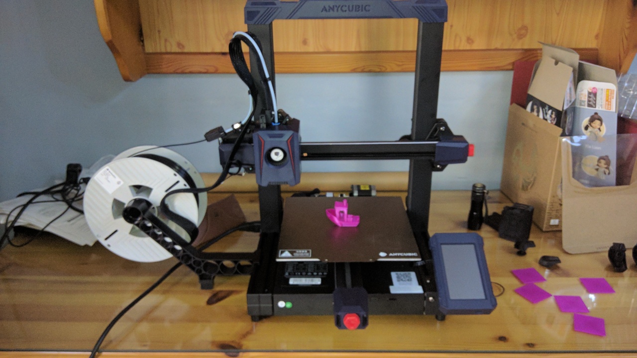

Finally, after a lot of toing and frowing I got myself my first ever 3d printer. It's an Anycubic Kobra 2 FDM printer.
Earlier this year I nearly got myself a resin 3D printer but eventually decided that the technology wasn't mature enough with many complaining of print and FEP failures. Also it is a bit messy and I could not find any liquid resin locally which makes running it fairly expensive for me.
Last May, Anycubic introduced on the market it's latest budget FDM printer. I waited a bit to see what people thought about it and eventually got myself one as it seemed geared for a beginner and not expensive and free delivery to boot.
I have been playing with it for some time. It is easy to set up and what I found strange is that it came with a Prusa slicer. Usually Anycubic tends to come with Cura as a slicer. One can still use the Cura slicer but I suspect the Prusa slicer might take advantage of the fact that it can print very fast (default is 150mm/s).
So why did I get it? To do something new I guess. Also, I have many highly detailed 'private' 3D models which I would like to bring to life. With this FDM printer I will be losing all the fine details but at least I can actually hold the part in my hand.
After a lot of trial and errors (mostly failures for now) I have managed to get something reasonable. Still far from good but still learning.

I think resin printers (I use an Elegoo Saturn) are best for small parts, whereas an FDM printer is best for large prints - especially 1/6 scale tanks !
Be aware, also, that FDM prints can melt if left in strong sunlight, where resin is much more stable.
Have fun with your new toy !

Awesome Vince! You will love it! I echo Chris - I have Elegoo Saturn and love it. There is a learning curve with resin just like FDM. But both are great addition to tank building! BTW I really like Prusa Slicer as well.
Best regards and have fun!

Thanks Chris and Bob for your comments.
I was amazed at the plethora of settings that can be changed in Prusa. I need to check if there are some Utube beginner tutorials on using Prusa slicer. In the meantime the plastic reject heap continues to get bigger.

Welcome to the frustrating world of filament printing, between us we have been producing superb parts for a few years now. Keep us all posted on your progress as it's a fascinating subject!

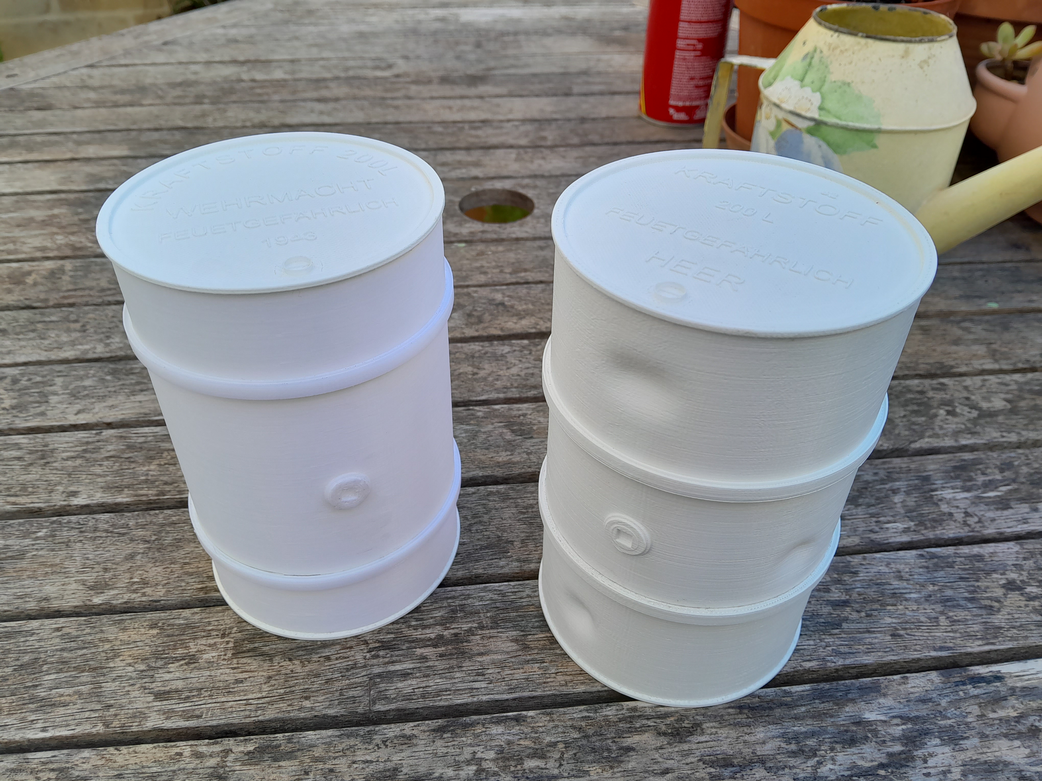

As I suspected would happen, I haven't used the printer for some time. So decided to go through the 3d models to see if there is something I could print. Came across a 200 litre oil/fuel drum I made for Phil some time ago for his 1/4 scale panther.
Used the dimensions of a modern 200L drum as reference and drew it up using separate independent parts for ease of printing. Learned that what looks OK on a computer screen does not always equate to a good physical print. After printing the different parts I noticed some drawing boo-boos. There were clearance issues between some of the parts and the top and bottom faces of the drum fell apart when I removed them from the print bed. Back to the drawing board.
Fixed the clearance issues and also the top and bottom faces. Reduced the height of the embossed lettering and also added a small plug to the top face like on modern drums. Later on looking at period photos noticed that this plug was not there so I need to remove it again. Hopefully also find a way to fillet the lettering if possible.
Glued it up together and it looked too squeaky clean. How about adding some dents and knocks to the drum wall? But how? I knew how but was just avoiding using a particular feature of Fusion because I always thought that it was complicated to use. A few Utube videos later I gave it a try. Still feels complicated but managed to do something. Had to "sculpt" a new drum wall from scratch to simulate the dents but can use the other parts from the previous version.
Cut the model differently from the previous model for even better ease of printing. Printed the various parts and glued them together.
Looks much better with the dents. I used two different branded filaments. The one on the left used mostly Anycubic filament and the one on the right was Verbatim filament. I think I prefer the Anycubic filament.
Have to fix it again as I made the new drum 5mm higher.
P.S.
Could someone tell me what colour these drums were painted? Or were they left unpainted in bare metal?

Hi Vince. Pretty sure they were left in a galvanised bare metal finish. The bands tended to rust so looked brown. There are quite a few WWII colour pics on the internet showing them in this state.

Many thanks Simon for that info.
I have just now found two references which say the same thing you said. It seems also that drums made in 1944 and 1945 were painted dark yellow as they were not galvanised during that period.

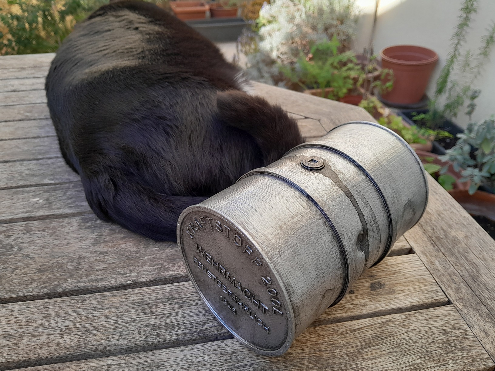

A little update on the dented drum saga.
After I finished the IR mount project for the Chieftain guys (hope you liked it) it was time to get back to the 200L drum. Made the necessary corrections and also managed to fillet the embossed letters (hardly shows at 1/6 scale). I guess it was third time lucky as I am happy with it. It was in five parts and eventually glued them up after running out of glue half way through.
My wife is in Japan with youngest daughter for the Sakura (cherry blossom festival). Was supposed to have happened four years ago but COVID threw a spanner in the works. So I am home alone babysitting the cats and thought that I would bring everything home and try to paint it. I am going for the stainless steel version so sprayed silver with a rattle can. Now I am starting to dirty it up with a dark wash.
I am applying the dark wash with a small brush and then with a paper towel removing the excess and the brush strokes. I don't know the appropriate English word but I am not wiping with the paper towel but touching the painted surface with a gentle vertical up/down movement (what's the word for this?). It seems to be giving the desired dirty look but I suspect I have to do it again a couple of times.

A little more 'dirtying' of the drum. This drum project seems to have a life of it's own. Maybe more things to be added.
I'll give one more coat of dark wash and call it a day.
