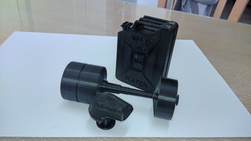

Today I printed a part. Actually three parts that go together. Usual horrible print where supports are concerned but not really bothered as it was more of a proof of concept.
I made the following 3D model for a forum member here some time ago. It took a couple of weeks to do but at the end he asked me if it could be made functional, i.e. closes and opens. This took me a bit by surprise but made an CAD assembly to animate the model and luckily on the monitor it looked like it could be functional. I told him I had my reservations of how long it would last and sent him the files for resin printing because of the details. Haven't heard if this was actually used or not.
Usually I delete files like this after a while but for some reason I kept this one. Today I printed the three major parts and used metal rods at the pivot points.
https://youtu.be/W8xiWSZSvAg
If this forum member is seeing this I am happy to report that it is fully functional and that I was wrong in my initial assessment that it would quickly break.
Can anyone recognise this part? It was meant for an English Armortek tank. Can't remember which one though. Part used on turret.

Looks like a gunner´s sight hood, not quite right for Chieftain so maybe Comet ?

Thank you again for all your hard work in producing this part. I still haven't found anyone to resin print it for me, so it's really good to see it in the flesh as were and to know that the lifting cover mechanism all works out ok as planned. Unfortunately my Chieftain build is a long way off completion, but I look forward to the day I can give this little jewel pride of place on the turret.
With all your skill for design, I'm intrigued to see what else you will be producing with your new toy.
All the best David

First of all I would like to apologise for not remembering it was you and for which tank it was meant for. I must be getting senile. As I said I only kept the 3D model but deleted all our emails and photos of the real thing. Also I believe you said that this part was not fitted to all Chieftains.
I hope that when you get to that stage your print will be a 100 times better then what you saw today.

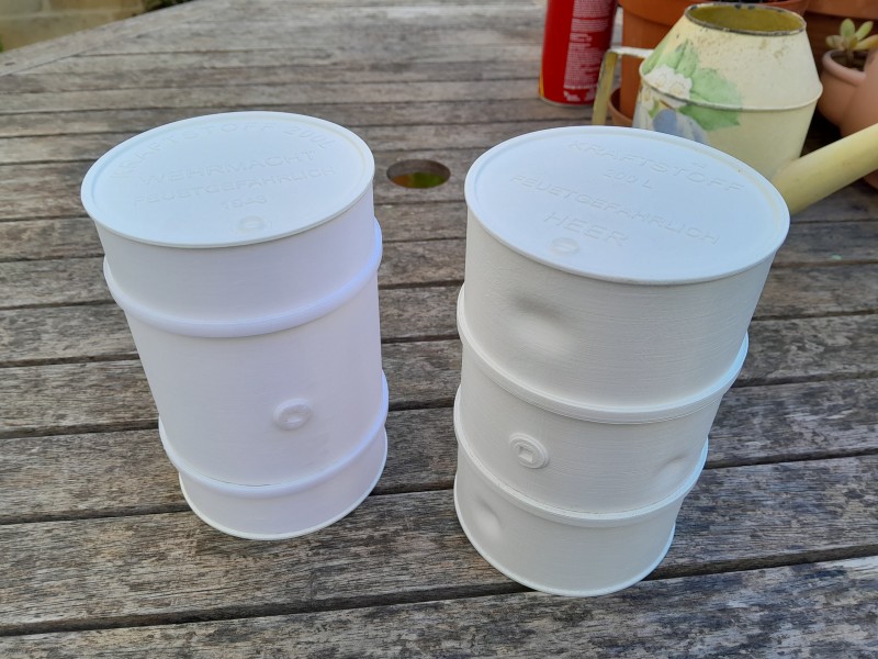

As I suspected would happen, I haven't used the printer for some time. So decided to go through the 3d models to see if there is something I could print. Came across a 200 litre oil/fuel drum I made for Phil some time ago for his 1/4 scale panther.
Used the dimensions of a modern 200L drum as reference and drew it up using separate independent parts for ease of printing. Learned that what looks OK on a computer screen does not always equate to a good physical print. After printing the different parts I noticed some drawing boo-boos. There were clearance issues between some of the parts and the top and bottom faces of the drum fell apart when I removed them from the print bed. Back to the drawing board.
Fixed the clearance issues and also the top and bottom faces. Reduced the height of the embossed lettering and also added a small plug to the top face like on modern drums. Later on looking at period photos noticed that this plug was not there so I need to remove it again. Hopefully also find a way to fillet the lettering if possible.
Glued it up together and it looked too squeaky clean. How about adding some dents and knocks to the drum wall? But how? I knew how but was just avoiding using a particular feature of Fusion because I always thought that it was complicated to use. A few Utube videos later I gave it a try. Still feels complicated but managed to do something. Had to "sculpt" a new drum wall from scratch to simulate the dents but can use the other parts from the previous version.
Cut the model differently from the previous model for even better ease of printing. Printed the various parts and glued them together.
Left is version 1 and right is latest version.
Looks much better with the dents. I used two different branded filaments. The one on the left used mostly Anycubic filament and the one on the right was Verbatim filament. I think I prefer the Anycubic filament.
Have to fix it again as I made the new drum 5mm higher. :oops: :evil: :evil:

Hi Vince. Pretty sure they were left in a galvanised bare metal finish. The bands tended to rust so looked brown. There are quite a few WWII colour pics on the internet showing them in this state.

I have just now found two references which say the same thing you said. It seems also that drums made in 1944 and 1945 were painted dark yellow as they were not galvanised during that period.
