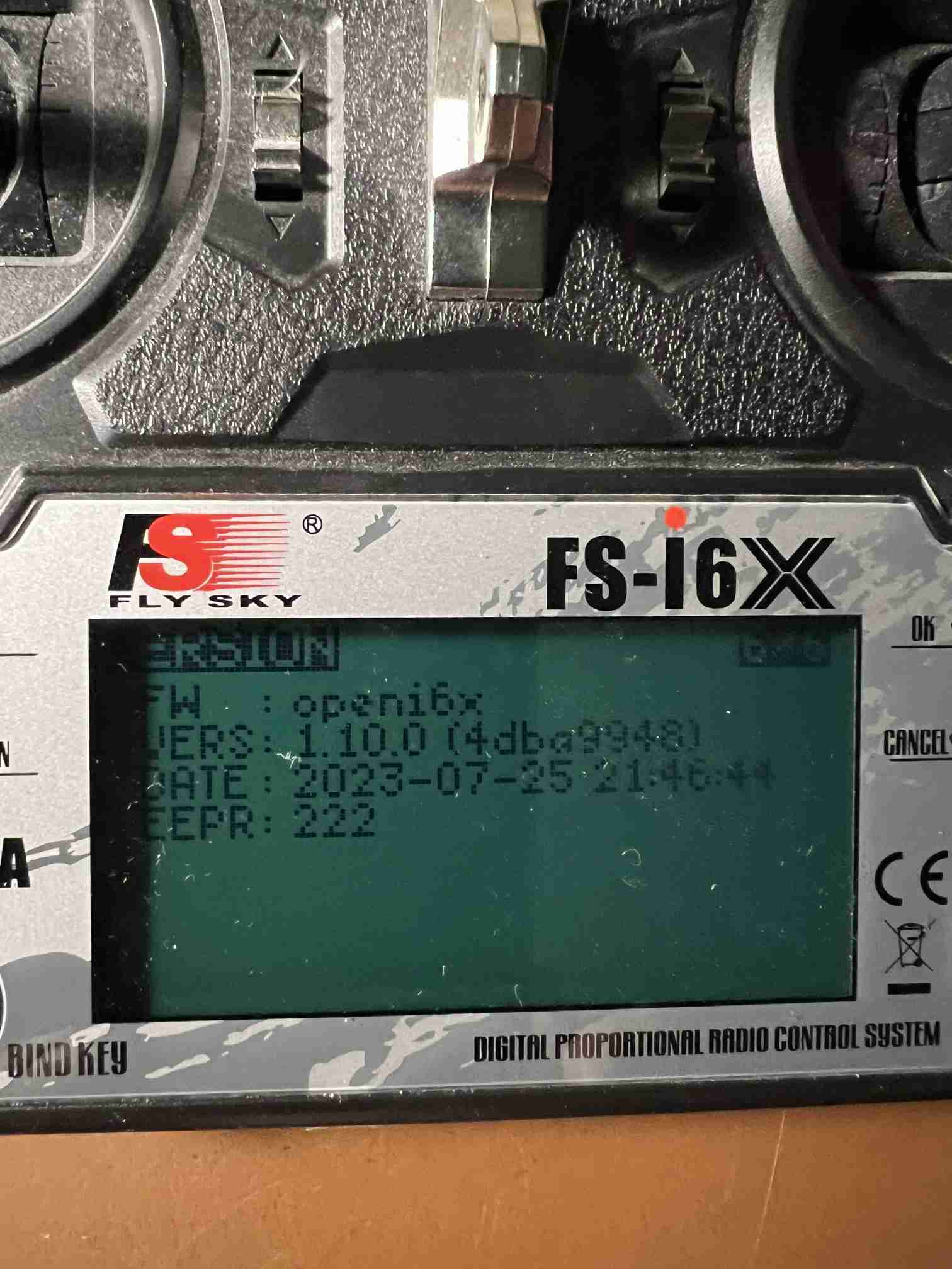

I was able to flash a version of OpenTx to my i6x. There are a few wiring mods I may try to squeeze a bit more utility out of this thing.
There's good information here: https://github.com/OpenI6X/opentx#adjus ... -level-mod
