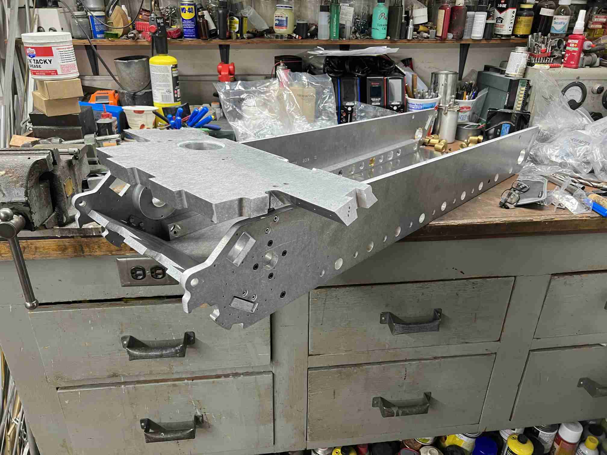

If I could offer any insight from mine, it would be: Check the hull sides and rear plate for warp-age. They have to be dead on or all sorts of issues can raise their head pages later in the manual. Particularly critical is the fit of the the lower hull sides to the rear plate. Any silliness there and you could run into problems getting the track tensioners aligned and operating smoothly.

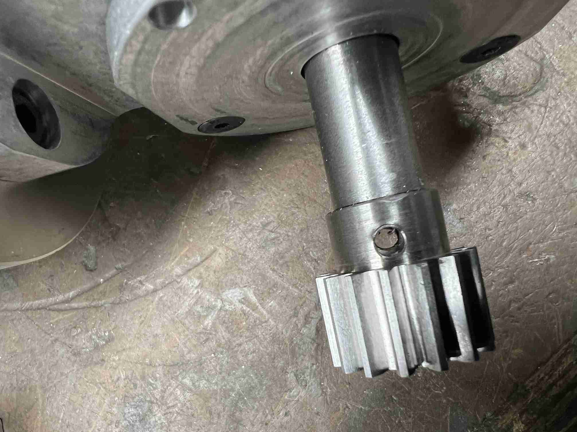

The second motor appears to have a bent output shaft. Its rotation correlates to the change in pitch I hear.

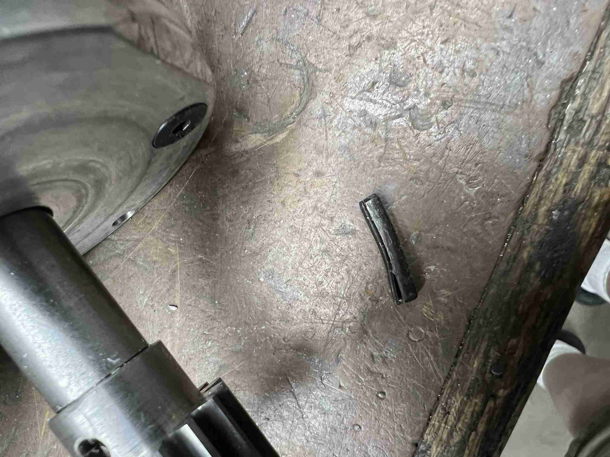

I went ahead and took that motor apart. This is not a new issue for me as my parents told me the first thing I did with my toys as a wee lad was to take them apart to see the guts. I've gotten better since than at putting things back together.
Yes I know the warranty went out the window, okay I got that.
During my disassembly I noticed that the pin hole for the pinion and the shaft are not well aligned. The rolled pin was forced in to the point where it
was bent like a banana. Hmmm.
What I found was somewhat surprising. I disassembled it as far as I dared and try as I might I could not remove the outer (M 1.5??) pinion gear
from the shaft. It is 'ON THERE' for keeps. I tried a gear puller to no avail and was going to use my 20 ton hydraulic press before I stopped myself
from doing damage. I decided I will live with this thing as is for now.
I was able to remove the bevel gear from the shaft ; this appears to be a hypoid helical bevel gear but I may be wrong. Carefully putting this precious gear and key aside I decided to mount the shaft with remaining flange and the resistant pinion gear in my lathe where I could use a dial indicator. I held in by the greater diameter section where the bevel gear mounts and set the dial indicator first at the shaft just before the pinion and then on the pinion's flange avoiding the pin hole. To my surprise and pleasure I found the run-out to actually be minimal, no more than +/- .003" which I can live with.
So why the run-out when assembled? I noticed that the output shat is supposed to ride in a large ball bearing however this is a very loose fit,
almost sloppy. I believe here is where the deviation from running true comes from. As a test I held the motor fixed, then ran it while pressing against the shaft with a thick piece of aluminium. The run-out lessened noticeably.
So long story short is I don't like things to not run true but assuming it doesn't not affect running I will live with this. Should it ever fail I will make
a new shaft and replace whatever gear need replacing hoping that pretty helical gear is not one of them!
Onward!

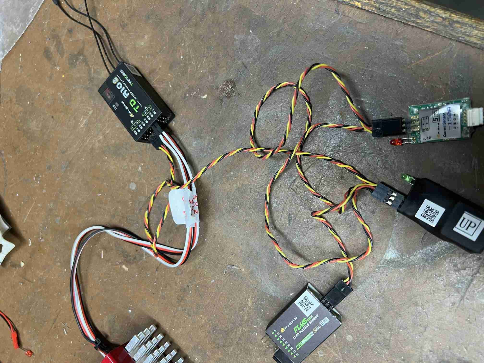

Telemetry. I love gadgets. I have, on the one smart port three sensors daisy chained, a current sensor, a voltage sensor and for no other reason than I could: a GPS unit! As I said I love gadgets. I'm next going to try my hand at defining additional views to display the Telemetry data.

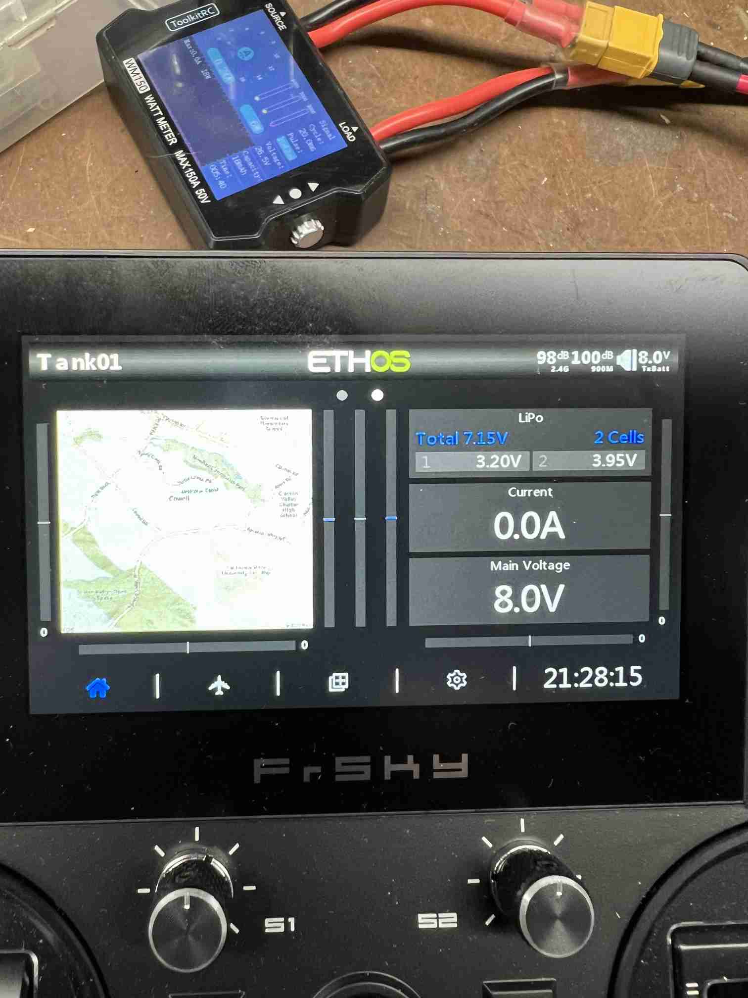

I neglected to mention that discovery of the smart port sensors is as easy as I've ever experienced.
I've included a preliminary screenshot of a secondary screen I defined using various inputs to populate the widgets, GPS( or course!),
voltage for main (LiPo), Current and main system (Xmitter) voltage. I used another LiPo pack for the input as I haven't decided where I'll put the inductor to read the current. I'd previously 'Jerry' rigged (I believe I'm allowed to say that) a temporary connection just so I could see it work with the actual battery but as it's pretty much a permanent installation when it's done and I don't really know yet where I'm going to place it in the model... I use a stand-in battery to see some movement.
You can't possibly see the GPS map but it's one I used a tool (https://ethosmap.hobby4life.nl/) to create a local map of my area. I'm going to remake this map to be a bit closer detail and recheck the GPS coordinates they provide, but it does work and it's fun to see! Totally useless really but the gadget appeal is worth it... At some point I have to try designing my own lua script to be invoked via a switch to tell the model to come back home to it's starting point. I can't see why I won't be able to persist the originating GPS coordinates for the duration of a run. I moved the system around my backyard prior to building this graphic widget and cross checked the longitude and latitude values with a handheld GPS and they're exact. The map and script is cute but as I said pretty impractical.
So on to FPV.
Ain't technology grand!

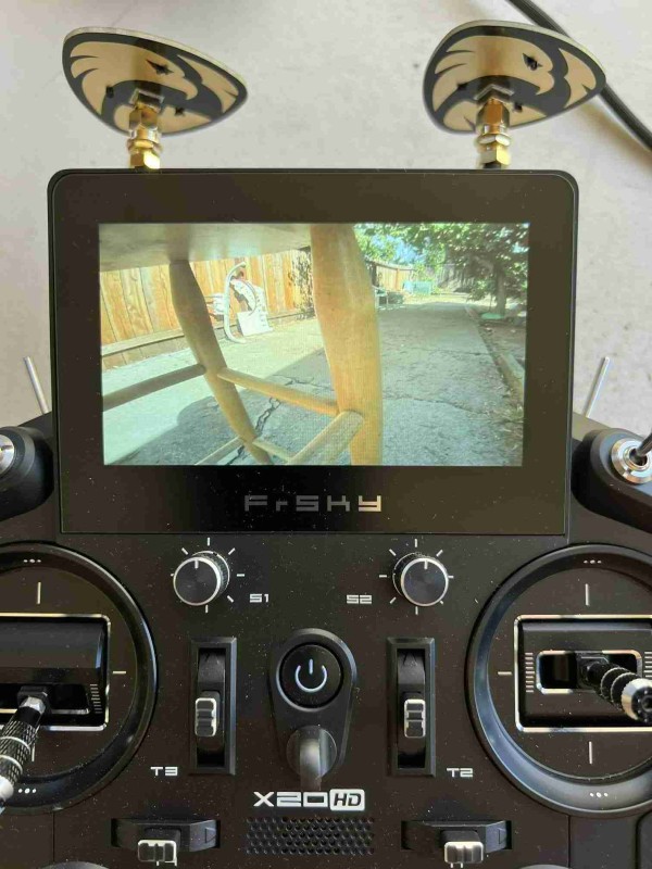

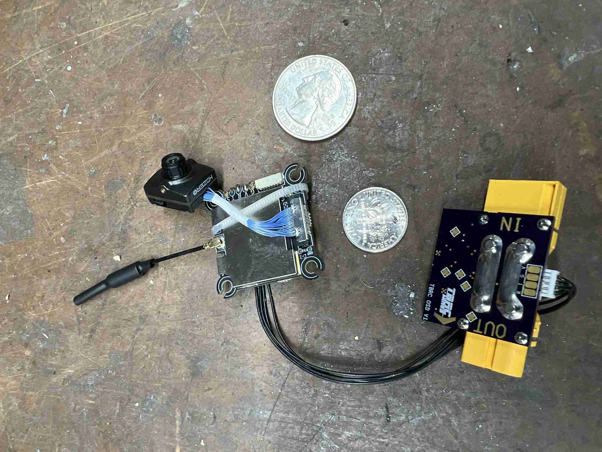

I performed an initial test of the fpv system I wish to use with this build. That the components were most originally intended for
aircraft the components are comparatively tiny as may be seen in the photo.
The components used are an HDZero 'Whoop Lite' VTX - the video transmitter, a HDZero Camera and a TBRC OSD ( V1) -on screen display, that
powers the VTX and will also send embedded telemetry data (in the video stream) of it's own regarding the main battery. A plus
is the OSD is capable of running directly off of the 24 volt main battery as an in-line component.
For the test I propped up the components on a stool at the end of my yard and simply used a rather tired Lipo 7,4 volt pack to power the OSD which is at the bottom of the range it requires. It can use up to a 8S pack (28-29volts?) but delivers the required voltage to the VTX which is 10v. I would have used my large LiFePo4 packs but I need to make a adapter cord.
I'm quite pleased with the video quality, remains to be seen how the 5,4ghz stream will work from a heavy metal model. I don't plan on embedding
this system permanently in any model. It's small, light yet gets quite warm in use so I think some implementation partially exposed should work. Haven't finally decided.
Except for having to do some annoyingly twitchy mini-soldering onto the VTX board ( the solder just didn't want to wet the solder pads!) to provide a communication line from VTX to OSD the setup compreised of
1)powering up the X20HD transmitter and switching to DISP mode
2) powering up the fpv system.
The video stream displayed immediately- I didn't need to hunt for the correct video channel.
I think I can start building now...!

Preparing to assemble the lower hull. Identified some unusual characteristics of the rear hull plate and brought
it to the attention of Armortek. In the meantime reviewing assembly to determine how I want to approach this.
If I want to apply any modifications
Deciding if I want to make or have made steel sprocket rings though I would prefer the latter if steel is the way to go.

Trial fitting lower hull components. Already this beast grows heavy. I knew I shouldn't have given up weight lifting early. At university I did
mix a weigh lifting course in among my chemistry major course work - I was able to deadlift 350 pounds at one point....
That was ages ago and surely doesn't help me now...
Onward!
Onward!
