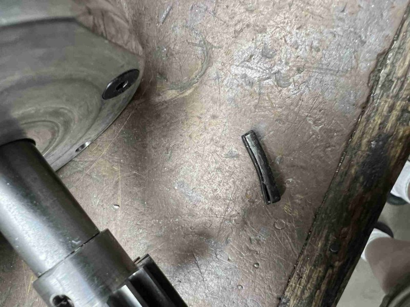

The second motor appears to have a bent output shaft. Its rotation correlates to the change in pitch I hear.

I went ahead and took that motor apart. This is not a new issue for me as my parents told me the first thing I did with my toys as a wee lad was to take them apart to see the guts. I've gotten better since than at putting things back together.
Yes I know the warranty went out the window, okay I got that.
During my disassembly I noticed that the pin hole for the pinion and the shaft are not well aligned. The rolled pin was forced in to the point where it
was bent like a banana. Hmmm.
What I found was somewhat surprising. I disassembled it as far as I dared and try as I might I could not remove the outer (M 1.5??) pinion gear
from the shaft. It is 'ON THERE' for keeps. I tried a gear puller to no avail and was going to use my 20 ton hydraulic press before I stopped myself
from doing damage. I decided I will live with this thing as is for now.
I was able to remove the bevel gear from the shaft ; this appears to be a hypoid helical bevel gear but I may be wrong. Carefully putting this precious gear and key aside I decided to mount the shaft with remaining flange and the resistant pinion gear in my lathe where I could use a dial indicator. I held in by the greater diameter section where the bevel gear mounts and set the dial indicator first at the shaft just before the pinion and then on the pinion's flange avoiding the pin hole. To my surprise and pleasure I found the run-out to actually be minimal, no more than +/- .003" which I can live with.
So why the run-out when assembled? I noticed that the output shat is supposed to ride in a large ball bearing however this is a very loose fit,
almost sloppy. I believe here is where the deviation from running true comes from. As a test I held the motor fixed, then ran it while pressing against the shaft with a thick piece of aluminium. The run-out lessened noticeably.
So long story short is I don't like things to not run true but assuming it doesn't not affect running I will live with this. Should it ever fail I will make
a new shaft and replace whatever gear need replacing hoping that pretty helical gear is not one of them!
Onward!
